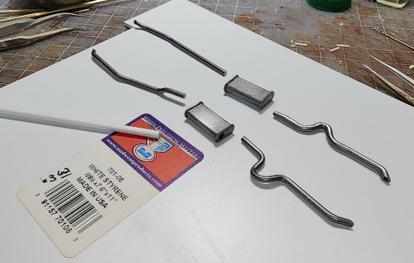

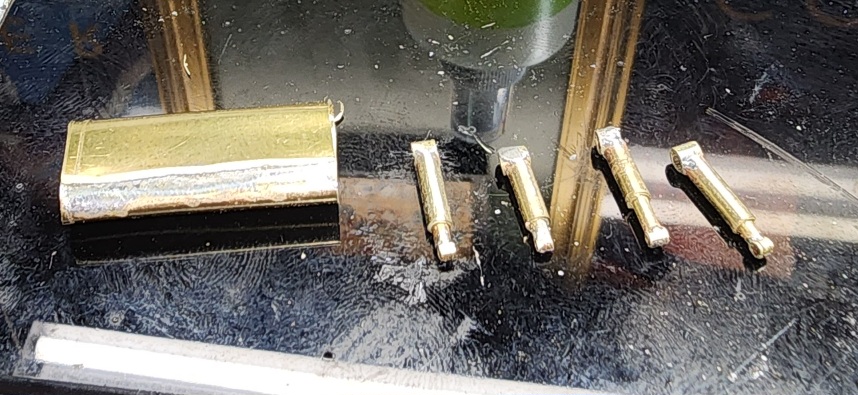

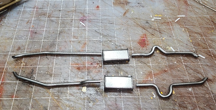

Yeah, it worked and they look good. I have thee soldering irons. One is a 140W industrial gun, a 60W and a 30W. I used 2 different solder wires, .031" diameter and .062" diameter, both rosin core. The only thing consistent with every fail was the flux. I only have one kind of flux, AquiFlux hard soldering liquid flux. I need to get a differnt flux and try again.Sounds like the work piece is not getting hot enough before the solder melts. What you have looks good!![]()
Yessir, then alcohol to clean off dust and whatnot.You cleaning the work piece first, like sanding it?
And it's very dirty. I did a comparison somewhere between some electrical flux and plumbers, maybe it was solder paste...going digging in photos.Additional fluxes like plumbers flux are designed to work with gas torches and need high temps
That is exactly what was happening. Thanj you Paddy. I am so relieved I figured out to not use the flux!Greg
I think your problem is the flux is actually making the weld dirty.
With Rosin core solder the rosin is the flux so you shouldn't need extra flux. with the size of items you are soldering a 30w iron should be fine.
Its a balance between getting the brass hot enough to melt the solder but not burn the flux. Try it without the additional flux.

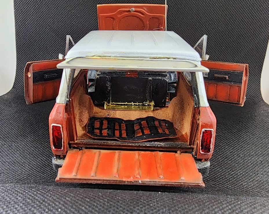

I noticed that after looking at the photos. Should be an easy fix. All that is left is making floor mats. I believe the tape is going to work well for that. I have them base coatedBusy, busy, busy! You have a lot going on there Greg!

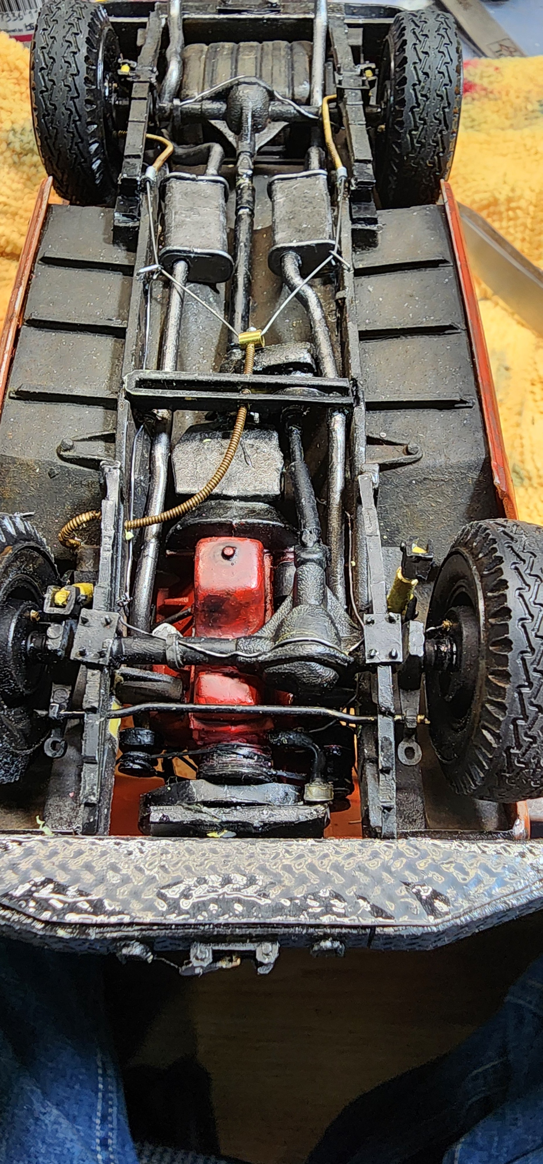

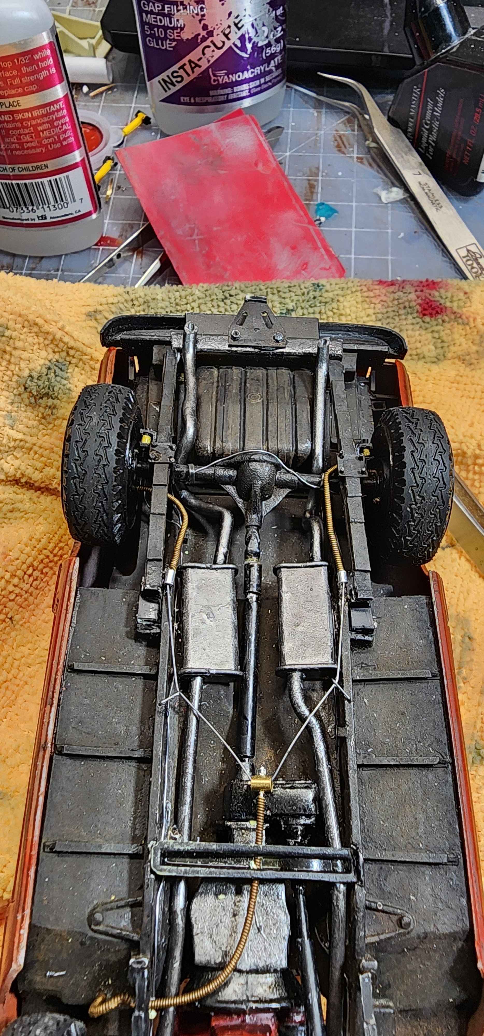

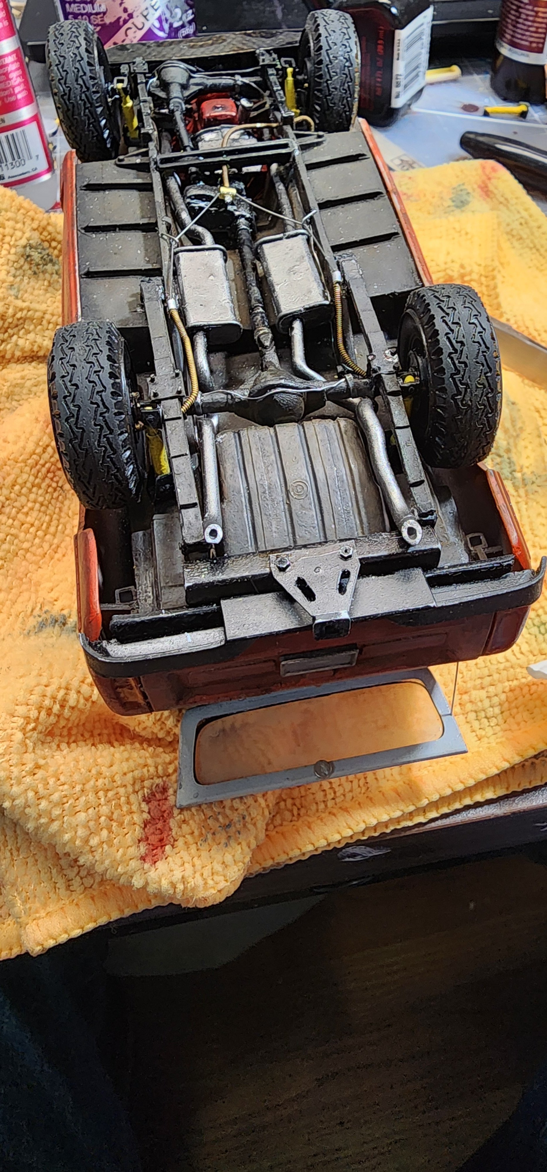

You might want to open up the holes on the tail pipes.
