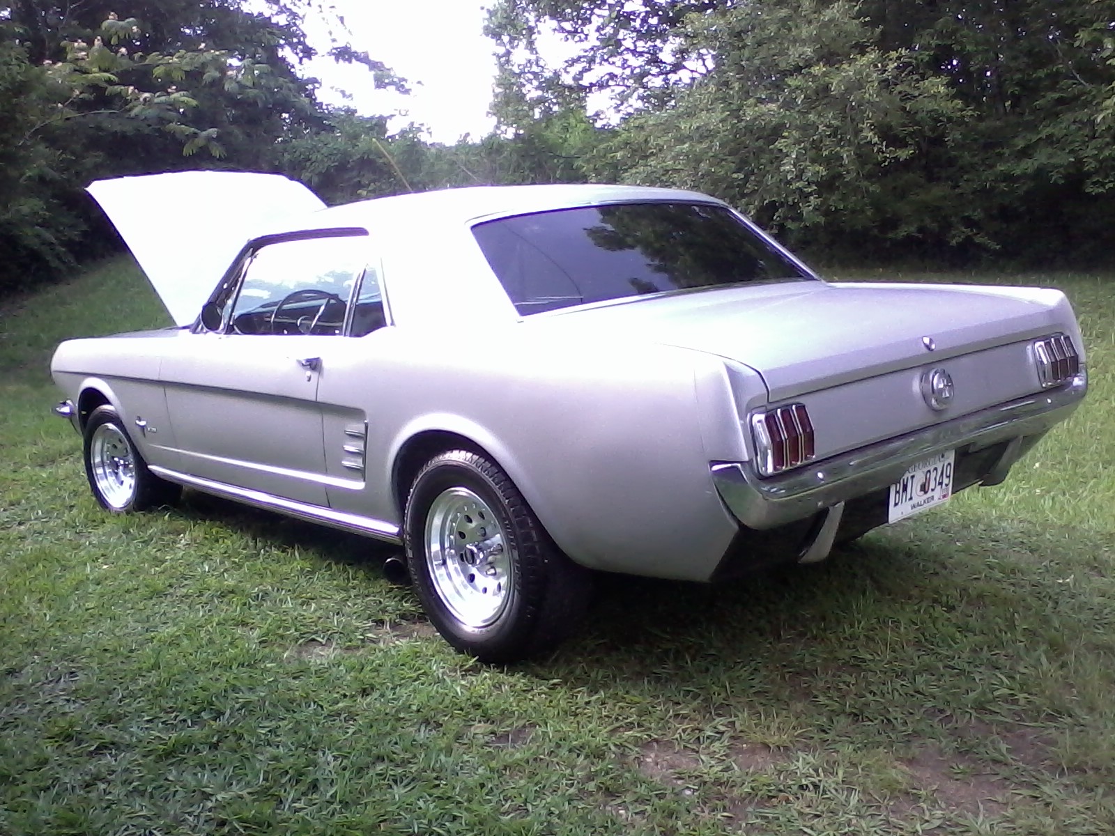

Few pictures of "The Troublemaker" Torino GT survive.
I do have the Monogram Pro-Modeler kit.:hmm:
That's a good lookin' notchback Tim. They were never the sturdiest of cars but they were sure fun to drive and I really enjoyed all of the ones I had.
