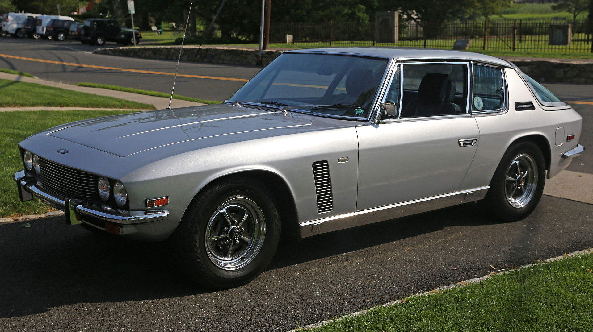

What channel is that Radio on ? :cool: American cars are so different from anything we had over here these threads are always really interesting. I think the nearest we had was the interceptor with 440 cu in (7.2 L) Chrysler V8 (1971-1976)
