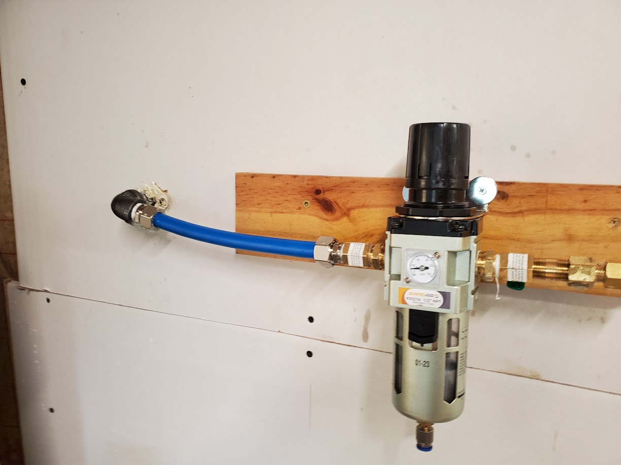

I'm building out my compressor lines, first trap and regulator is on site
This is not in place now, I'm pulling a mulligan after finding multiple leaks even after initial leak test passed.
Anyway, this is a nice one but the gauge is really small and I want another at the bench where the air feed is for the airbrush. This unit only starts working at about 15-20 psi because the water trap spring.
I'm only seeing gauges that go up to 200 or so. Are their any fine tune gauges out there or do I just get another mid range and dial it in close enough.
Yeah I got several options for that type James.
BTW, this is what the regulator looks like now.
I'll put a flange around that hole to clean it up. Level? It looked level before I took that picture. Must be lens flare... :rotf

Yep the pressure gauge is sideways but I can read it better than the 1/4 inch one. Will apply pressure tomorrow.
