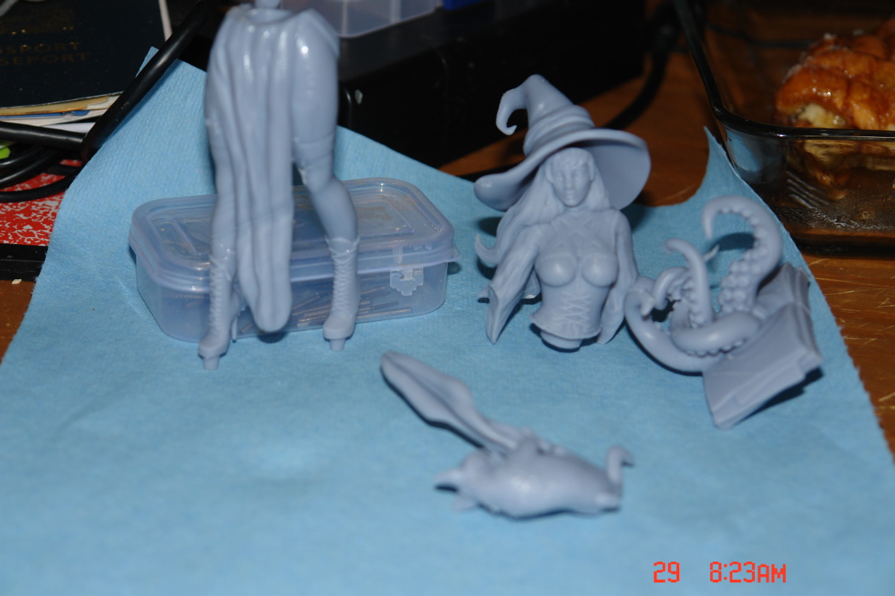

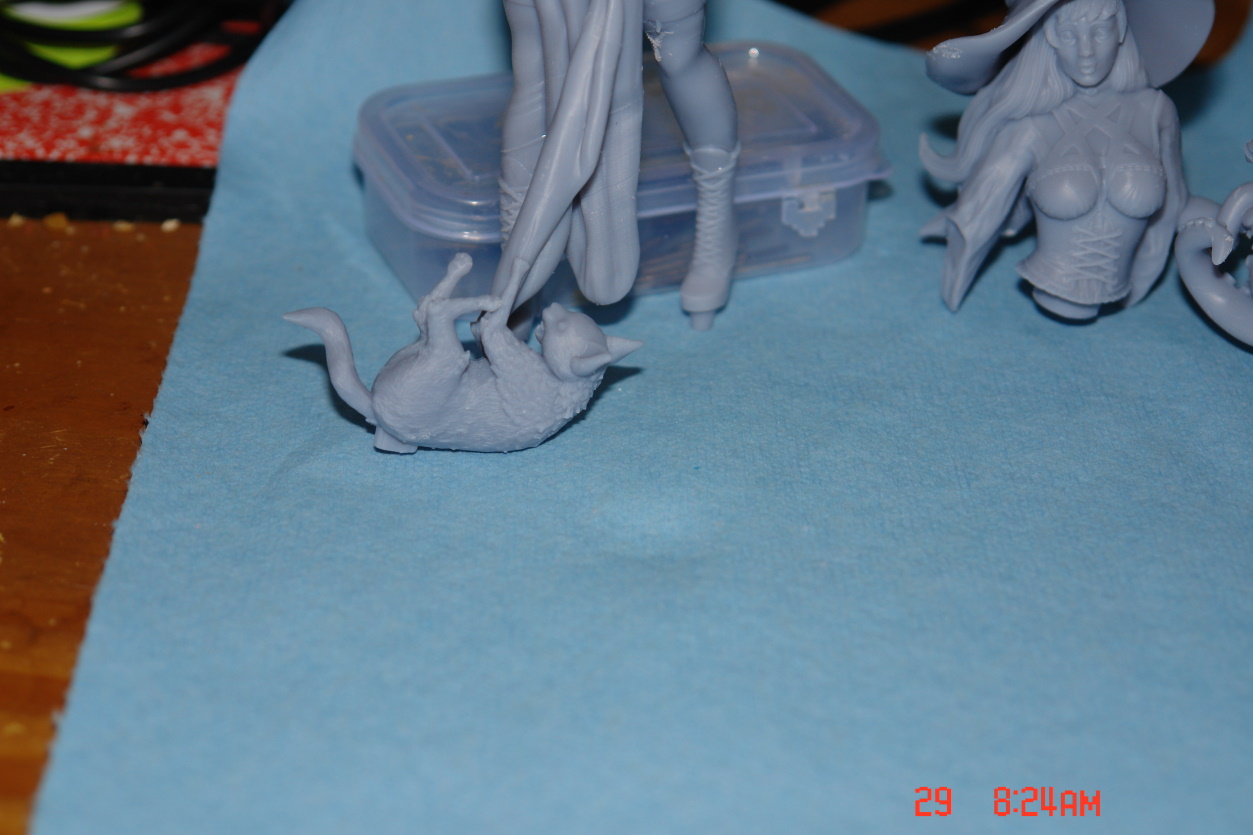

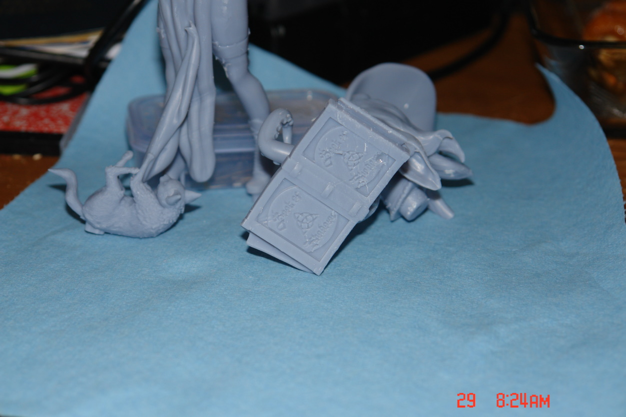

It is. I just got the rest of it out of the printer and will package it up for my youngest son for Christmas. I have Black Widows legs on printing now and hope it will be 3rd time lucky.Looks like I am going to be wanting a printer sooner rather than later. That is an interesting figure James!
No fun to paint realistically and show in public!Oh and yes for the first time they give a 1:1 scale dagger. That should be fun to print and paint.
