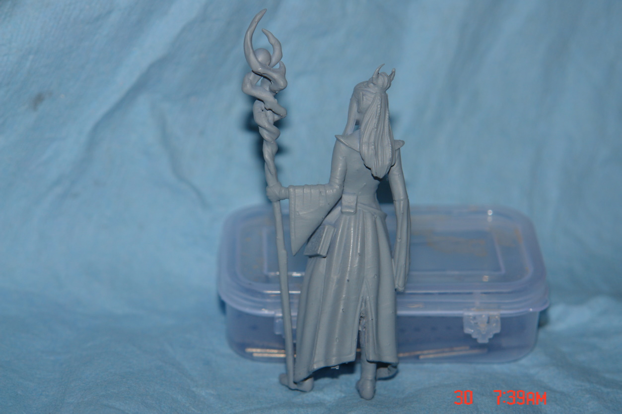

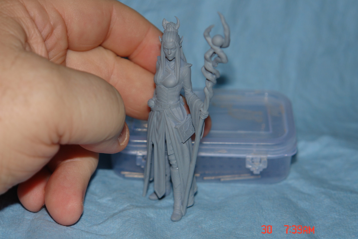

Meanwhile did this yesterday. Had one fig fail and found a flaw in my tank. So new tank on and have to fix the other one. Cant wait to get the part for the Saturn so I can print more and hopefully better figures and things.

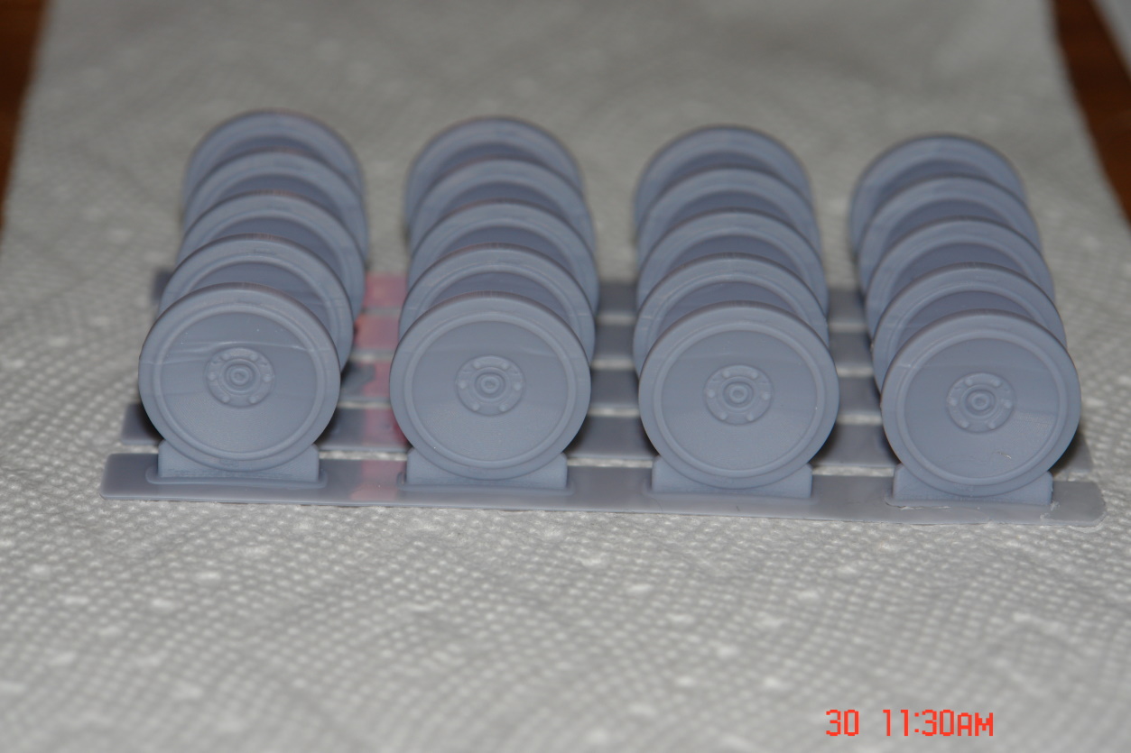

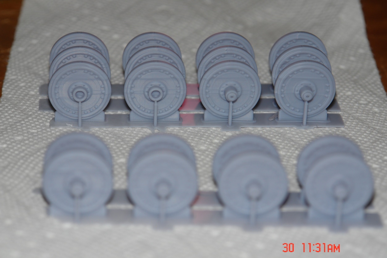

Okay first try. Got a set of wheels to replace C5 and C6 in the RFM Tunisian Tiger I Early kit. Unfortunately There are some that are no good due to a line across them. I kind of wondered if that would happen. It would have been netter if they were angled a bit for printing. Will have to see if the designer can give drawings without supports. Still I am pretty happy with them overall and it will help make the kit better.

Very interesting James, what caused those lines across the wheels?
It could be the settings are wrong for the type of resin but I dont think so. From the beginning I have seen and been told that where possable you should tilt your print. There is supposed to be a formula for it but I have not really looked. I Have a Viking figure in printing for another few hours. He is tilted so if it all works that might be the problem. Its all a learning curve but having fun so far.

What it looks like is happening to my eye is that the parts are getting far enough away from the mount that they are shifting a little bit. The slight shift is giving you a line. It is possible that they just need a little more support to hold things stationary during the print process.

On the tiger wheels maybe try a 90° angle to get rid of the lines, if it was made with the saturn verify your serial number as there is a firmware update that corrects a similar issue with the lines. Keep it up its looking good. Are the wheels for the cyber hobby tunisia tiger?

Thanks. Still waiting for a limit switch for the Saturn as is arrived broken. These are all done with a Mars 2 Pro so far. Most stuff comes out good. I'll check on the Saturn Serial Number. Did not realize it had issues. The wheels are made for the RFM Initial but the fellow has some other wheels also. I have not yet tried the Panther wheels. He also has a conversion for the first Tiger with the big round housing in place of a turret.

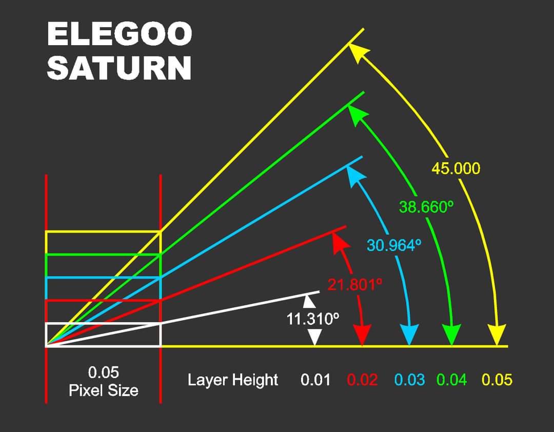

Here is a table for the saturn but I think it works for the mars also

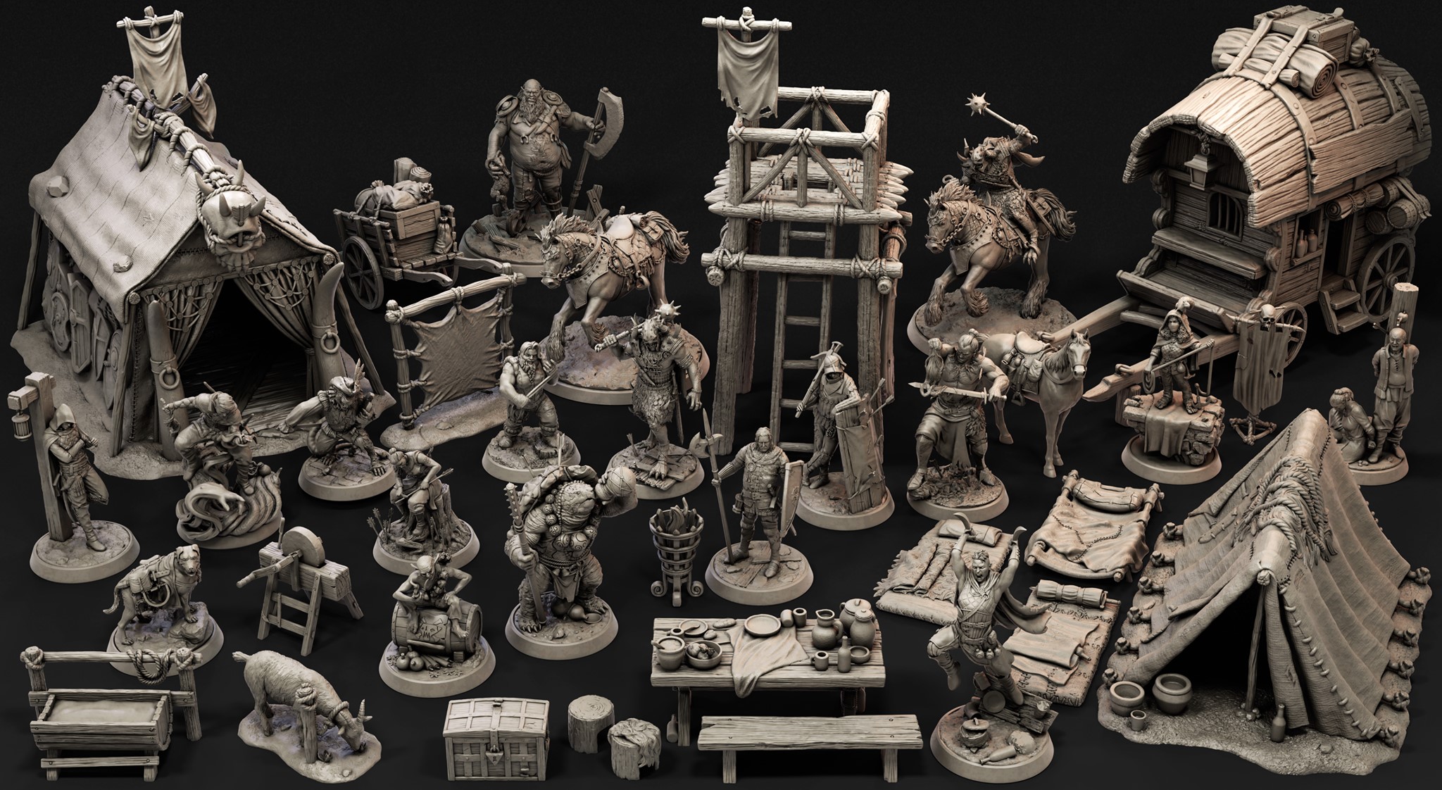

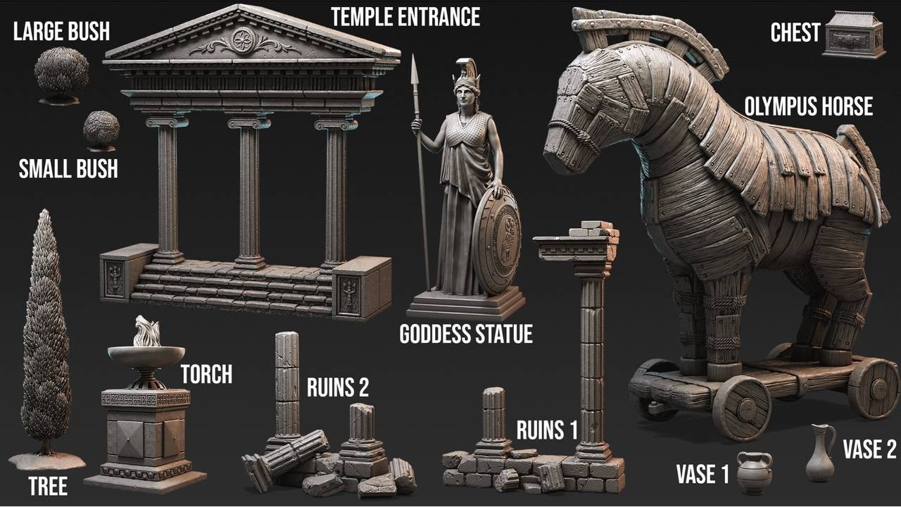

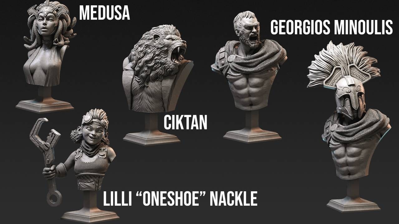

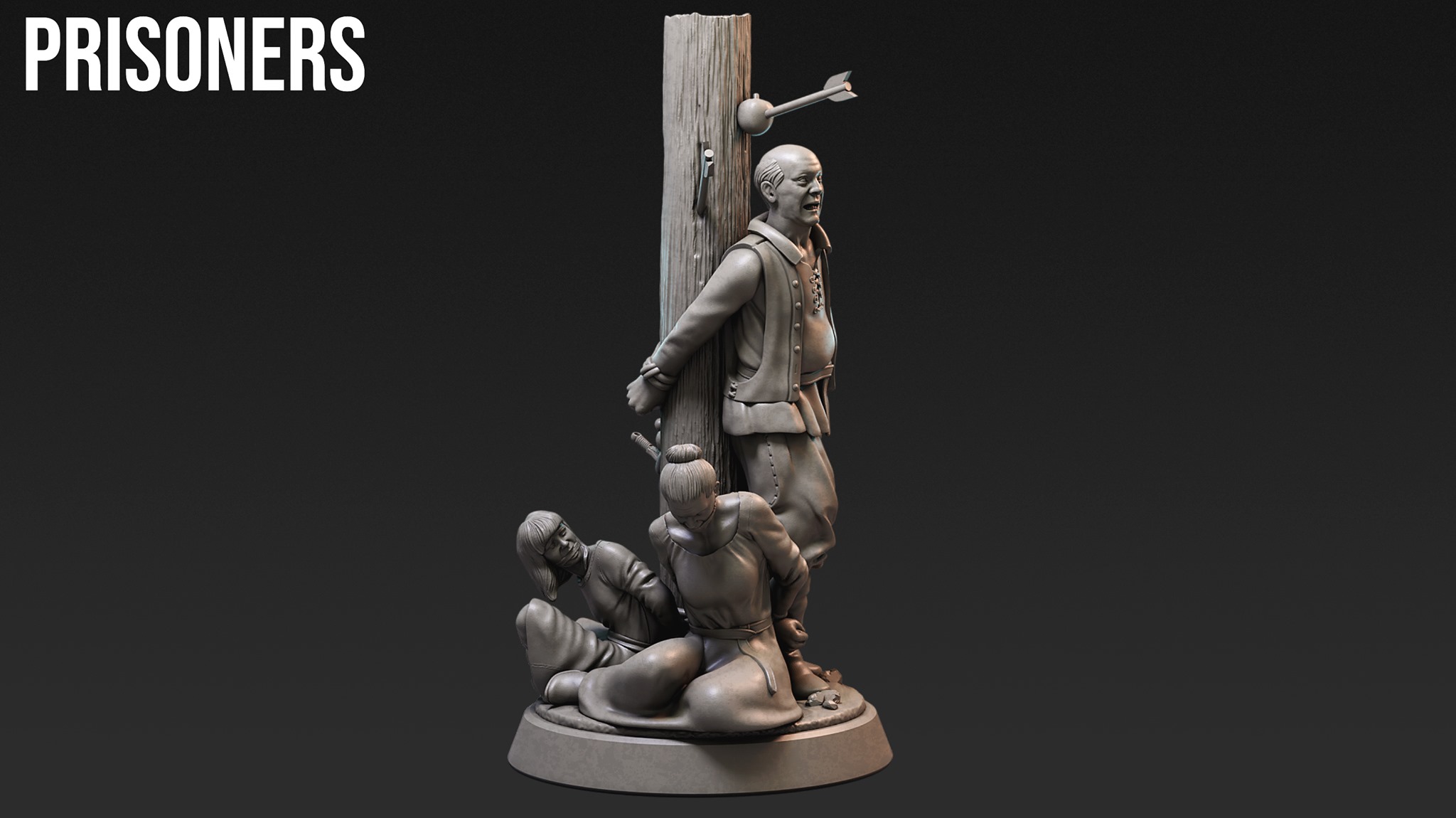

If you like those figs here is this months and January's files. In the process of printing a Centaur and a Hydra and Panther 16 Bolt Road Wheels and axles.

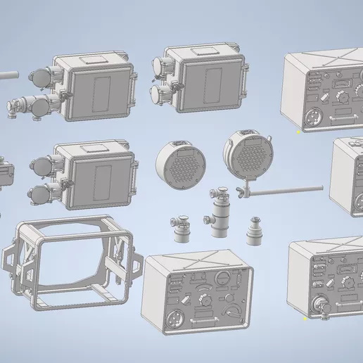

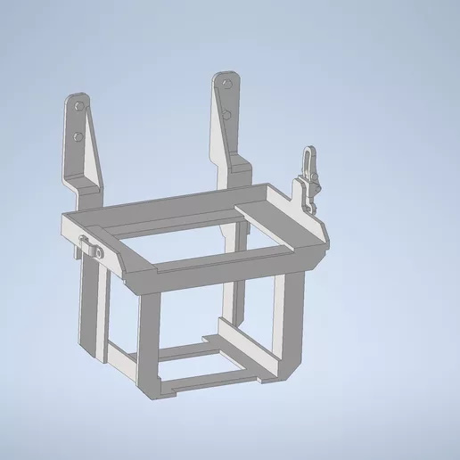

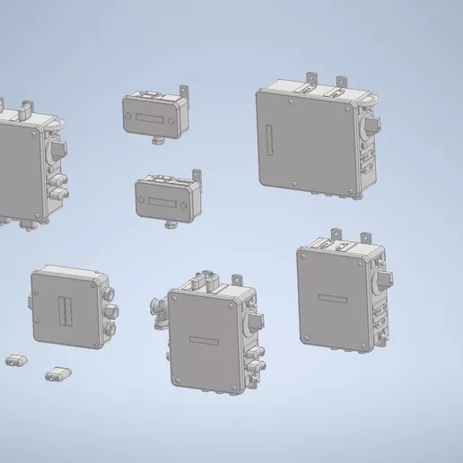

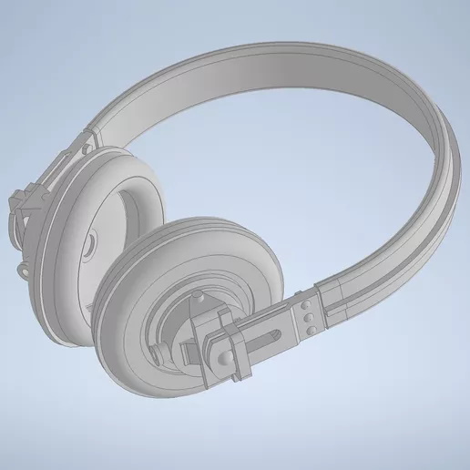

Added to that my fav maker of 1/35 has put out a couple of 1/35 radio sets and associated equipment for 1/35 German vehicles.
Hope they turn out well.

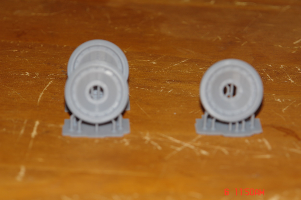

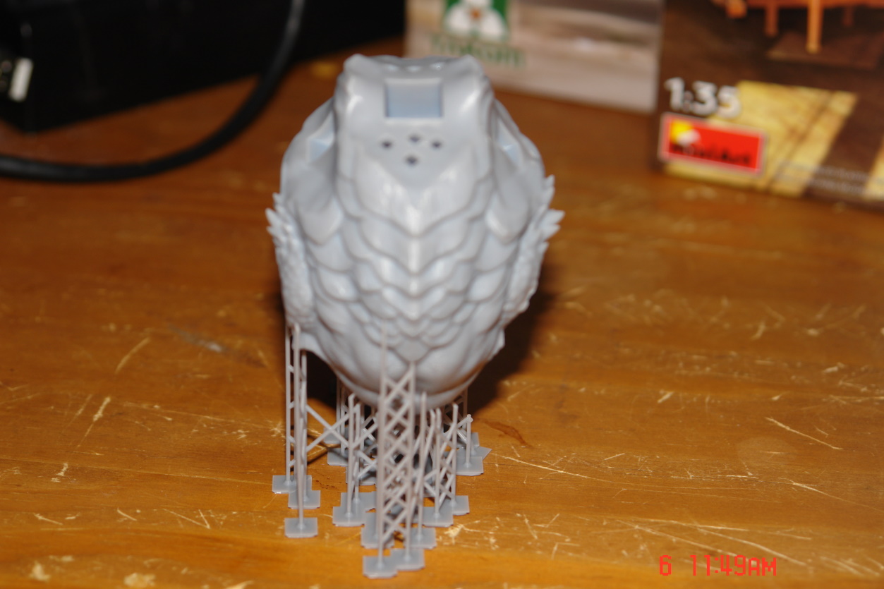

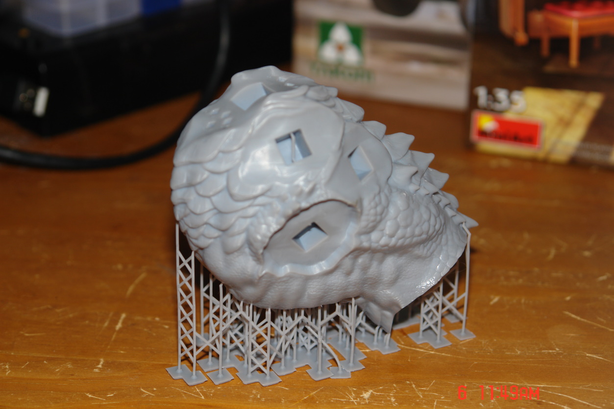

So started a print before bed last night and it was done this morning. The body for the Hydra. This morning while washing and curing it I did some road wheels for the Panther. These I did on an angle and they all look good so quite happy.
full
full
I hollowed out the body as it is a big print. The small diamonds are the drainage holes for inside.

The first set of Panther wheels. Theese are 16 bolt wheels for my Hobbyboss Panther A. Unfortunately Hobbyboss dropped the ball with this kit and it is a toss up between a D and an A. So I will make it a D as that is the easiest path. Hence the 16 bolt road wheels vice the 24 bolt.

Wow, all those benches, stools, table, beds, trough, chest, grinding wheel, tent, goat horse anmd cart would be so incredibly awesome in 1/72 scale! Man I just wish I could get all those to add to my 1/72 scale accessories!
Beautiful print on that Hydra body; that is exceptional! Nice job on the wheels too. I knwo someone else who has printed up a number of wheels in 1/72 scale who also did them at an angle and it does help with the quality.
