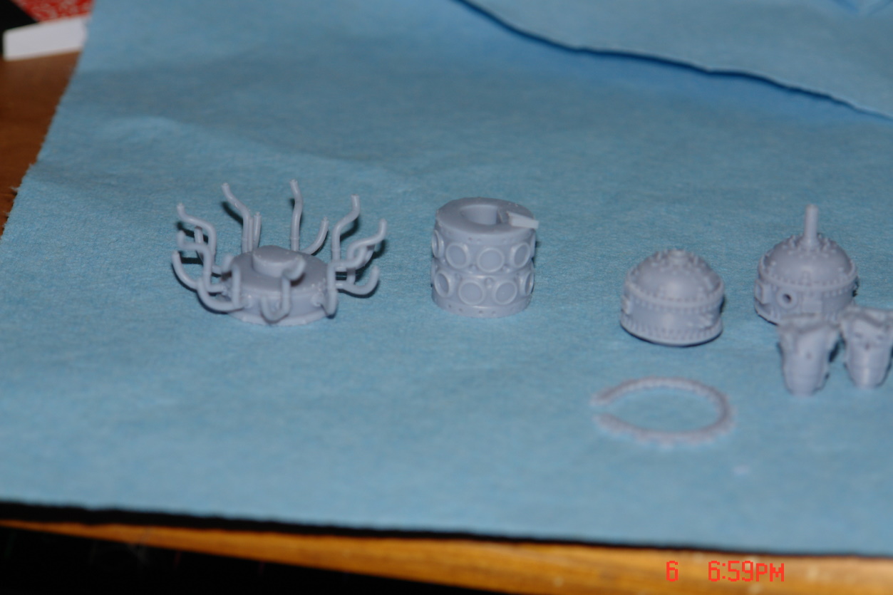

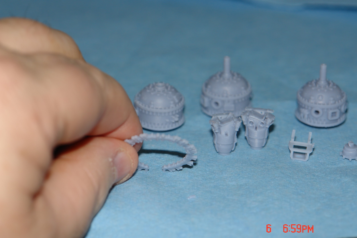

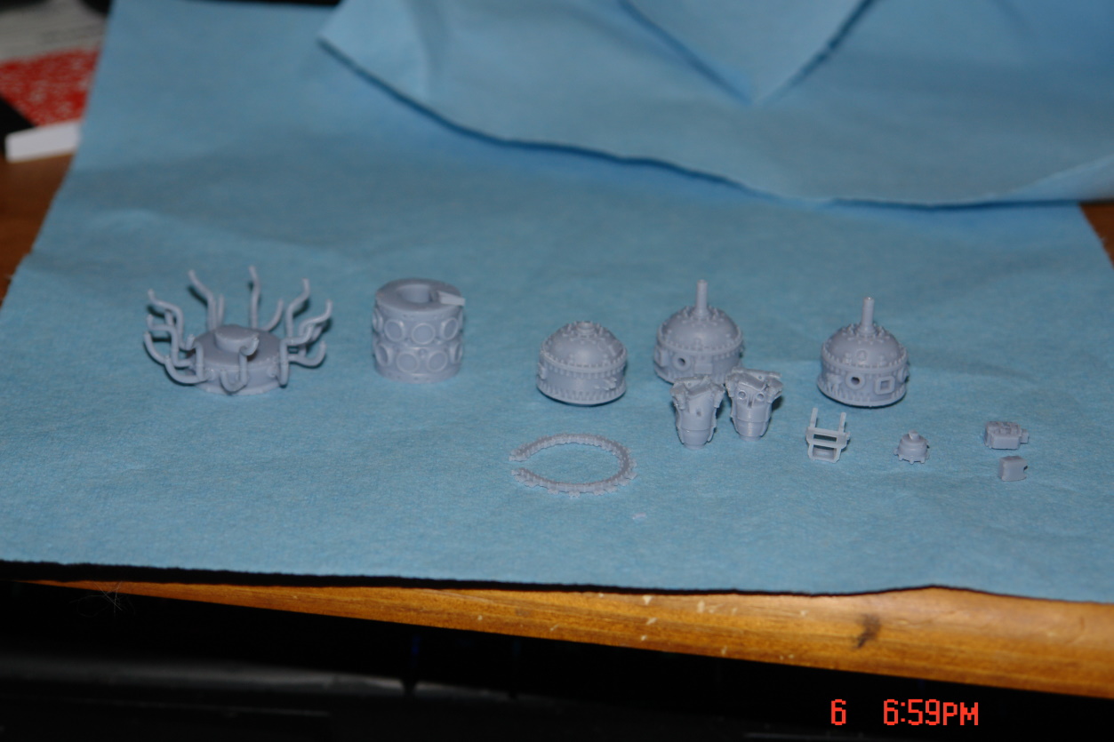

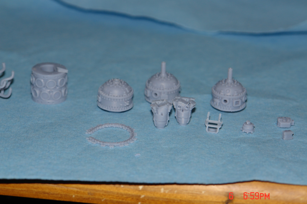

So we have a Pratt and Whitney R-2800-C Late. It has 3 different noses and different pumps and cylinders. Of course I forgot to print more cylenders but this was just a print to see what it looks like. Unfortunately you cant see, but the ignition ring has holes for your ignition wire. 1/32 scale but you can scale up and down.

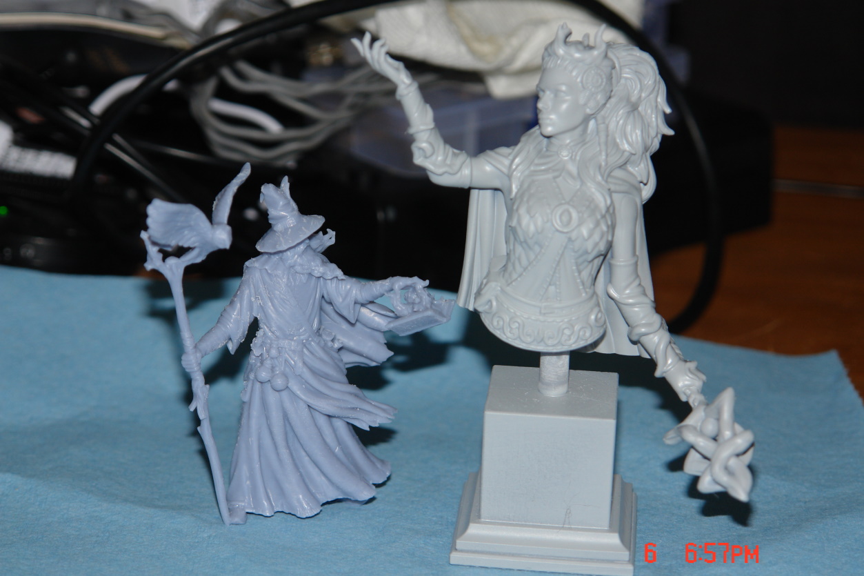

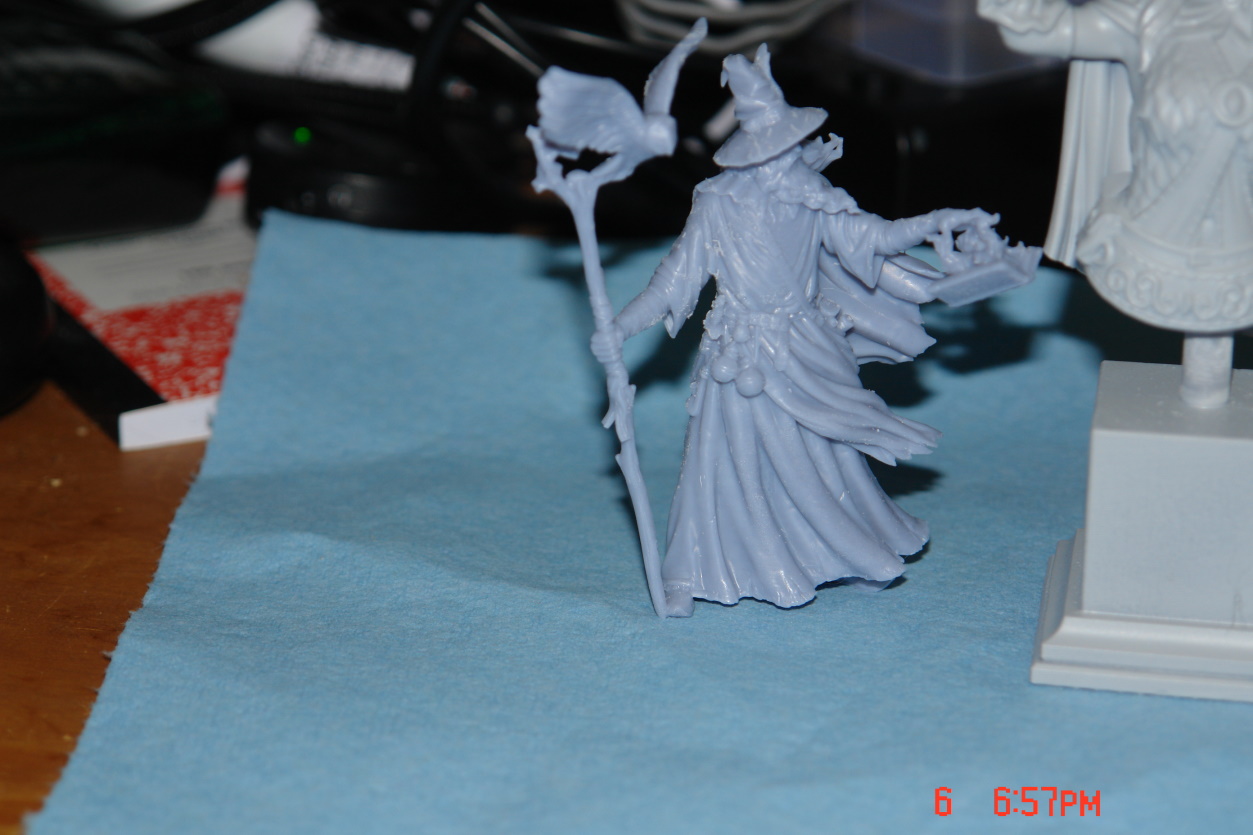

Next are a figure of a wizard casting from a flaming book in 75mm and a bust of a Nature Wielder.

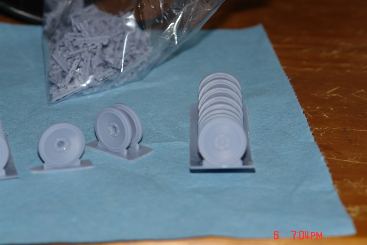

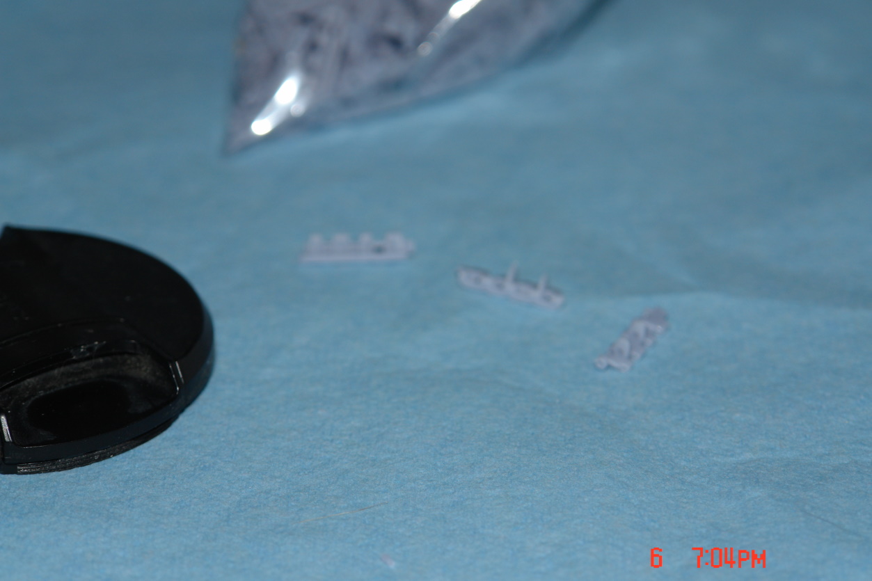

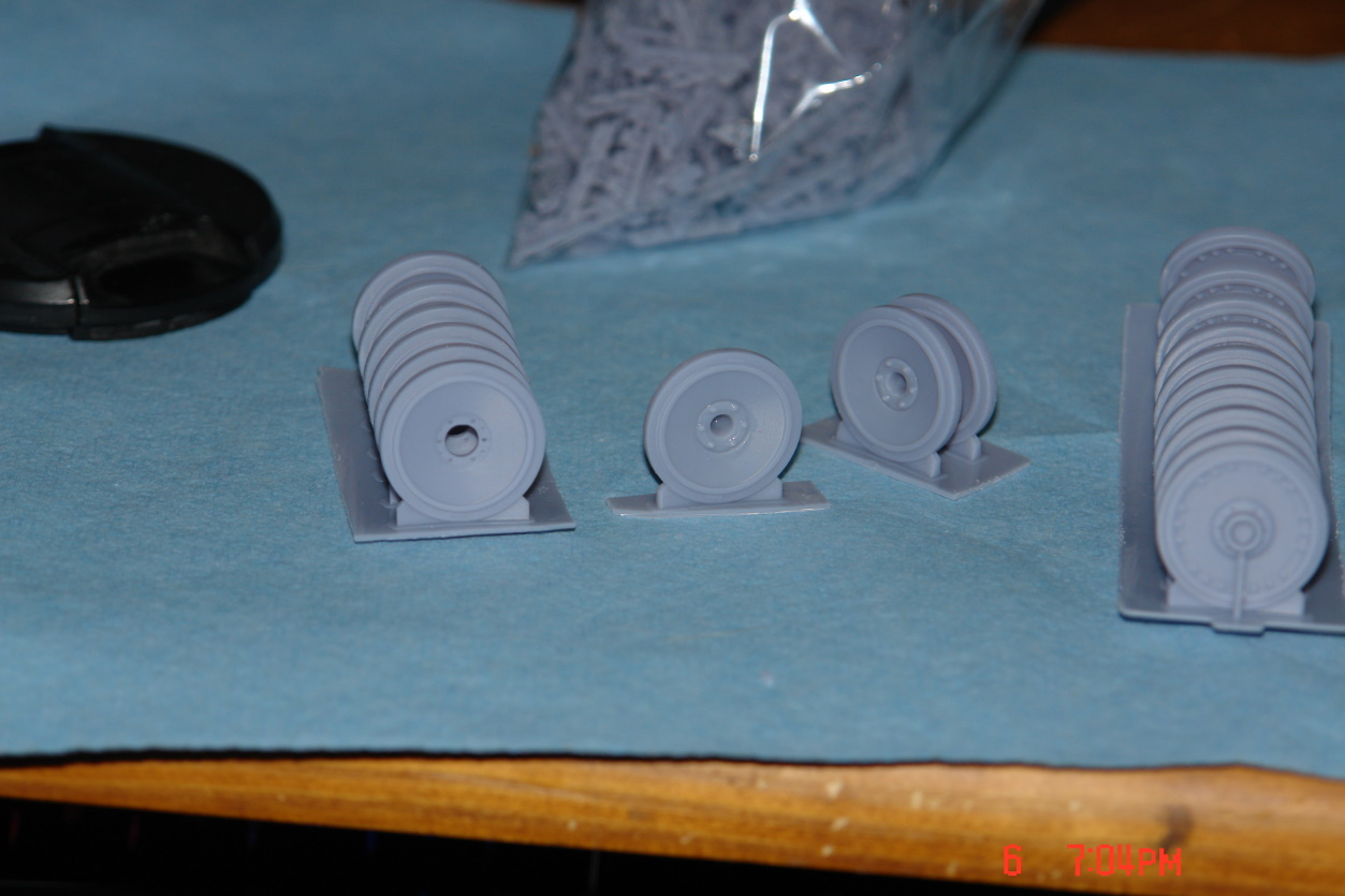

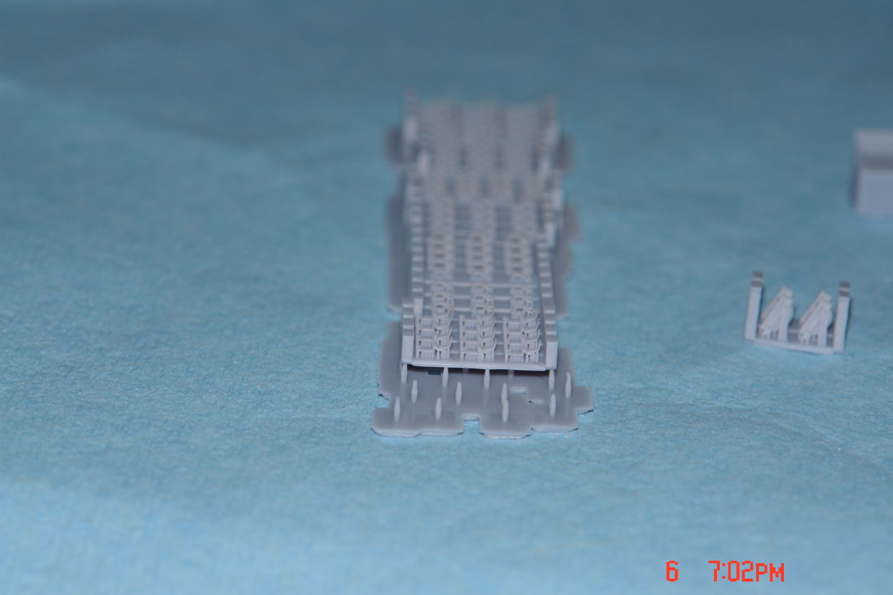

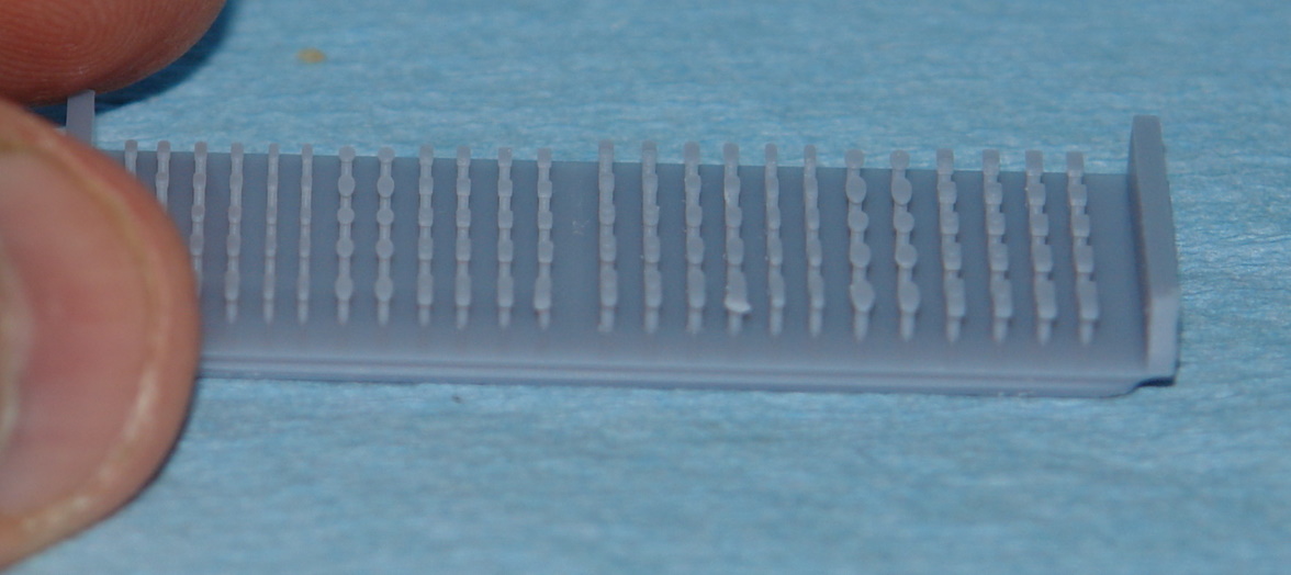

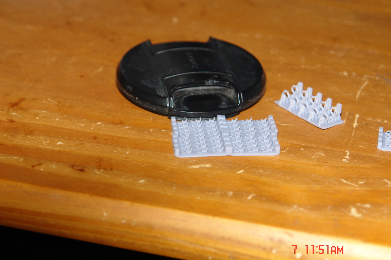

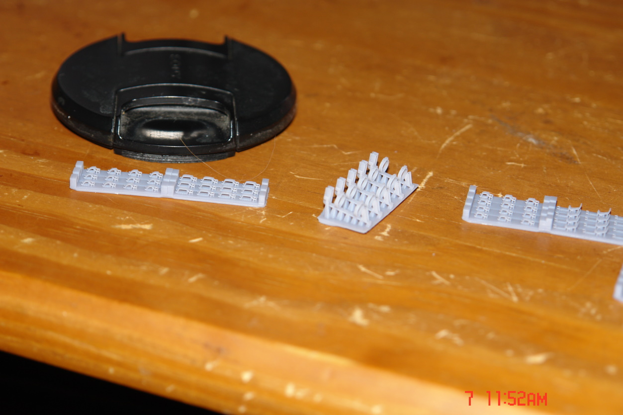

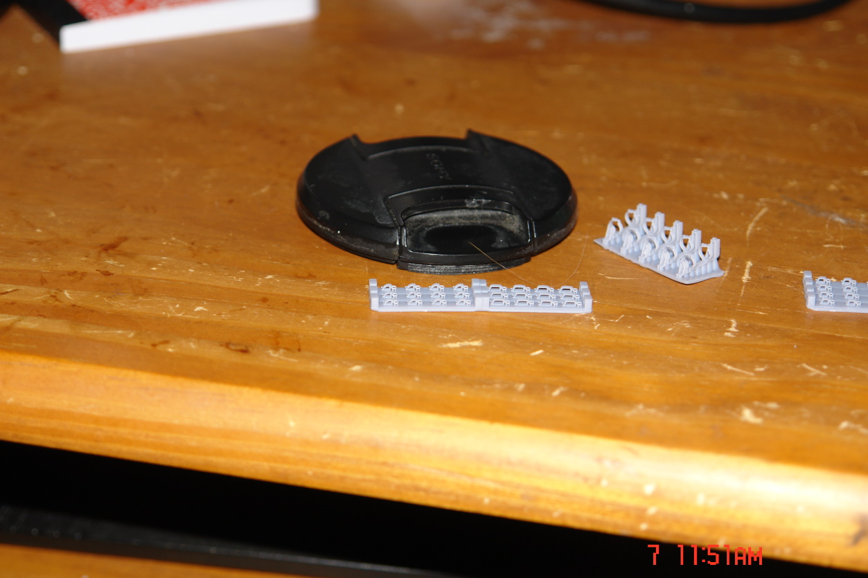

Then a bunch of early Panzer clamps both open and closed and different sizes. If you look back a few pages at the ones printed on the Mars you will see the Saturn printed way nicer as its a higher resolution machine. Also 16 bolt road wheels for my Initial Tiger I in Tunisia. The wheels printed beautifuly on the Saturn while if you scroll back you will see earlier attempts had ridges.I also printed initial tracks for the Tiger. Forgot to show the track pins. Yes the tracks have holes to pin them :). Also in there are some Panther axles and other little bits and bobs. The fellow I follow on Patreon just provided corrected rear mud flaps for the Tiger and the proper sized smoke dis-charger. I have the Ammo of Mig version but I think his are better. AoM provides the whole thing in one print. This fellow has the mount separate and then 3 choices of dis-charger. With rubber cap, empty and full. It even has wiring points. Tomorrow I hope to do some more tracks and clamps as well as the new stuff. I have also printed some early style Pz I tracks. He made then with 2 different types of ice cleats or straight in early and late track and has also provided the cleats separately. Sorry did not take pics yet. Printed out early for the Tacom Pz Ia I will be doing, oh and yes they are workable.

I need to sand down the locating surfaces a bit so the engine slips together. Then i need to do some research to see what the difference is between the nose pieces. 2 have rods for the prop while one is without. Also different pumps. So when I figure out what is what I can assemble it and see how it looks and then maybe find something to put it in. I found it while looking for some Flames of War stuff for a friend. Would be nice to find other engine files also.

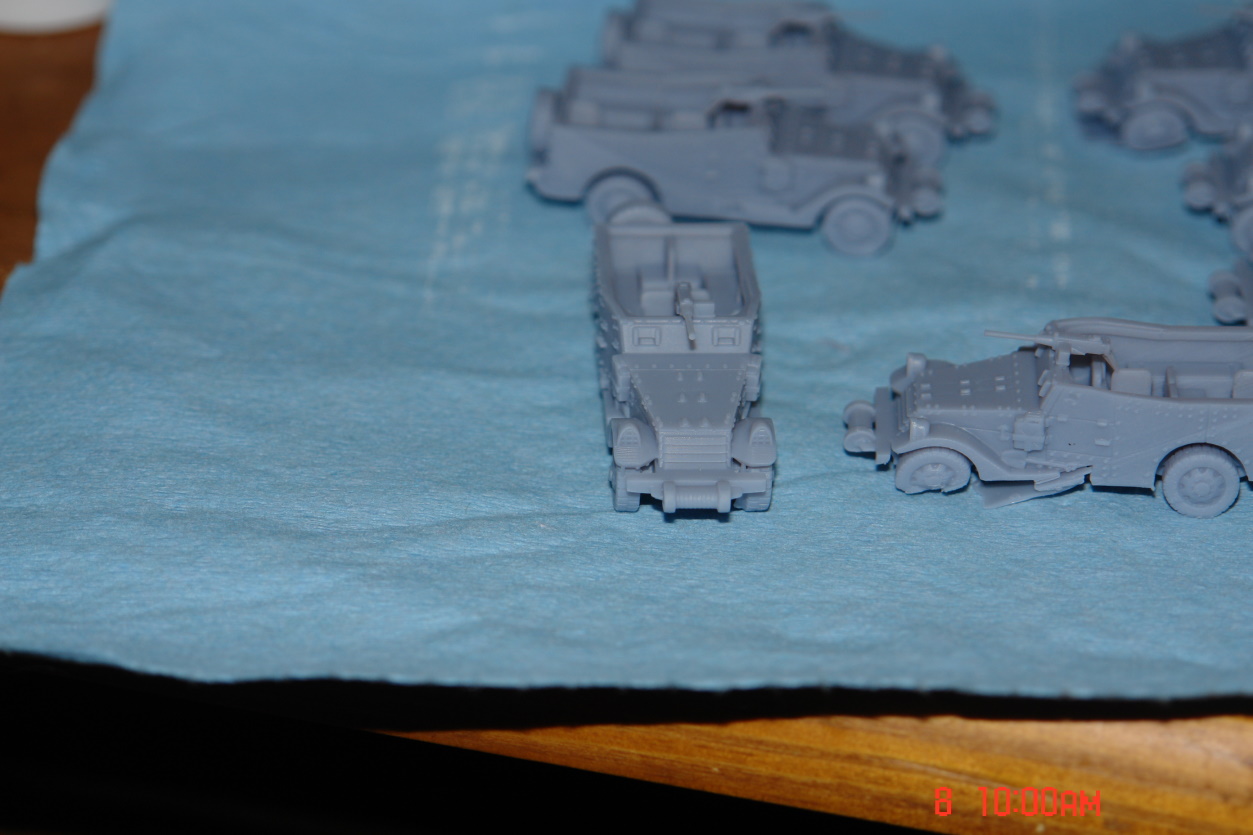

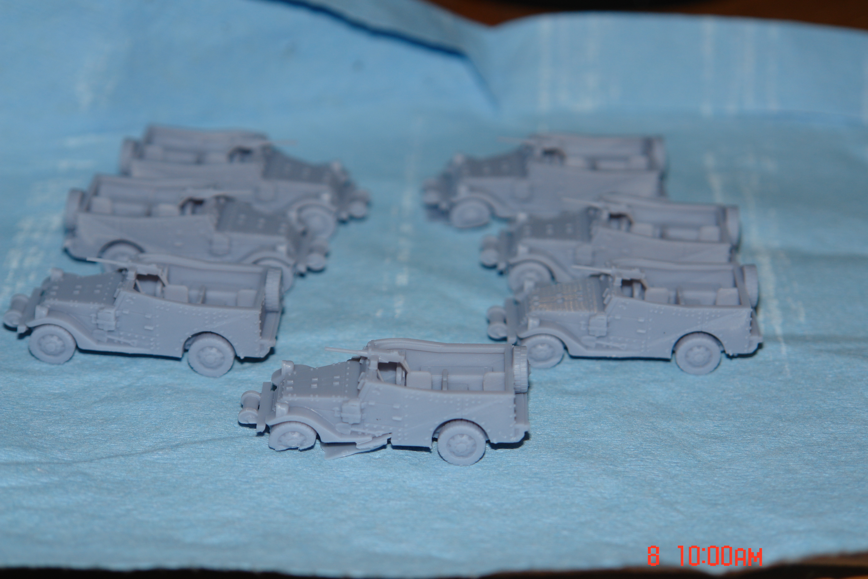

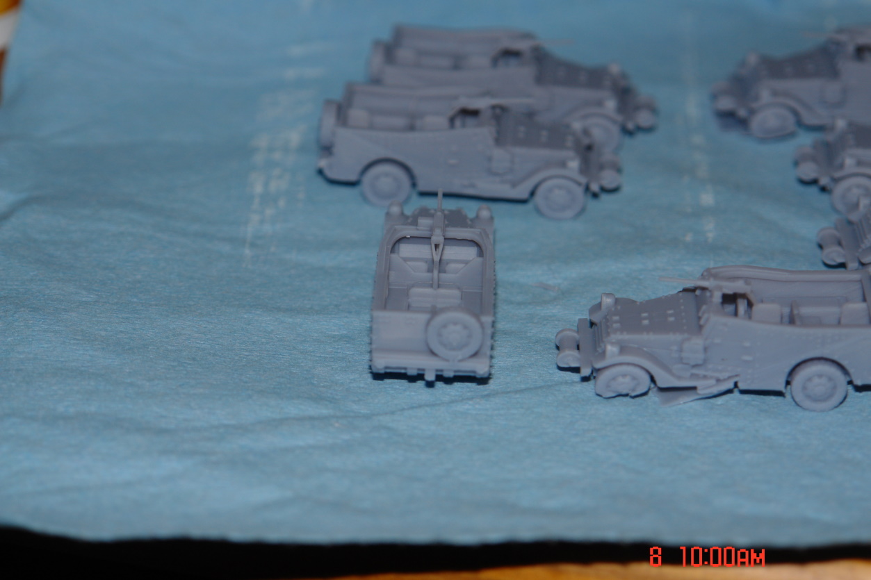

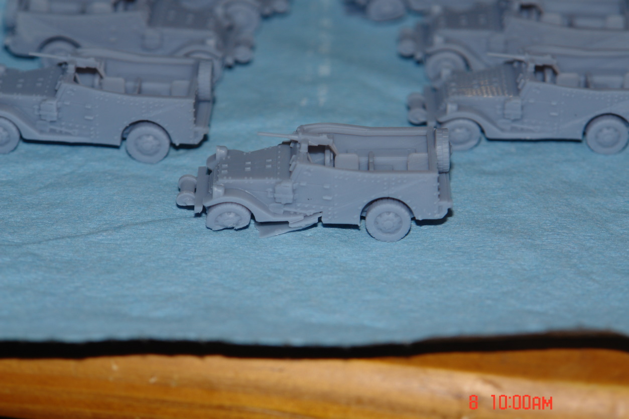

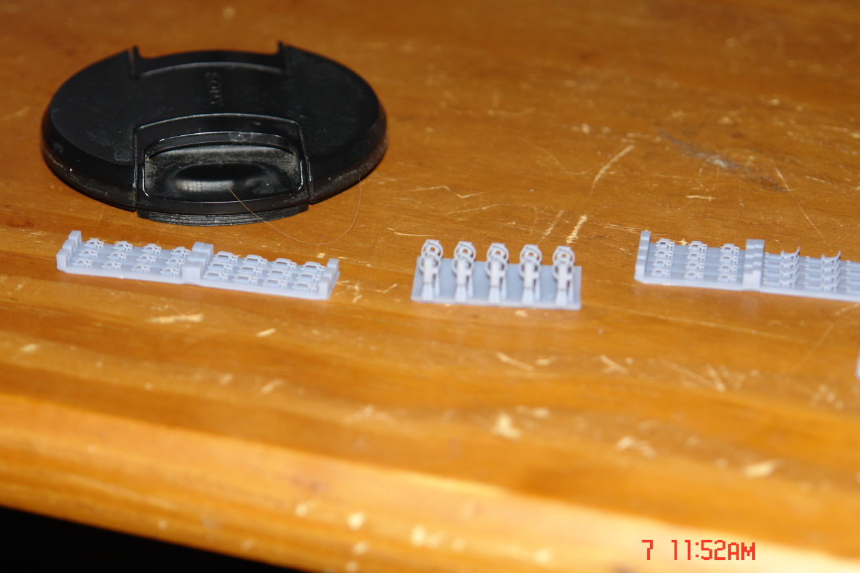

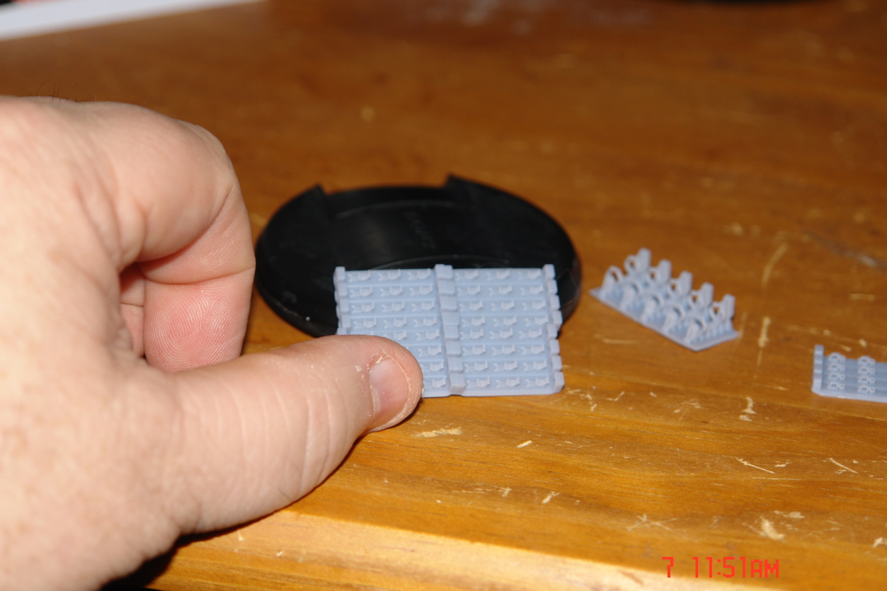

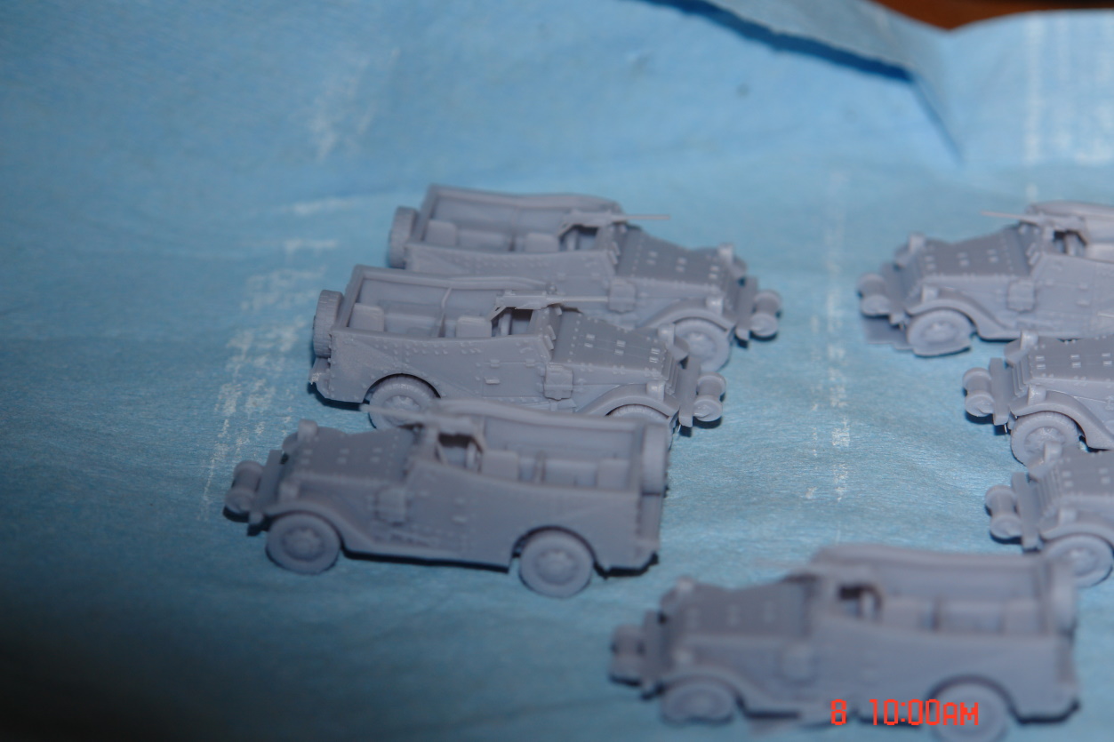

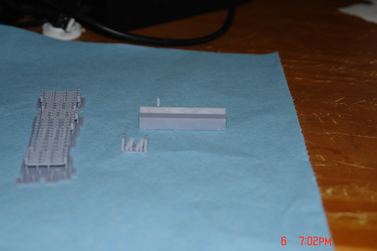

Okay some better pics of the clamps and printed some M3 Scout Cars for my buddy for Flames of War. Need to get more resin for more FoW and miniatures. Trying to print the 32mm miniatures and background stuff and man its tiny in my eyes.
Had 4 failures on the scout car. 2 never made it off the FEP and 2 are damaged, but I think could be used for destroyed vehicles maybe.

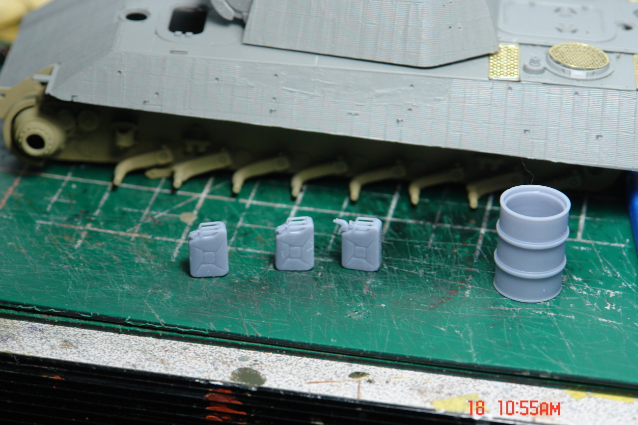

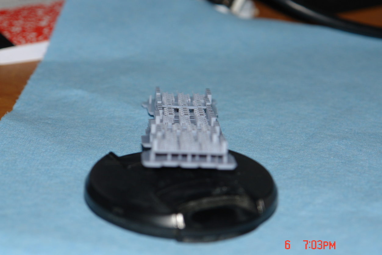

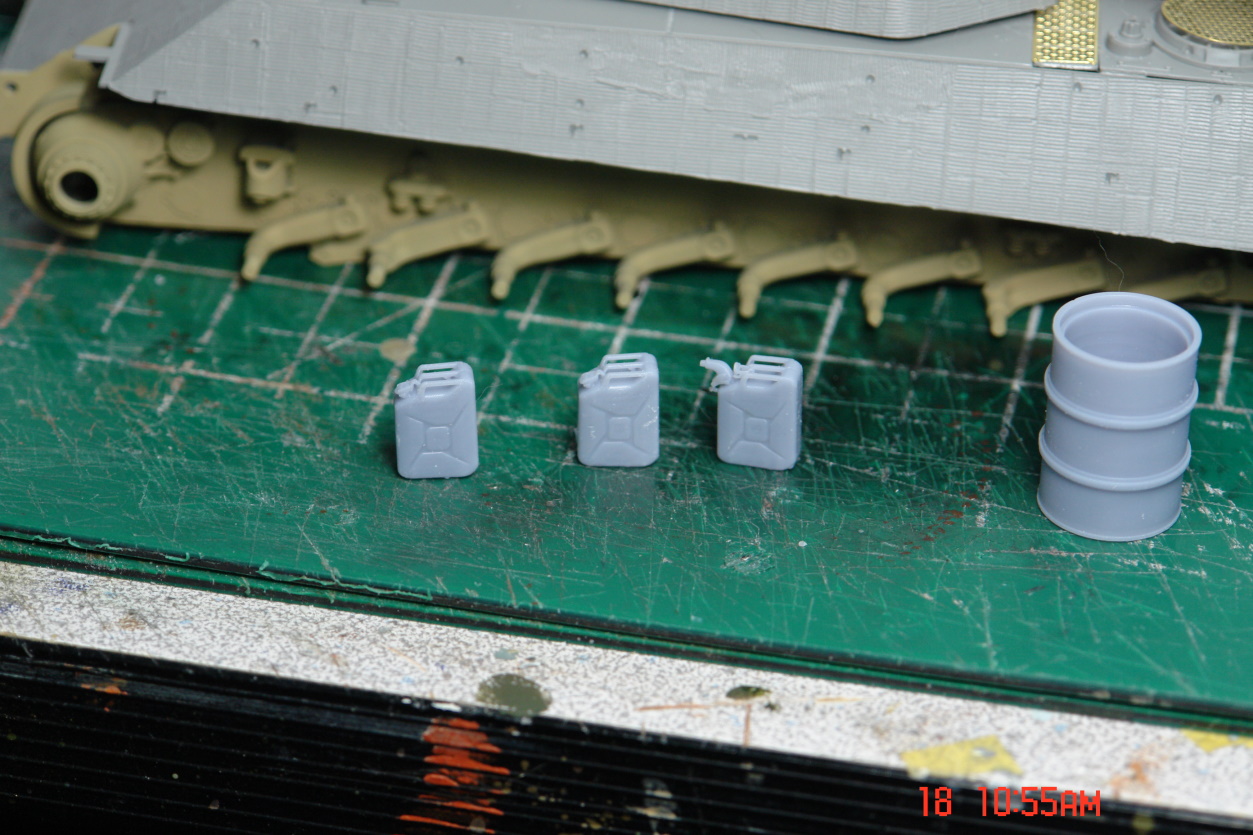

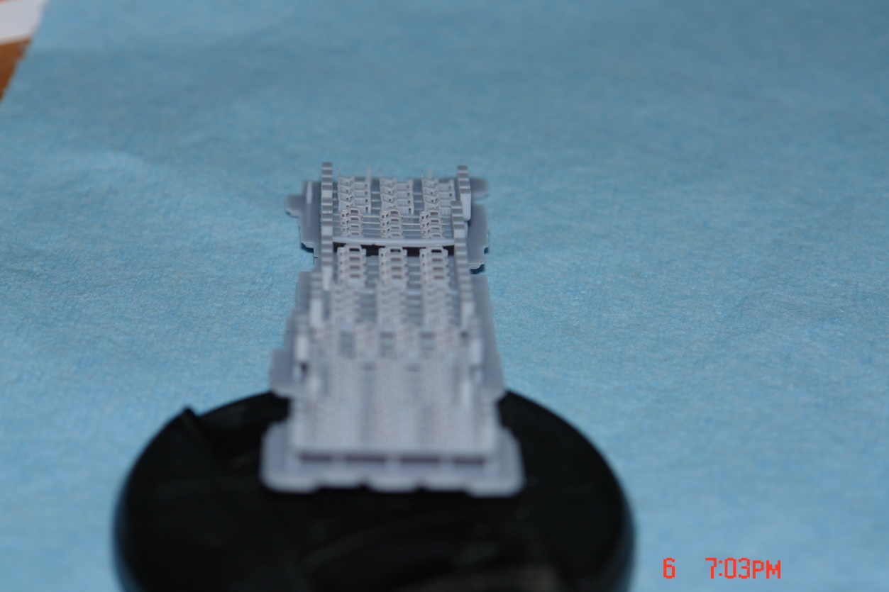

Then I printed some tracks for my Panther. I will redo them now I am more dialed in and they should be even better. I have road wheels and some other bits to do next. I also pulled out some Jerry cans I printed and took a look at them. I need to re print them also and hopefully the detail will be better. The one fellow I follow had put out files for Jerry cans from a number of different manufacturers and years and had the lids ope or closed and even spouts. The spouts need some fine lead wire to finish them off. I cant say what we called the spouts in the military as this is a family friendly place. I hope with painting and a wash the data pops out nicely. I have also got to print out more Tiger tracks and a conversion to make a very early Tiger with the hinged armour on the nose. Sorry not a lot of pics.

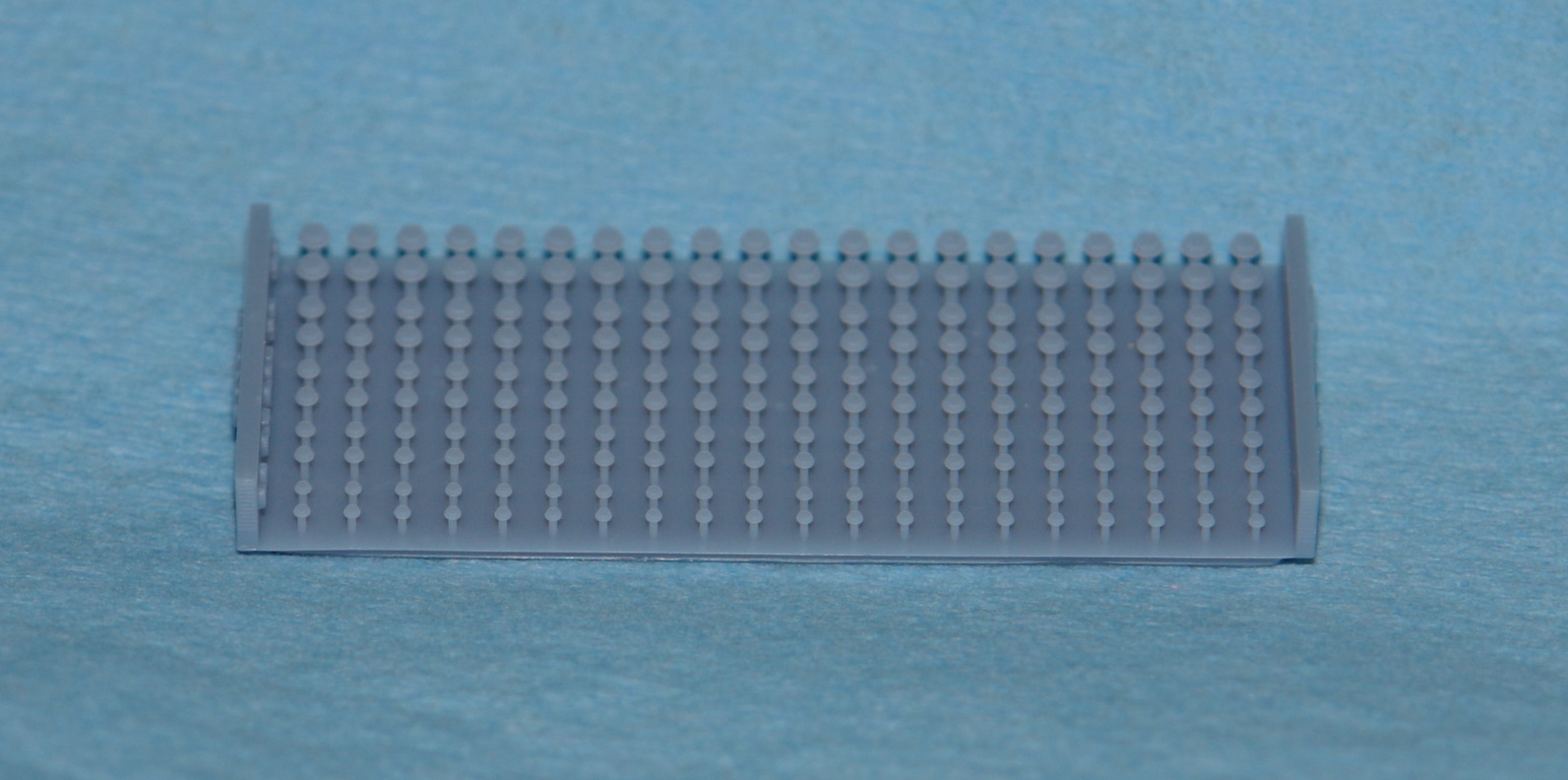

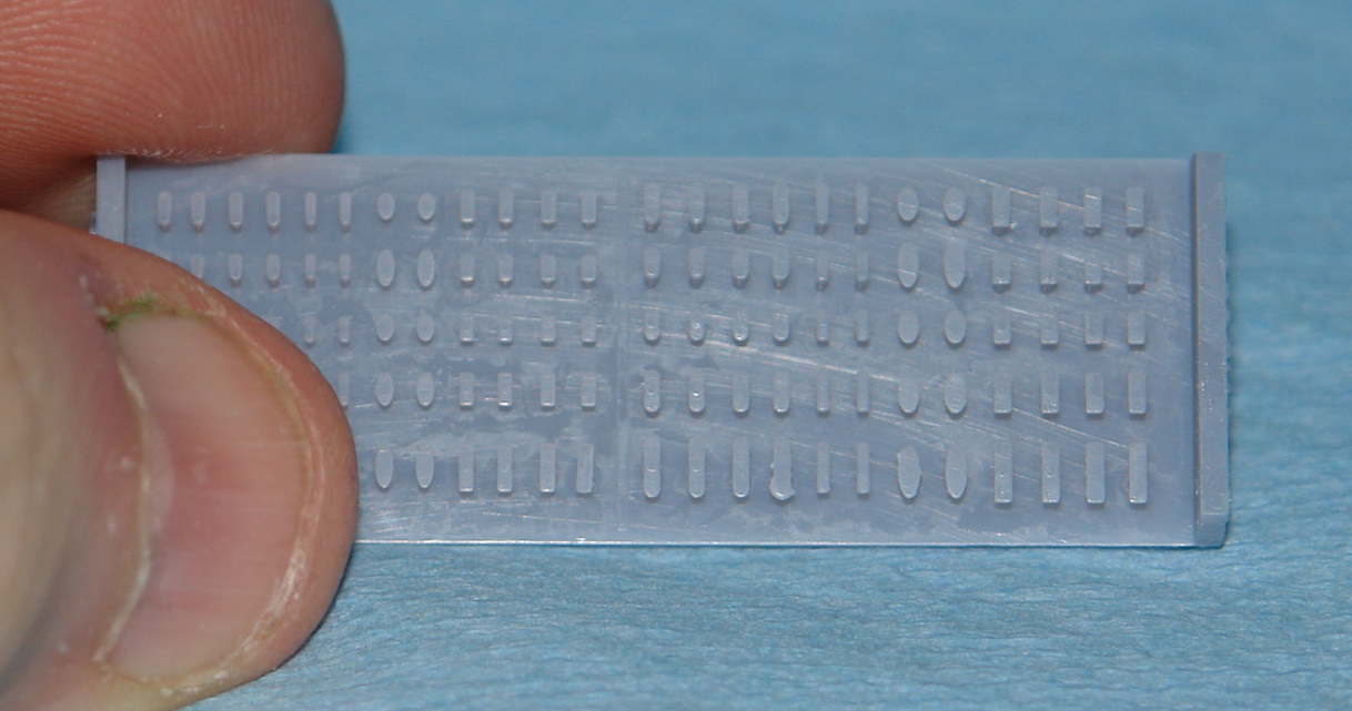

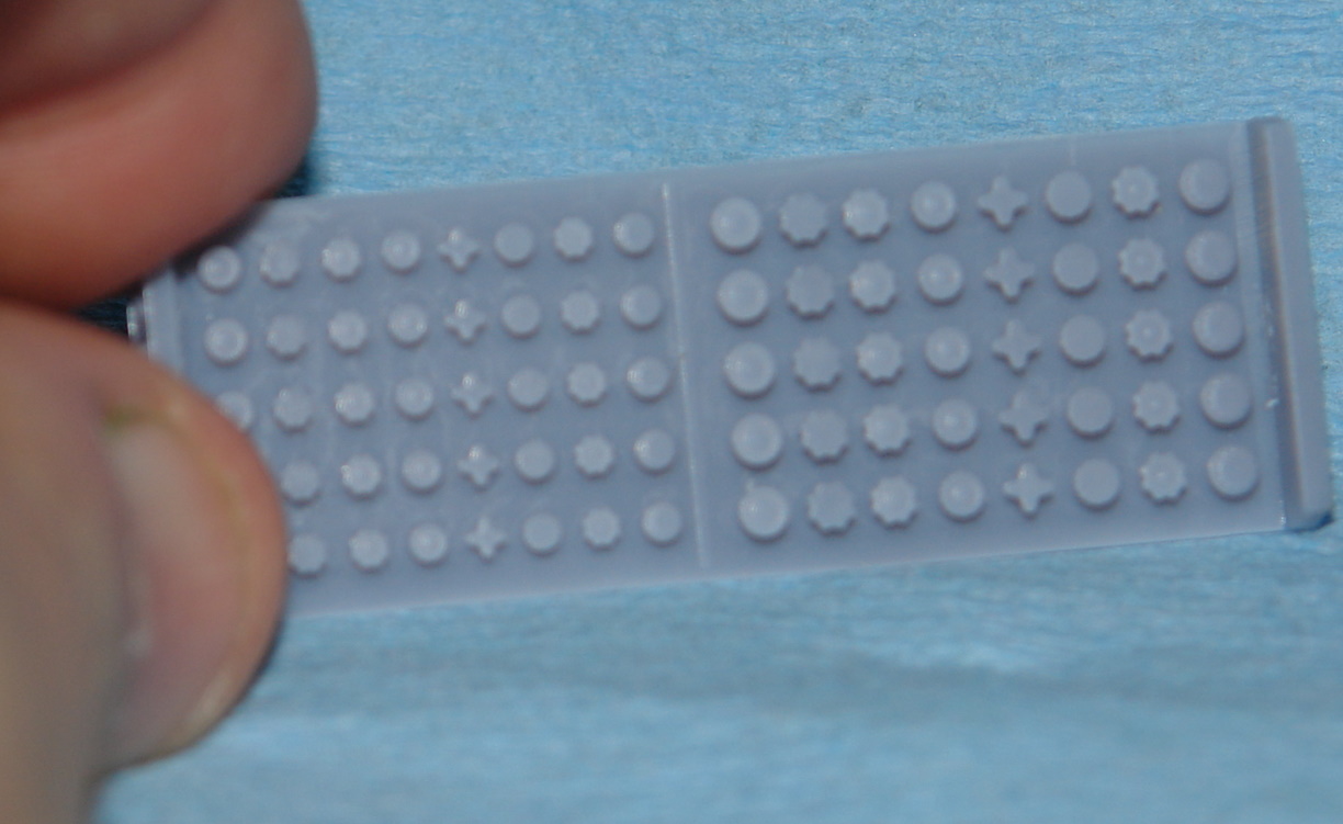

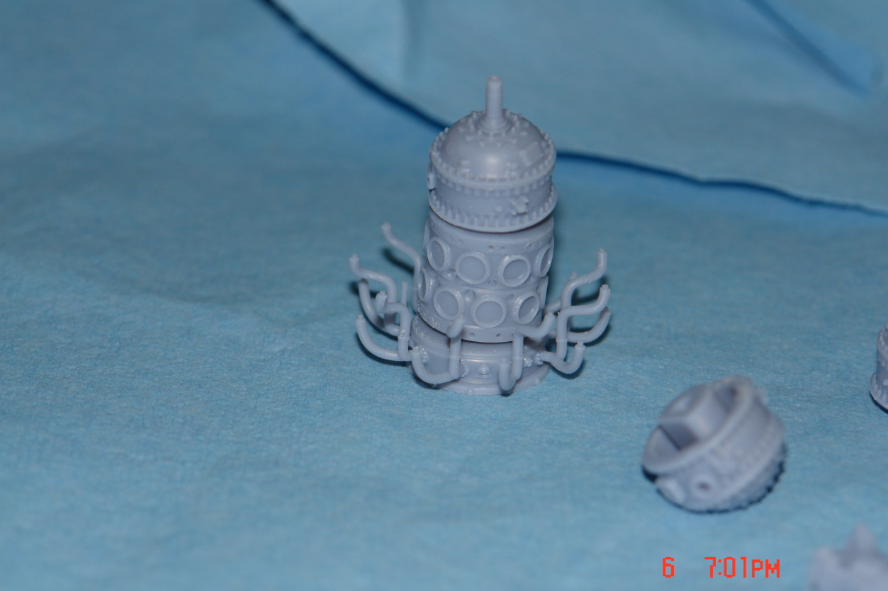

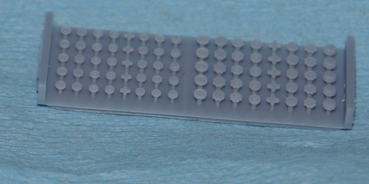

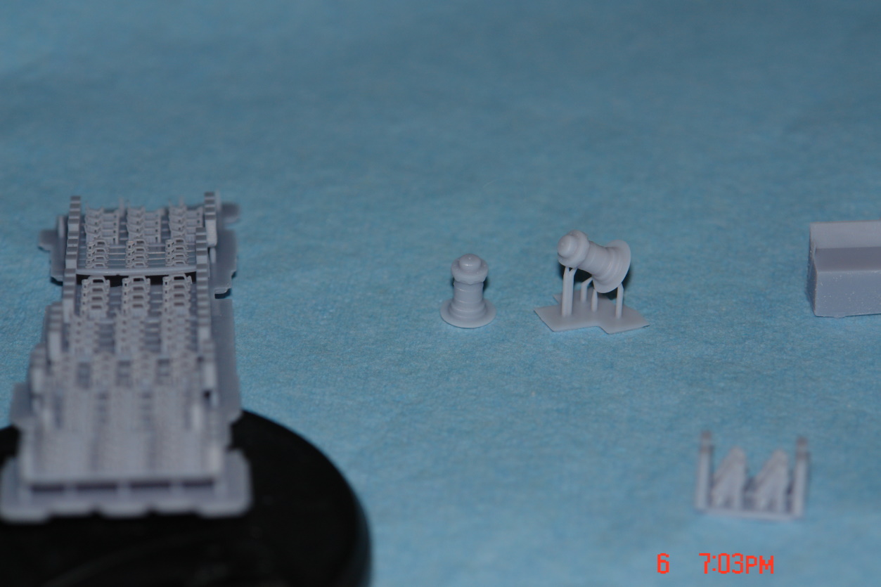

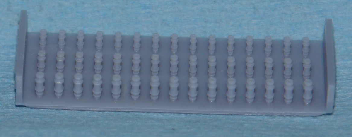

Last year I think I posted about a company, ANYZ who make switches and buttons etc in 1/48 and 1/32 scale. I really wanted to try them but shipping and costs were too much. Well Saul pointed out to me today that they are now selling STL and Obj files to print your own. So of course you know what I did. I need to tune my printer a bit more and my photography sucks but this is what you can do. Thre are some covered switches here, knobs, pneumatic/hydraulic fittings etc. When I zero in my printer better and practice taking pics I'll post more.
