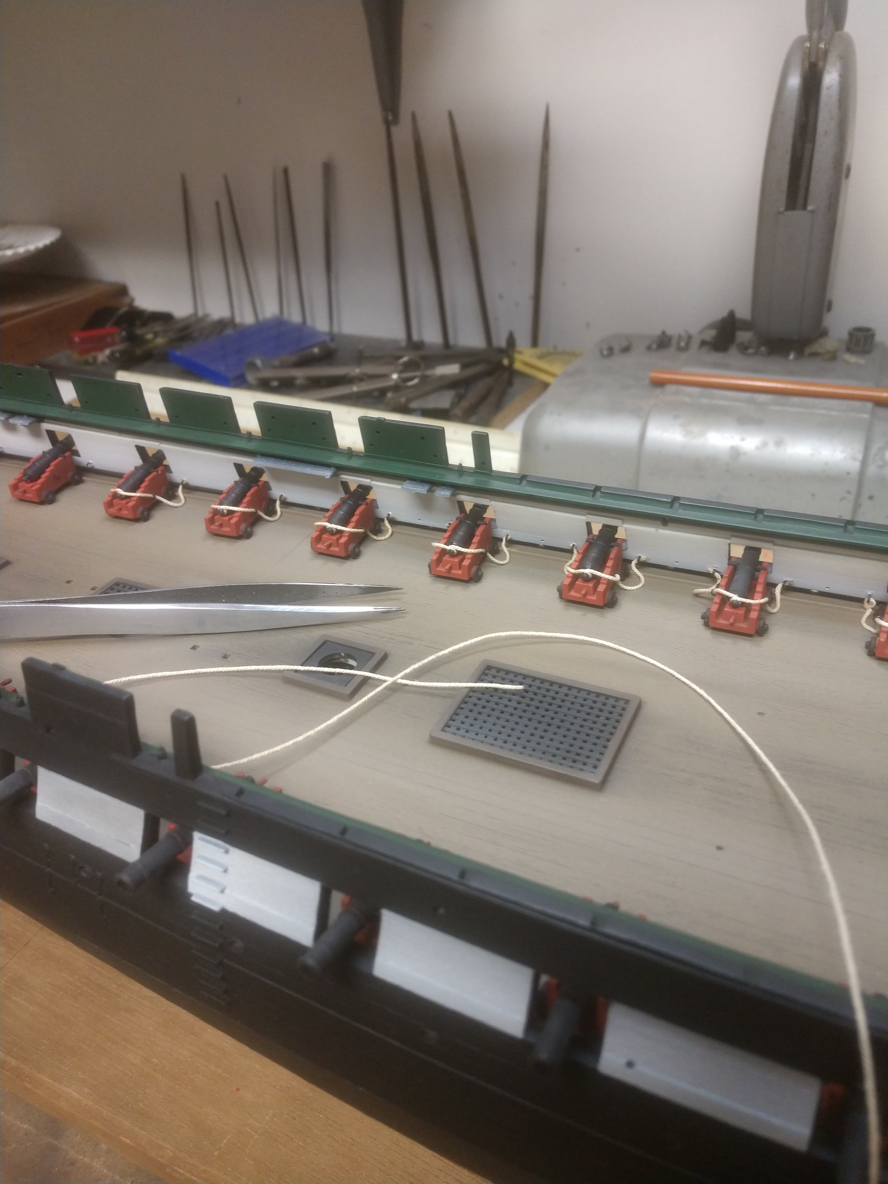

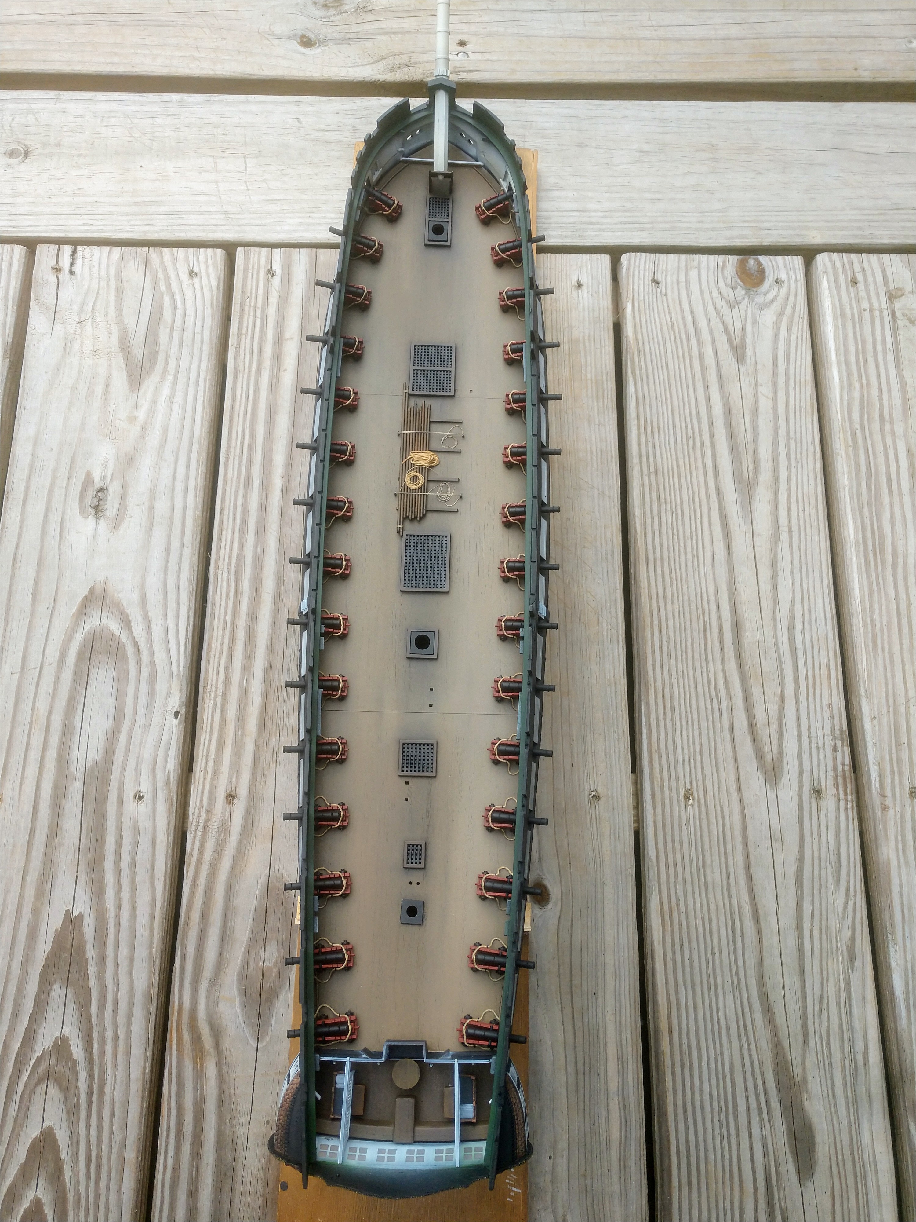

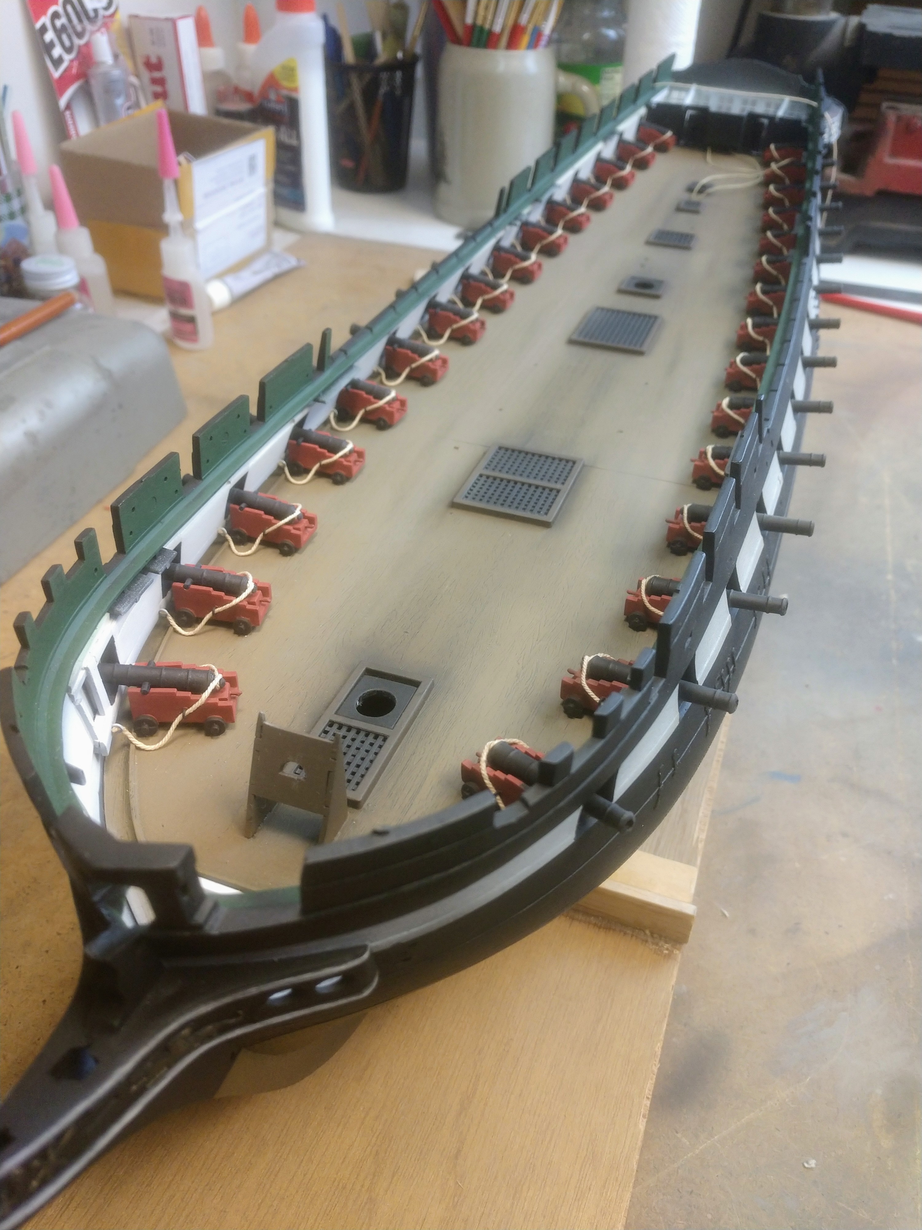

1/96 scale USS Constitution build.
The gun deck cannon breech ropes are done.
That is certainly further than I ever got on mine. I tried the same thing and just could not get them on.

Thanks Duke. After about the 20th one I got the time down to around five minutes per cannon. It was a learning experience. So, I'm going to take a different approach with the spar deck's cannon. They will be fully rigged.

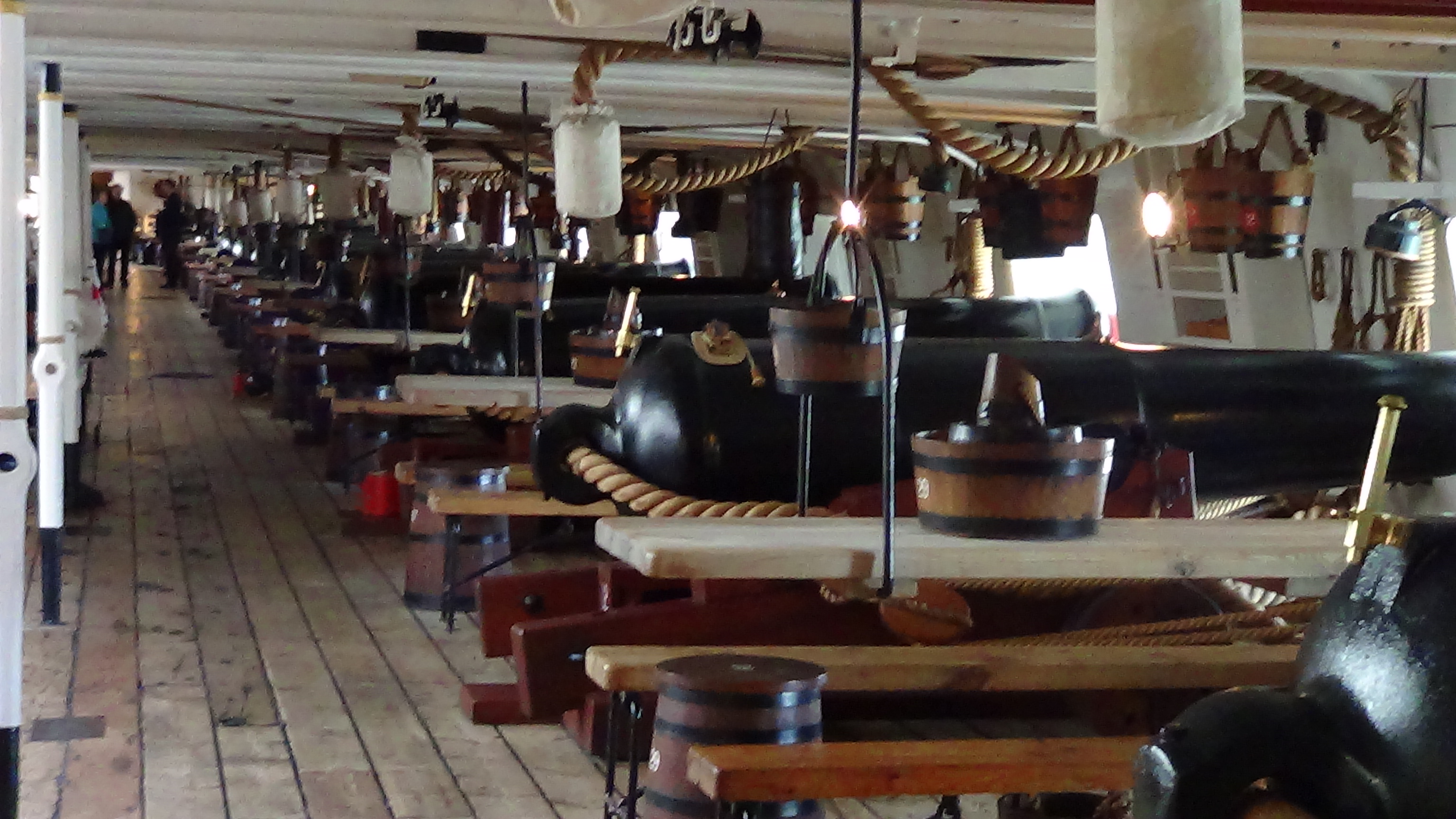

I visited HMS Warrior in Portsmouth a couple of years back and commented to the official there, where did you find all these guns. Turns out they were fibreglass :) fooled me but did feel a little stupid as i was leaning on one at the time.

Thanks! I had to put the gun deck in per the instructions, in three pieces. I didn't like it much though. The spar deck, however, I was able to glue up as one piece. Lots of test fits, sanding, adding styrene filler strips etc..etc. I've decided to paint the spar deck out of the hull, then drop it in place. I thought about the aftermarket deck, but something bothered me about the ones I had seen...even more than the kit's plastic ones...lol.
