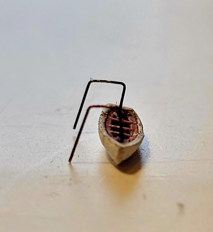

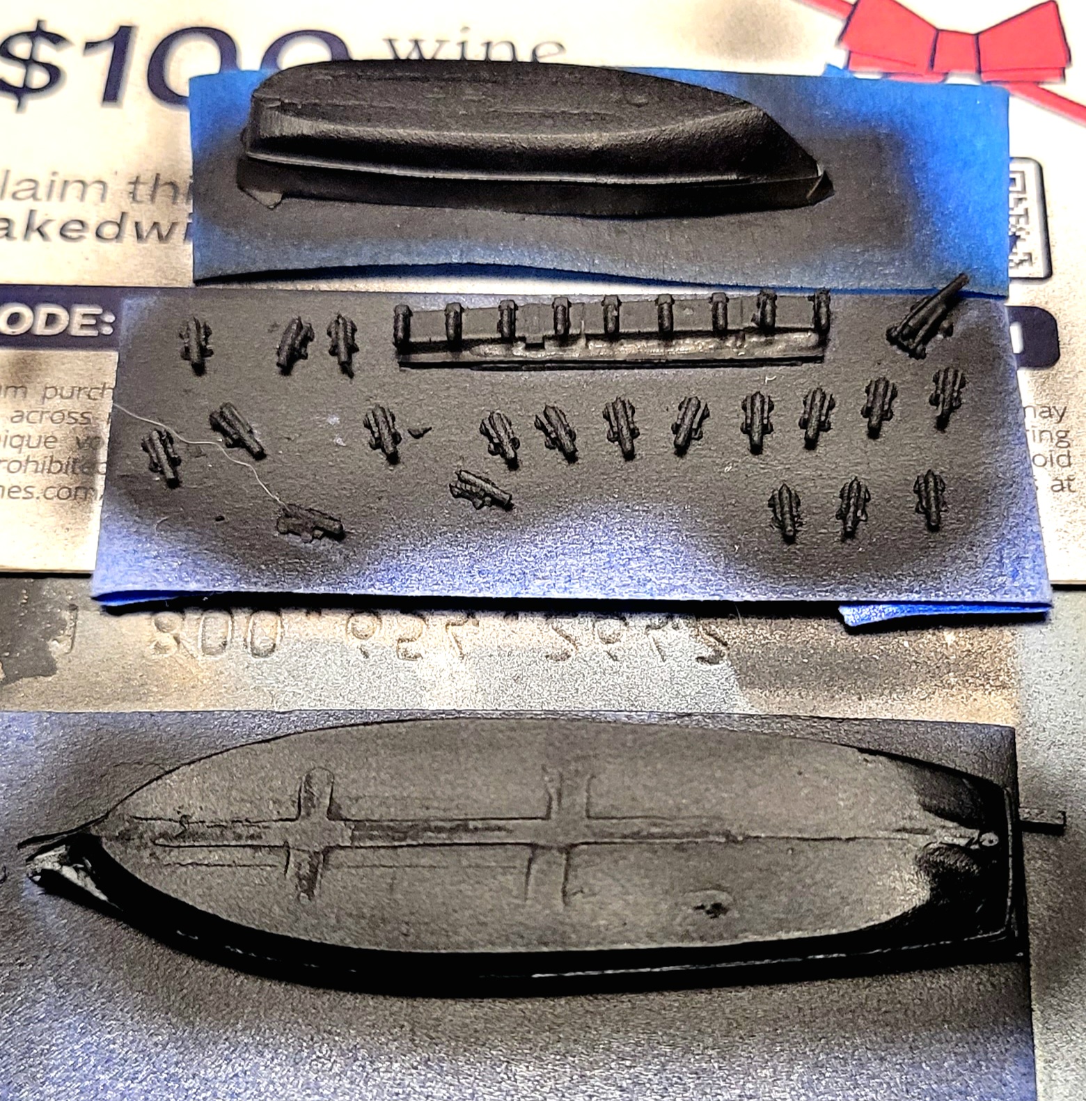

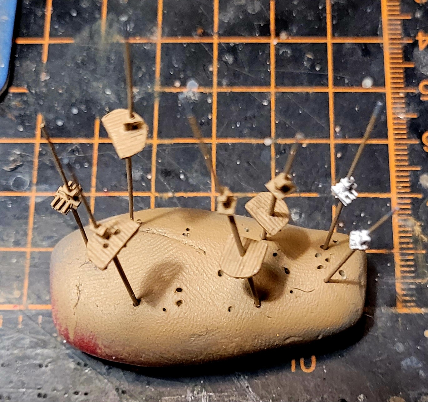

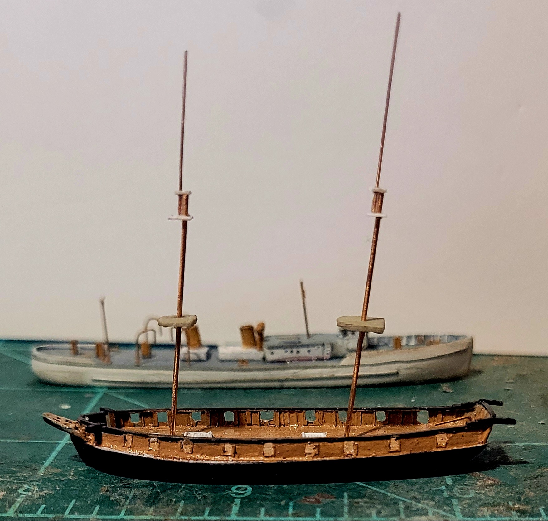

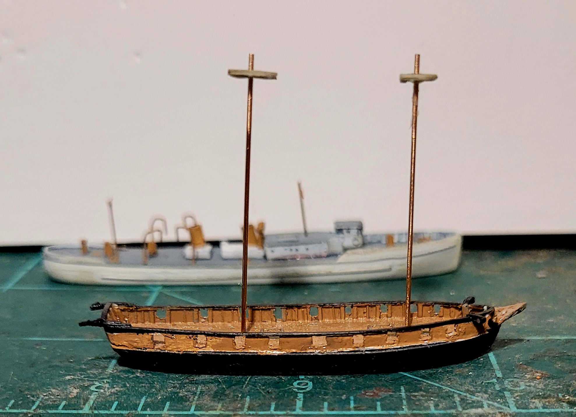

I have a long history of paint adhesion problems with the copper phosphor wire/rod. Years ago there was a product called "Blacken-It". I remember armor guys liked it to make metal track links black. I bought a little bottle of JAX Pewter Black to give it a try.
This stuff is GREAT! Dip, wait for a bit, wipe it of and dunk the part in water.
Booms and yardarms are mostly black. BONUS!

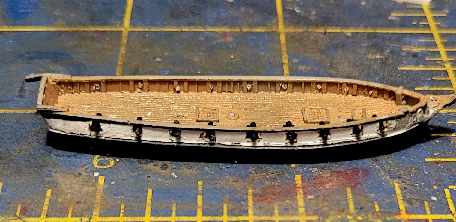

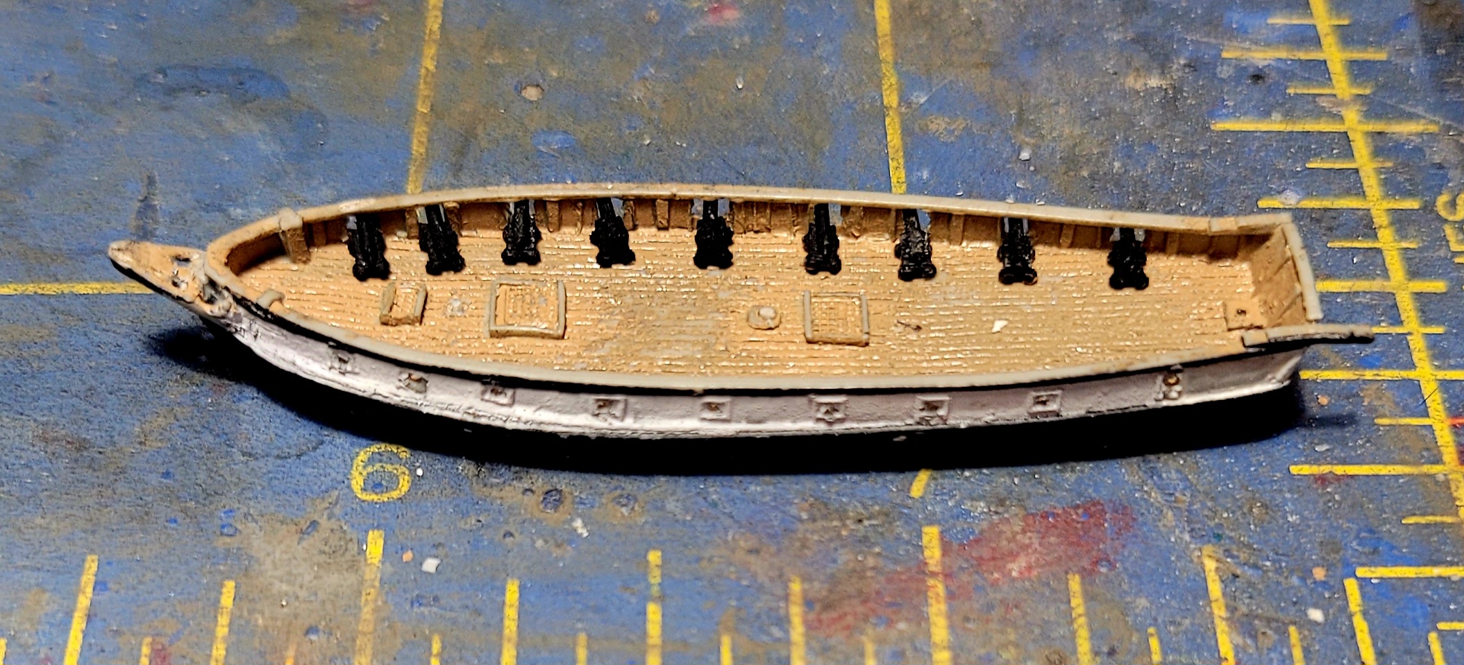

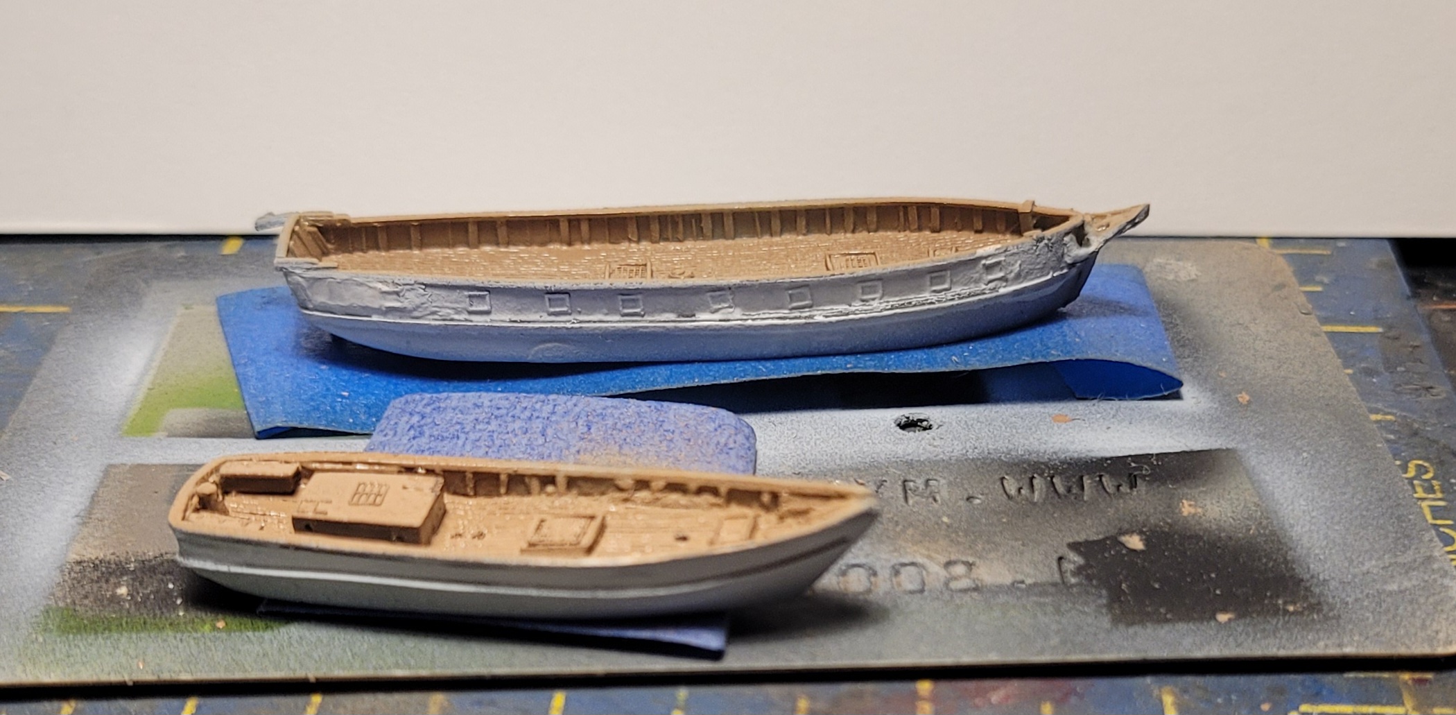

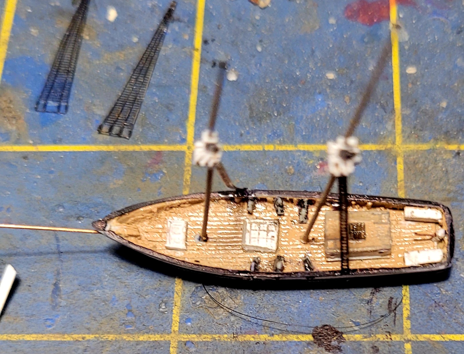

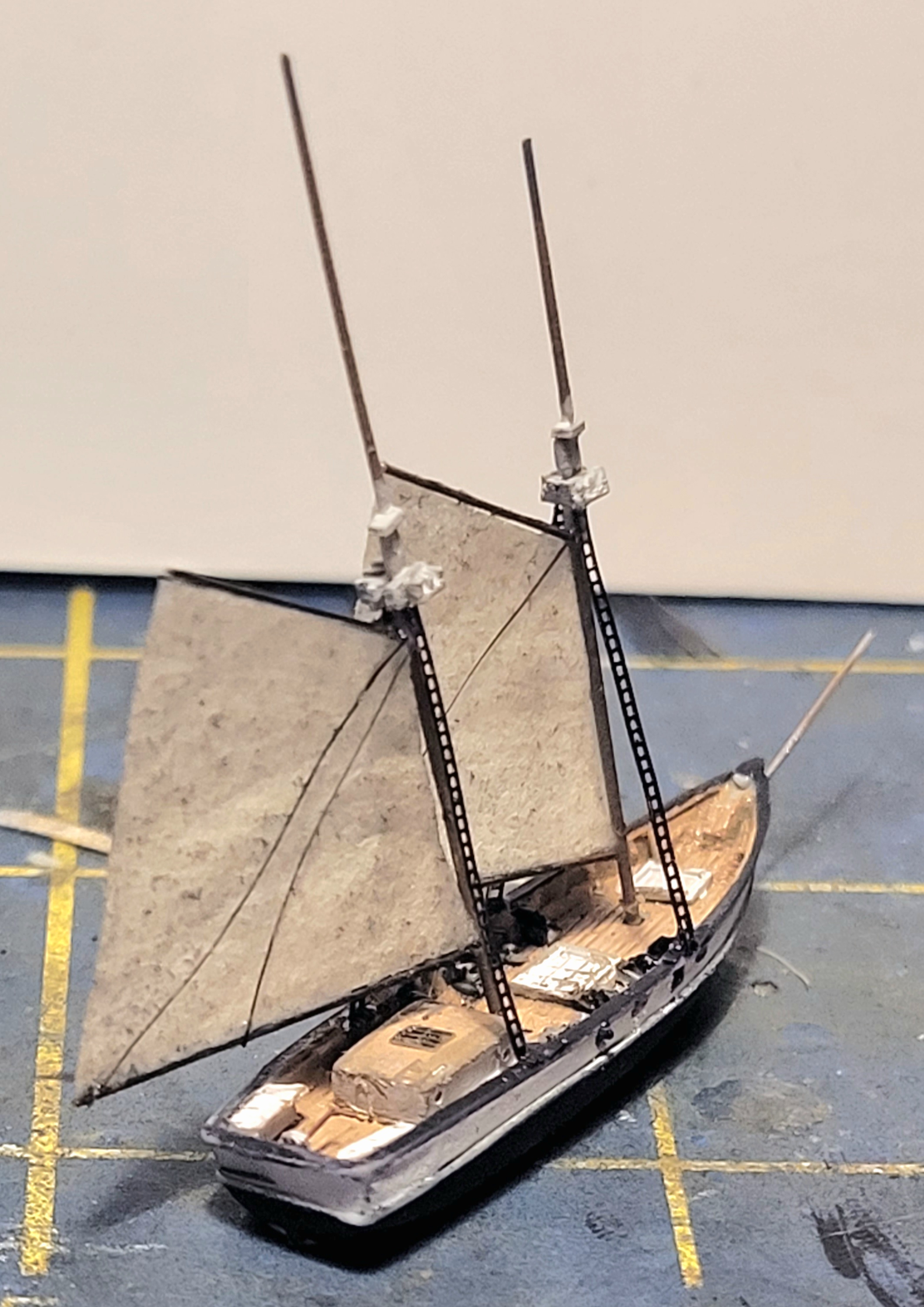

To make the 6-pounders fit the Cutter, quite a lot of trimming and sanding is involved.
The Hamilton-class revenue cutters were armed with16 of these guns in their hey-day. The kit includes 9. It took 13 to mount 8 cannon.

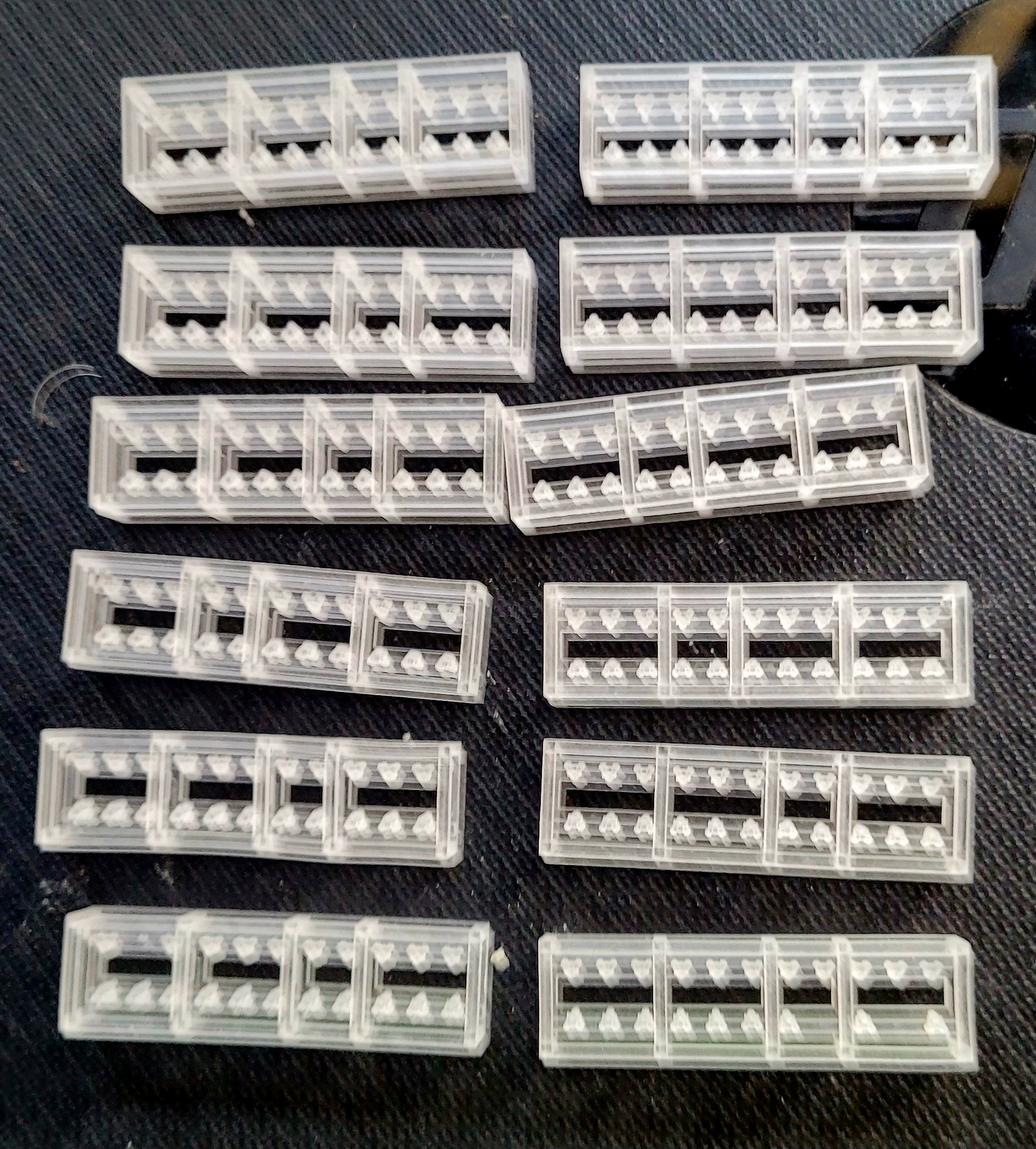

They are so small when they take flight, they make no sound when they land. These are glued on with Tamiya X-22 clear.
Roger B's rails are a little short for mounting 9-pounders.
Kit instructions will warn that the teeny cannon might be more trouble than they are worth.

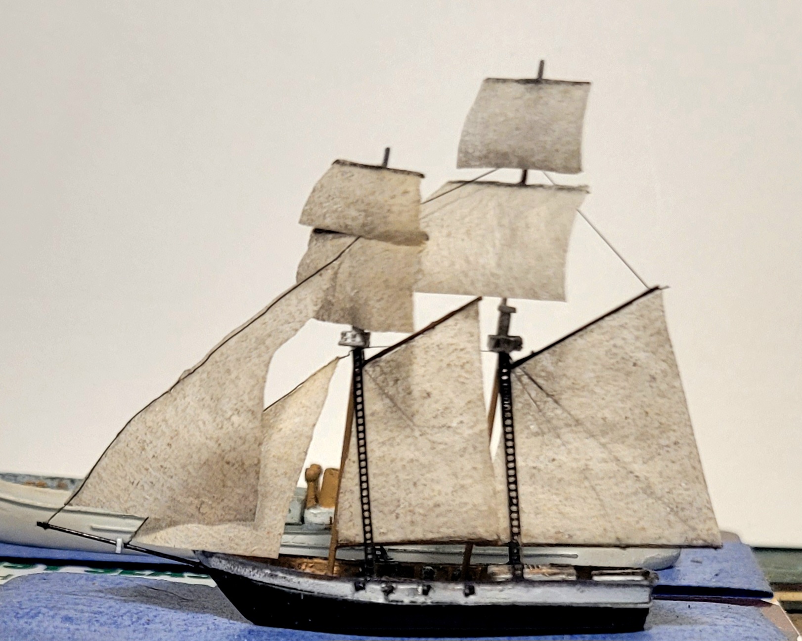

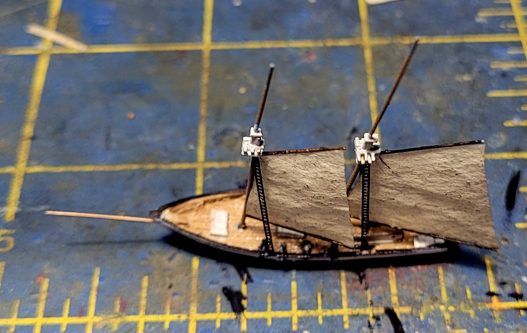

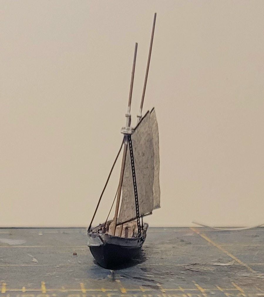

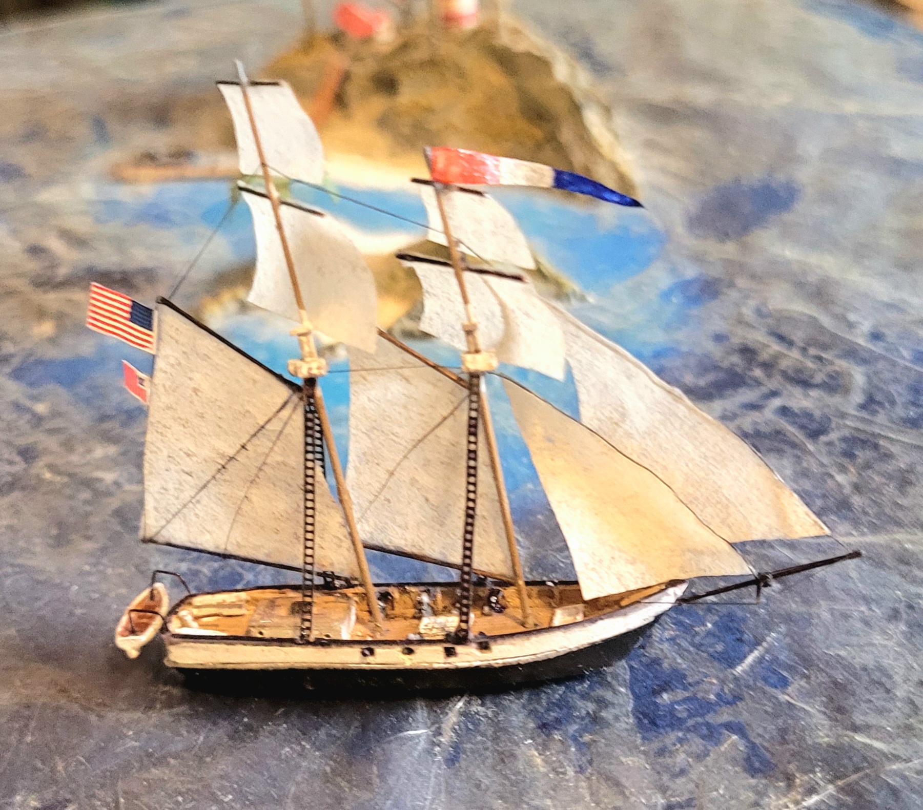

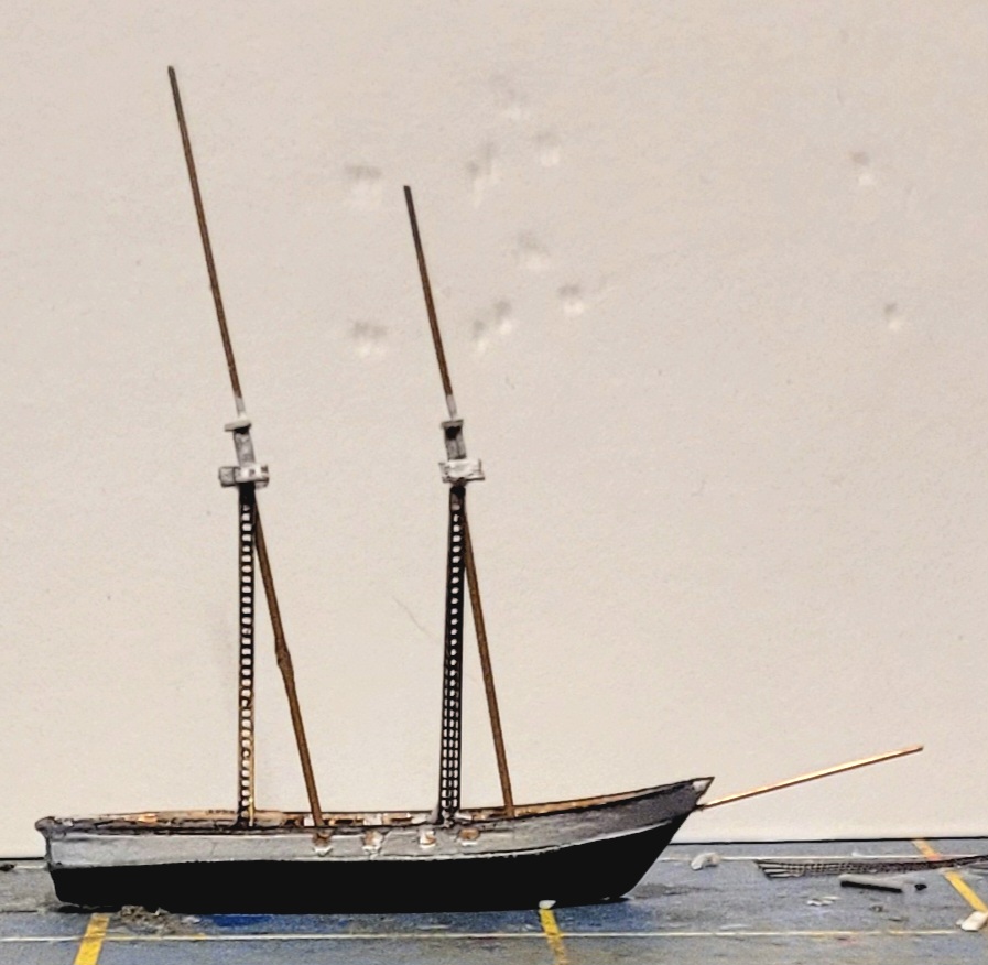

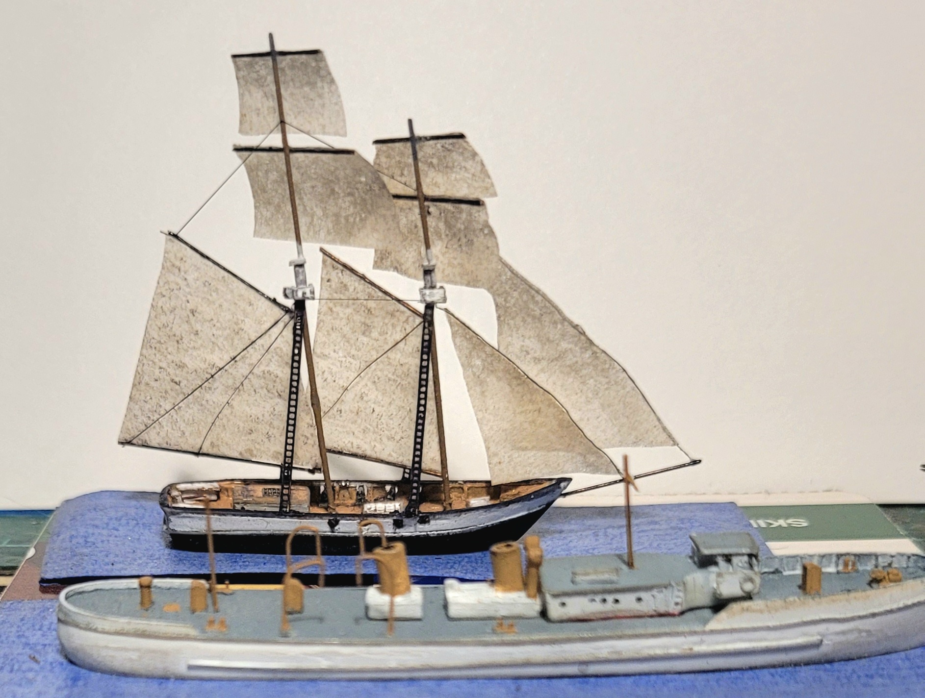

She's starting to look pretty! On a cutter-rigged vessel, there would be a jib boom extending forward from the fore mast (the one in front) with a sail flying from it.
I will be satisfied with topsails and headsails. Roger B. Taney's rig will resemble a topsail schooner. I LIKE me a schooner!
After the X-22 cures, I will flat all the shiny spots and the deck.
