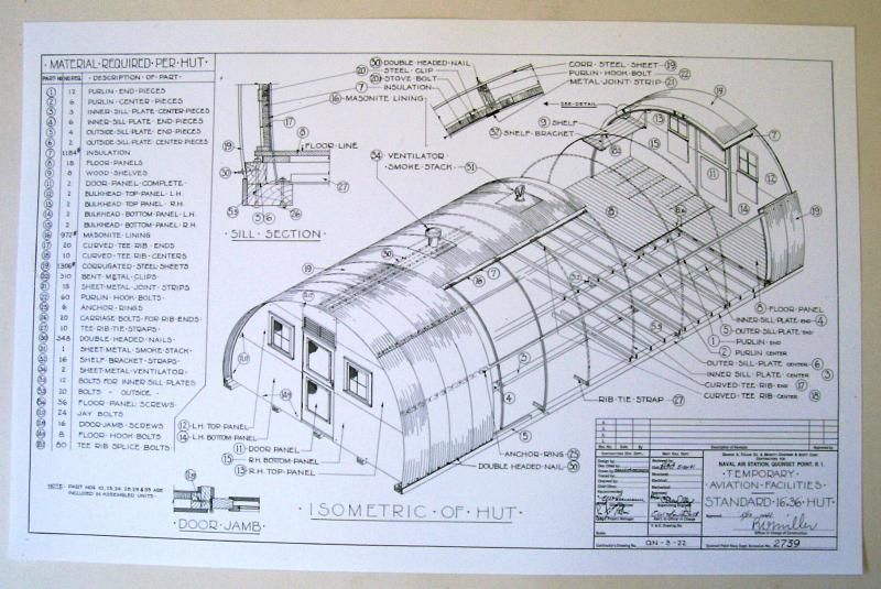

Any way you can open the middle up and show it under construction ?
Heya Glenn...
Sadly, I've not gotten any wood yet. My wife's been on a family hike kick and my son's playing football this year, but I'm starting this weekend whether she likes it or not...she's too used to being cozy in the winter to say much. ;)
That would be very cool to do-- but I've got a notion of what I want to do with the crewmen inside that wouldn't work if they're still building it-- but I love the plans...where you get them? I need some good interior pics at some point...

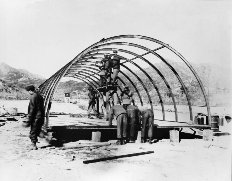

But then I found I still need to improve on it after finding this pic...
First stage-
Gotta tie it in with the wire I bent from a paper clip for the top part of the frame-- that's on for tomorrow...I won't have the wire frame that we see in the pic-- but will add a Aves sculpted mattress to each of the 6 so you wouldn't motice anyways ;)
