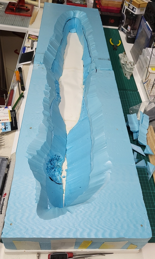

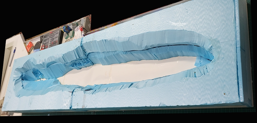

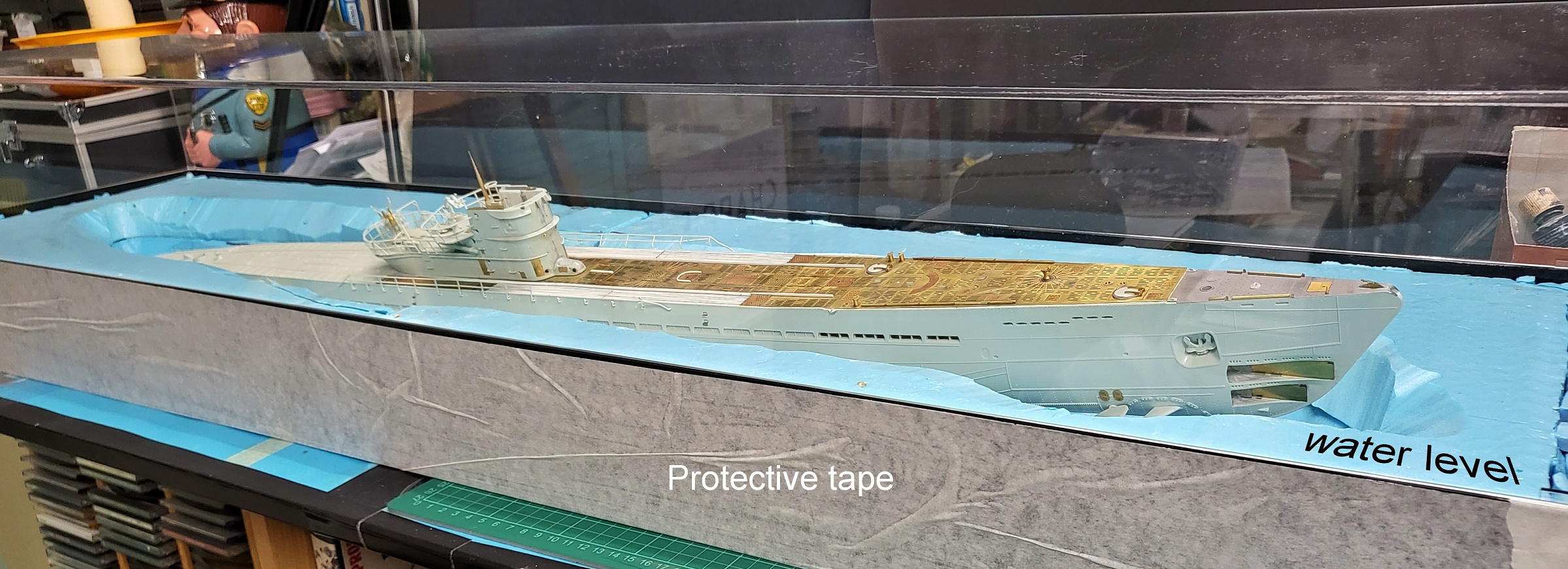

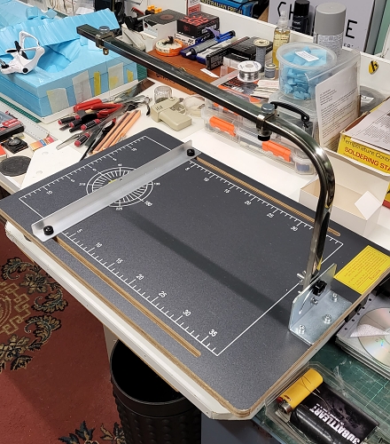

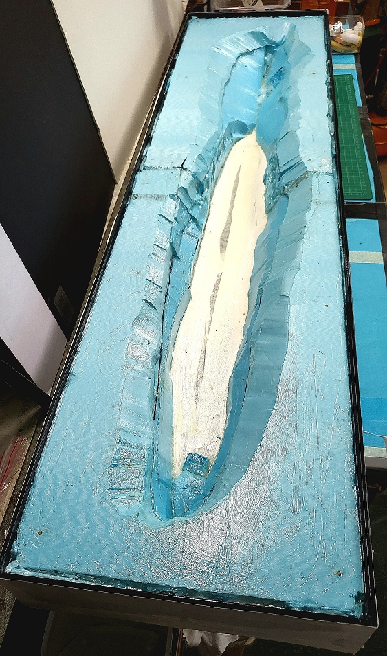

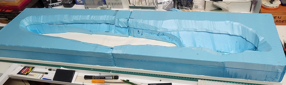

I completed the foam base cavity for the depth work on the sub, digging out a bit more around the inner edge and near the hydoplanes at the front. I trimmed- up some pieces at the back to fit the melamine board base with my new foam cutter.

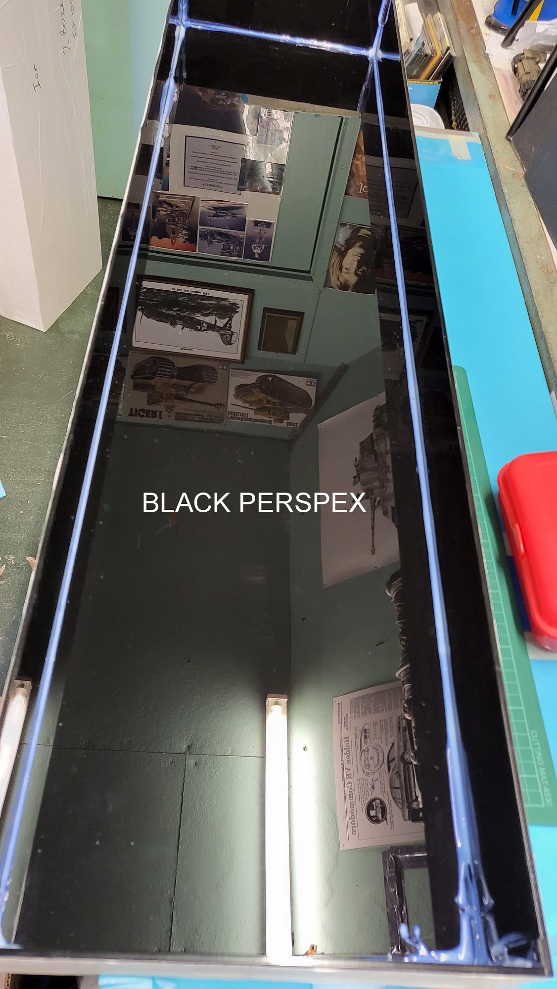

Currently working out my measurements and drawings for a black perspex surround. The next stage will be applying a epoxy safe covering over the foam and intergrating that with the perspex when it is made. I also need to trim more off the underneath rear of the model so that I can get it to sit lower enough as I don't want to add more foam (as this will mean more resin).

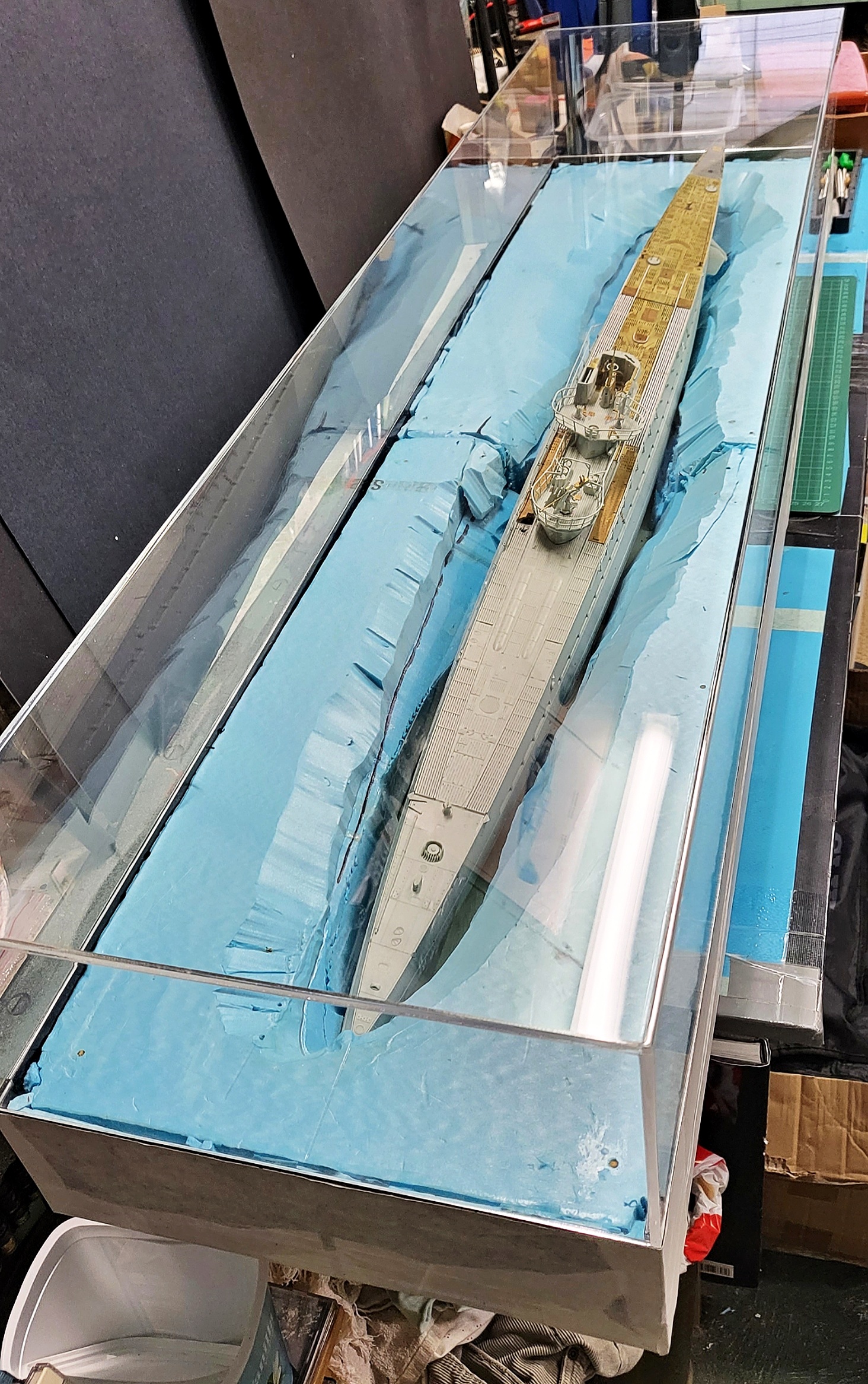

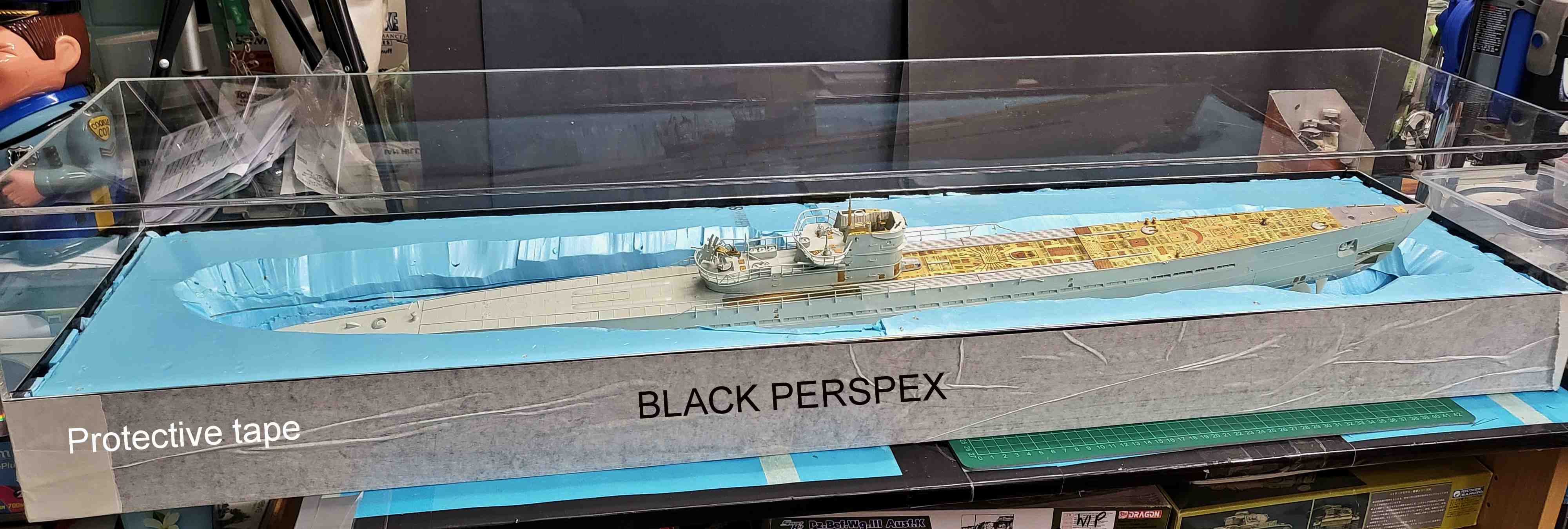

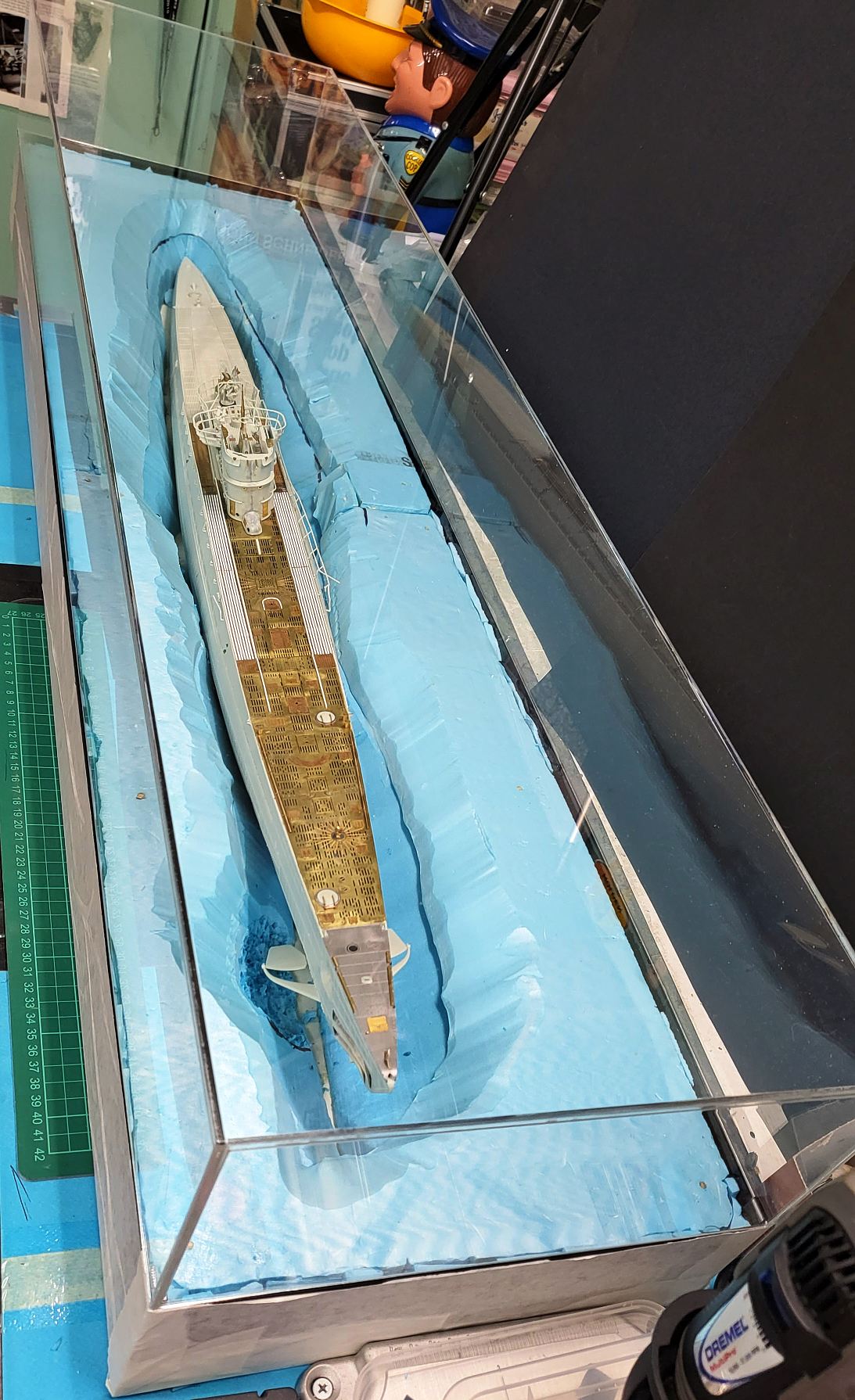

Nearly ready to move on to stage 3 with my this dio. My perspex box is made(the tape around the base is just on there to protect the black perspex) and I have fitted my foam ocean base. I just need to do a little more work on the CTower details and I will start the model clay work on the ocean base.
stage 1 - build the sub
stage 2 - work out the base and build it and have a perspex box made.
stage 3 - create the base clay and cover the foam base to protect it from the epoxy resin water.
stage 4 - build the figures and surf boat.
stage 5 - paint the uboat and the foam base
stage 6 - attach the uboat to the base, add the figures and final wires and mooring /tow lines.
stage 7 - add the resin and water effects.
stage 8 - design name plaque and attach this and photos to the base sides.

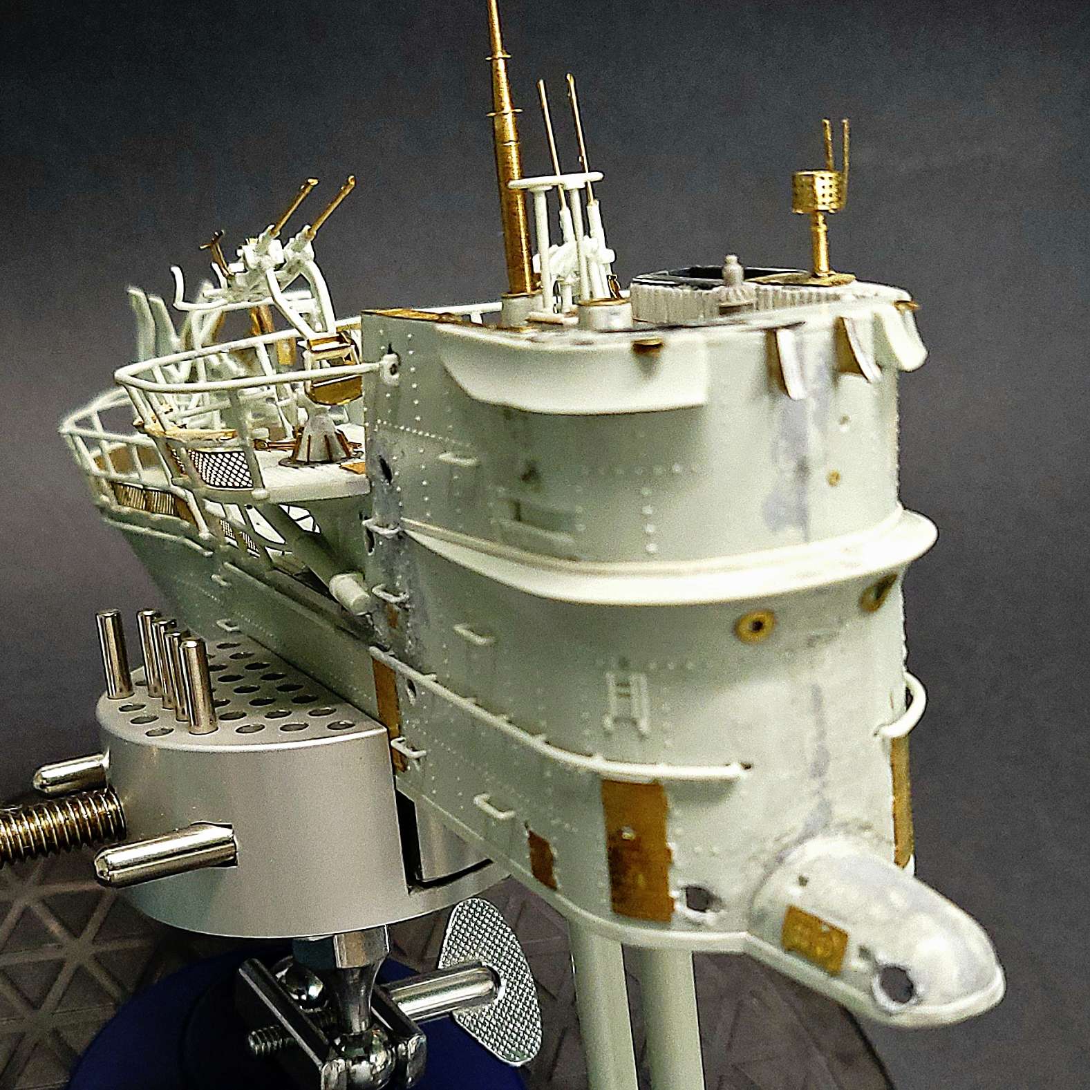

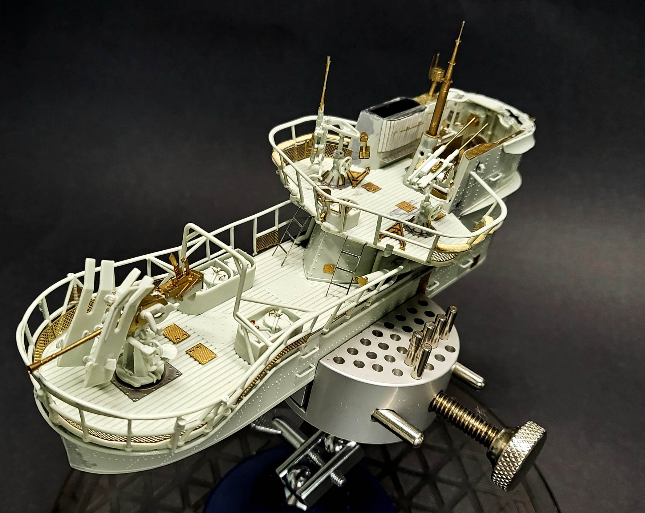

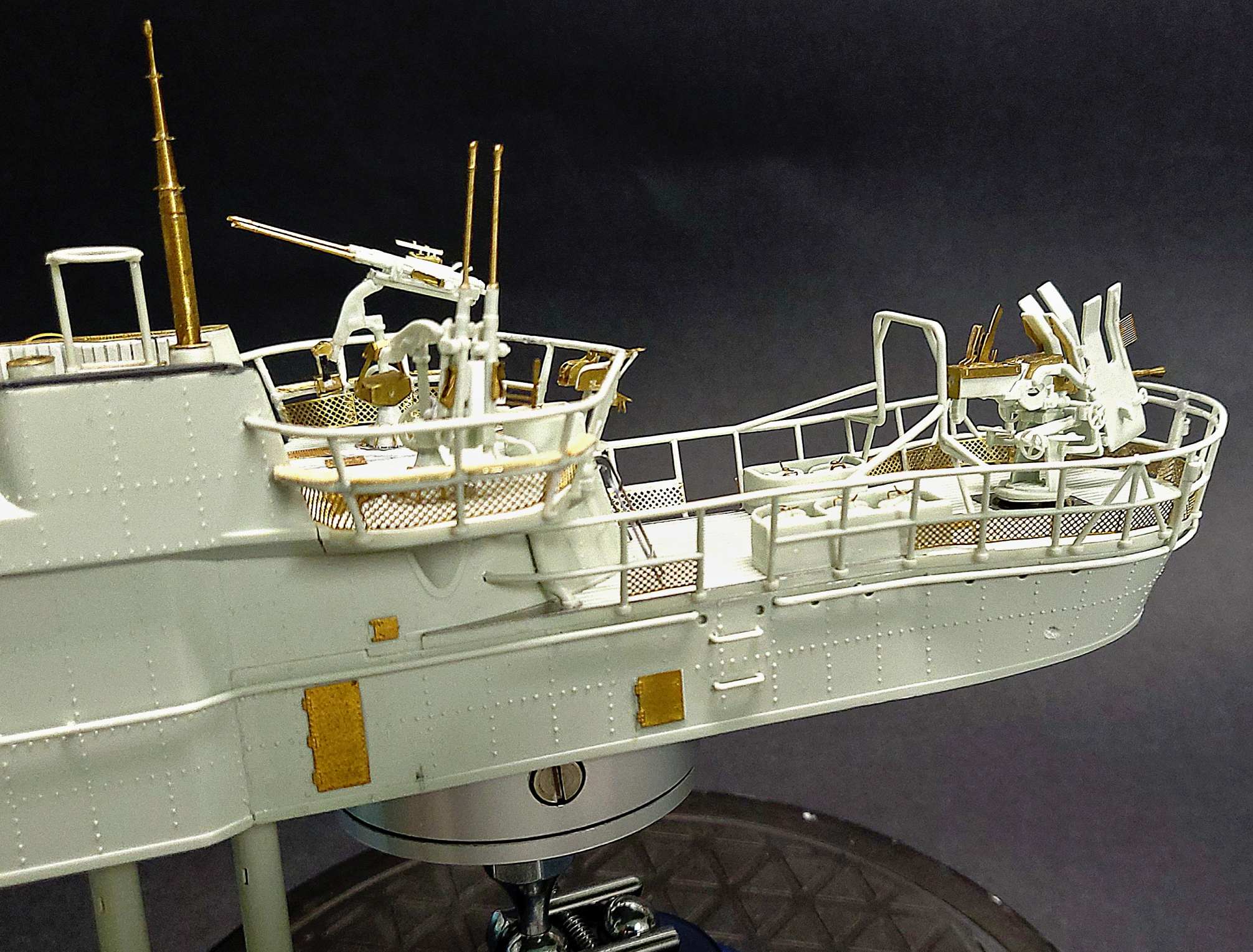

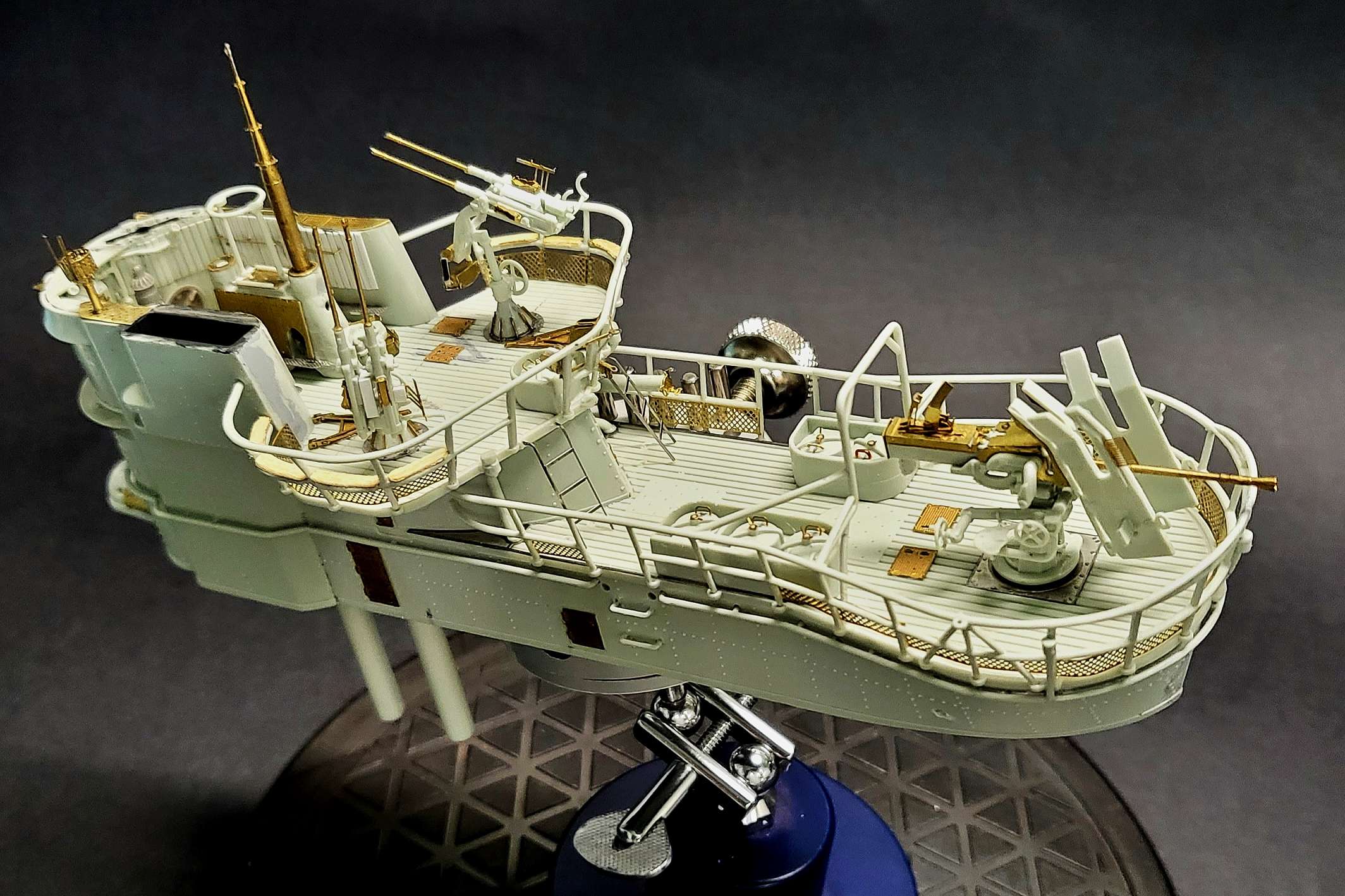

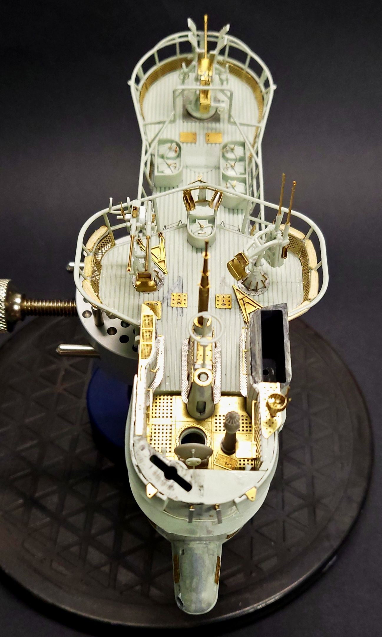

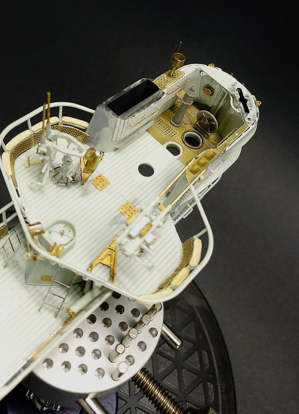

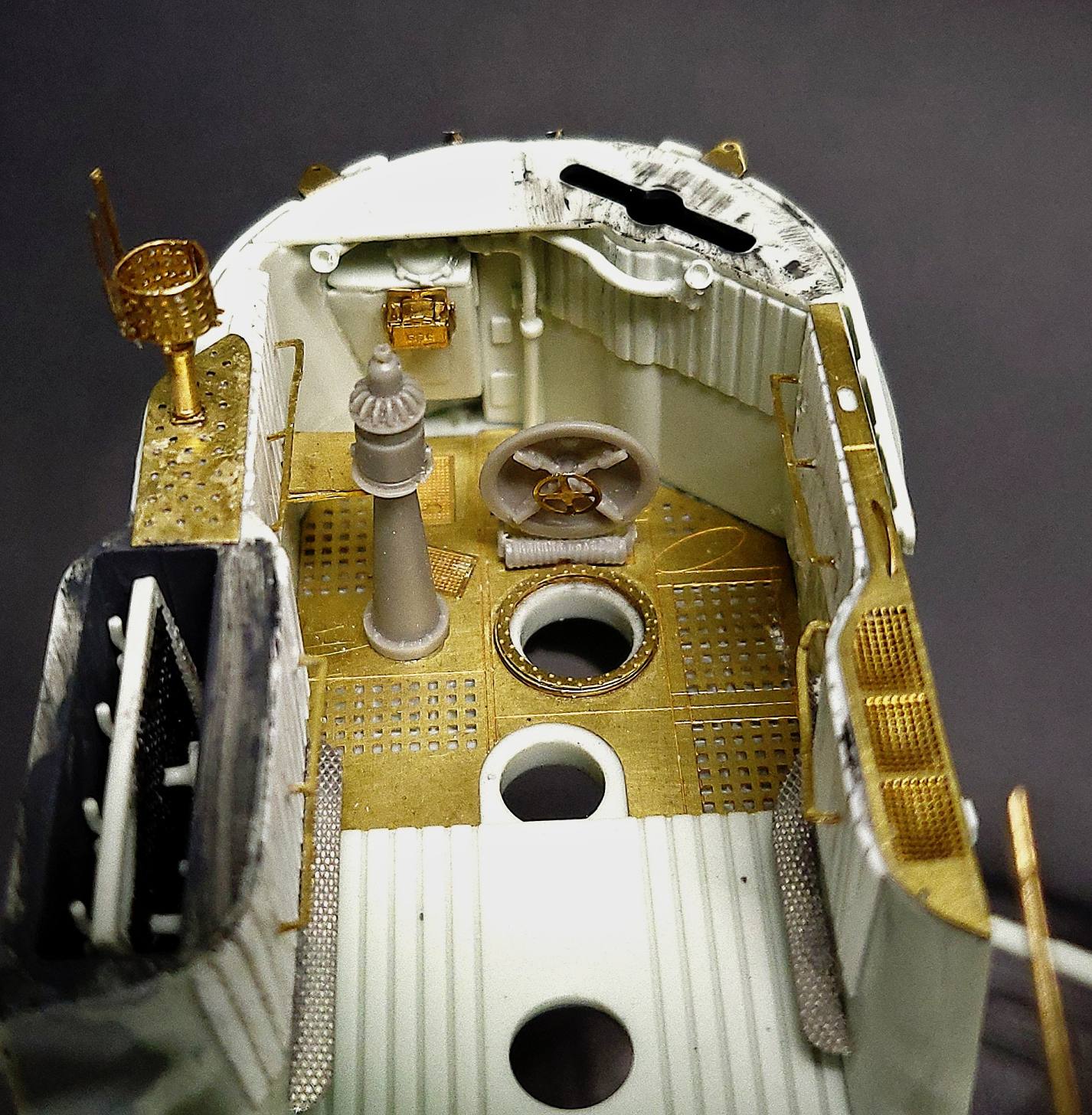

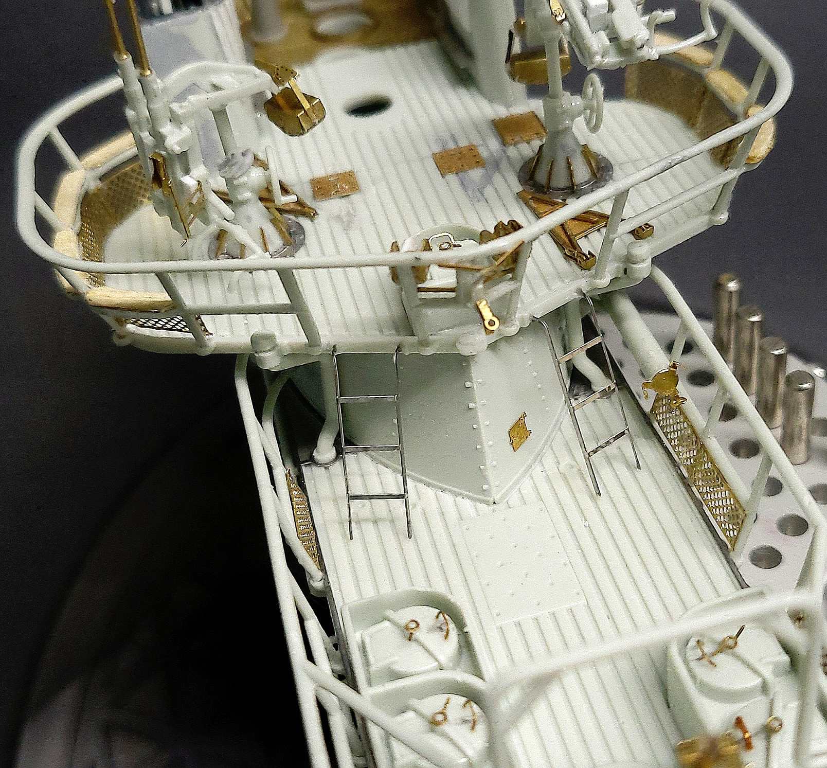

Time for an update................

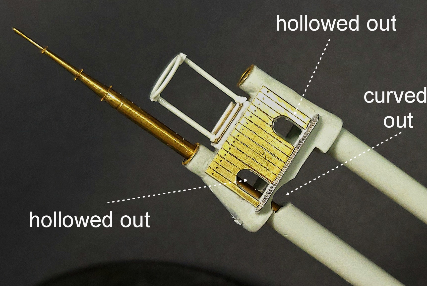

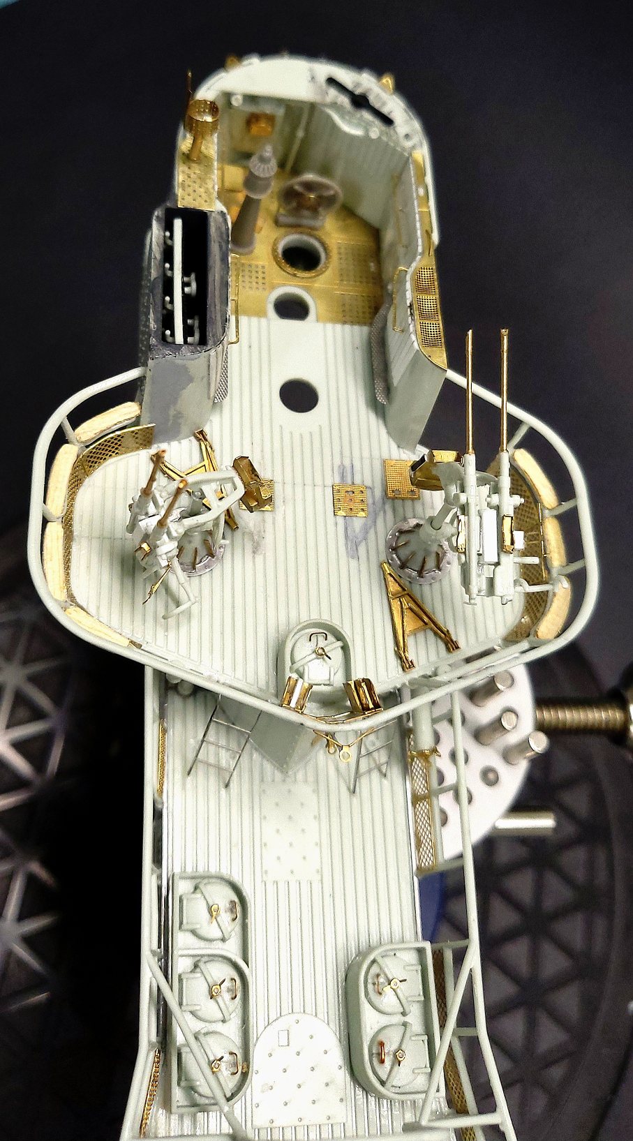

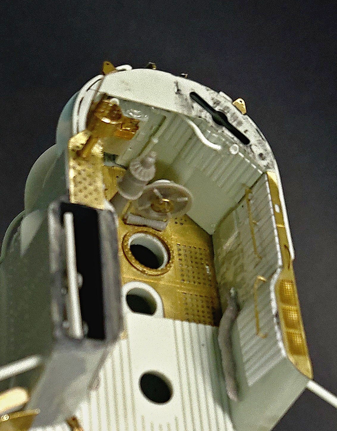

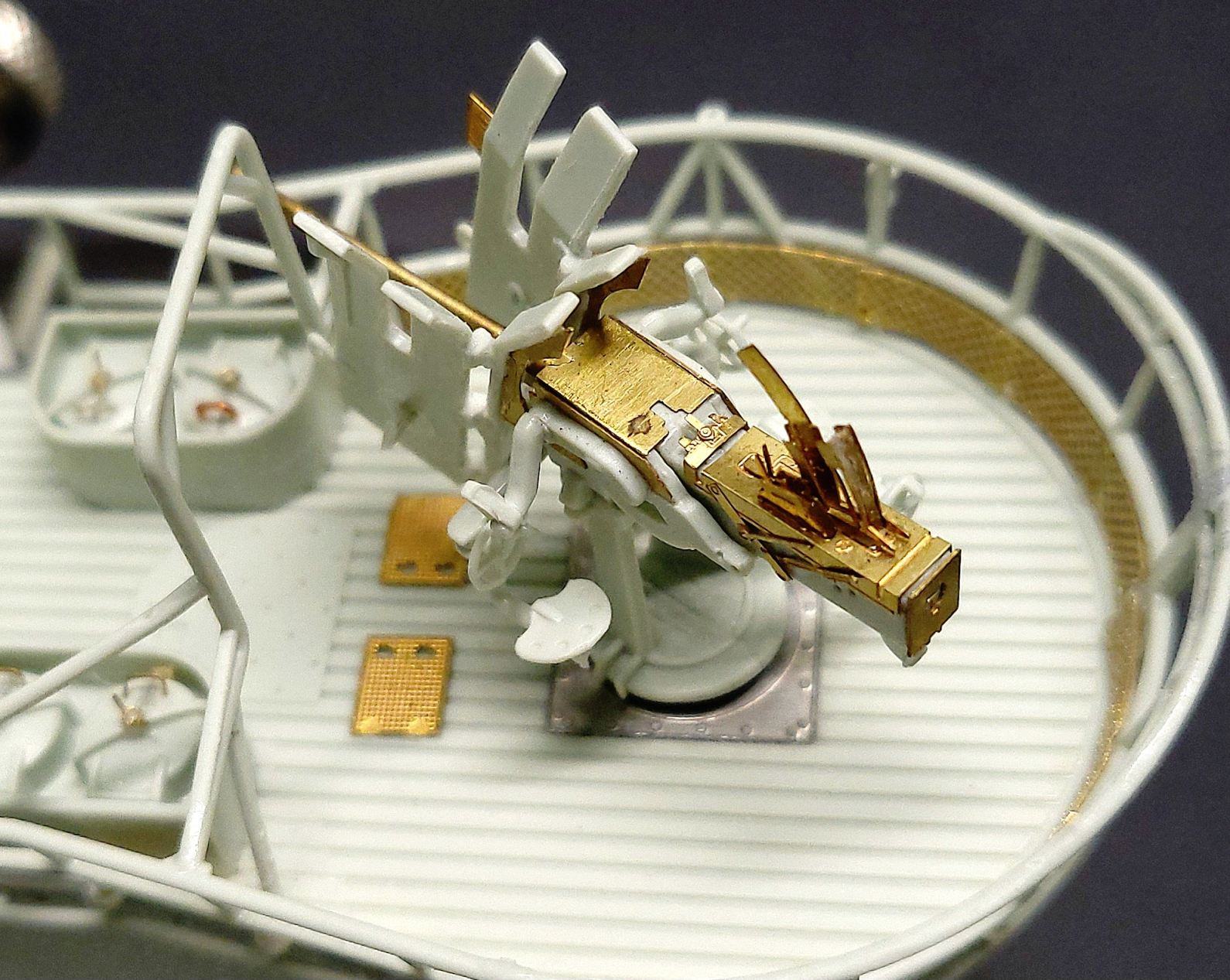

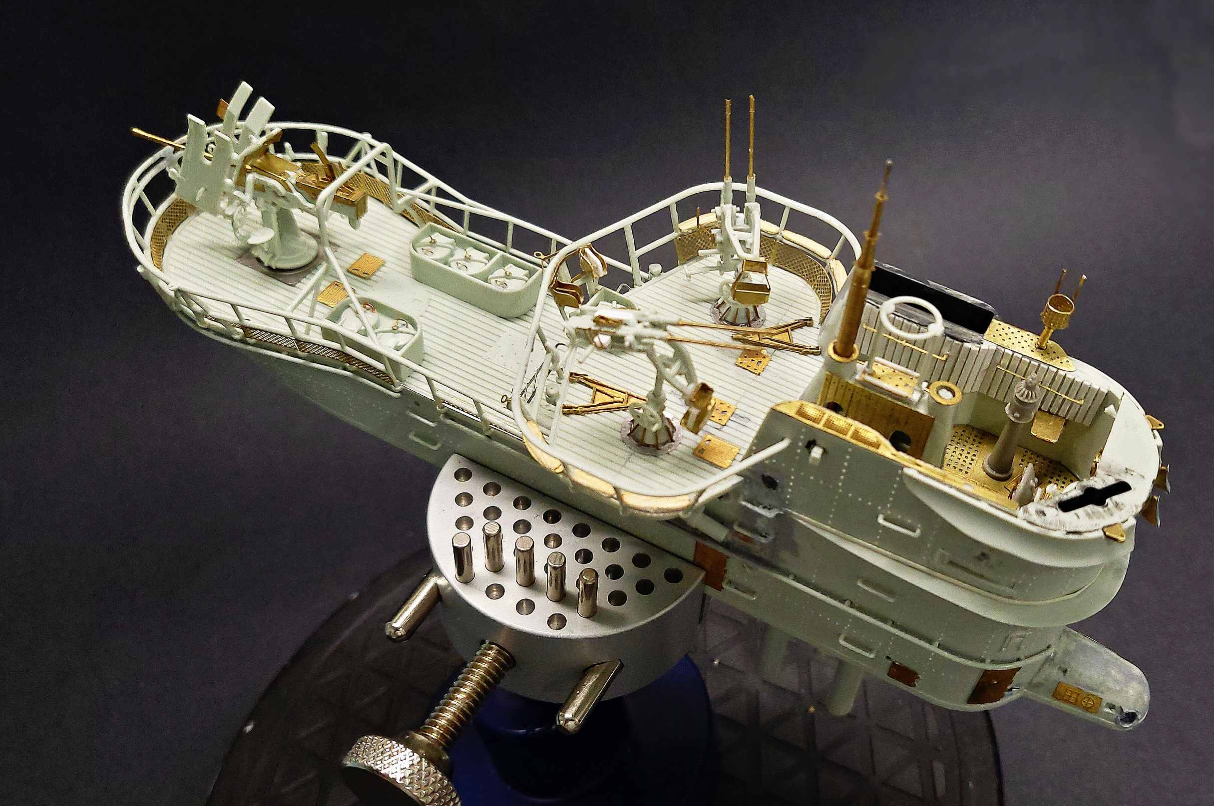

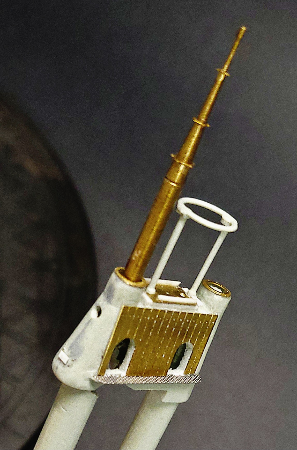

I finally finished the Conning Tower details but still need to fix the Port side join seam between the two levels. The PE on the tower was very frustrating and I learnt some better ways to approach this part of the model which will speed me up on the next one. For instance, just the fins on the twin 20mm base mounts took a whole afternoon. :silly::soldier
The 'Bali' radar on the tower was a nightmare. My first attempt using the Pontos PE just failed as it was overly complicated and after a whole day I just gave up. I turned to my other version in the RC Subs set and this was way simpler and finished it in 20mins. :ph:
I constructed the tower and railings too early, having to work around these details to attach the PE - a big mistake. For the next 9C I will attach the handles and wire mesh etc while the parts are seperate.
The Flag pole mounts alone had so many parts that assembly took me 4 hours. U-505 had the mounts but no pole.
I cut up the edges of the Pontos wooden decking and trimmed them for the seats, adding them on top of the plastic base shapes.

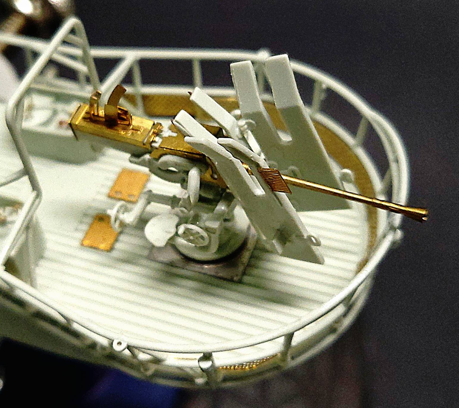

Another note is that I did not use the PE shield provided for the 37mm gun as I compared it to photos and it looked right. The PE actually looked a little thin, which came up a few times, especially with the handrails.
There were many mods on this tower such as:​
- all PE parts are from the Pontos 9C set or the RC Subs U-505 set.
- completely replacing the wooden panelling on the inner tower sides.
- replaced the binocular mount with the CMK after market part.
- filling and replacing the molded twin AA frame supports on the top level Wintergarten floor. These also needed to be completely repostioned, as U-505 had these set at opposing angles, unlike other later boats.
- modifed the front windbreak cowling to make it damaged.
- added all the battle damaged matched to the actual surviving sub photos.
- added the missing drainage holes in the periscope housing base and adding the circular scoop cut-out at the bottom of the base.
- added a thin strip around the front of the tower above the splash guard (which was missing).
- cut and reposition the 37mm gun shield to a closed position.
- a major clean-up of the top rear railing on the lower gun platform which needed a lot of work to thin out and fill the rough detail and flash.

I have also added a complete coating of white glue over the foam to seal it and needed to wait for it to dry for about a week in the thicker areas.
Enjoy.......next up is the putty on the foam.

This is just spectacular! You guys build so clean. I feel like setting my bars, like building cleaner, one at a time is making me better.
Thanks Greg, I try to do the PE as clean as possible but I do clean-ups on the PE where I can, sanding off excess glue etc.
Thanks MP :). I hate PE but agree that it is worth it in the end.
