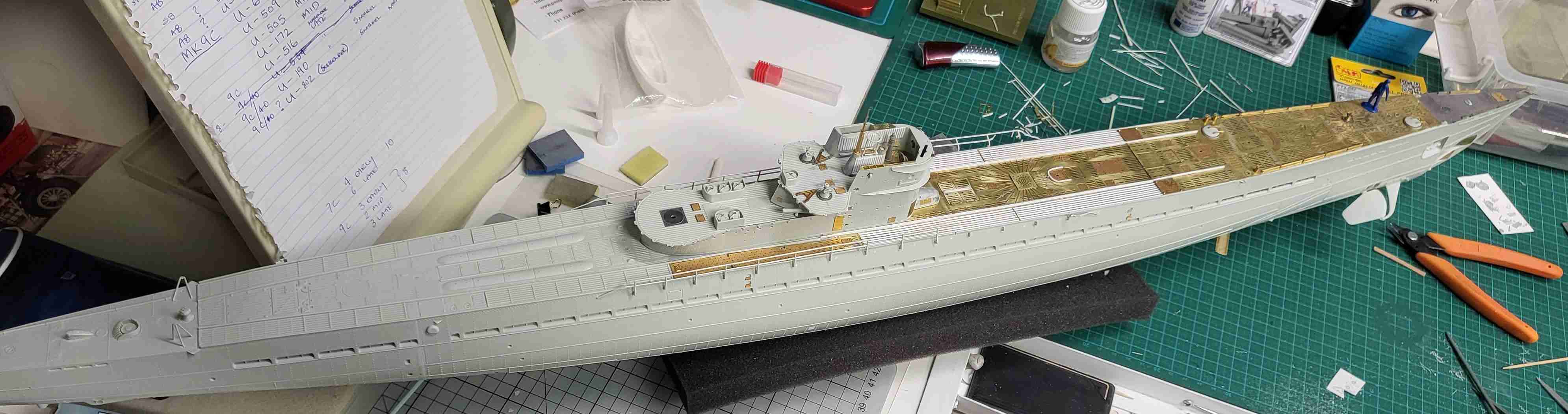

Thanks Steve, however the tower damage is only at the mark-up stage and the tower itself needs to be started. Plenty to go yet. Yeah. the stand that comes with the kit is an excellent holder but is lacking when you need to turn it on its side. I adapted the piece of foam from the packing in the Pontos set to sit on the stand as a curved pad so I can work on the sub at any angle. :hmm:

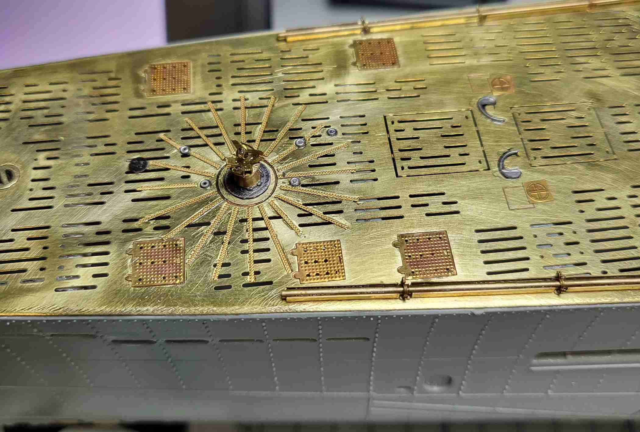

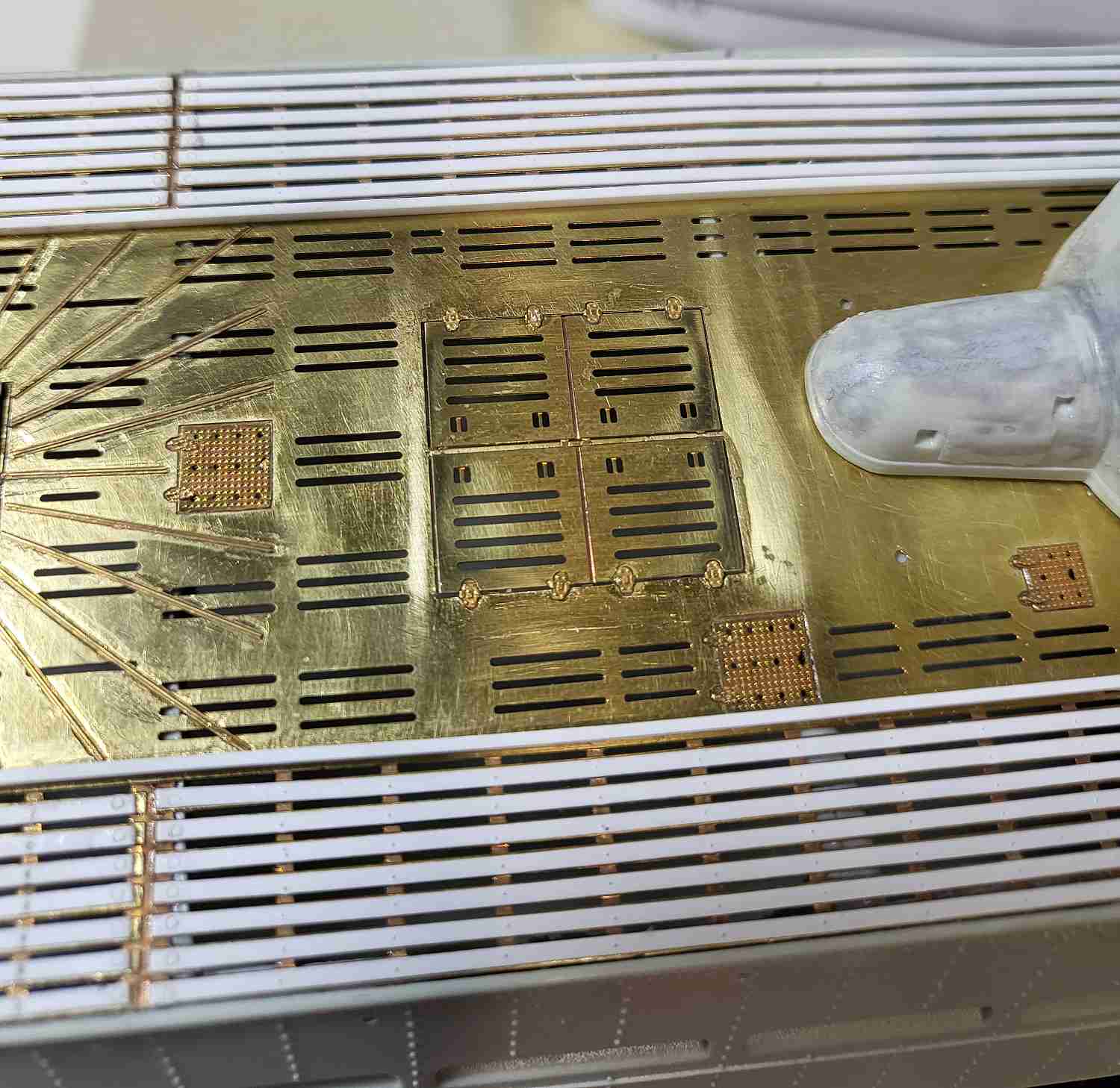

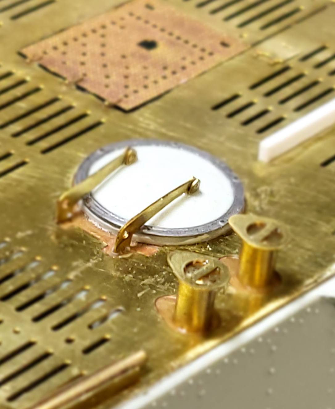

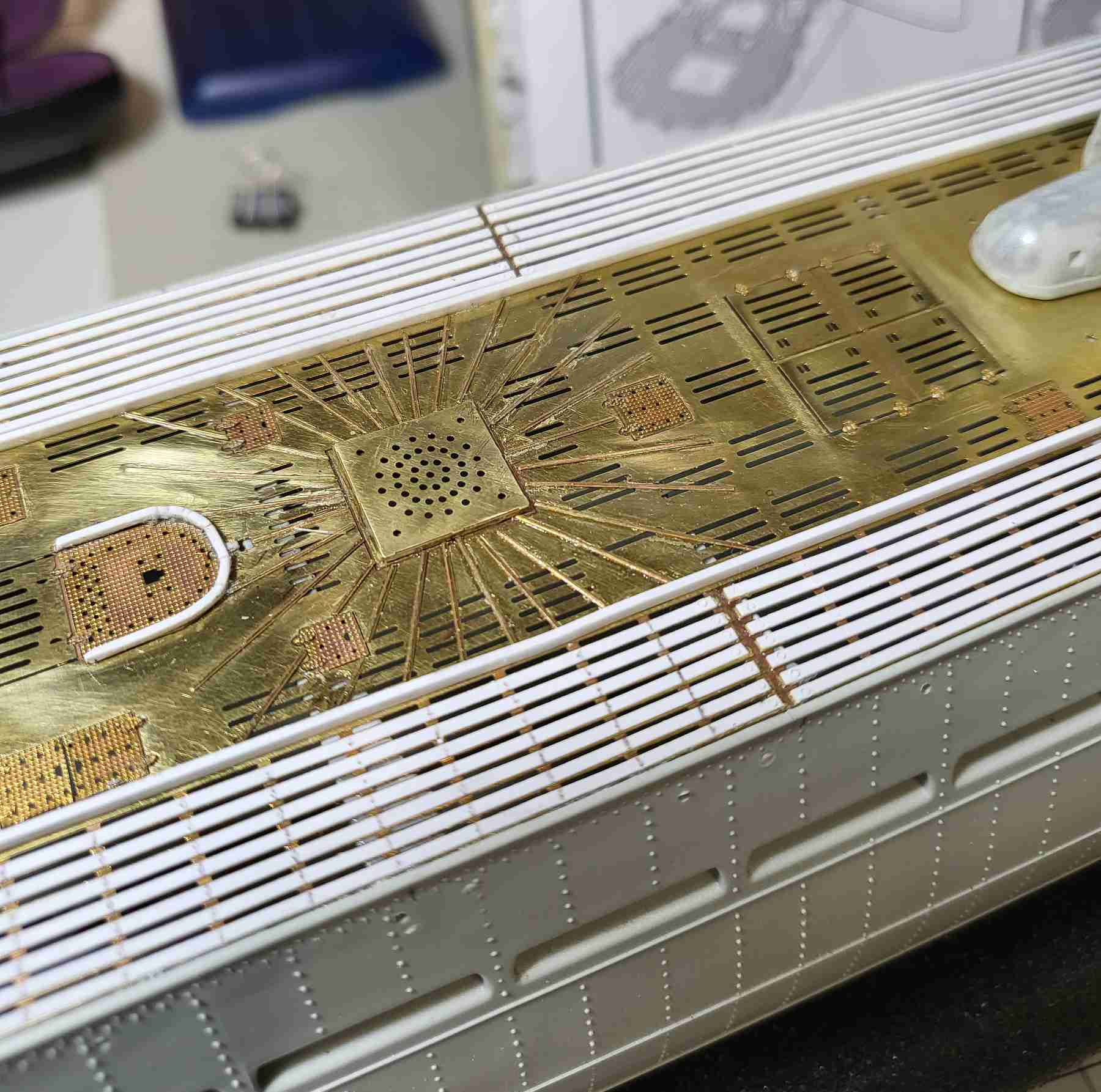

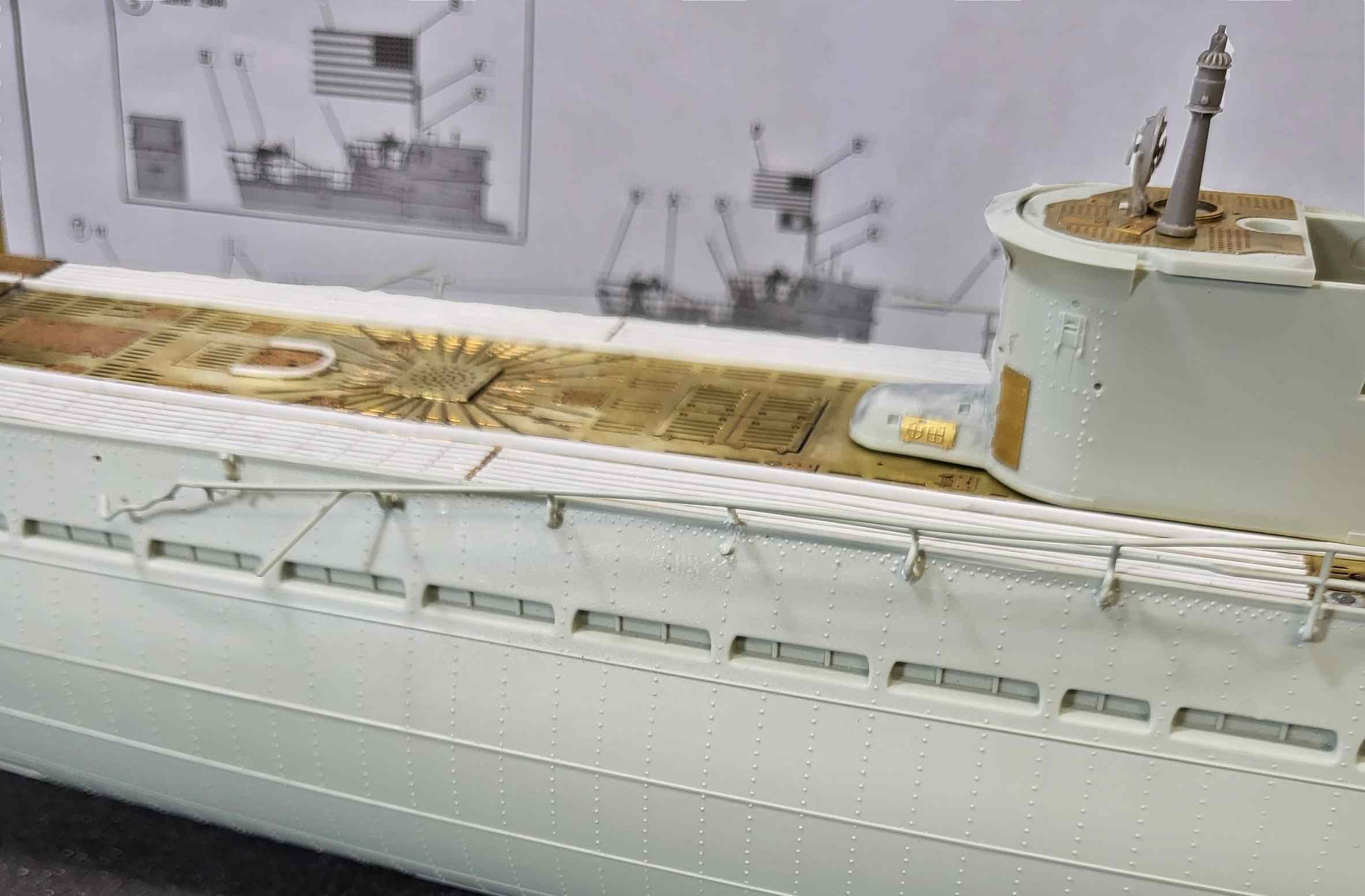

so more progress.....I have an overload of PE at present. I usually try to avoid it but with these U-Boats there is no choice....:smack:

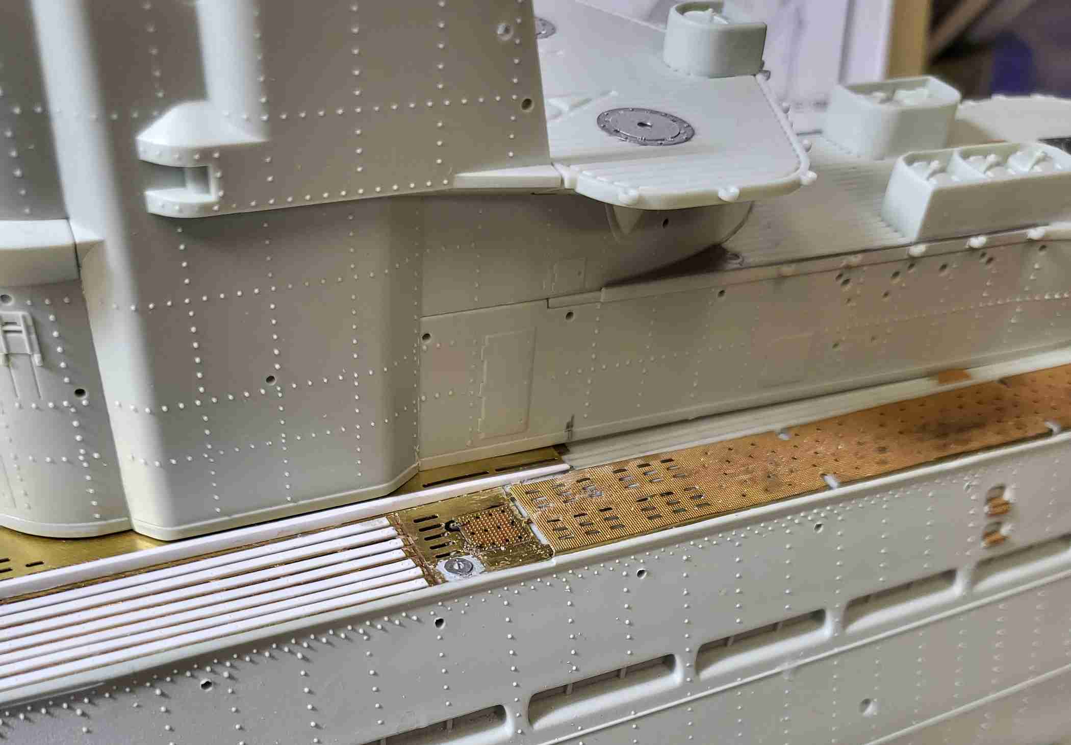

Added more hinges and all the anti-slip deck strips. These were patience testing!

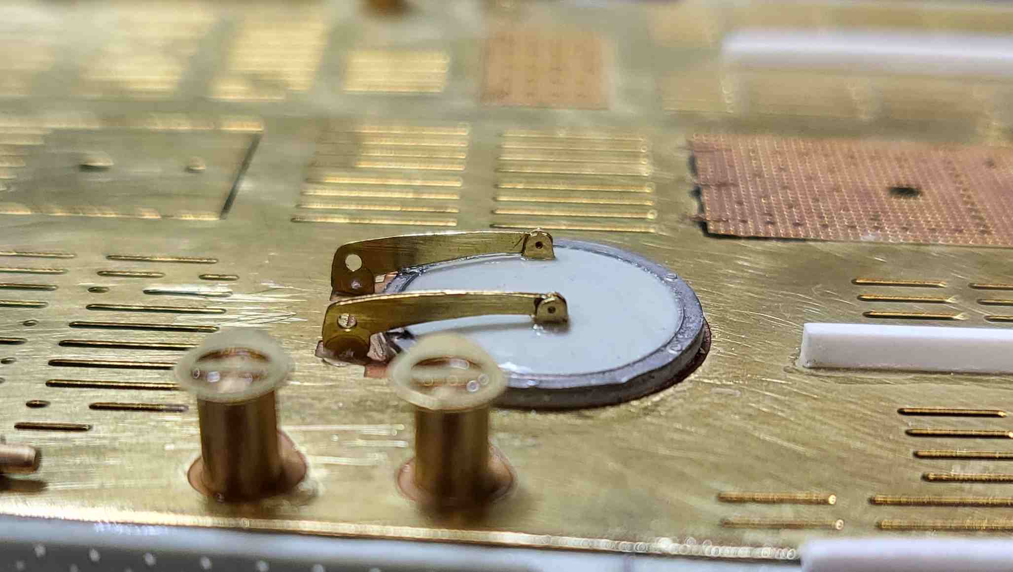

Also added the hatch arms but I am still researching the bar that fits between the arms. It seems that the hatch closer to the tower has the bar under the deck while the one near the nose has it above deck. This changes between boats as well and I have no clear photos of 505's before post war restorations. Still researching this aspect.

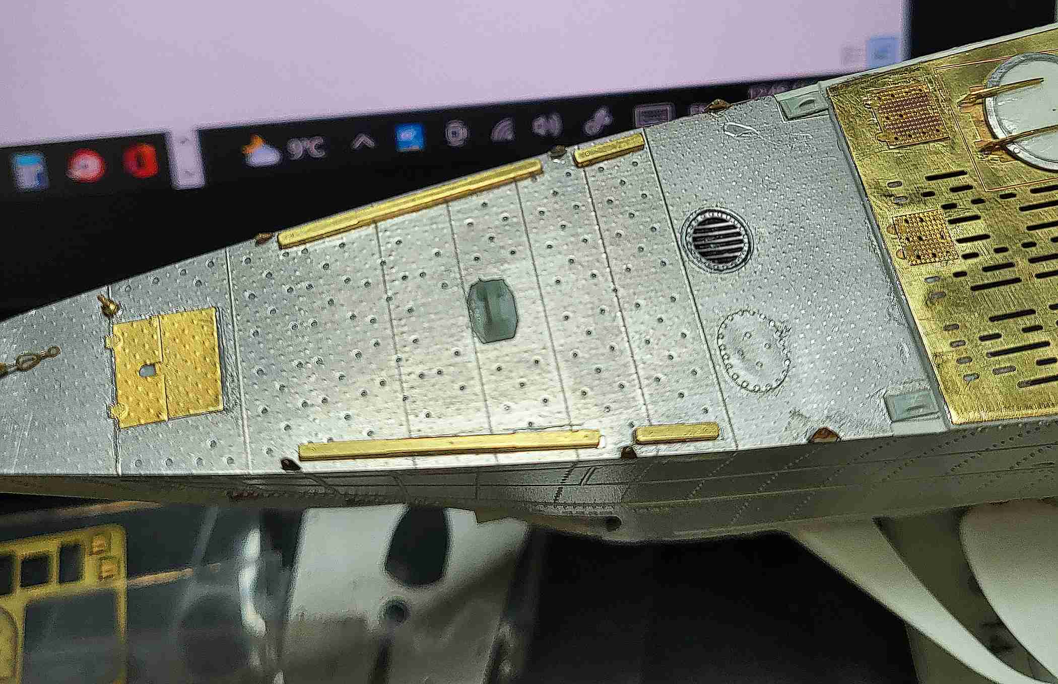

Some more PE stuff........

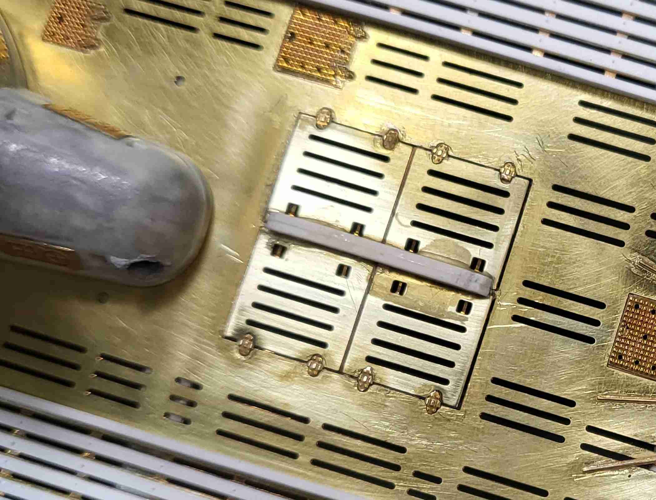

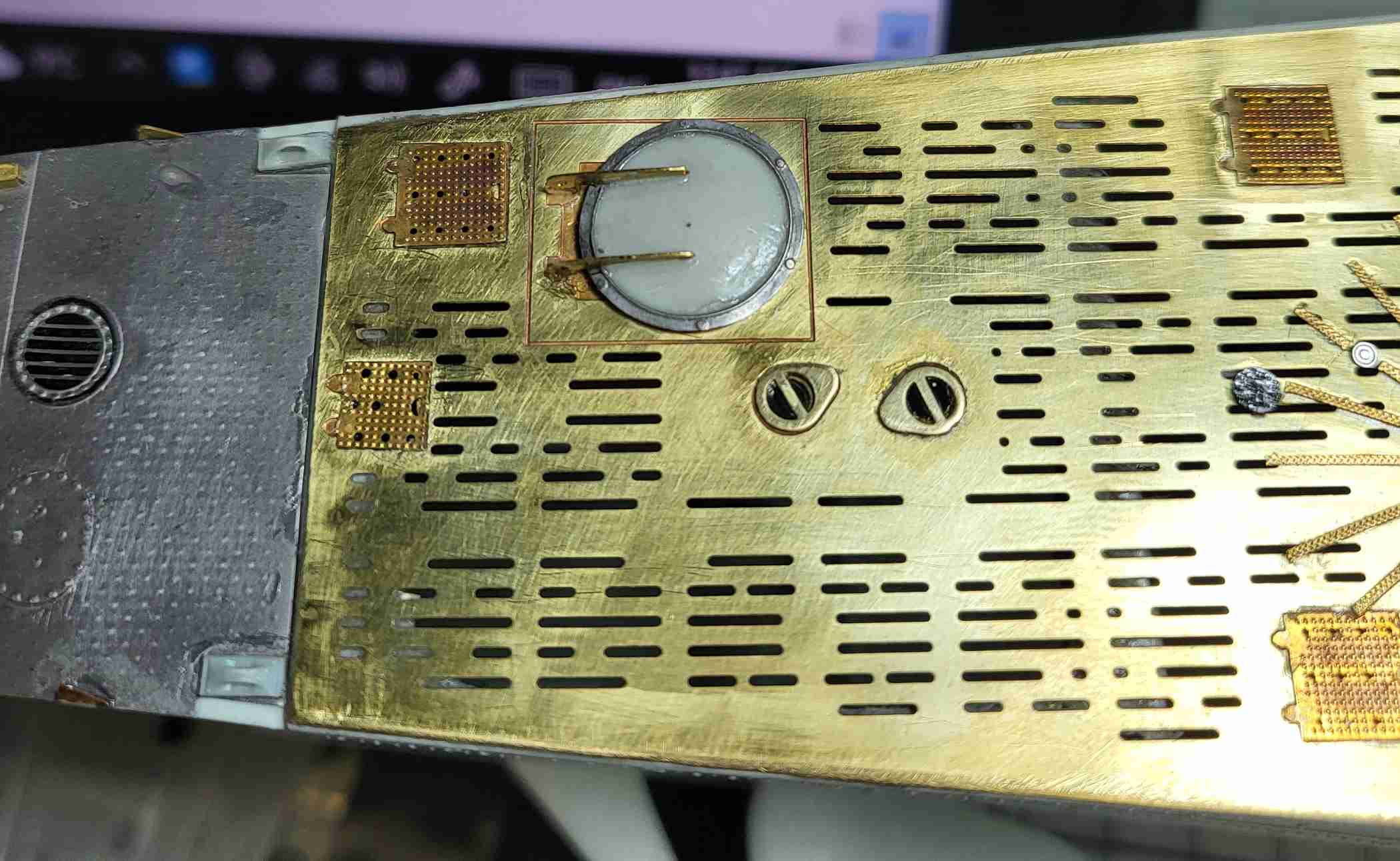

I added some strip plastic with a groove to simulate the raised edge on the center of the double doors on the deck, the bar for the forward hatch hinge(as discussed last post) and a couple of improvements. I took off the UT blanking plates I had replaced the sonar plates with earlier thinking it was a needed detail - it wasn't. The thing about this sub is that some of the details supplied in the Pontos update are there to replicate the current details of the U-505 on display in Chicago. However, this sub has had a number of post war renovations that you need to be aware of if you want to model this in the WW2 condition - so these were removed and some nice PE sonar plates used that also came with the set.

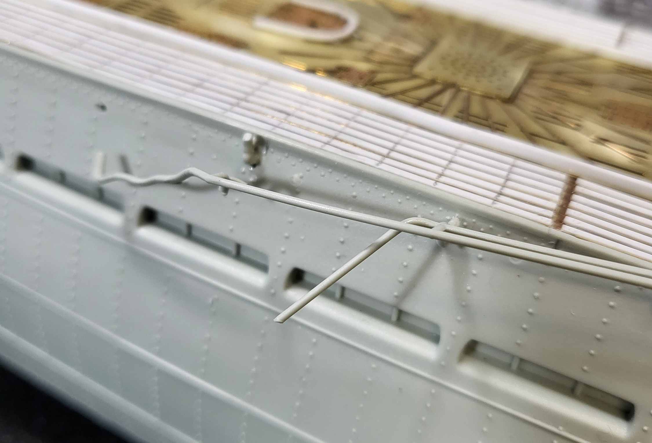

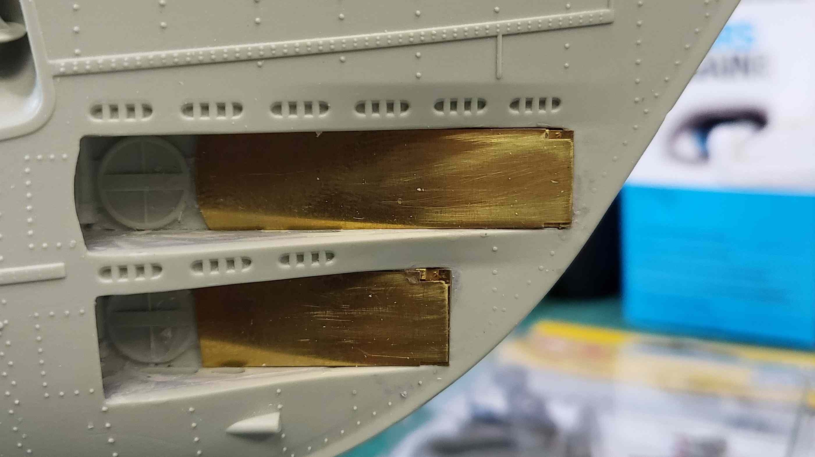

The next details was my placement of the torpedo outer doors. MP :mpupcalled me out on this earlier and he was correct, they should not be covering the round inner doors, so I moved them forward as per some photographic refs i had and should have looked at earlier.

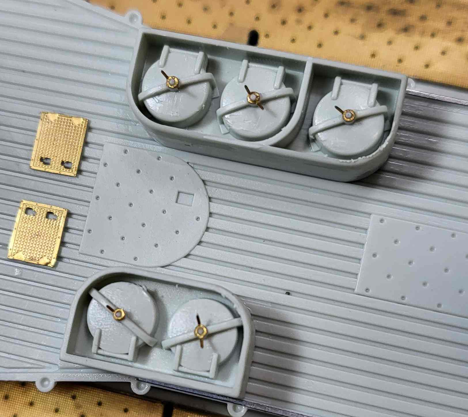

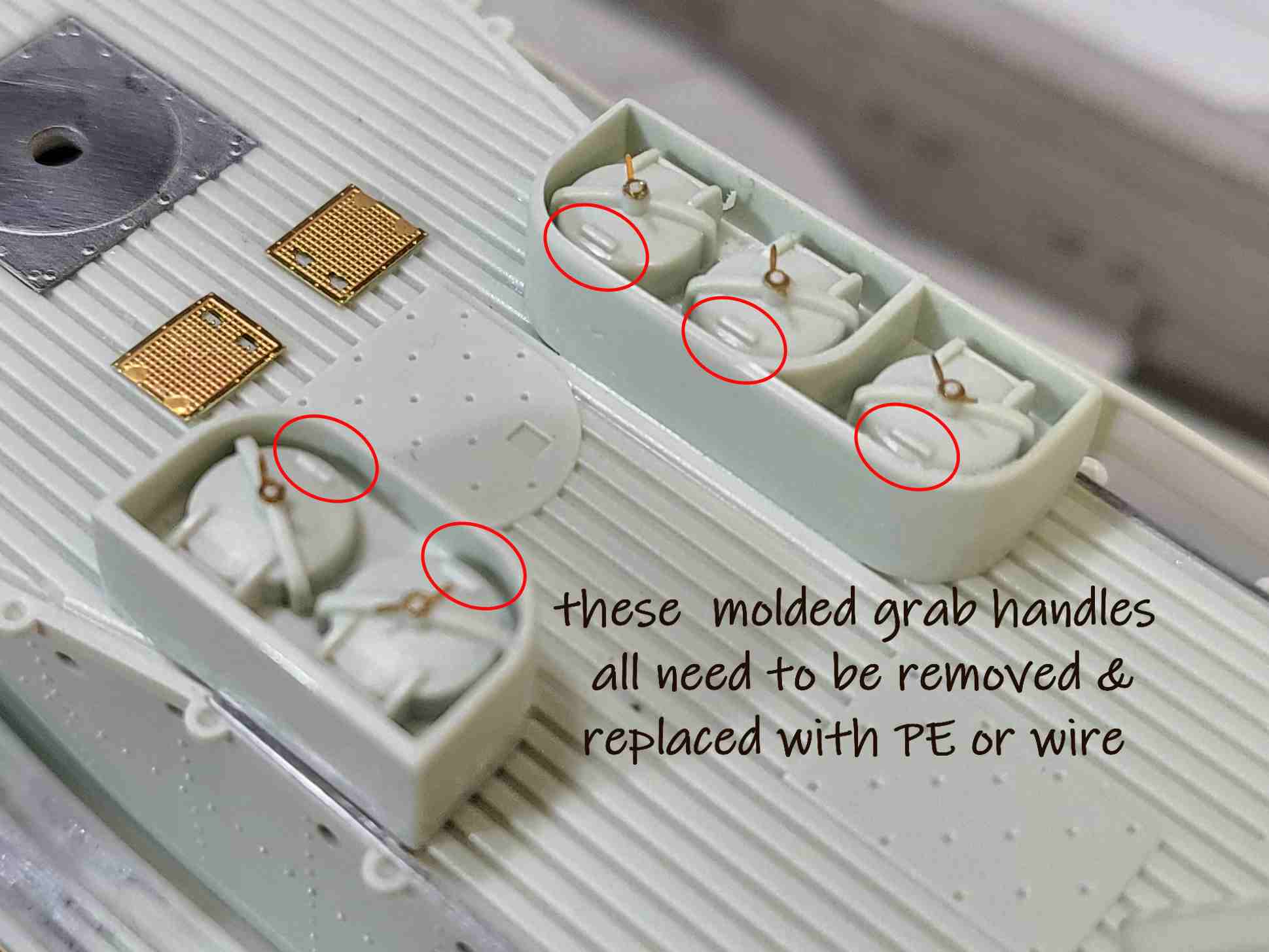

Next up is the ammo storage containers. I added the PE handles and cut off the molded lifting handles. I still need to add some home made grab handles to replace them.

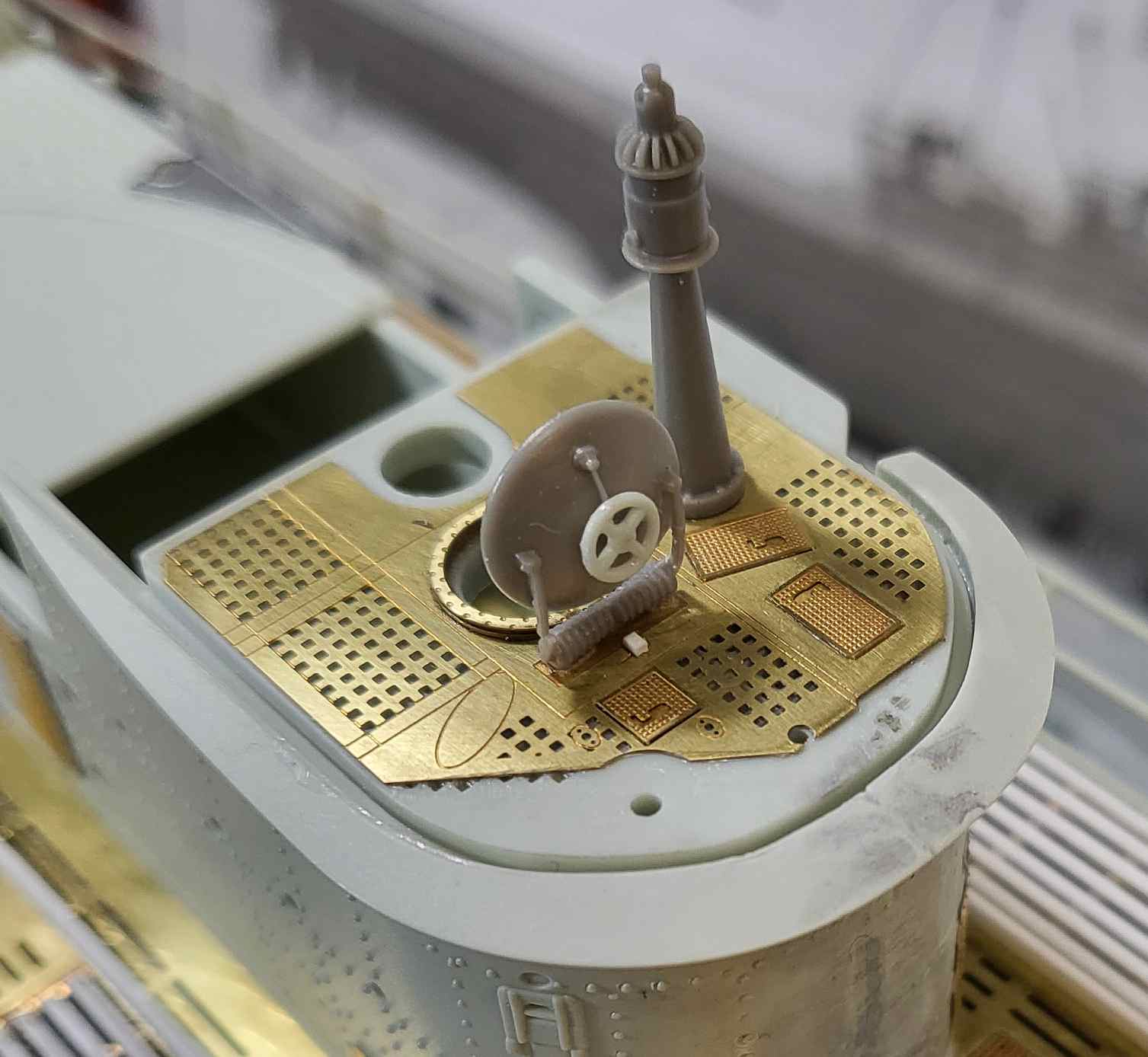

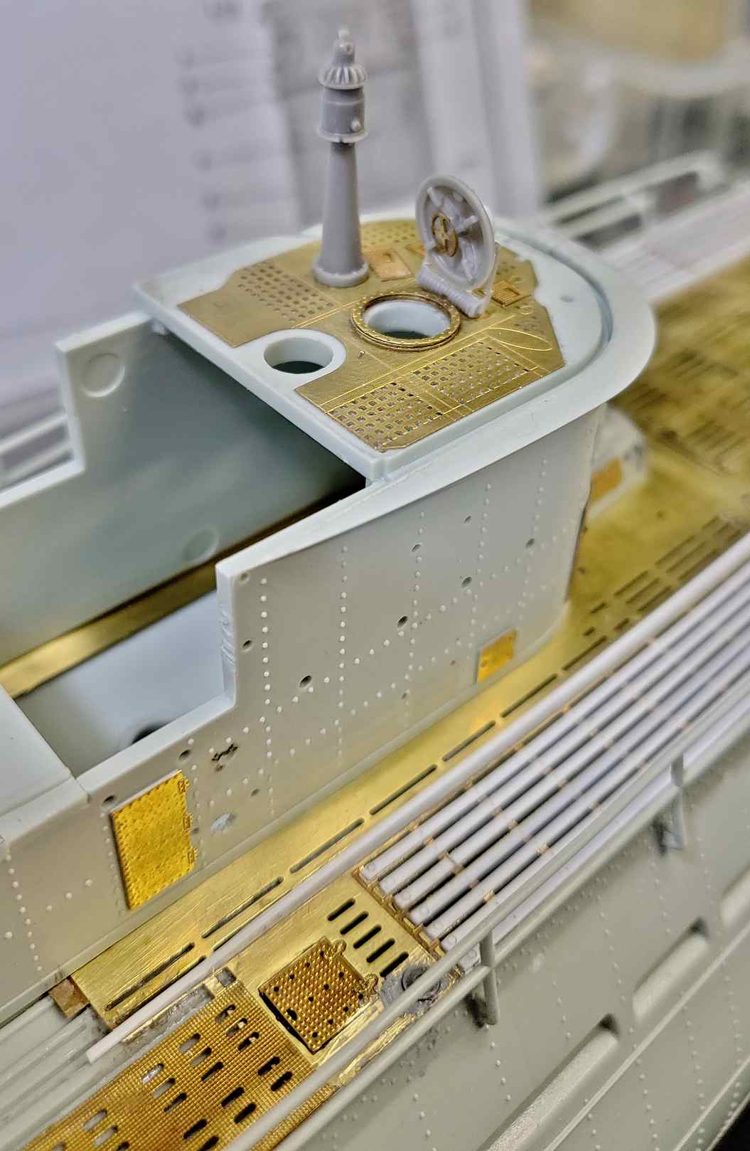

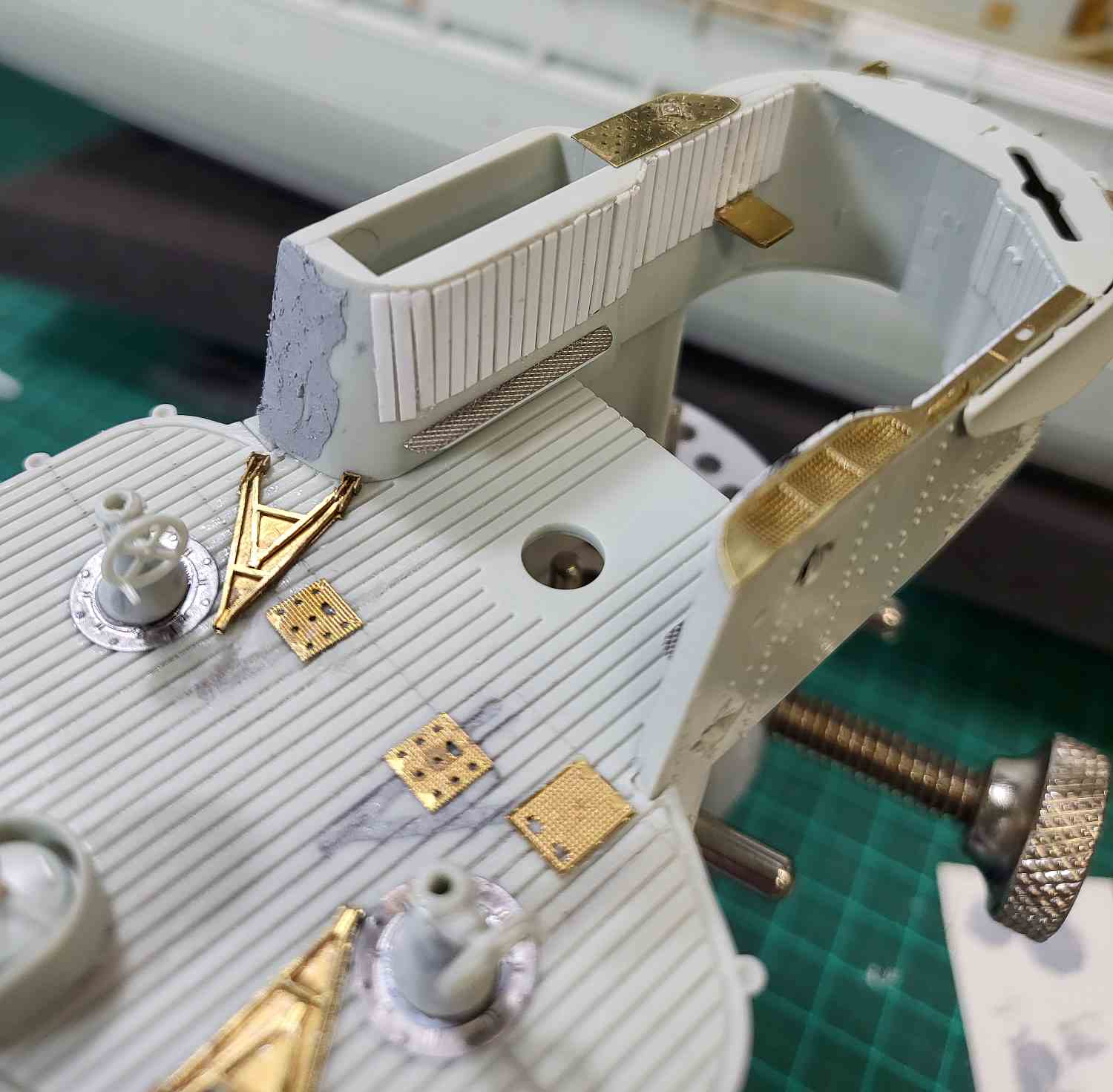

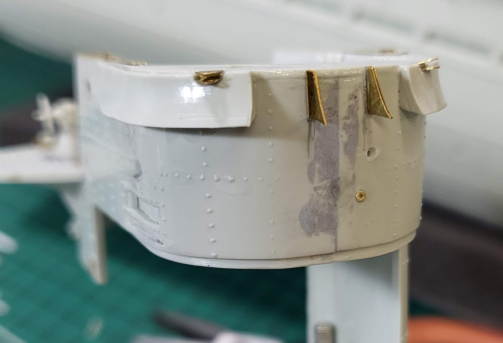

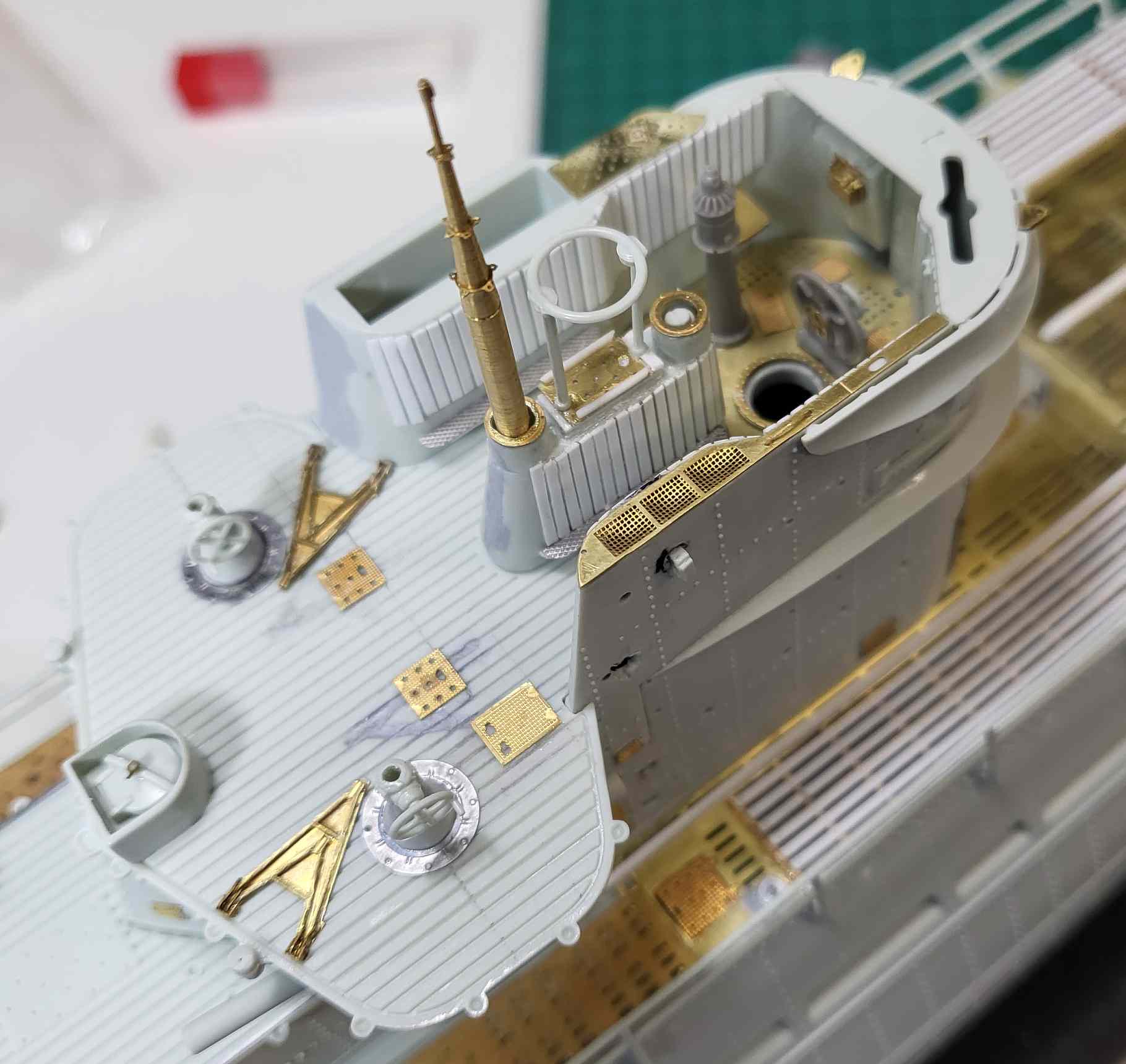

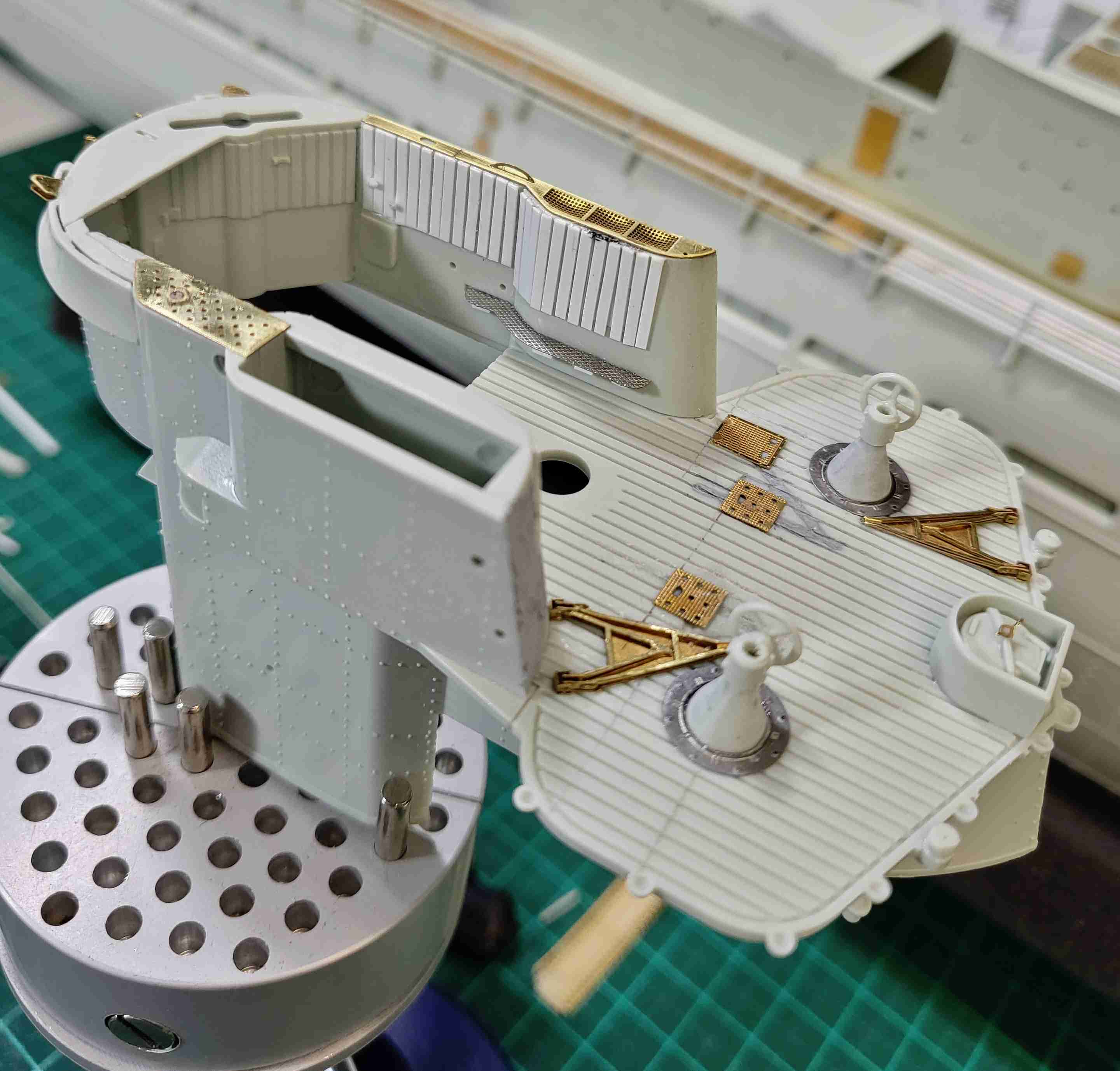

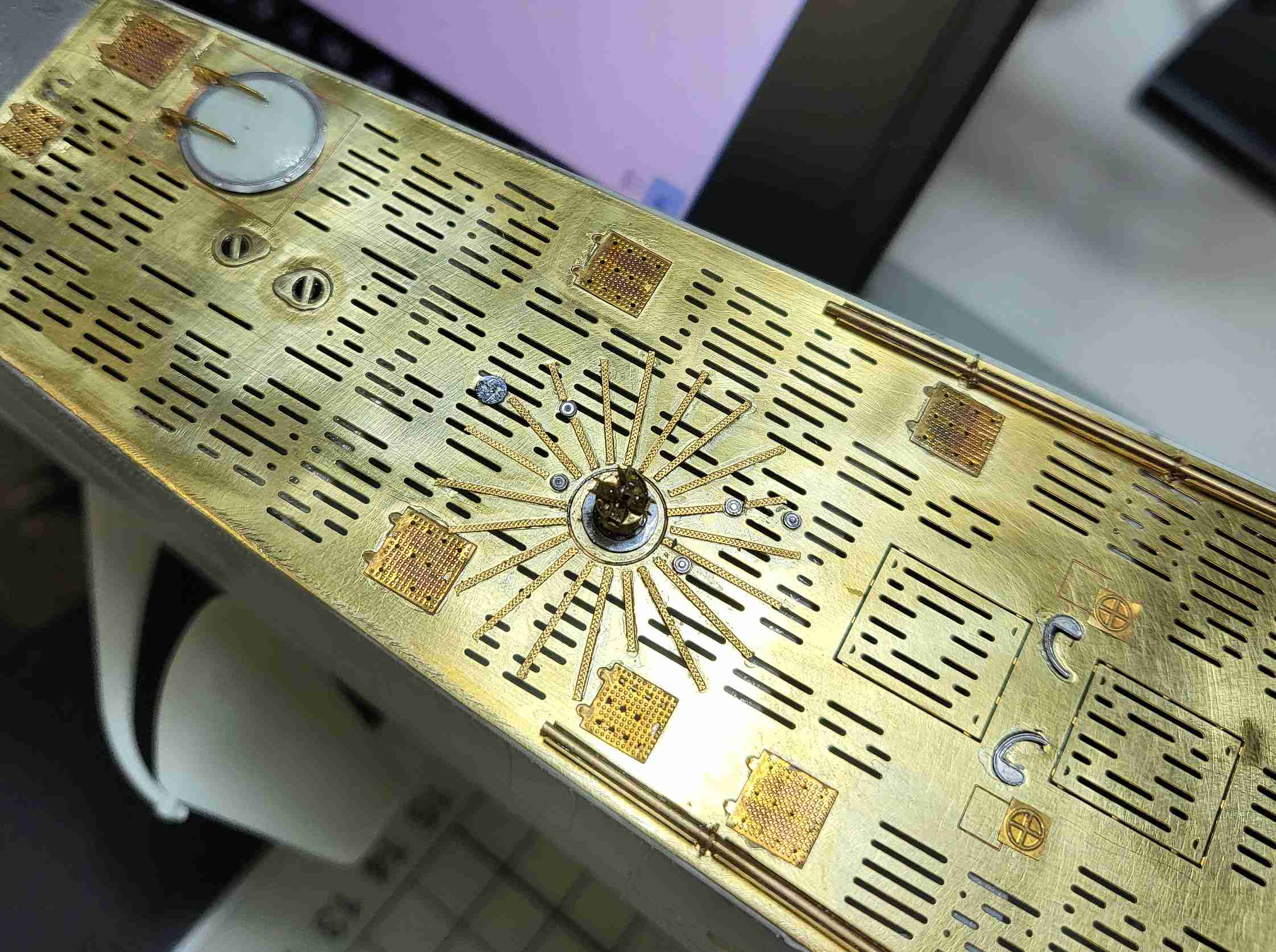

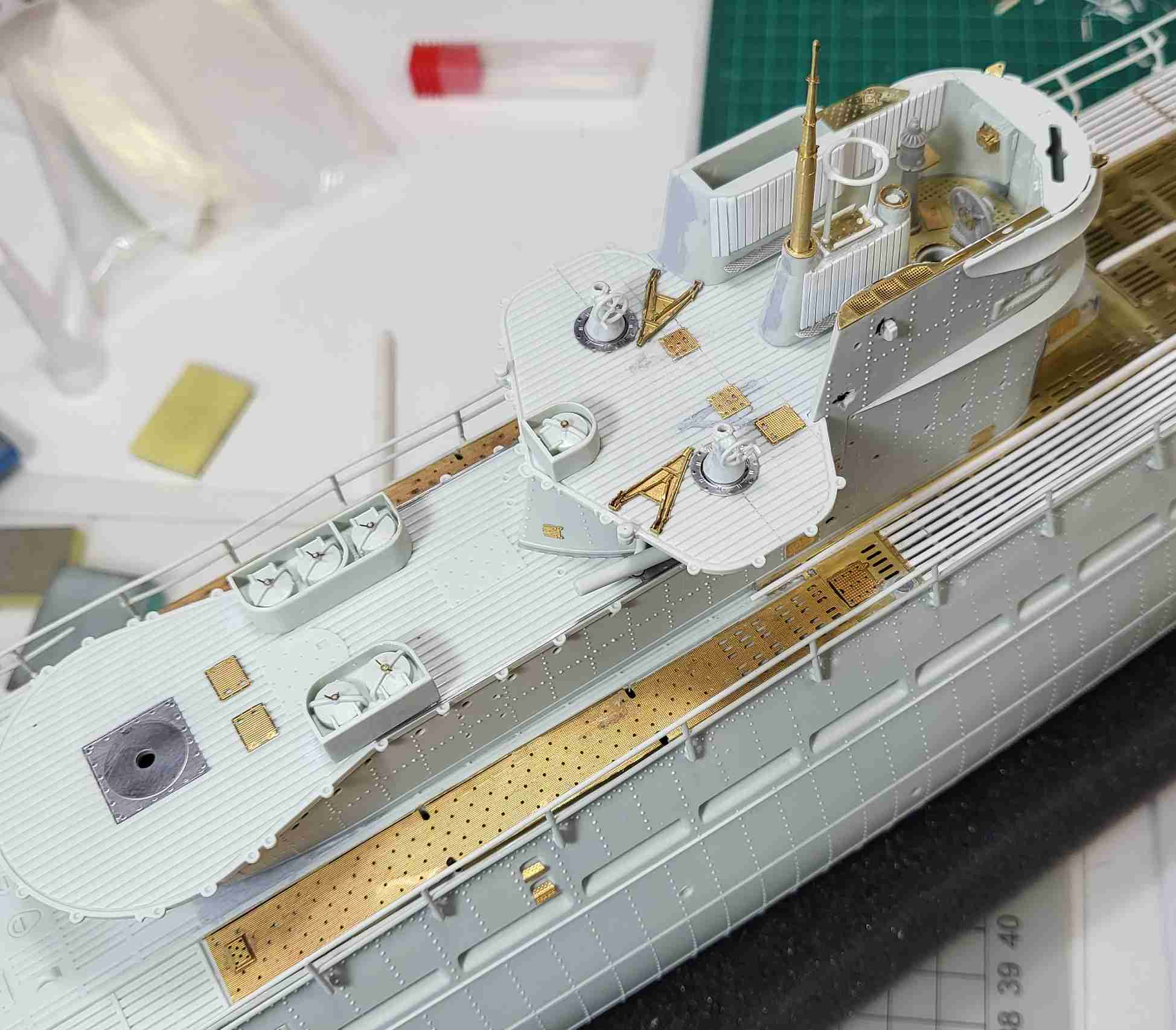

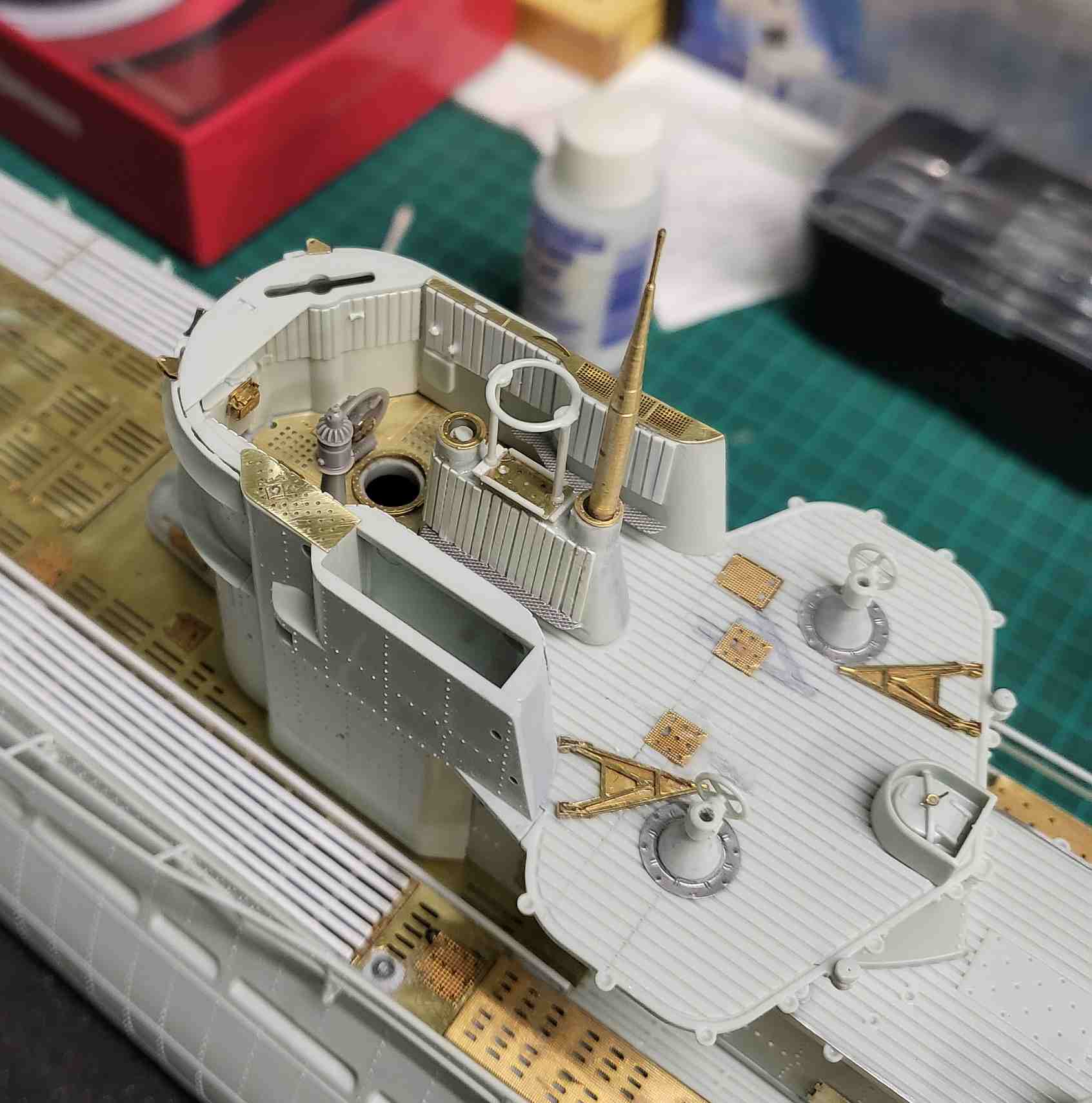

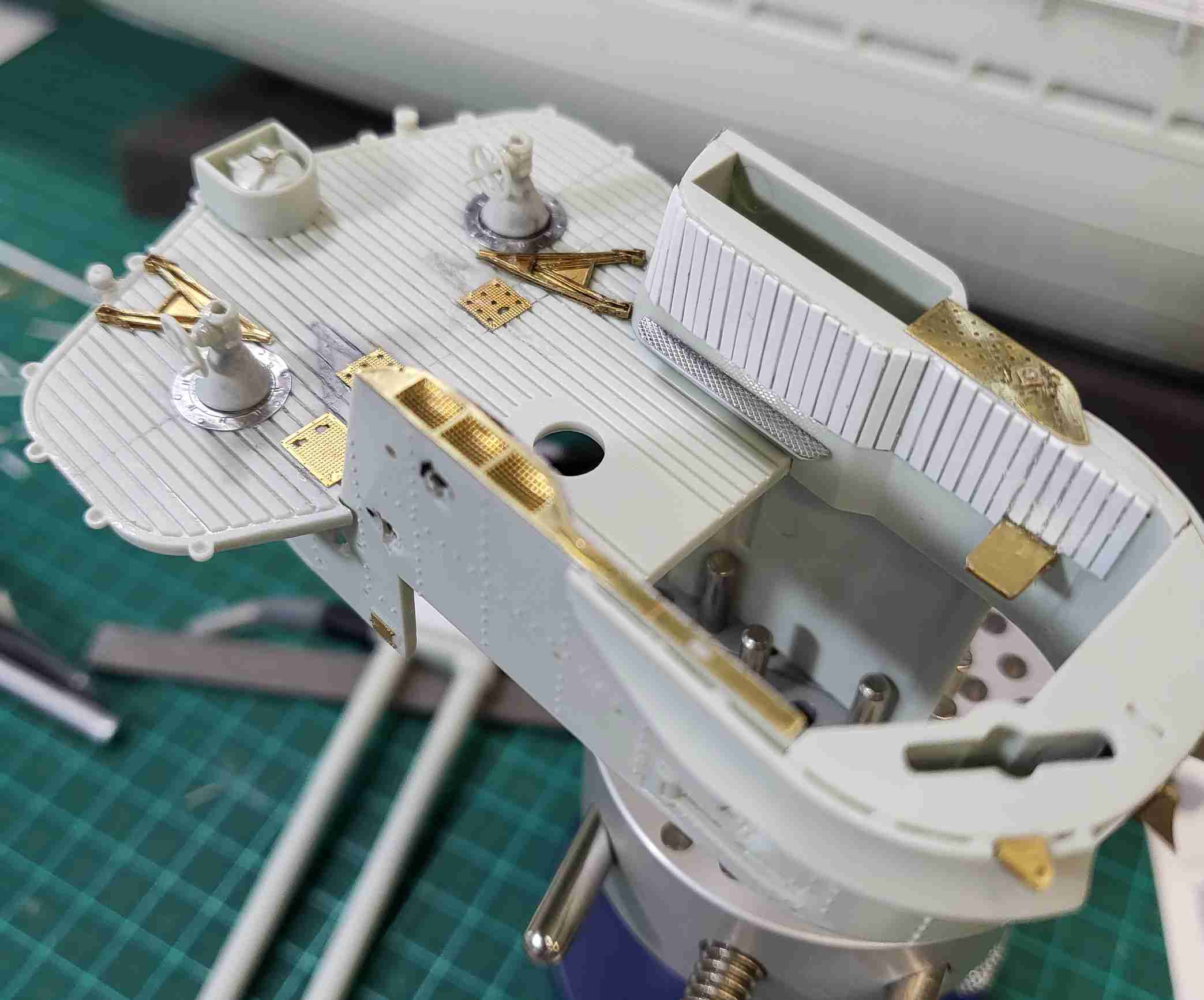

Some more work on the tower starting with the lower section were there was more PE and some nice little update parts from the CMK Special Navy 9C set - resin hatch and Binocular stand/ range finder(I think). Damage also being added.
Upper tower stuff
20220710_170033.jpg20220710_170121.jpg20220710_170130.jpg20220710_170047.jpg20220710_193044.jpg20220711_232953.jpg
Finally railing damage as per photos and recorded info.......
The railing on the other side is also damaged with the first 5 forward uprights missing.

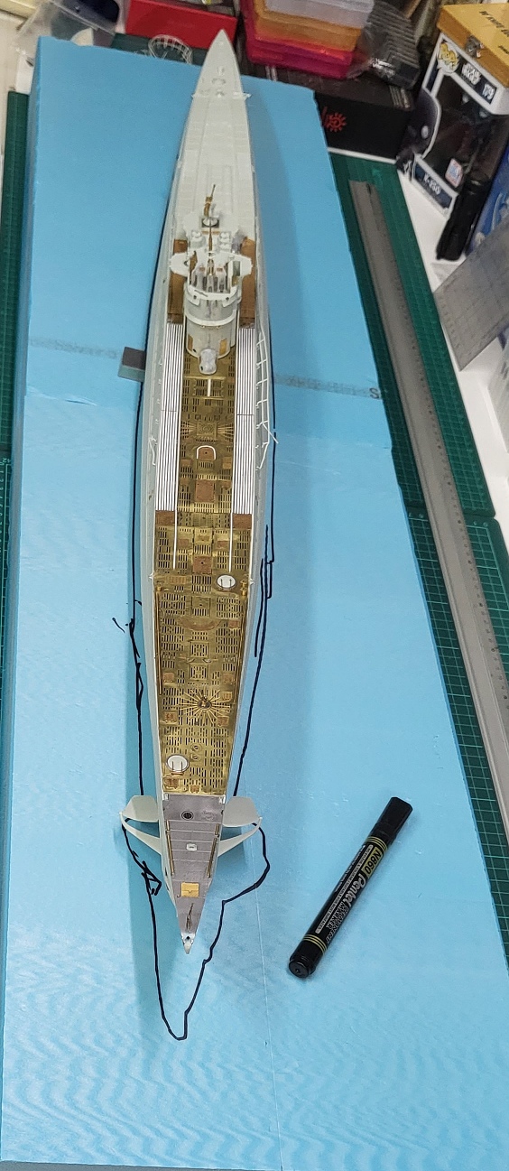

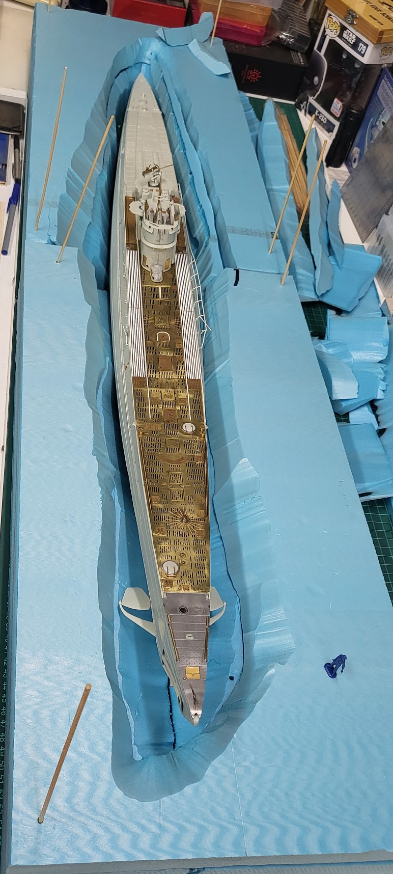

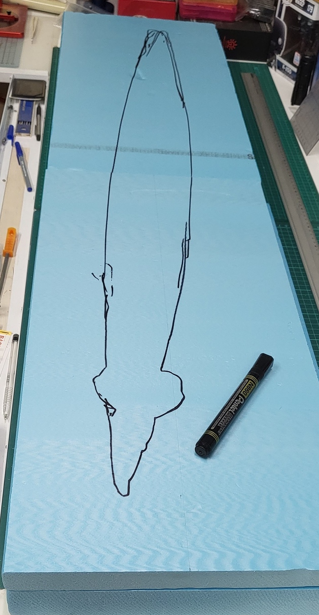

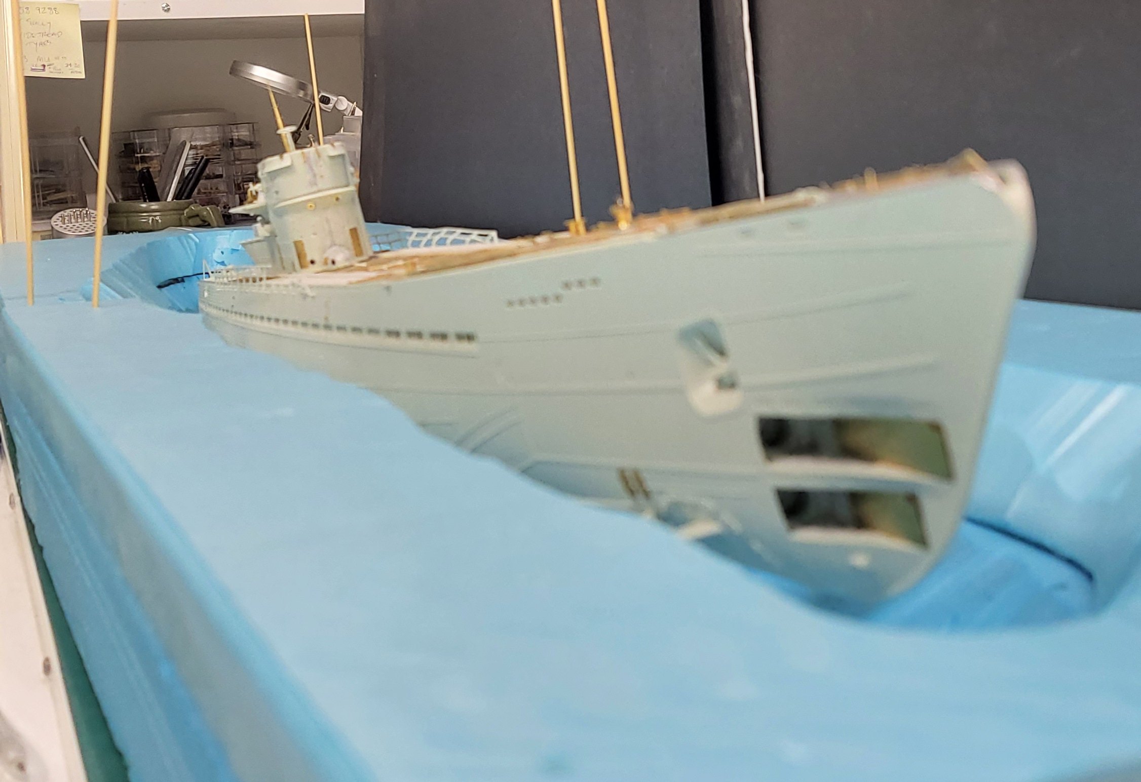

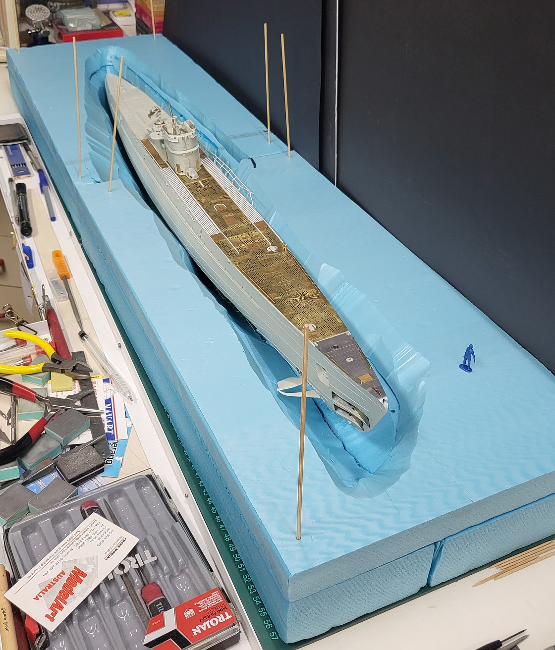

Started work on the foam base.............the sub still needs more work on the Conning Tower gun platforms.
I am using toothpicks and wooden meat skewers to keep the foam in place. I will need to do more trimming to get the sub to sit lower enough and to transition the 'depth to flat ocean' to be more gradual. I will probably end up cutting the foam layers in half to get better access to the depth gradient, as my hand held hot wire loop isn't wide enough to deal with any more than what I have completed to this point.
