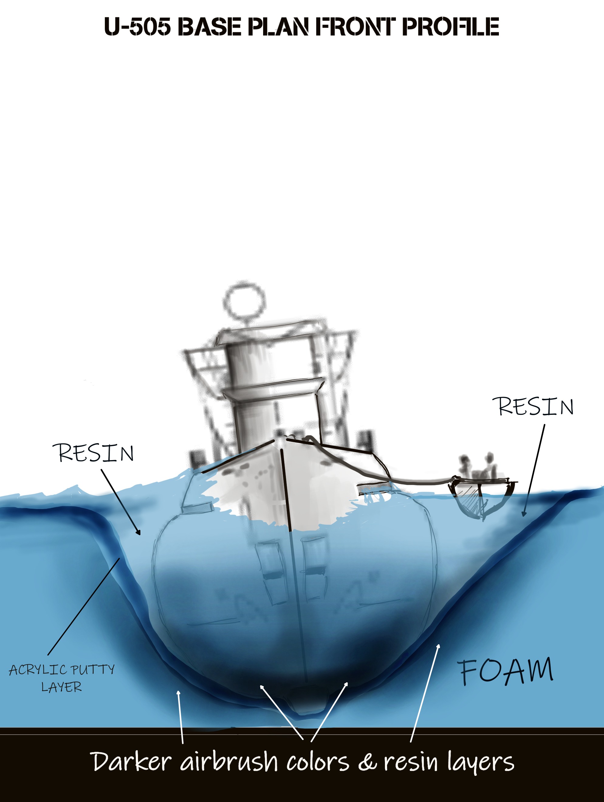

THE DIORAMA/ MODEL
The main photo is just what a diorama maker is looking for in submarine modelling, with the drama and detail all there.

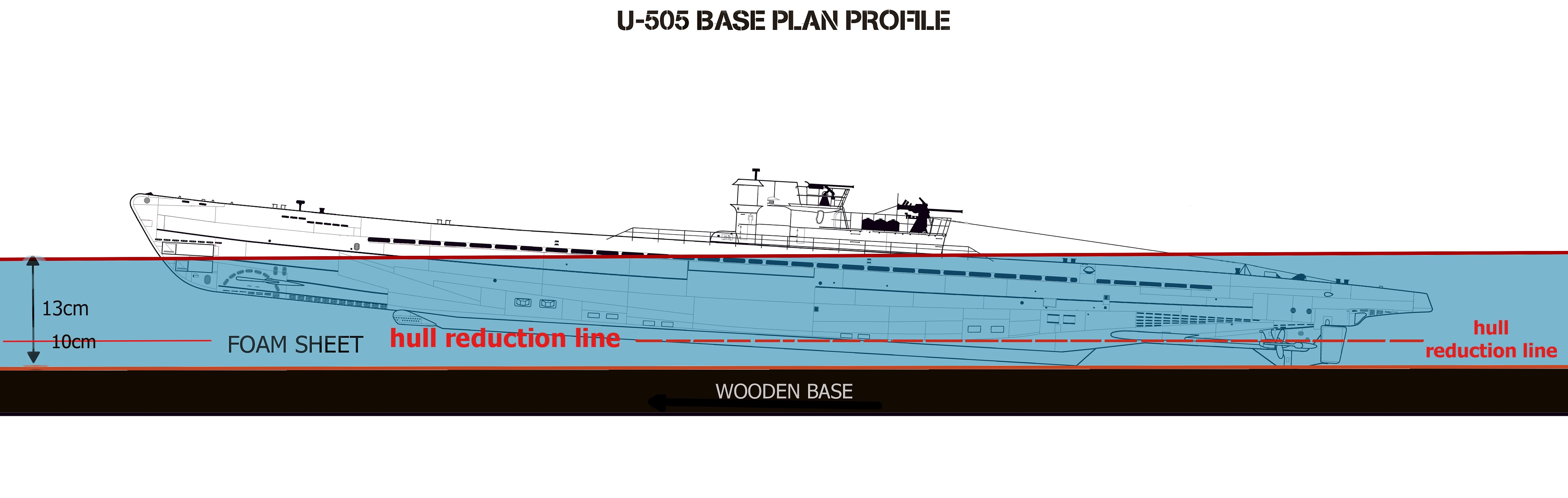

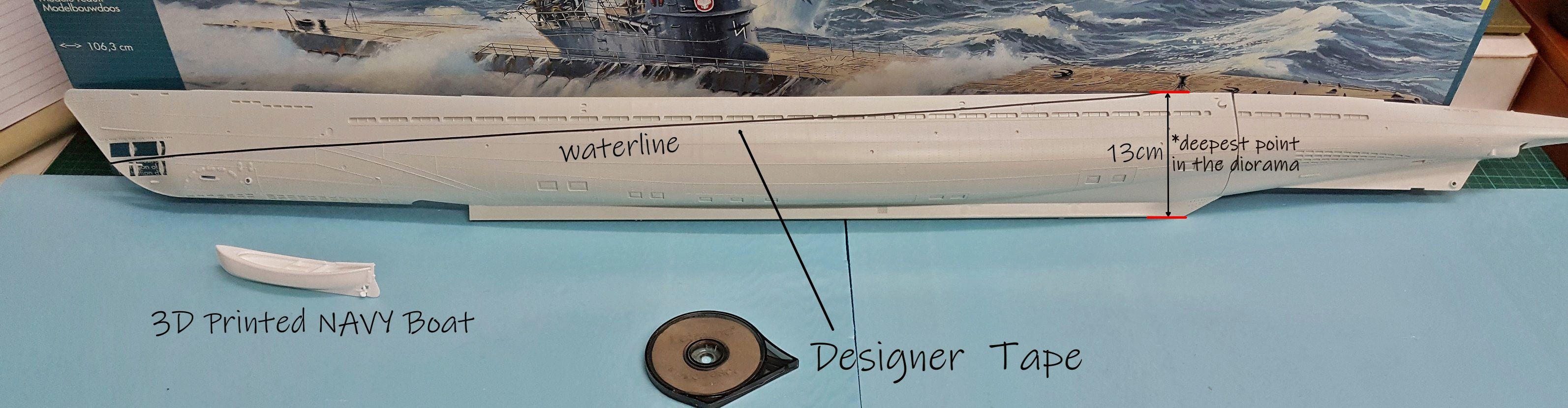

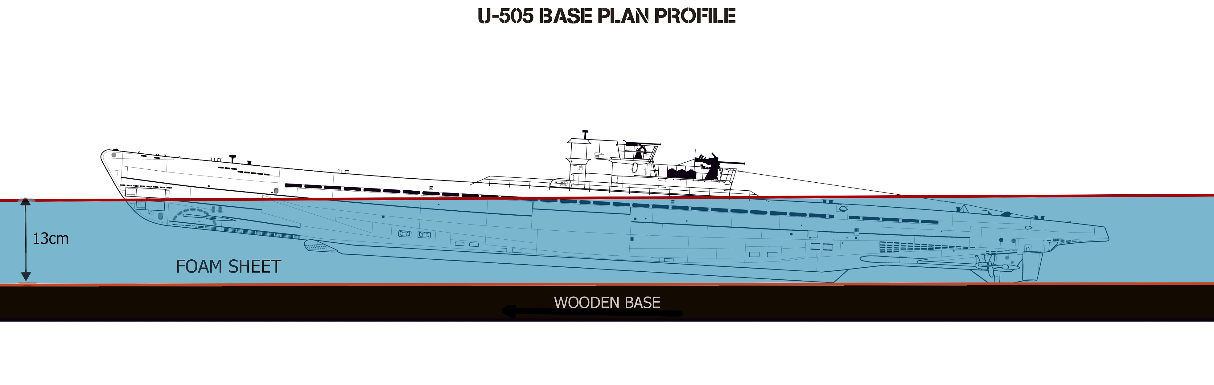

The real challenge for this one will be creating an ocean surface with semi transparent areas close to the hull and blending these with the deeper ocean with no depth, further out.
Of course the late, great diorama modeler, Lewis Pruneau' modeled this exact scene in 1/35 scale back in the day and it has always been a favourite classic dio for me. It was his diorama that inspired me to create my own Type 7C/41 dio in 1/72 scale (the Last Patrol), some 10 years ago now. So in a way, I suppose this will be a kind of tribute to him, from me, for the great models he created and inspired in others.
Please follow and enjoy the build from here' as I will be incorporating lessons learned in my earlier diorama' while incorporating some new ideas that I have formulated since then. There is also a 'ton' of PE and figures that are available now that did not exist 10 years ago.......as well as the kit itself.
I will be using the following :

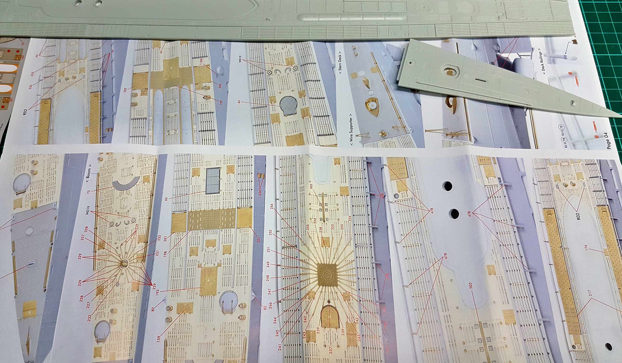

  • Pontos 9C upgrade set
  • CMK US Navy figure sets
  • Shapeways 3D printed USN surf boat

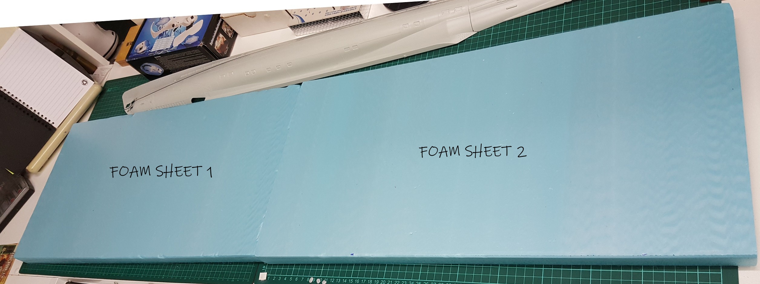

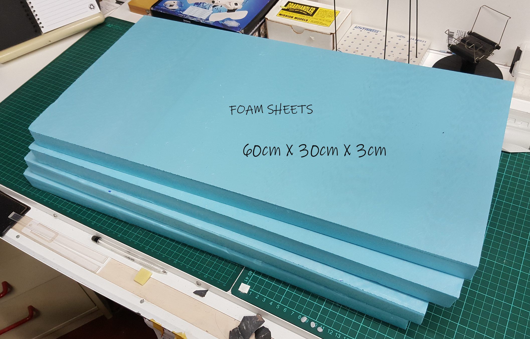

  • Blue foam sheets (30cm x 60cm x 3cm, 30cm x 60cm x 5cm)
  • Various new water products from AK.
  • Correct tower and water line decal sets from AMP.
