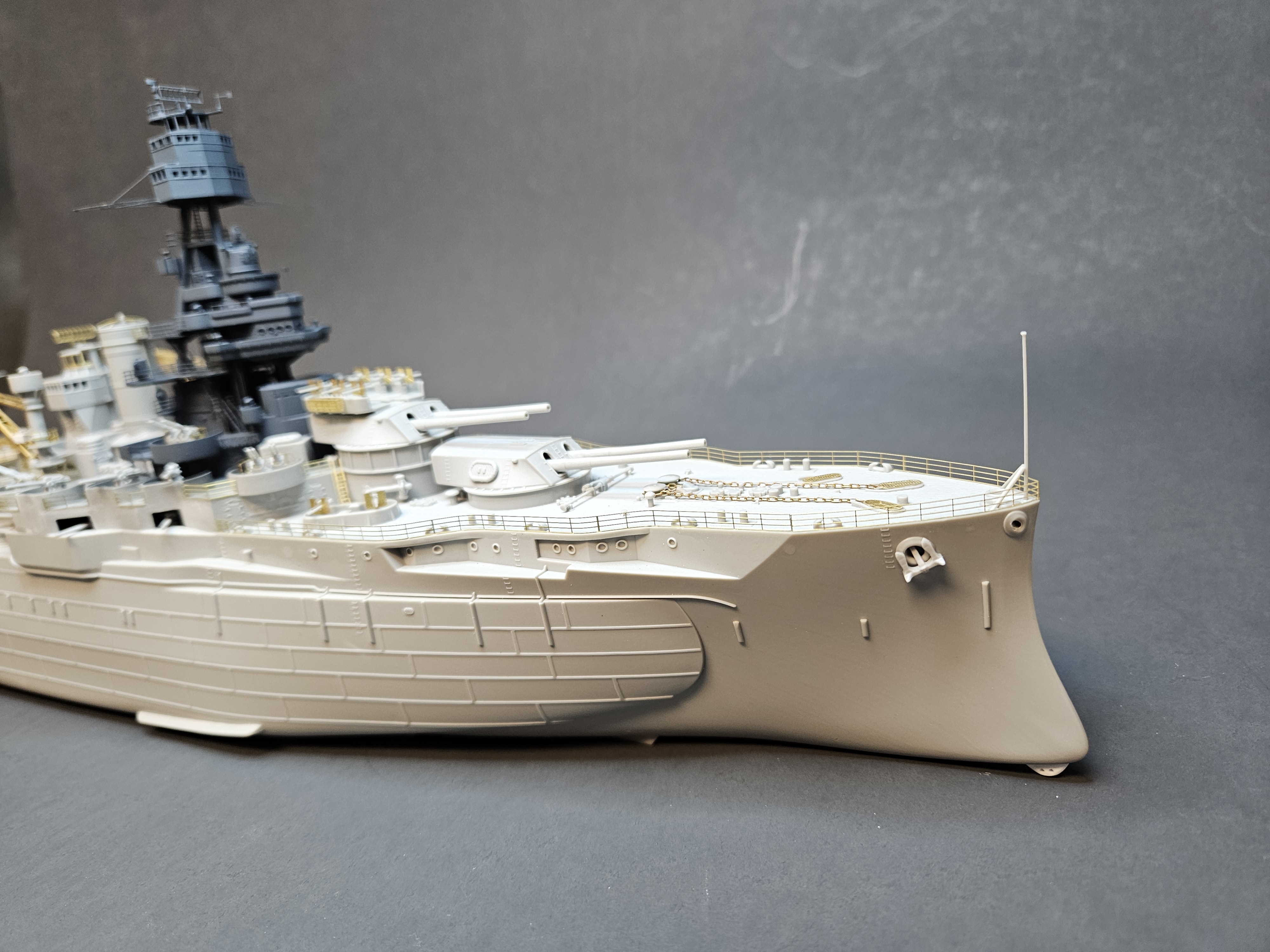

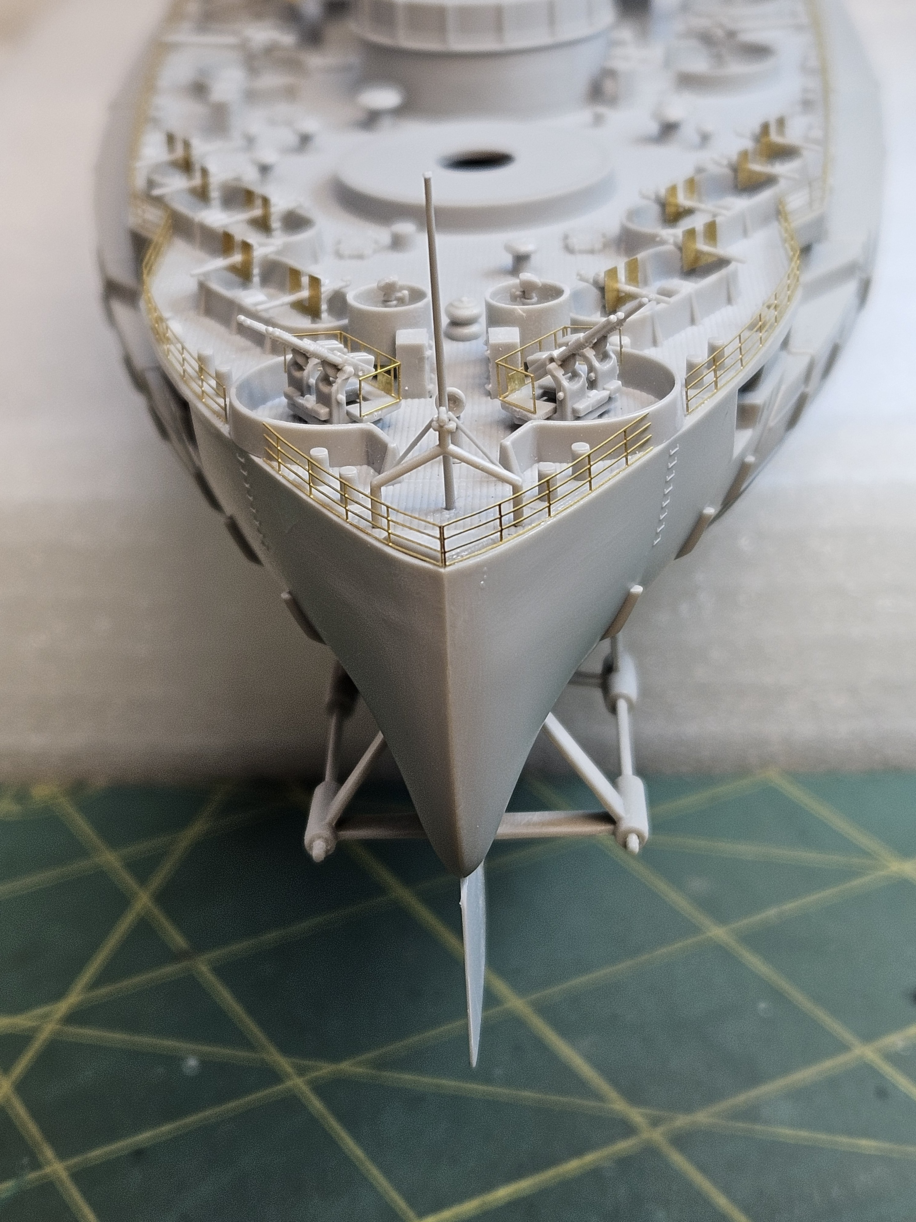

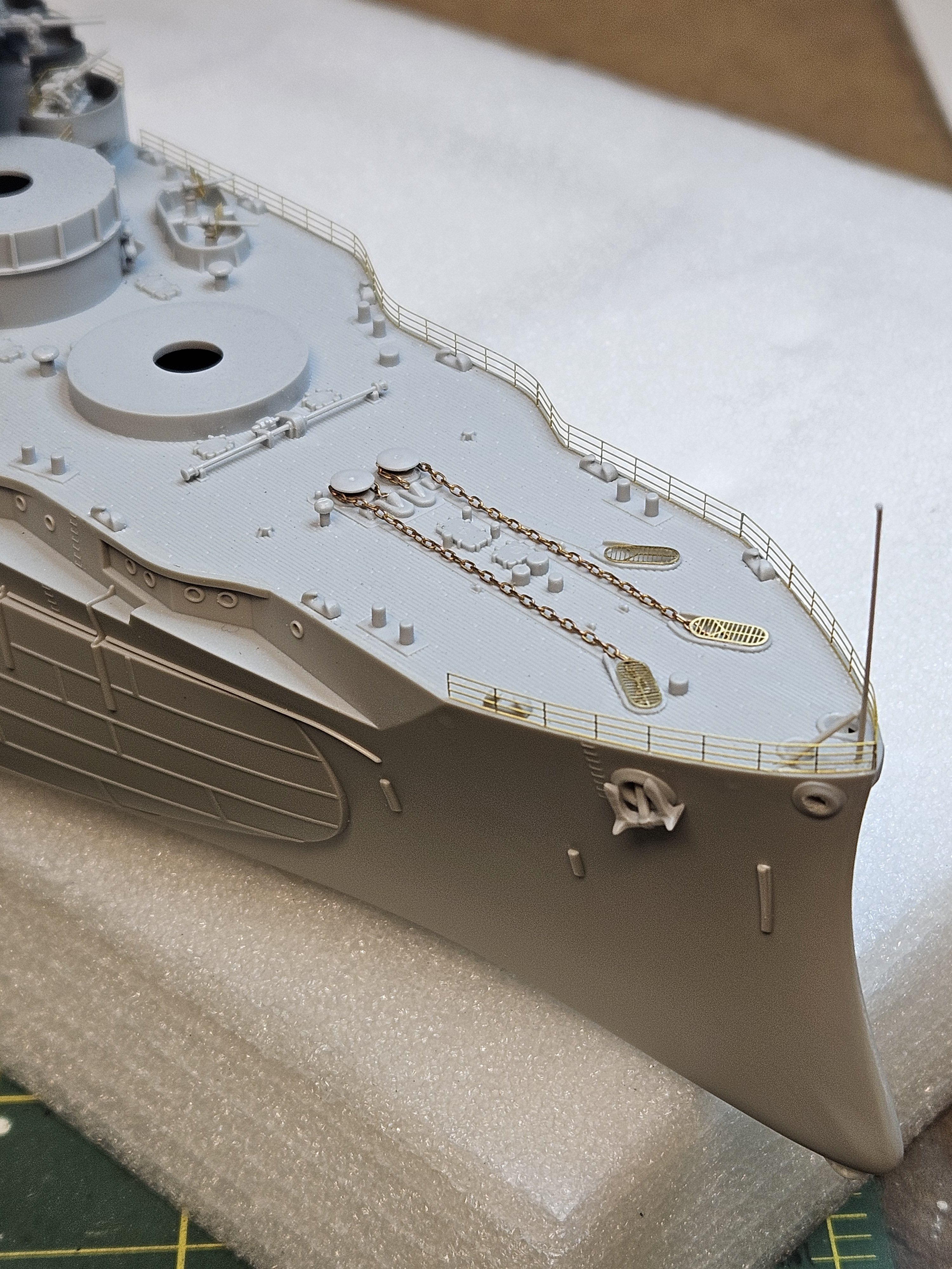

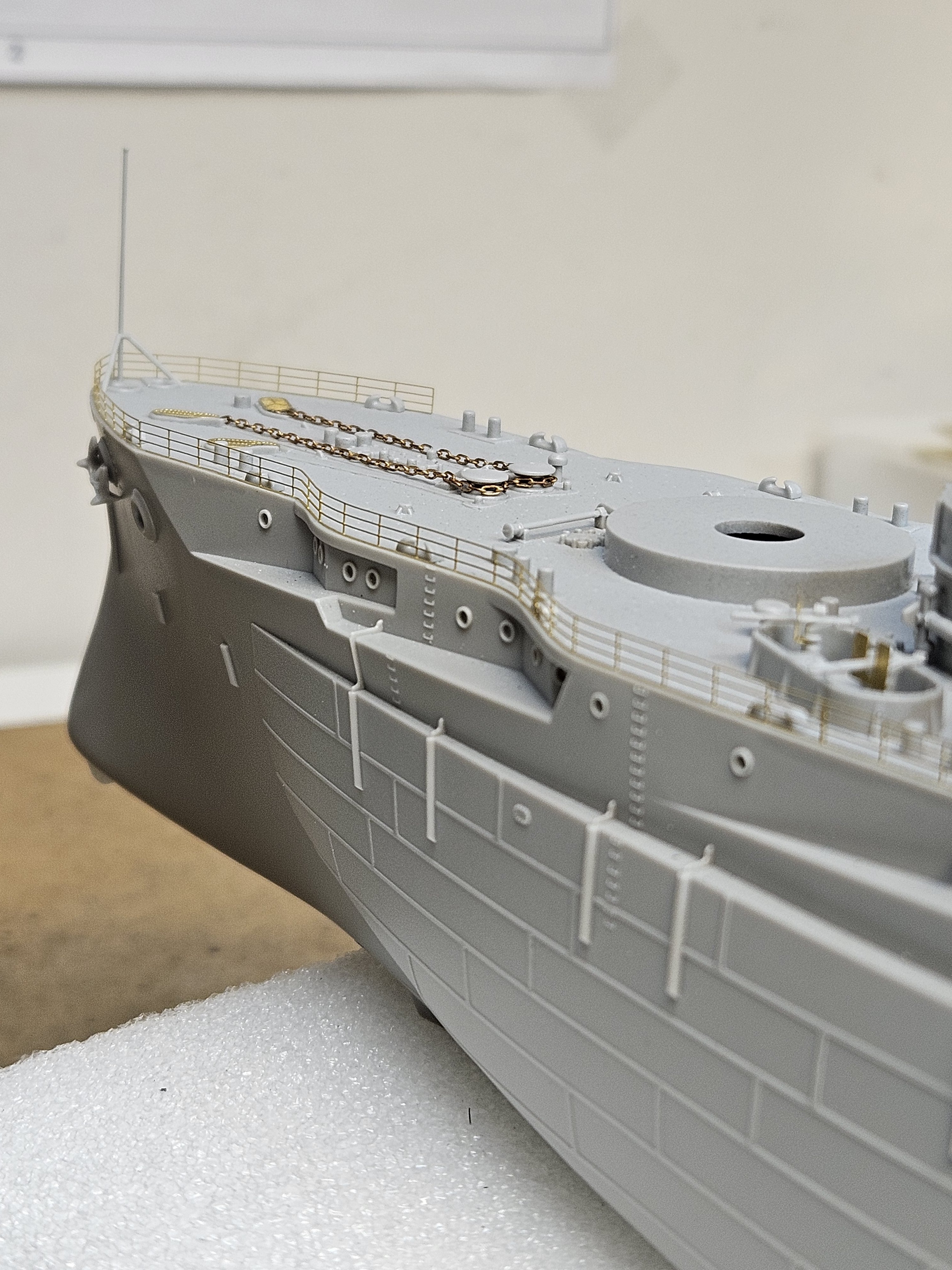

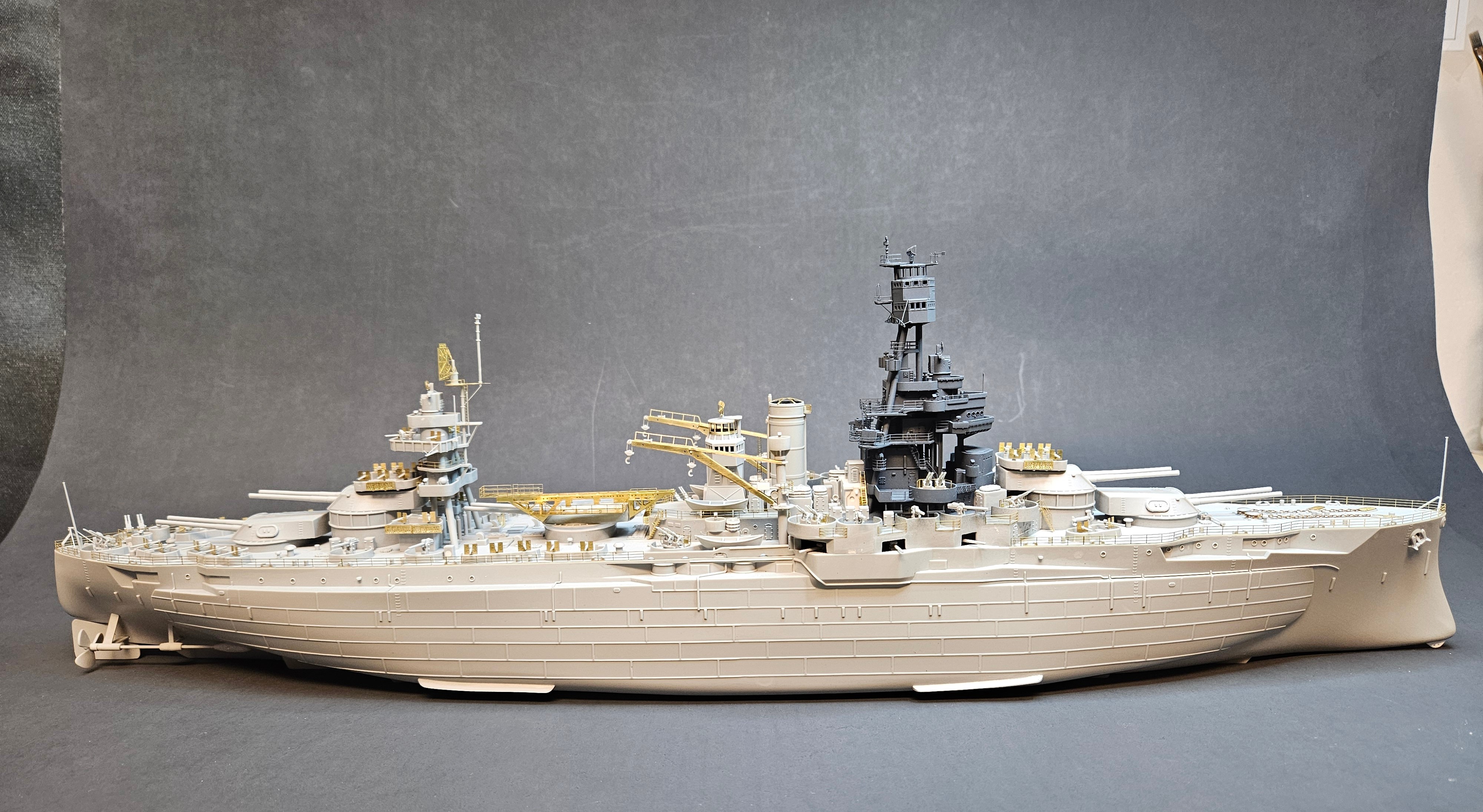

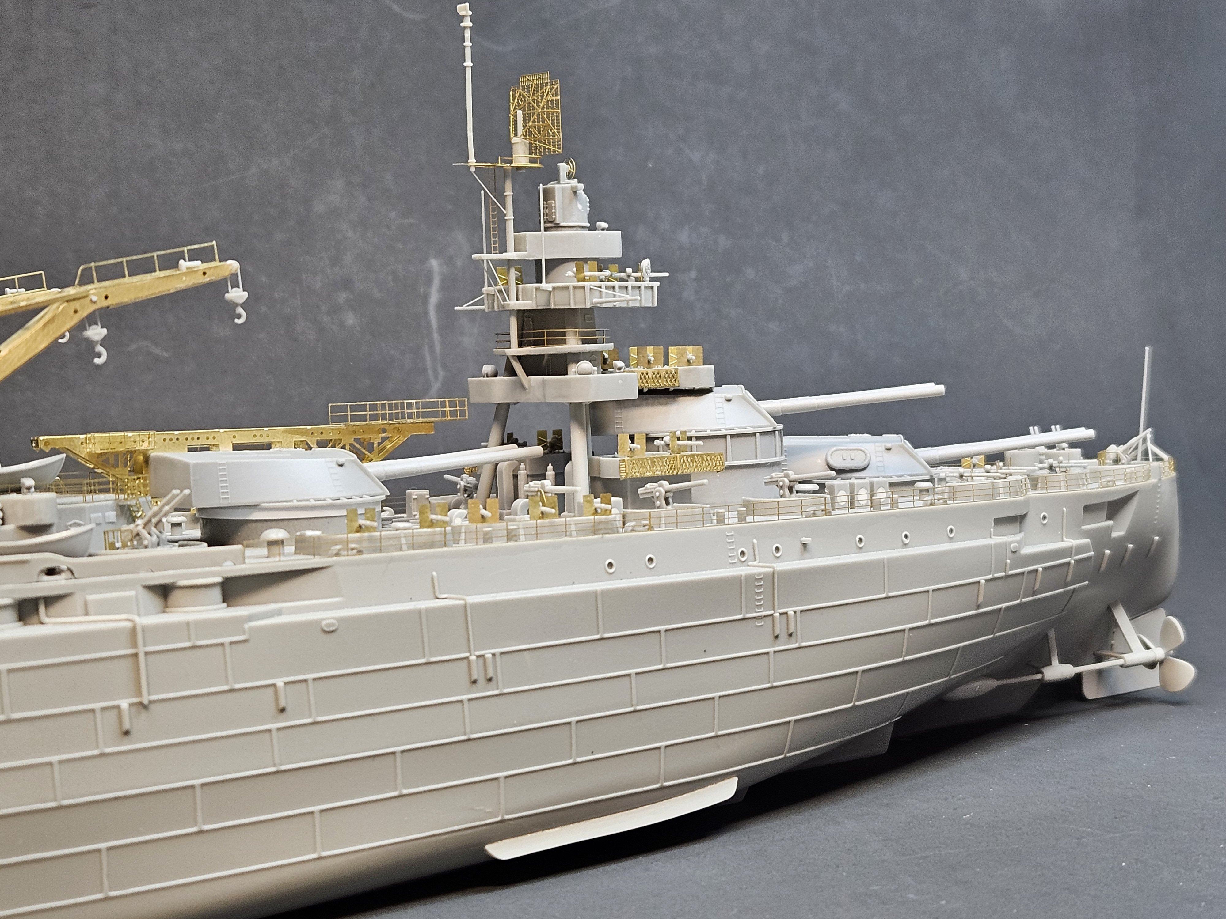

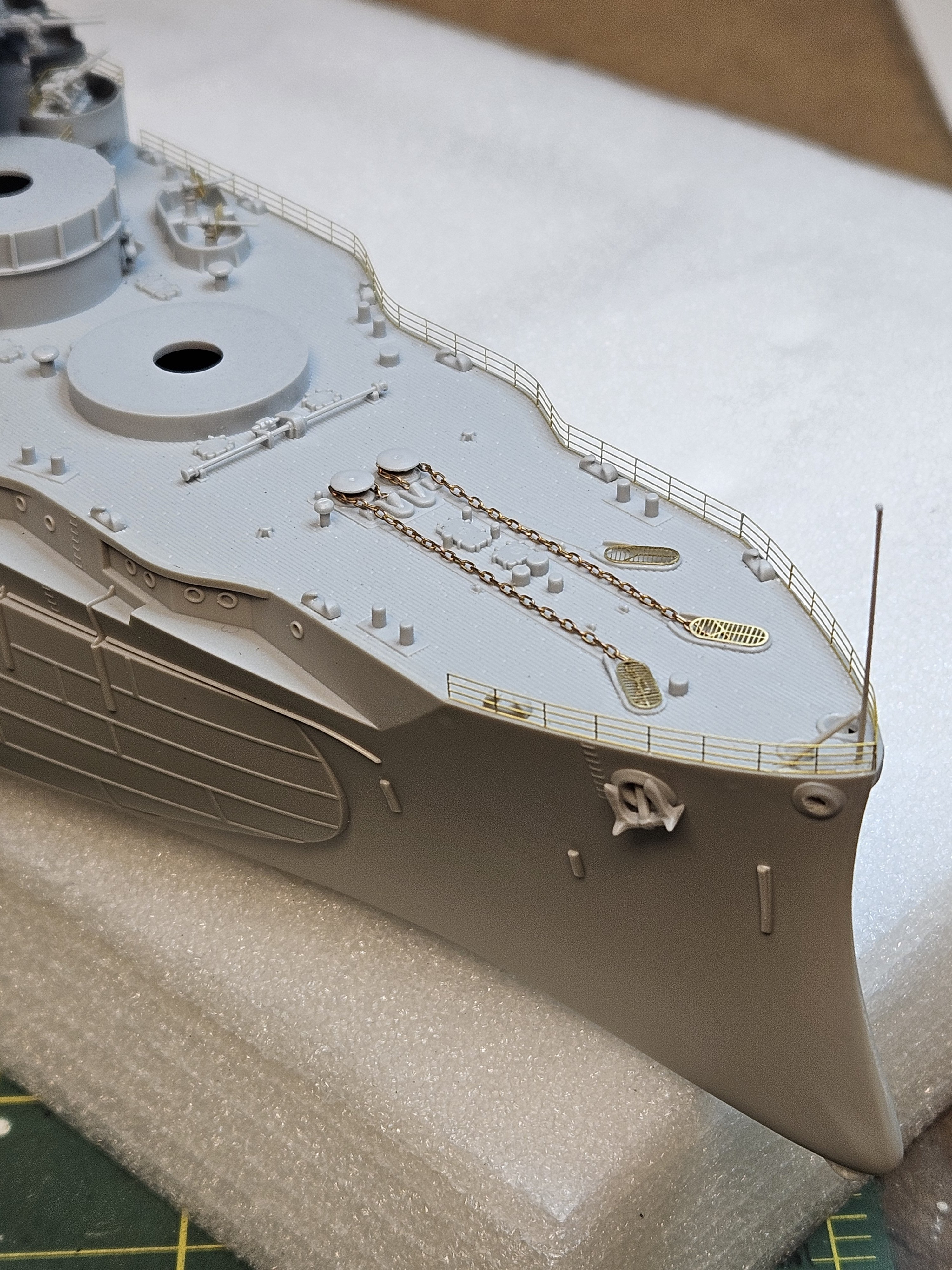

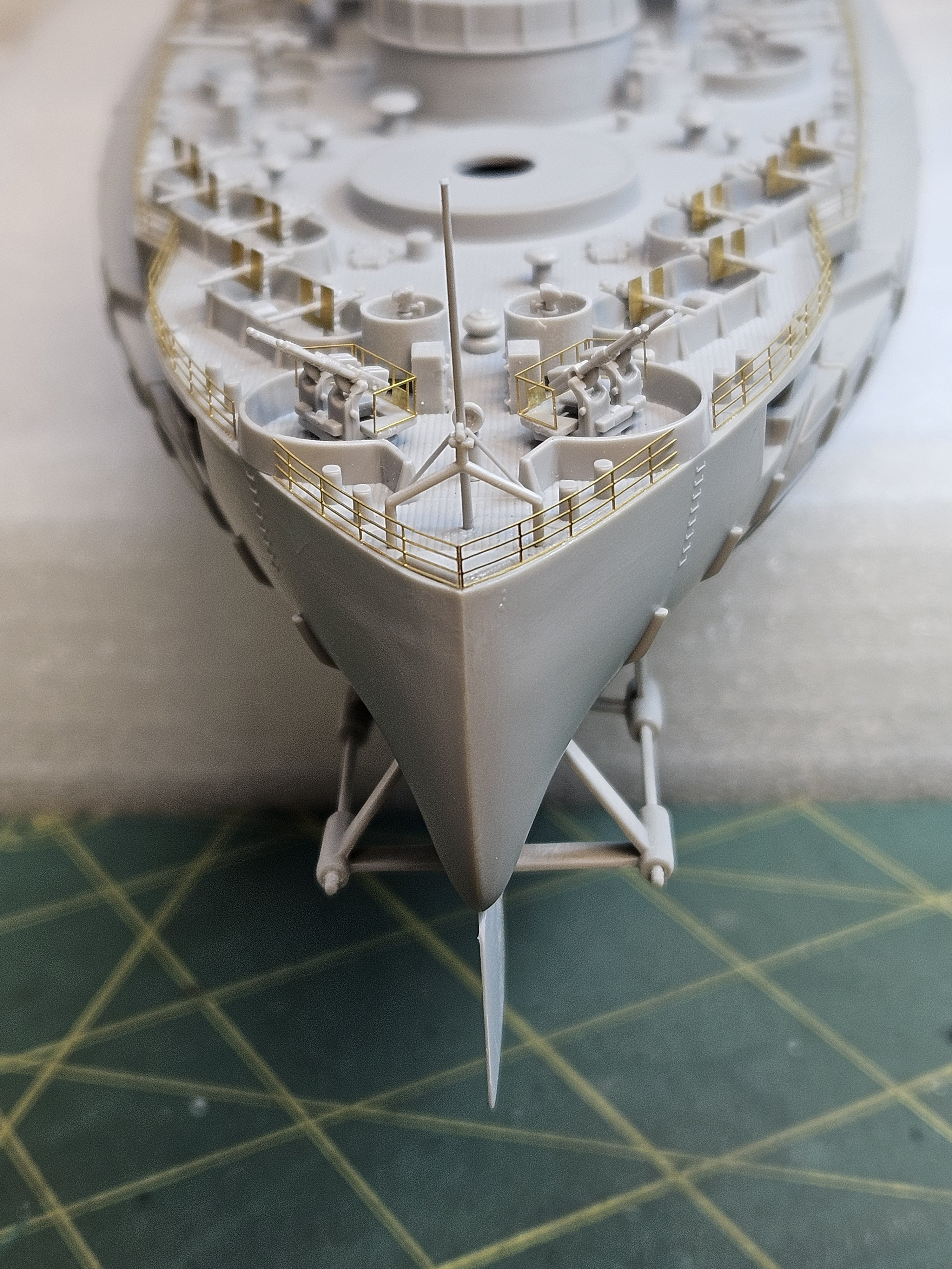

I'm almost there! The kit supplied bow flagstaff was to thick, and looking at Texas pics, way to short. The kit didn't even supply one for the fantail. I replaced the bow flagstaff, and made the whole setup for the aft one with stretched sprue. The fantail's staff is set at an angle. I'm beginning to get a bit frustrated with this Trumpeter offering. I mean it's not like there's not plenty of info to make a decent model. Hell, the real thing is sitting in Galveston, they could go look at it. Anyway it is what it is. At this point I'm just looking forward to getting color on it.
Yeah that is a common problem with Trumpeter kits. They usually fit together well, but are almost never quite accurate. Their 1/32 B-26 is horribly wrong, as is the Ju87A and the USS Arizona. You would think they would learn to just spend a little time on research to get things a little closer to correct. As the kits they put forth are many times the only kit in scale or the only kit available, you just have to deal with the issues.
You should be happy and proud with the quality of the build so far. You are going to end up with a very nice Texas
Yep, that's where I failed on the Graff Spee, Couldn't figure out how to get those on without gobs of glue. "Very Carefully" yeah I know. :rotf
:popcorn
:popcorn
I'm digging these steel warships but, the next one will definitely be at least 1/200 scale. Don't think they do the Texas in that scale yet. Not sure about that though. I'm using sharpened toothpicks to apply the glue. I can see from the stern photo on the starboard side of the hull there's a couple of drops of CA I need to clean off. We'll see what all needs attention once the primer is on.

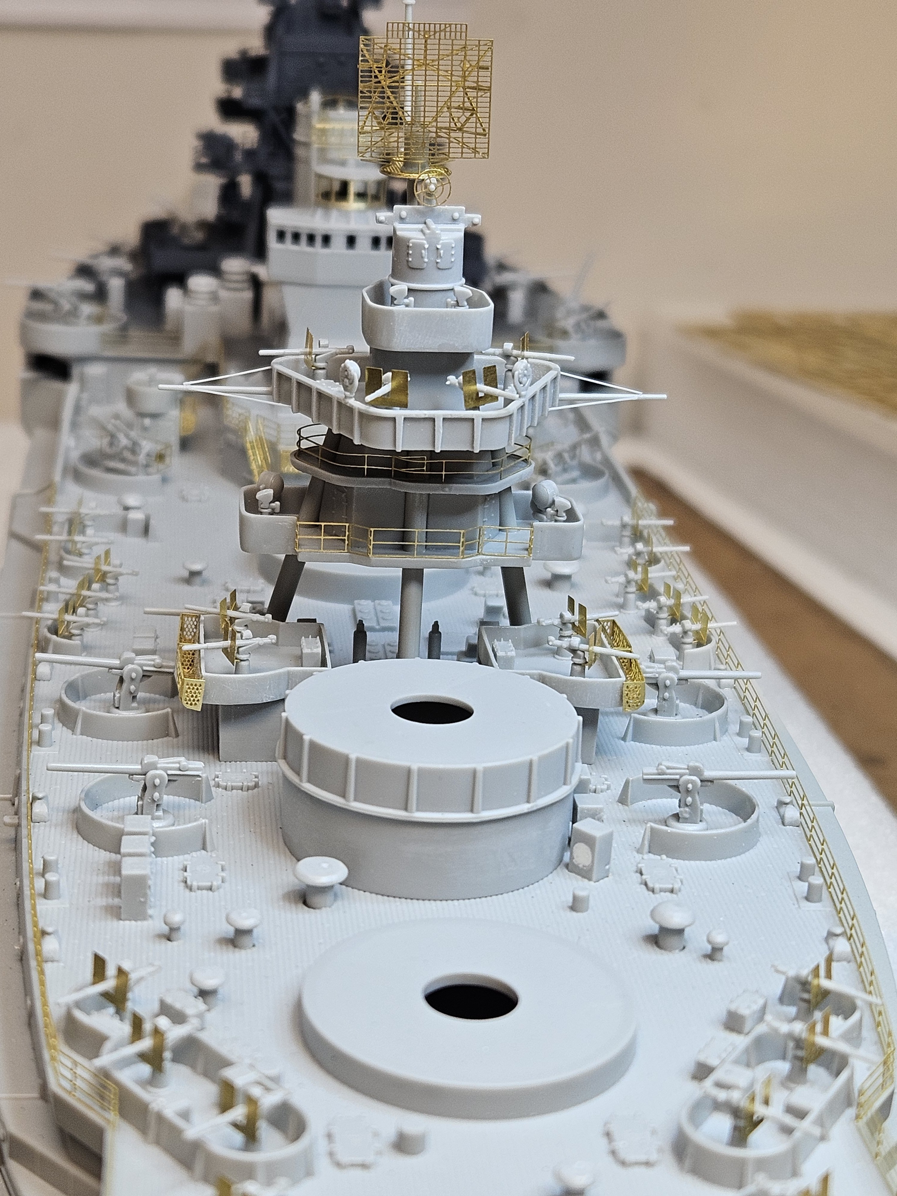

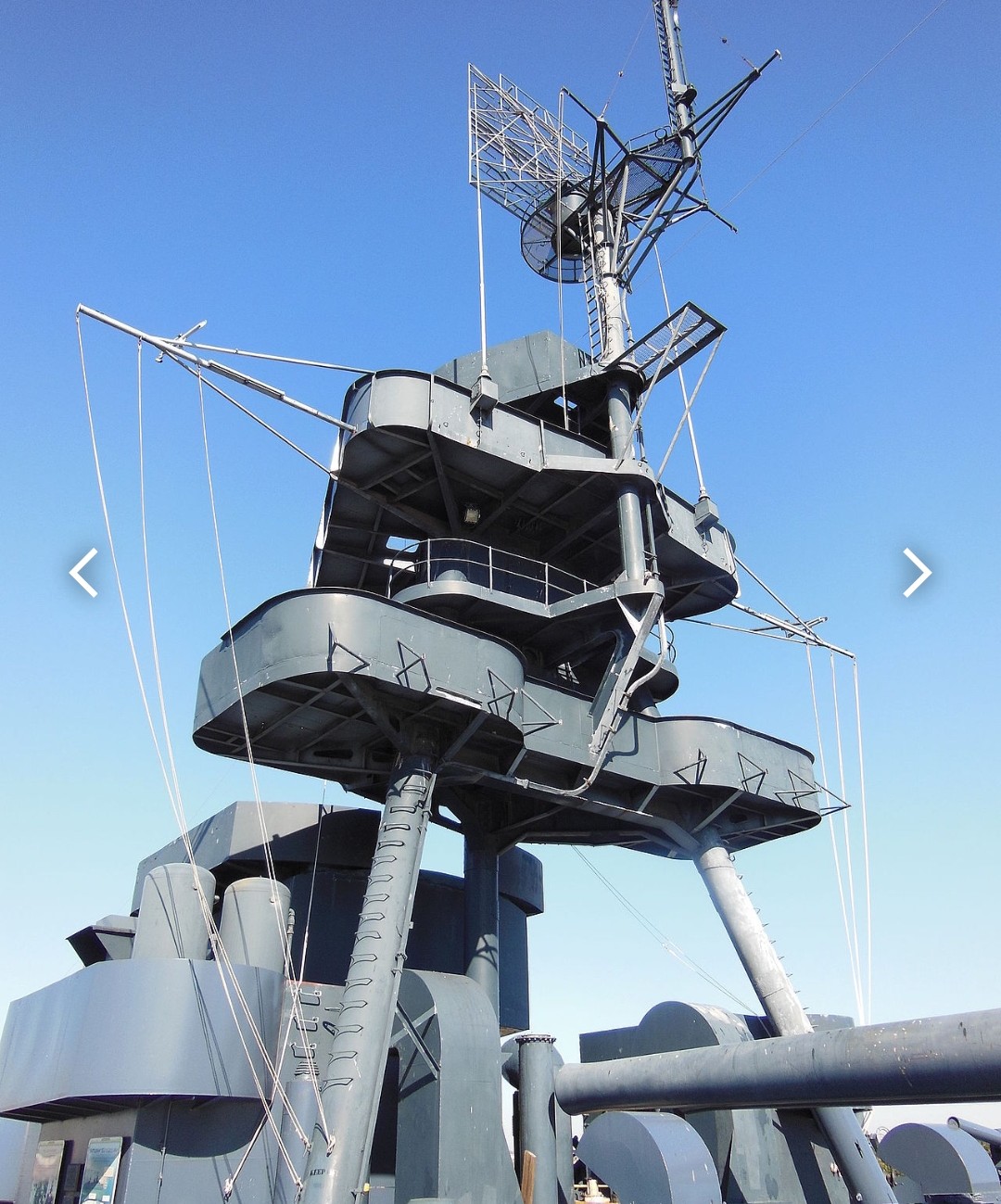

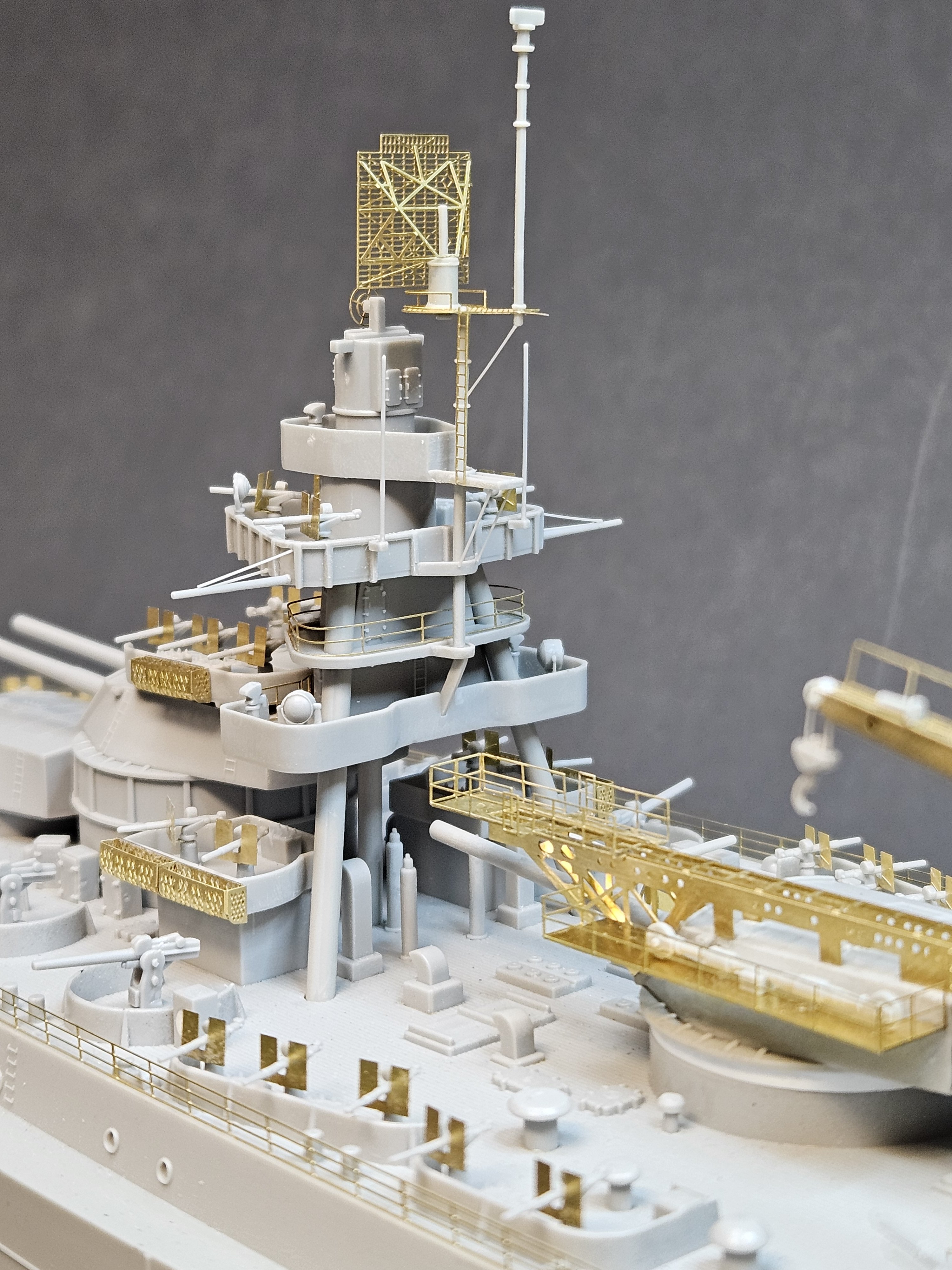

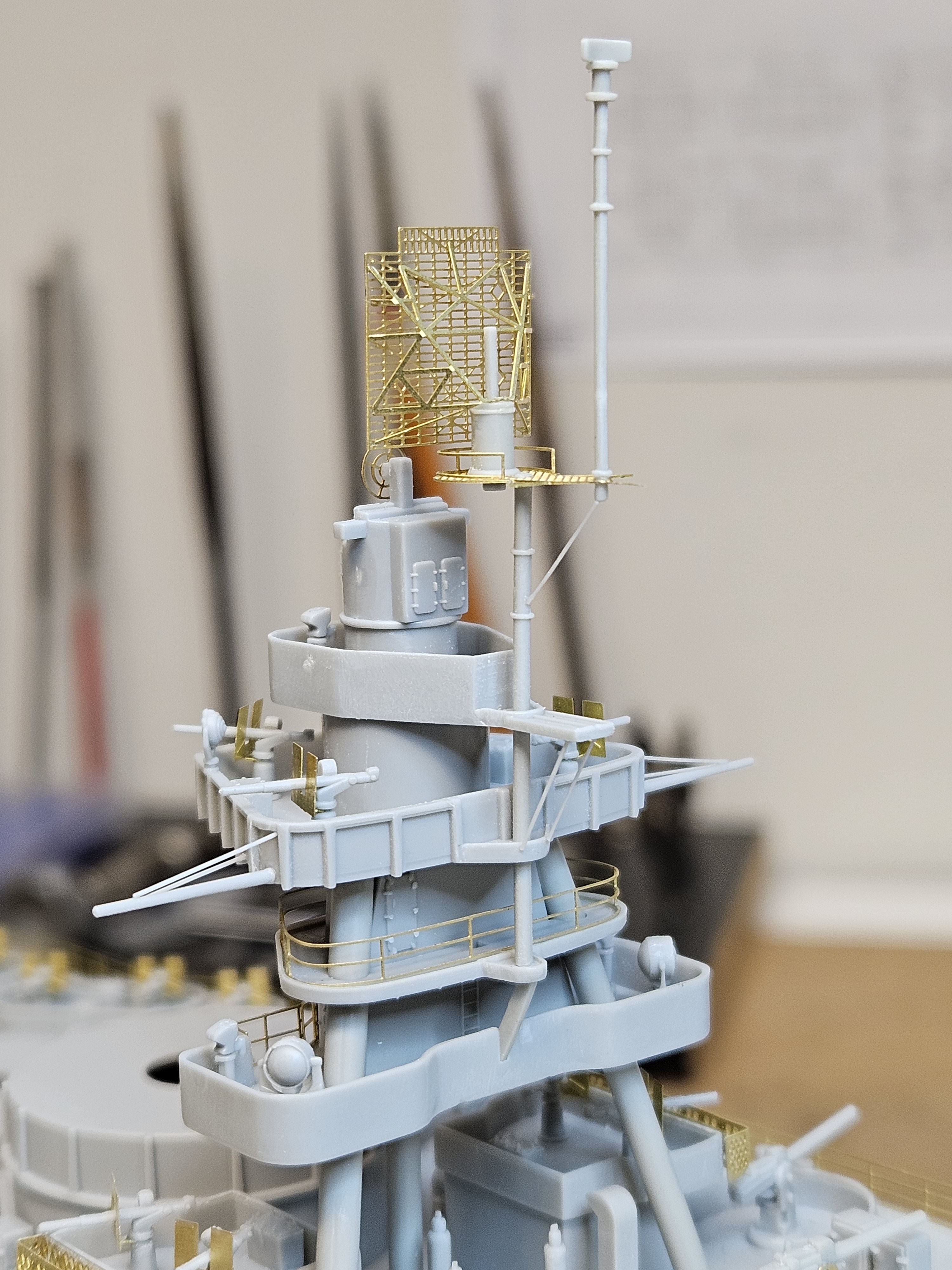

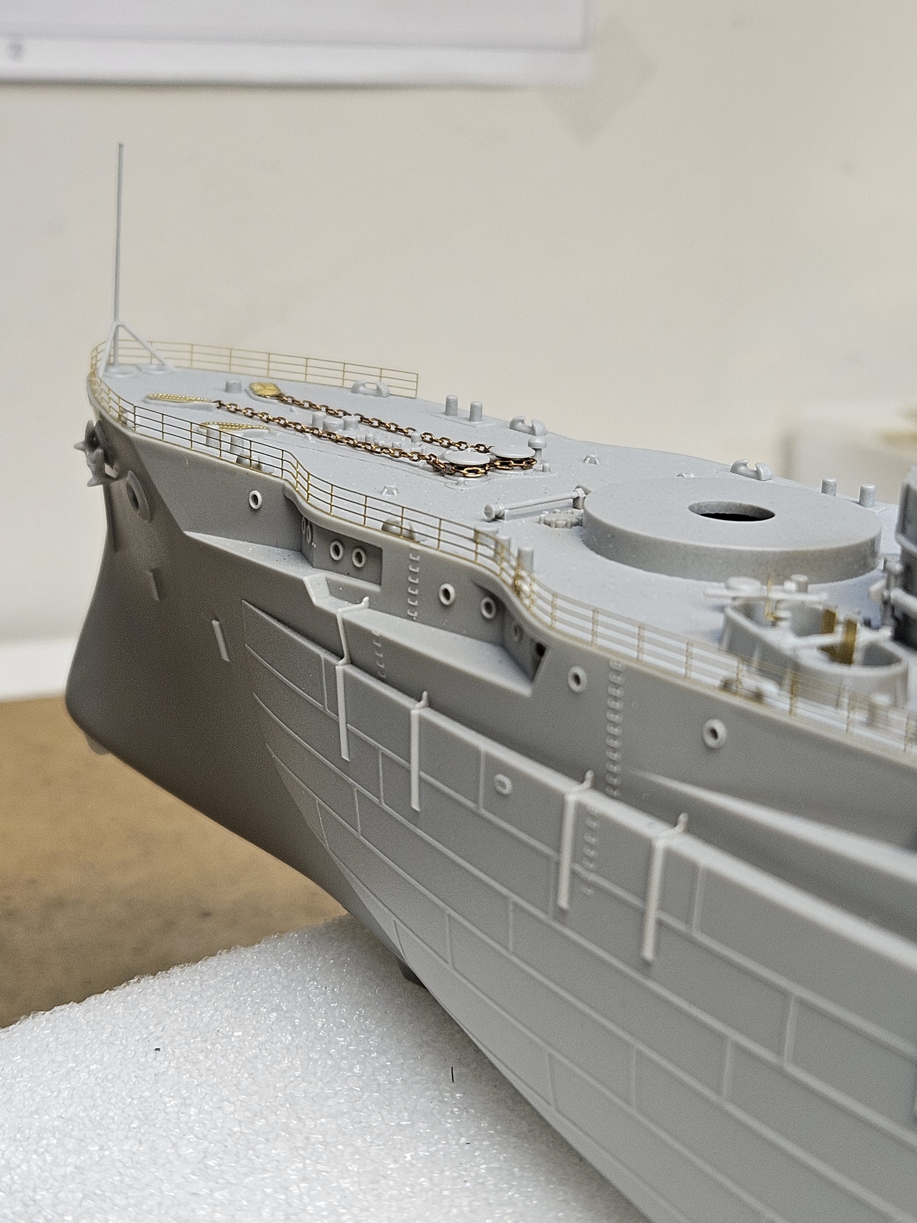

On the mainmast of the Texas there is poles extending out on each side of a platform. I don't know what they are called,
I thing they for flags. The kit didn't supply this, so again stretched sprue was used to represent it. I can see from the Texas mainmast pic where I can add a ladder to the radar mast. I have lots of ladder PE!

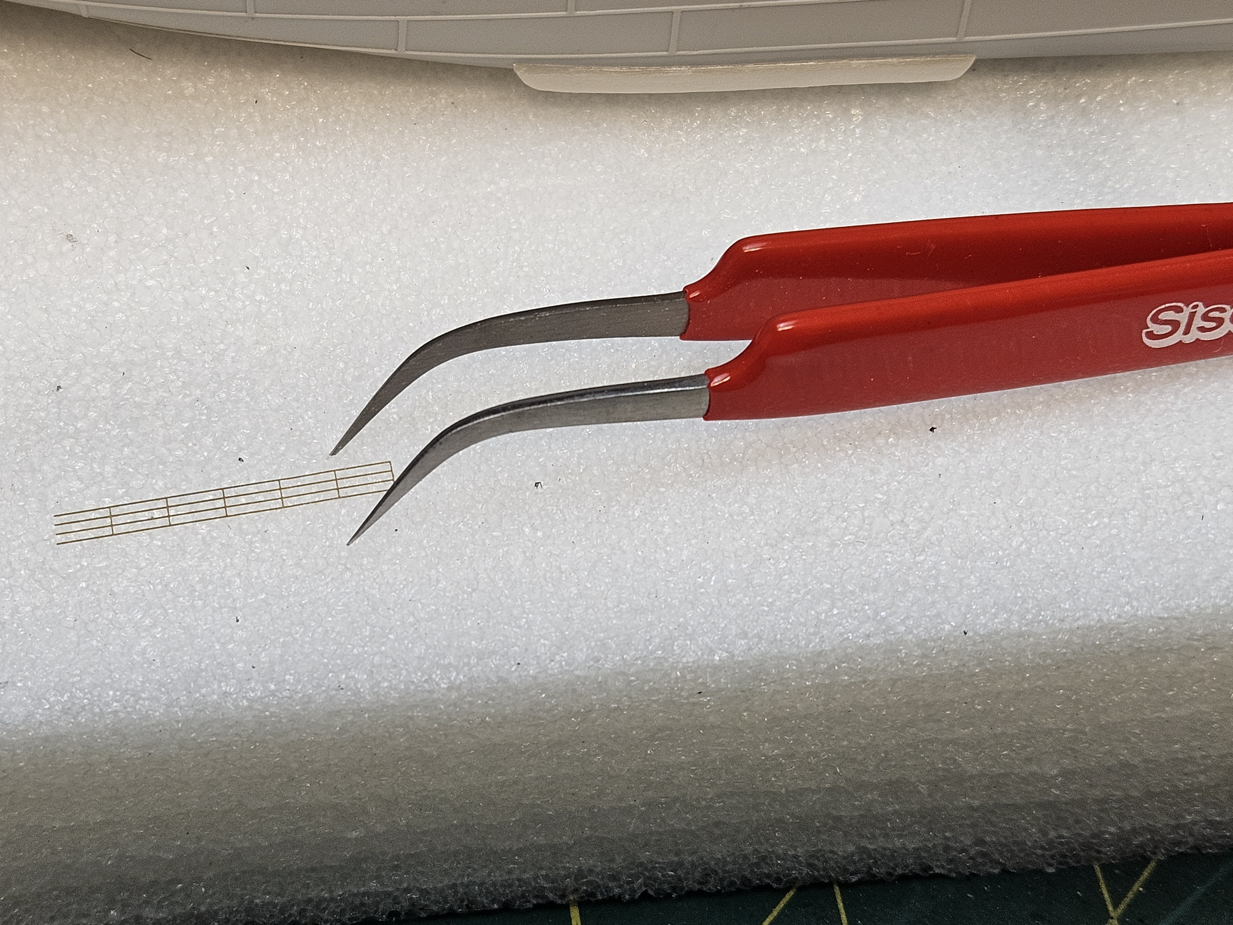

OMG, you are a master PE'er! Those railings look so dang good!
I need you to do a video of how you did that STAT!

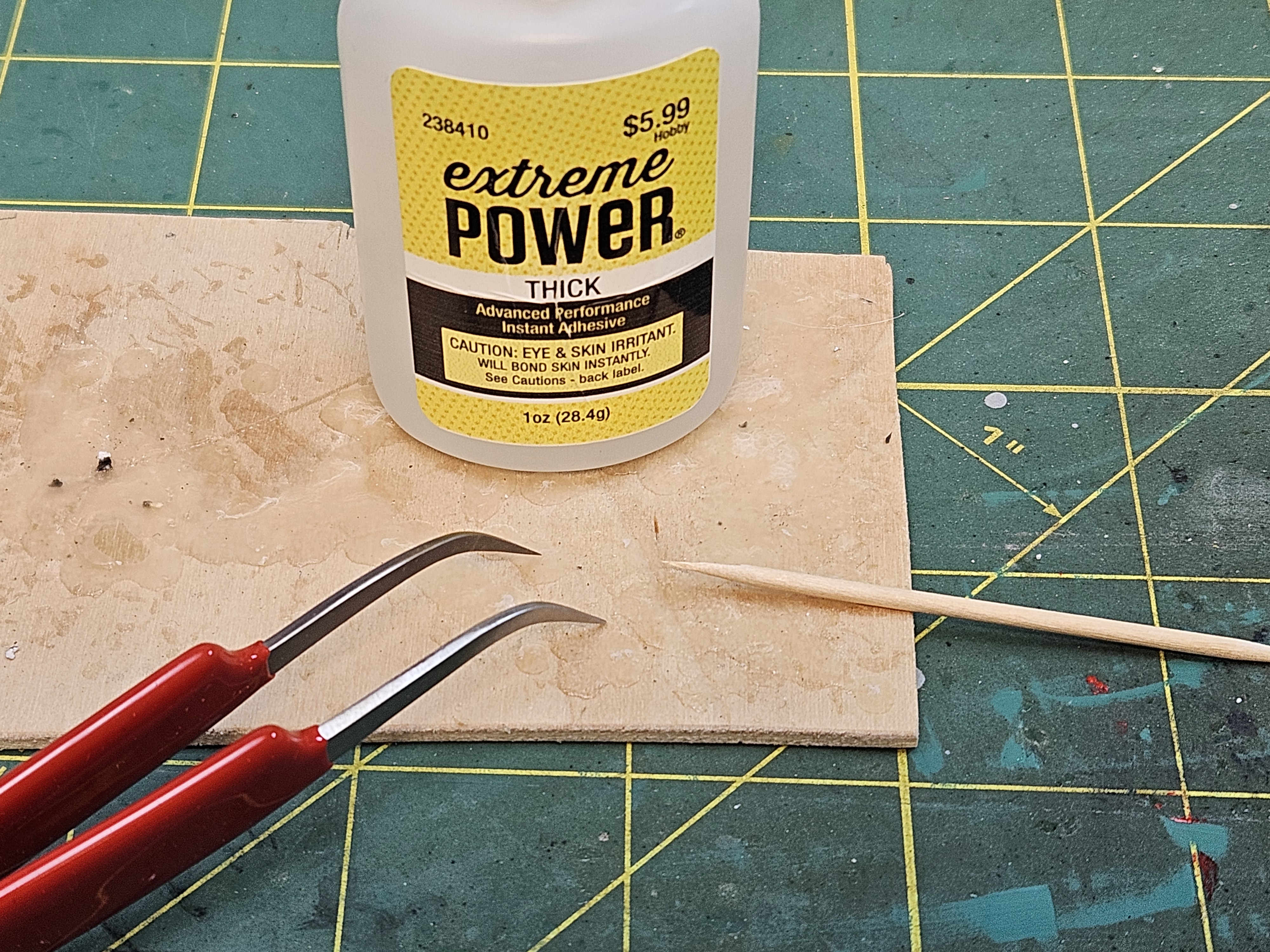

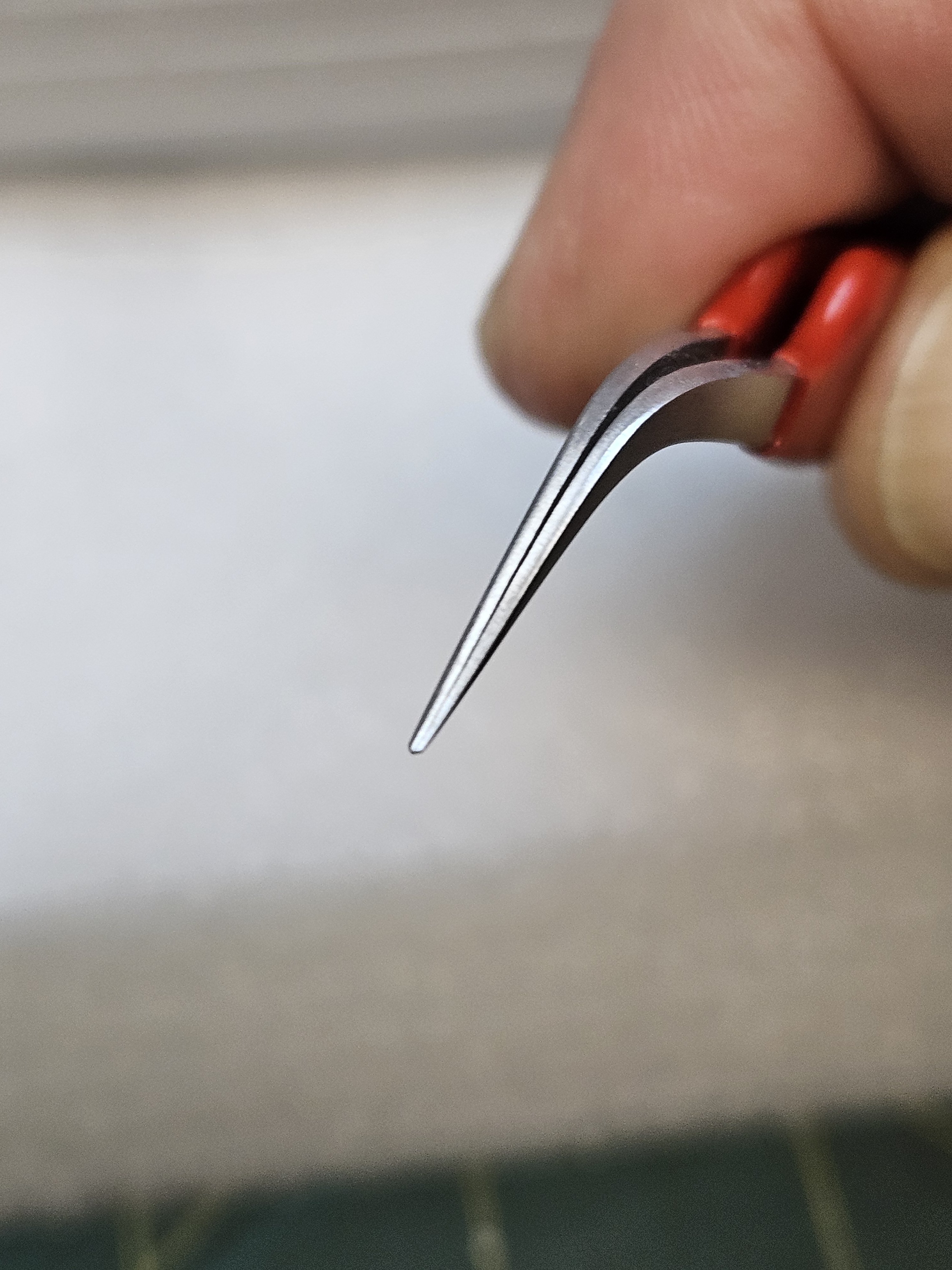

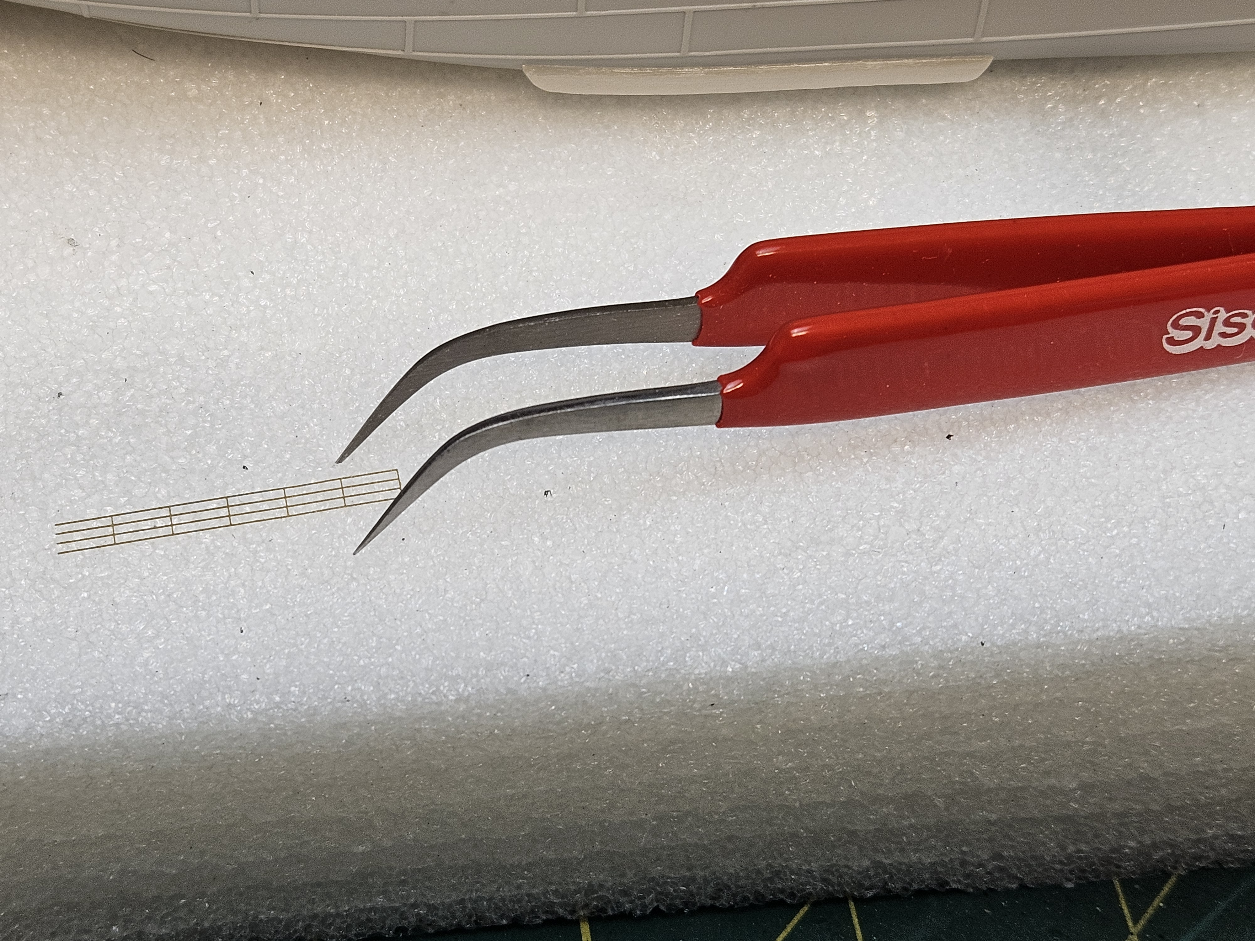

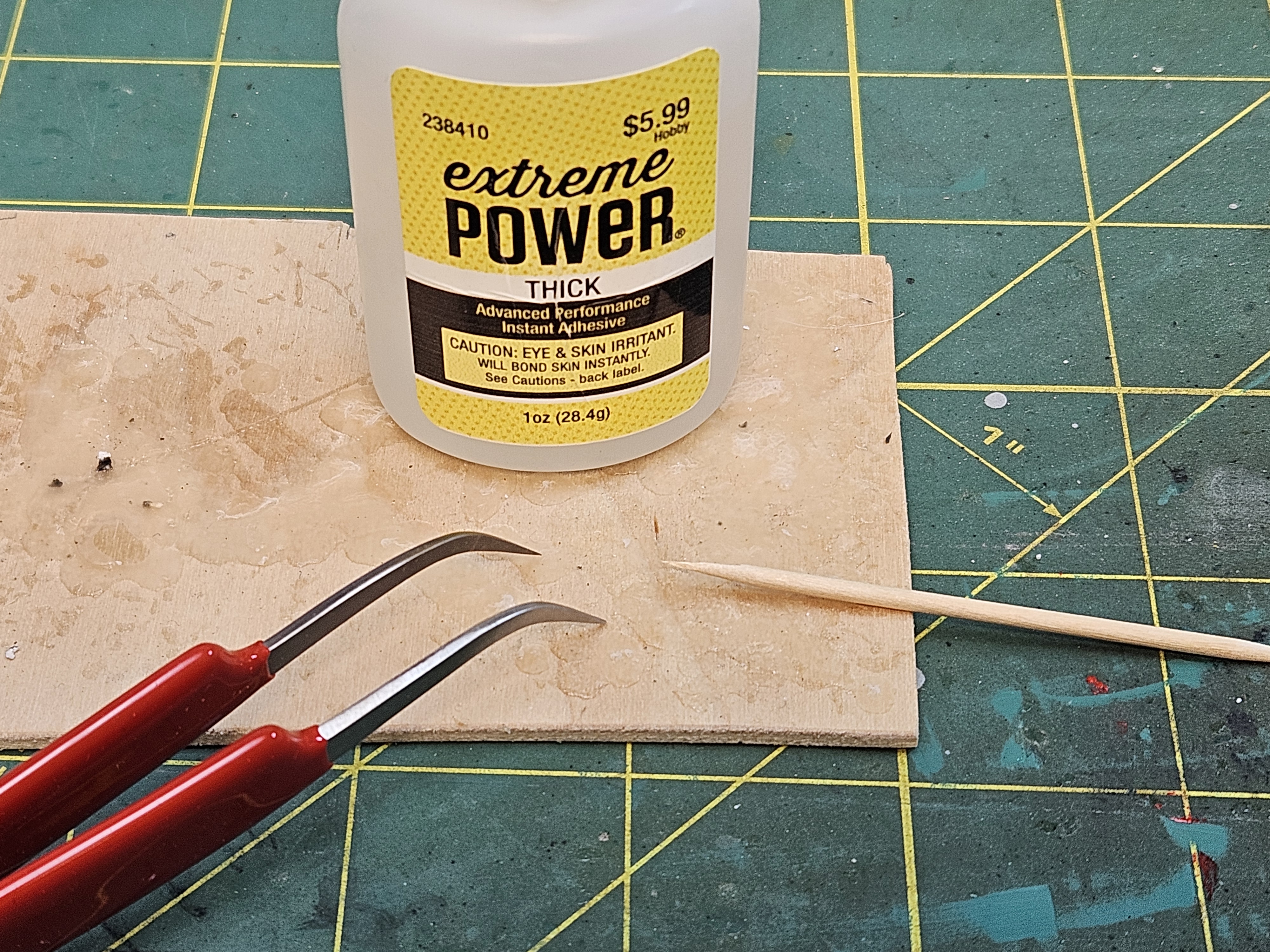

I'm a far cry from a master, Greg. Here's my simple setup. Scrap piece of wood for putting a drop of CA on. Sharpened toothpick, tweezers.
I go through a lot of toothpicks. Good quality tweezers are the key. These Siser brand pair are the best I've seen. Got them at Michael's.

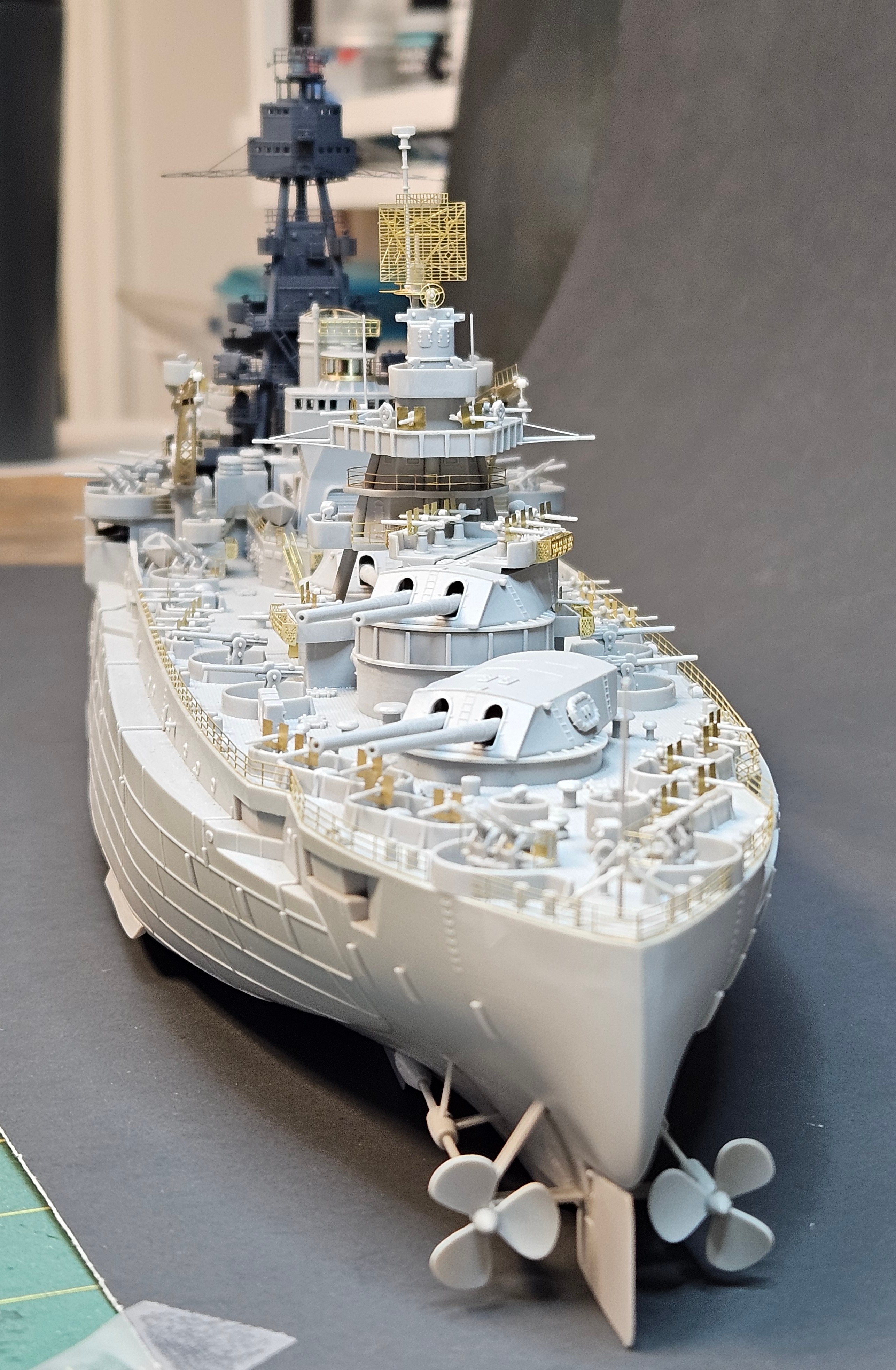

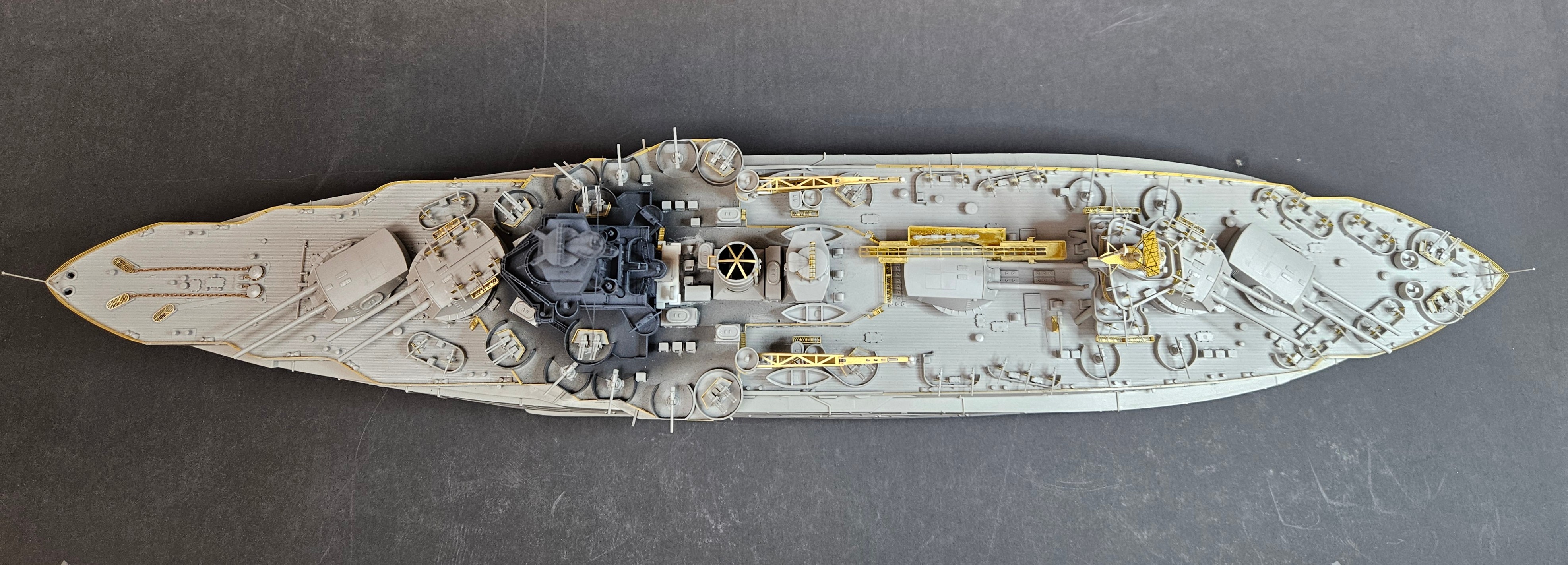

Most impressive, Tim! How much of USS Texas comes apart for painting?
One would think somewhere near the after superstructure, not far form the flag hoist yardarms one might find an oddly shaped locker with slots in the top. A "Flag Bag". It hasn't been a cloth bag for over 100 years, but that's what it's still called, even when it is made out of welded steel.
Storage for flag-hoist signal flags.
Trumpeter didn't even supply the flagpole, let alone a flag bag 😜
The main guns, and boat cranes come off for paint. I wanted to glue the cranes on, but they would be all in the way airbrushing.
I go through a lot of toothpicks. Good quality tweezers are the key. These Siser brand pair are the best I've seen. Got them at Michael's. View attachment 165149View attachment 165150
Well, I doubt a master could do a better looking job. Well done! And thank you for the tips!
