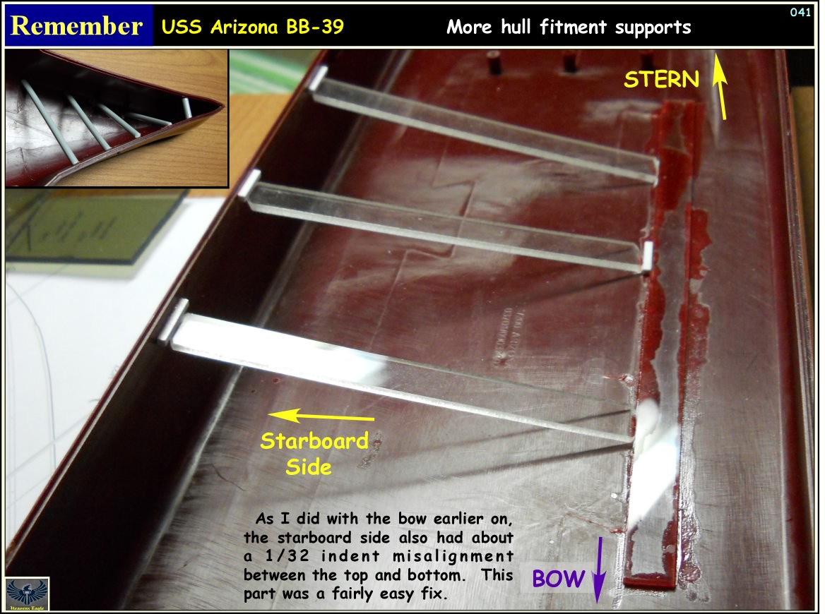

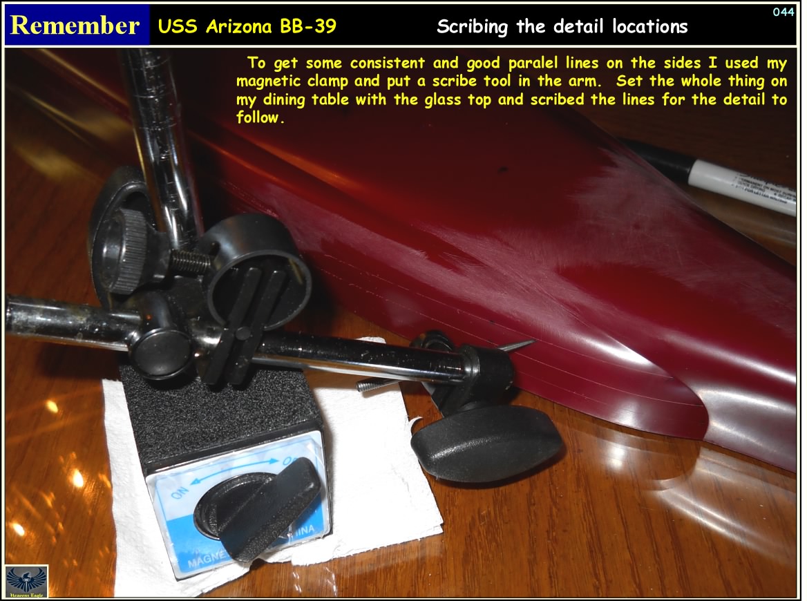

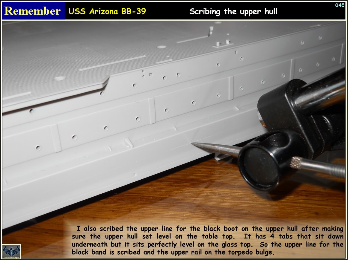

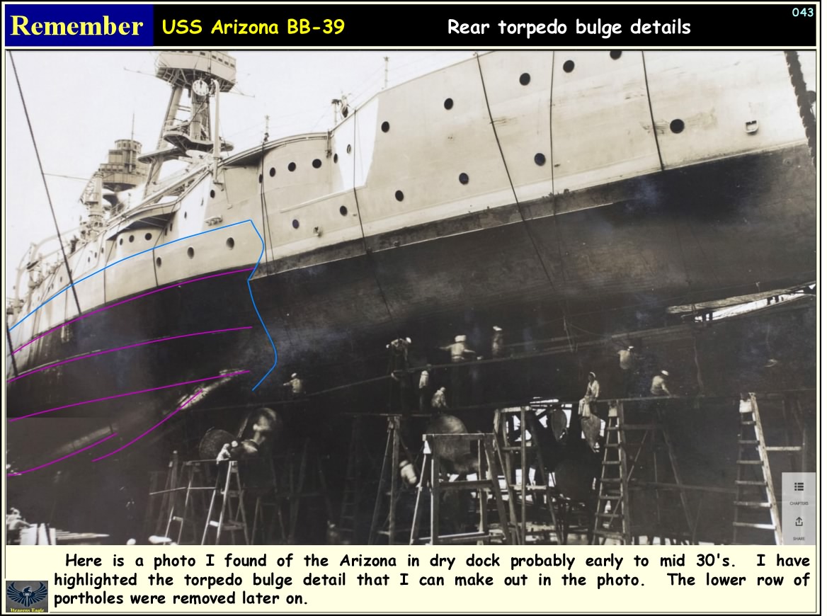

Paul, your problem-solving Kung Fu is strong indeed! I love the shot with the flashlight and straightedge- brilliantly simple. In fact, the whole hull correction shows how careful forethought can be distilled to a simple and practical solution. Nice work on the prop shafts as well- cheers!

Chuck I really appreciate your praise. Watching your builds has a lot to do with how I think outside the box on a lot of my solutions.

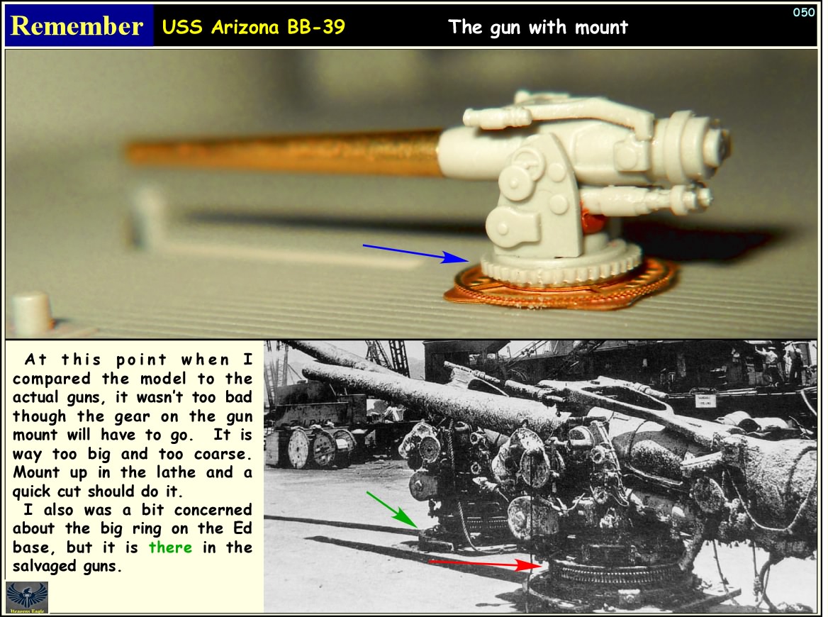

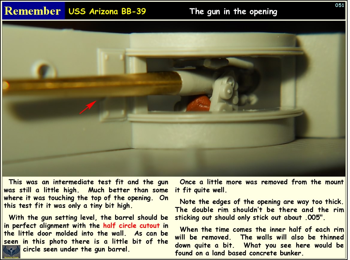

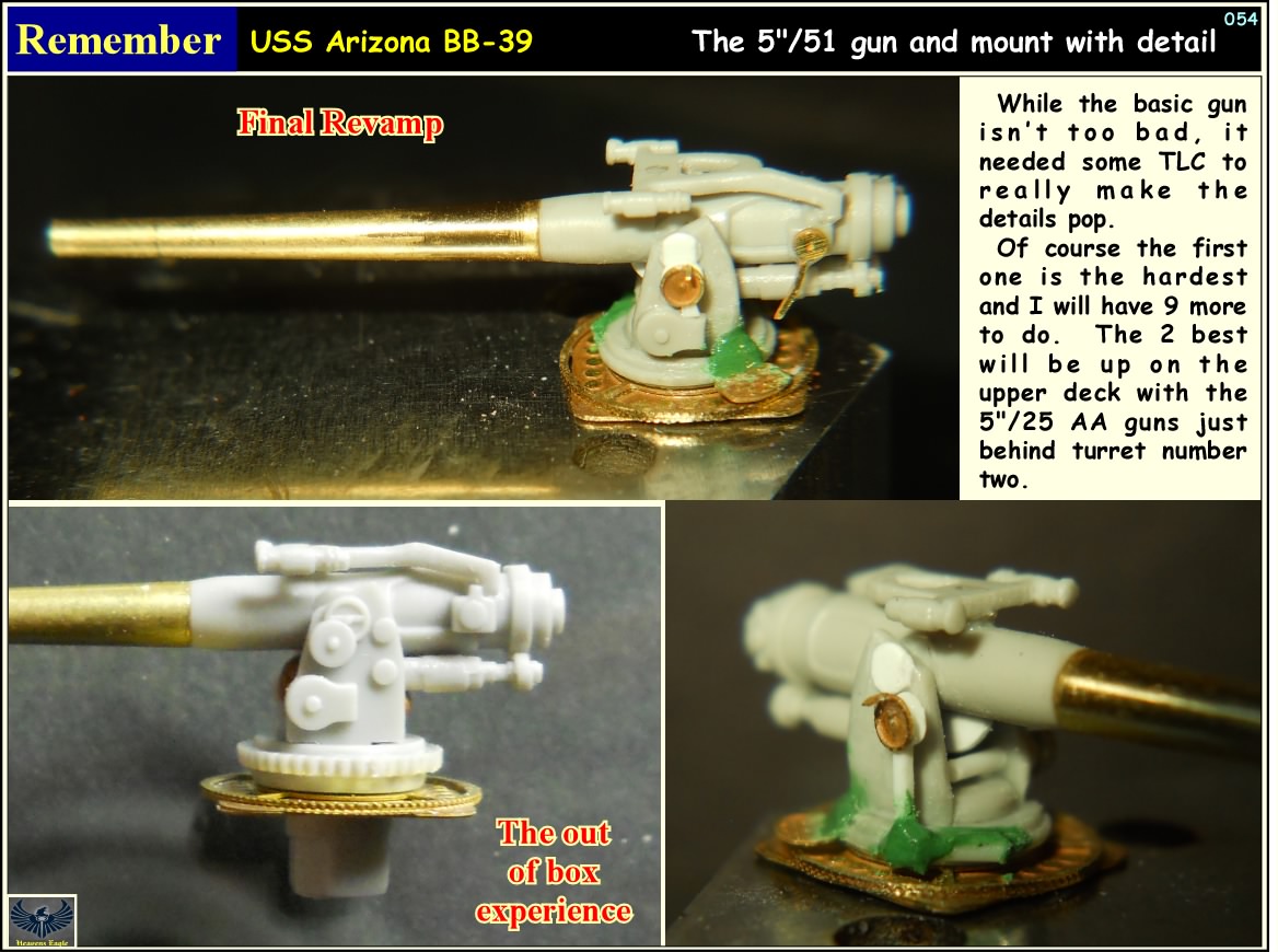

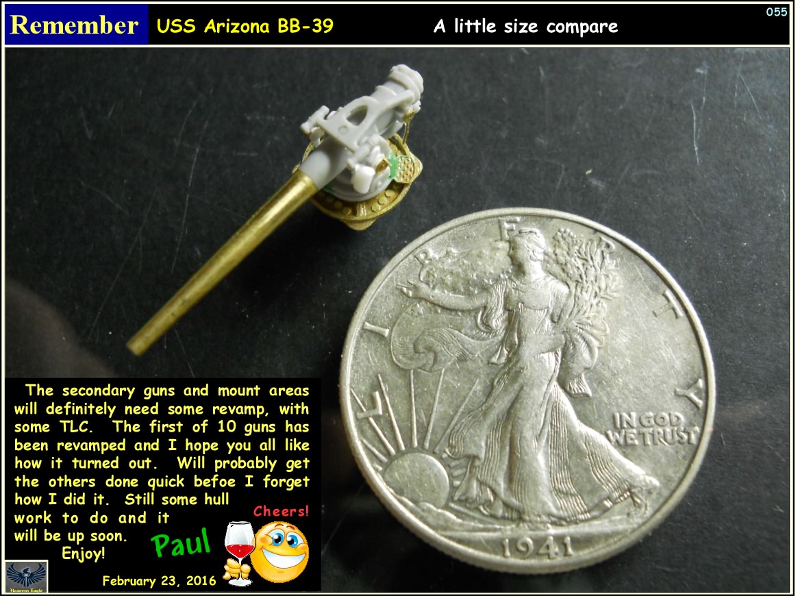

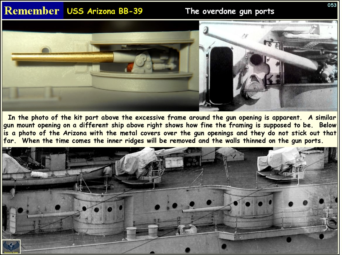

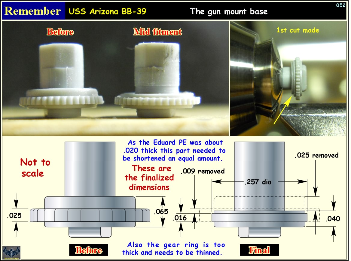

Just a little update here folks. Some more tedious work on the hull and a little something different. I decided to build up one of the 5"/51 caliber secondary guns and check it height wise against the lower superstructure openings.

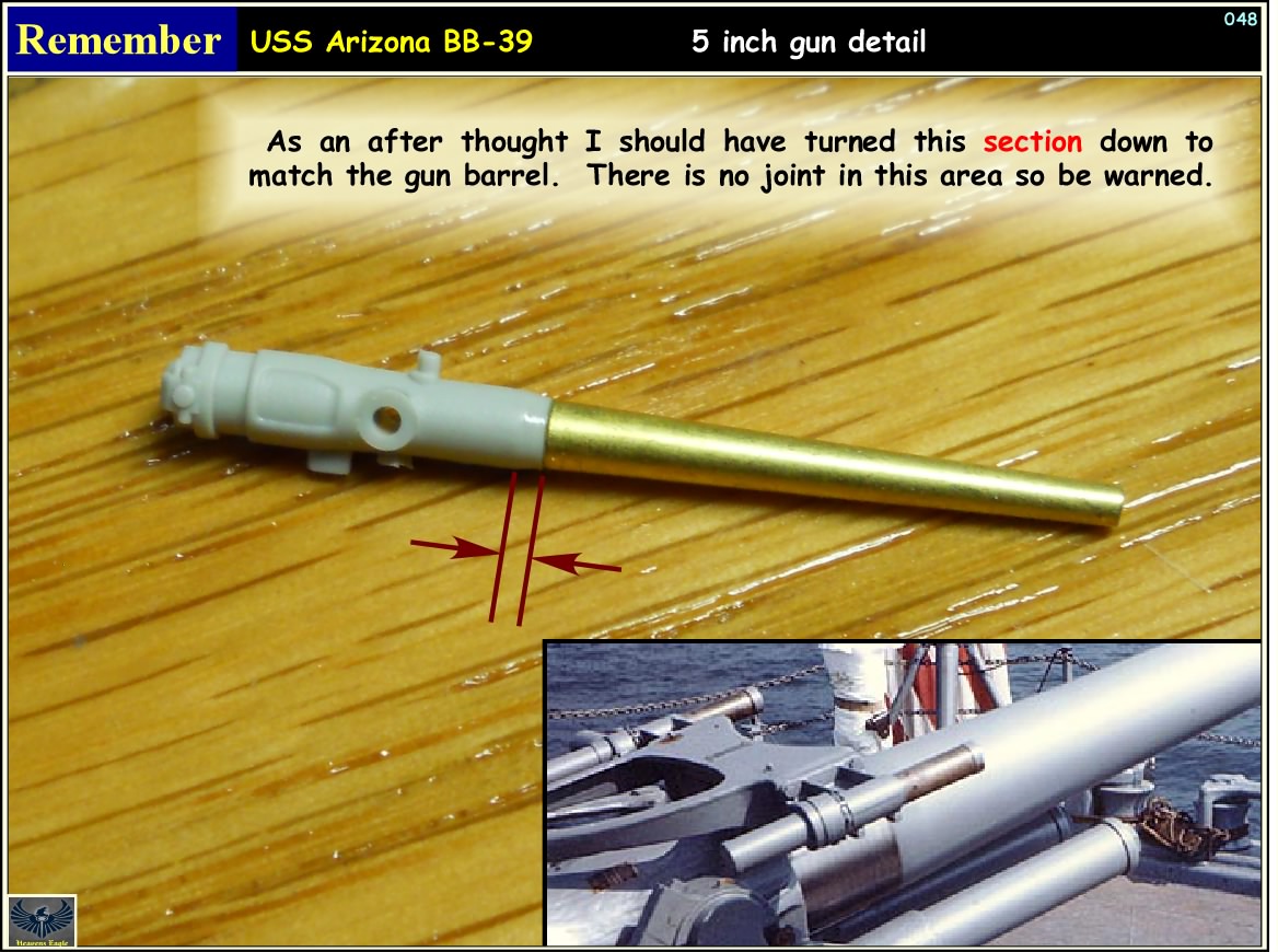

There were some modifications done to make a big change in the gun mount partly to use the Eduard PE and a bit of scratch building to make the little gun look more like it is supposed to.
Enjoy
I will probably get the rest of the guns assembled while I still remember how it was done. I am sure there will be improvement in them as they are built so the 2 nicest ones will end up on upper deck with the 5"/25 AA guns.
There is a bit more hull work I could do, the decision is do I want to do major rework or medial work to get things looking good. I will be pondering for a little bit yet.
Enjoy, and feel free to ask questions, been looking at the 5"/51 caliber guns all week doing research.

Hey that's not fair, you pulled that gear out of someone's watch! I was hoping you'd show us how to use that divider thing I got with my lathe.

Divider thing? Is that like a thing-a-muh-jig? :huh:
Eduard has 8 PE parts to add to each gun. I figured out a number of other changes that should be done as well. :D

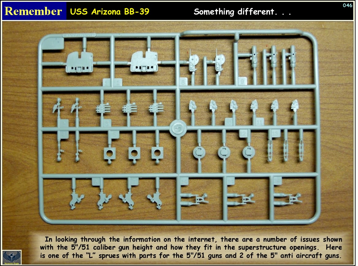

Decided last night I had better get the other 5"/51 guns going while all the little mods and changes are still fresh in my mind. There are parts for 12 guns though I think only 10 are used (not sure am at work).
Get it all set up and do it assembly line for all the changes and such. I will get a more consistant look to them that way as I can make all the little add in parts at the same time and all the part modifications and they will look the same. I will try and get some reference photos of what I am doing showing the mod steps to the parts as I do this.

As to the huge model, outside of the hull parts it seems to be a bunch of small models that then join for the whole. Each of the 5"/51 guns has 6 plastic and 1 brass part in the kit. Eduard then adds 8 PE parts. Then with the added corrective detail changes I make there are an additional 16 little plastic parts added or reused in a slightly different way. That amounts to 31 parts per gun. A mini model all by itself and there are 10 of them on the Az. :huh: :blink
