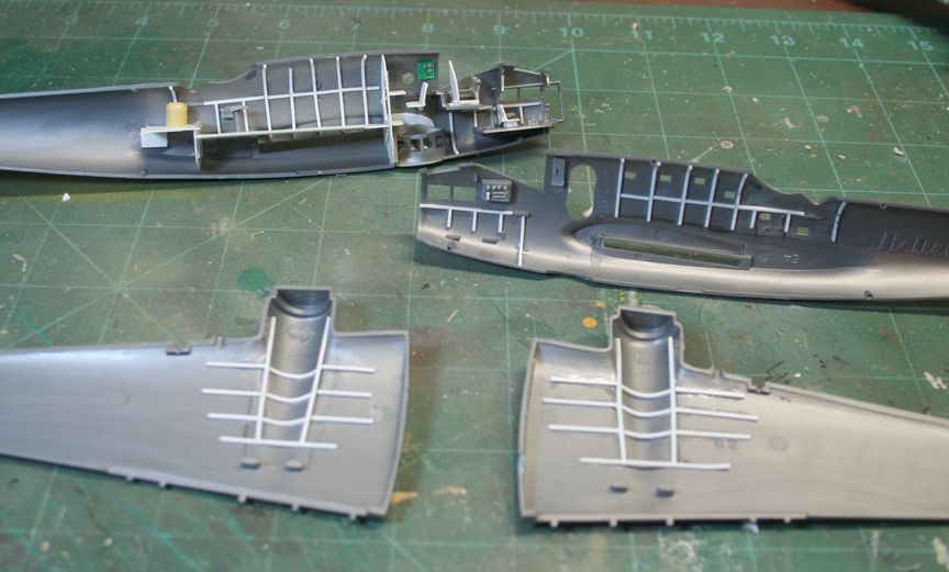

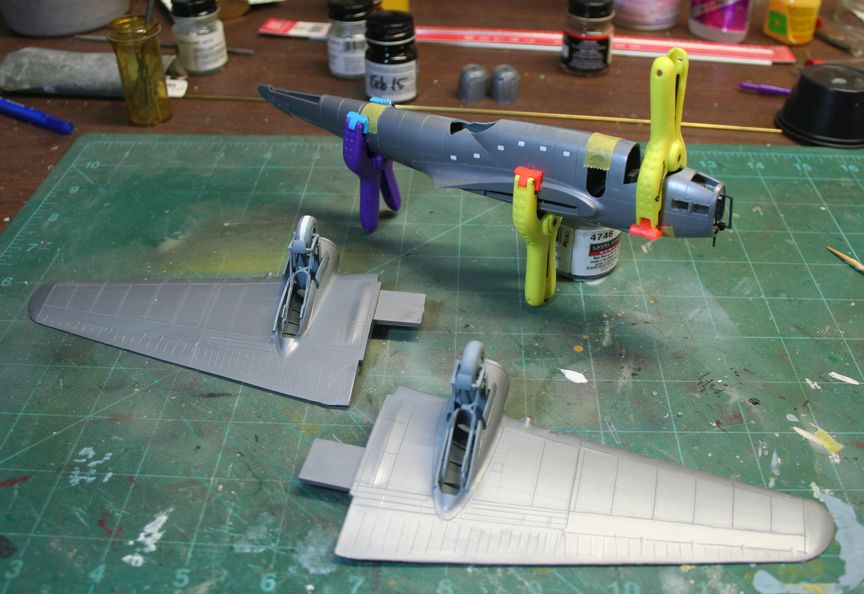

Got the inner upgrades finished.
Also took a bit of time to scribe and rivet the wings and body. Should be bale to get some paint on and the fuse together next time.

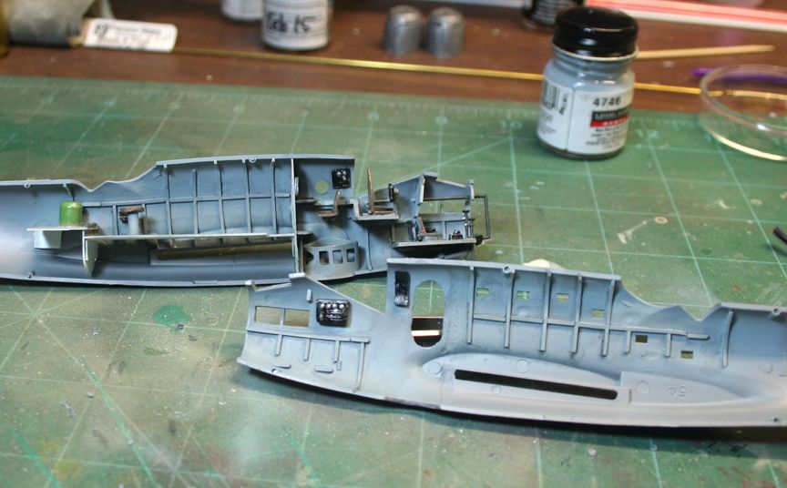

Got some more done on this today.

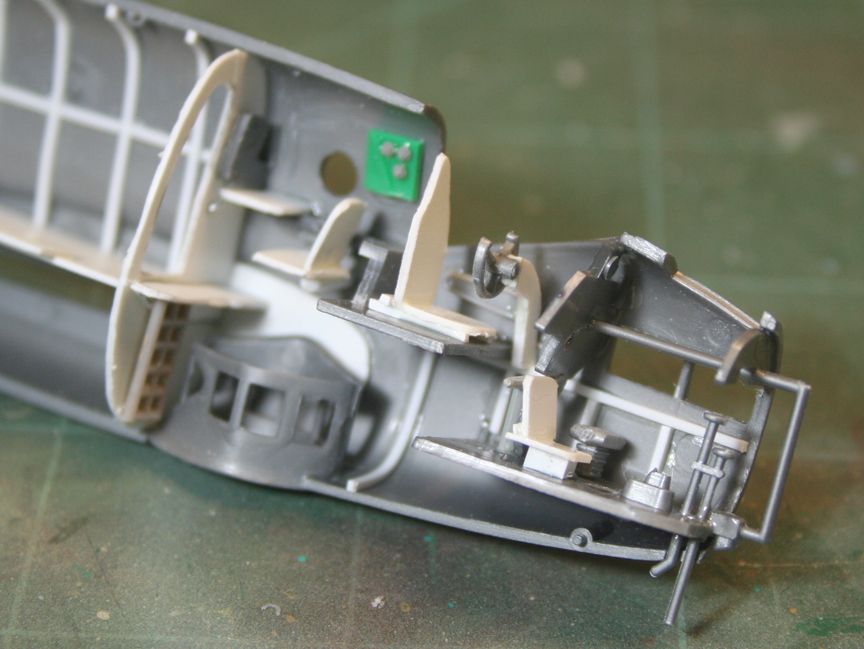

Finished up and weathered the interior slightly

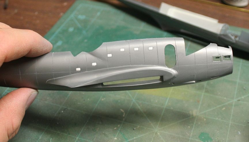

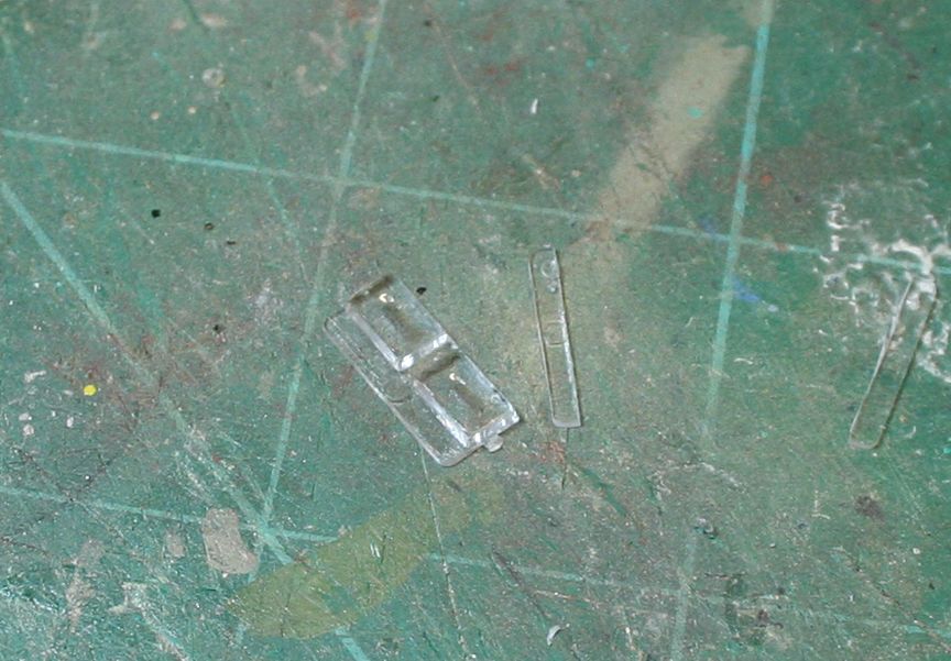

For the side windows in the nose, I cut them down some. All of these small windows suffer from dimples. Not the greatest but I'll use these ones
The little side windows I am using Micro Crystal Clear

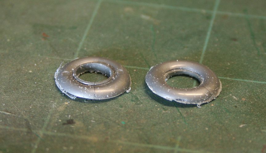

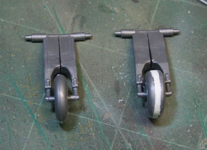

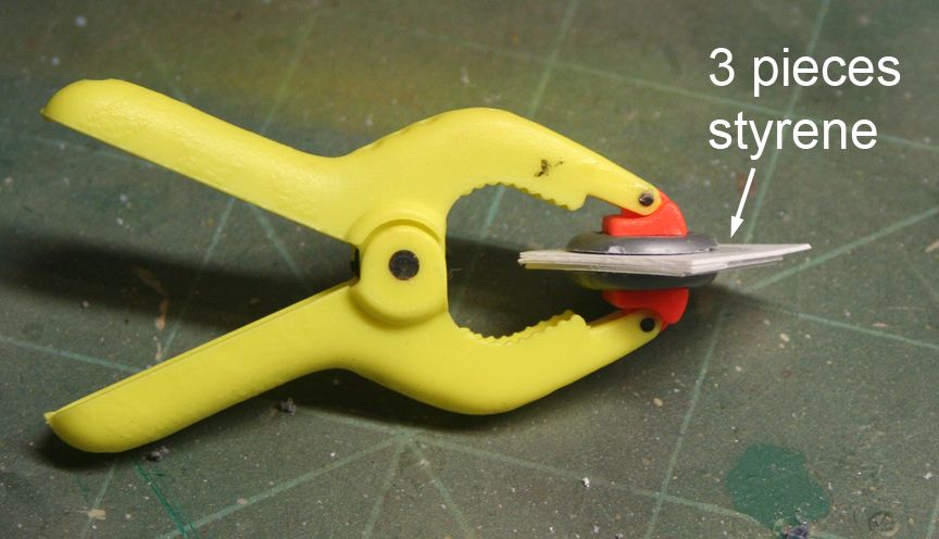

Next on to the gear. I thought these wheels looked a little on the thin side.
So I broke out the razor saw and cut them in half
Then sandwiched a few sheets of styrene between them. 1 for the material removed from the cut and 2 to widen the wheel

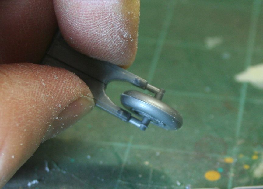

Then I just trimmed and sanded the wheel and filled any spaces with putty.
I think this looks better

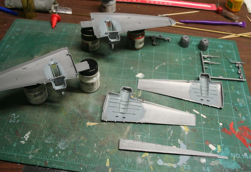

Then I painted the bays

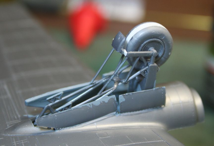

and assembled the wings and gear. The instructions call to assemble the gear before assembling the wings. They are quite complex for this little kit, 11 pieces making up each gear. I am sure it could be modified to add later but this is simpler for me at the moment

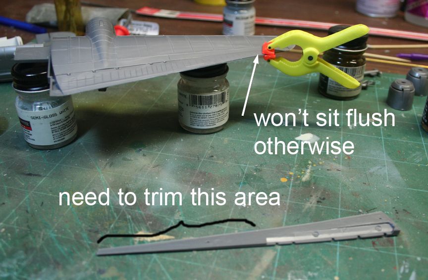

The flaps need quite a bit of material removed so that they sit flush with the rest of the wing
So now I have the fuse and two wings assembled. Have some more scribing to do on the body before I can attach the wings though!

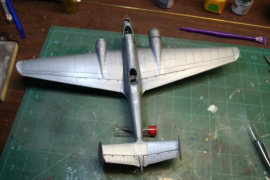

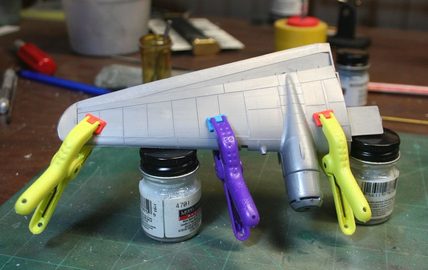

Little more progress on this one just to show I haven't stalled on it completely!
Got the wings on and the rest of the riveting and scribing done. Just working on a little sand and fill at the moment.
