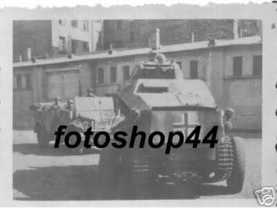

That is weird James, but very cool. Was this an actual production vehicle? Do you know how many were made?
Looking forward to what you do with this.
Tom
I'm not sure Tom. Seems to be a bit convoluted history to it. But if I read right 129 made it into service. How many with a turret I dont know.

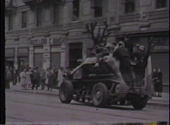

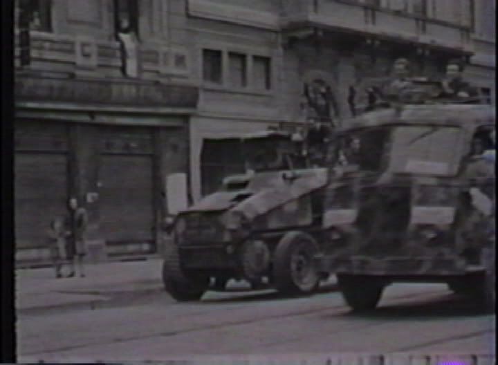

The turret ones, three made, were one offs. There is one with a T-26 turret which you can take from the new Hobby Boss T-26 (twin turret) kit, another has a T-37 or T-38 turret (similar to the T-28), and the last the PzKpfw I turret.
