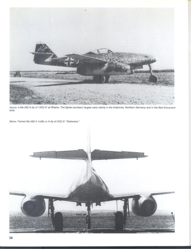

- Colour scheme - could not find ANY photograph of this plane, the only reference I have is a print on sale signed by Tony Gaze, showing his Spit shooting at the Me.
Laurence, not your specific aircraft but these may help a bit for what scheme you choose to do, not the first one though.
1/KG51 aircraft schemes
1_KG51%20262_1.jpg~original
1_KG51%20262_2.jpg~original
1_KG51%20262_3.jpg~original
1_KG51%20Edelweiss_A.jpg~original
1_KG51%20Edelweiss_B.jpg~original
