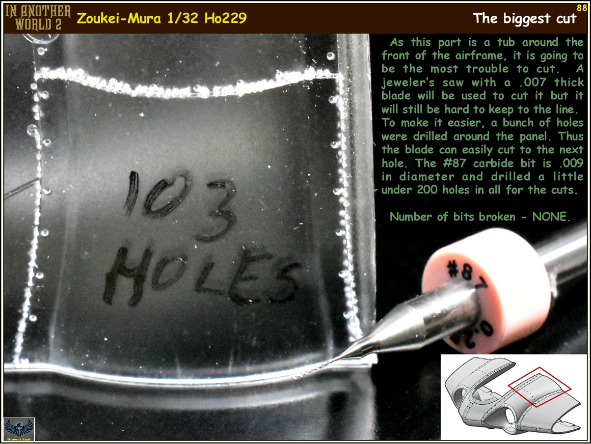

As to the flex shaft, it has nothing to due with the mounting. If you are using tiny drills, the length of the shaft is the problem. That length with the weight/power of the motor at the other end will bounce it the tip jams at all. It is great for doing stuff that needs power or has to run a fairly long time. With tiny drill bits however it is going to break them at some point as there is too much mass and power going on. In addition, you are going to constantly fight the flex shaft's weight and pull.

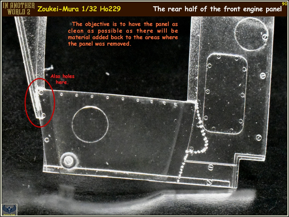

I did this:

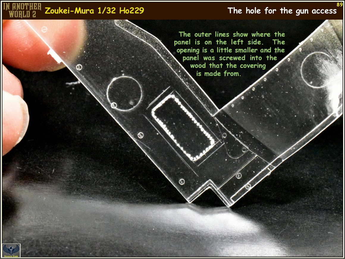

Remember that clear plastic is rather brittle as well, and a small drill can grab and pull as it breaks through the back side. I drilled all these holes with one very thin bit and did not break the bit. I can promise you that a flex shaft would have broken the bit.
With this:

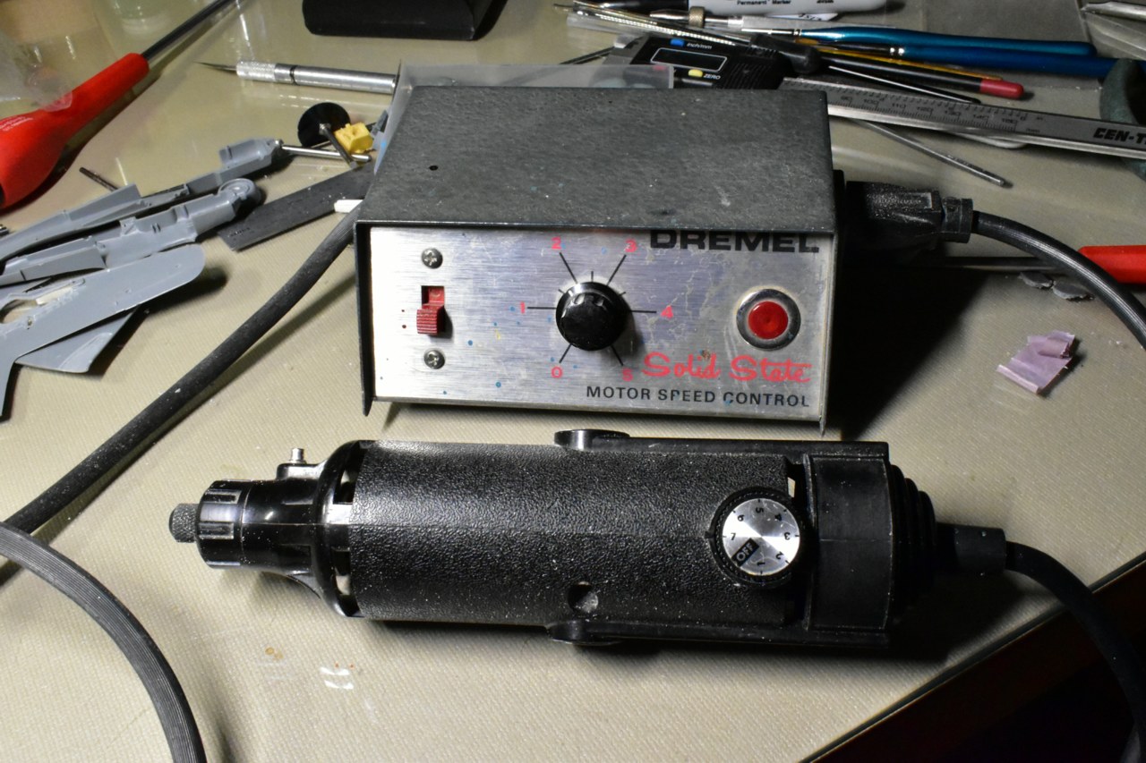

While the Dremel has some weight, it stays constant, and the power cord doesn't put any real pull or tension on it. Also when running slower with little load it does not heat up. The speed control sets a constant speed that once you have drilled a few holes, becomes real easy to know how to handle and hold it to feed the bit and not break it. I have used this set up for over 30 years and while I have used some quality jewelry flex shaft units in the past, I wouldn't trust them with any tiny bits.
For sanding, grinding, cutting, and drilling larger holes and such a flex shaft will work well, but I still prefer this setup for the precise control it gives.
This is what I use for drilling small holes. I found a small pin vise that will fit in the largest chuck and use that for the smallest of bits.

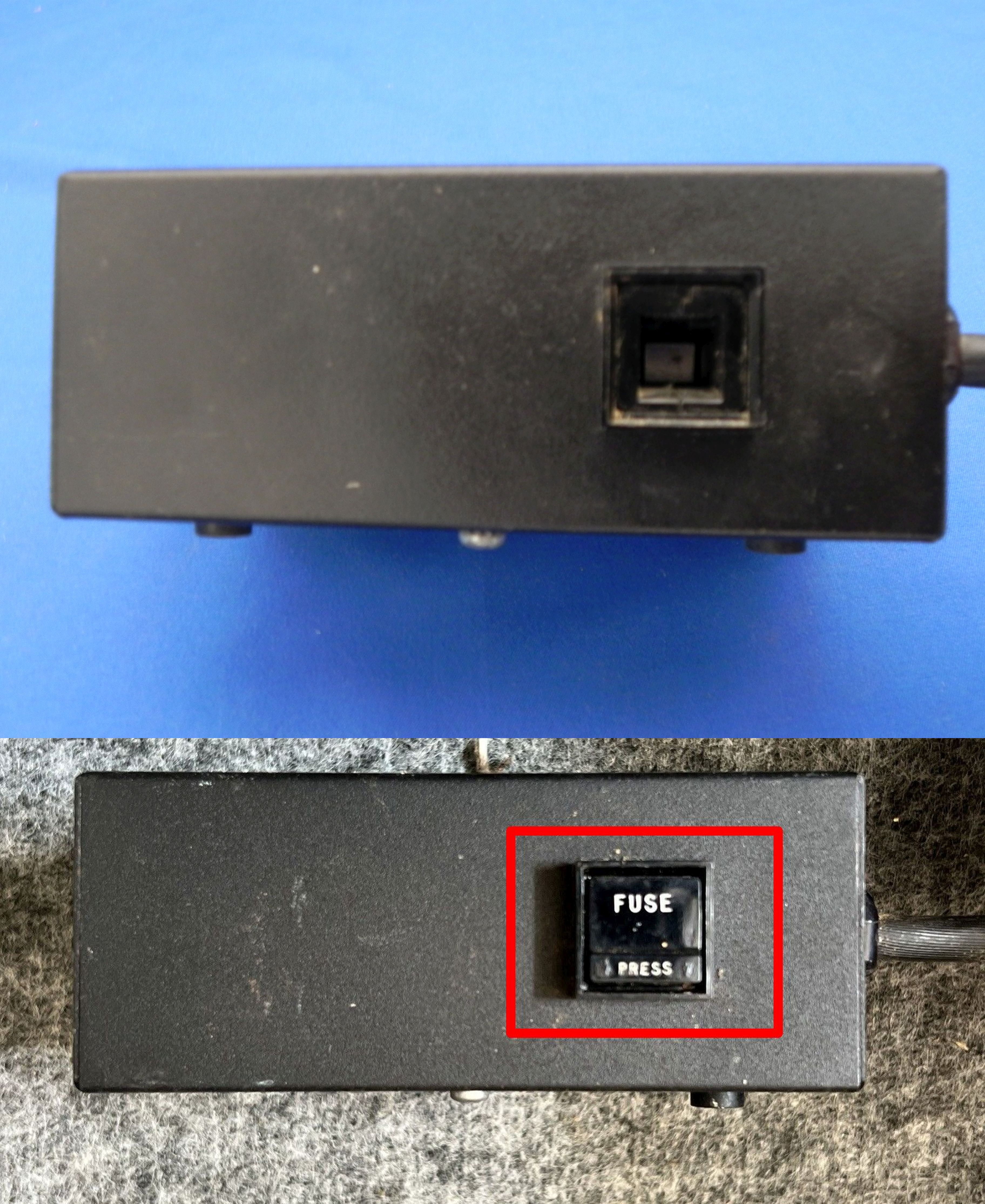

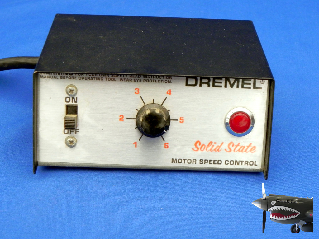

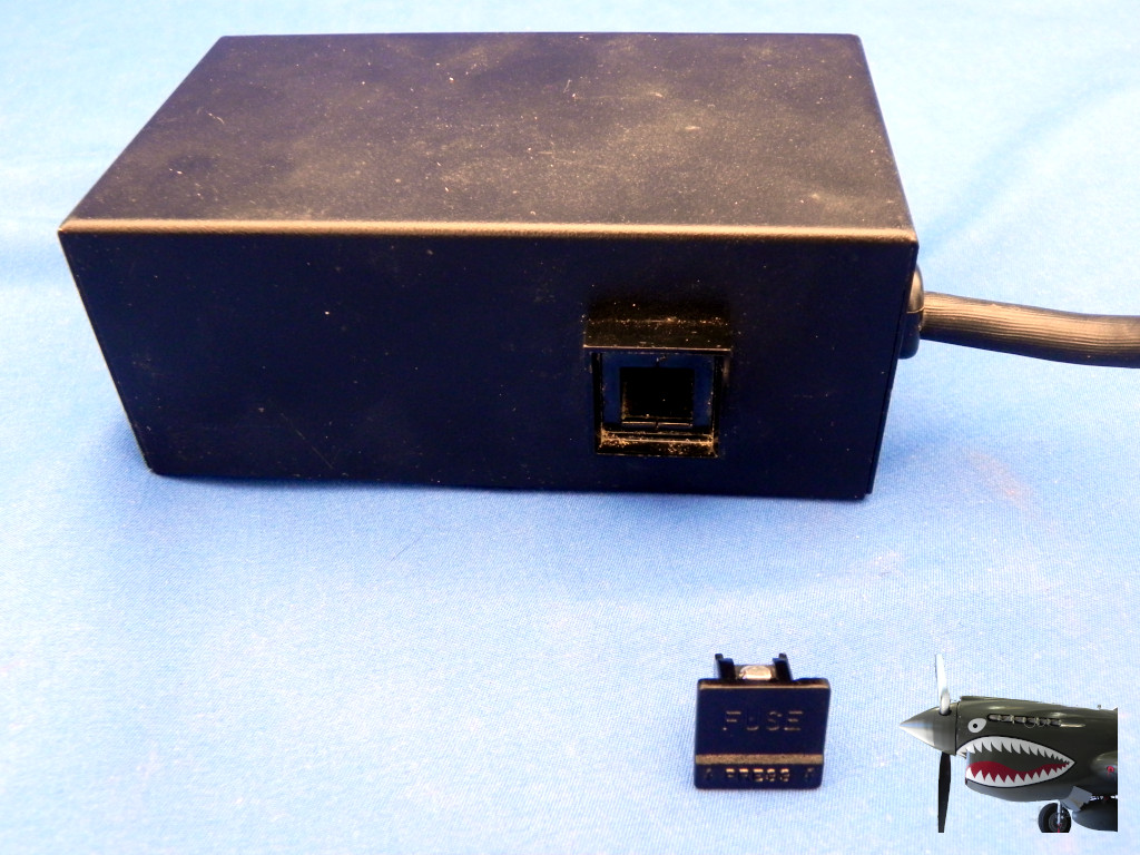

Followed @Heavens Eagle's advice and bought this on eBay...
When it didn't work, I check the back and the fuse holder (with fuse) was missing!
Fortunately, the eBay seller apologized and refunded the total amount. Now, to find the fuse holder or buy another speed control.
No manual and no idea...

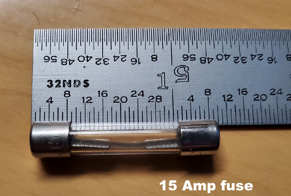

Same fuse in Bosch:
Bosch 2615631029 Fuse 3 AG 5 Amp​
Since I have a working unit, it is a 15 amp fuse. The one in my unit also is 32Volt, but I don't think that is a big deal.

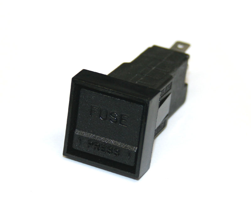

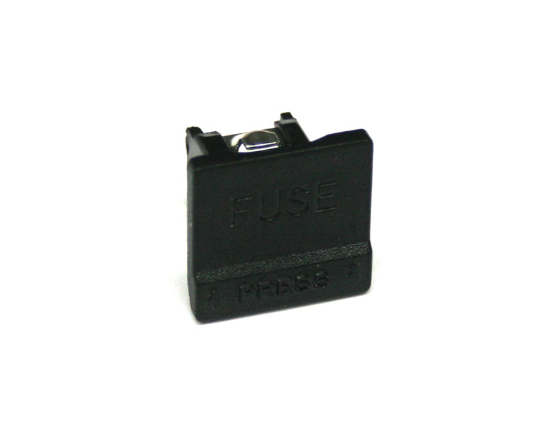

Here is a link to replace the Fuse holder: and here is a link for just the Fuse holder Cap black
I gave both as a new cap might work, or since the unit is rather old the dimensions might have changed a little and the new cap might not quite fit.
The cap is listed for $6.95 and the whole fuse holder is $19.95
I ordered the cap and will exchange if it doesn't fit. I then have to find the fuse. Perhaps in Home Depot or Lowe's? Thanks again!
I will check the voltage on my unit to ensure the fuse can be 15 amp.
I don't think the voltage is all that important. You might also check an auto parts store for the fuse.
I'll take a photo of my setup. I haven't had any issues with the bit wandering.

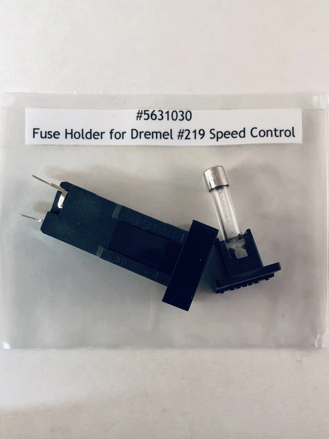

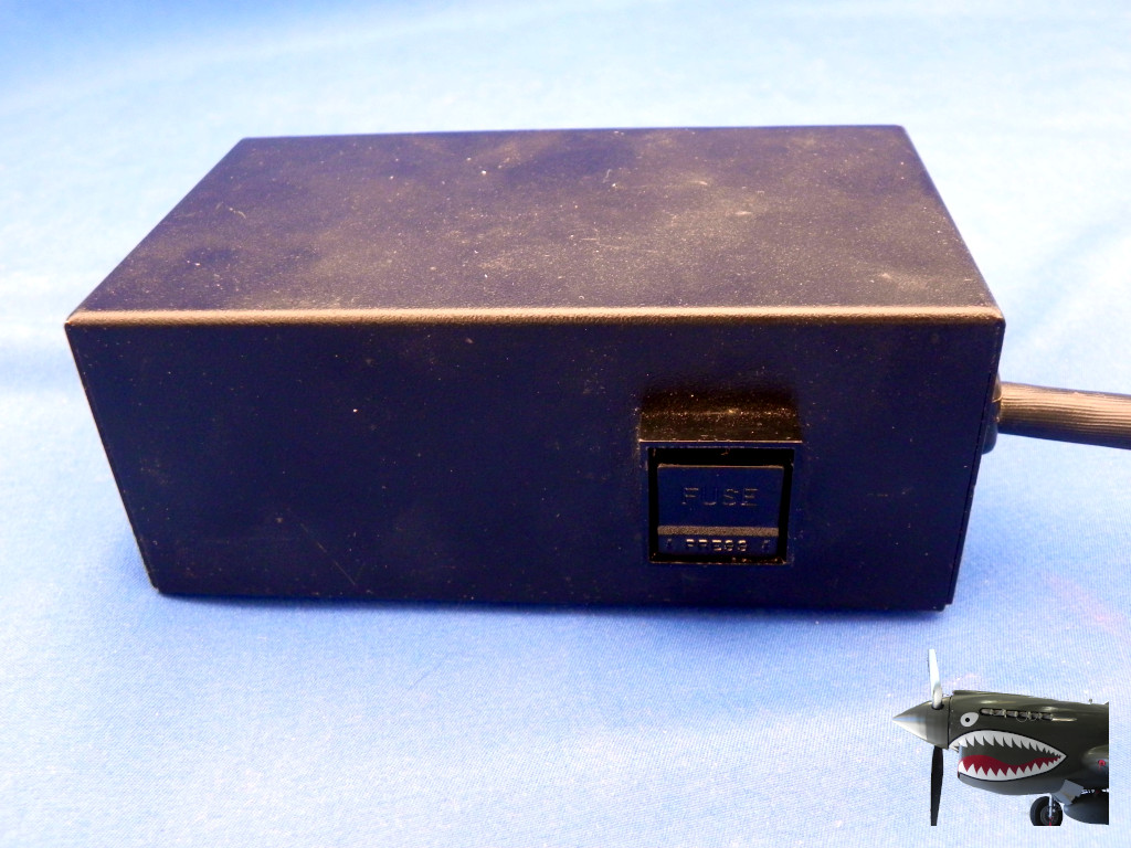

Well, today I got the replacement fuse holder and it fits! I still don't know which size fuse is required.
3544-lg-jpg.158877
Worse, thinking I couldn't get the part, I had a third party software place bids on another (with a $40USD limit including shipping and taxes). I forgot to delete that and I won! A second unit is coming to me. If anyone wants it, it will be $40USD (including shipping) or I will simply replace my rheostat contraption.
dremelspeedcontrolfront-jpg.158864

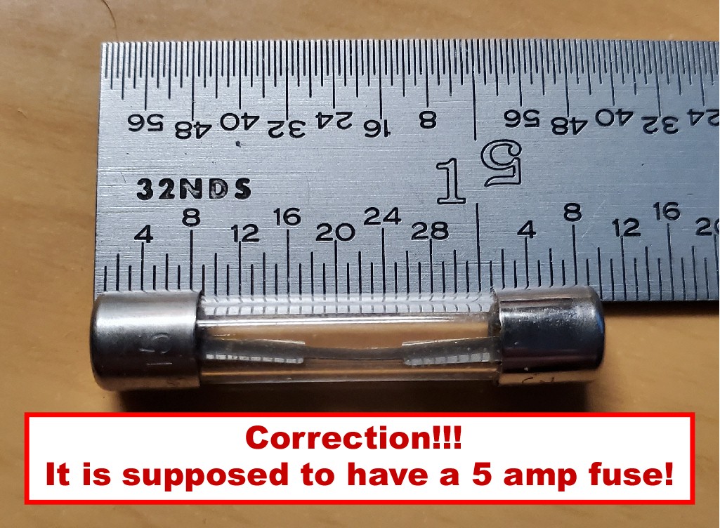

@Sharkmouth I stand corrected! I have had the 15amp fuse in my unit for years after I blew the previous fuse. I found an Ebay photo where they had the Info sheet in full view and it stated to use a 5 amp fuse. You have the size above, and now we both have the correct amp rating for the fuse.
As I have only ever used mine to run a Dremel it hasn't been an issue, but tomorrow I will go to one of the local hardware stores and pick up a pack of 5 amp fuses for my unit.
