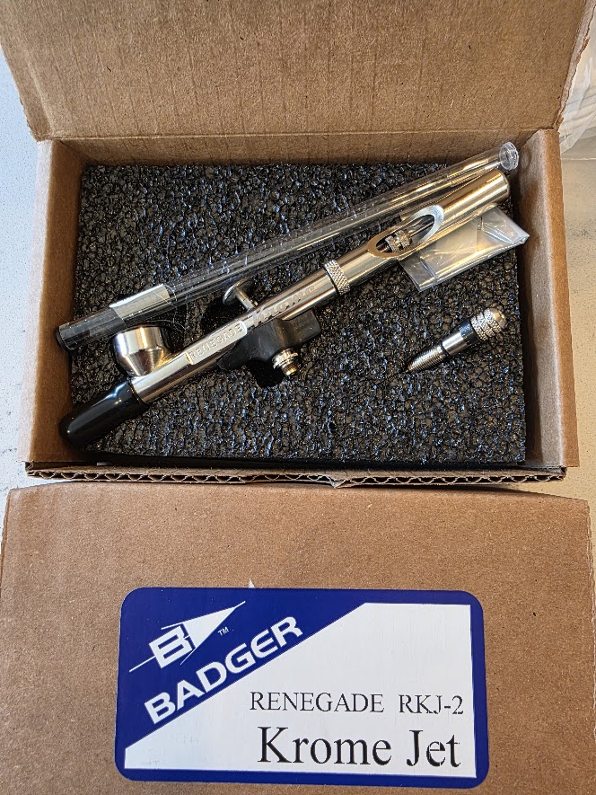

Took advantage of USAirbrush 2 for 1 sale during the 4th and got the new (I think) Krome Jet
I haven't squirted anything yet. It has a .2mm nozzle. Will update when I do.

Of course i'll be sending it back for replacement or repair, whatever they decide. Since it was a 2 for 1 sale, I have another that I will inspect before using.

Kevin at USA Airbrush Supply contacted Ken at Badger, Ken put a stop to my returning the defected airbrush and is sending me a new one instead.
Thanks to both for exceptional service!
All fantastic news guys! Great scores and Kudos to Badger for the customer service. That is why I do love Badger airbrushes.

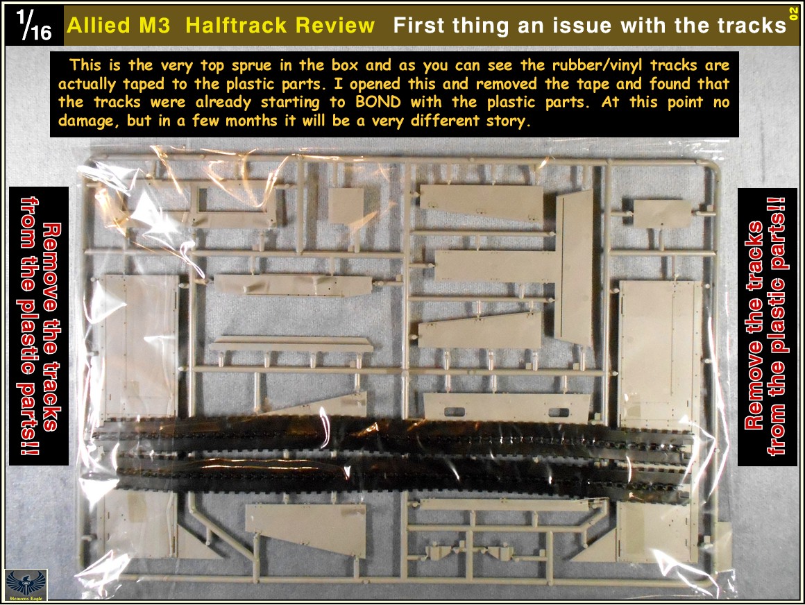

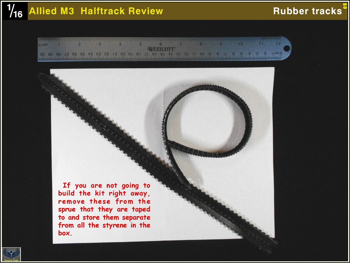

Upon opening the box, the first thing you see is that it is completely FULL of bagged sprues. The topmost bag has a sprue and the two soft rubber/vinyl tracks taped to the plastic of the sprue in the bag. This was a giant red flag to me. Rubber/vinyl on styrene is NOT good.
Do yourself a big favor, open the bag and remove the tracks from the plastic parts.
They are taped on at the ends, but I found that the tracks were already starting to attach/stick/bond to the plastic parts and came off with a lot of small pops as they released. At this point there was no damage, but if they stayed attached for several months to years a whole new sprue might be needed. Better safe than sorry, I wrapped my tracks in some clean packing paper and placed them at the bottom of the box. Other than that, I was fairly satisfied with how the kit was packaged and the parts and sprues all looked as good as could be expected.

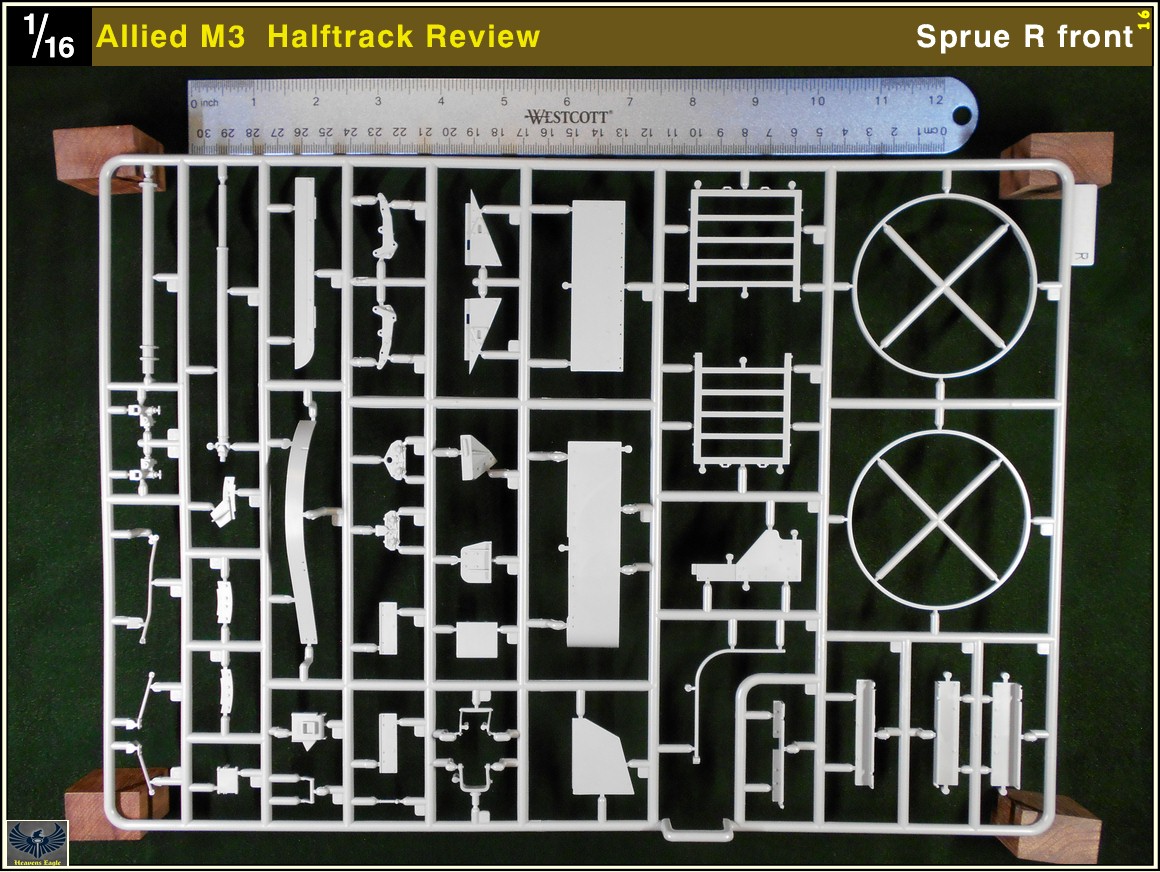

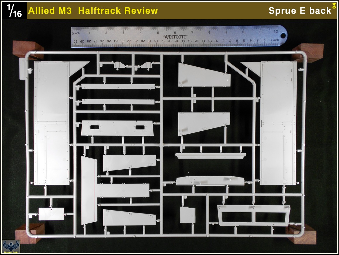

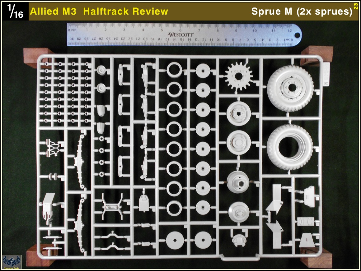

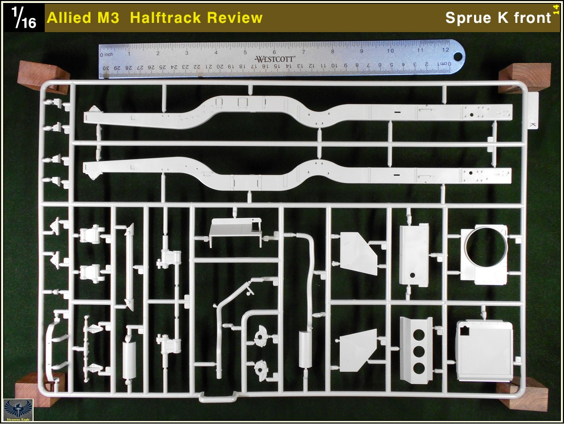

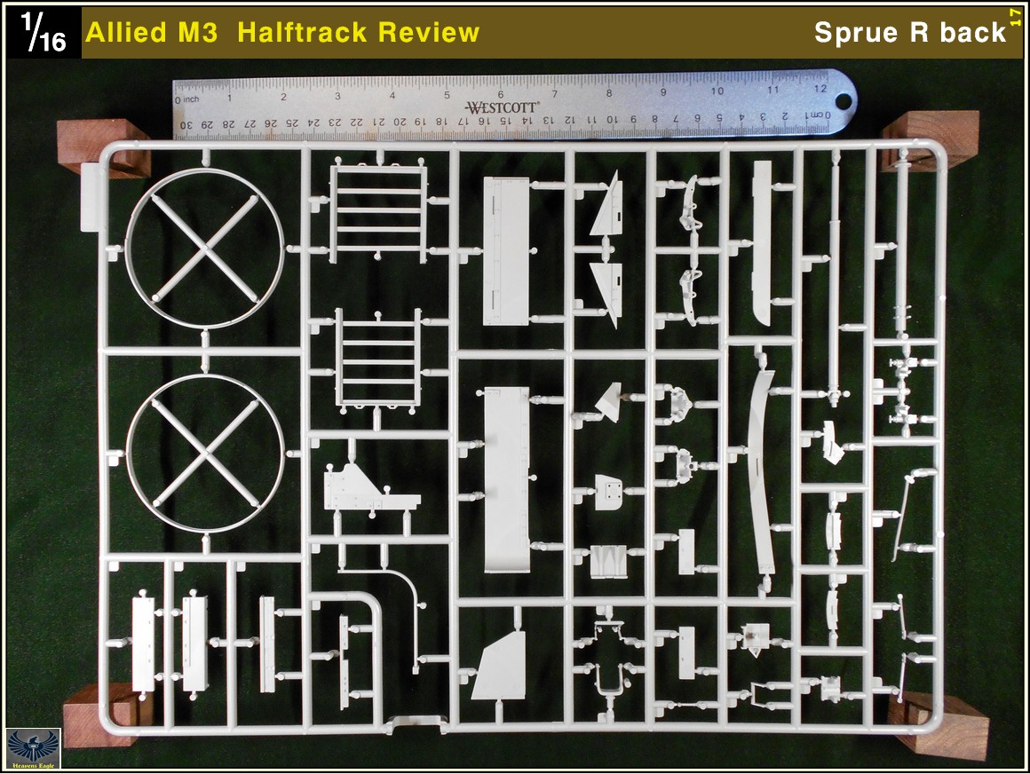

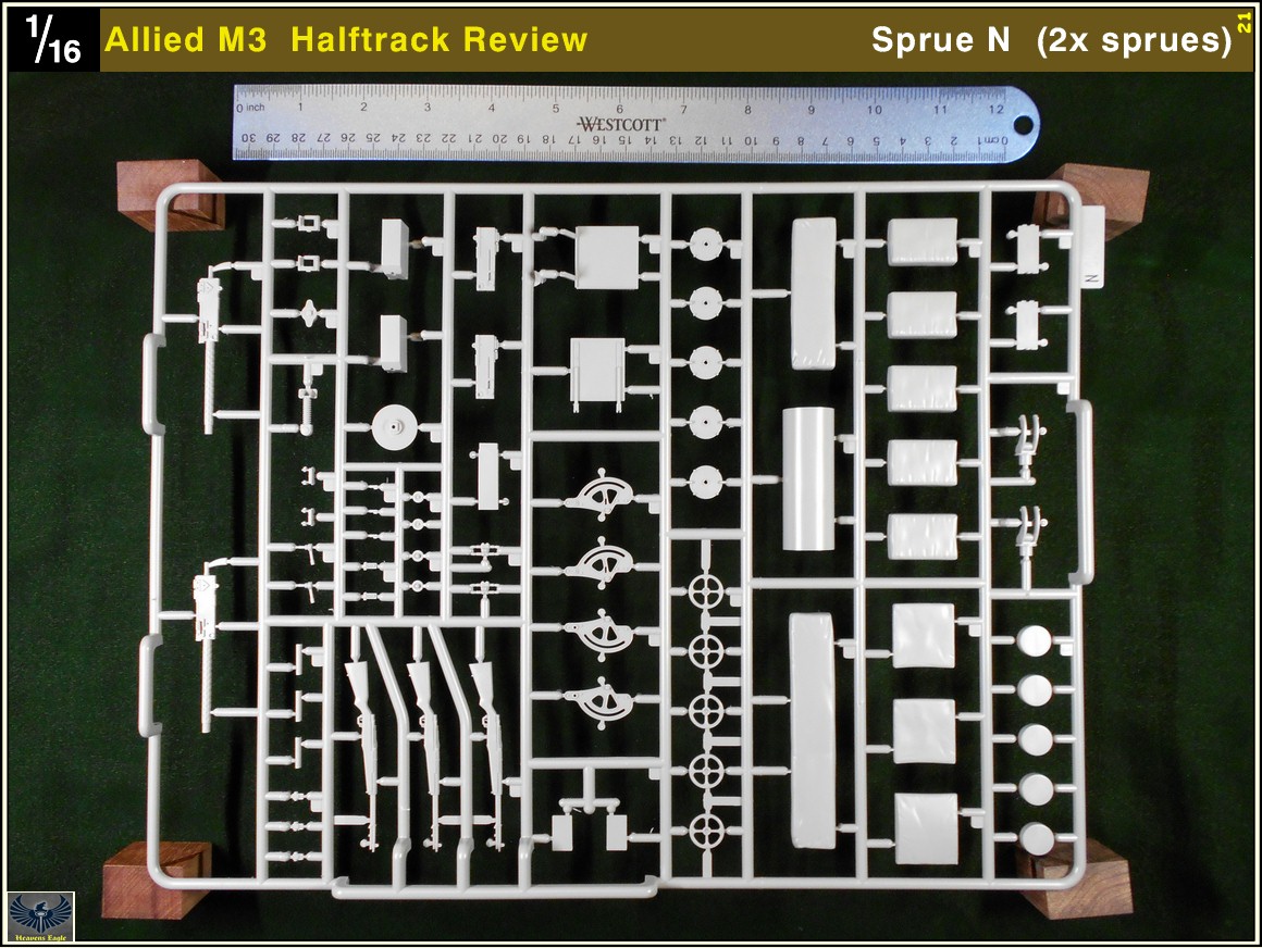

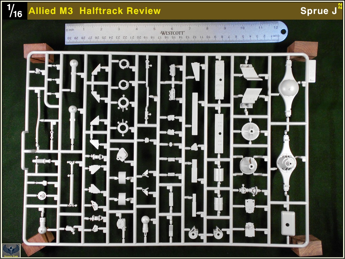

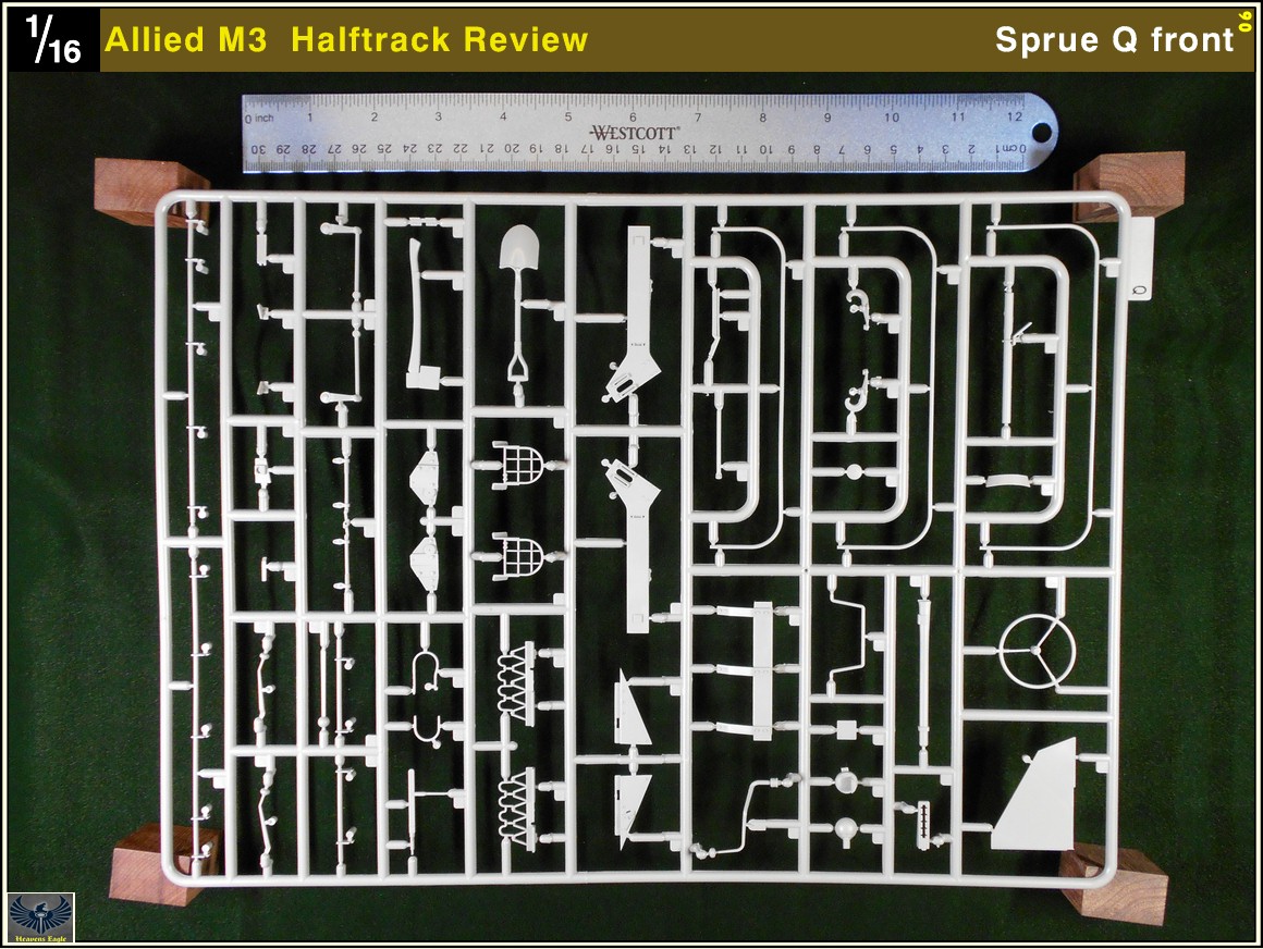

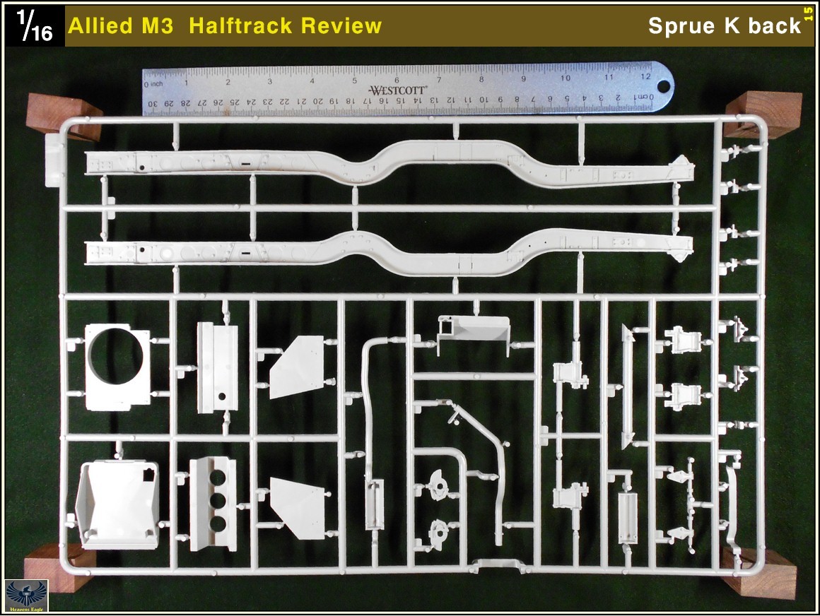

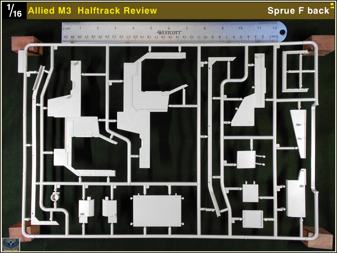

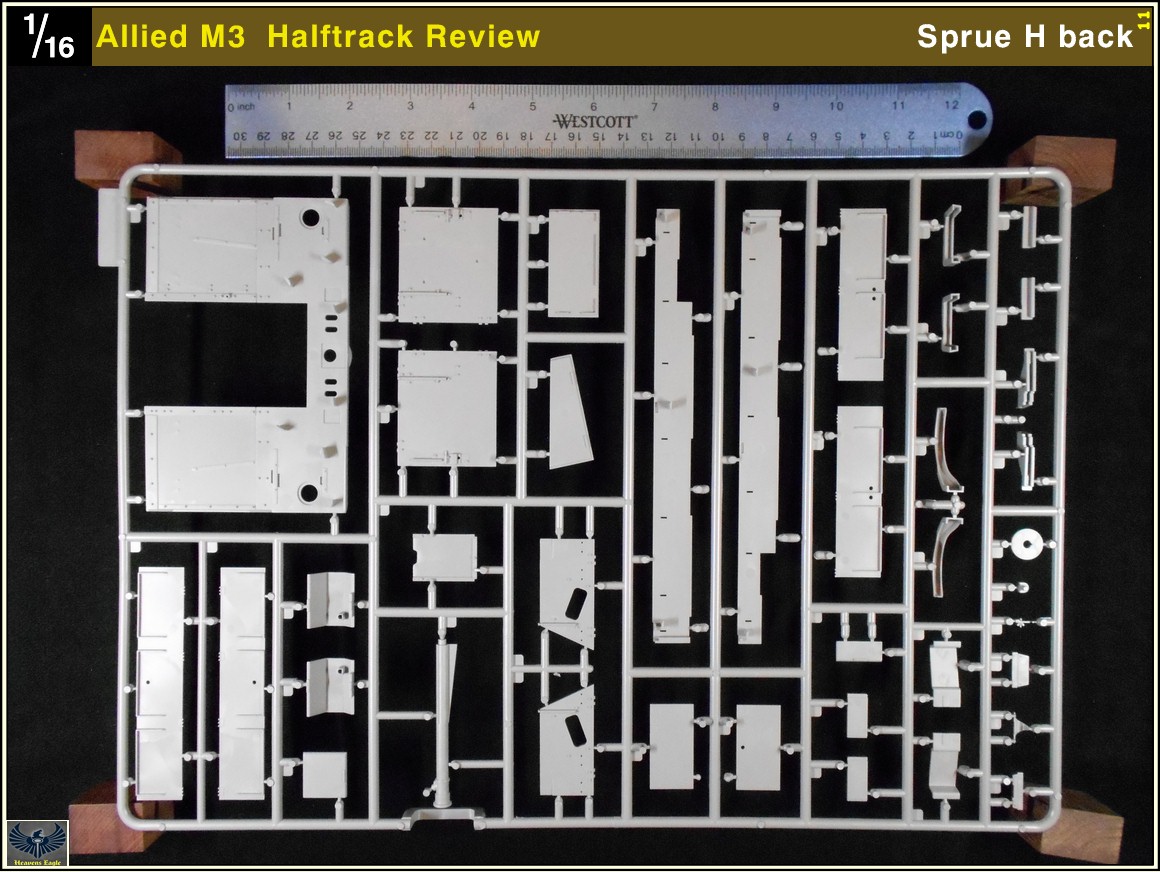

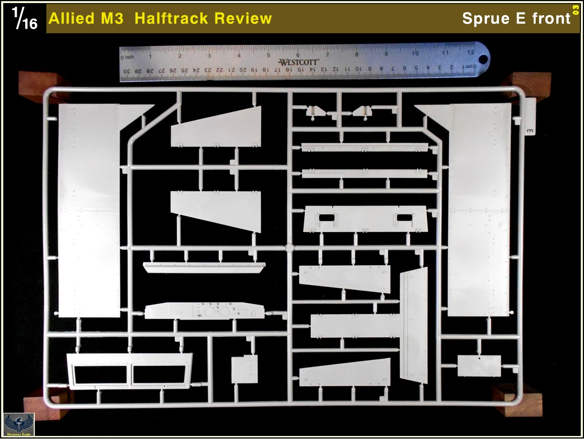

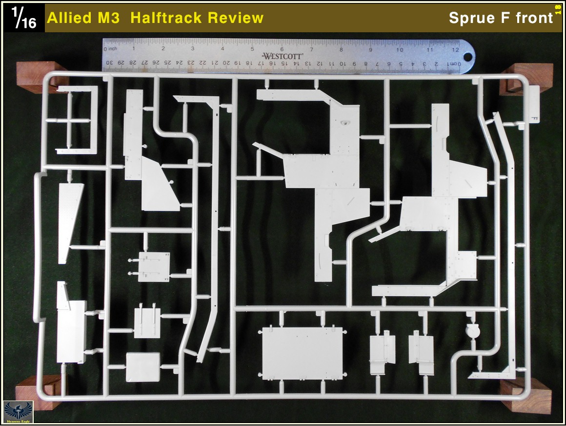

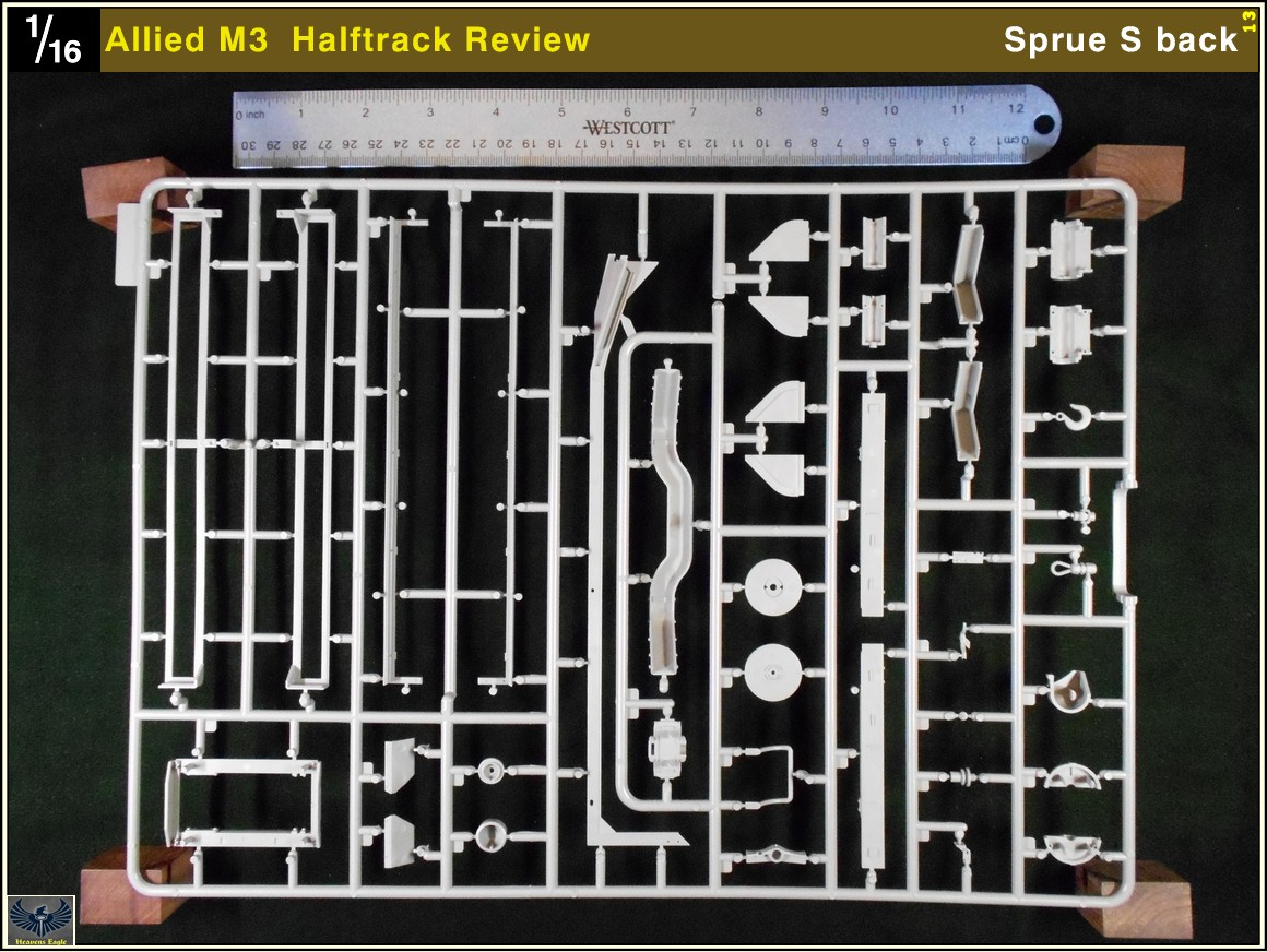

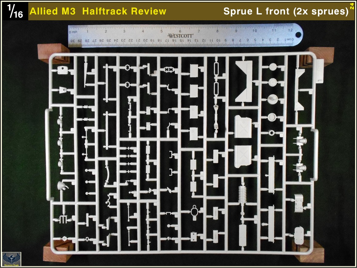

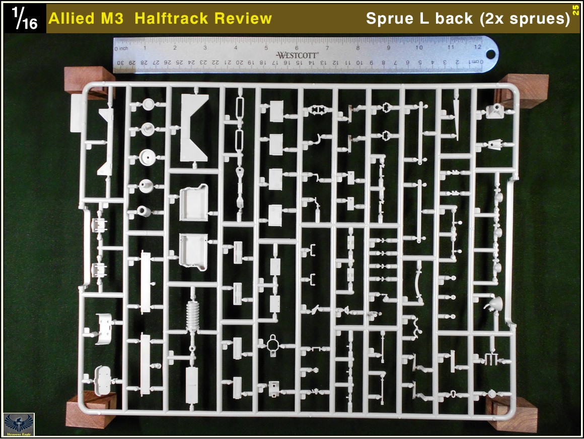

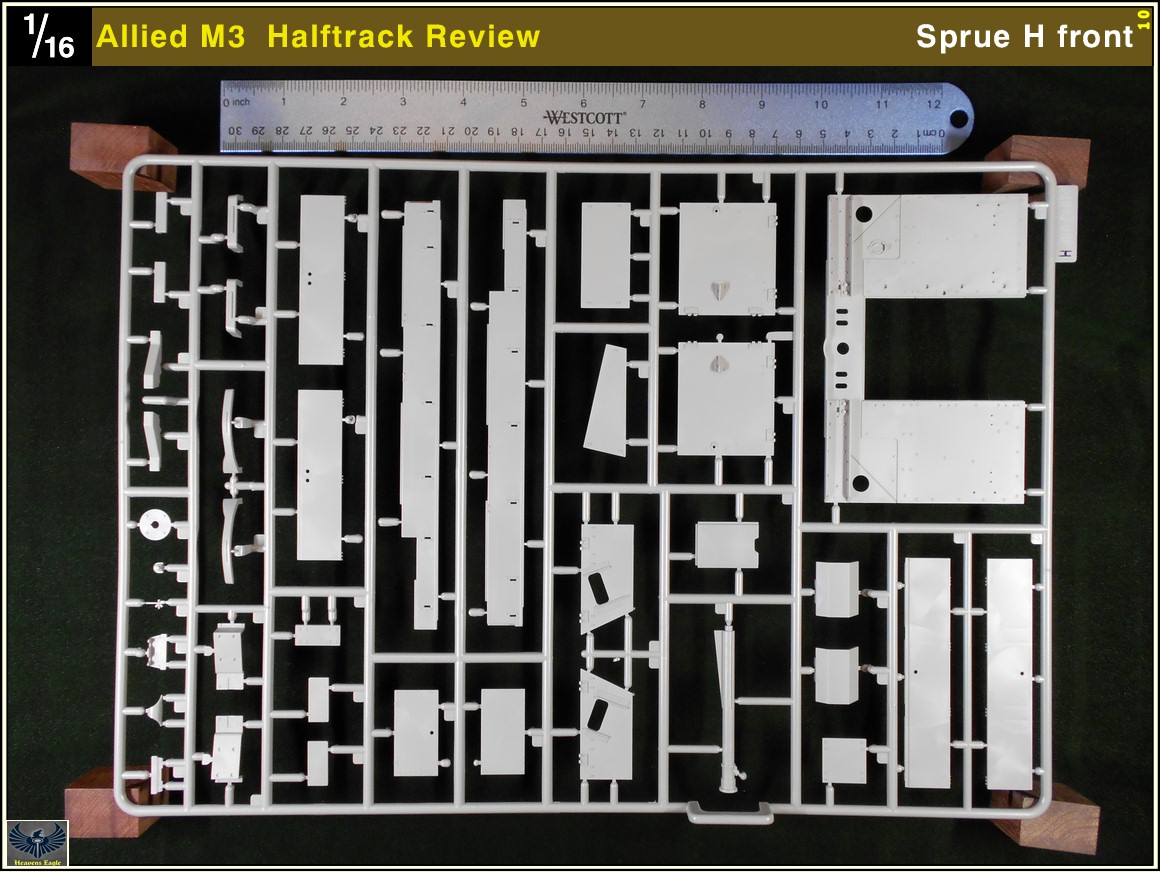

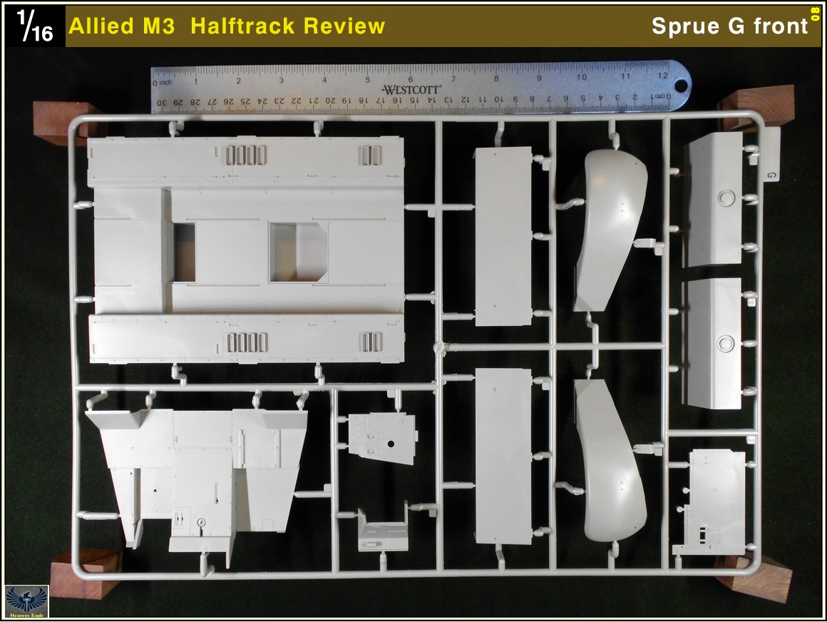

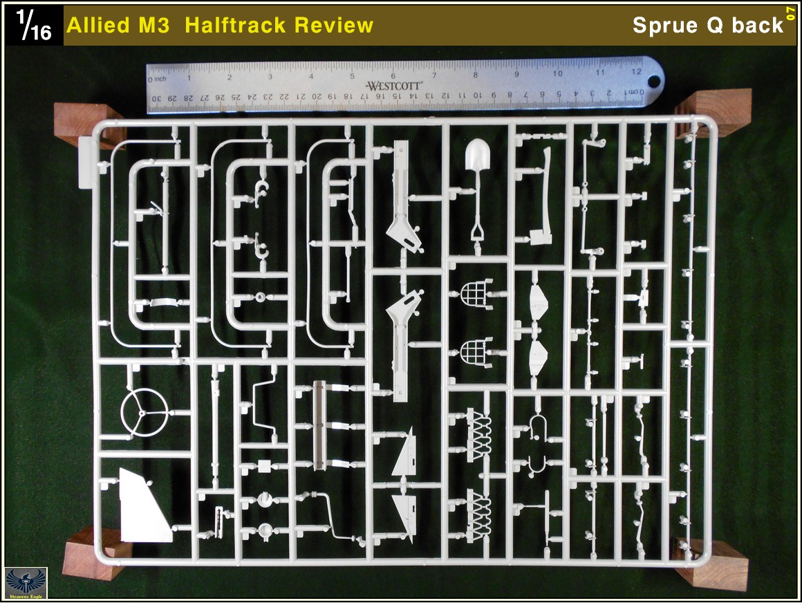

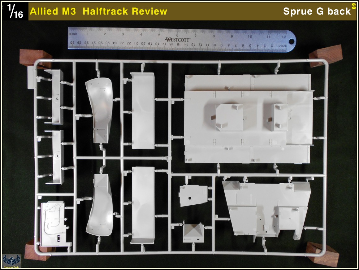

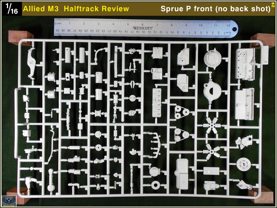

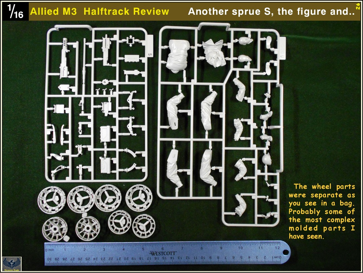

Here are the rest of the sprues.

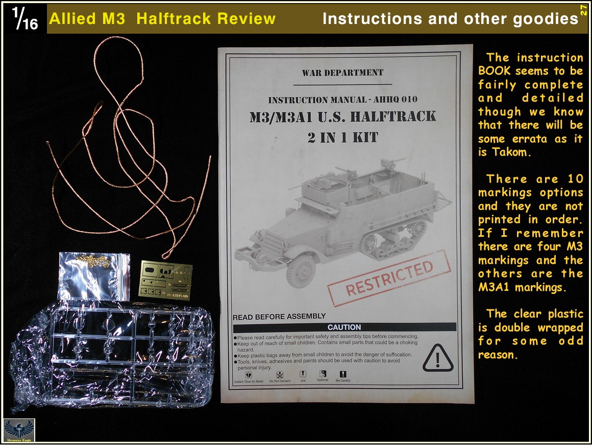

I did not delve into the instruction manual too far. Needless to say it is a small book with a little weight to it. The kit comes with engine, full chassis, drive train and suspension. The front wheels appear to be able to turn left and right. The marking options for the M3 are mixed in with the M3A1 options and there are 10 build options in total. I would suggest a thorough study of the instructions and bit of forethought before starting assembly. In addition some decent reference material will make getting the paint and details that much closer to how a battle worn vehicle of this type would look and be fitted out.
