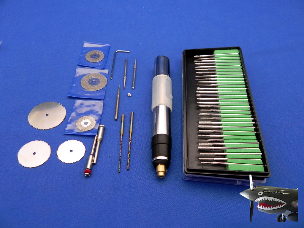

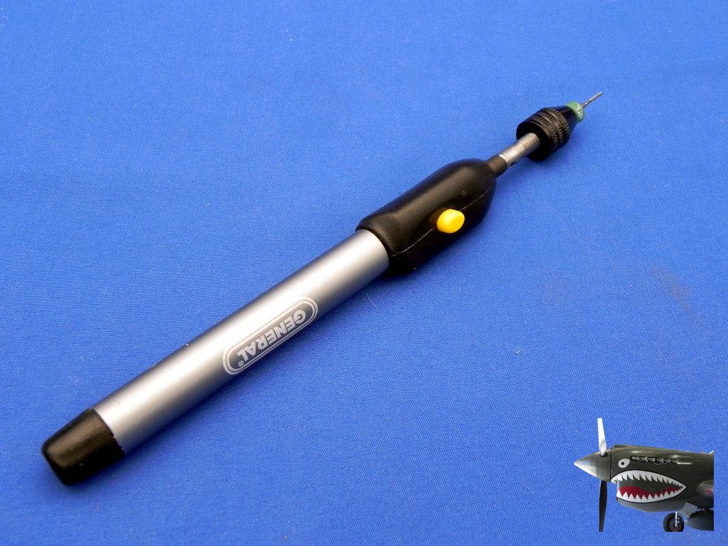

Although I have another by General, this one has multiple speeds and (cable not shown) USB rechargeable. Everything you see (plus a cable not shown) was $15.17USD shipped.

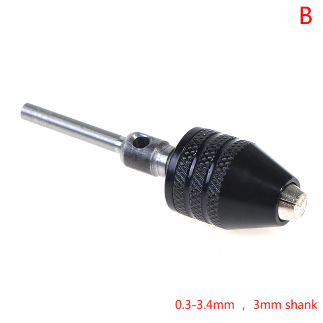

the problem i have with these things is they need a small pin vice to take pin drills rather than a collet system. Also they are usually too fast as the nature of the thing is zero torque. so they melt rather than cut plastic.
The issue i've always had with dremals is the shaft wobble. Since this is named an engraver is it prett steady? How's the torque?
I had read a review of a branded engraver someone raved about and copied the specs. This is what I used to search for the engraver and the resulting one I chose has these specifications. I will test it out soon.
"Electric Drilling Etching Pen Professional Cordless Engraving Drill 3 Gears Adjustable DIY Power Tools for Ceramic Metal Plastic

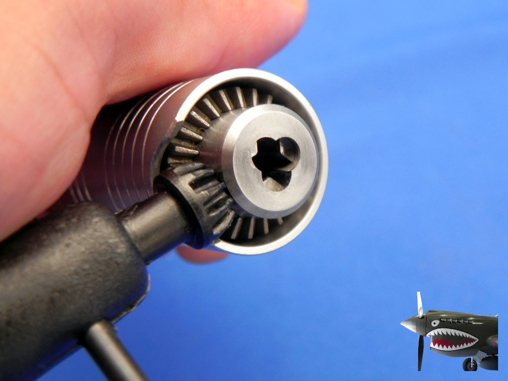

My issue is that it has a 3mm collet secure by a screw. No chuck is included. I bought a 3-jaw chuck for the General engraver which was 5.1cm long and wobbled since the weight of the collet is away from the pen. Since the opening on this one is 3/32nd inch (a bit larger) the wobble was expected once I tightened the screw.
Hopefully this new engraver is a tighter, and less wobbly, fit with the 3-jaw chuck.
The new engraver does go down to only 5,000 rpm so it may not melt plastic.
I think the wobble you all are talking about is with the smallest collet which is for holding say a #80 drill bit. I agree with that though the real issue isn't the drill motor, but the collet itself. I think I have found maybe one collet in all the ones I have bought that actually ran somewhat true. Even the larger collets can have a little wobble. I do have a set now that are pretty true for my Dremel. It just took buying several sets to get it that way.
As to the speed issue, most of the better quality flex shafts (for actual jewelry work can run quite slow. I don't really like the flex shafts though as they can grab and yank and then the shaft will make the tool move around.

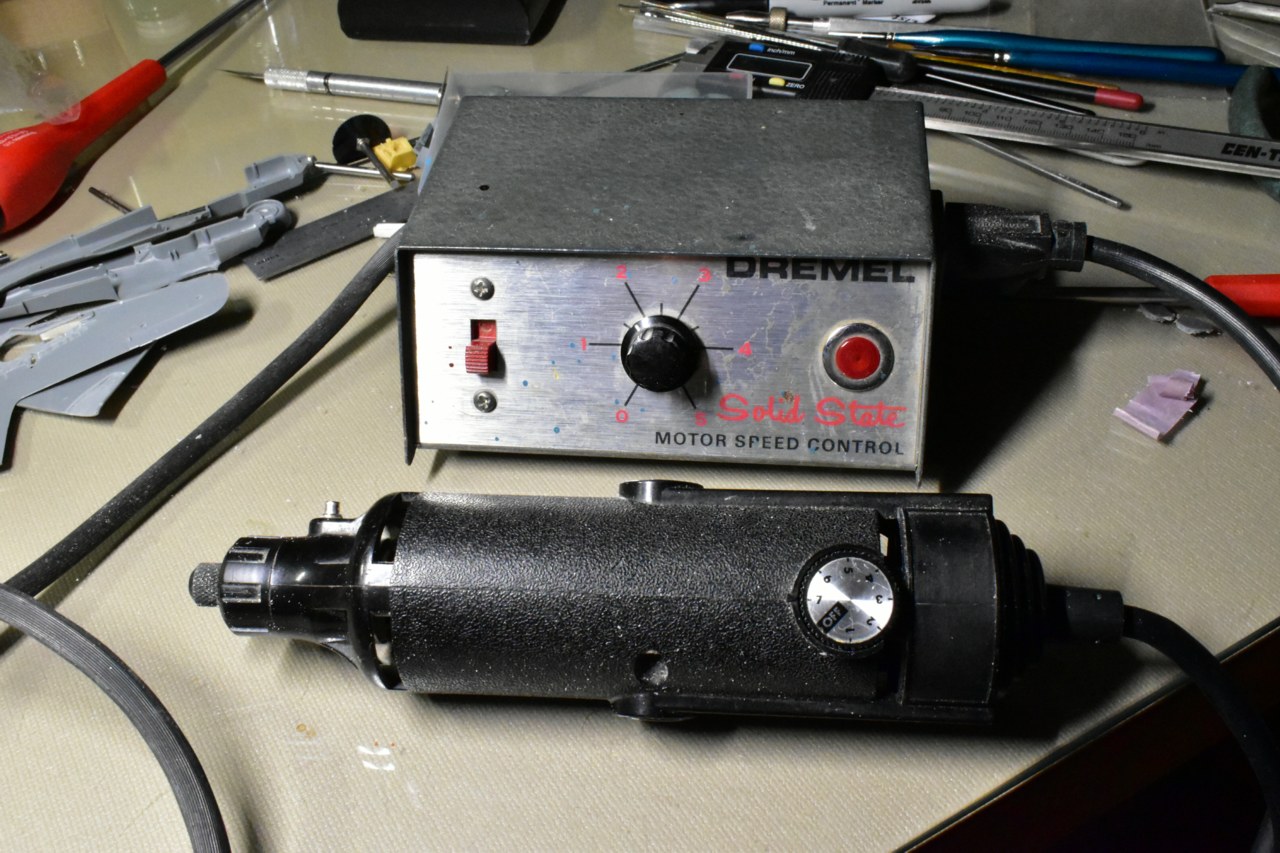

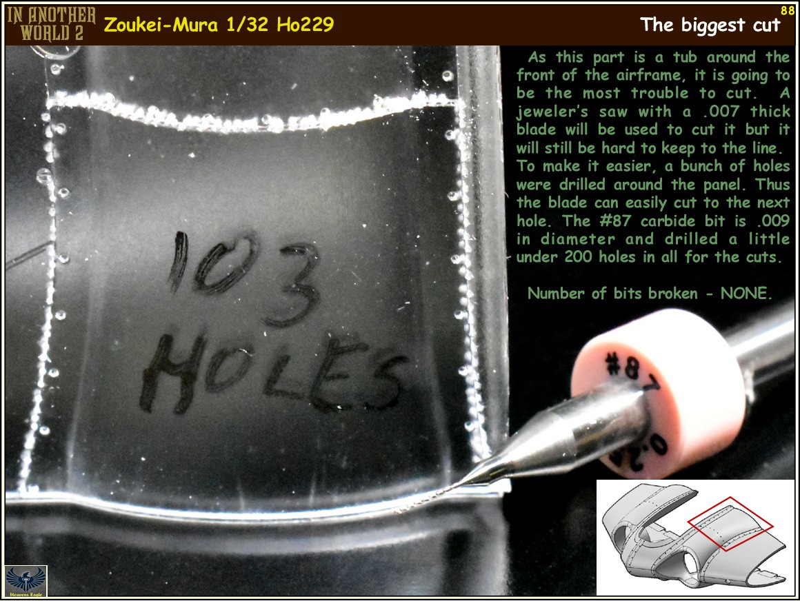

The variable speed Dremels (and most of the other hand held units) all run too fast and of course melt their way through the plastic. Years ago I had the opportunity to use the Dremel variable speed power supply. I have shown pics of it on here before. I won't use my Dremel without it as I can control the speed way down to zero. When you are talking about 5 thousand RPM, I am talking about a few HUNDRED RPM! Which do you think will melt plastic faster.
I used my Dremel with the speed control to drill way over 100 holes with a #87 (.009inch or .23mm) carbide drill bit in clear plastic, and DID NOT break the bit. While I do have very steady hands, the bigger part is having really slow speed control. These speed controls are still a reasonable price on Baywatch and will work with ANY plug in Dremel.
Note the old Vari speed Dremel and the speed control is all the way full on. The "Box" works better than the switch ever thought about working. With the switch turned on high it works great. If it isn't it does some weird stuff and you will "KNOW" that it isn't full on.
The only thing that drills better and more true is my mill and there are quite a number of things that it just cannot do.
I actually used this unit to drill thousands of holes in hundreds of prototype fiberglass circuit boards and mostly wore the carbide bits out.
One other thing, This Dremel is about 35 years old. Not running it at high RPM has also greatly lengthened how long it is going to last.

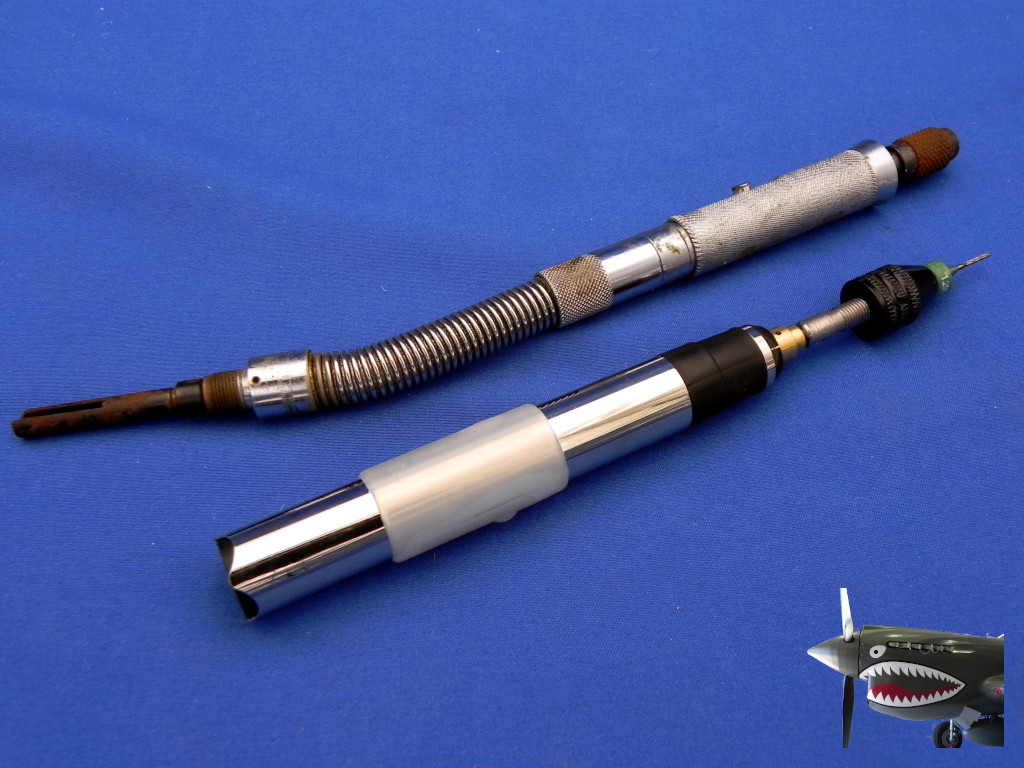

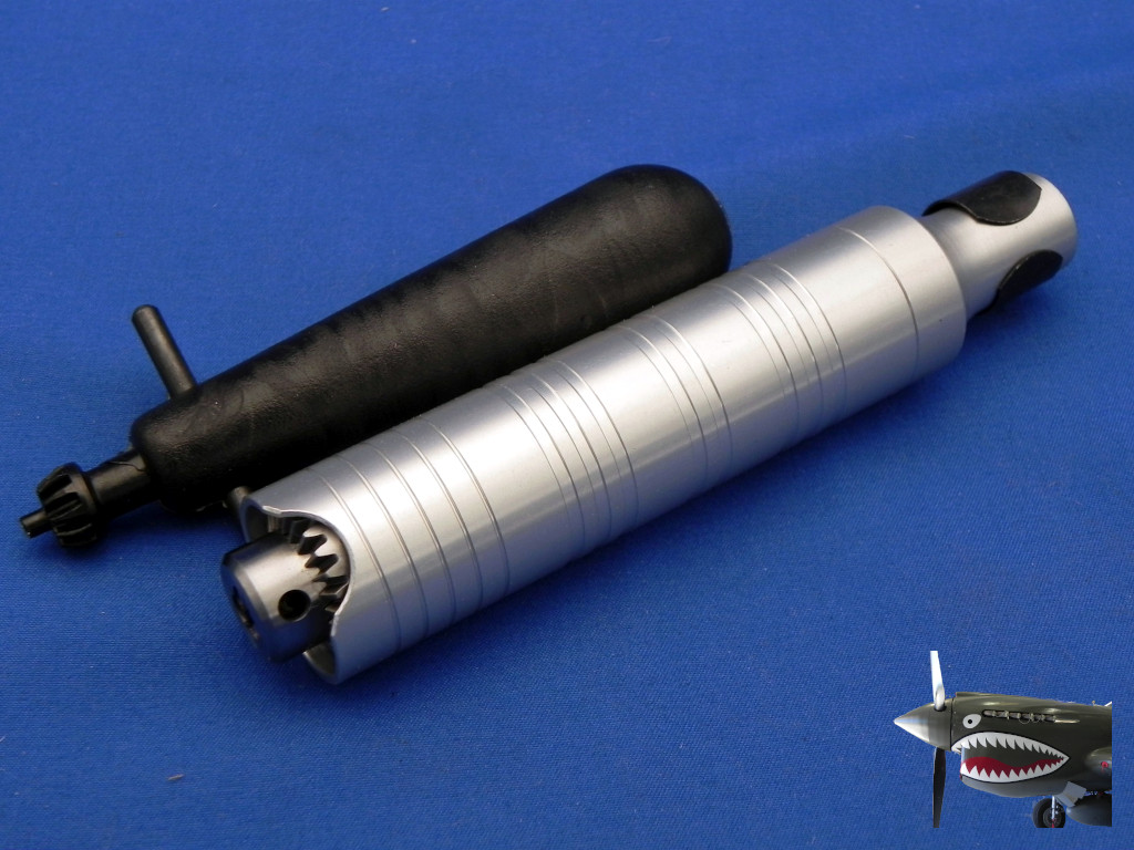

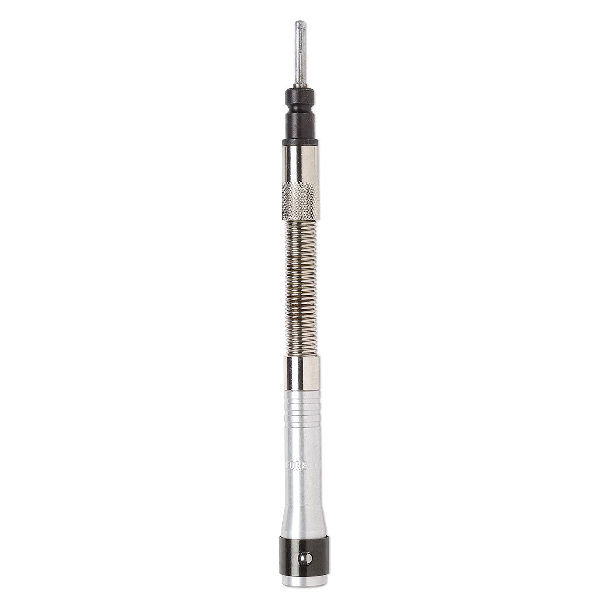

I bought a newer Dremel with came with a flex shaft and was designed for the vertical press I had. However, my main flex shaft is from Foredom (got it from a dentist) but I use a foot pedal to control the speed. The only awkward thing about the Foredom if that the motor housing is designed to be hung as it has no feet. Since the flex shaft is starting to bind, I will need to replace it.

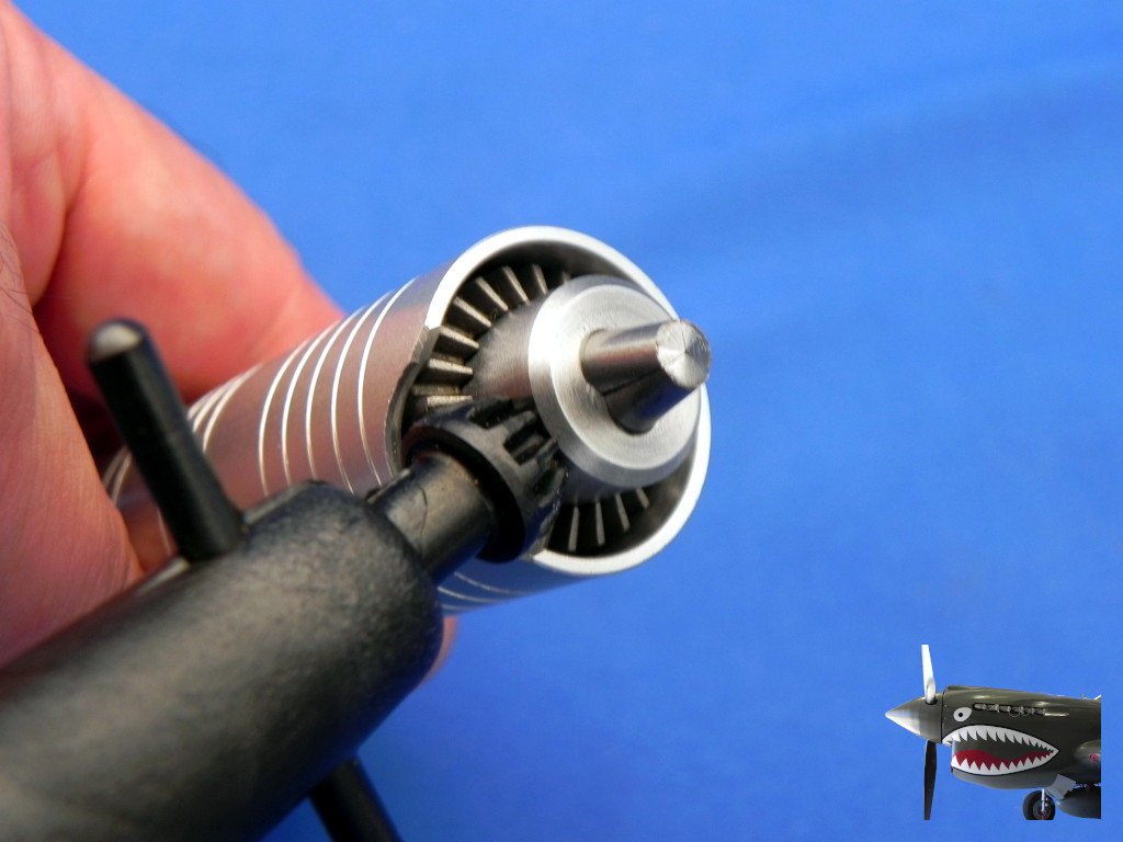

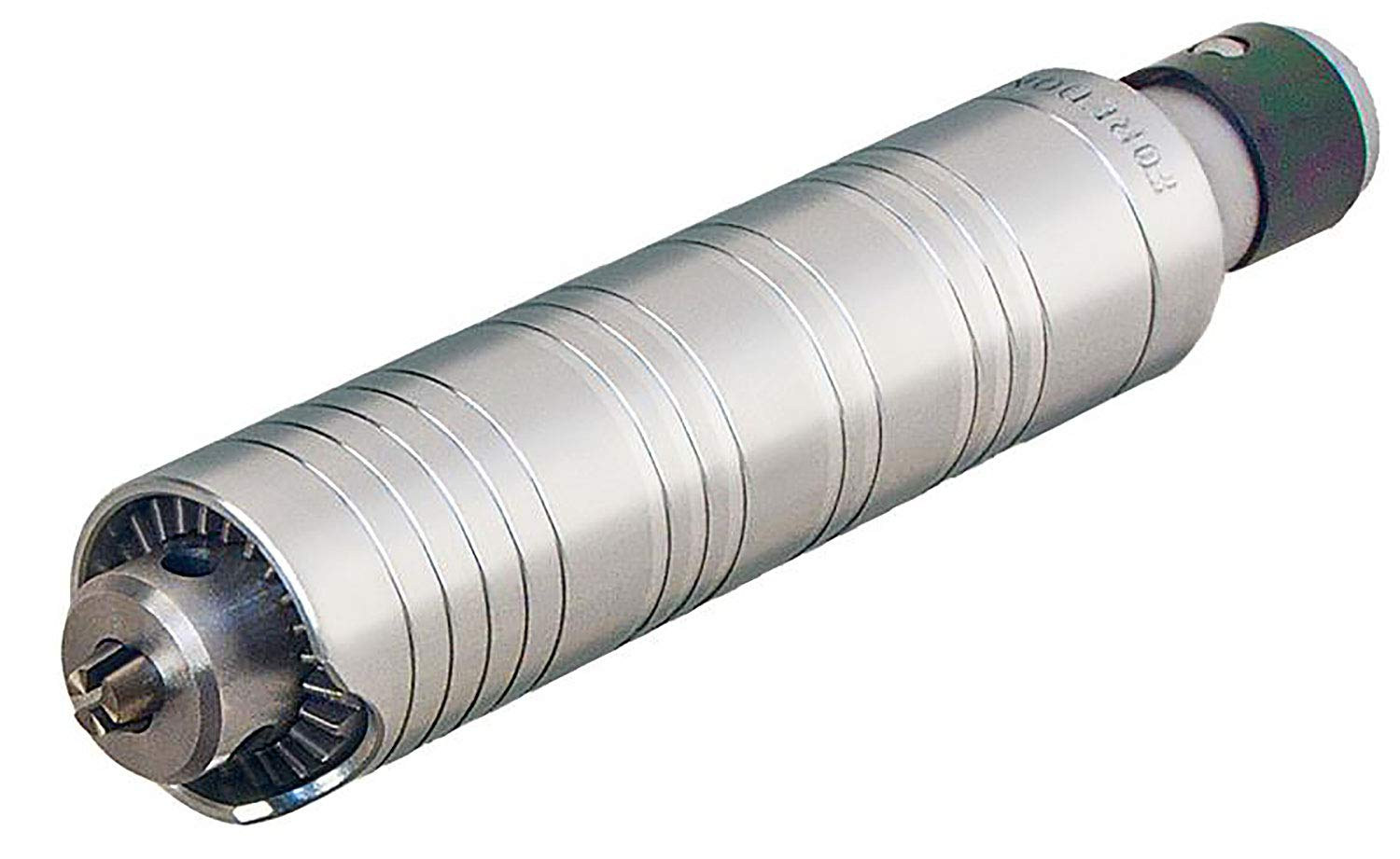

Tested the Foredom CC (F Motor) and it is the duplex spring in the handpiece that is damaged. It turns but slowly. Replacement is expensive because of the duplex spring. Here is that rusty piece with the new engraver holding the chuck.
So, I have ordered the 3-jaw (Jacob) H.30 handpiece which should arrive tomorrow. The extra flexibility of the duplex spring isn't there.
If I find I need it, I can get a duplex spring adapter separately.
A nice thing about the Foredom motor is that it starts slow and builds up speed until the limit (which I set from the foot pedal). This handpiece allows me to use more tools and bits than the previous one. The check wrench does have a strange and cheap feeling plastic handle.

A nice thing about the Foredom motor is that it starts slow and builds up speed until the limit (which I set from the foot pedal). This handpiece allows me to use more tools and bits than the previous one. The check wrench does have a strange and cheap feeling plastic handle.View attachment 154285
As tight as it goes...
Say ahhhhh...

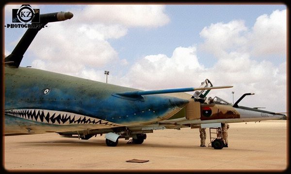

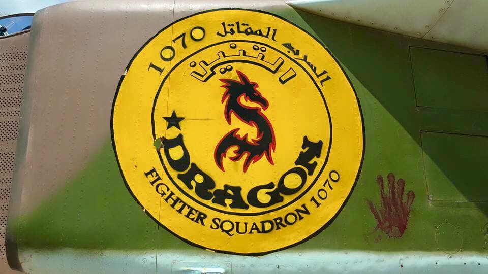

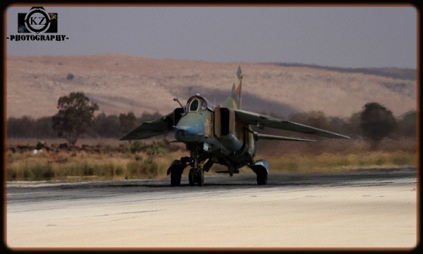

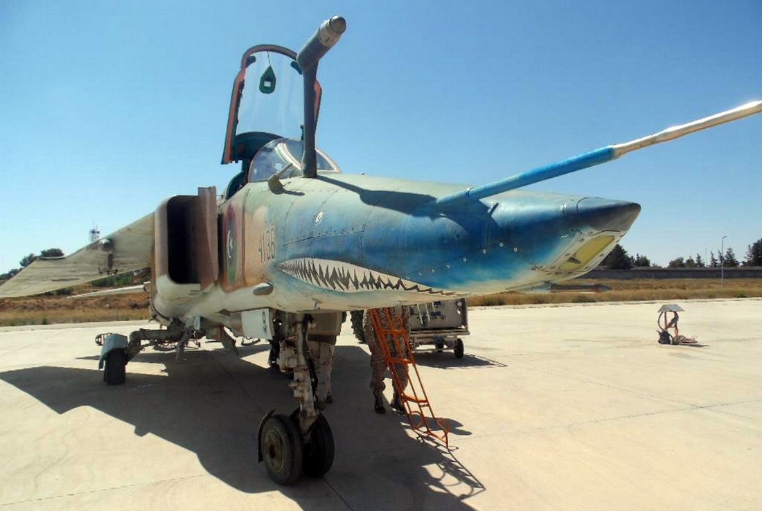

Added to my 48th scale Trumpeter MiG-23BN box (for one of the Libyan Sharks):
I prefer 4136
