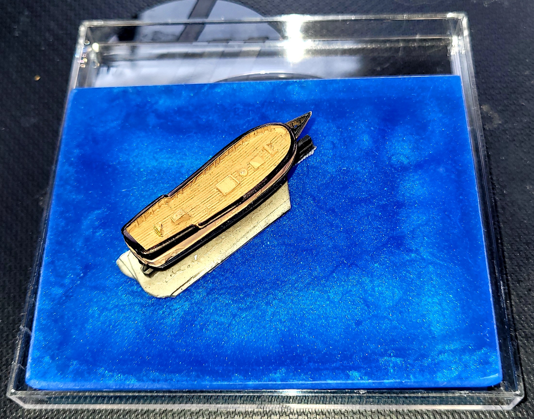

Teresa made the cool ocean-ish resin base. I bought some clear plastic boxes to transport and store the sailing ships in. I hope to use the lids as bases and the boxes as covers. She's pretty sure she can make a blue base that fits the box top a little better. No dust or spiderwebs for the Antelope! The Wind Breaker and Nancy schooners will get similar housing!

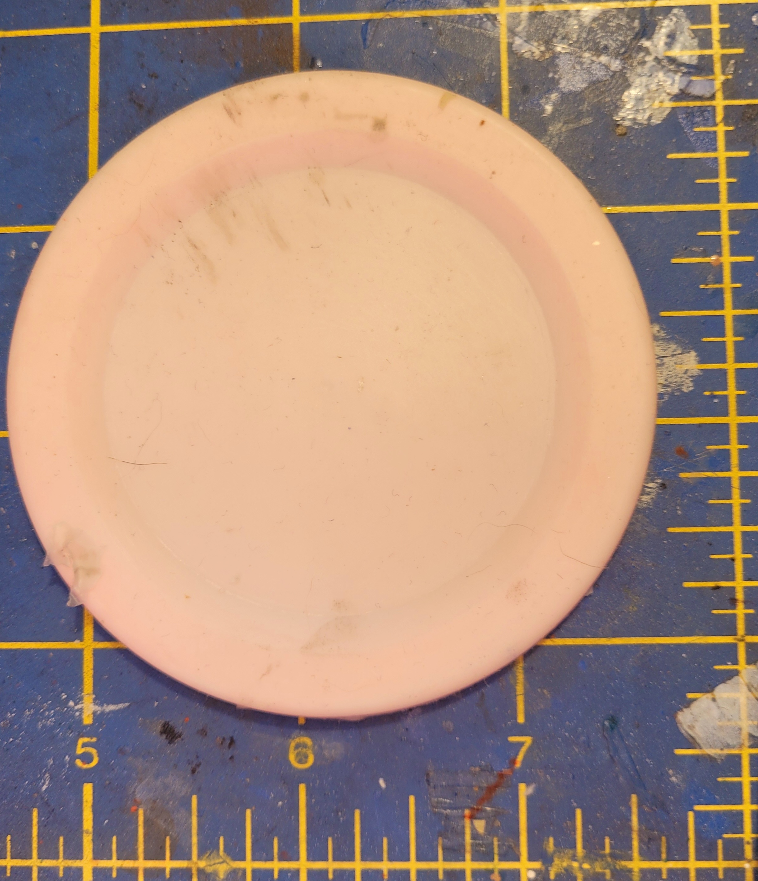

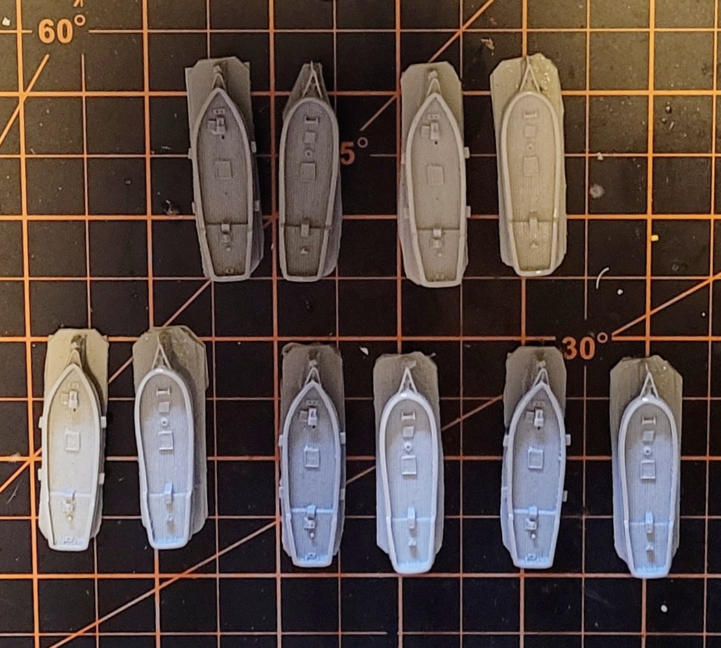

During the course of mold making, sometimes I mix a little too much RTV. Since nothing ever goes to waste here, these leftover bits make dandy pads for gluing small plastic parts together. Styrene and MEK do not stick to the silicone rubber pad.
The color makes it easy to find and contrasts with almost every color of plastic/resin.

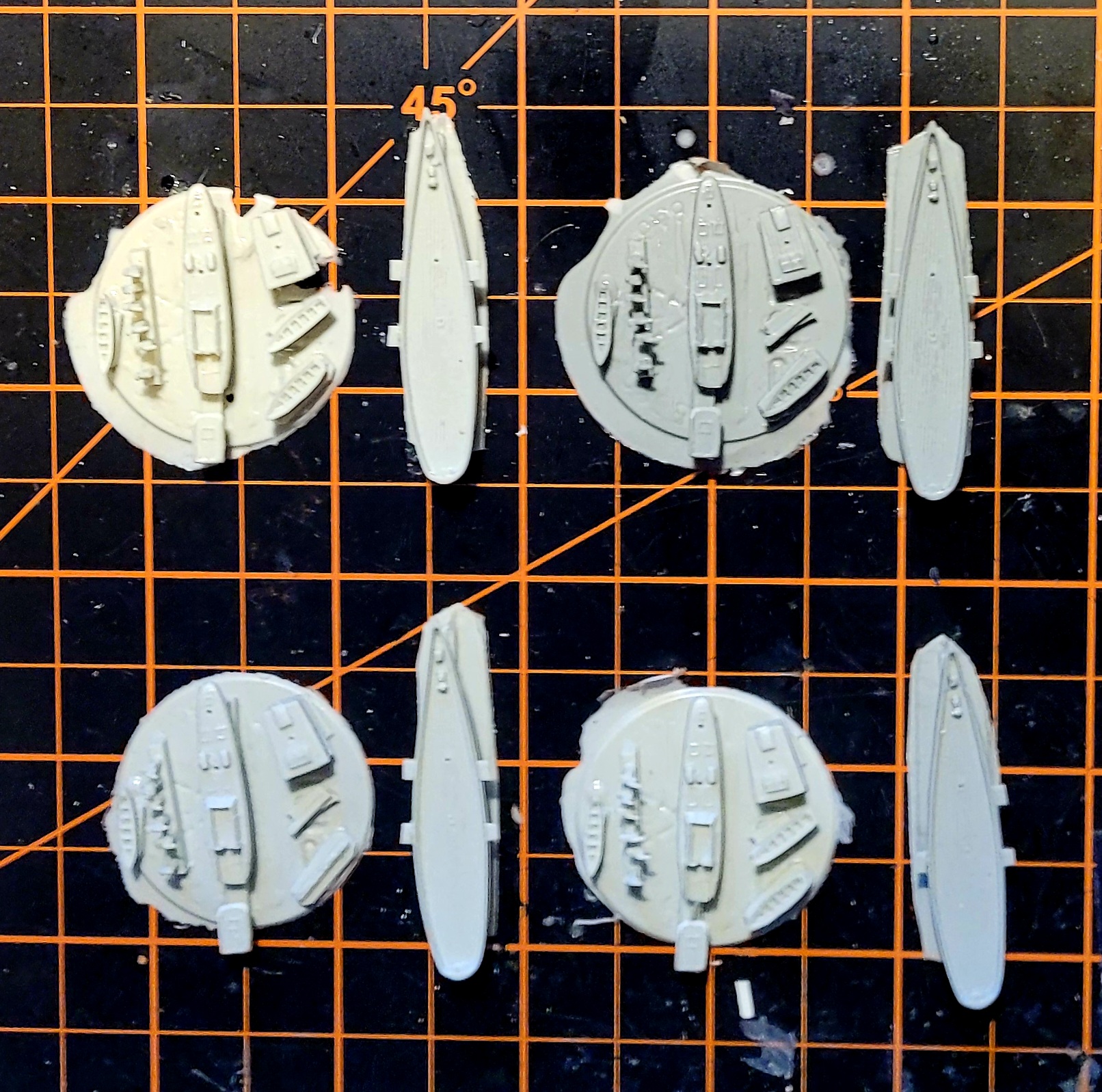

Here's little peek at what "Manufacturing" actually looks like.

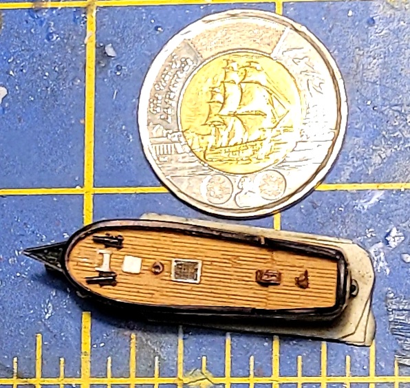

Nancy and Antelope will go to market as a set of War of 1812 Canadian Warships.
The 2/3rds size Baby Bluenose/ Wind Breaker schooner could be built as a working1920's fishing boat, a swift Privateer or a luxury yacht.
The Bluenose & Cleopatra schooner set, with modern boats for Cleo is still underway.

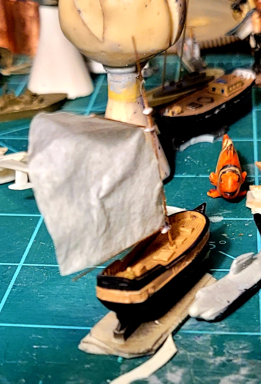

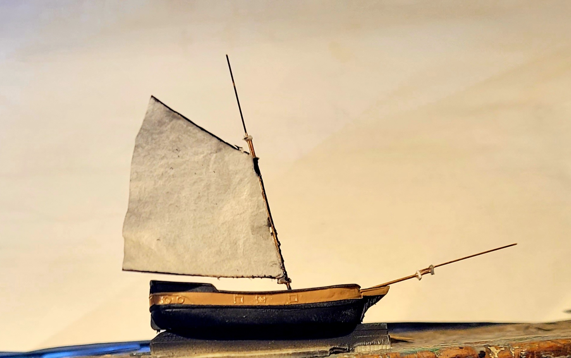

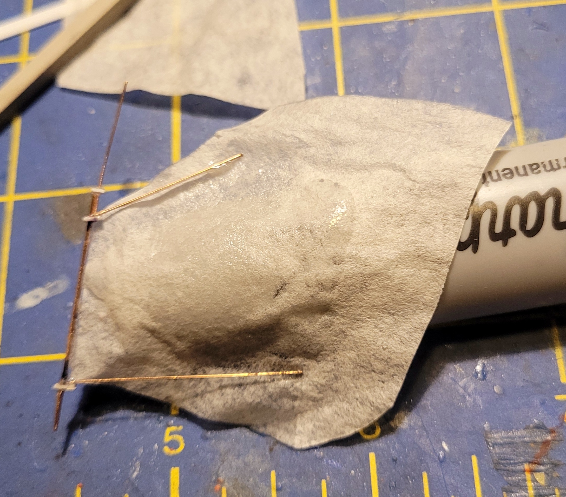

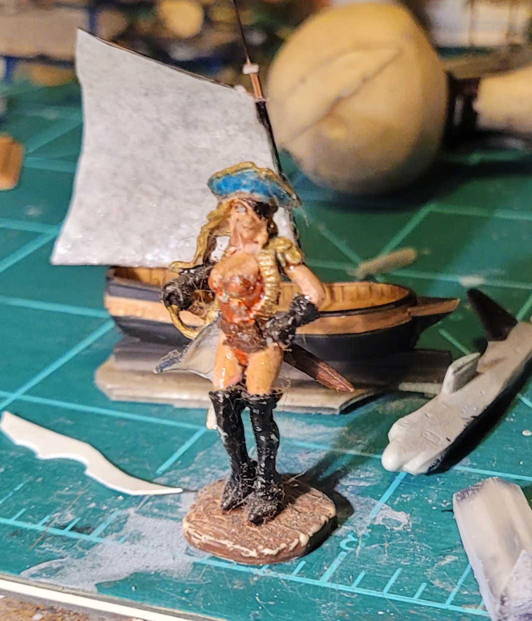

First Mainsail attempt. Not exactly what I wished for. In truth, this looks like hammered dogshit!

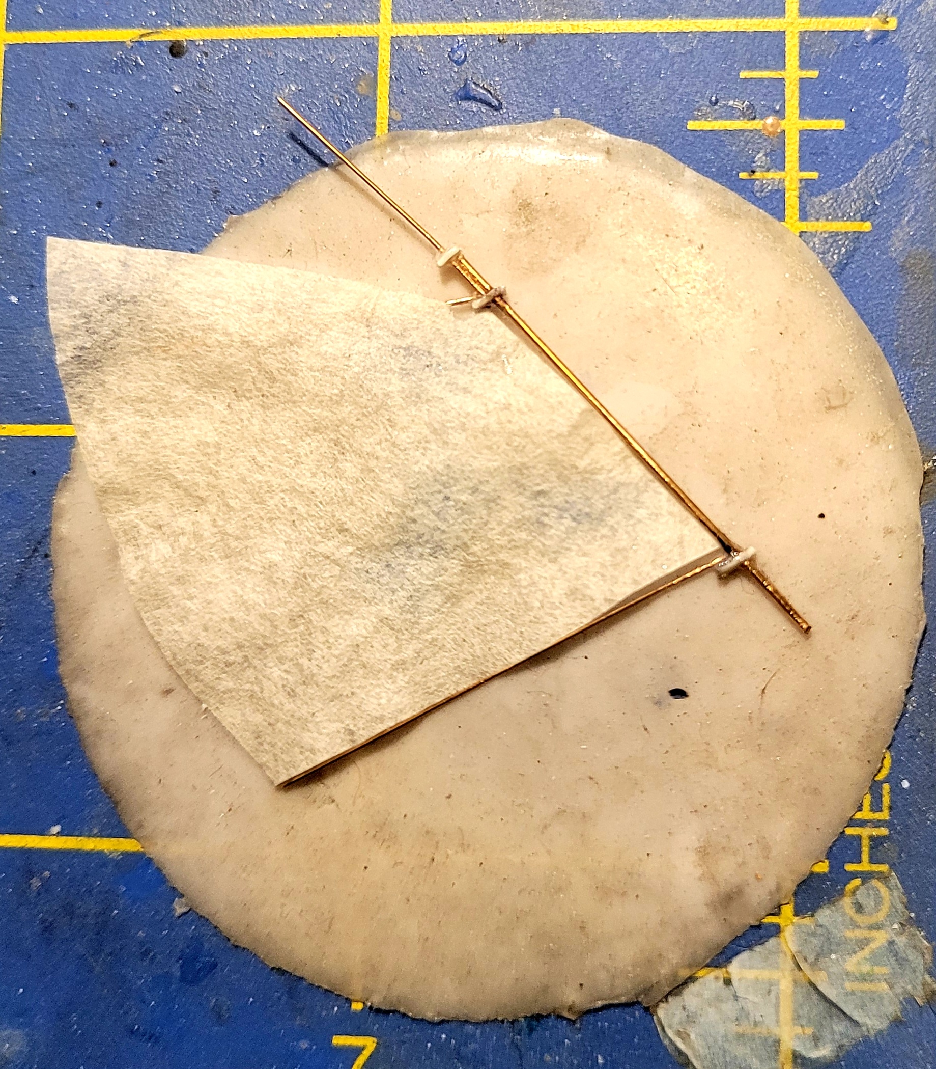

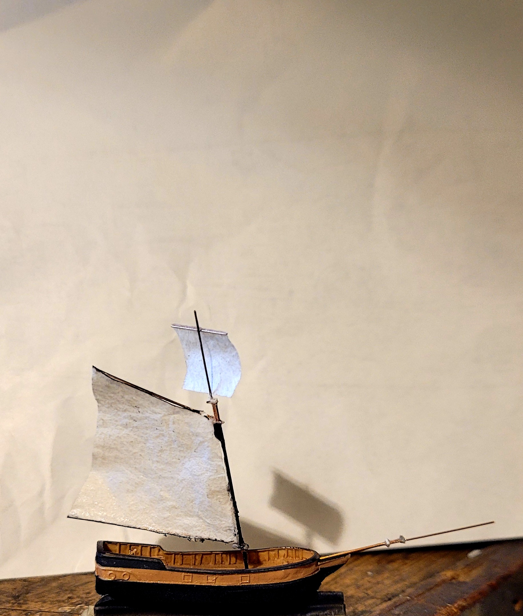

Second attempt: It's been a long time since I did Dynamic Geometry in my head. Dampen the gelatin treated coffee filter, lay it over a curved surface, tack it to mast & boom gently.
BETTER! only 6 more sails to go on the Antelope sloop!

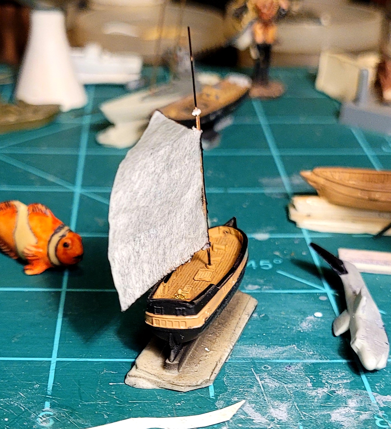

Another picture of the Antelope.

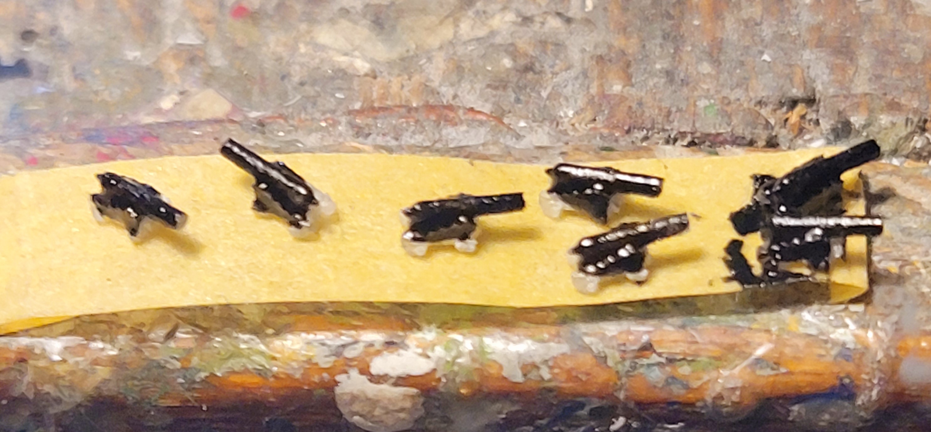

The fun continues! Stan Rogers tells us the Antelope sloop carried "cracked 4-pounders" and I did make some and cast them too.

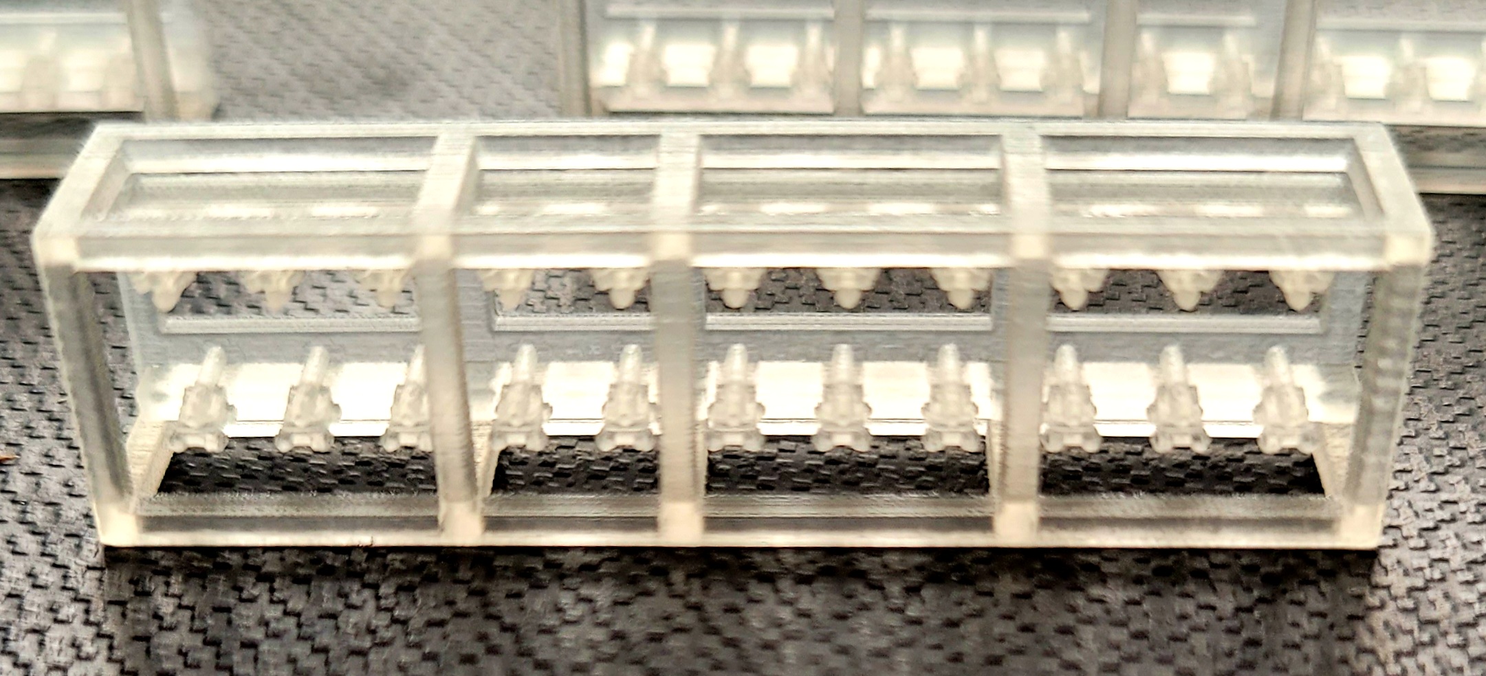

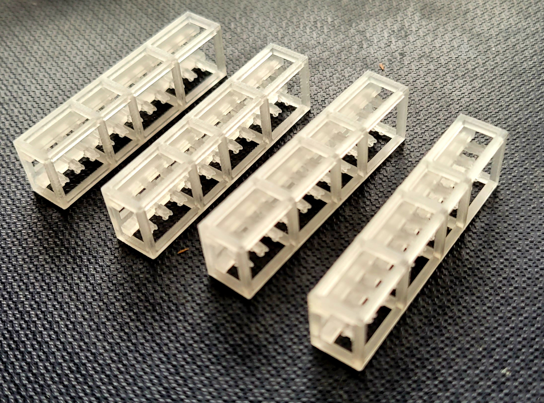

Without consulting The Board of directors, I made the decision to include 3D printed 9 pound cannons in both the Antelope and HMS Nancy TLAR Models kits. My version of Stan's imaginary privateer Sloop has the capacity to carry 10 cannon. How many guns will you choose? Resin cracked 4 pound or cool-looking 9 pound guns? You get both. Decisions, decisions........................

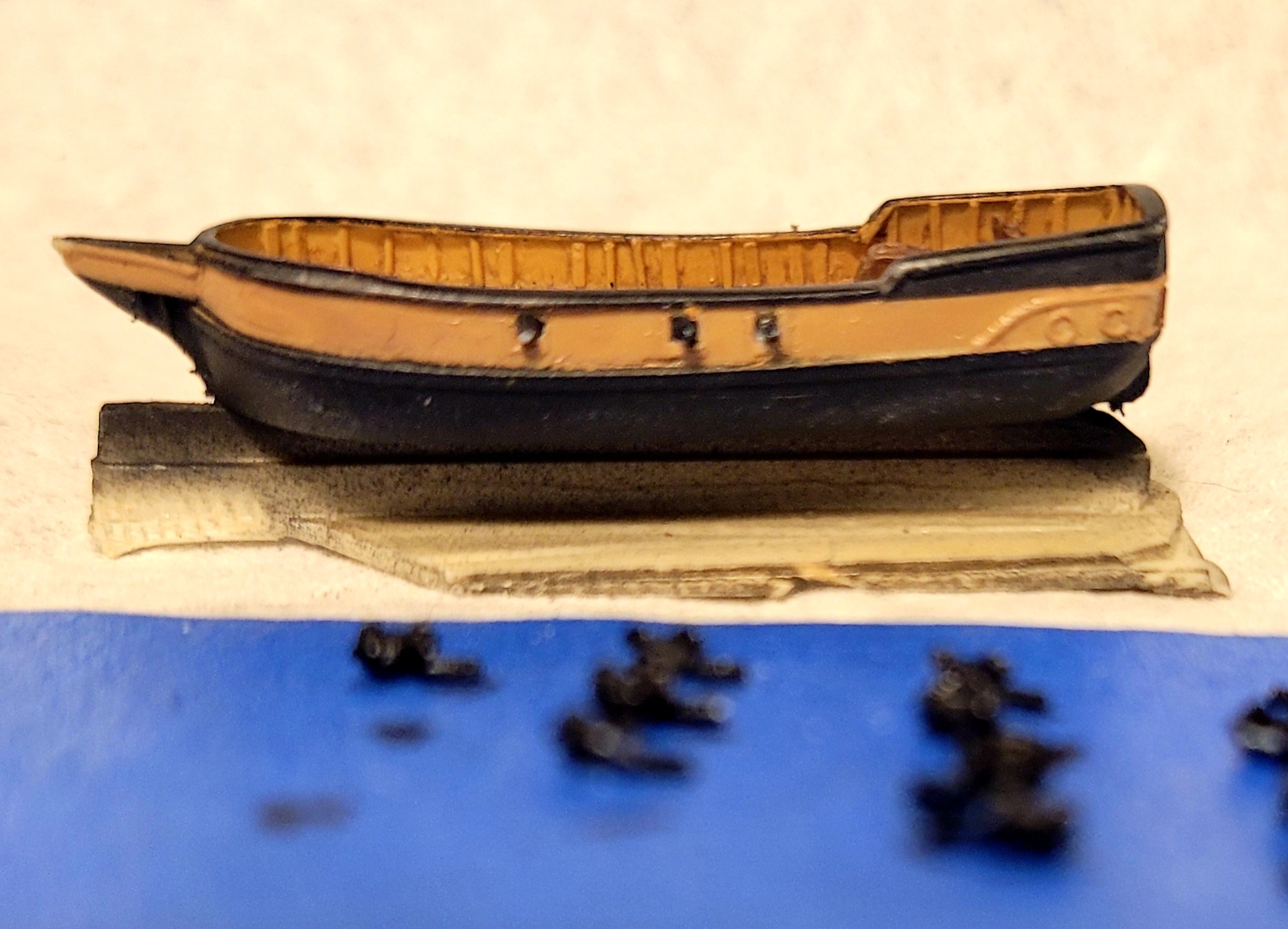

I chose to paint the 9-pound guns. Mostly to make them easier to keep track of. Tamiya semi-gloss black is the cannon paint of the Day.
It turns out the guns do not interfere with the windlass, so yes Bob! Your Antelope Privateer could carry 10 big guns! And not much else!

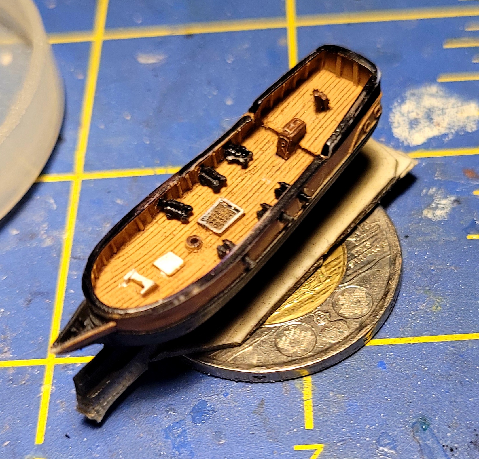

Careful drilling and carving of gun ports, test fit of cannon. Voila! Antelope has her teeth!
how many 9-pounders will YOUR Antelope privateer be armed with?
A few more hull details to finish and the mast and ratlines can be installed.
