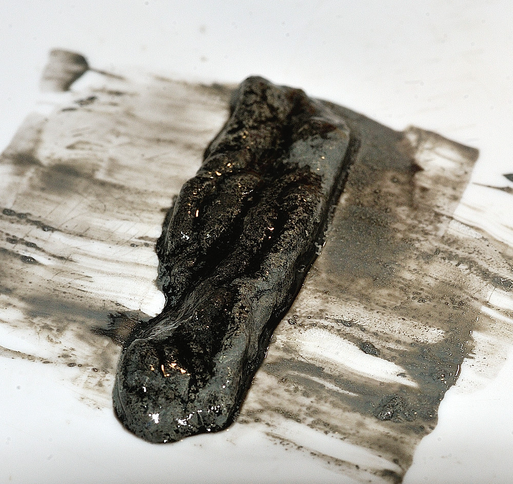

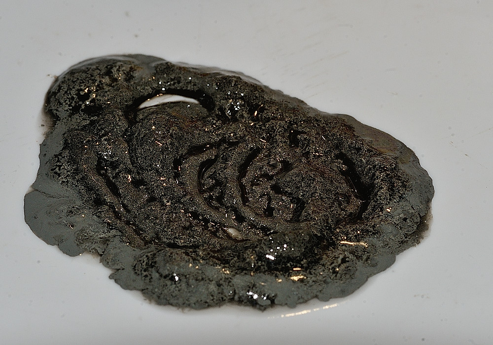

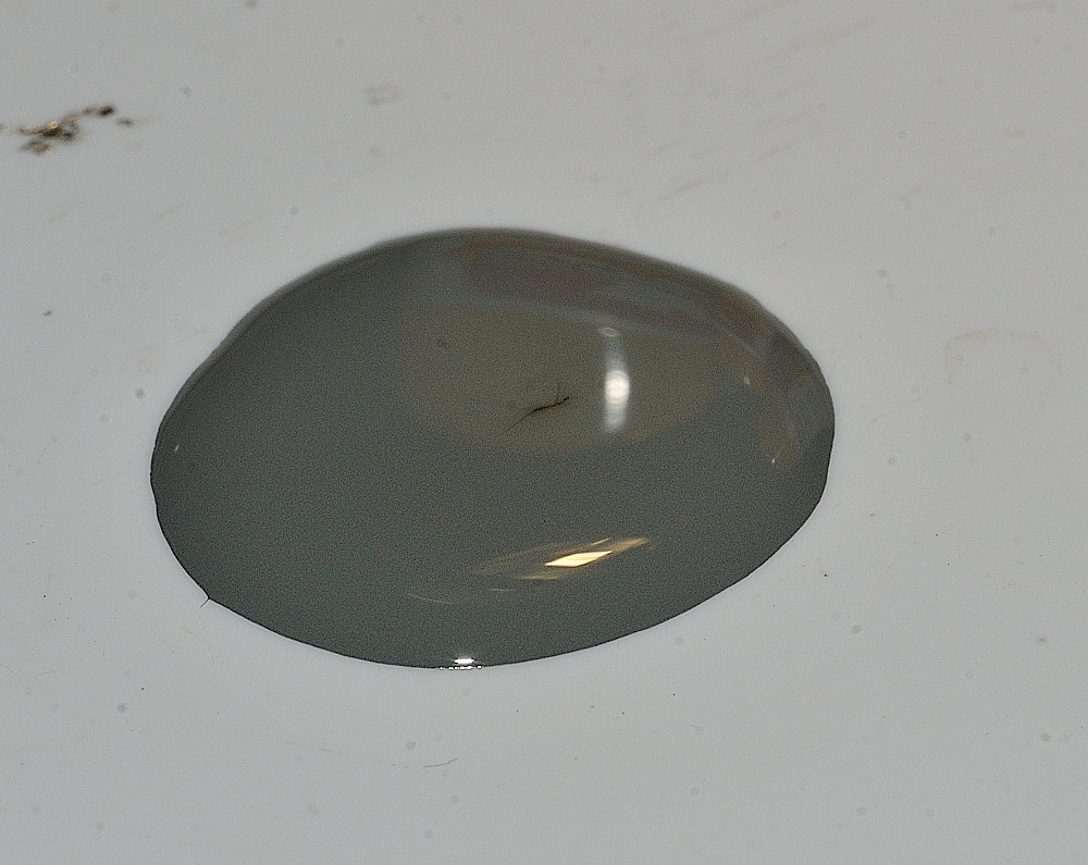

I decided to go with Xtracrylix as they are accurate colours but i have never used them before. As its a first time and on line reviews say neat or thinned up to 50% i thought some experimentation would be needed.
Anyway what i found was despite using their own brand thinners i was getting some sort of chemical reaction which turned the paint into a gloop like crude oil.
this is drop of ocean Grey , looks good but a little to thick to spray.
this is the same drop with about 25% thinners added :)
and here it is fully mixed and ready to apply with a plasterers trowel :)
So the moral is, stick to paints you know and always do a test run and allow an hour to strip and clean your spray gun nwhich is what it took me as i initially mixed this in the gun and just did the pictures above to show you what happened.
after all that, go out and buy some Tamiya paints and problem solved :)

That is ducking fugly!

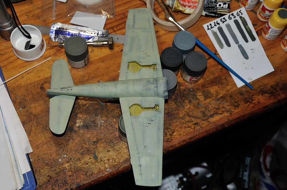

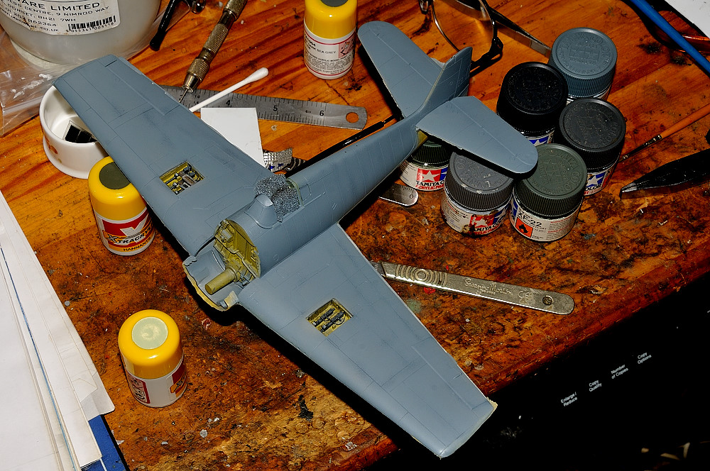

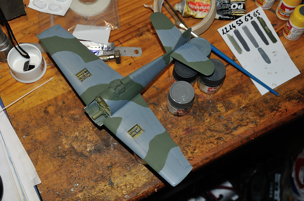

I ended up mixing my own colours from Tamiya paints but its hard to actually know what the original colurs were. I had the names and FS numbers but even they vary hugely on the screen. In the end i tried to match the xtraacrilx colours i had....(year we spell colours like that over here and its our language so we should know :) )DSC_1281.JPG

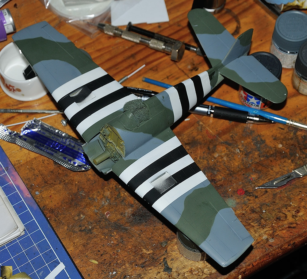

bit sparse on the green ( which is 90% field grey) but it will look fine with its invasion stripes...

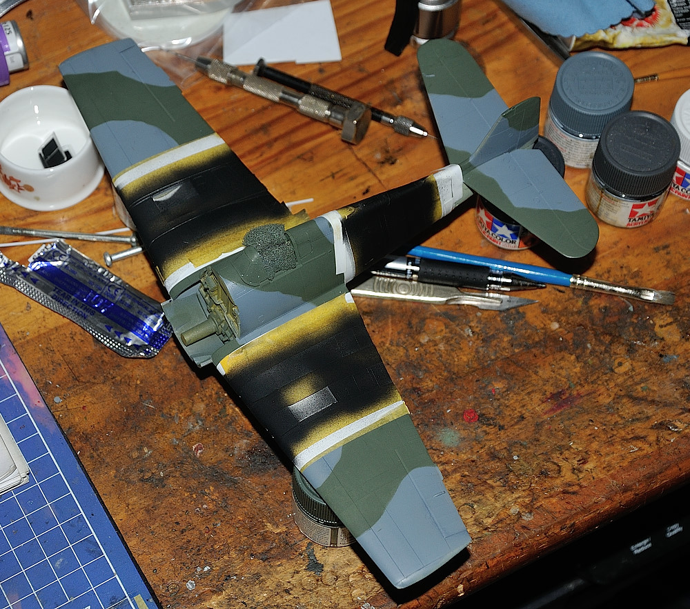

this will be really weather beaten when its done hence the odd finish
The moment of truth, never keen on this bit, did i get the lines straight, did i get them evenly spaced or worse, did the black bleed under the tape and in to the white ?..............( i know how to build the suspense )
SUCCESS :)
Phew, a few little bits to clean up but all in all quite happy :)

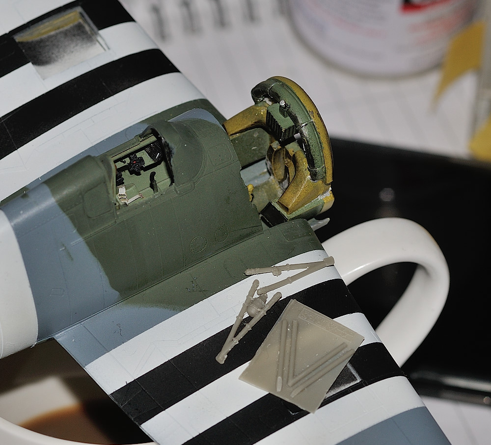

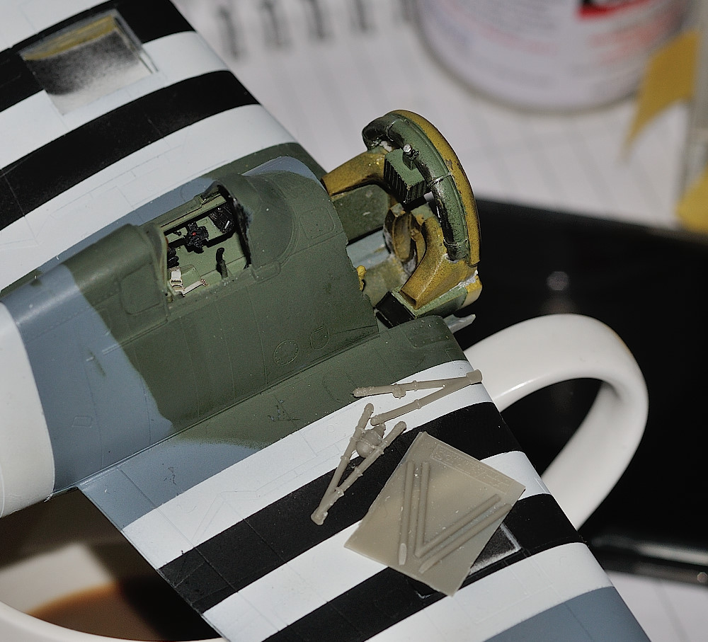

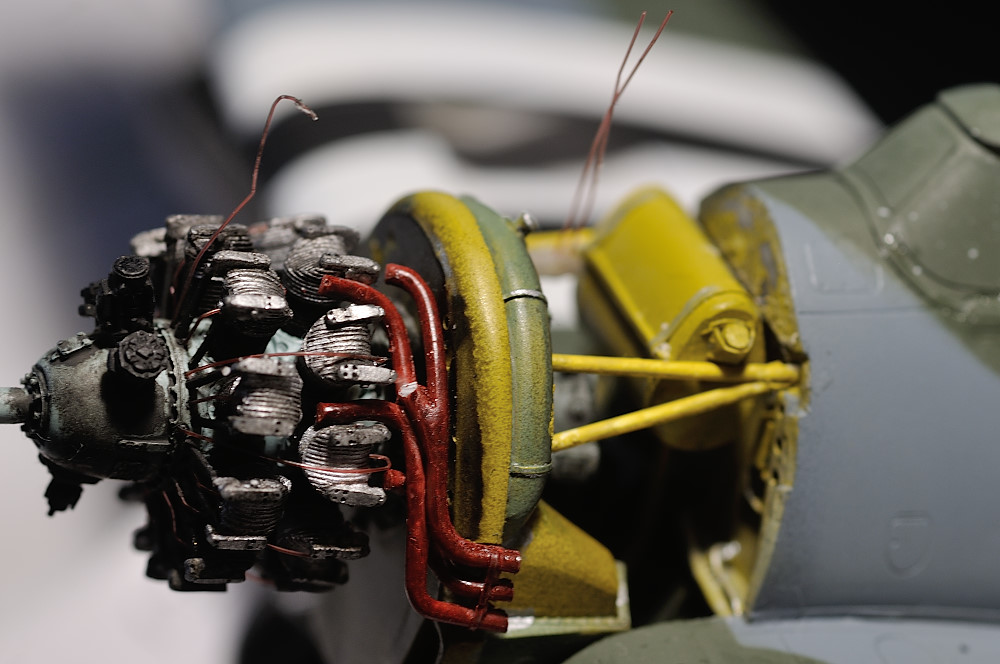

I fitted the engine bulkhead, its resin attached to resin so you need super glue and you need to get it exactly square so your engine is not at a jaunty angle up or down or left and right.
the parts on the wing are the stretchers between the fire wall and bulkhead but they are not quite long enough so i have made some of my own

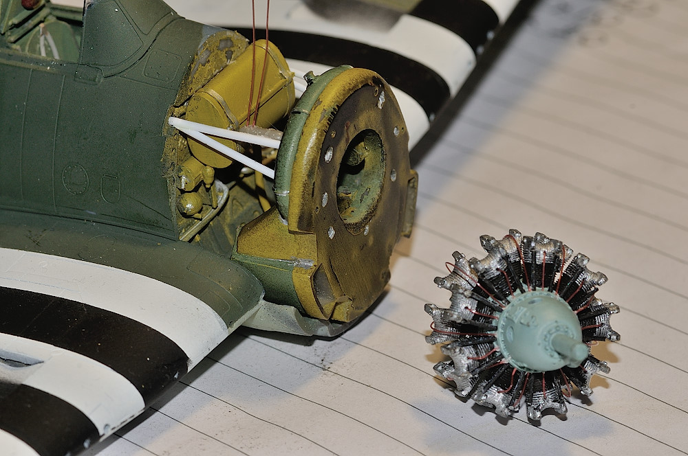

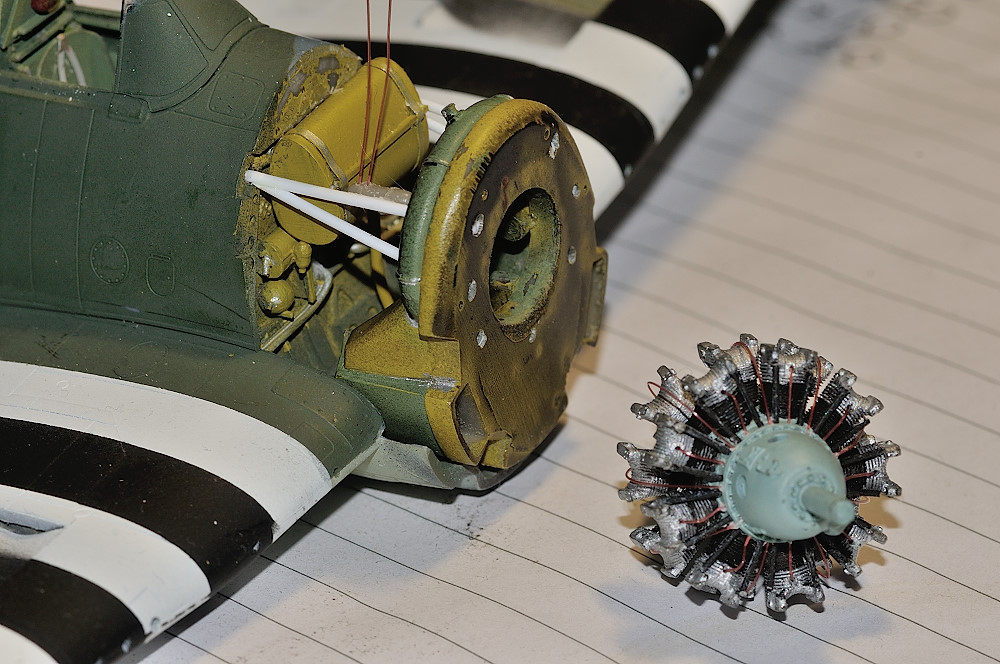

Engines is coming along but i have been putting off fitting the exhaust because....well basically if doesnt seen to fit :) well theres a surprise :)

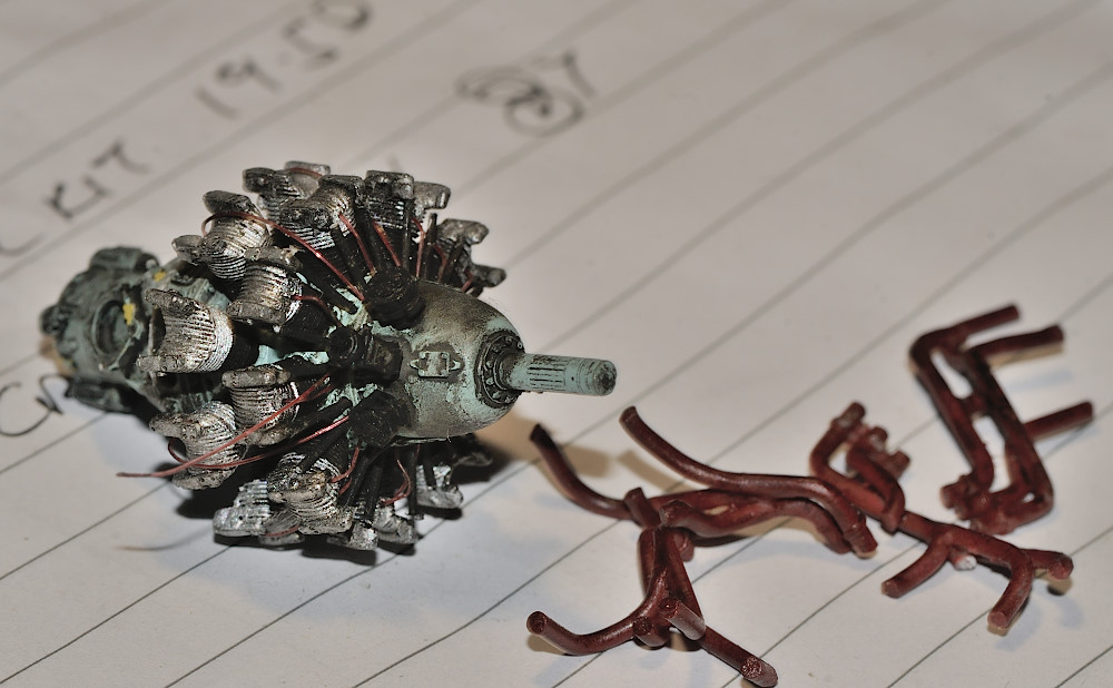

i have run up against a major problem. However you look at it the exhausts dont fit, they are not even near.....
On top of that the glue i used to fit the cylinders has not set so trying to get the exhaust sit where i want it means the cylinders are moving out of line.
Nothing for it but try and salvage a bad situation by at least stripping the engine back to its parts and re gluing the cylinders.. I will also have to make an exhaust system as i can see this one is not even near. Not sure how i will do that yet but i will think of something :)
I cant get too upset about it. No one builds aires sets and expects them to go together but when the whole point is to display the engine that really needs to be a bit better than this :) I like a challenge and boy have i got one here....not ruled out scrapping all yet and building something OTB :)
at least as the glue never sett it should come to bits easily
