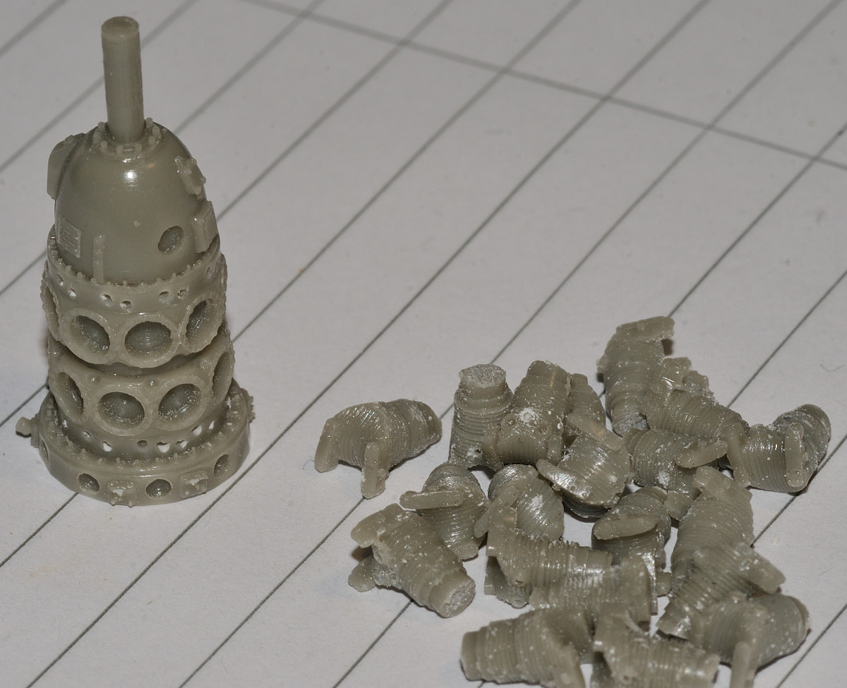

This is the basic Aires detail set as it arrives on its pouring blocks
Dont always assume because its an "upgrade" detail set its going to better than the stock parts. You can see here its not worth messing about with the resin stuff compared to the Hasegawa original plastic in the cockpit, i will probably use the resin seat and the PE seat belts.
Here is an example. Little wonder this guy had trouble hitting anything when i look at his resin barrels.

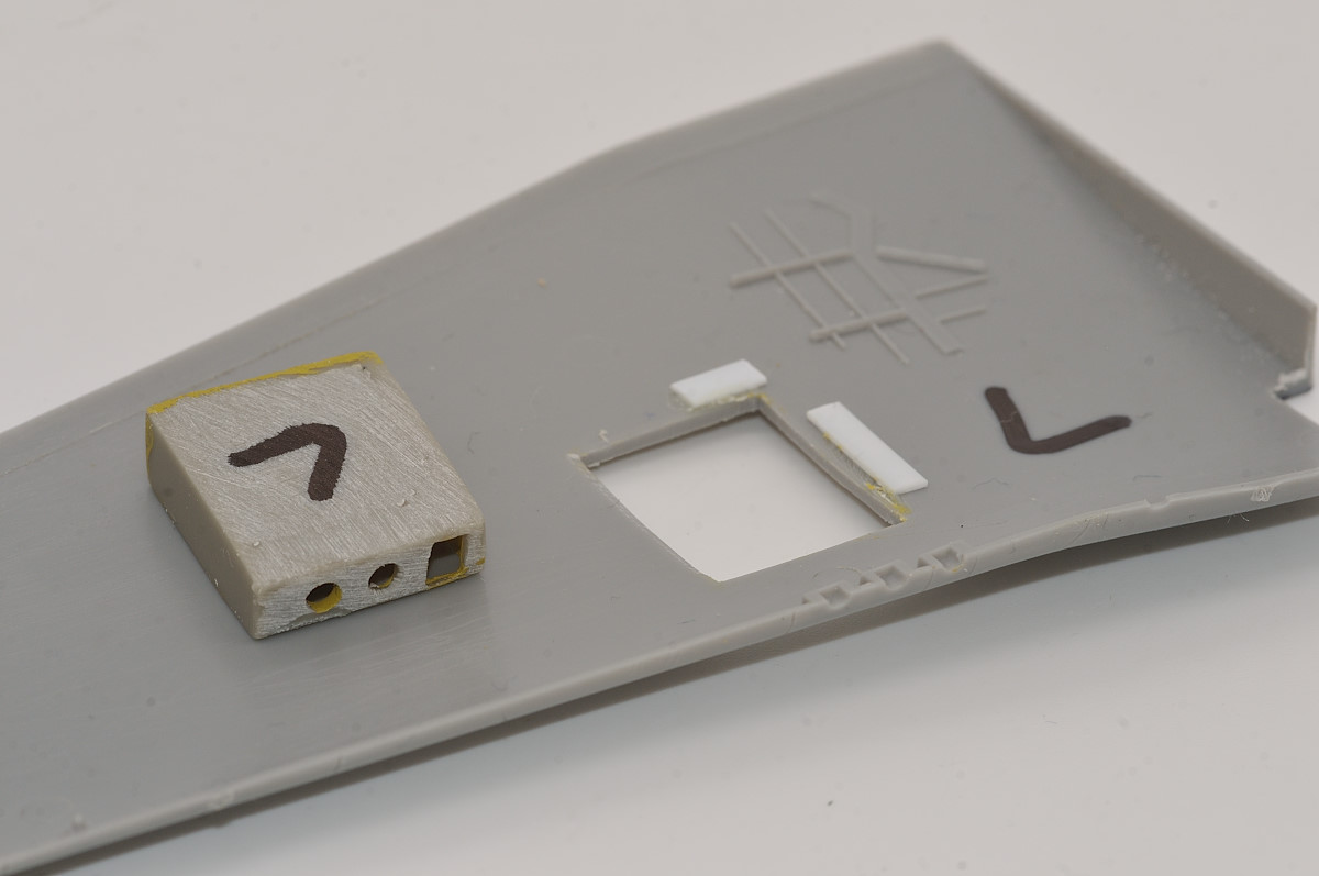

I have cut the holes in the wings, i like to get the gun bays where i want them, clamp them and then glue a couple of guides in place because when i finally glue them with super glue i need to get them right first time with that stuff..
I have found the resin guns are pretty naff and they only give you 4 and you need 6 so i will have to make some. I will need some 1.5mm x 3mm plastistrut next time i am passing a model shop,

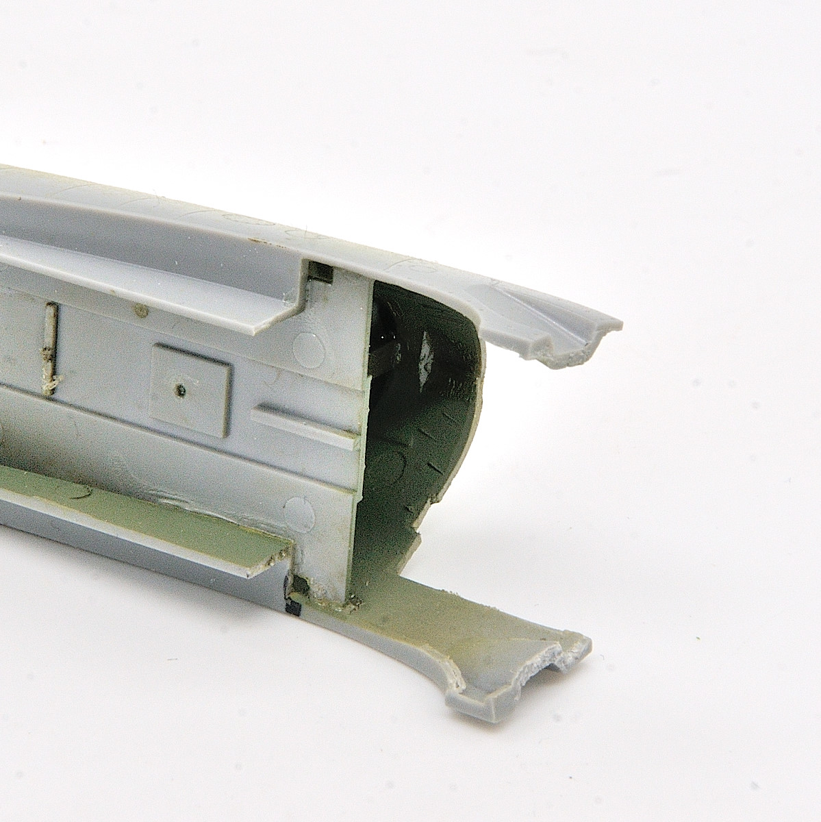

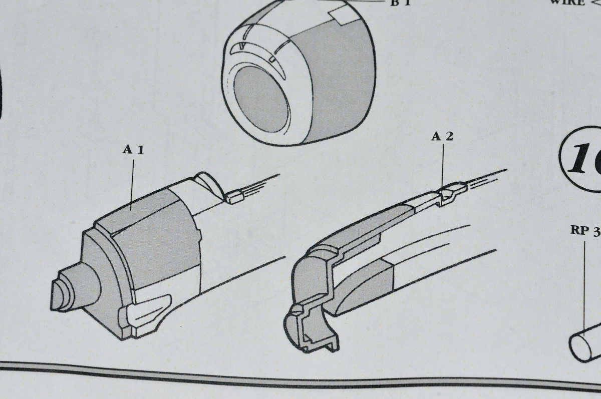

The instructions , such as they are call out what needs to be cut from the front of the std kit parts leaving the sides with the exhaust channels.
This makes it trick to cut and later like me you will also find this cant work :) You need to cut these side panels off as well as there is no way the forward bulk head is going to fit inside them.........
after a lot of head scratching and thinking i looked atthe box again and the guy that built the model for the box front also found the same as he cut the sides off as well
Thats more like it :) I have now cut the sides off of mine and will a bit of trimming got the cockpit wall/bulked in where i want it also now shortened the cock pit floor. One other problem i found is the sides when still fitted were different lengths, 1mm out despite being cut to the panel lines ....so another good reason for losing them.

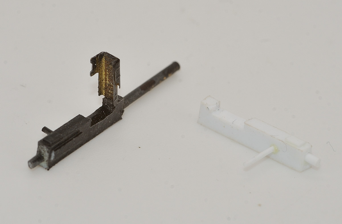

found time to call in at the model shop yesterday and got some .060" x .100" and have made this..
Macro lens doesnt do it any favours but with the ammo belts and the guide shoots for them i think 6 of these will do, certainly better than Aires efforts :) some better paint and a little cleaning to do up but scratch has never been my thing.

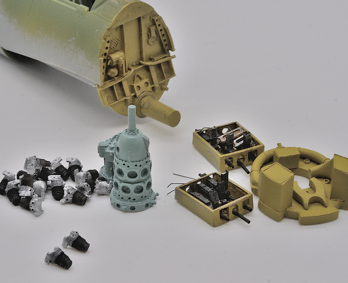

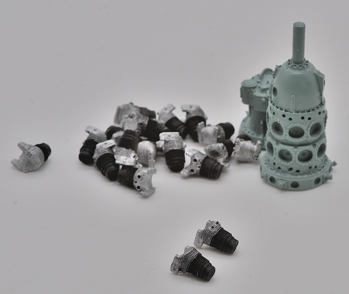

I have been trying to find a way to cheat painting the cylinder heads :) I wanted to do them bassed on the double wasp in the imperial war museum here with black barrels and alloy heads but they are very small and i couldn't find a way to mask them so ended up painting them by hand.
i had already drilled the spark plug holes. i didn't fancy trying to cut push rod tubes, all 36 of them exactly to length so i have drilled the holes in the crank cases a couple of mm deep so i can fit the rods over length and just slide them up till they touch the heads if you see what i mean...hope it works :)
I have done the gun bays with my home made guns, the Aires kit give you four guns and about enough ammo for 4 guns so i made six new guns and have only armed one side. If i had know all this i would not have opened one of the wings up and just displayed one side.

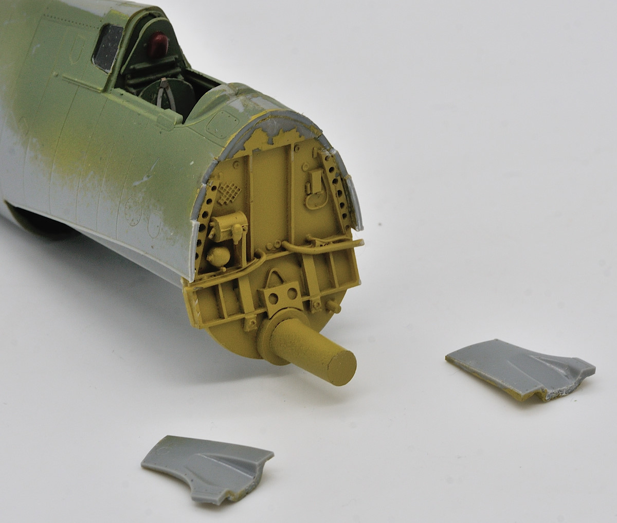

So i am happy with the bulk head and this is where i am at the moment
