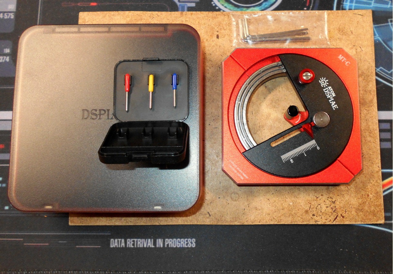

I bought this to cut out small circles of clear plastic to put over the instruments on my SdKfz 251 kits. It works and cuts quite well, HOWEVER, it is a pain in the can to make an accurate sized cut.
I posted this review on the seller's site and am not sure they will ever post it up. I rated it only 3 out of 5 mainly due to some of the sloppy tolerances on some parts and the lack of being able to make precise circle cuts. I can probably modify it to make it work the way I want, but it could be better in a number of ways without impacting the MFG cost.

The materials and finish are quite good. It is solid and can do circle cuts through .018 inch thick clear polycarbonate with little trouble.

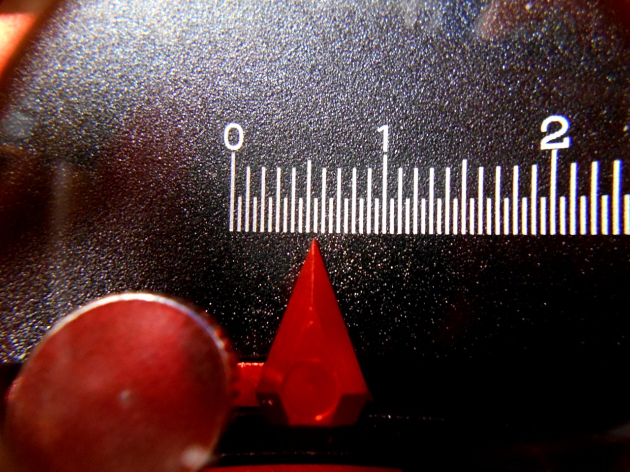

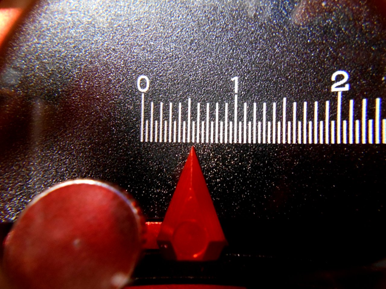

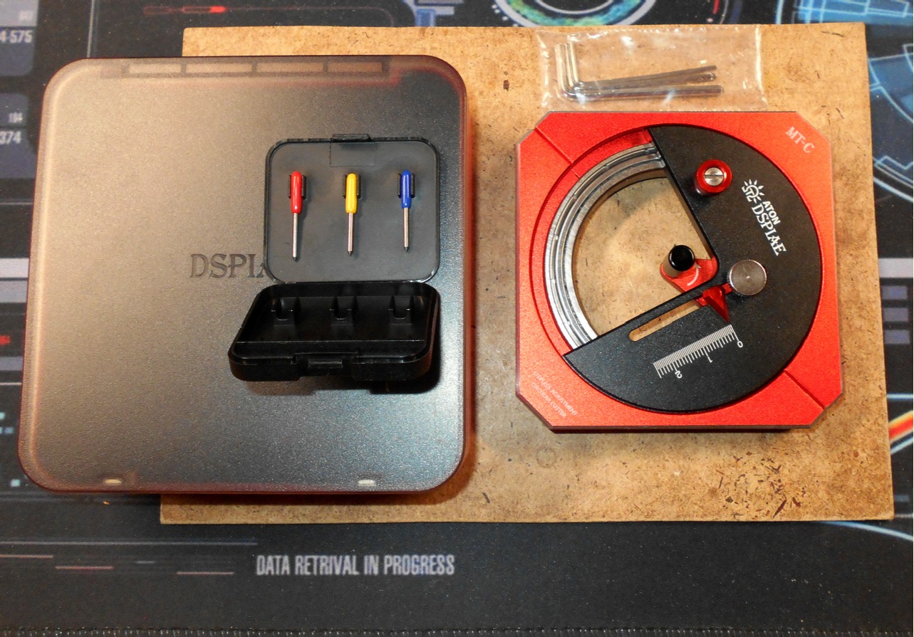

Let's start with the simplest issue. The silkscreen measuring grid. The lines are located about 1/2mm away from the pointer. The lines should be UNDER the pointer. This would give a better indication of any size corrections needed.
If the pointer were to be actually located OVER the grid, it would be easier to see micro adjustments.

The cutters are tungsten steel which is very hard, but also very brittle. I thought it would be OK to cut on a piece of glass. DON'T DO IT!!!!! The shallowest cutter damaged the glass and the tip broke off.
I switched to cutting into a scrap piece of acrylic which worked better. The super sharp very tip still went away, but that was somewhat expected. I have not looked yet but there need to be replacement tips available. I can probably resharpen my tips as I am able to do so with small tools.
Lastly, the tolerances for the turning knob are WAY TOO LOOSE. Yes it needs to be free and turn easily but there is no need for the sloppy fit. Also, the threaded tube and knob for setting the tension/pressure for the cutting tip are a bit too loose as well. The parts wobble a bit and thus setting the tension is a bit problematic. I added some super glue to permanently set the threaded part into the red base next to the white arrow. This helped quite a bit with making the tension adjustment more positive.
