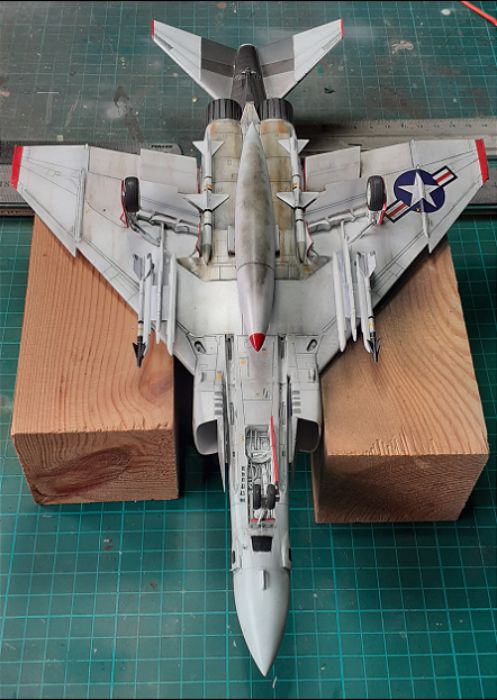

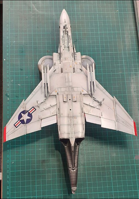

Before and after photos:
Burned Sienna, Raw Umber and Paynes Grey oils applied and blended yesterday - two hours or so uninterrupted as it was Fathers Day here :good:
More soon.
Ian.

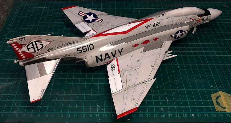

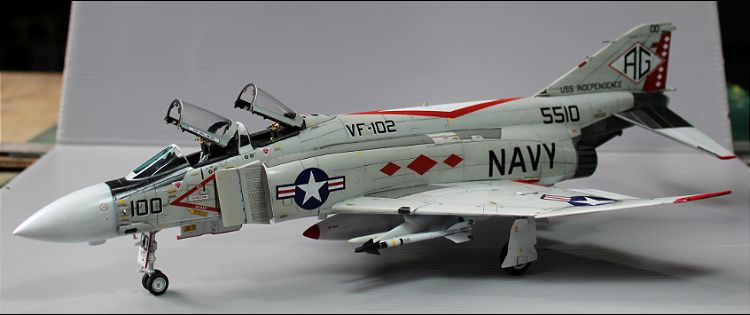

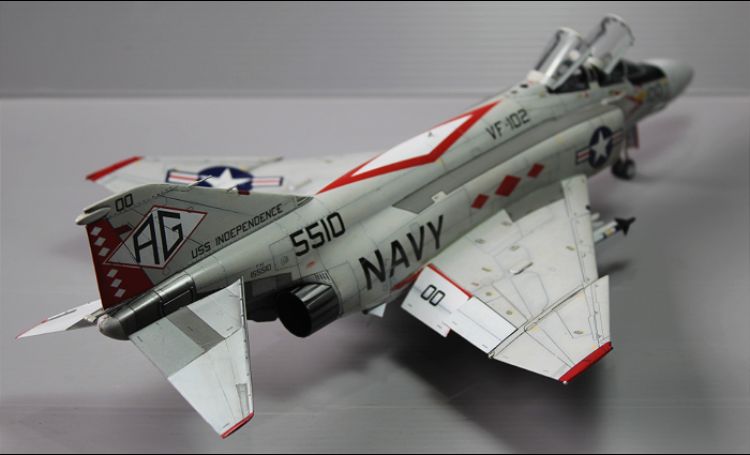

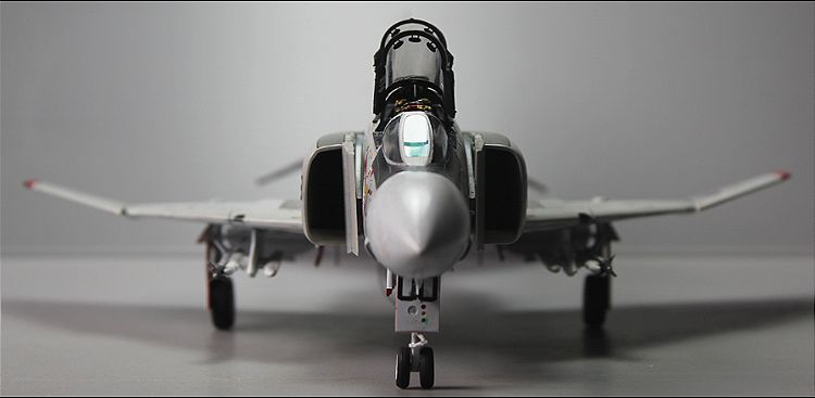

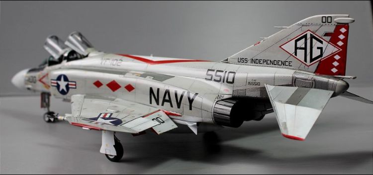

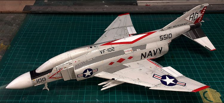

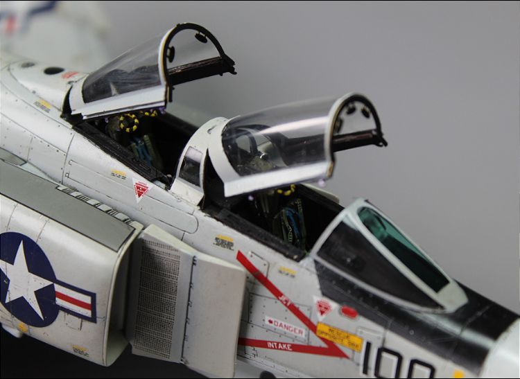

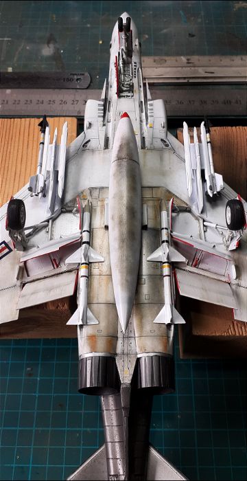

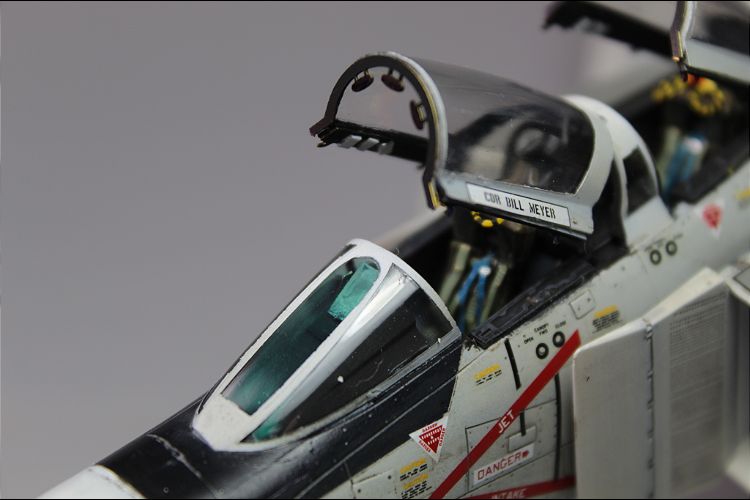

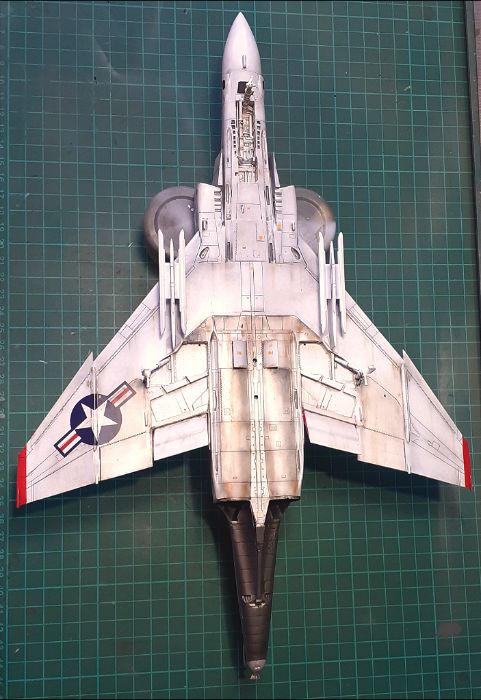

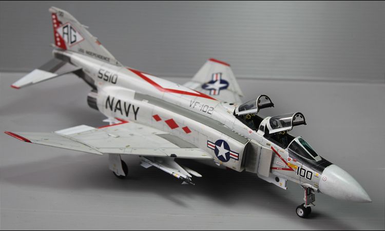

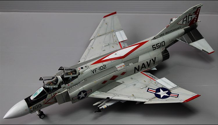

So the kit is the re-issue of the Hasegawa 1:48 F-4S from 2004, but with the 'J' wings and all engraved panel lines - because the fuselage is the 'S' version, the 'slime lights' had to be carved-off, so whilst I was doing that, I decided to cut & re-profile the inner flaps, scratchbuild the rear of the back-seater's IP with scrap sprue and short lengths of fuse wire etc and detail-out the nosewheel bay with larger gauges of wire. I also added all of the Eduard kit-specific etch set and Airwaves canopy set. The seats are Aires resin replacements which come with separate etch frets for the seat harnesses. The rest of the kit was built straight from the box.
I mixed the Light Gull Grey from Tamiya acrylics using the (in)famous Mk.I eyeball method, but before laying down the paint I decided to test my new Uschi Van Der Rosen 'splatter masks' which was risky but very worthwhile - I would recommend giving them a go, but be careful, practice to get the best results - I just got lucky.
This was my first time using Furball decals, they are bl**dy superb - amongst the very best decals I have used in fifty years of modelling.
For final weathering I went to my tried and trusted 'oil dot & blending' method using Windsor & Newton products - been doing this technique for thirty years, so I'm sticking to it.
Not too much else to say - I love how it's turned-out, certainly the best F-4 model I've completed - but then the last 1:48 kit I actually finished was sometime in the 1990's so it's not much of a claim. Please feel free to comment, question and criticise.
