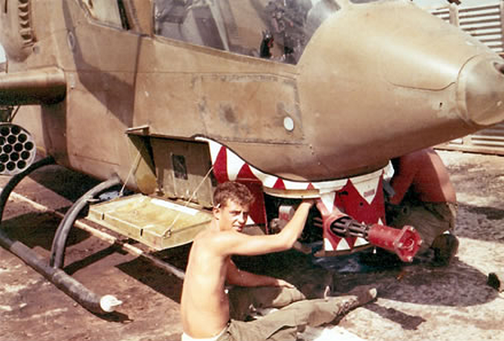

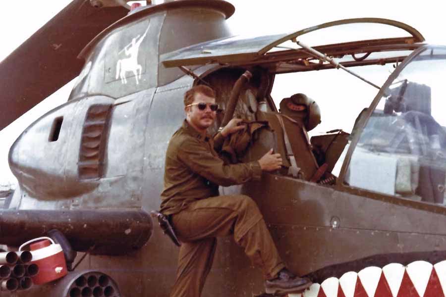

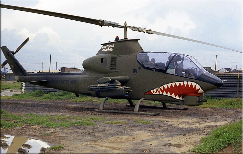

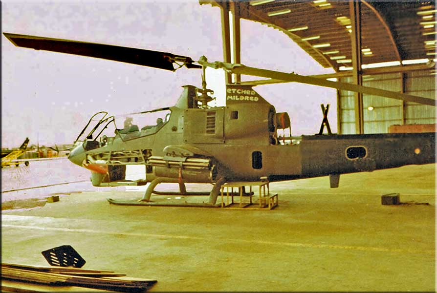

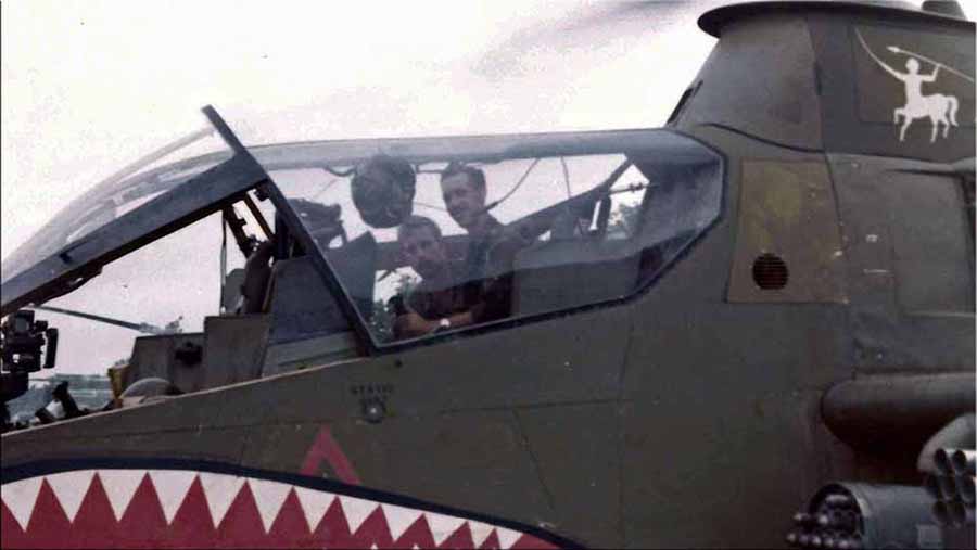

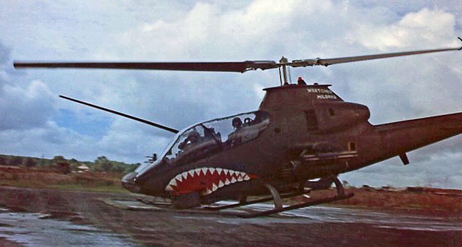

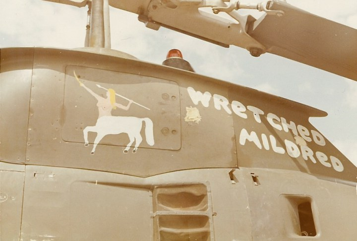

Would you be able to order these photos so as to know how the markings changed over time for Wretched Mildred?
Here she is without Centaurs or Chinese characters but the tail color doesn't seem to be different:
2016-01-05_143754-jpg.141196
Here the tail is replaced (different color) but no Centaurs or Chinese characters:
wretchedmildred-jpg.141146

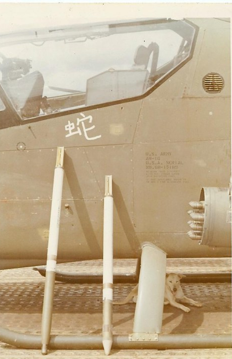

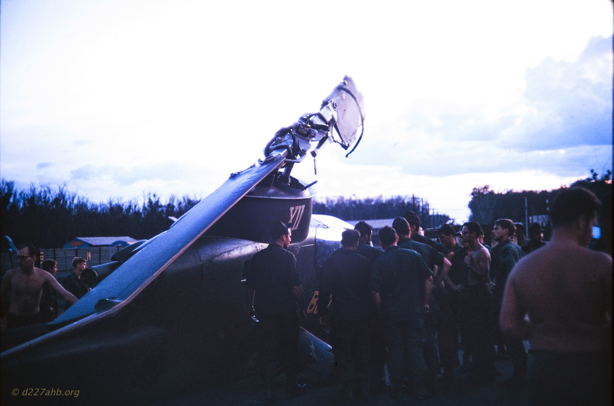

...during the tail boom repair, no Centaurs, Chinese characters under cockpit, and shark mouth still on:
Once the Chinese 蛇 appears for Snake, the shark mouth is not there.
Port:
Starboard:

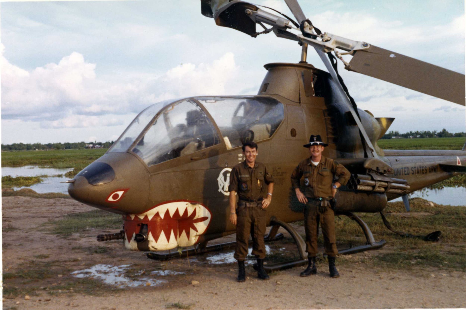

Chinese characters and serial, no sharkmouth, Centaur is there and tail boom color is the same as the rest of the fuselage. Were the Centaurs on before this time (before tail boom repair) or only afterwards? Is this when the port one was female? Or was the port one always female?
37099-11909-40-1-jpg.141202
I used the bullet hole repair to identify this as the same time frame:
1631216798342-png.141208
Regards,

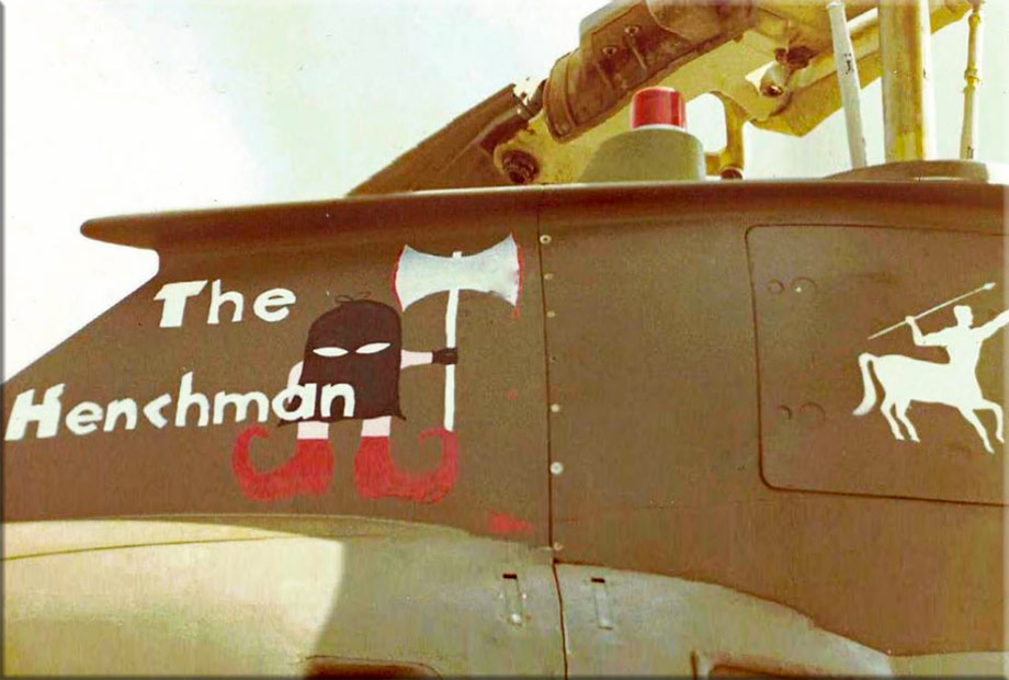

The tailboom color changed happened when the tail rotors were change over to the rt. side. Don't know when the centaurs were painted on., but they were all male till I changed the one on the lt. side to female. I kinda did it as a throwback to WWII pinups. The missing teeth (you can see where the teethe used to be. I think we were getting ready to repaint the mouth. I have pics of in progress teeth painting when maintenance drop 189 while undergoing a skid change. At that time I had just 3 wks. left in country and discharge. Gary S. LGB XLV MMXXIV

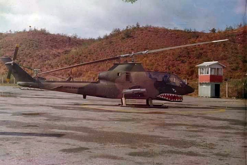

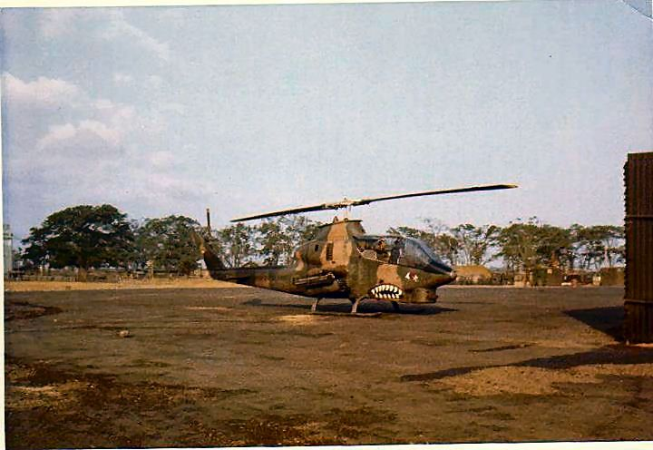

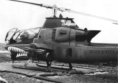

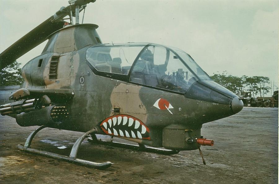

A camouflaged AH-1G with a Shark Mouth!
AH-1G 66-15273 AH-1G D Troop, 1st Squadron, 10th Cavalry Regiment
AH-1G Camo 66-15273 AH-1G D Troop, 1st Squadron, 10th Cavalry Regiment 03.jpg
AH-1G Camo 66-15273 AH-1G D Troop, 1st Squadron, 10th Cavalry Regiment 05.jpg
It also looks like it has a replacement tail.

Welcome Ronny,

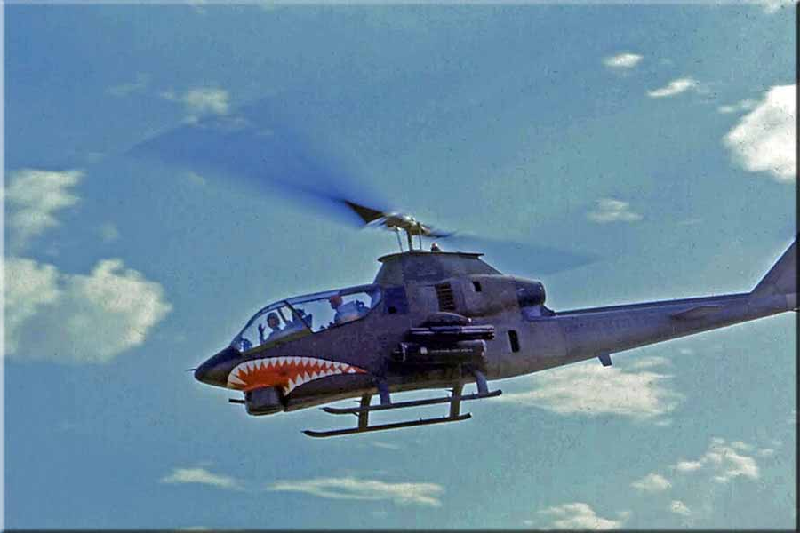

I am almost certain that it is the same aircraft as each sharkmouth (my nickname by the way) was slightly different and this is an excellent match. The photo was taken from one of John Brennan's books and only has that one image. I'll need to find which as I have all of them!
6dacfe67-e728-4ff5-bb11-81b83d73205b-png.159028

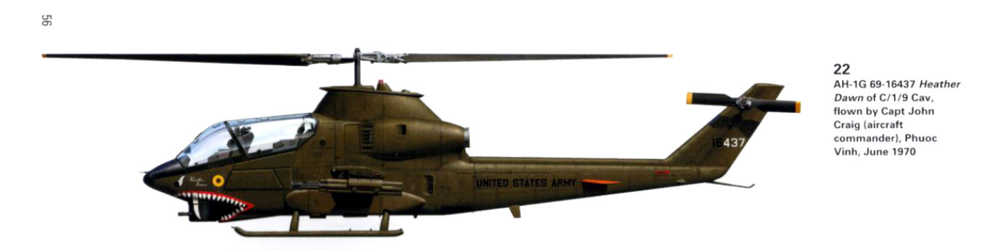

Jon Bernstein has a book, Osprey Combat Aircraft 41 US Army AH-1 Cobra Units in Vietnam with a color profile of the same Cobra after it was renamed "Heather Dawn." I don't have the book but I can contact Jon directly.
It looks like John Craig also repainted the sharkmouth.
Or someone read the serial wrong and has the incorrect profile. I am sending an e-mail out to Jon as my curiosity is piqued. His book doesn't have a photo of Heather Dawn.

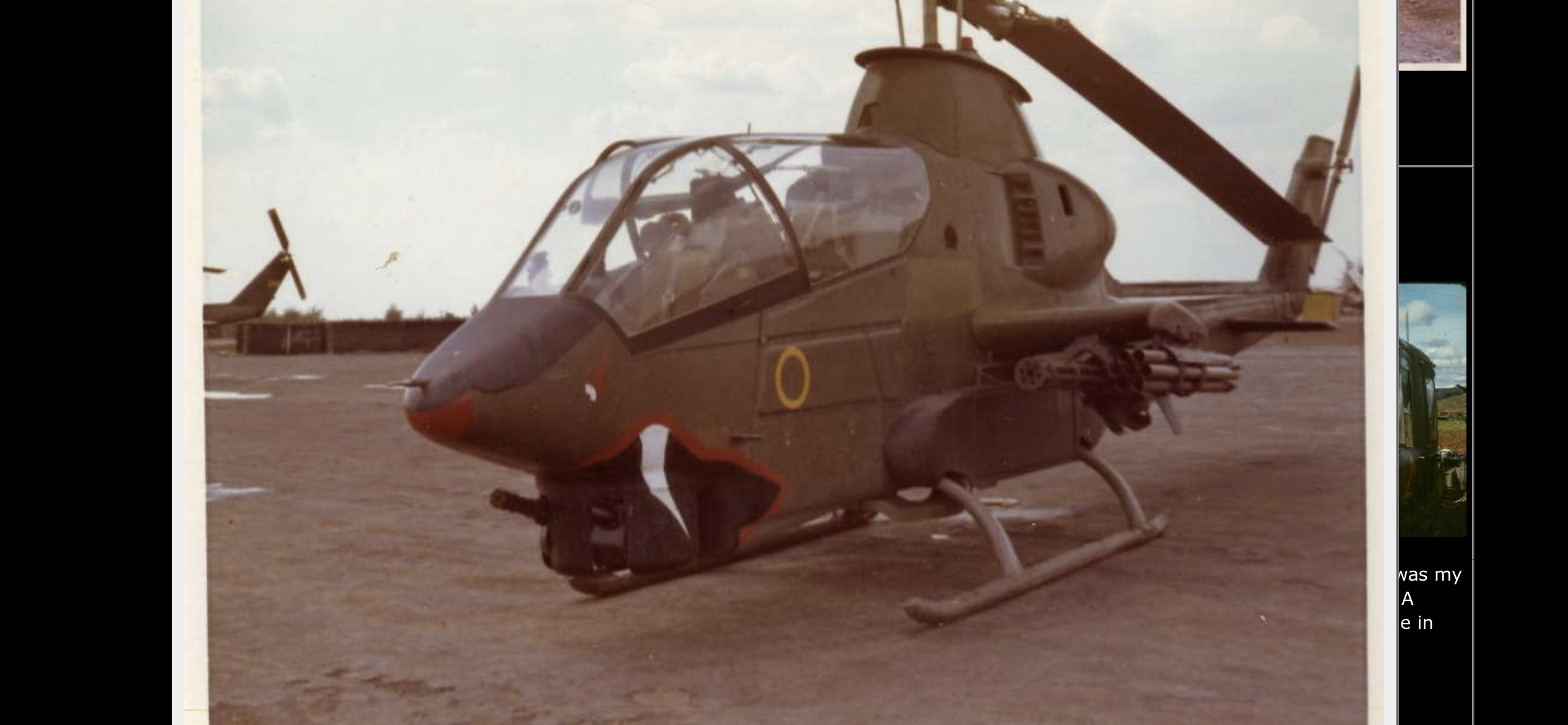

Also noticed this... Early with pusher tail, nose landing lights, and no ECS (Environmental Control System:
Here, we see that the nose is painted over, the tail boom was replaced with a plain green tractor rotor, and the ECS is added with the zinc chromate panel visible:

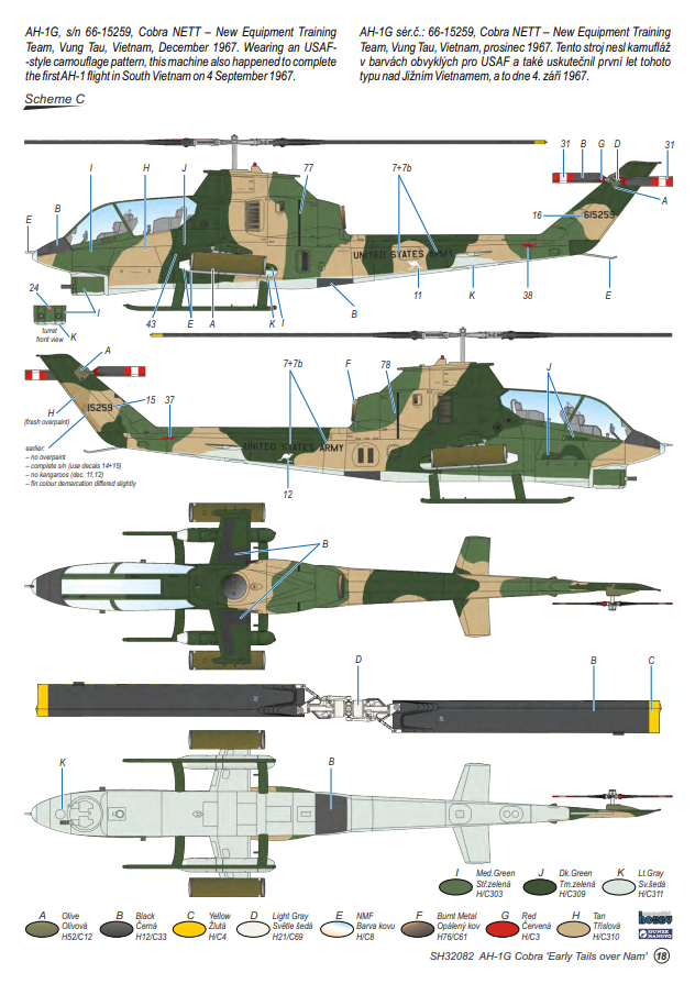

I have the Special Hobby 1/32 scale AH-1G Cobra kit and it has a SEA camo scheme as one of the options. I already decided that was going to be the way it was going to be built.
Thanks for all the postings Saúl!
Is this the early tails kit? If so, the NETT scheme is nice but they (NETT) kept half a dozen and the rest went to combat units, the one I posted being the only one with a sharkmouth. Perhaps, you'll have some leftover decals when done? :shark: :devil:

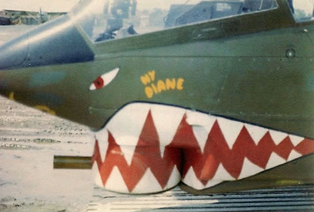

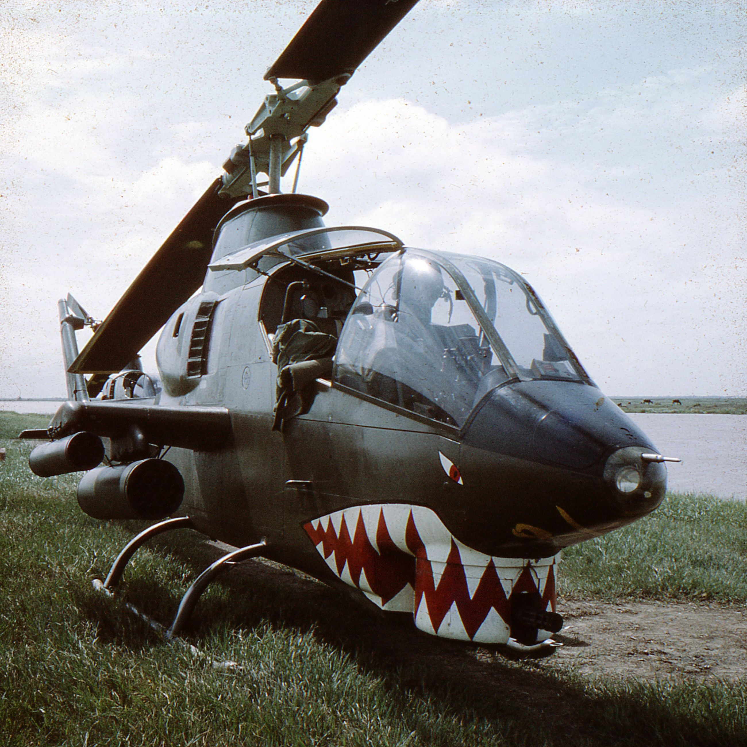

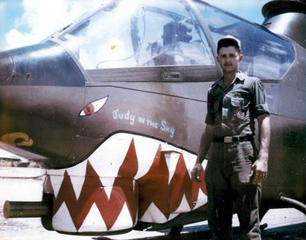

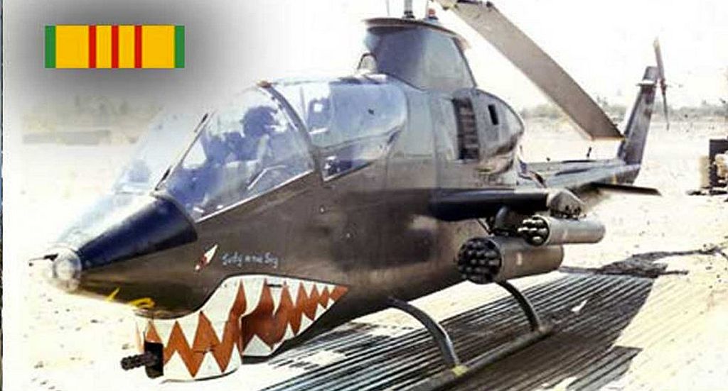

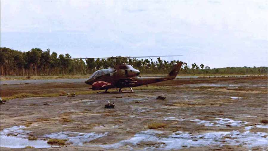

In all seriousness, I found this early AH-1G, earlier build than the NETT scheme Cobras, with a sharkmouth but am considering it in 72nd scale. Note the earlier TAT-102 turret with a single weapon, pusher rotor, dual landing lights in the nose (headlights), and no blade antenna under the tailboom. AH-1G 67-15475 (click to visit the history of the airframe):

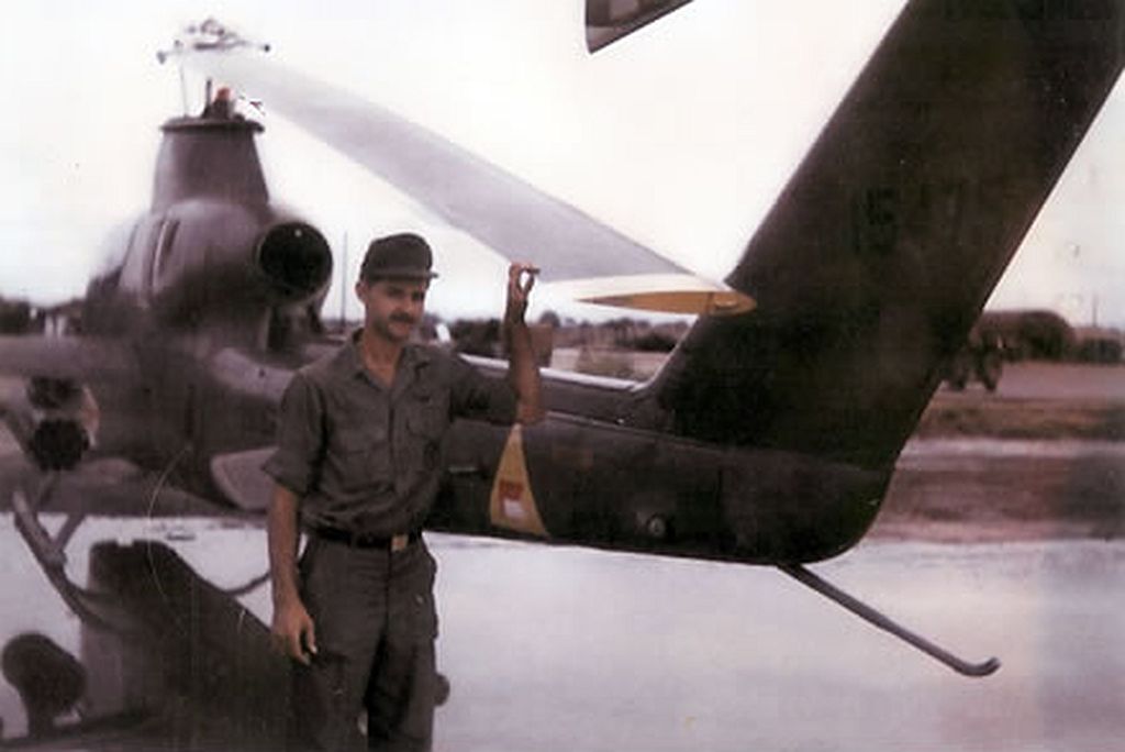

Note that the last three of the serial are still black:
She was renamed after overhaul but I have no clue if the headlights were painted over, UHF/VHF blade added, tractor rotor tail update...
However, she did get the M-28 turret, with dual weapons, later prior to upgrade to AH-1F (yes, the designations officially went backwards) standard:

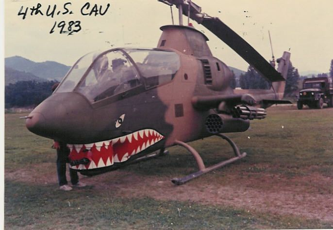

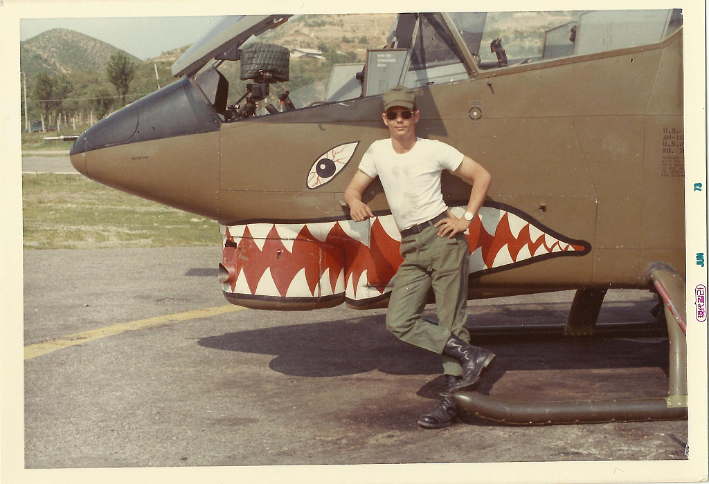

AH-1G 67-15452 Pete's Pet Snake. Mark Peterson was the crew chef of this snake assigned to the 4th Squadron of the 7th Air Cavalry. Low resolution but cool nonetheless! Click to see a cool article on an helo mechanic in 'Nam:
Same aircraft BUT...
Be careful when doing research though as this one is after the Cobra was repainted for display; note the year and located in South Korea:
