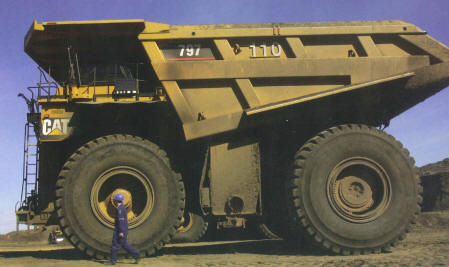

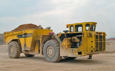

This thing is incredible, Moon- cheers! John has some great ideas- think of what it's been through- snow, sleet, some shitty cold rain- all of that for add layers of grub and crud flowing down those steels plates, dragging dirt and rust into the cold mud of occupied France. At this point you're adding thin layers- easy does it and you can't go too far off. :drinks
EDIT- hit SEND and then see T-San's post- yep, that, too! Crazy mining trucks- always have a place in my heart!
