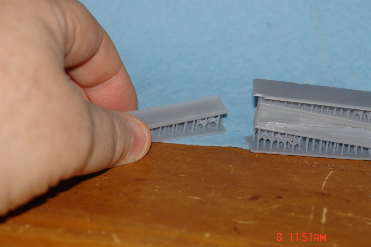

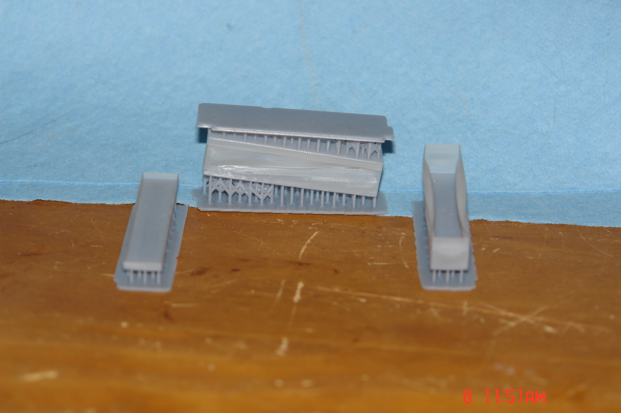

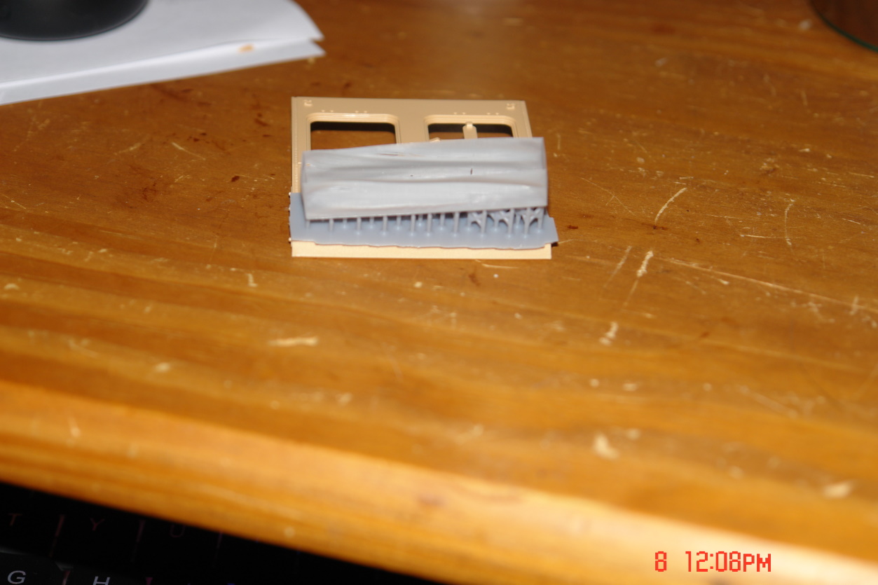

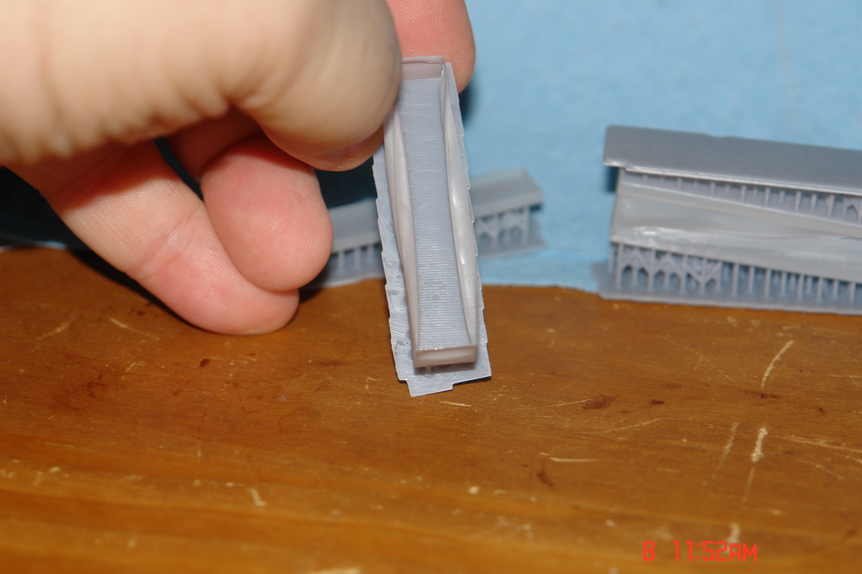

Okay so just finished my 4th print and it is no good. Having said that I did learn stuff so it was a success. As I cant find a lot of files that I can use I have been wondering about making my own files. Now the problem is I cant draw a straight line on graph paper with a ruler. Sad but true. So researched and found a program online that is free called Tinkercad. I watched a number of you tube videos and read a tutorial. I need a box for the back of my Pz III from the 24th PD. So I measured as beast I could. It took umpteen tries but I made a box. Bouyed by that success I made a lid. A few tries and done. I then sliced the drawing in Chitubox and this morning made 2 boxes. So I learned something new.....check, tried it,,,,check, and then printed it. Alas I think a .1mm side may be too flimsy. So now to redraw if I can remember how and try a .2mm wide sides. In the meantime here is my attempt Oh and it seems I can not measure either as I'm a couple of mm off but oh well. Oh and the lid actually fits tight so YAY :)
The box is sitting on the rear deck of the pz III.

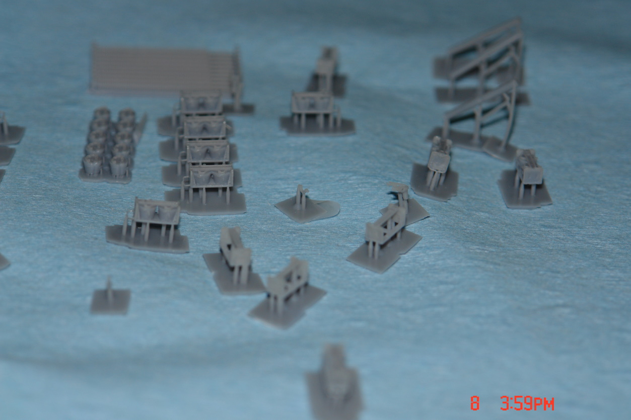

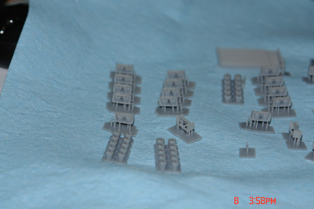

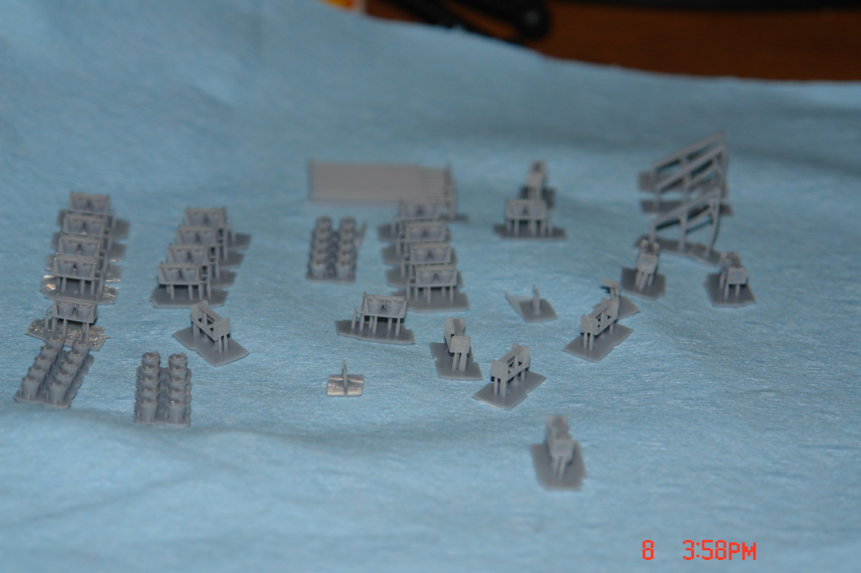

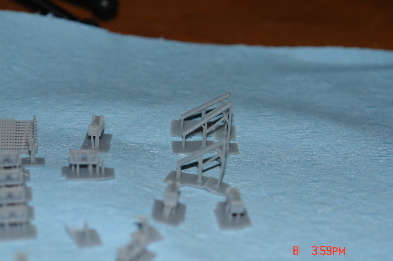

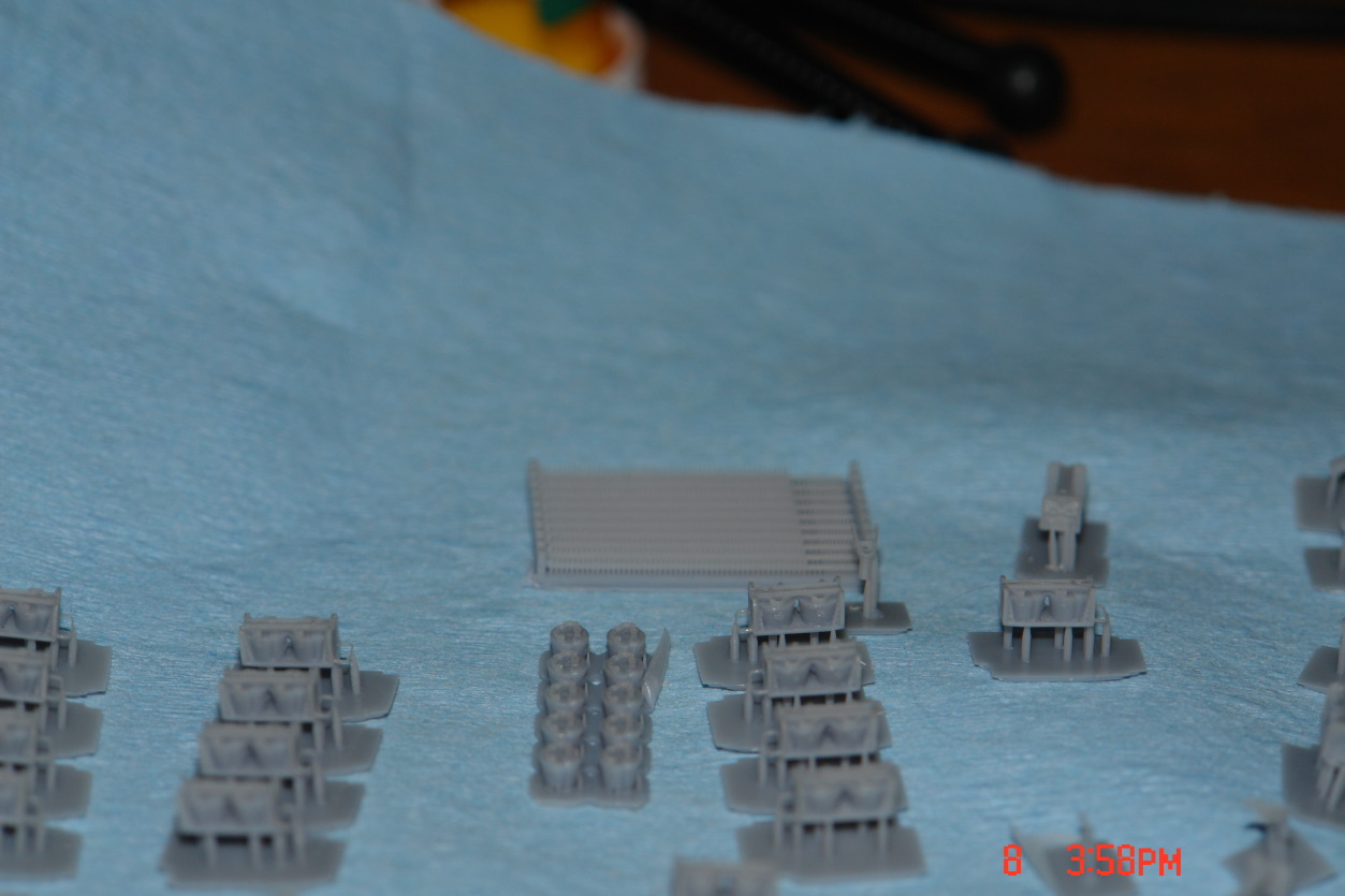

Last print of the day and happy. MG 34 accessories. 3 barrels, not thrilled, a bunch of ammo canisters in and out of their caddies. Some empty caddies and some belts of ammo. Picture sucks but looking with the phone magnifier each round looks good. A couple of mounts that are very nice.
And thats it for today.

I would suggest 0.4mm on the box sides. The larger/longer the side the more material it needs in order to keep it's shape. Remember the resin will tend to be a bit soft until it is fully cured, and if it isn't thick enough it will sag under it's own weight and can also get pulled out of square with the "popping' process when the printer pulls the print up for the next layer.
Lookee! An original product! Bravo young Mister!:vgood: Was the texture on the bottom of the box intentional or a happy accident?

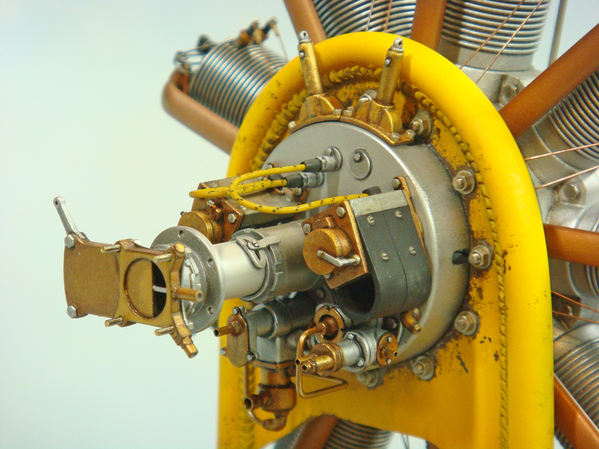

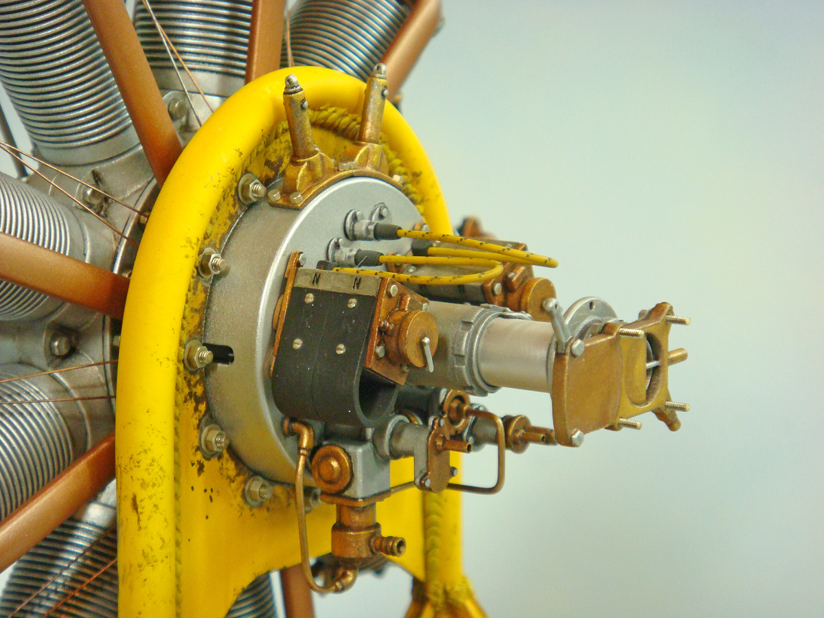

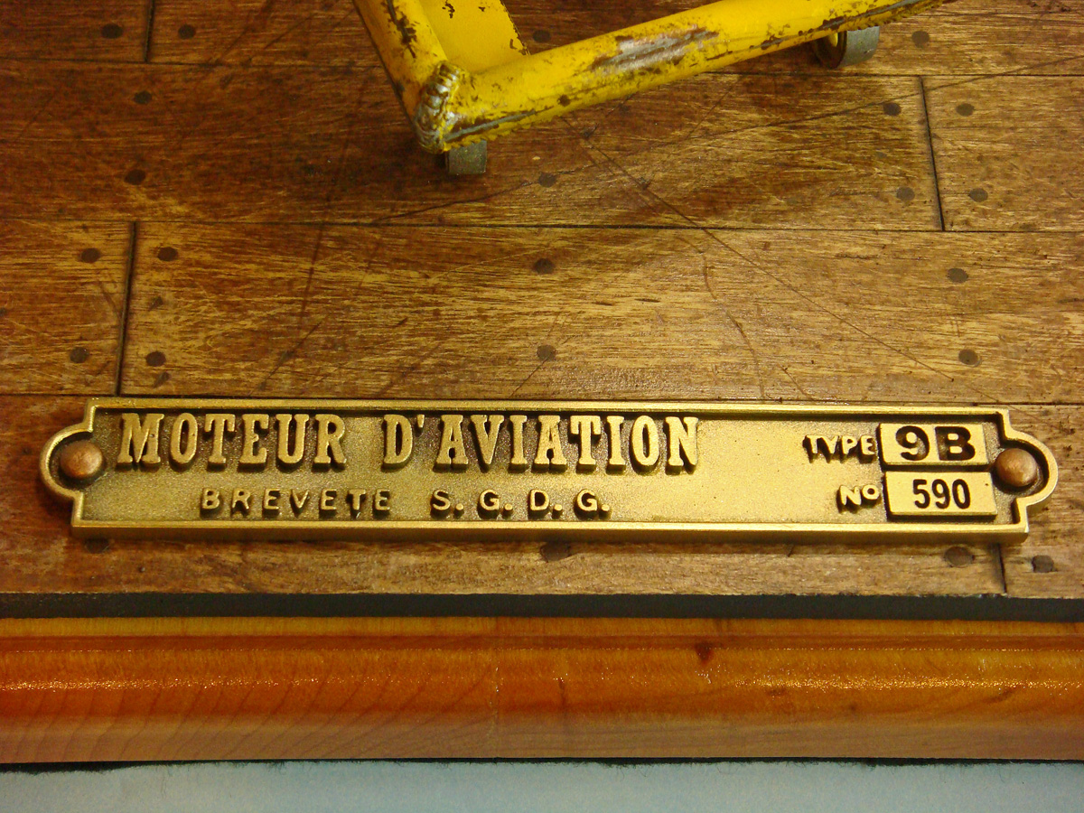

The future is NOW! Once you get a little practice with Tinker Cad, you'll be surprised at what you can do. If you run into problems with total file size, brake the project down into smaller sections giving each one a separate file. Another really handy tip is that you can import .stl and .svg files into Tinker Cad. You can then rescale or chop the .stl files up to use just parts of them. The .svg files can be handy for making shapes that are too difficult in Tinker or - my favorite - adding 3D text and graphics to an existing design.
This title plate for my 1/9 scale Hasegawa Clerget 9B engine model was made by taking two .svg files (one for the basic shape and one for the text, rim and rivets) and stacking them together in Tinker Cad.

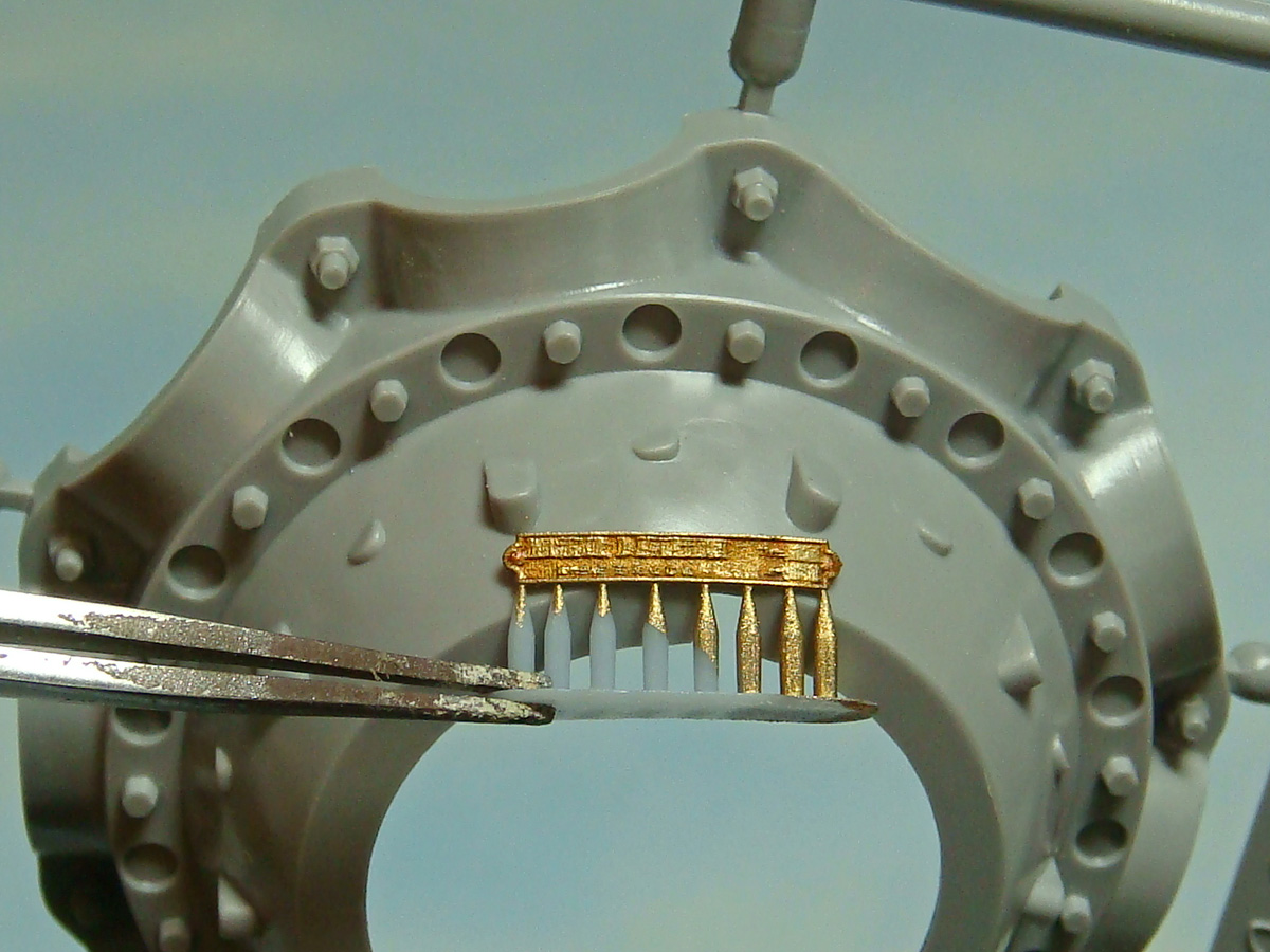

I used the exact same basic design to create this engine data plate. I took the basic design and chopped it using a pair of "negative space" cones (dimensioned to fit the contours of the engine case), then re-scale (re-sized) the now curved data plate.

Here's a general shot of the rear of the engine. Almost all of these details were designed using Tinker Cad and printed on my desktop 3D printer (Anycubic Photon).
With some practice, you'll start wondering how you ever built models without your printer.
