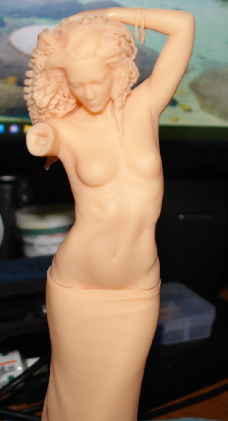

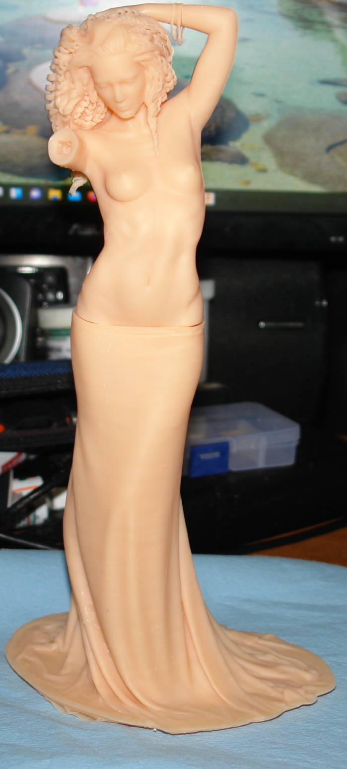

Well most of Mystique came out well. Reprinting the one arm now as it failed big time. 1/12 I believe. Also trying to print Agent Carter.
That's amazing. how long did it take for that to print?
It took almost 12 hours for the head and both arms and torso. One arm failed and not sure why. The lower body took 11 hours to print Went to print the second arm and it would have been 7 hours so added Agent Carters Torso and those two took 9 hours.
I'm just waiting on a UV flashlight and will use it with some fiber optic strands to ensure the inside is cured before I glue it all together and prime it.
I am looking at making this look like marble although brass also appeals to me.

very smooth detail. looks as though you are really mastering this now James.
I wouldnt go thatfar lol. Still a bit of bumpiness on the upper body from the supports but should sand down no problem. I really like the new resin. I kept reading about Sirya Tech but it was more expensive. I'm glad I switched. Its a really nice resin to work with. I might even try some of the Sirya Tech Tenacious. People say mix 10% of that with your resin and it makes it a bit stronger and a bit more flexible. Its just its a $100 bucks a bottle and that still seems pricey to me. Still saving up for a second Saturn printer so I can speed stuff up more. Really enjoying it though despite or maybe because of the challenges.

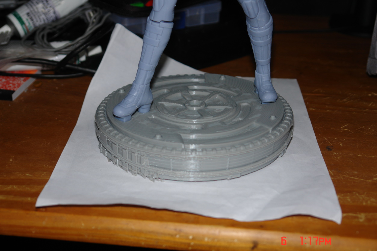

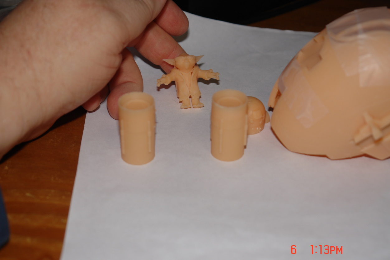

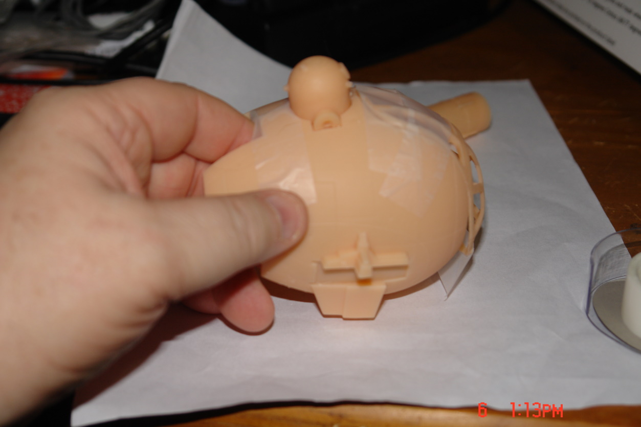

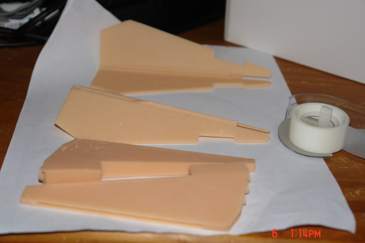

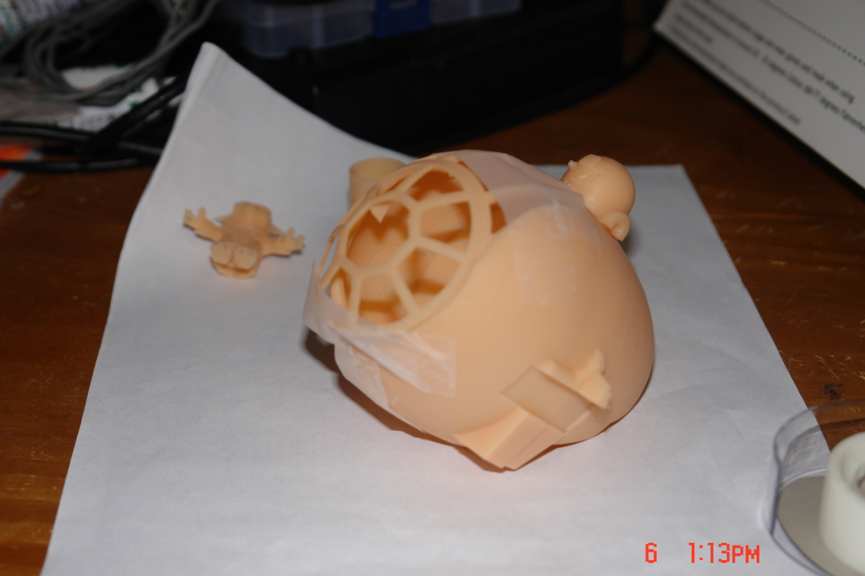

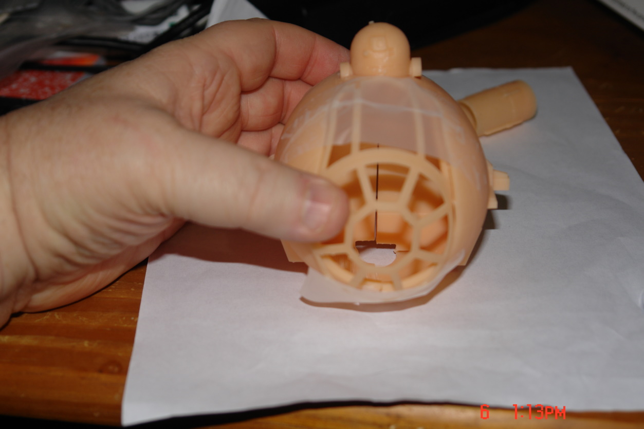

I have not been able to do a lot of modeling lately and even 3D printing is lagging. But I did get some done. First of a friend from Facebook Dana wanted Yodas ship from Clone wars and so went about building it in 3D. She was nice enough to let me get the files and in 3 prints since Friday I have most of the parts. Failures in each print but still trying to figure this stuff out. I think maybe weather might be playing a part but not sure. So now a fourth print happening trying for the cockpit again. Then I will need to try and print the weapons and aft of the ship again. I also got some advice and tried printing out the base for the Black Widow I printed for my Son for Christmas. It came out very nicely but taking the supports off is a major pain. Thats the next thing to learn for the FDM printer, how to make supports. So some pictures of the ship taped together and the failed print of Black Widow on the base for my Son.

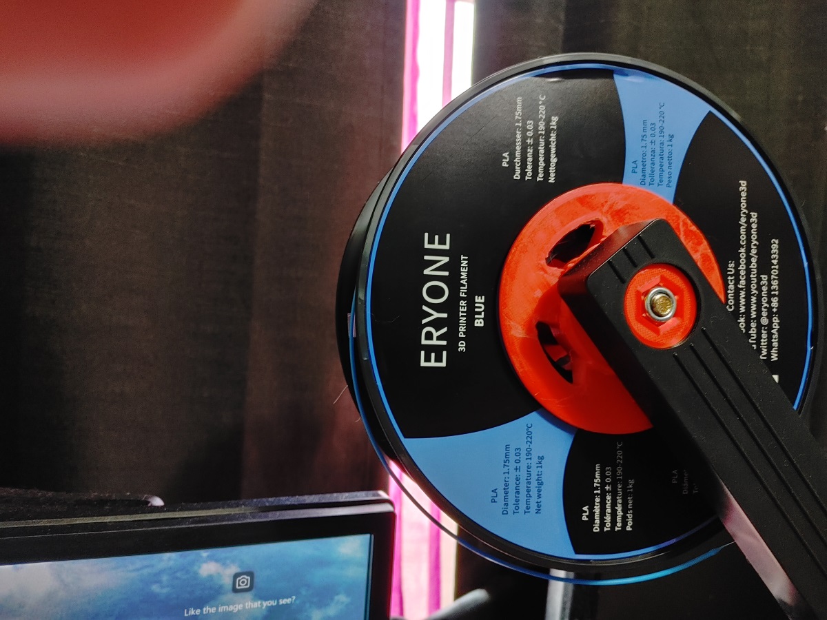

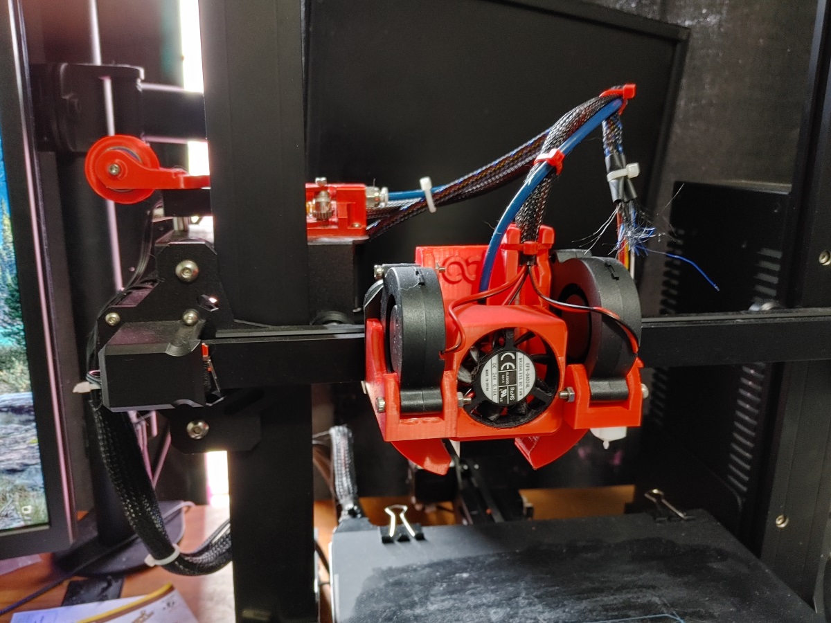

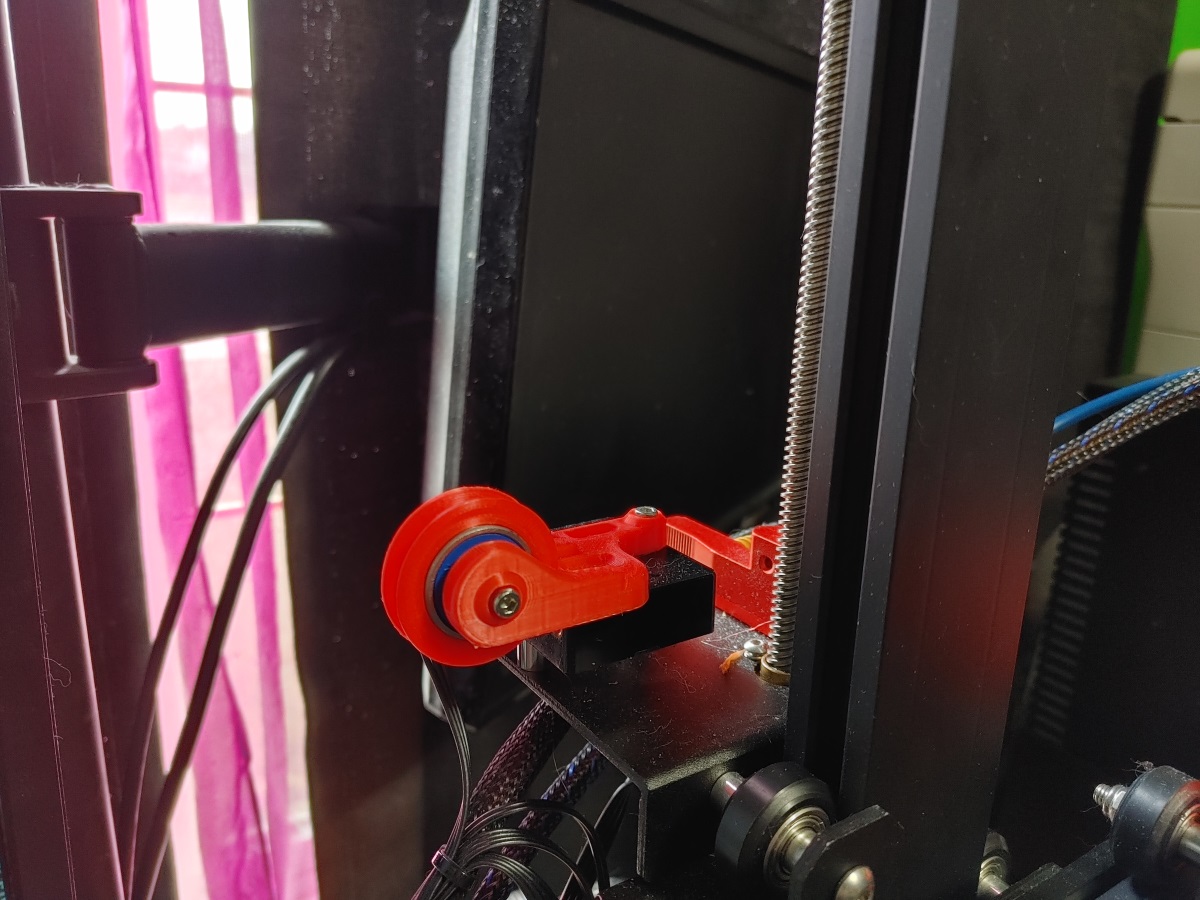

So supposedly something people do when getting an FDM printer is modify it.And thats whet I have been doing. I showed the tool drawer a while back which goes into the right side of the frame. Over the past couple of weeks seeing as I could not get into the work bench I have made a roller for the filament which is on bearings. It now feeds so much better. That led to a roller guide also on bearings, into the filament sensor. A good mod. Finally I modified the hot end and made a two blower fan which already seems to be making the prints better.
Nice bright red which looks pretty good. Next up are some feet now that I am figuring this thing out.

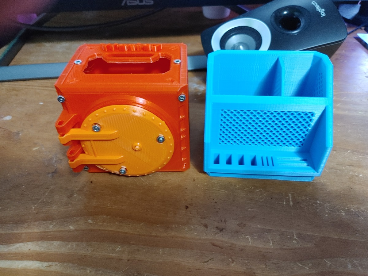

I have also been making a vault piggy bank fot my Grand Son. A blue and Mauve one is next for my Grand Daughter if I can get the lock to work. The gearing on this is the weak spot and I have not yet figured out how to fix it. The door is supposed to lock in place. I also made a desk organizer which will hold pens etc as well as some usb sticks and some memory cards.
