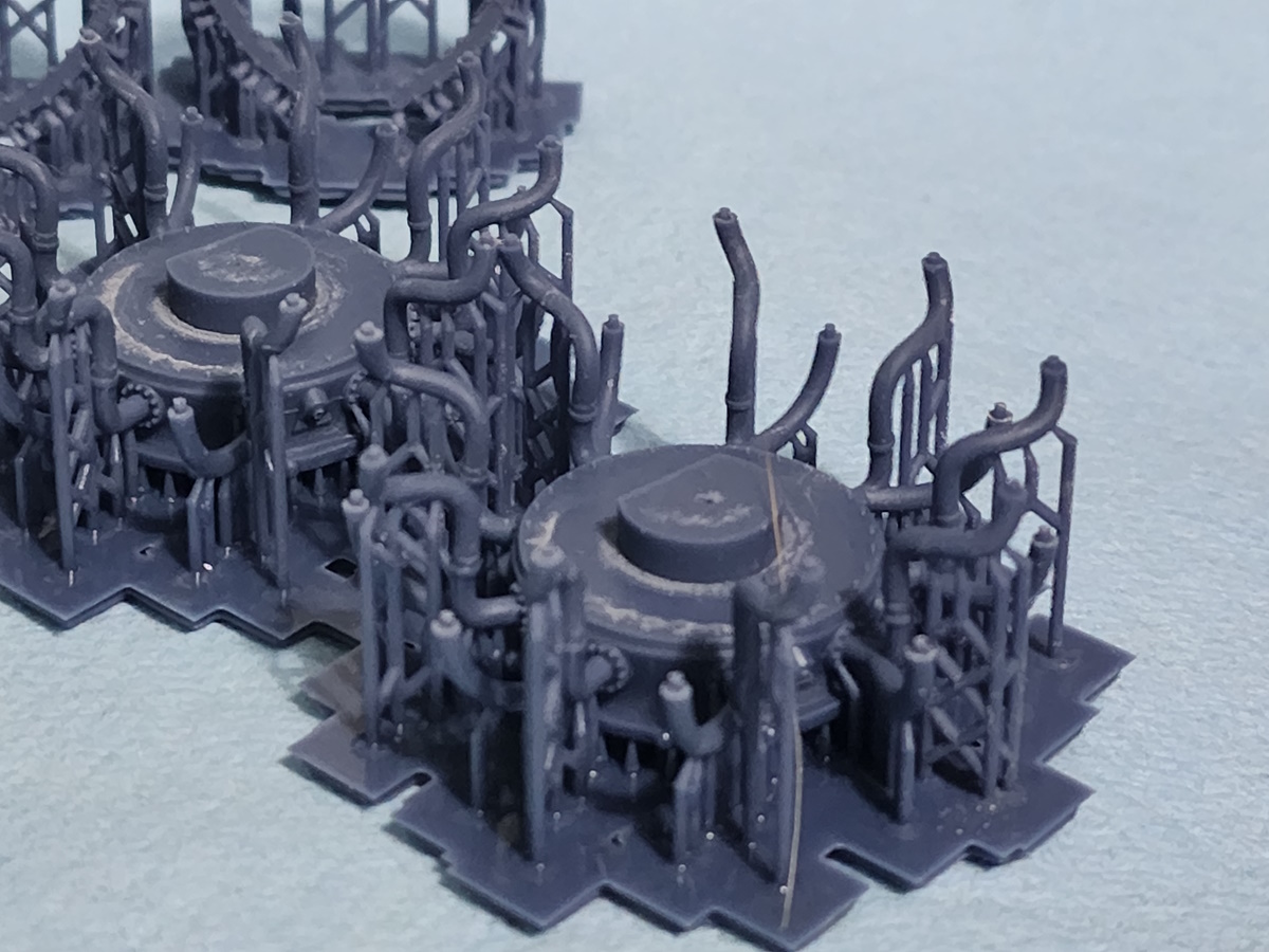

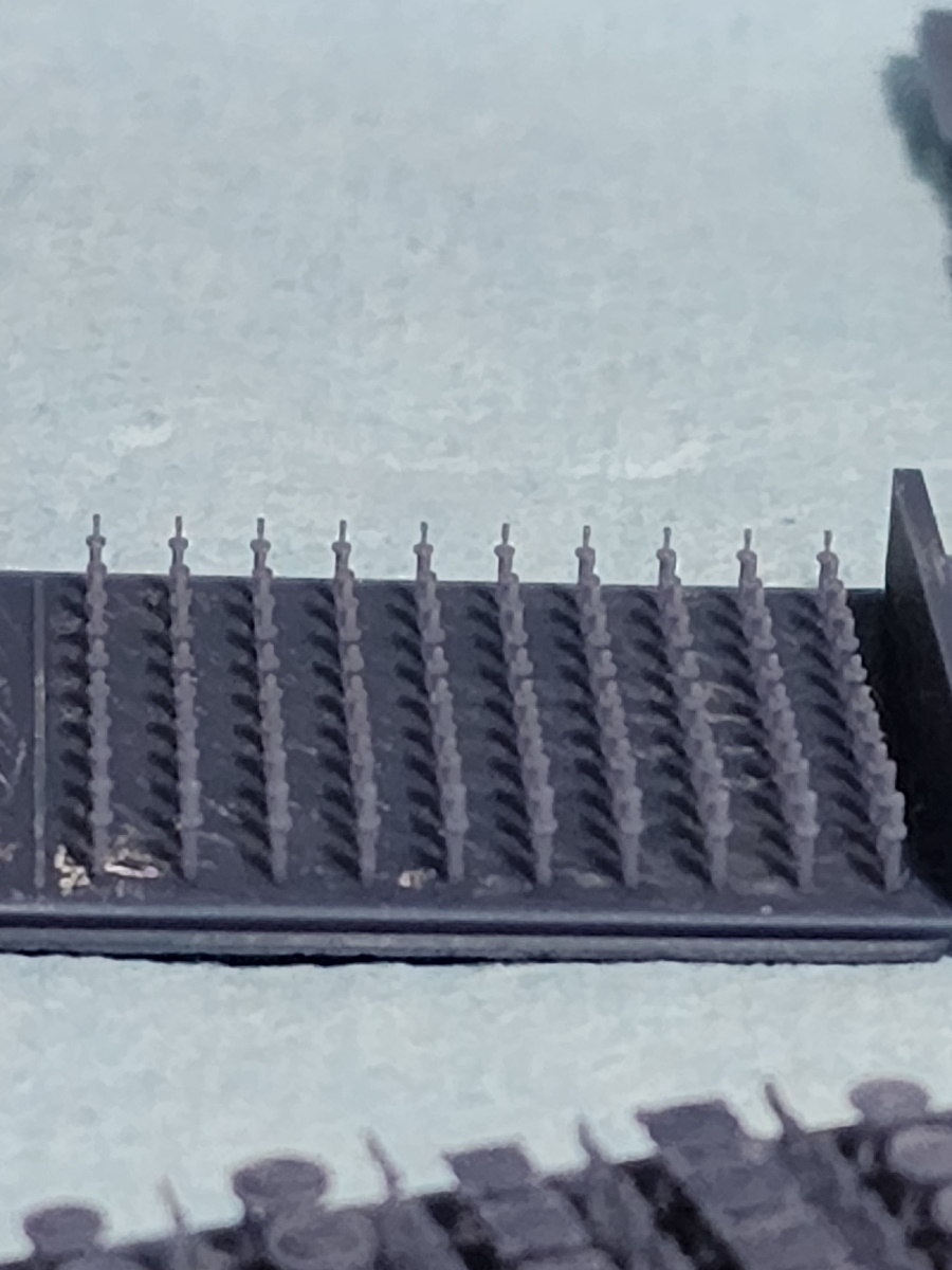

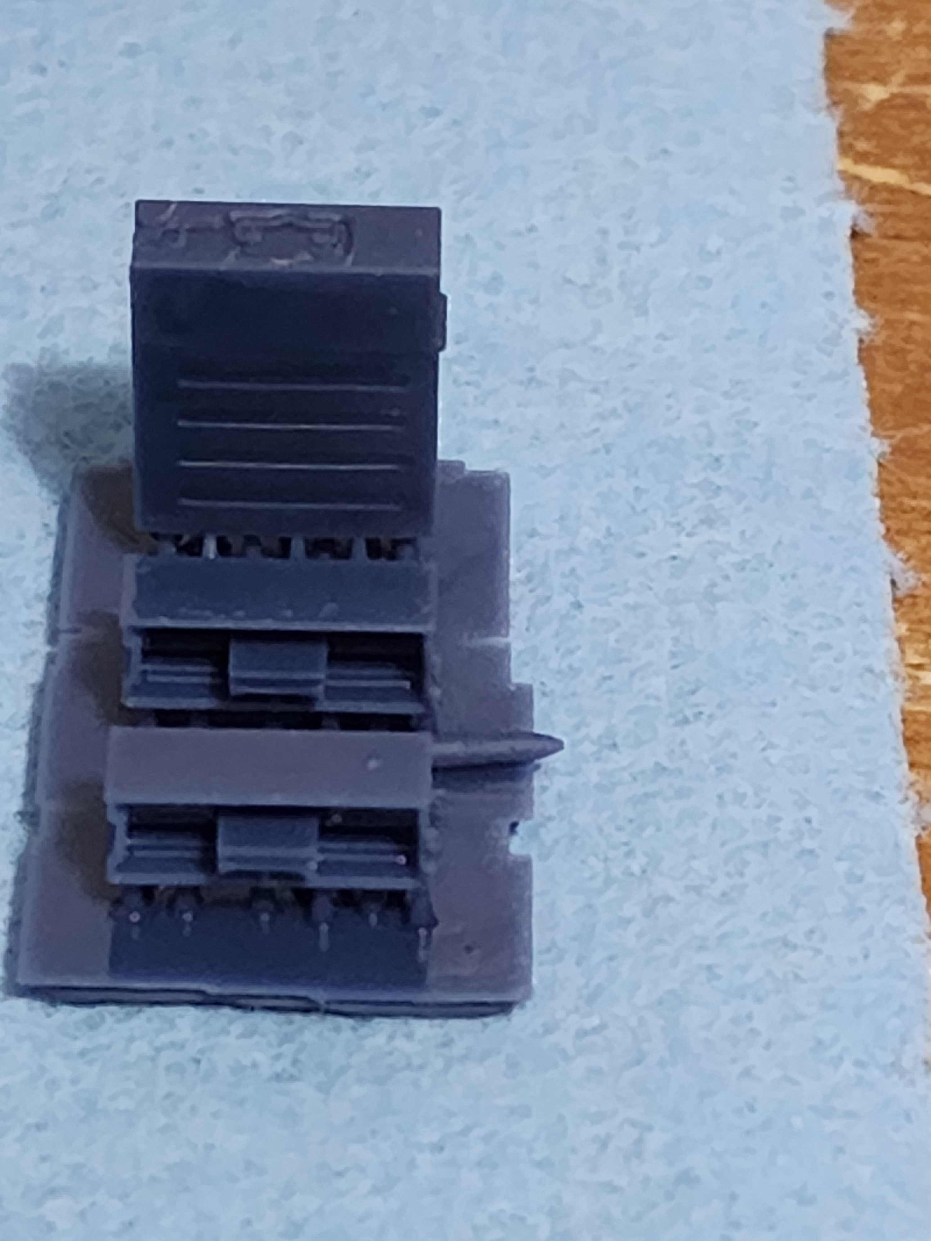

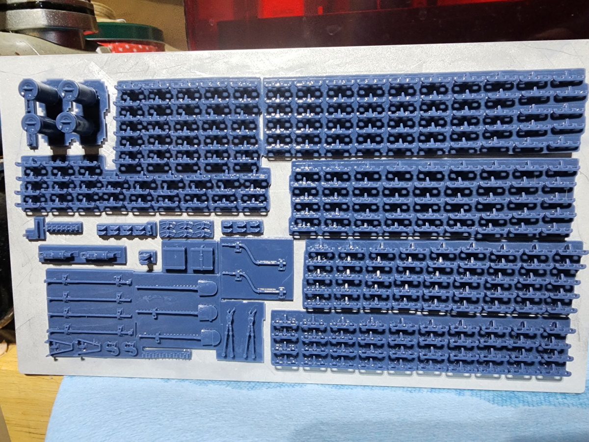

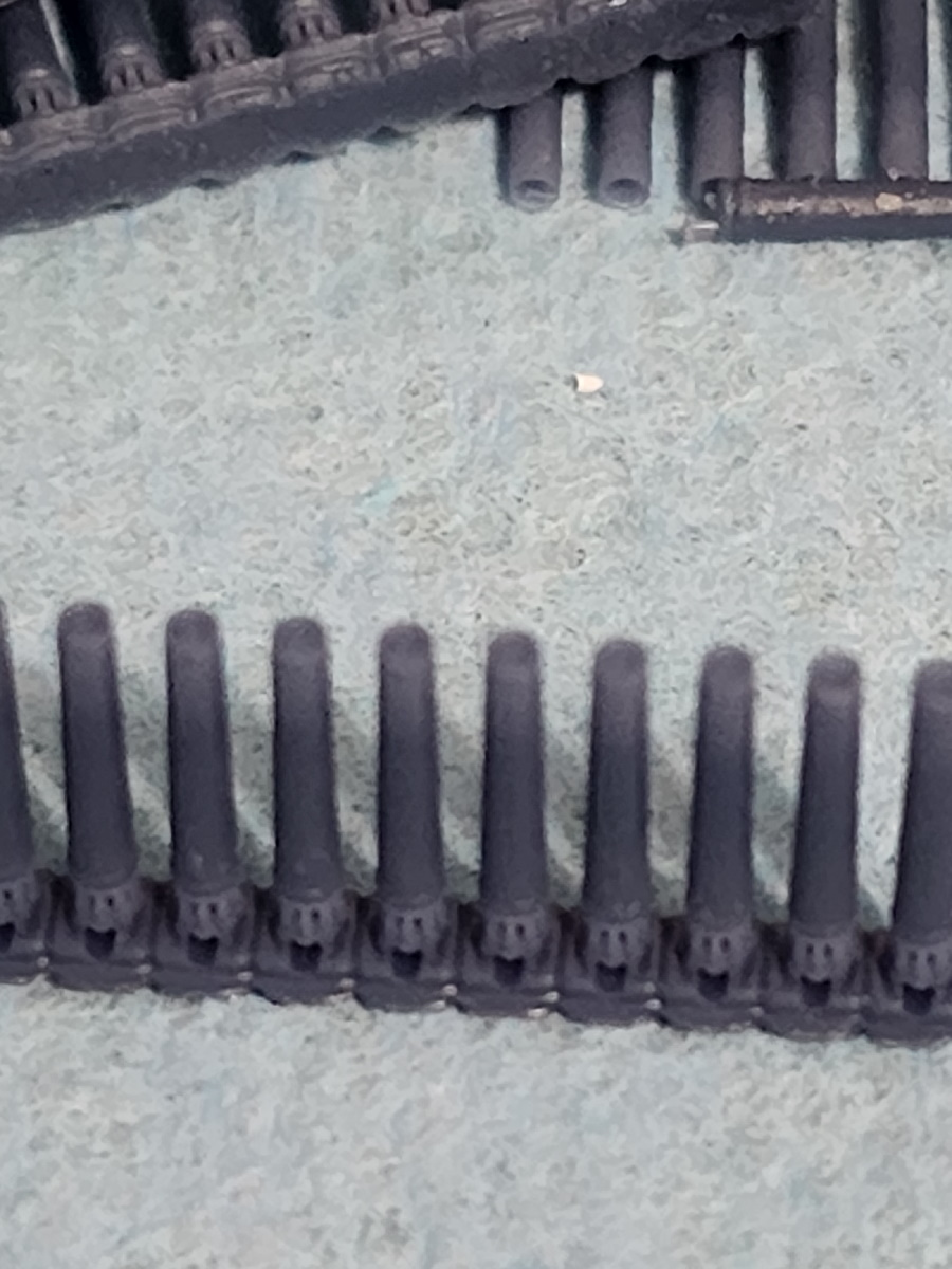

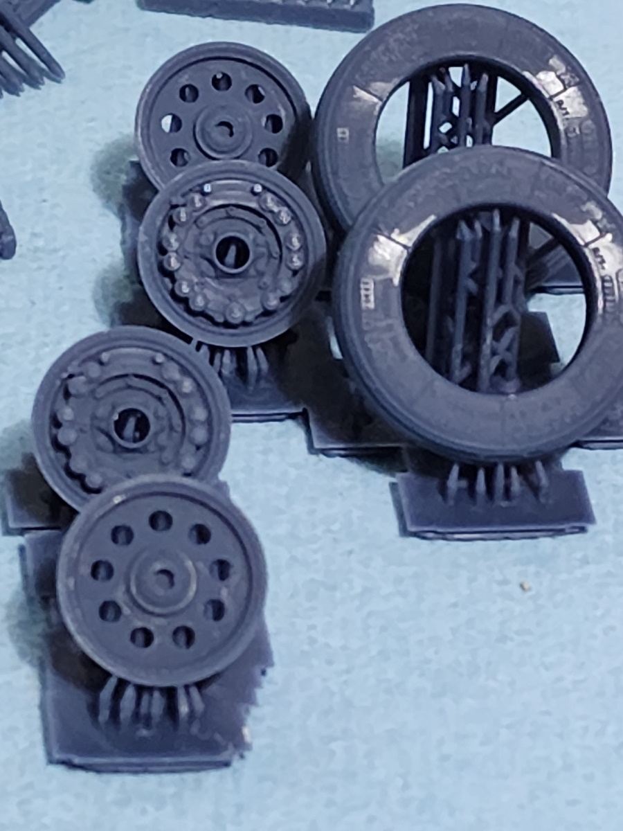

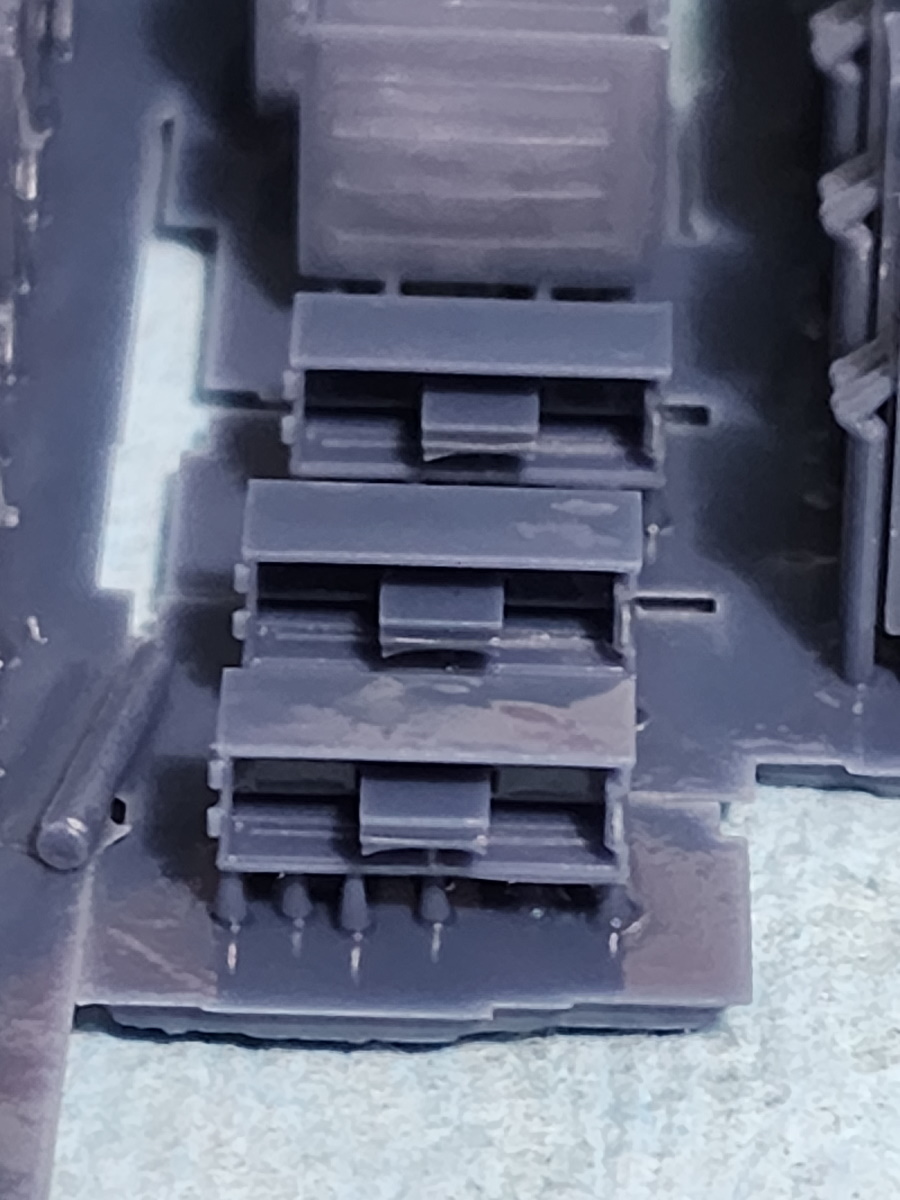

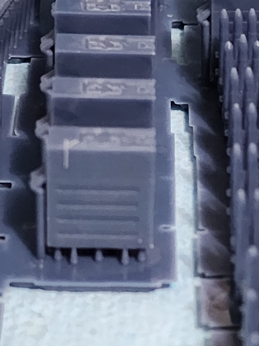

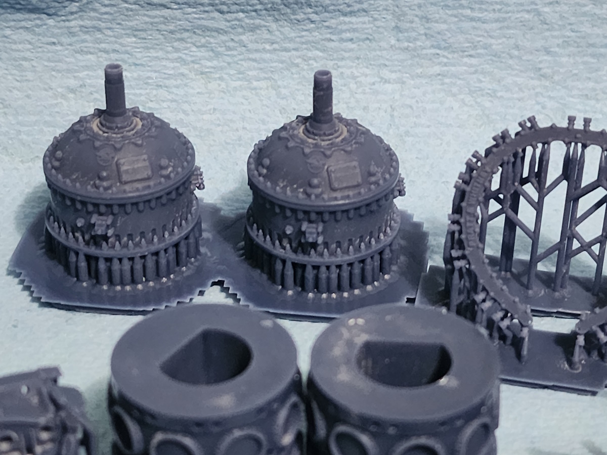

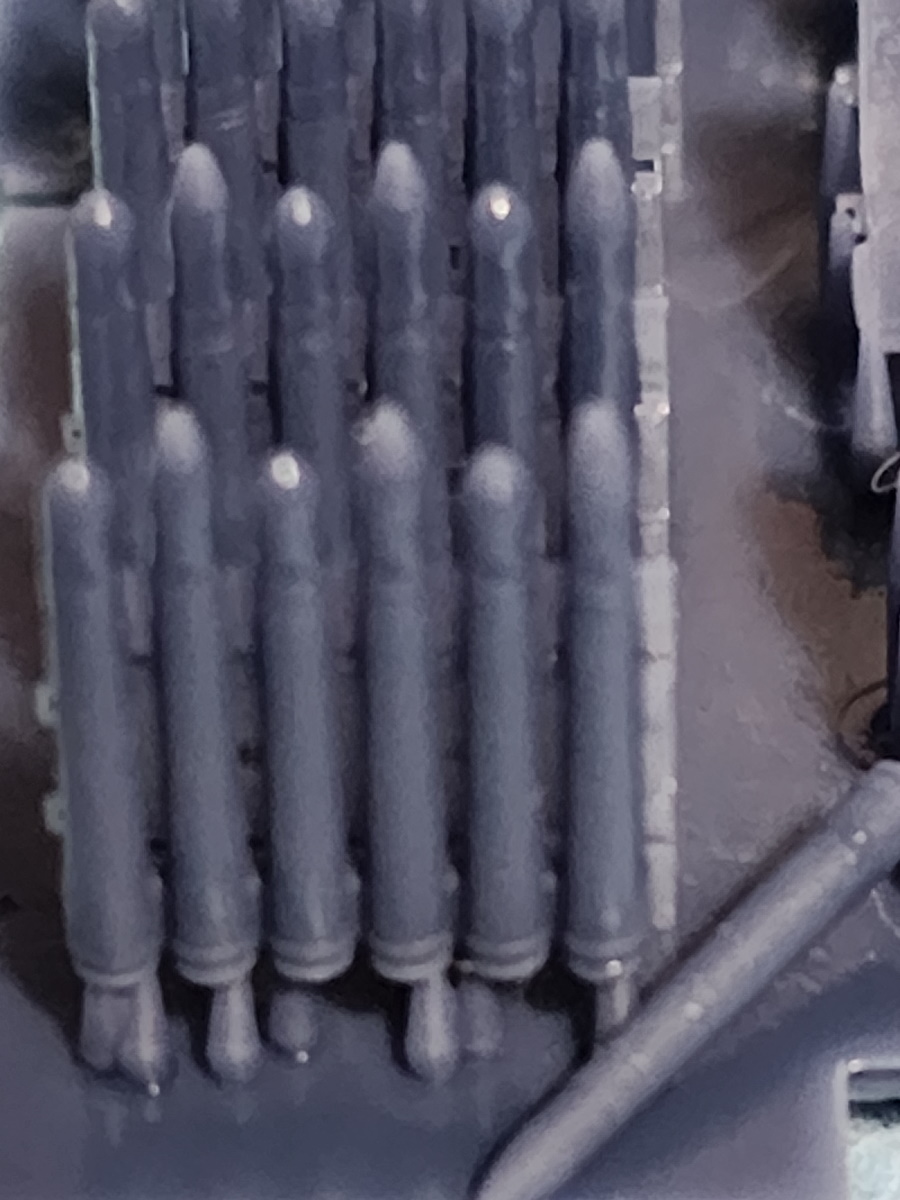

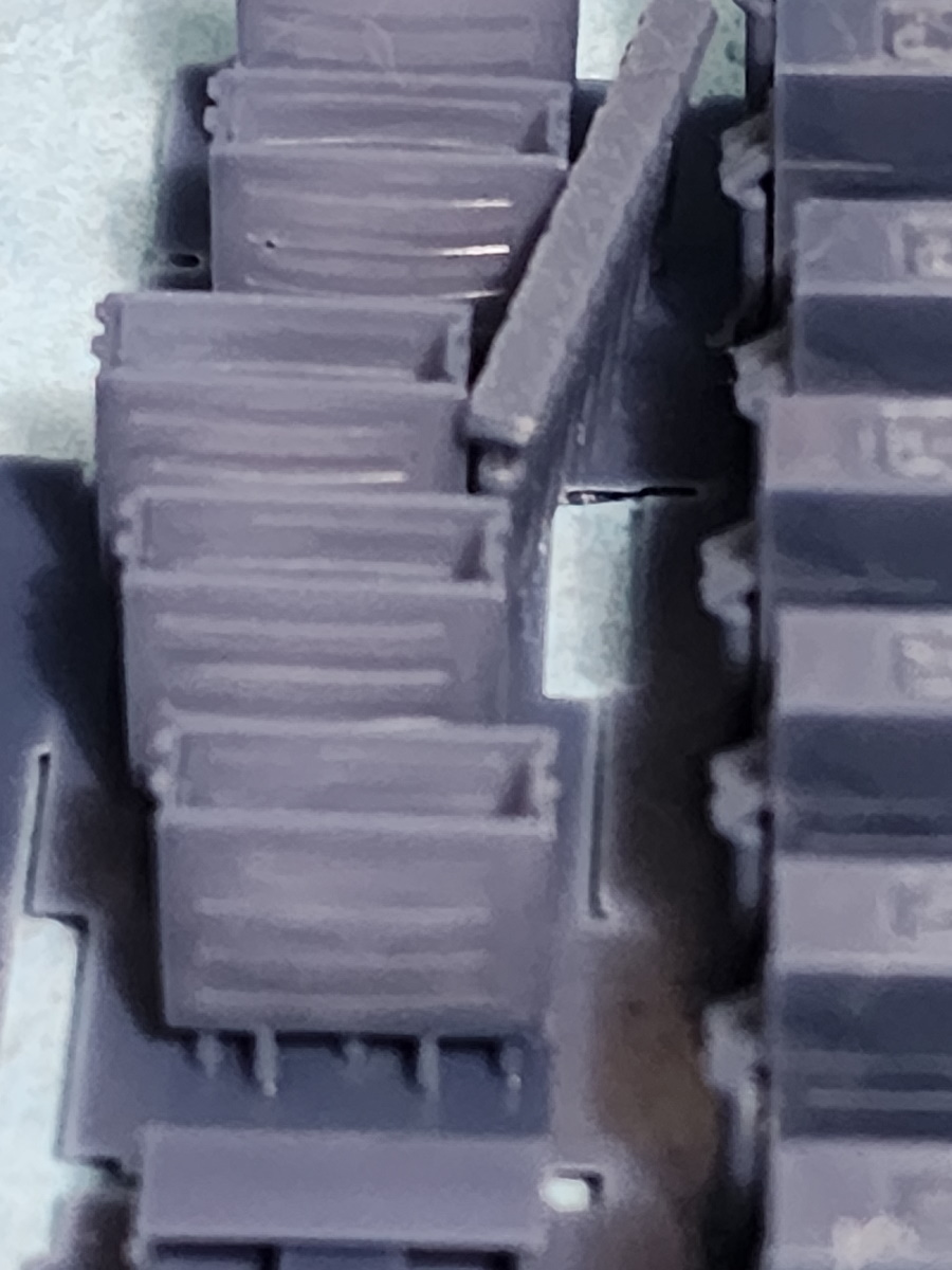

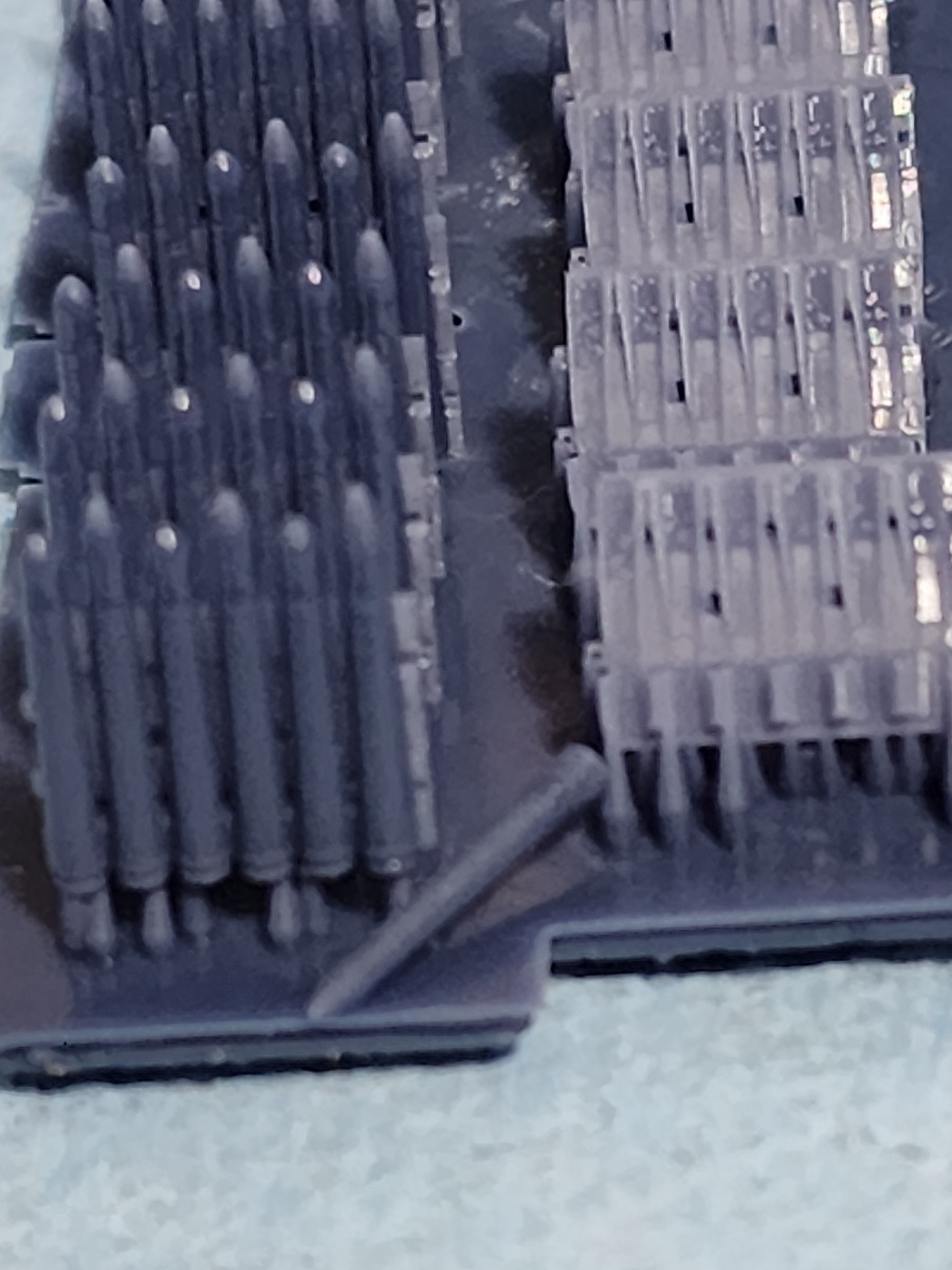

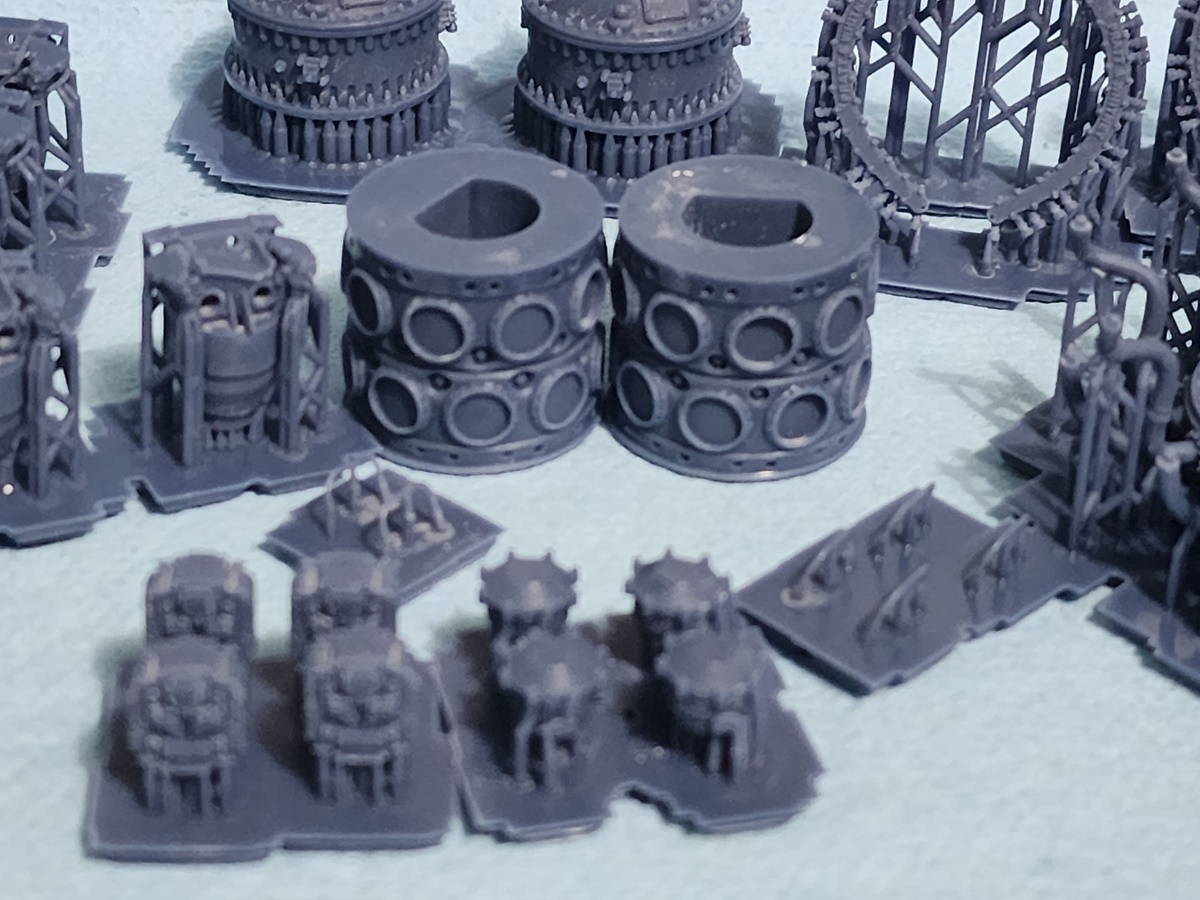

I'm still fairly new to this game but I am going to hazard a guess the first picture was under exposed a bit or more possably expired or poor resin. Some resins like the Sirya Tech Navy Grey you really need to mix well. I have seen on forums where some manufacturers have changed their formulas also with some poor results. If the resin has expired thjat can also affect the print. I have gotten a couple of bottles from Amazon where they were expired or contaminated and has things like that first picture happen. Its not lost though, just sand the waste off and it should be okay.. The next two might be the angle you are printing at. I am guessing you had this attached to the plate right side up. I'm thinking that because there is a bit of elephant foot on the very bottom. I would cant the model at 45 degrees and use supports.
