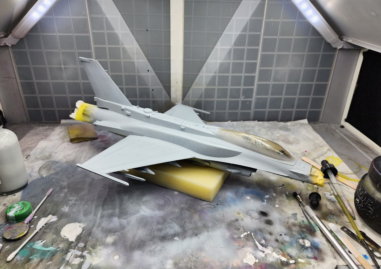

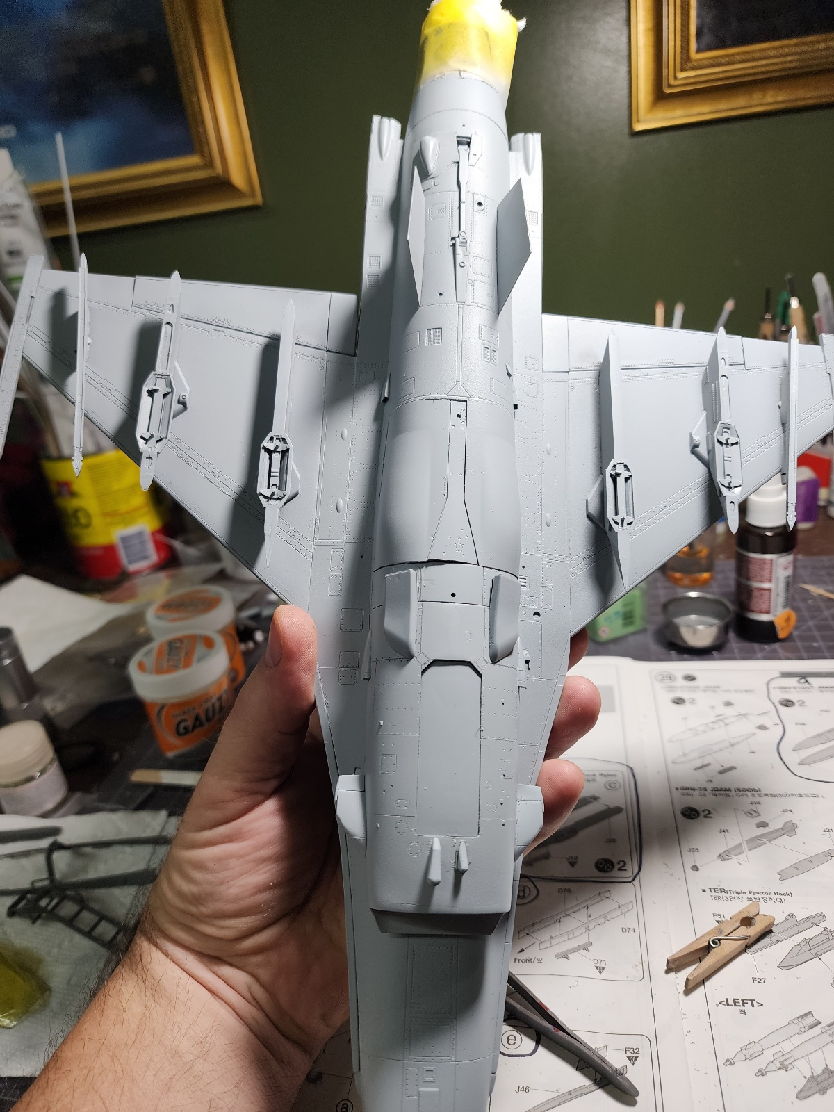

I have the weapon and fuel tank racks on the plane
The plane is taped off for priming
I am going to prime with the stabilizers off.

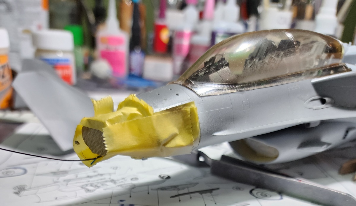

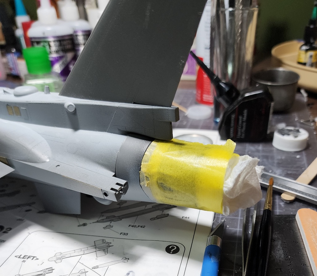

I am having a ridiculous time with the canopy. I tinted the front half with Tamiya Clear Yellow and Smoke like before, and it looked good; then the next day I dipped it in AK Gauzy Glass Coat and it made the tint crackle. I removed the tint by wet sanding. I don't know what will and will not hurt the clear plastic to try to use something to strip it off. I used Vallejo Yellow and Smoke this time, then dipped in Gauzy. It looks awful. So, I risked using alcohol to strip it since I know it removes acrylic paint but thought it may not harm the plastic. But it kept running through my mind "acrylic paint is just colorized clear liquid plastic, the canopy is some sort of clear plastic...eeeek". It worked out ok. Lots of elbow grease. The canopy is clean once again. Now I will go back and re-watch the Youtube video to see what I did wrong.
The plane is primed in gray so I can see what needs to be touched up as far as scratches and fouled panel lines before black base.
