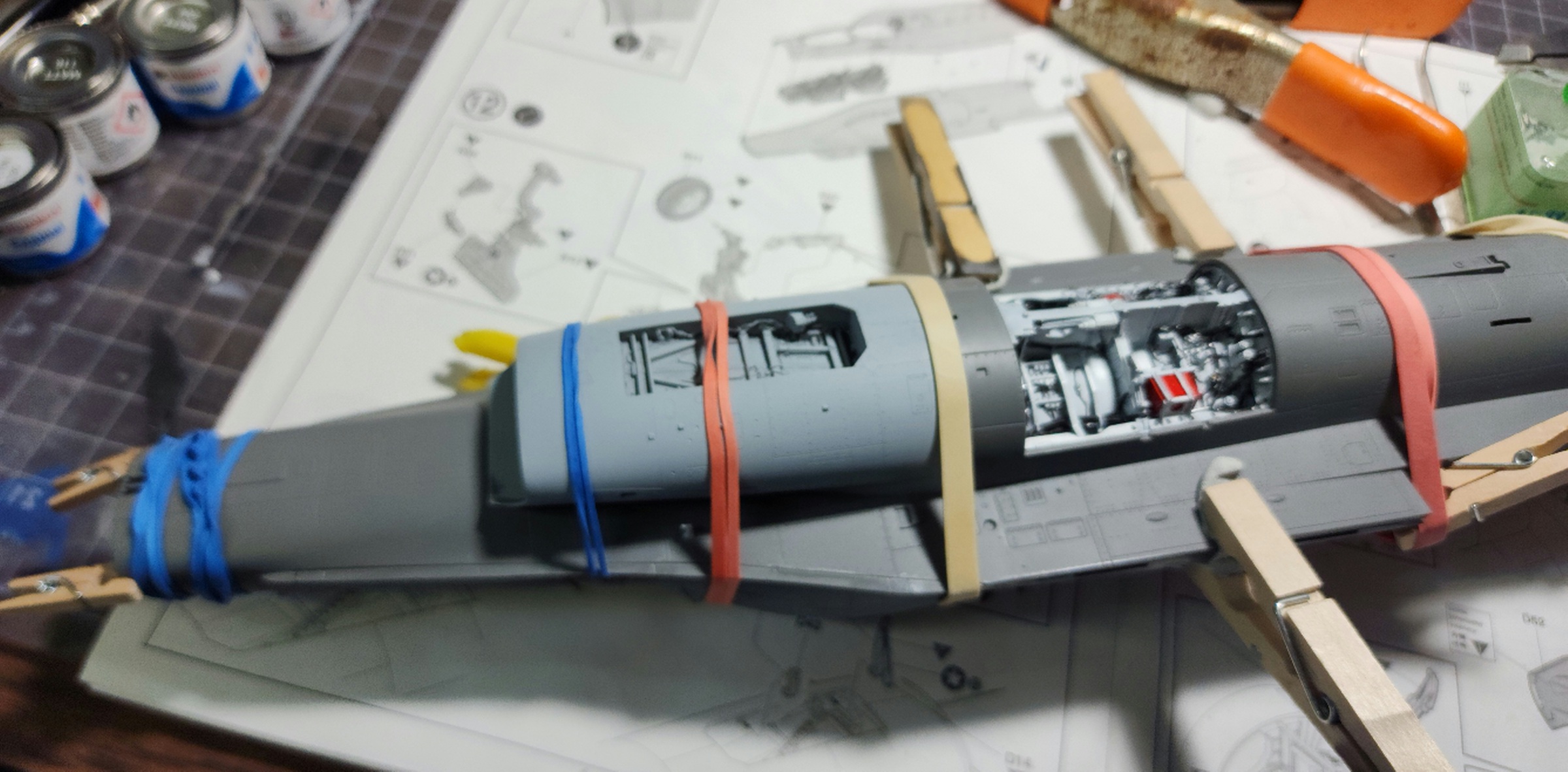

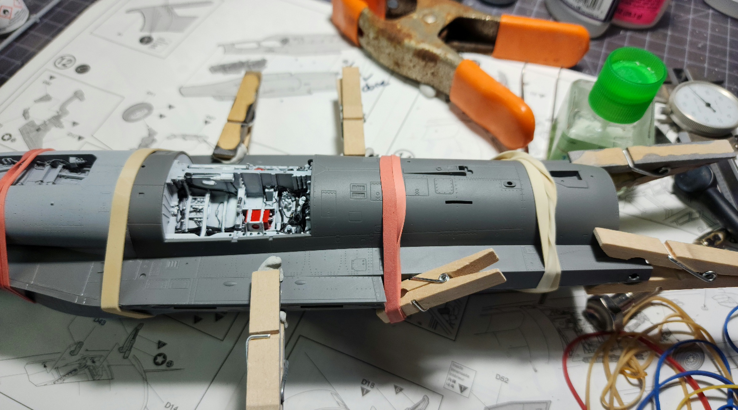

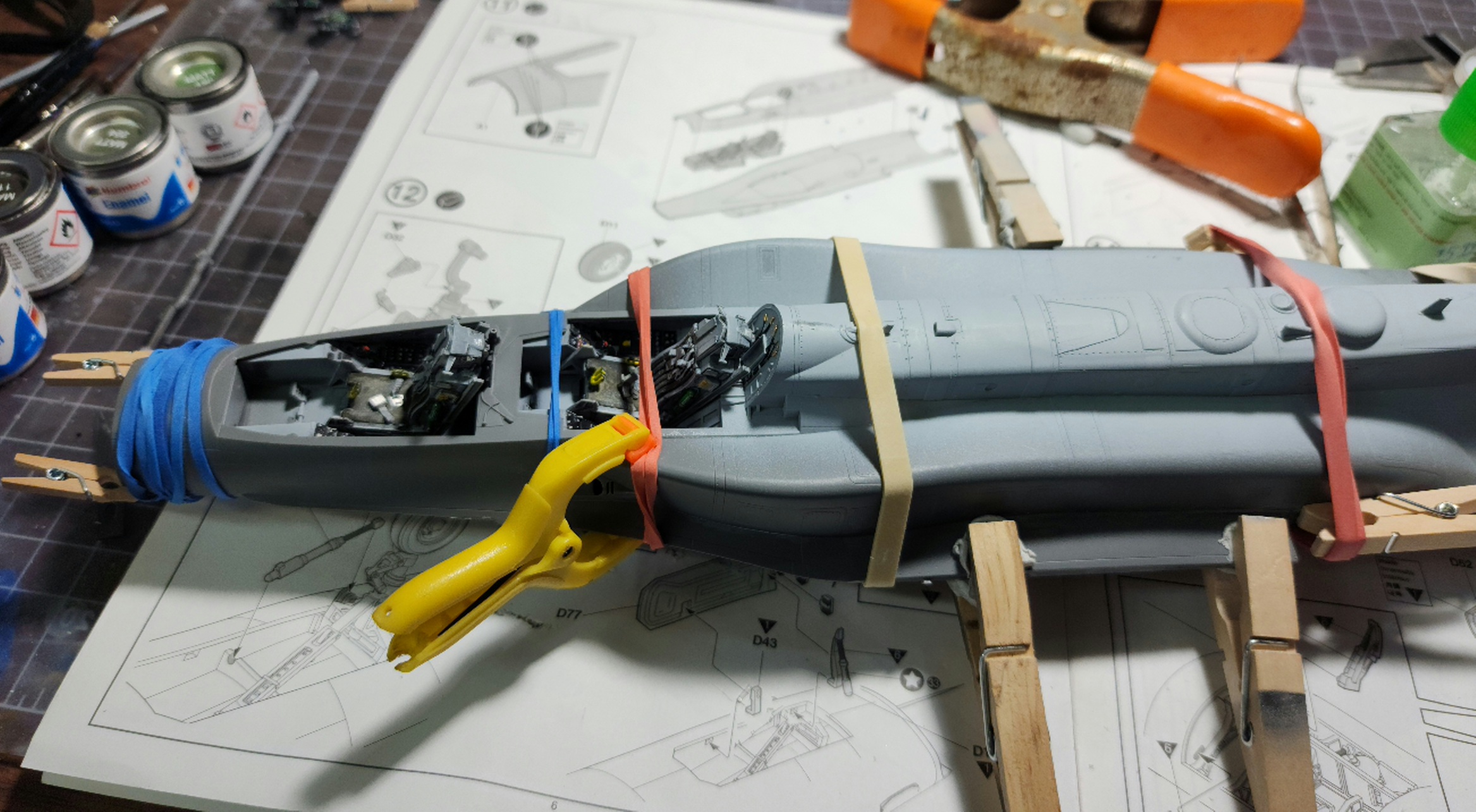

A lot has happened since the cockpit was finished. There were many extraneous parts on the top portion of the fuselage. I am trying to be extra careful with the seams so that sanding will be minimal. These might be my best seams yet. I have use Gunze Liquified Putty and Mr Surfacer 1000 to build up ever so slightly and make the seam disappear. I have been mostly successful. I redid some panel lines and rivets where needed.

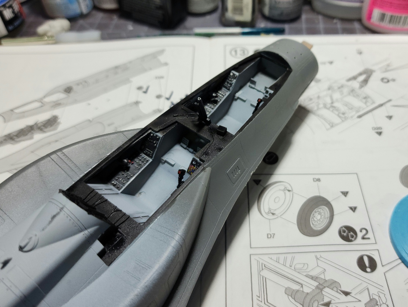

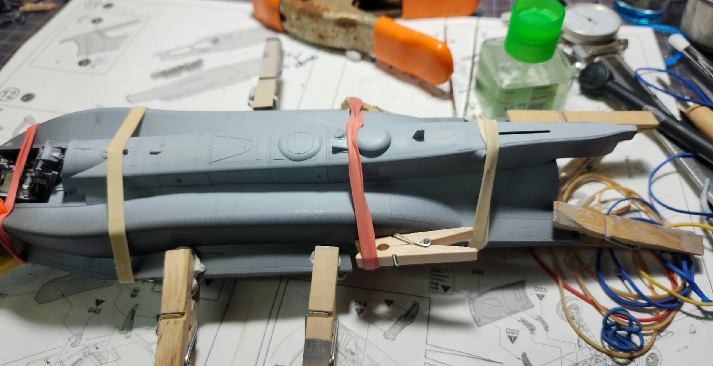

The cockpit is installed and fit perfectly. I cut off the top portion of the canopy prop and made a metal replacement part, but will leave it off until after I paint the plane so I can use one of the canopies as a "mask". The fuselage halves were very "fiddley" to get even, and the extra clothes pins are for areas that needed extra persuasion to stay even. For the slightly angled areas where the wings attach I added some putty to the clothespin because it kept popping off. The putty seems to keep it in place.
That is it for now. I put Tamiya cement along the seam and will let it sit for a long time!

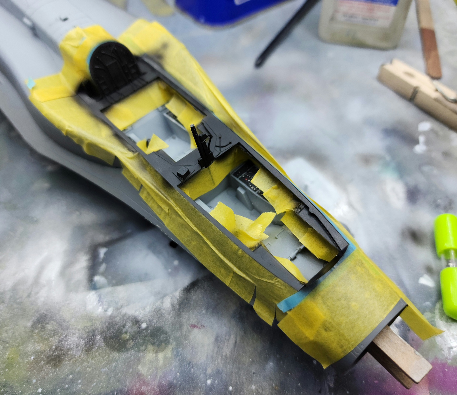

Well, I had a change in plan and decided to paint around the cockpit in flat black. I removed the seats and I taped off as carefully as I could and sprayed Alclad II Black primer and microfiller.

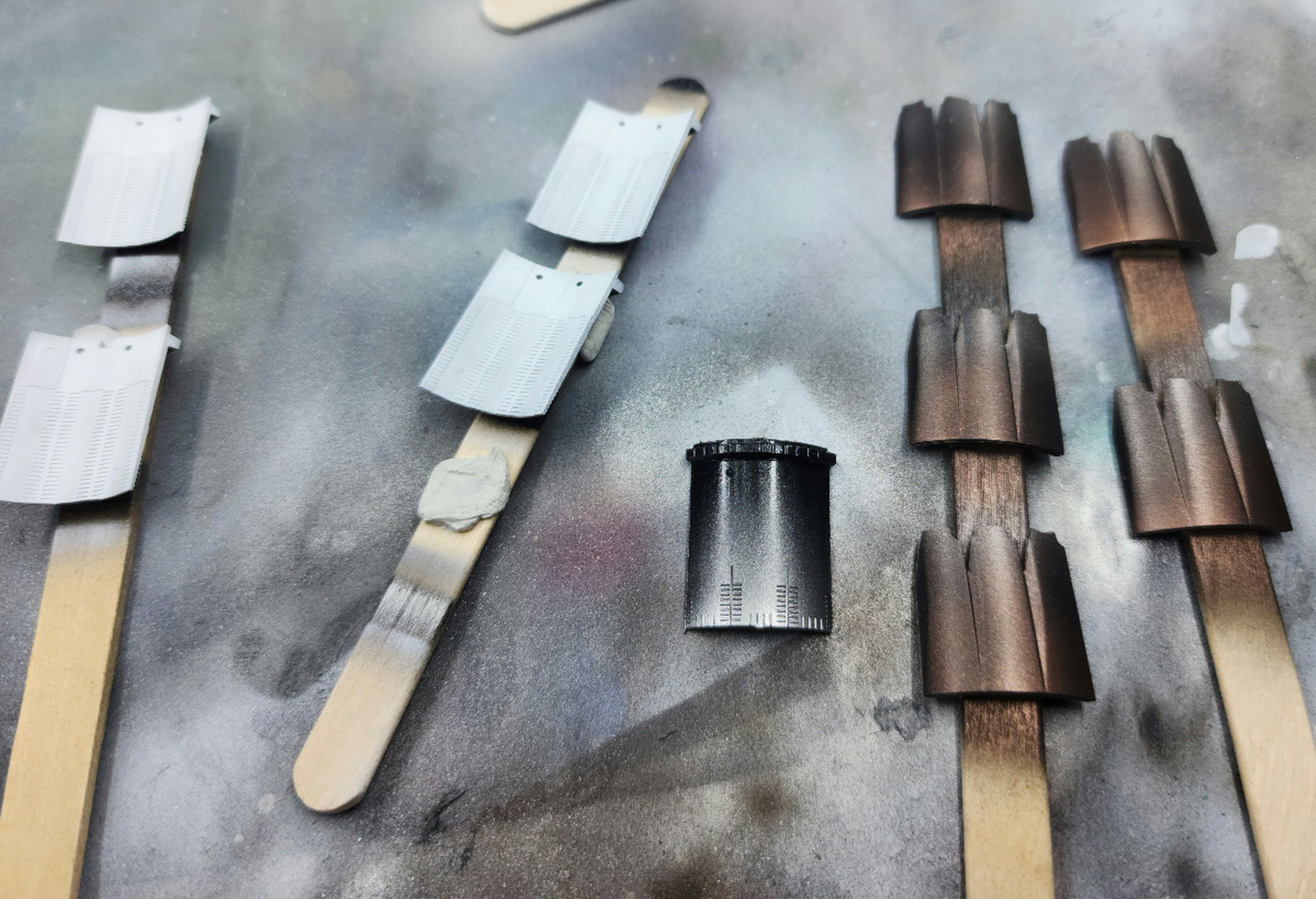

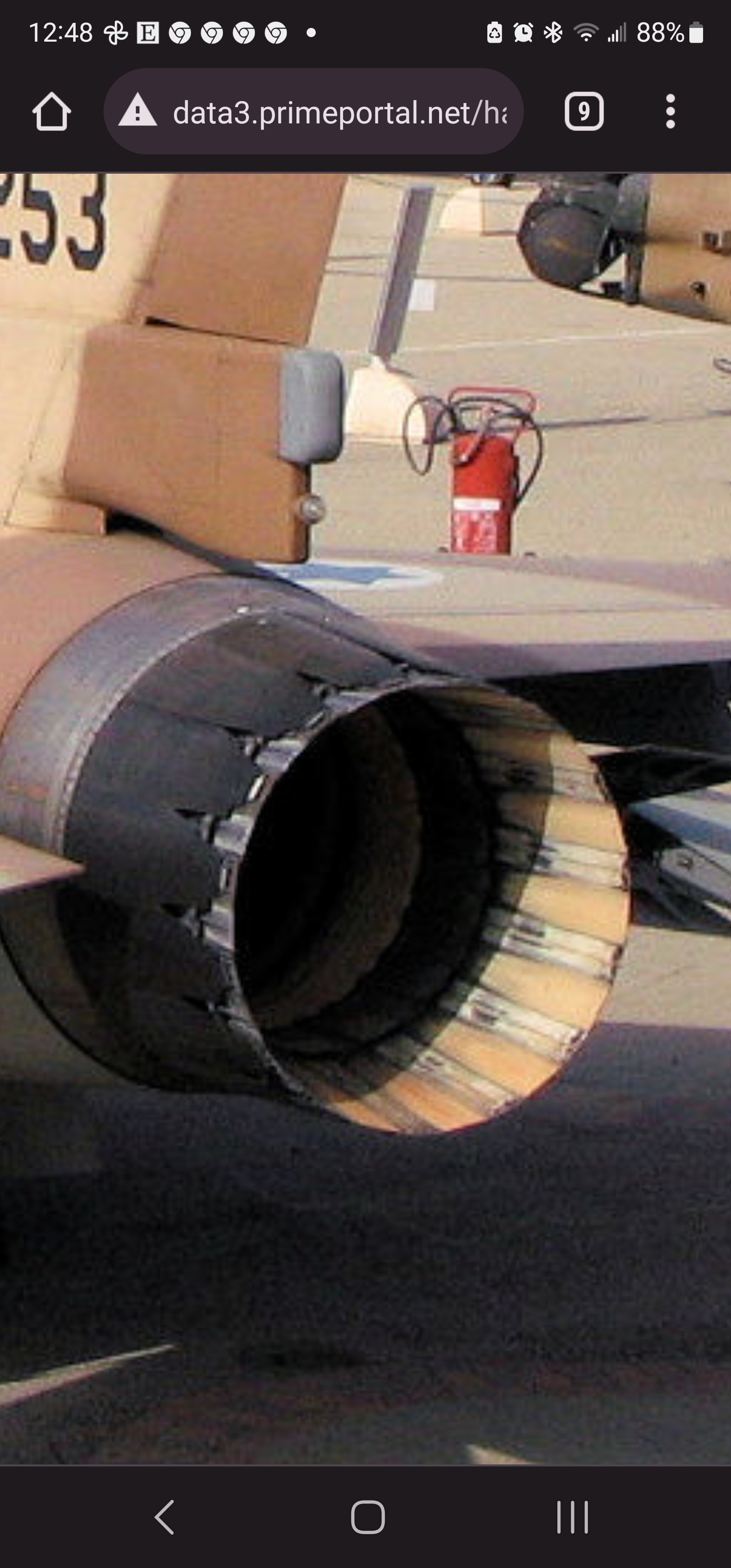

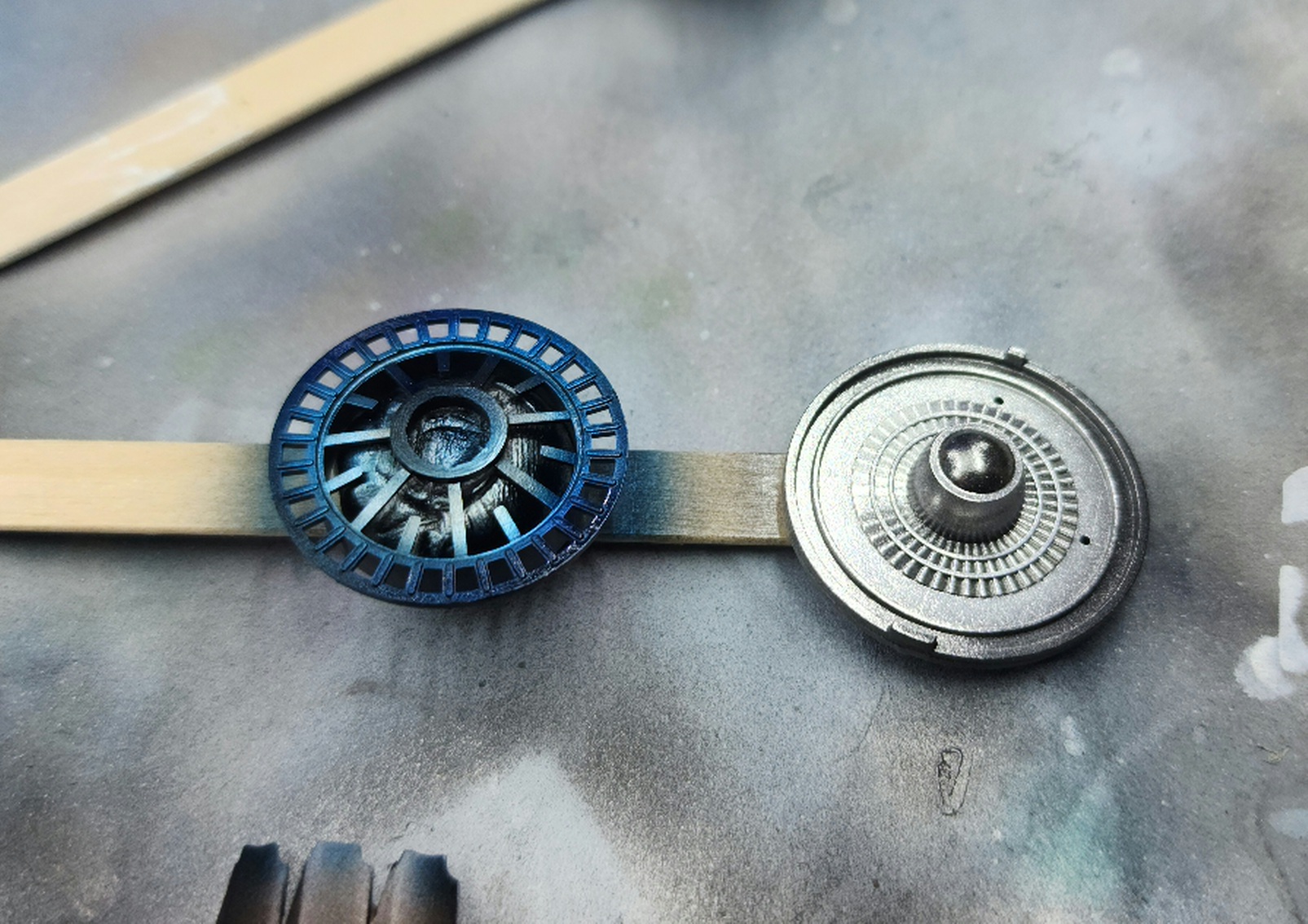

Working on the...uhh..nozzles? Where the jet exhaust comes out. For the inside, I am trying to match this reference...

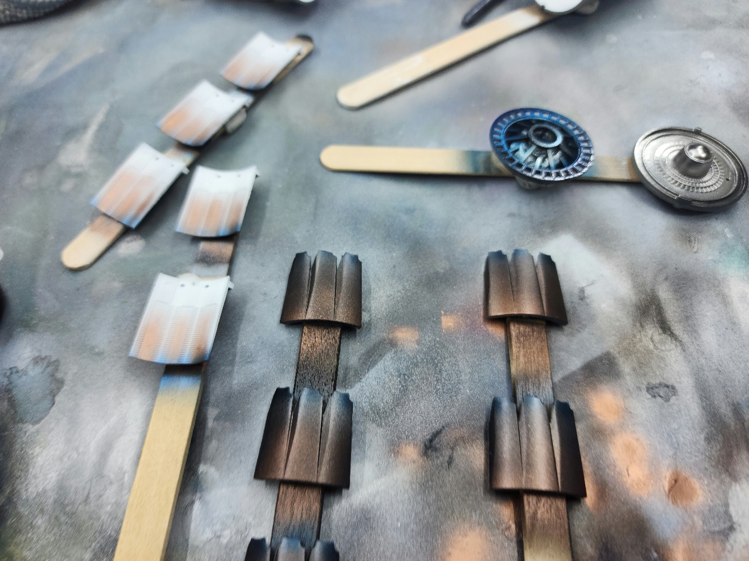

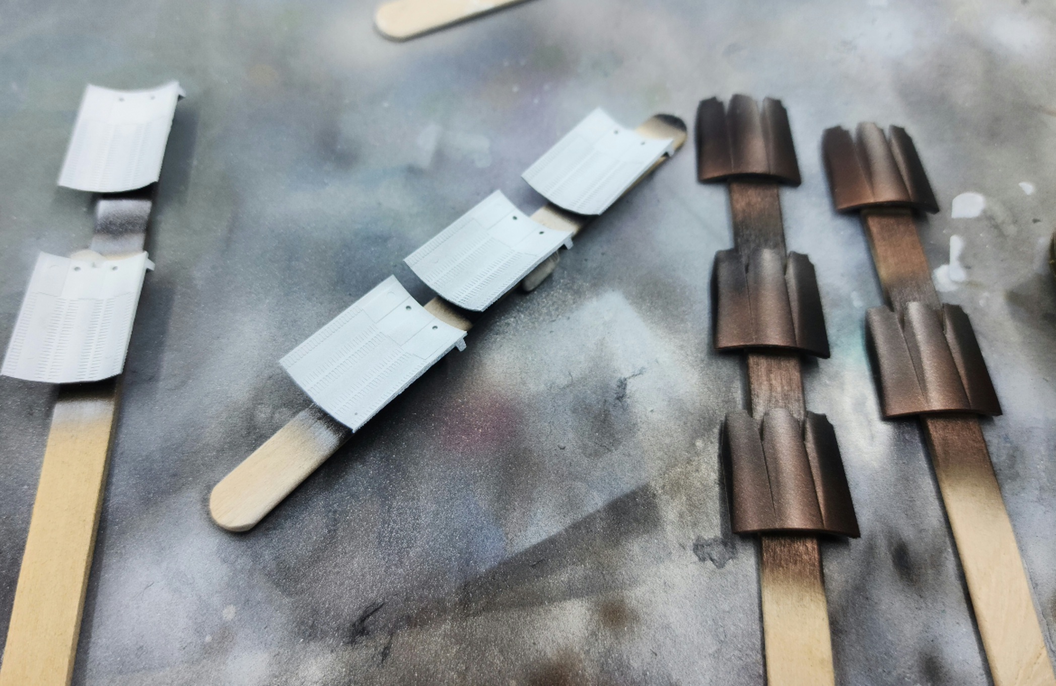

For the inside I am painting white, then Alclad Copper sprayed at a low angle from the bottom so it fades out. For the outside of the inner part I have sprayed it gloss black, then use Alclad Magnesium for the surface. Only a small portion shows. For the outside parts I based in gloss black, then used Alclad Jet Exhaust over the whole surface, then used copper sprayed from the top at an angle, then a very light magnesium sprayed from the bottom. A final blast of transparent blue near the outer edge of both inside and ouside. A black enamel pin wash will finish them up.

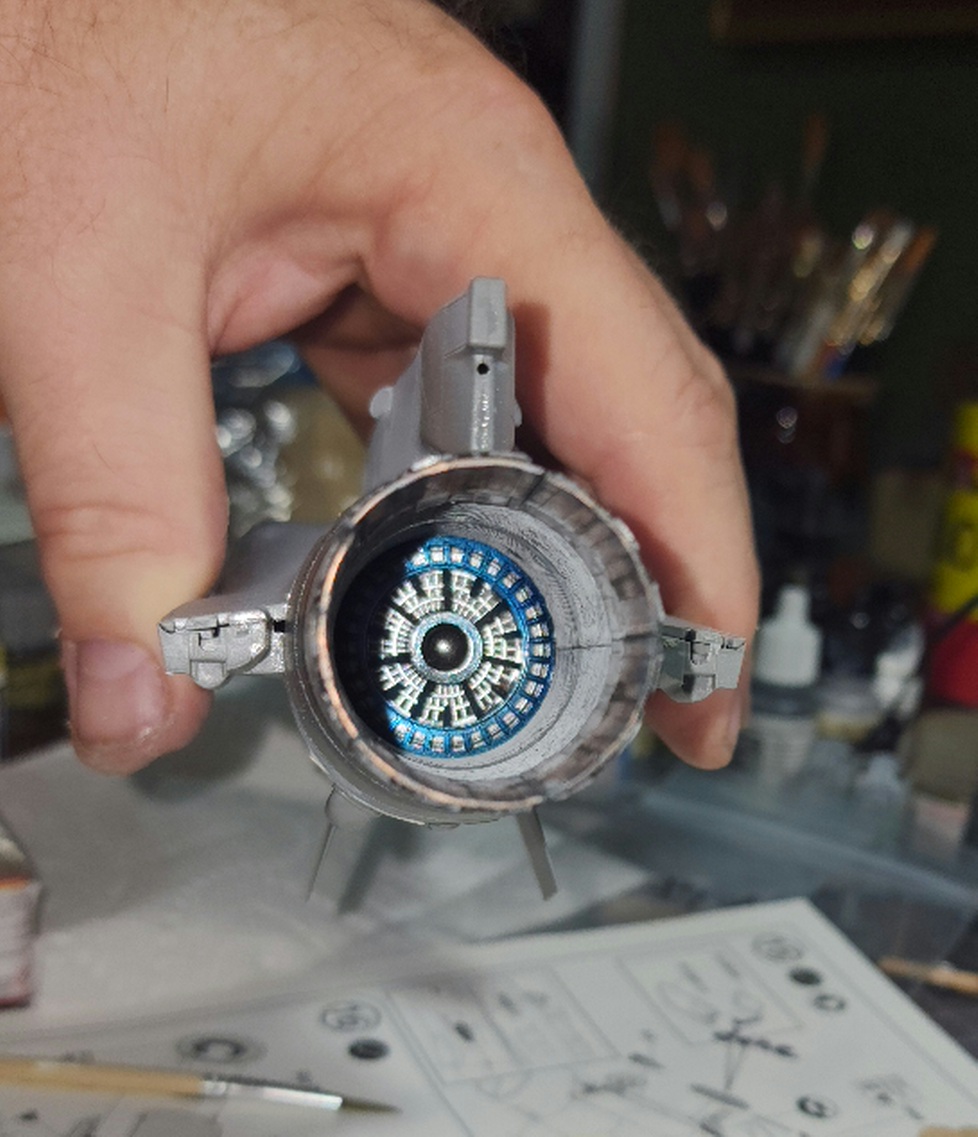

for the turbines, the back part is chromed and the front part is chromed then a thin layer of transparent blue. I hope that will look right!

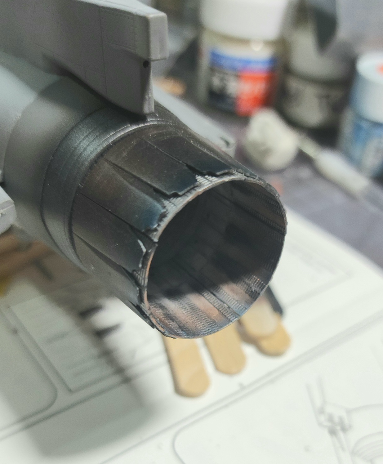

Ok, I have the nozzles in place and am happy with the look.
...and the reference again
...and the inside

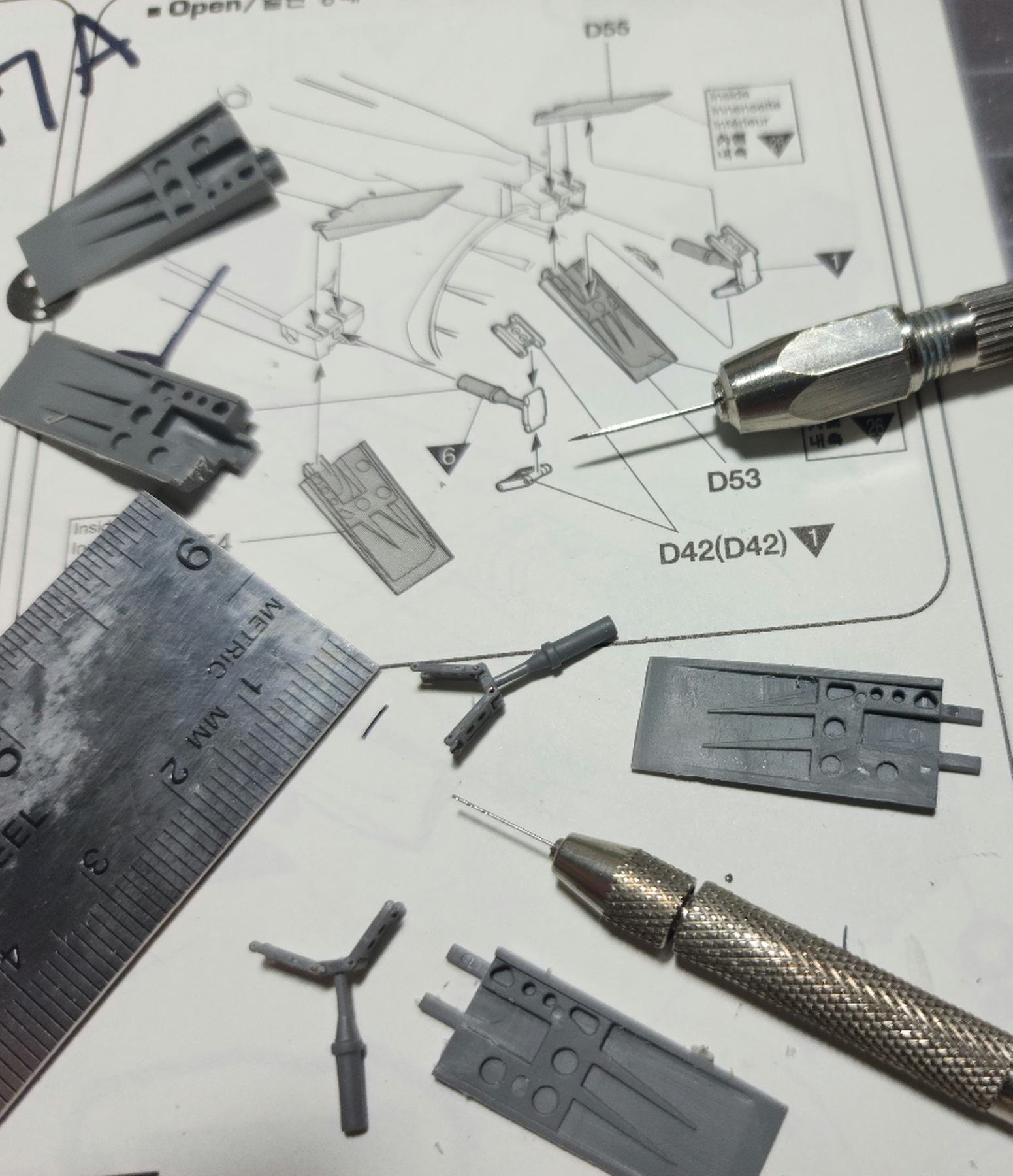

I started thinking about the air brakes and was baffled how I was going to hold everything together at the correct angle while I glued it. I decided to drill holes and put a 28gauge pin to hold the piston and brackets (I am assuming that is what they are called). I will paint these pieces and assemble with superglue
Onward and upward I go!

Thanks guys! I noticed in the reference that the area between the orange burnt area is more white so I will drybrush matt white over those ribs since the black wash made them too dark.

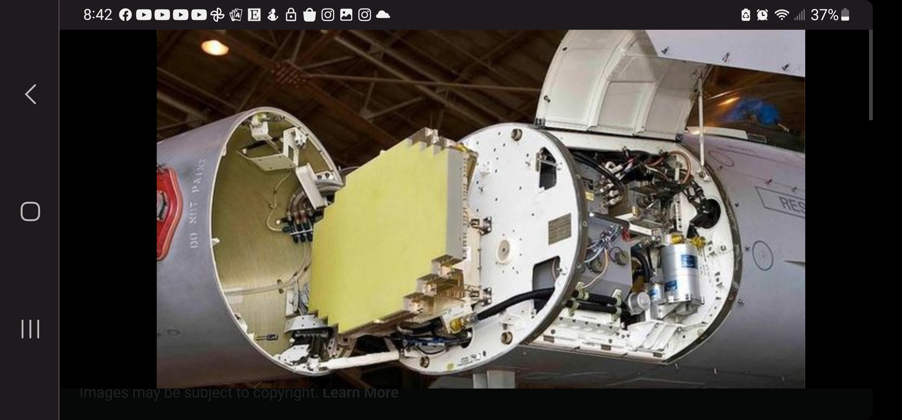

Ok, call me nuts now, but I am entertaining the idea of trying to replicate this scenario...

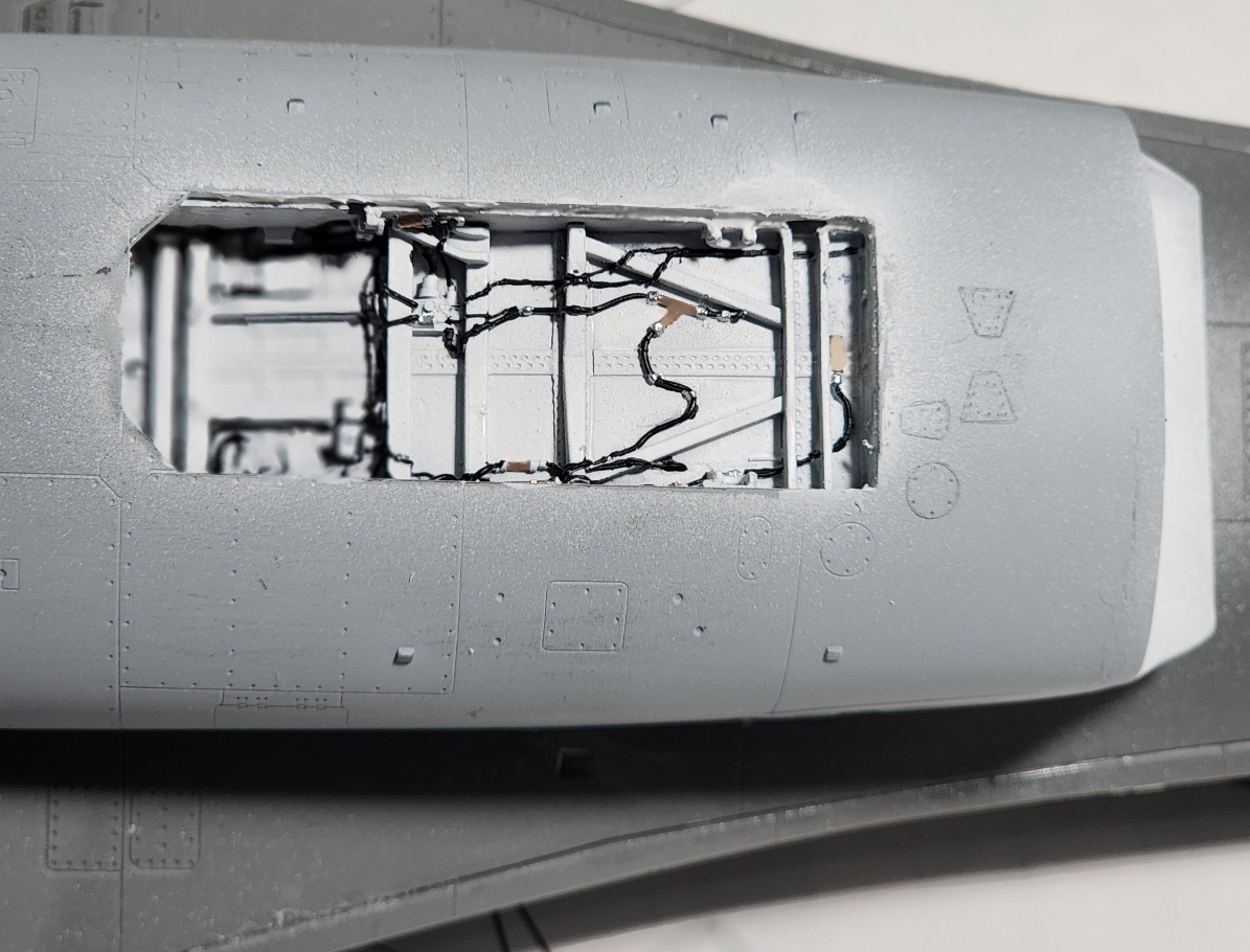

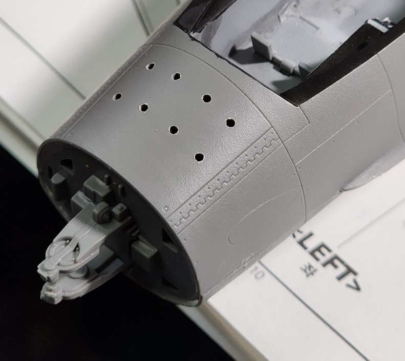

The kit has the parts that are inside the cone, just in front of that white bulkhead. What I am talking about is the area behind that, with the panel raised up and propped open. I will need to open the panel, which has my innards squirming a little. I am having trouble figuring out to to make the hinge at the top. Check the image of the moulded hinge...
It is that zig zag type hinge. Does anyone have a suggestion for that. I think metal sheet to cut out the surface, and maybe tiny sections of metal tube glued on? Or mabe cut the simulated teeth, then glue a continuous rod with notches grooved in to simulate hinge joints. It is 19mm long with 13 teeth in each direction, so we are talking small here. Is there one already made, and if so, where might I find it? If not, I may try to make the hinge before cutting the plane to see if I can even do it. Yeah, I will start there. Thanks! Good talk.
Wonder what that hinge line look like in photos, do you really see the piano hinge like that or is this overstated for the model? also remember you're looking at two different blocks of F16 here. even the components inside that bay are different. With this Israeli aircraft you could have another system completely different. Sure the electronics bay would be there but what's stuffed inside.
Good points. I thought the second photo was Israeli but will look further. Also, I found some photoetched hinges by Eduard from one of my suppliers.
