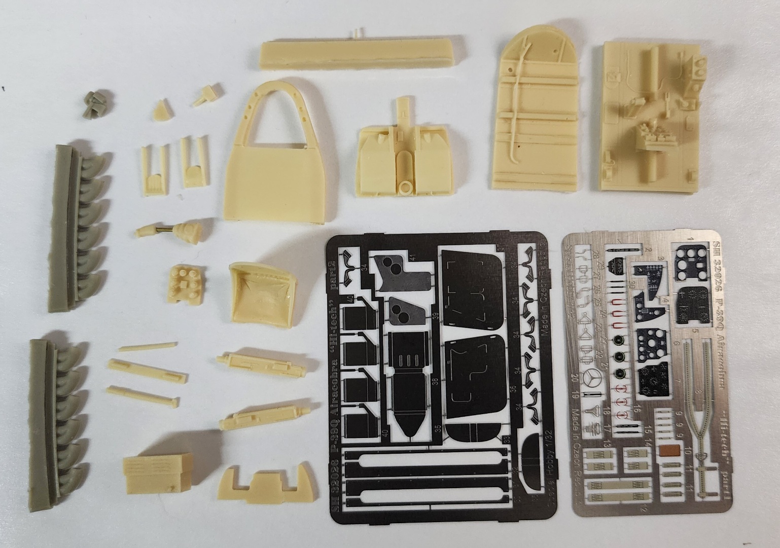

My friend John Montgomery purchased this kit to build, but after reading the reviews and looking through some build threads he decided it was too difficult for him and gave it to me to see if I was brave enough to try it. I am not sure "brave" is the right word, but "naieve" may be more accurate. The kit looks solid enough with lots of extra goodies in the box. There are two PE plates and two bags of cast resin parts. I did not take pictures of the sprues since I have already clipped "step 1" parts off, but the instructions show the sprue trees. I already clipped off some resin parts as well, breaking 2 of the delicate parts even though I was being extremely careful and nibbling away with the back of an Xacto blade. The joystick was repaired with a bit of brass rod, and superglue fixed the other.

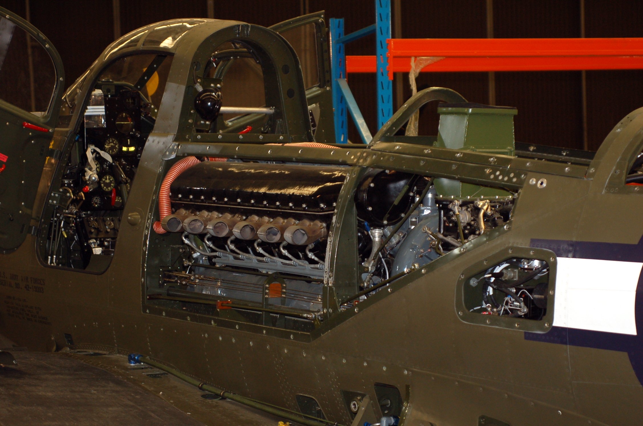

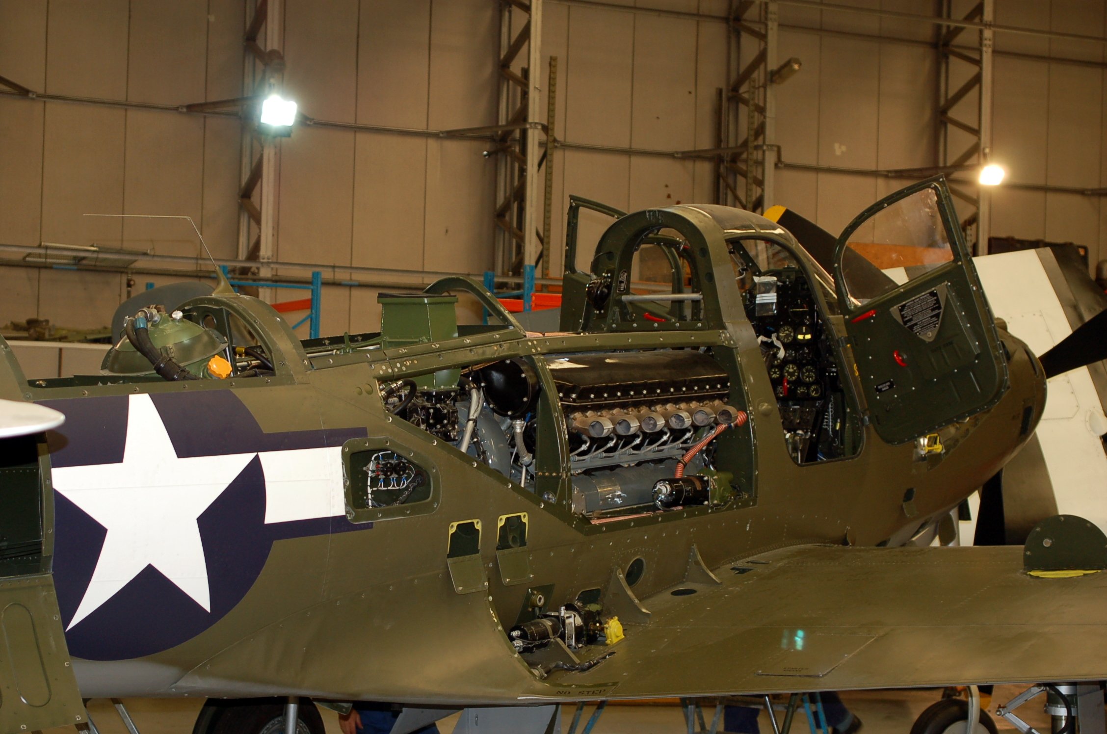

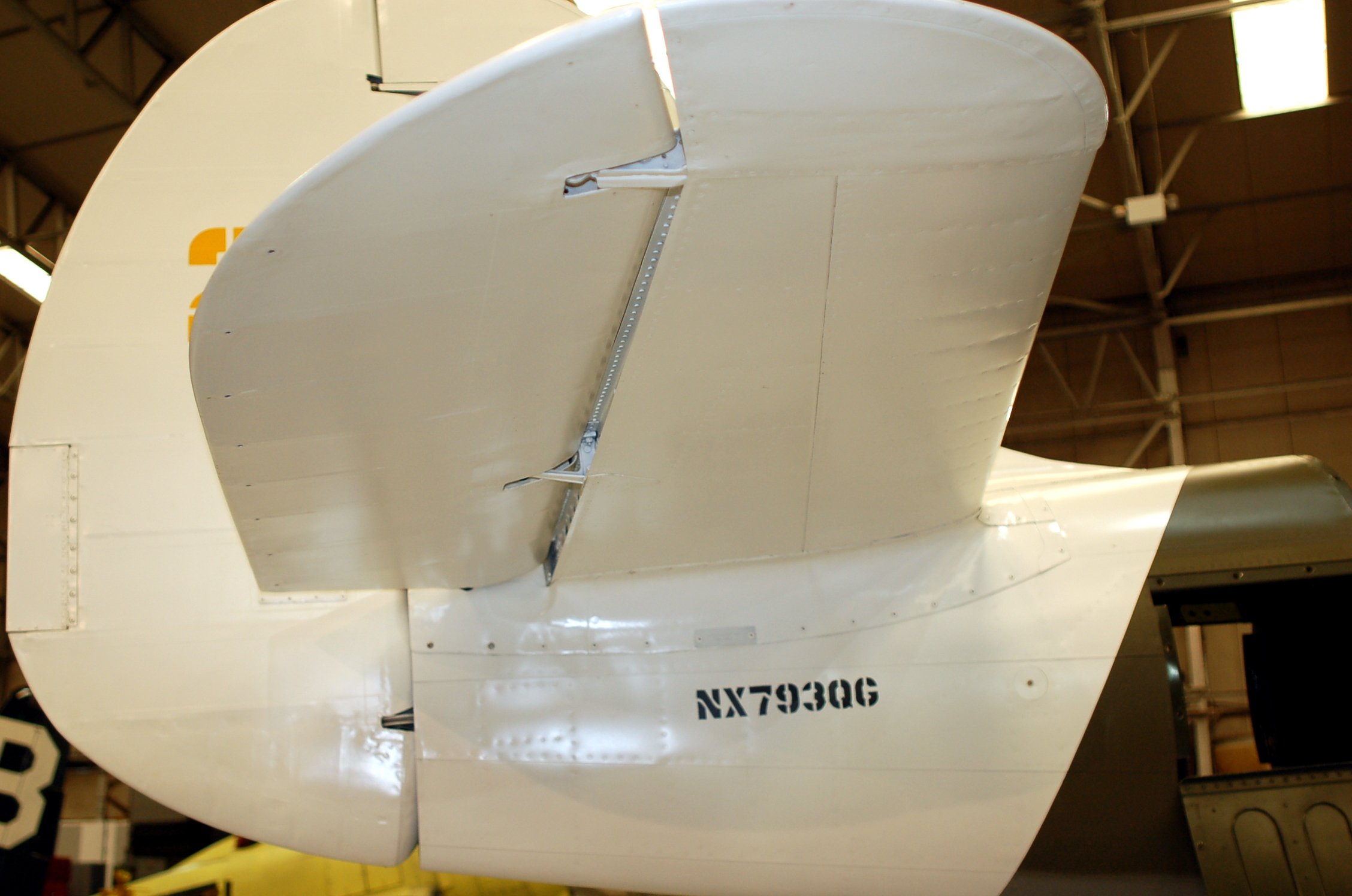

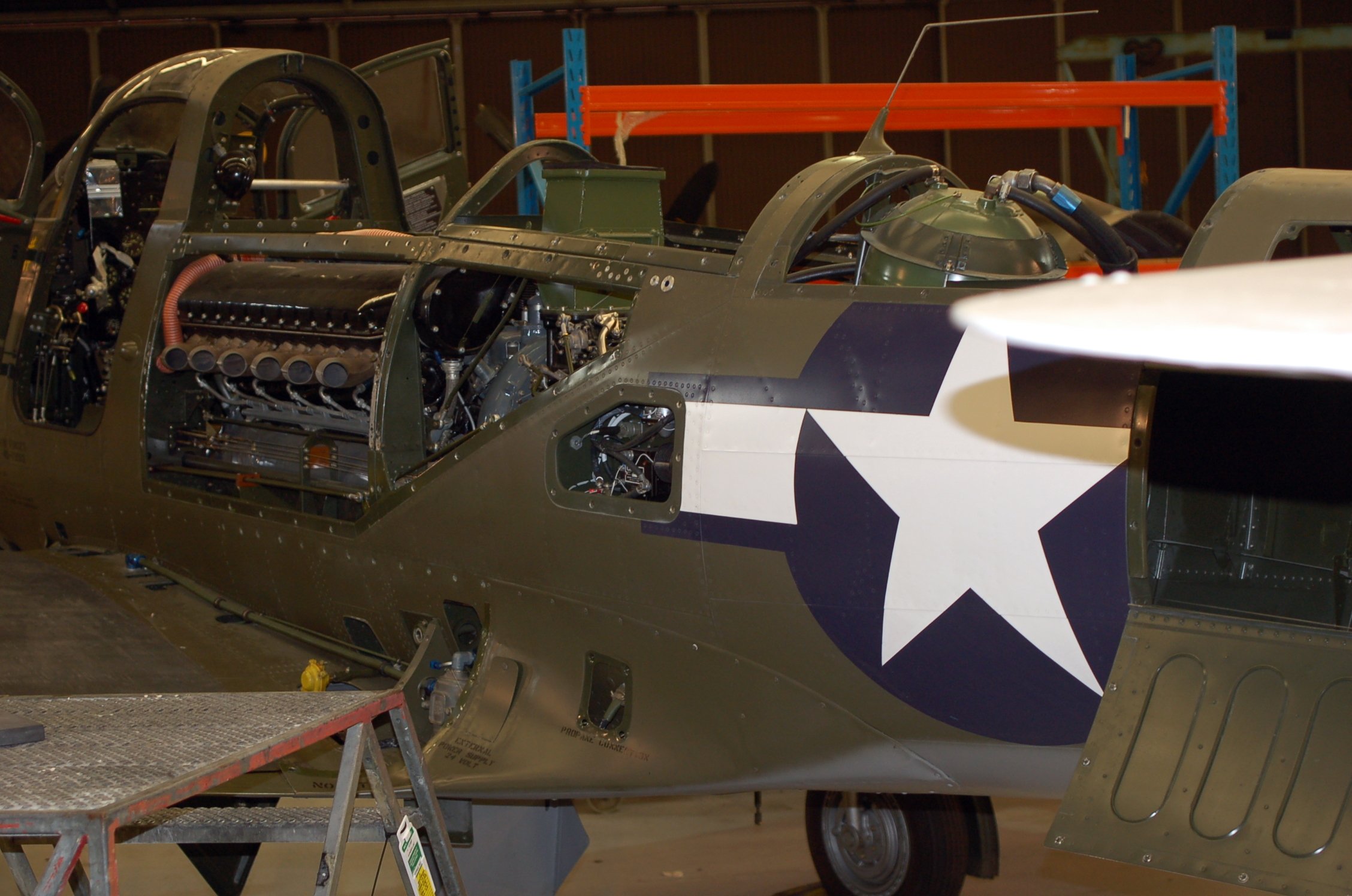

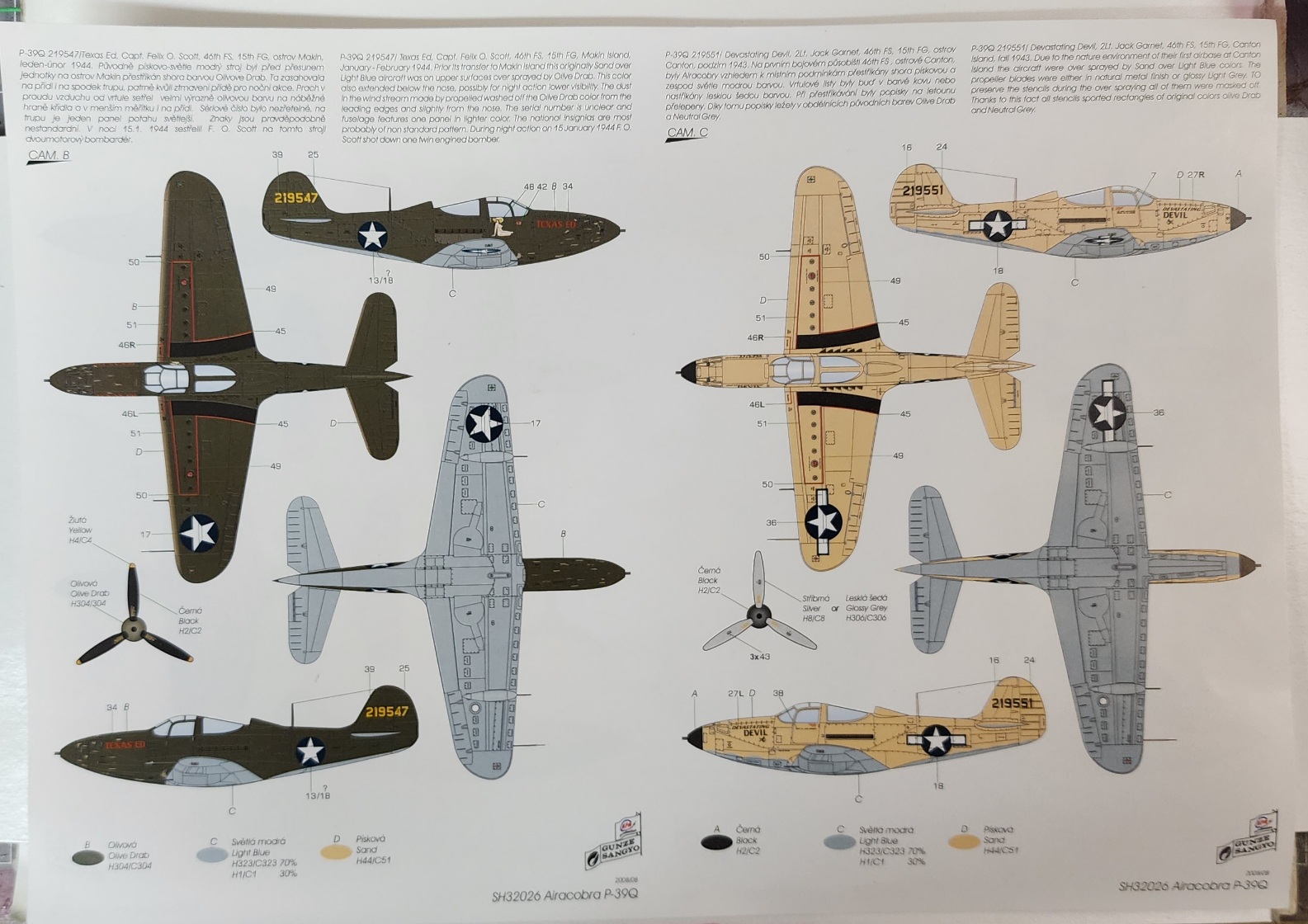

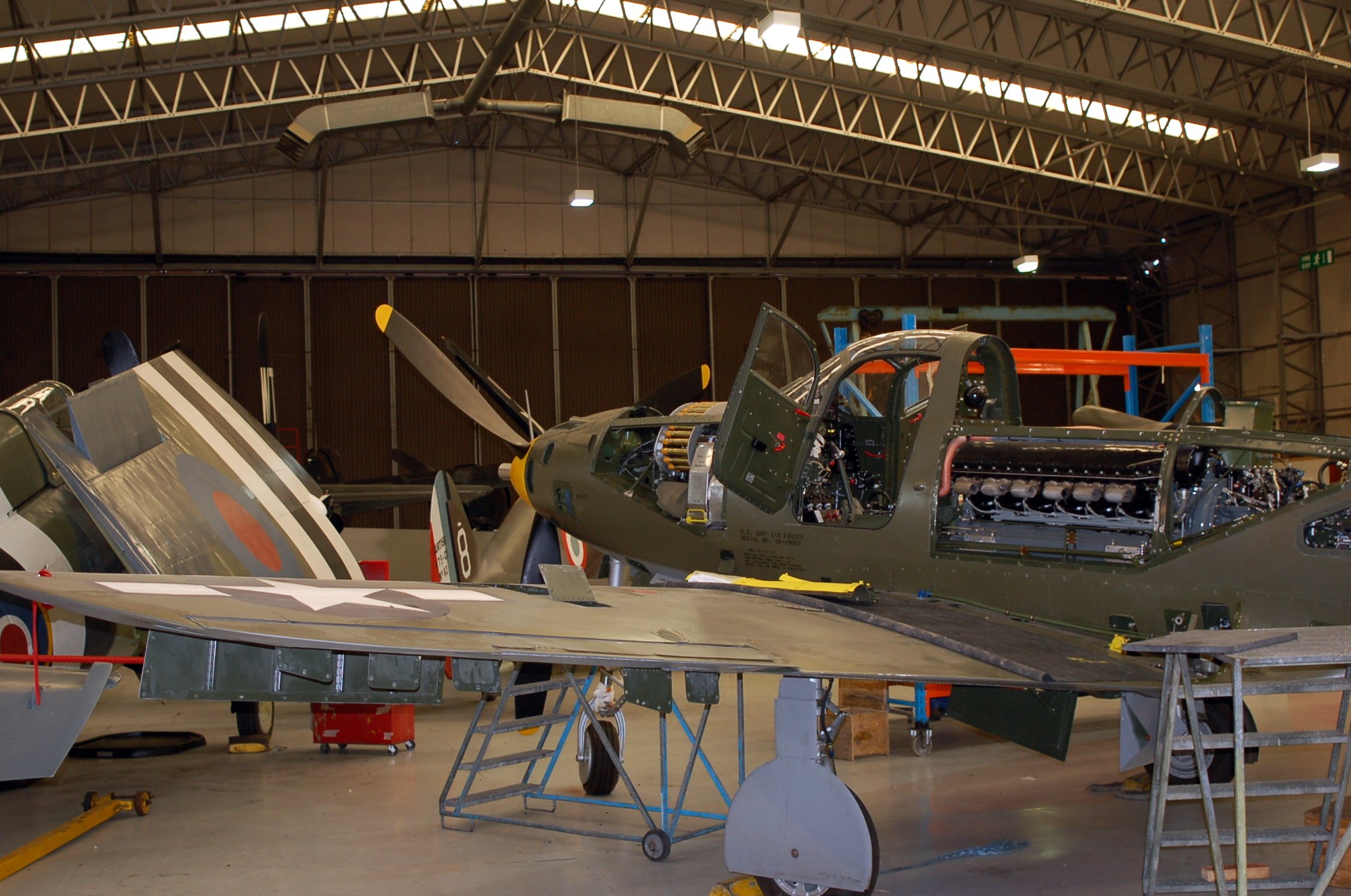

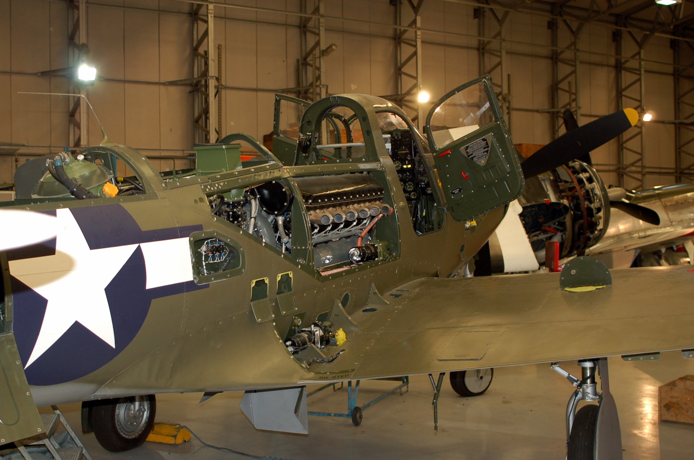

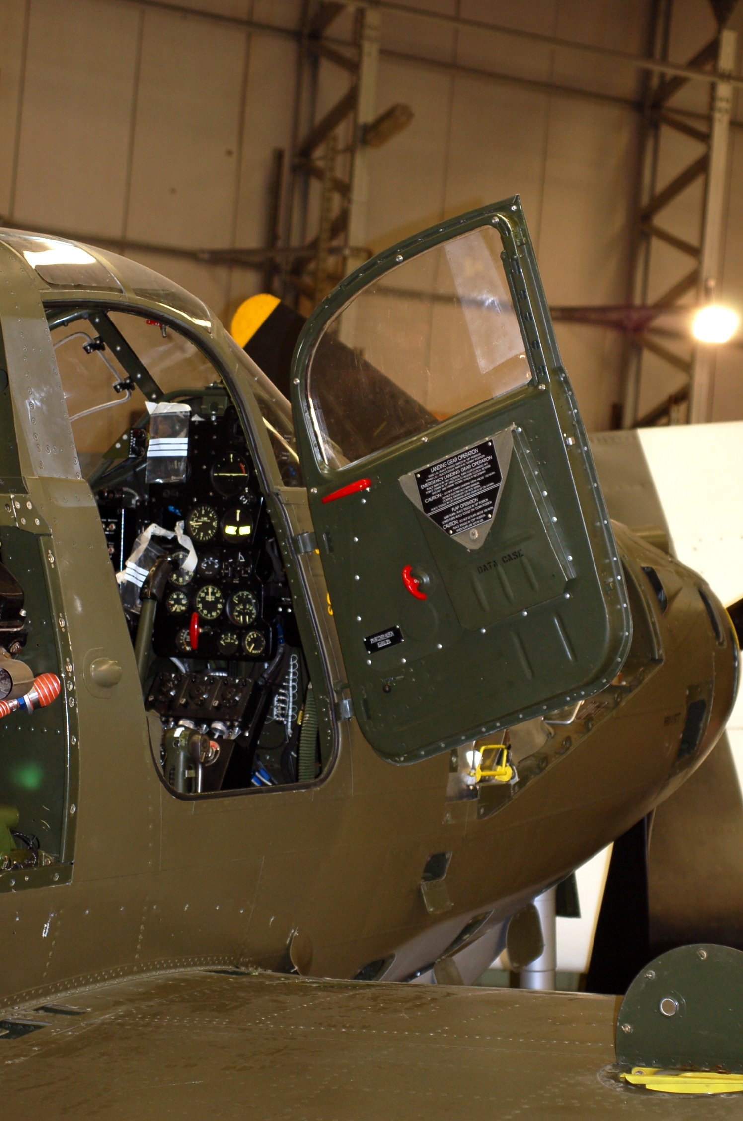

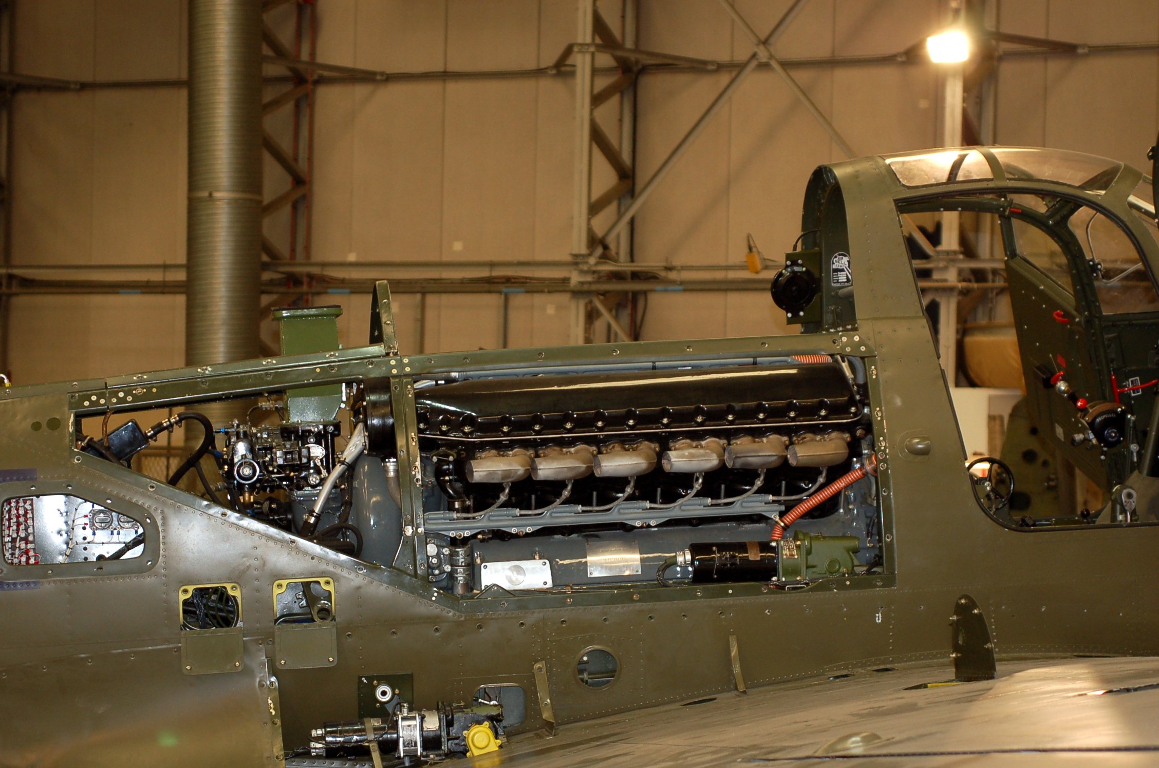

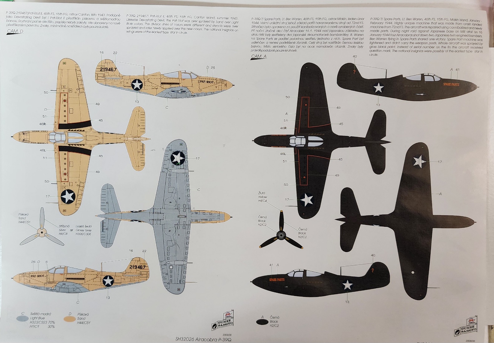

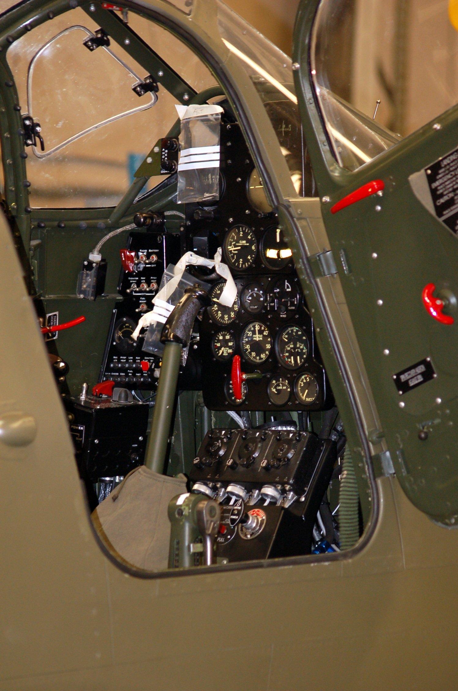

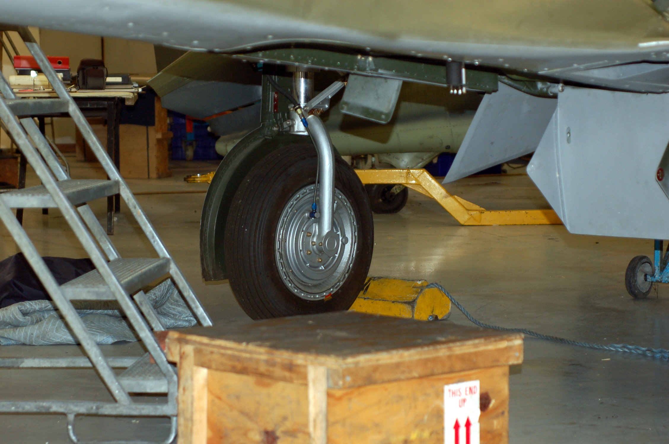

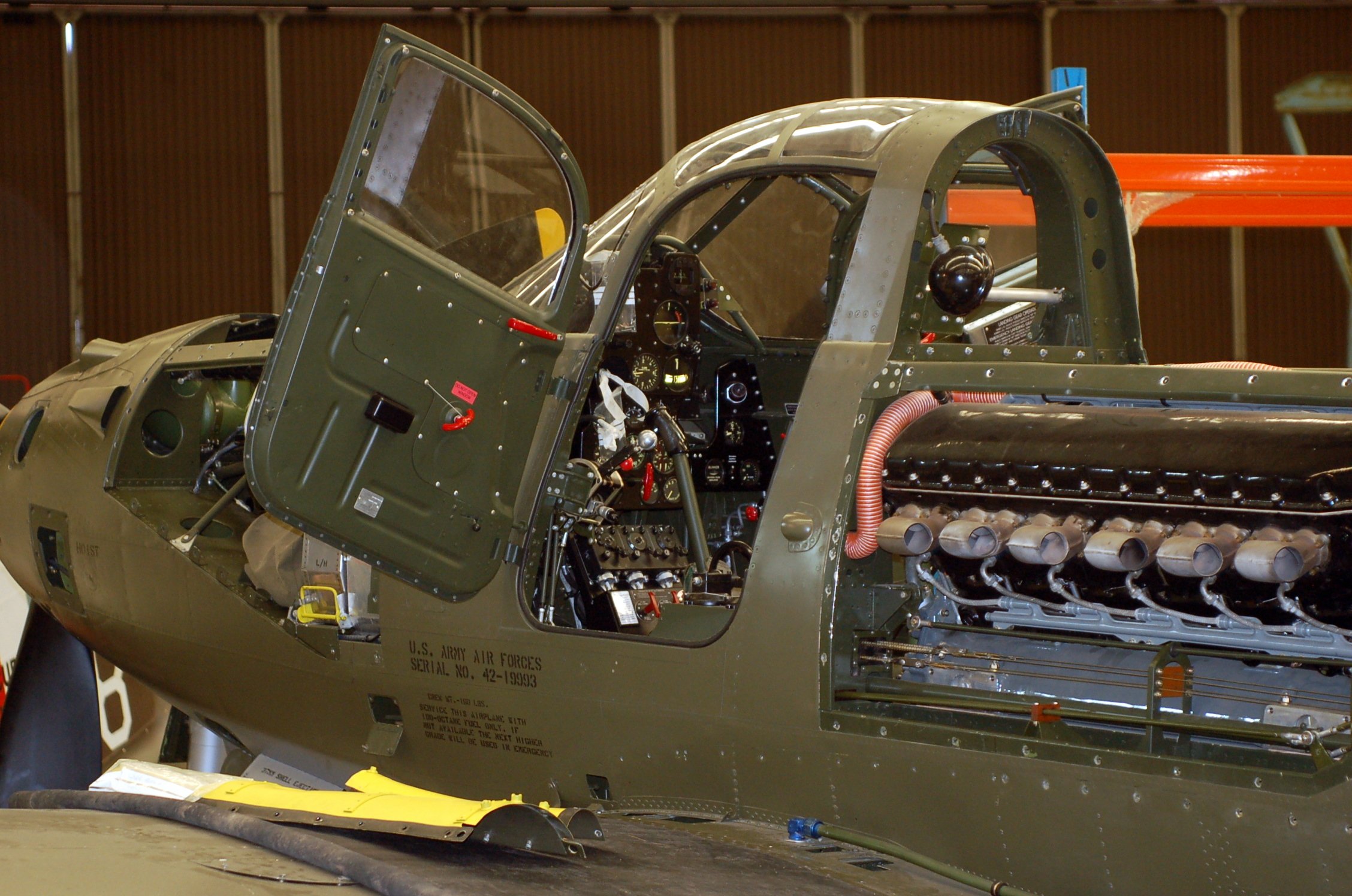

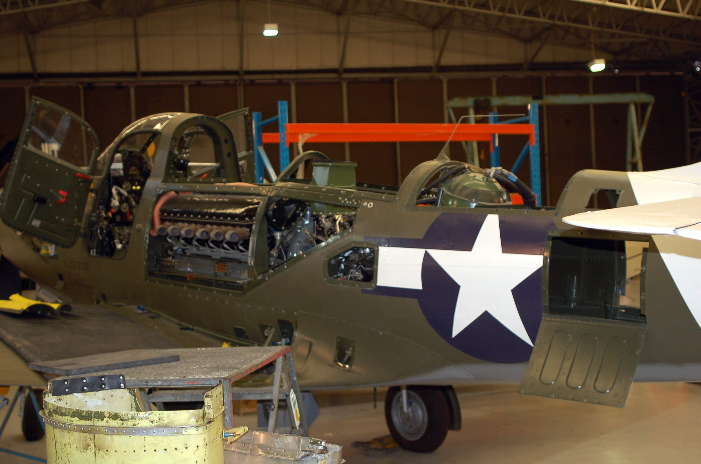

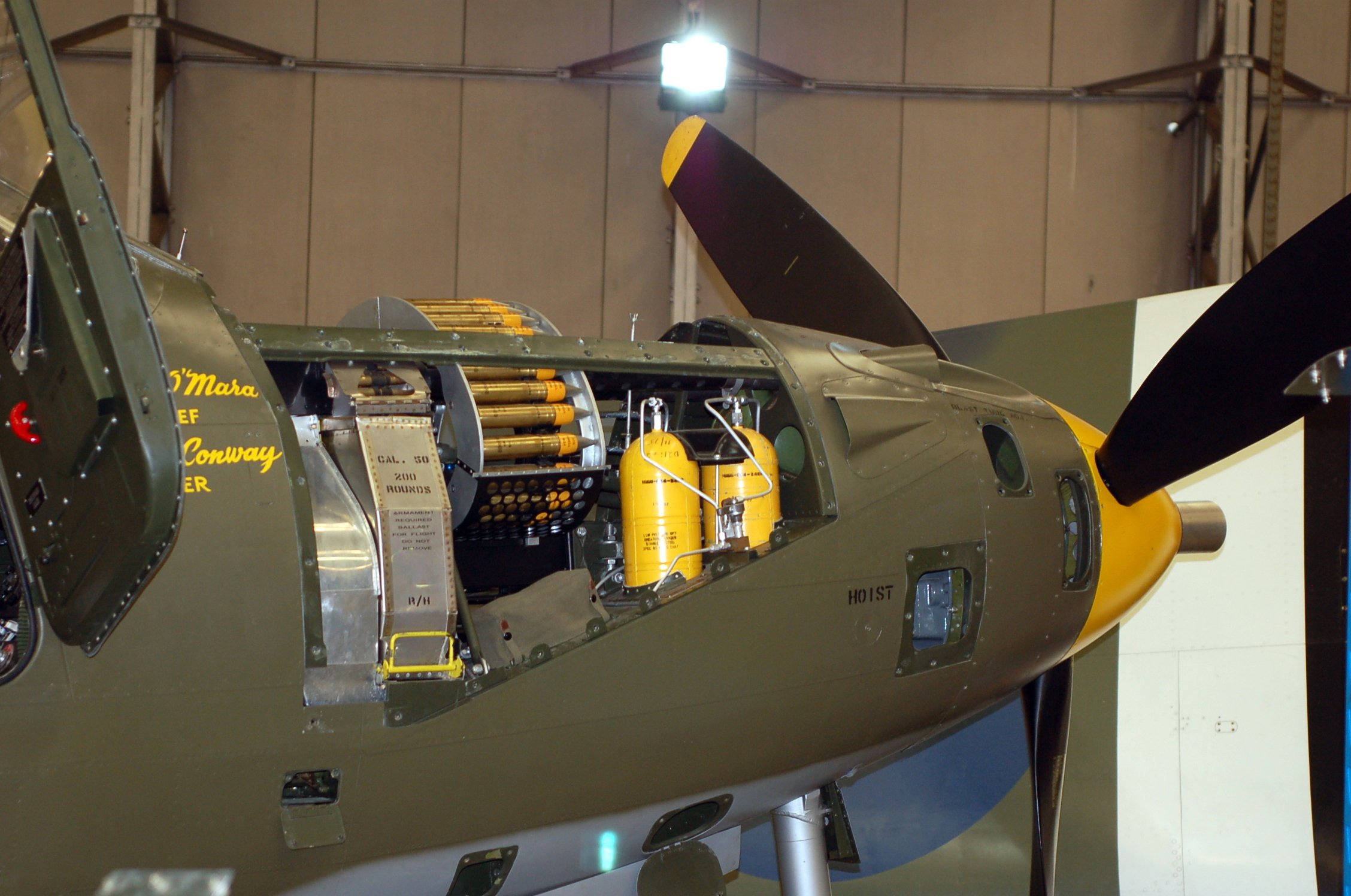

This is the color scheme I am planning except it will have a white tail. I found a pretty good walkaround with the white tail and I like it.

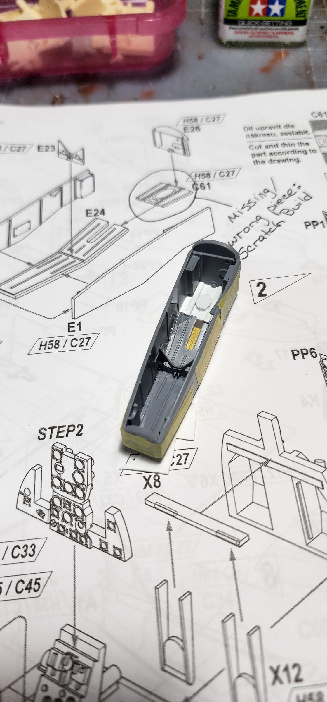

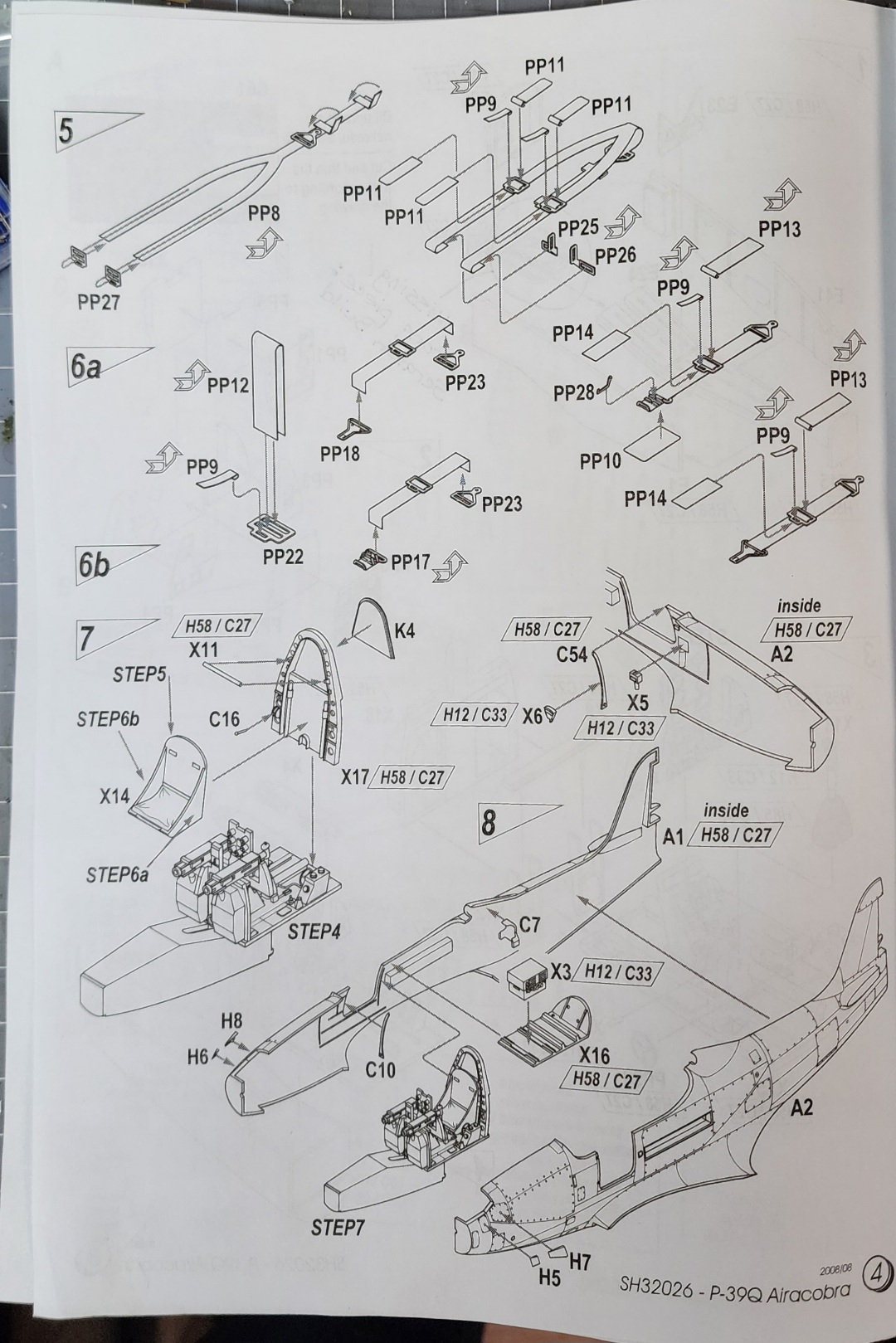

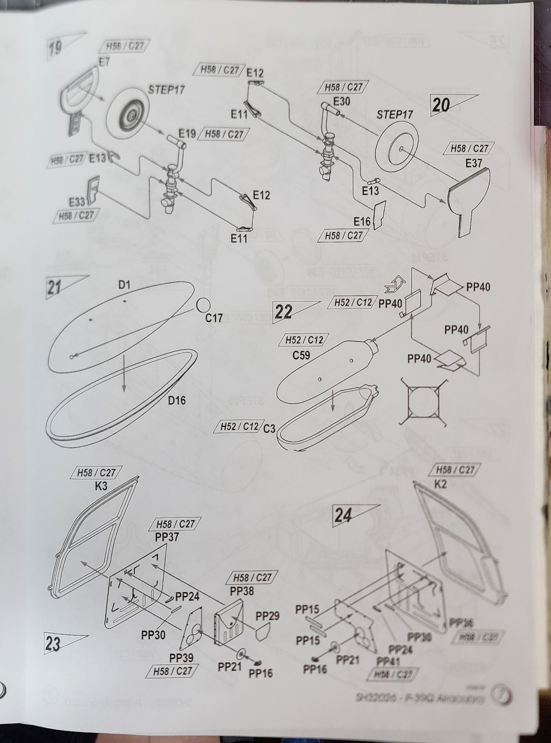

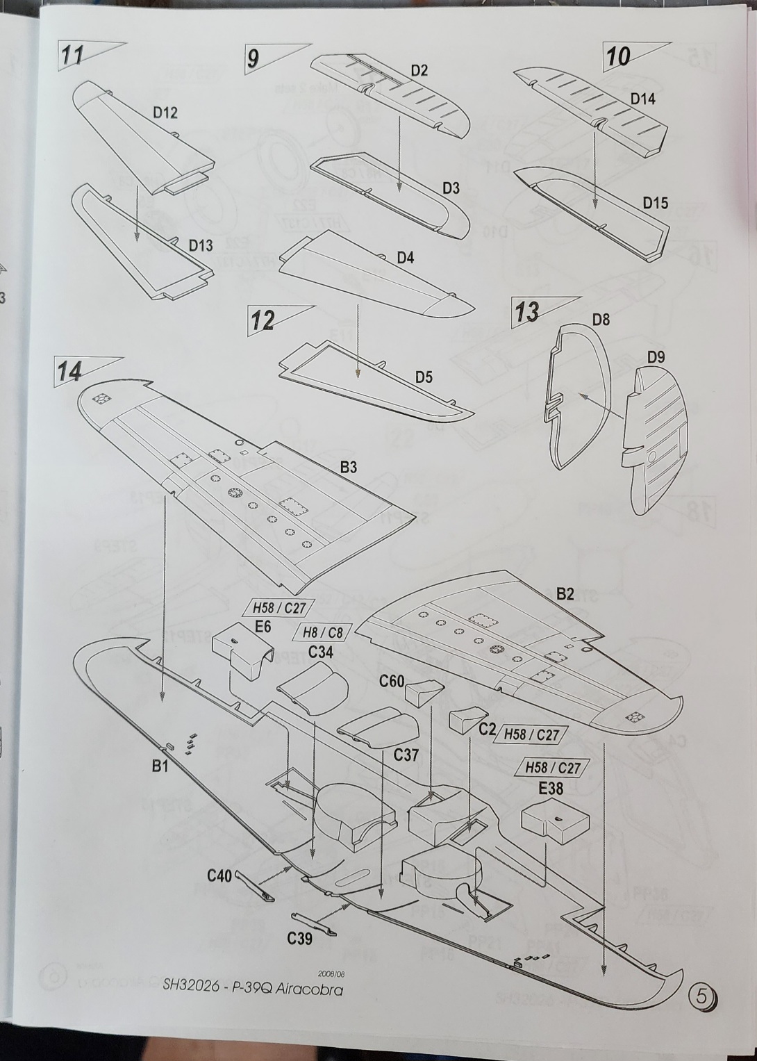

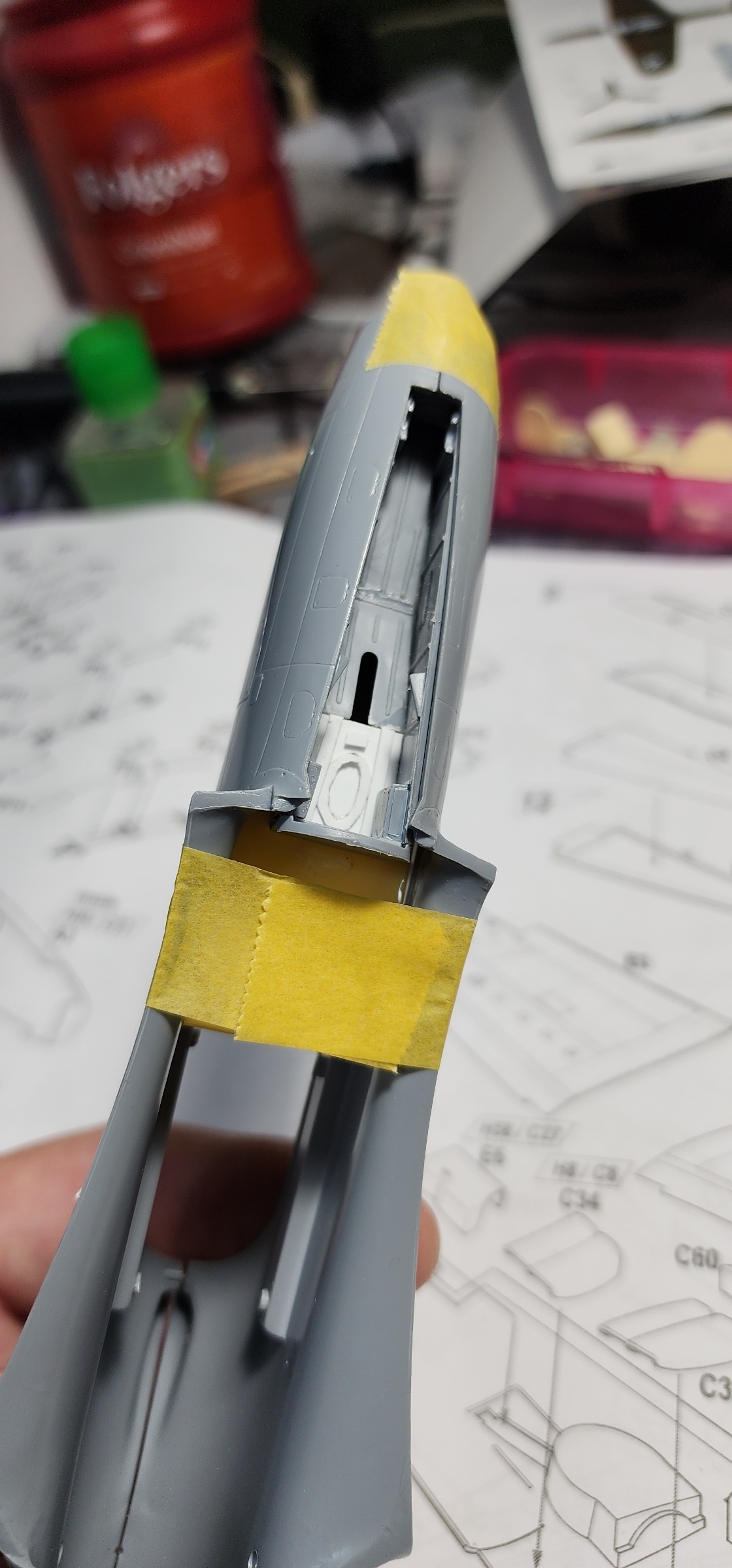

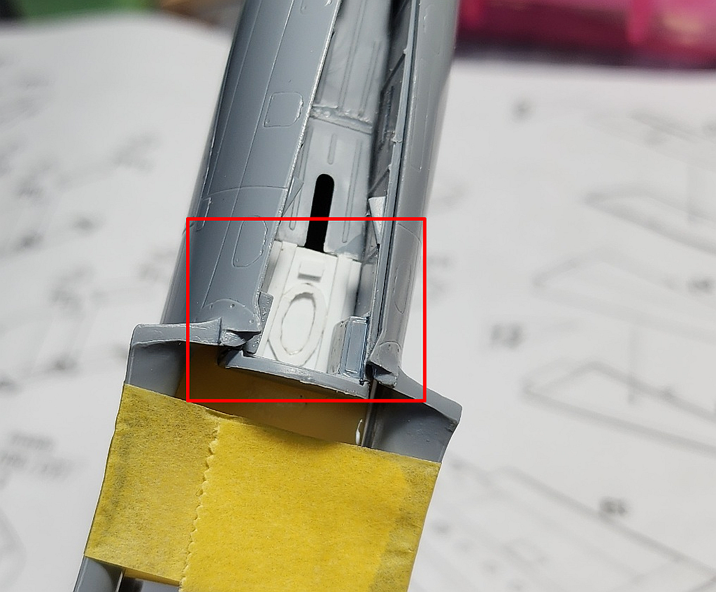

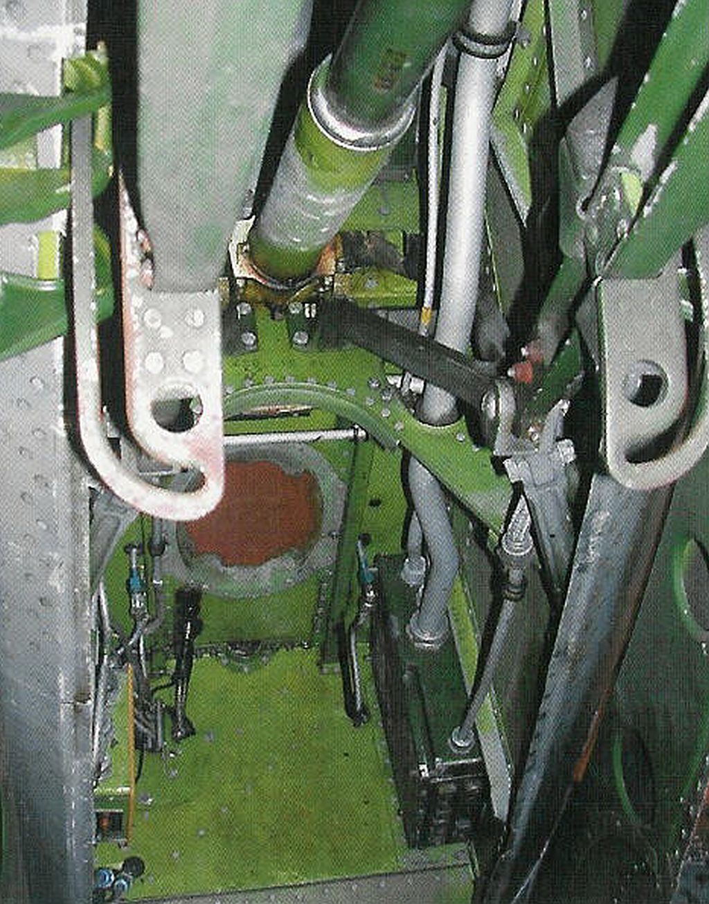

Thanks guys! Ok, so I dismantled the disaster of the front wheel well. The problem is that there are no register tabs of any kind and everything is butt joined and there is NO way to know if you have it right. I took Paul's advice and dry fitted with tape to see how things should be assembled so they fit.

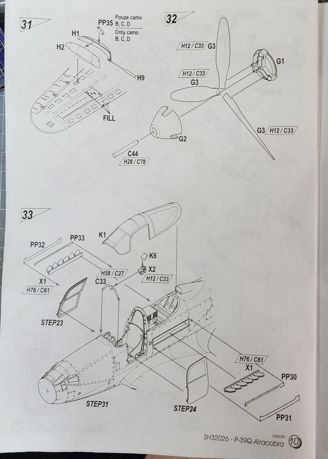

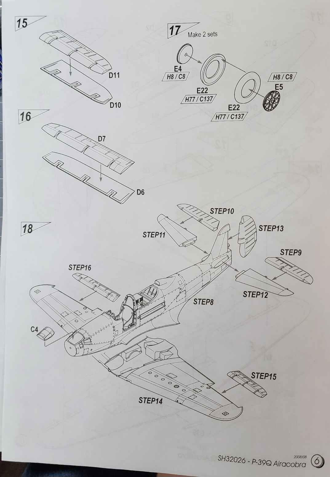

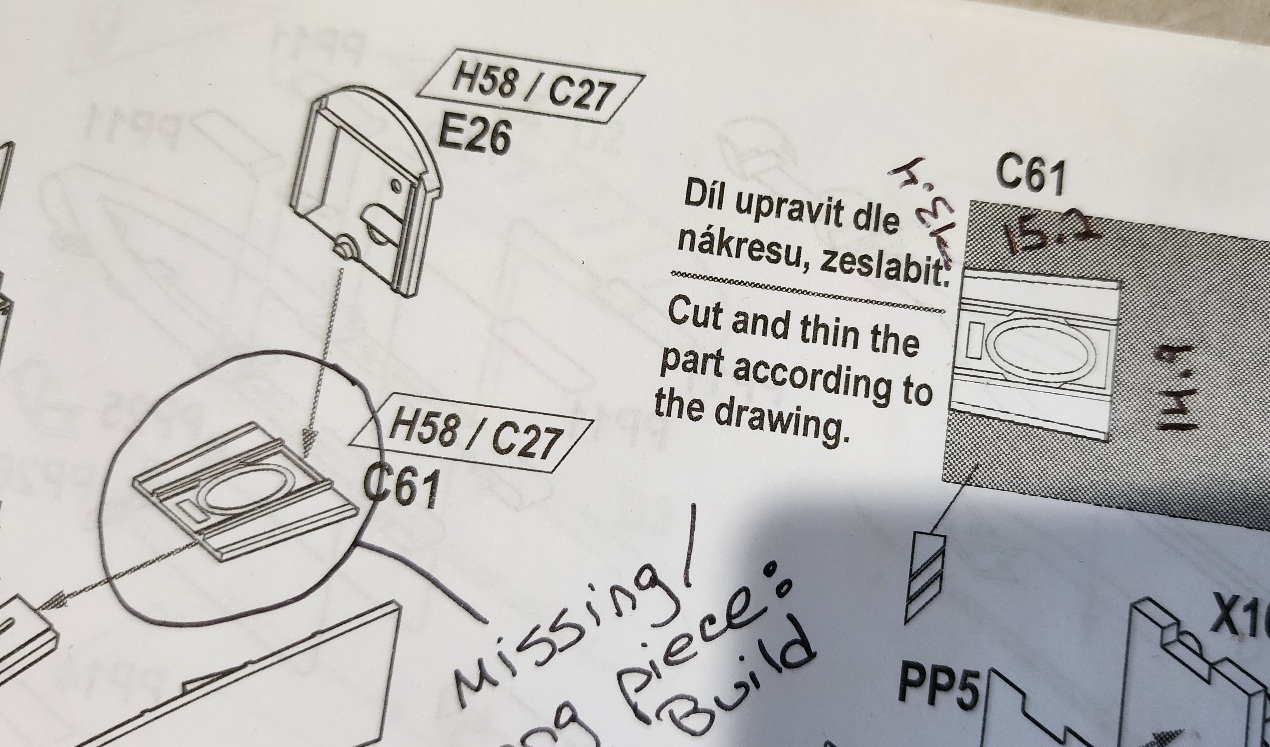

It seems to fit OK as I have it. I think it is weird that the instructions give an image of a piece to be scratch built. My 3rd attempt is the least bad looking. I can see a 3D print piece being nade but will slow production because my printers are still boxed from moving the store. I may do it anyway and put the build on a slight hold.
Let me find my kit tonight and see if that part is in it. It might be that your kit was just missing that part and the guy marked it up.
Yeah resin kit parts are not shake and bake builds. Some are good, some are horrible. The main reason I have not yet attempted any of my HPH kits, though with some of the correction mods I have done on builds that shouldn't be much an issue these days.
The tape bit is good, also you can lightly tack parts together with a few "spots" of super glue and then easily pop them apart. That is little spots of 1/16th to 1/8th of an inch here and there along a big seam just to hold it together a bit better while testing. I have found that the super glue from Hobby Lobby is more brittle and will pop easier. Lately I have been using the Medium Gap Filling super glue from BSI as it "isn't" brittle. My local hobby shop has it with their name put on it.
I also never apply super glue from the bottle. I make a puddle on a sapphire watch crystal and use a small applicator to place small amounts along a seam.

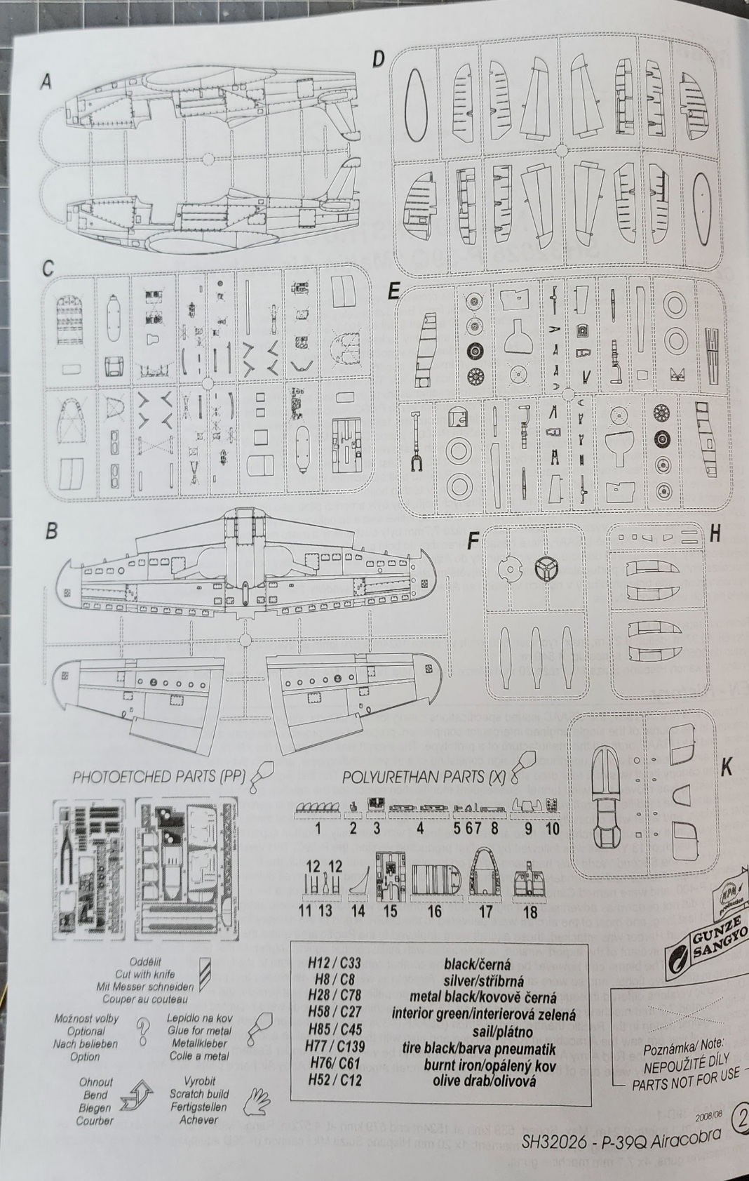

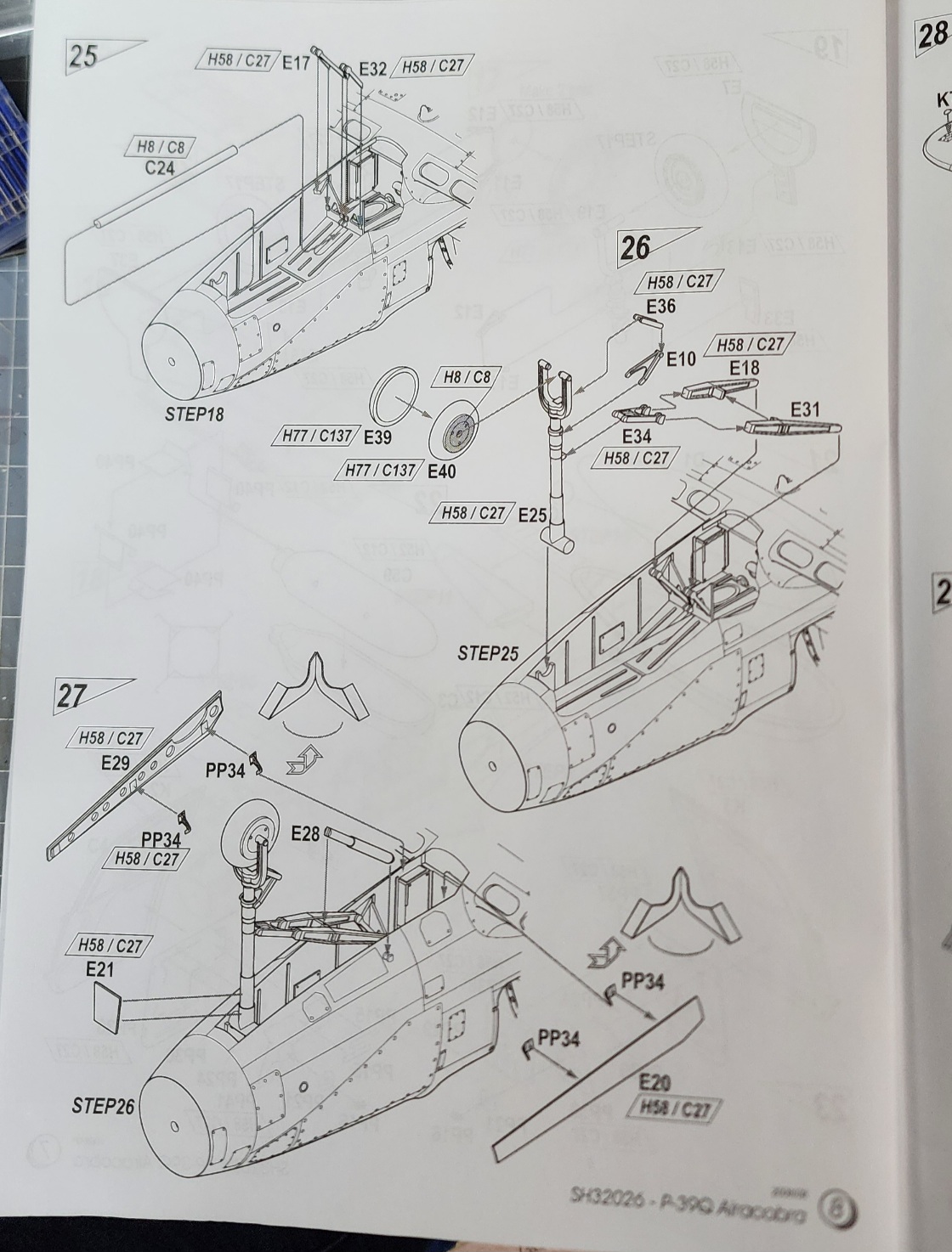

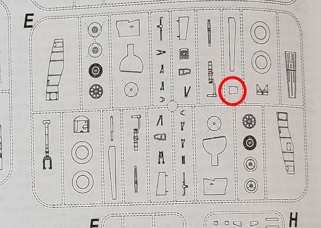

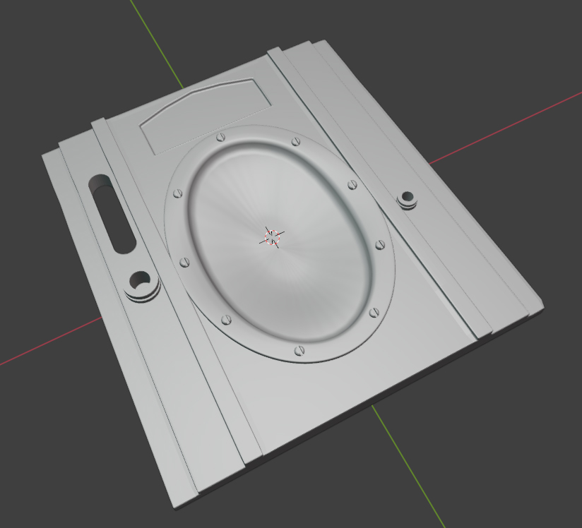

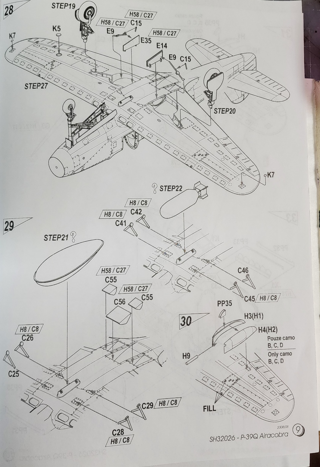

The "C61" part IS on the sprue but looks nothing like the drawing, and is X'd out on the sprue drawings as "not used". There is a little drawing on the instructions that says to make the part and thin as shown. Really? I have created the part in Blender and will see if I can get one of the printers going today.
