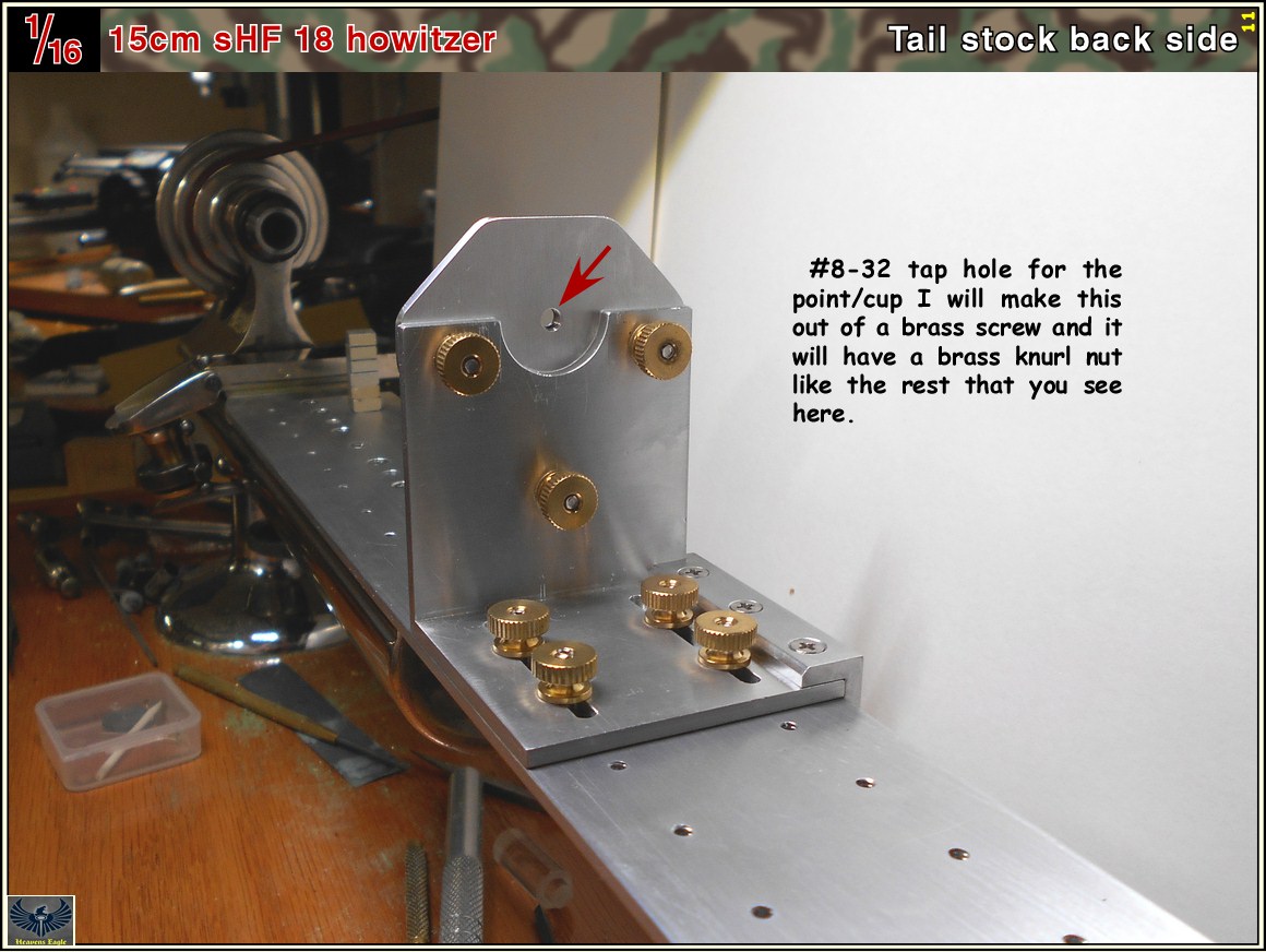

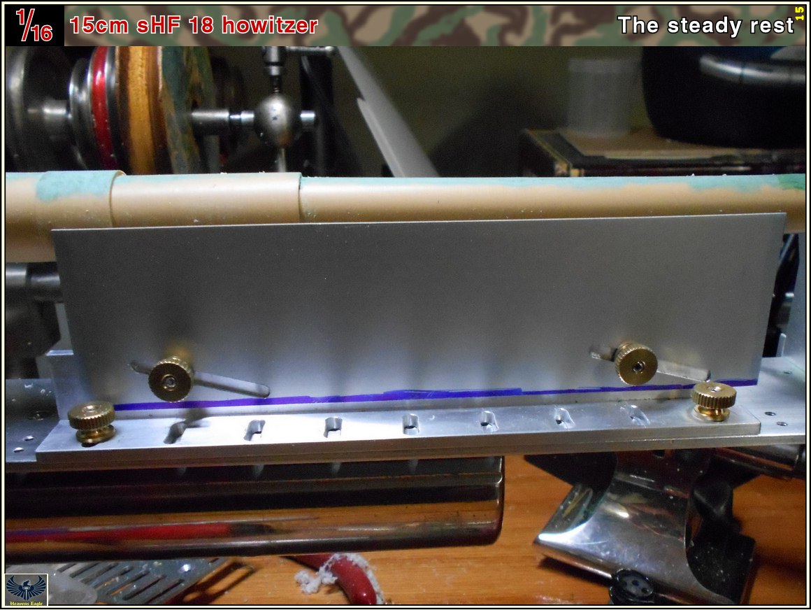

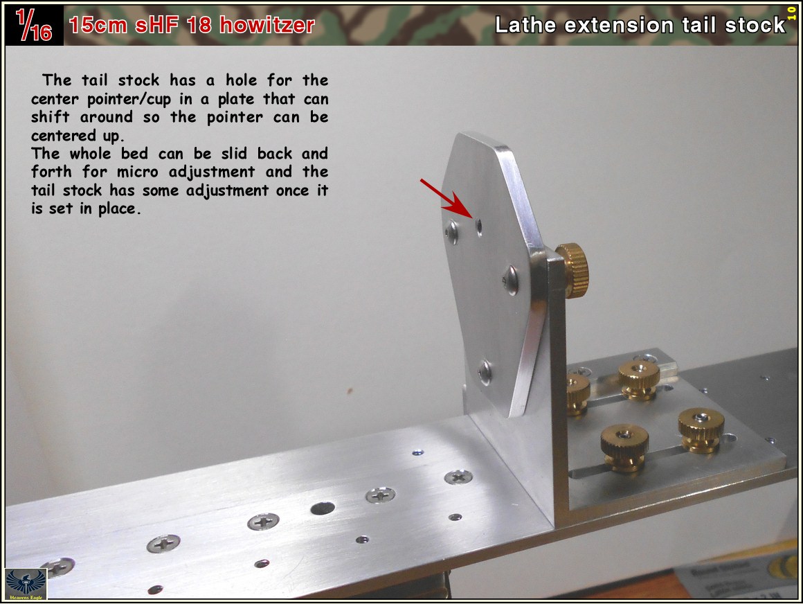

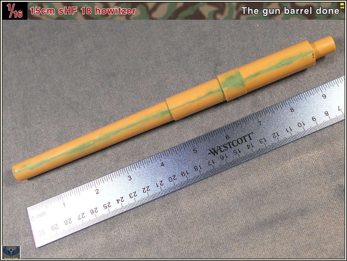

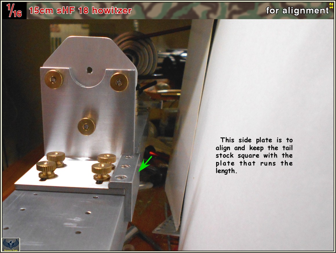

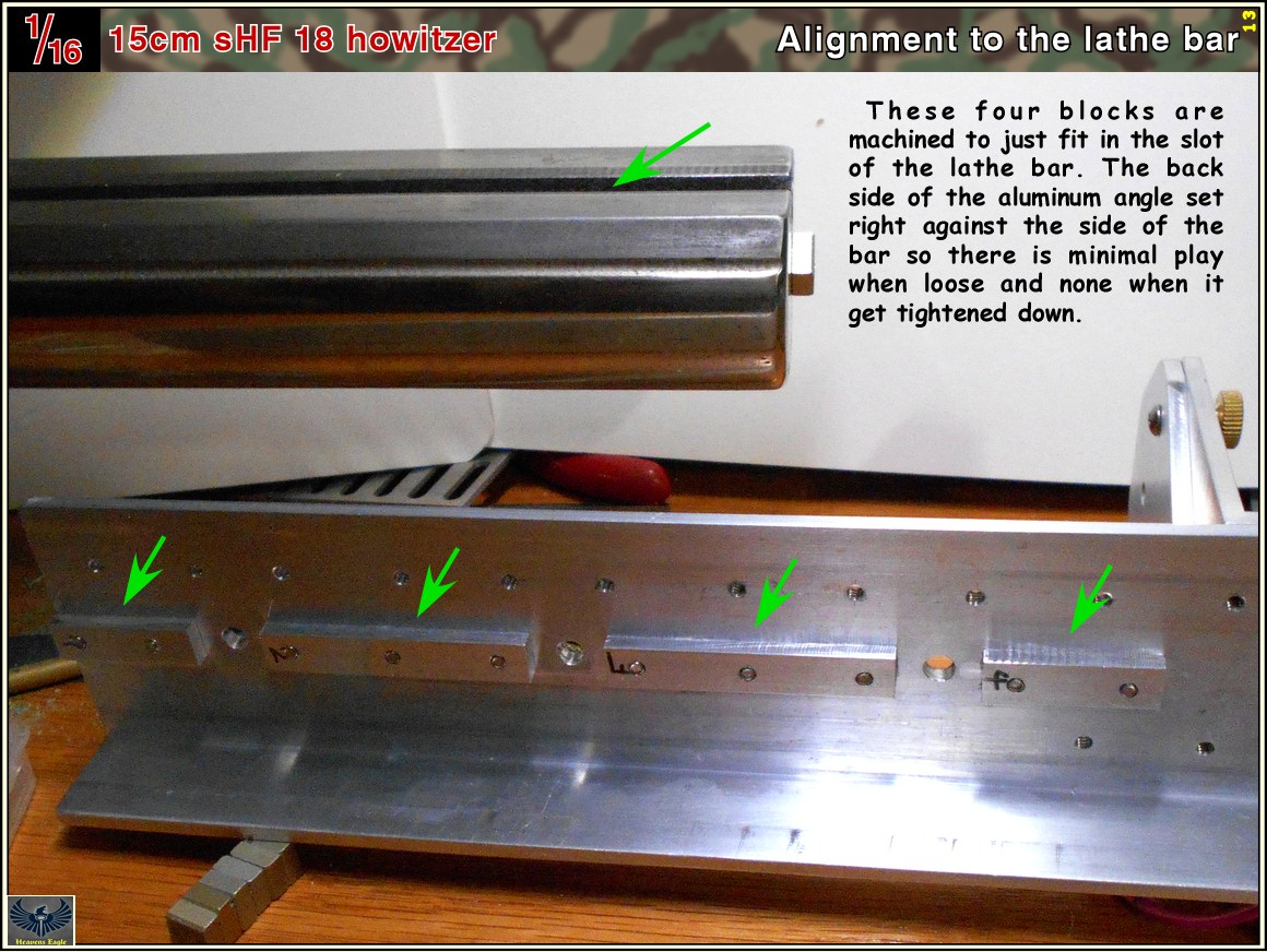

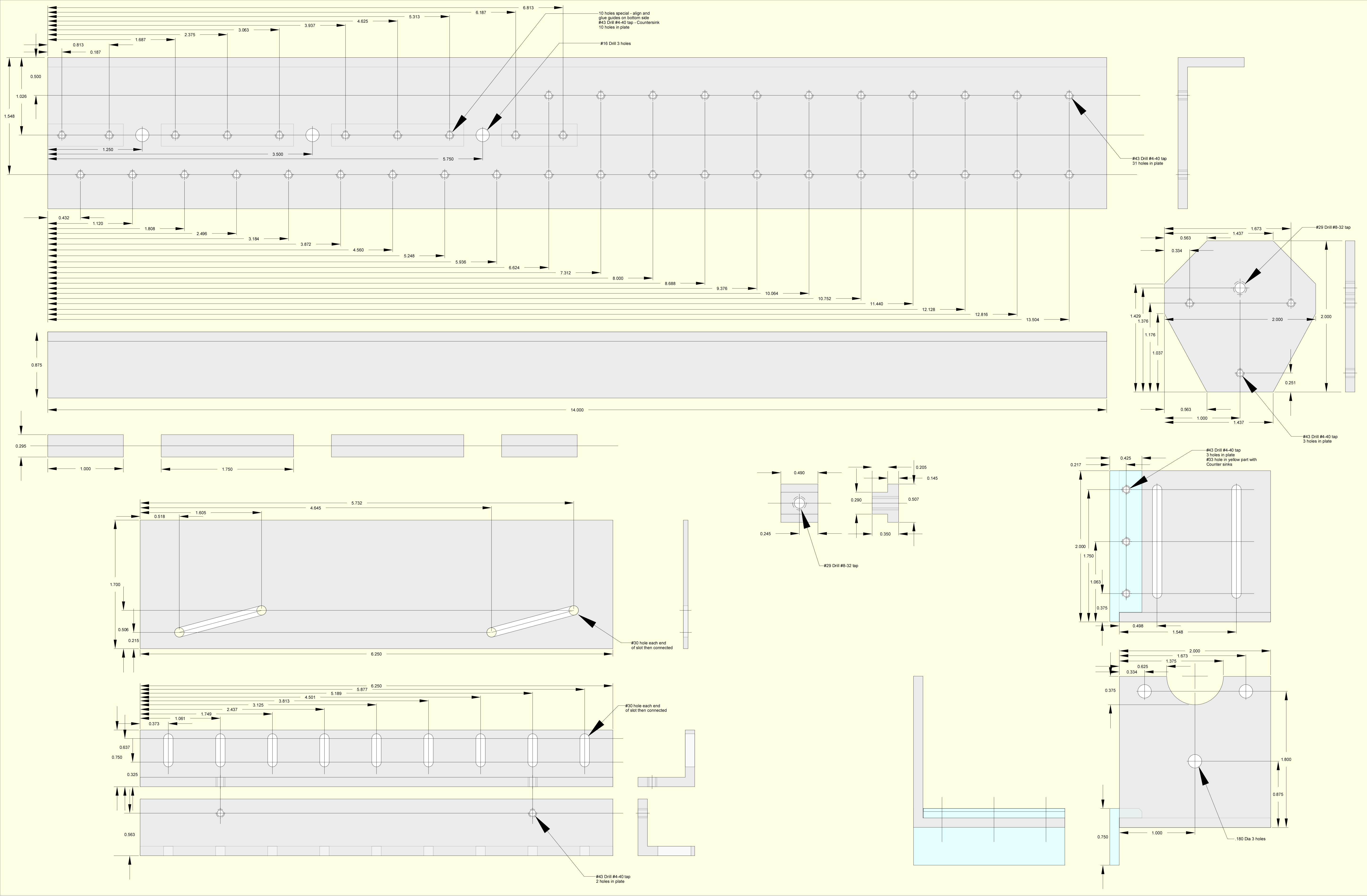

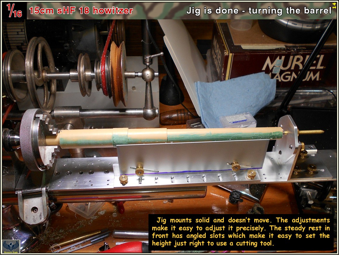

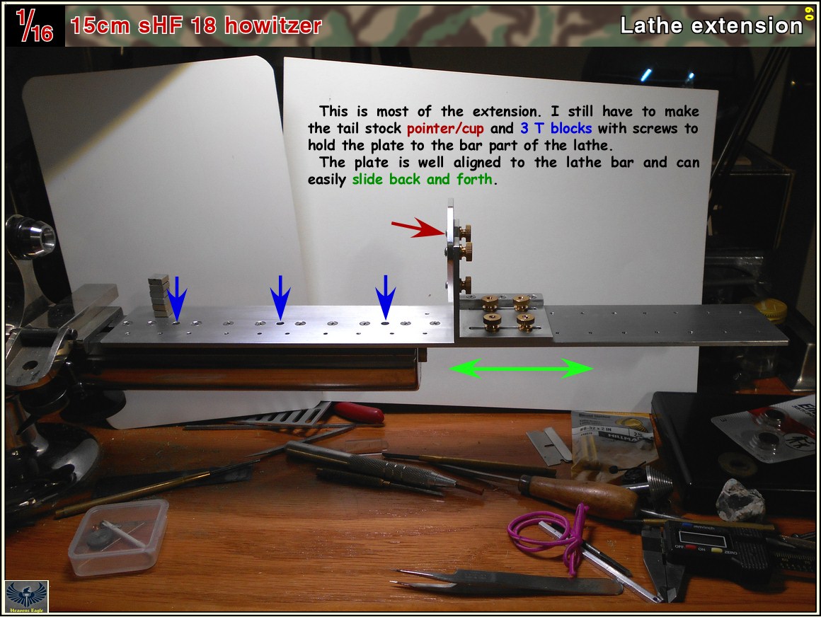

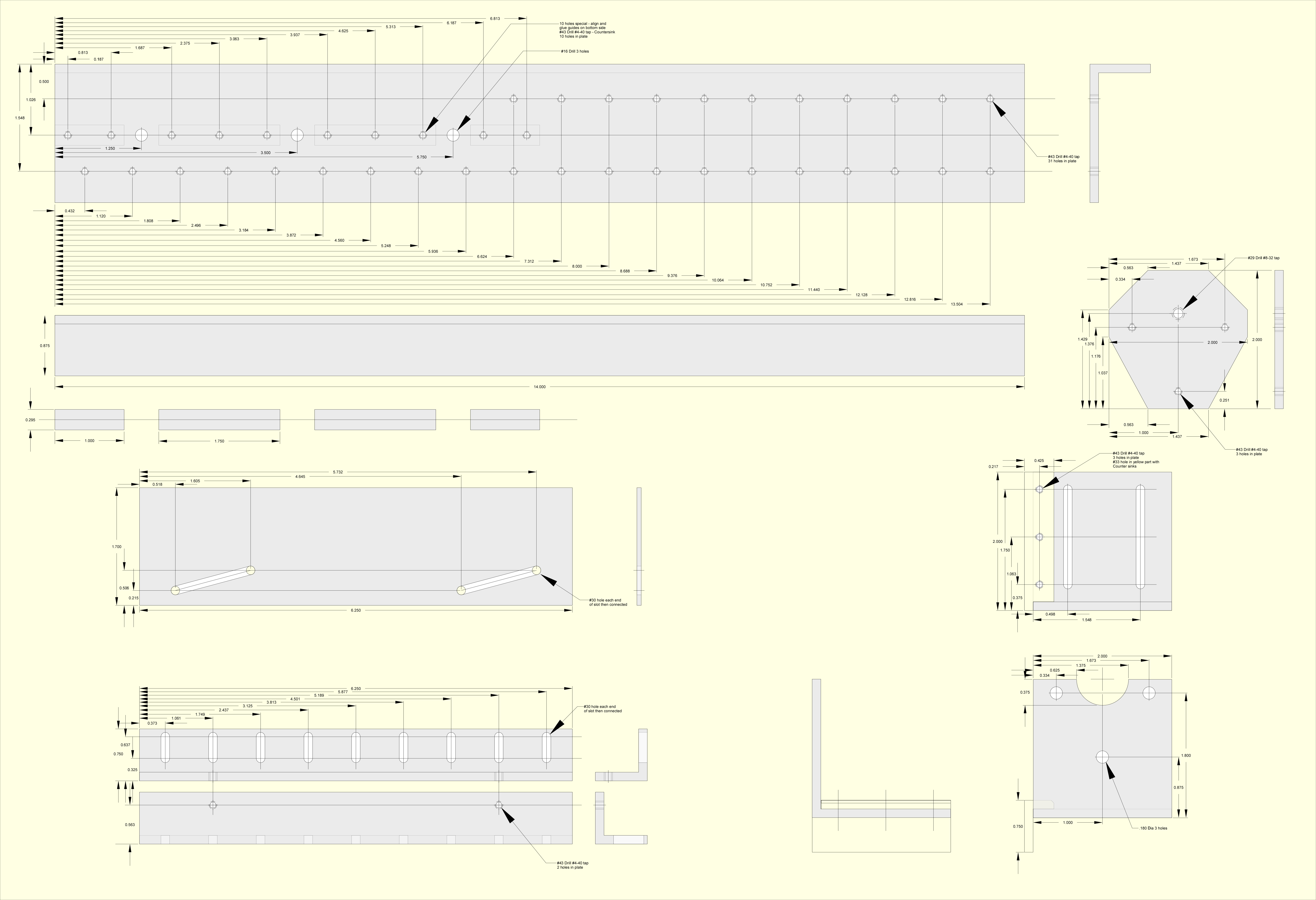

Right now, I am building an extension to mount on my lathe so I can put the LONG barrel in the lathe and make it round.
Here is the layout drawing. I have one more part to design, and some of the parts are already partially made. Since it is a line drawing, I could make it huge and the file size is still within the site's limit. If you really want to see the parts, download it.
