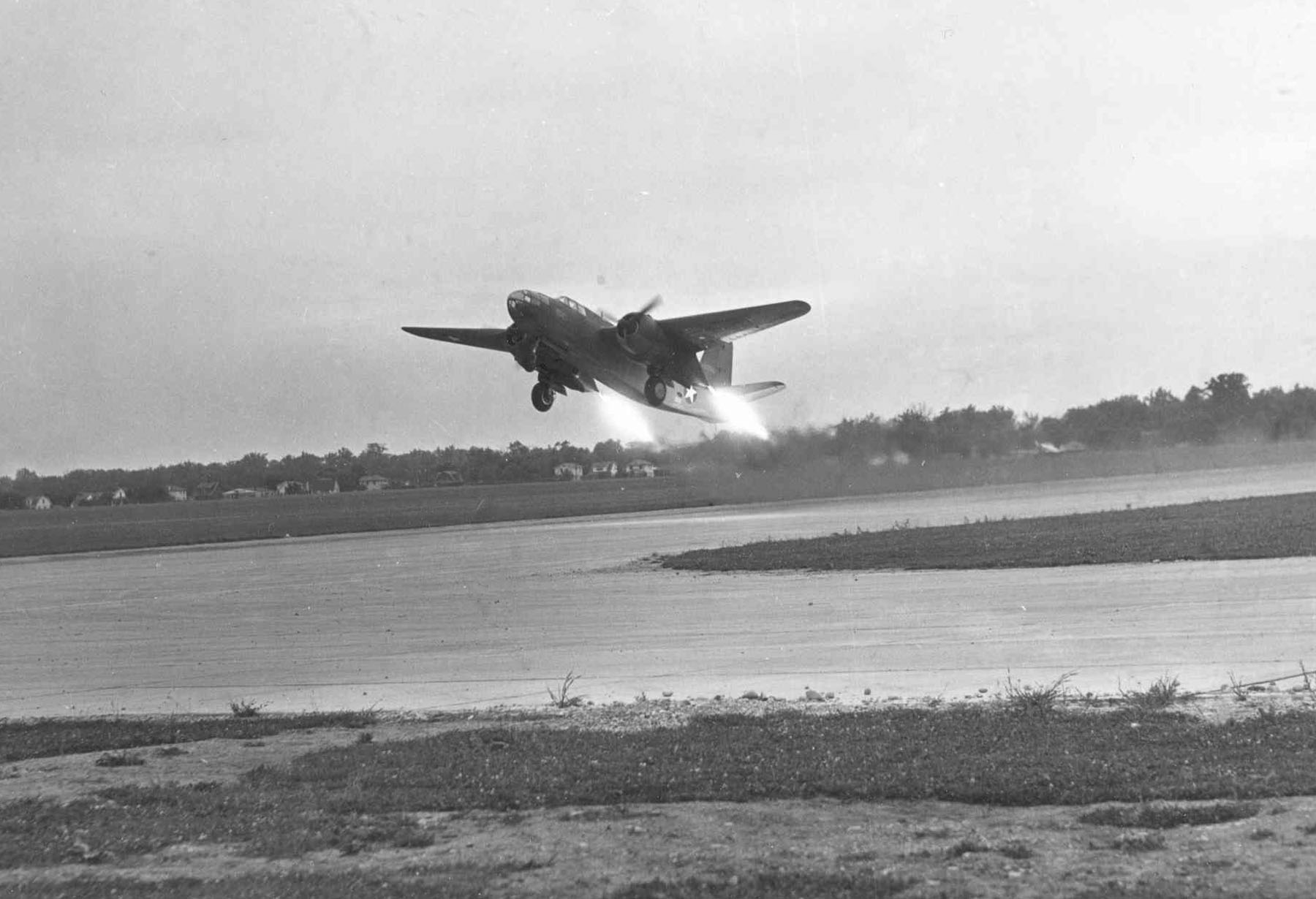

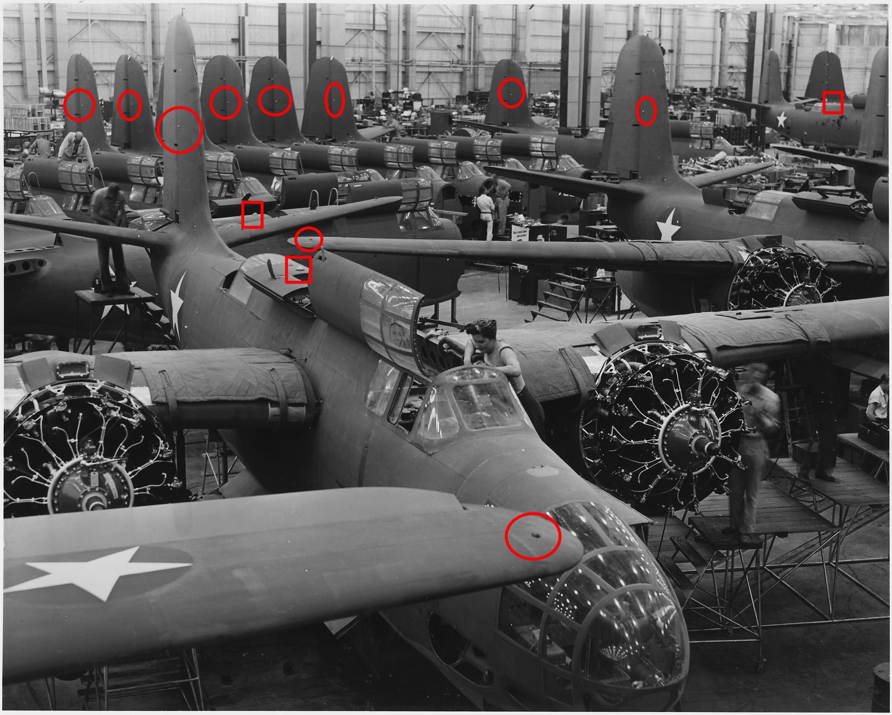

Note that this A-20B assembly line doesn't have the light above the bombardier's compartment making me wonder where the passing light is? Red squares show the anti-collision beacons:
