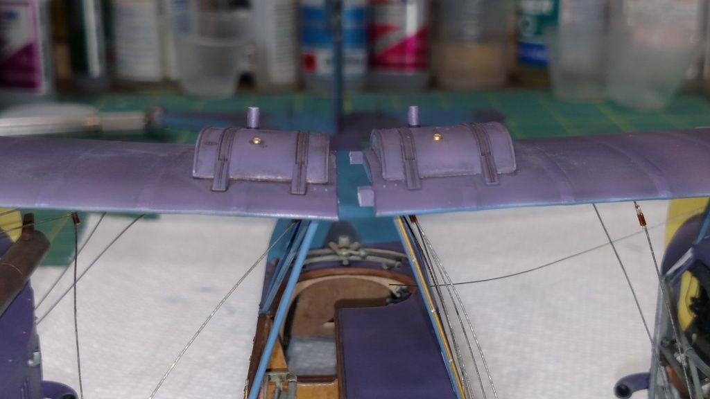

OK all, now that the 2 wings are glued to their respective struts, I need to address the broke wing halves.

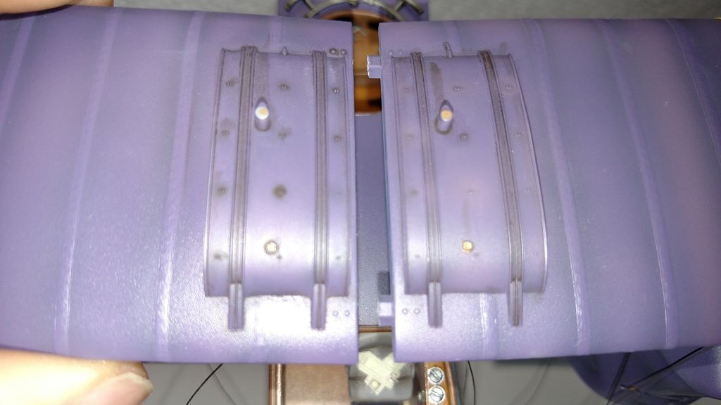

This is it slightly pulled apart.
And what it looks like when I hold them together. It actually finds its natural resting spot.
My question is to what would you use to join the 2 together. Regular liquid cement or 2 part expoxy?

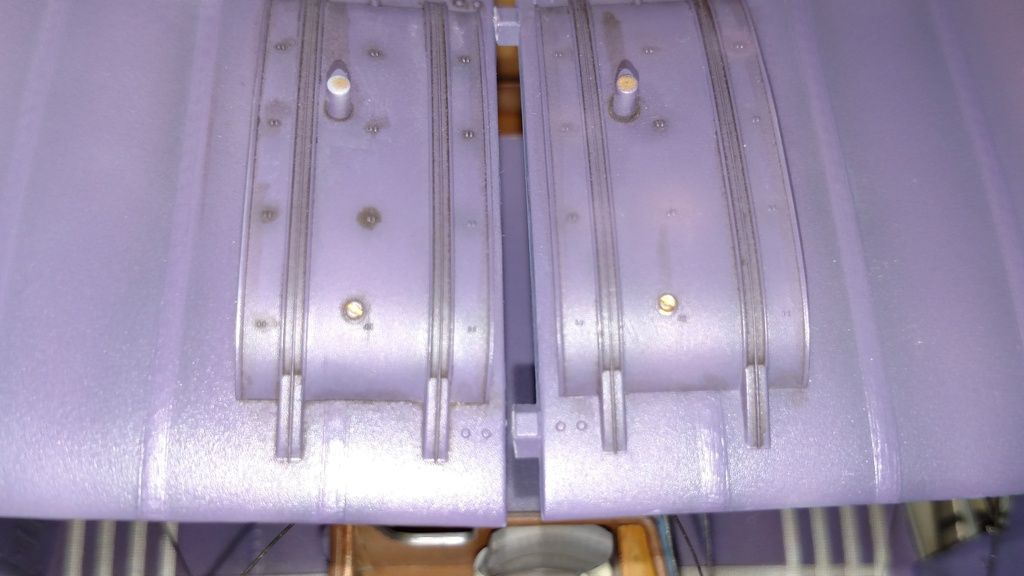

My worry is when I set it flat the weight of the wings which pull down will put pressure on the joint.
This is the gap sitting flat on its belly.
2 part epoxy. You use a solvent it will attack the paint and might mar up something. :popcorn
As far as the cement, I was referring to tamiya liquid cement.

It has been done. Epoxy on rod and in center, pulled together and masked, then followed by thin cement on the outside to seep in. We shall see tomorrow.

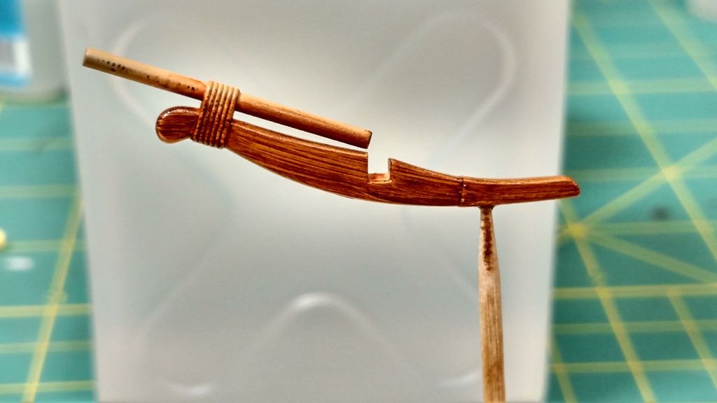

While I let the wing dry, worked on the tail skid.
Base coat of tamiya flesh with raw umber applied with a sponge.
Probably going to do the same on the props. I failed horrible last time at laminations.
Looking good :good: Truth is, I got a very similar effect a week ago trying to clean paint of a piece with some lacker thinner. Permanent wood gray with two swipes of the brush . :S
