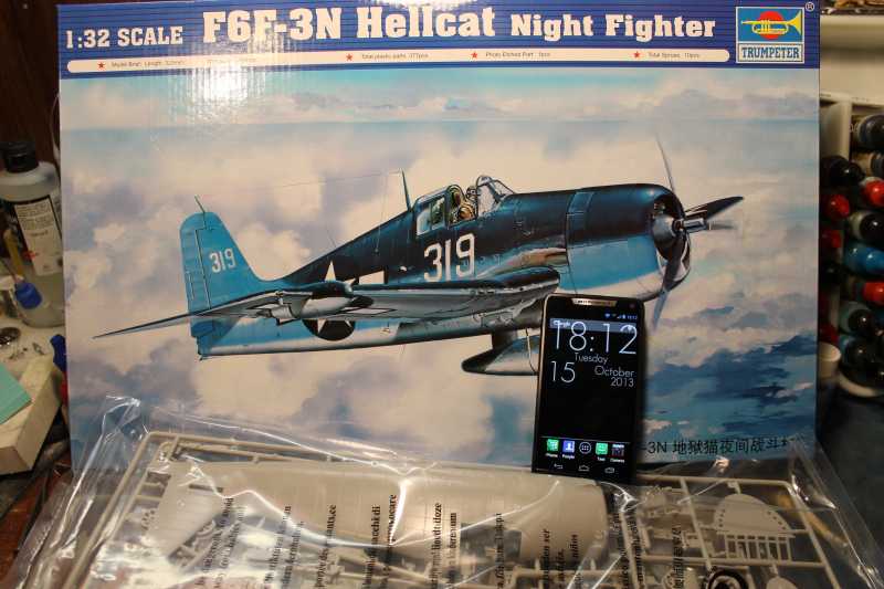

Long term project for the NF campaign.
I will get the decals I need later.
I am trying to do it both for the Memorial thread, the Marine thing and the night fighter. VMF(N) 511 or 533
Trumpeter 1/32 F-6F 3N
Hell of a project Paul. First question is, Solid or tricolor scheme?
I havent really thunk about it Bob. I still need some research.
