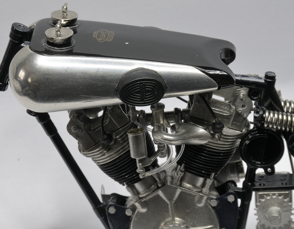

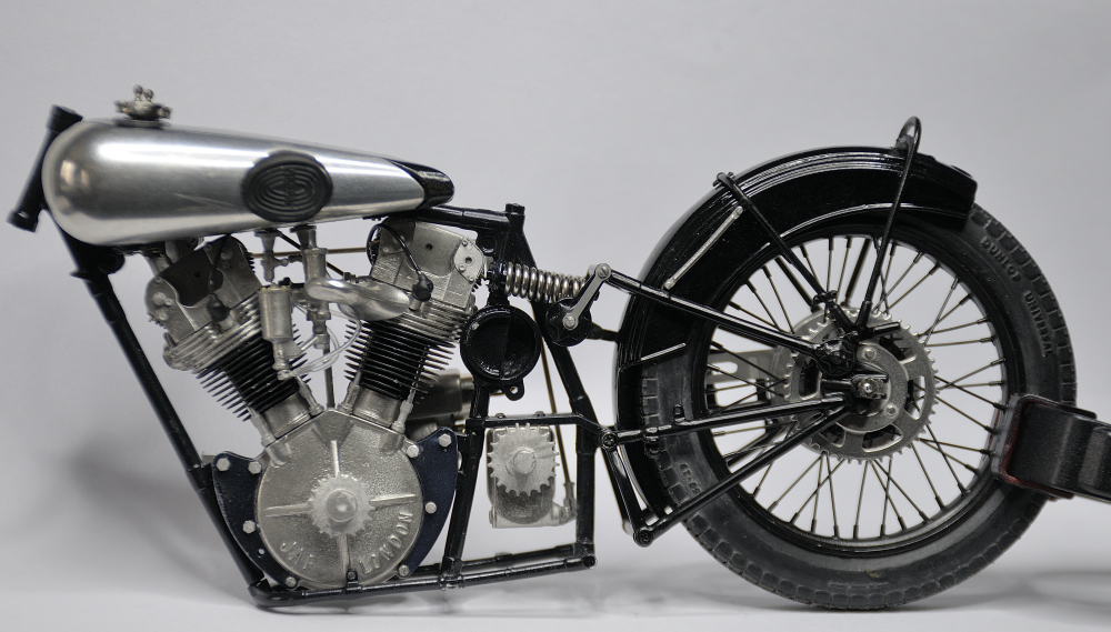

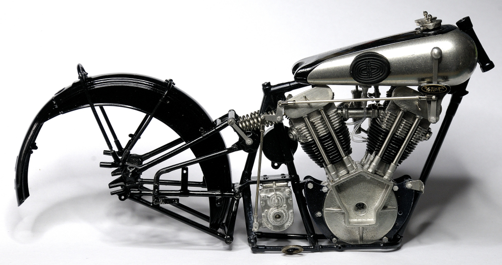

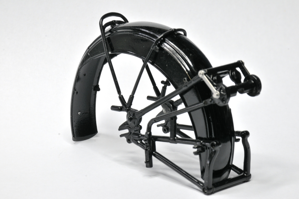

Progressing again now , built up the rear sub frame and attached and everything is still straight which is a miracle :) These are not easy builds and when something goes right its like the sun came out on a cloudy BBQ.. :cool:
