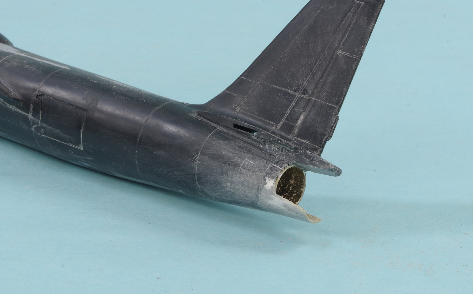

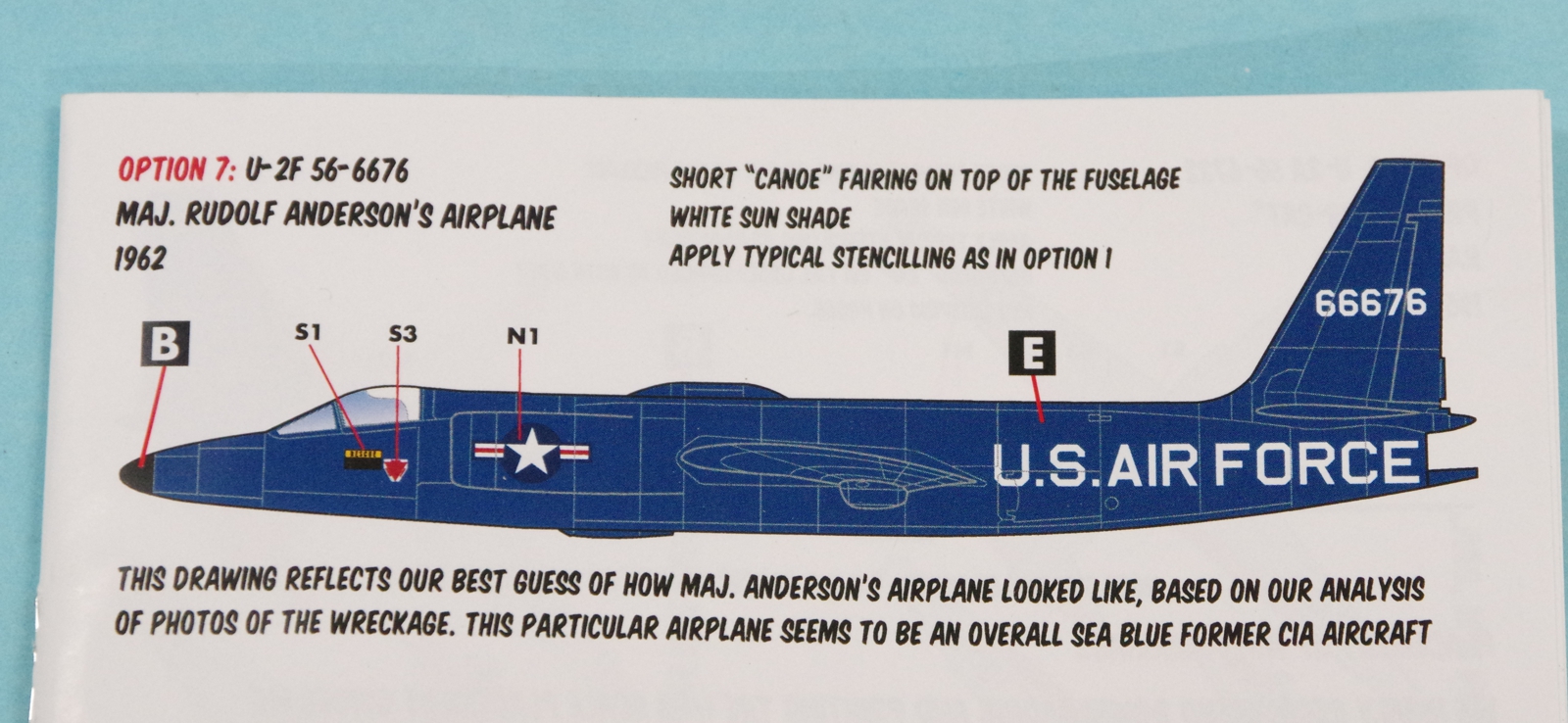

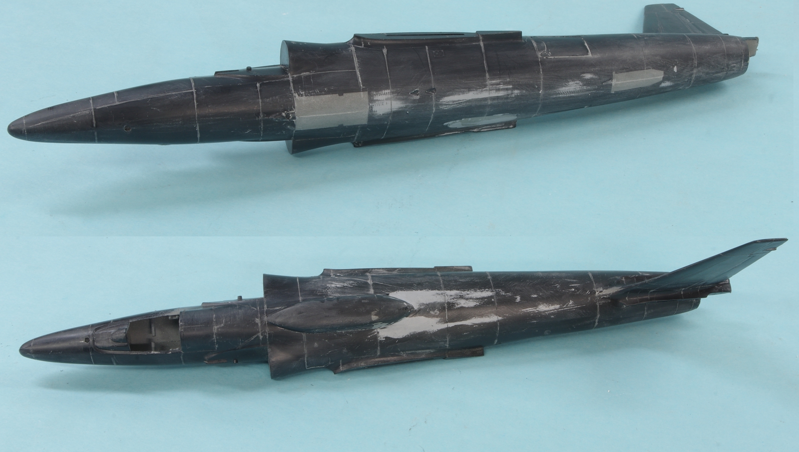

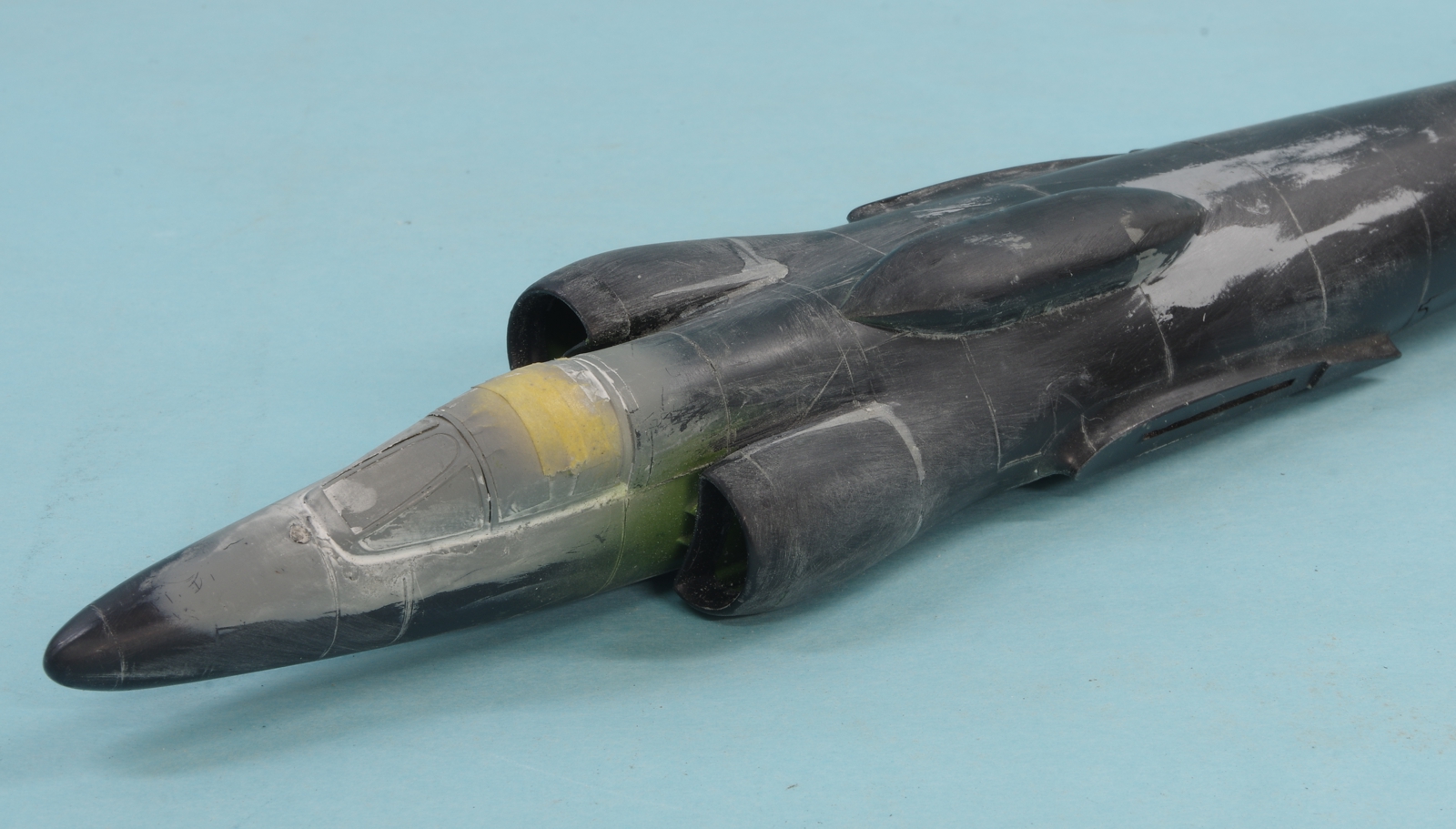

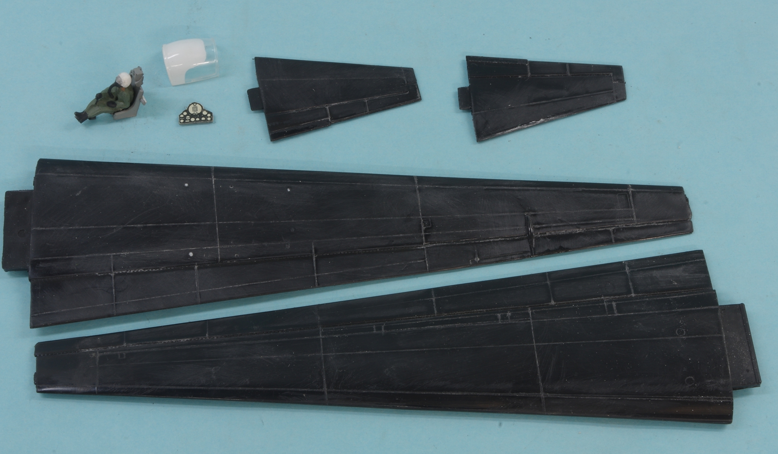

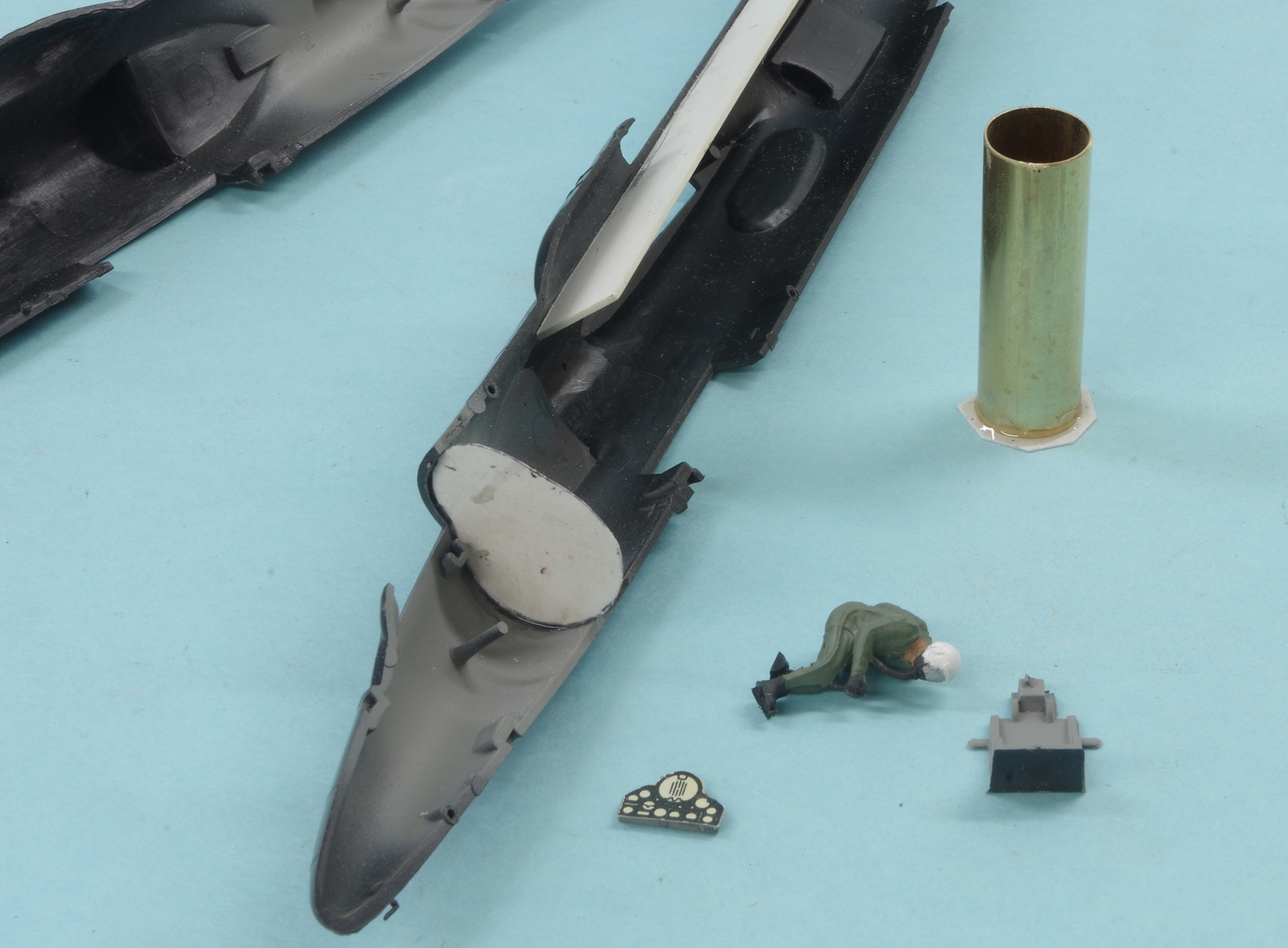

I will be doing this model as Major Rudolf Anderson's U-2F. Major Anderson lost his life when shot down over Cuba, an incident that is thought to have been a big factor in things not getting worse during that crisis. Caracal Decals did a sheet that has the correct markings. The U-2C kit has the long upper fuselage fairing which had to be shortened. After cutting the necessary area a plastic card backing was made for the area and then Aves Epoxysculpt was used to bring things back to the proper shape. The cockpit will be just the pilot, seat, and instrument panel as it will be an inflight display, and with the addition of a bulkhead blocking off the rear of the cockpit. The same process was used to fill in the landing gear bays and a recess for a duct on the bottom was also filled and faired. The model has been rescribed using a JLC saw and a fine Tamiya scribing tool. A tailpipe was made from 9/16 K&S brass tube.
