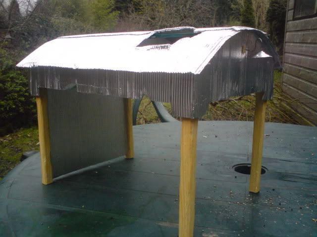

As part of my "Duel In The Sun" GB I have built a corrugated iron barn. The effect is simple to achieve and is open to experimentation.
Take some corrugated card. Mine is flat on one side. This was glued to the structure and allowed to dry.

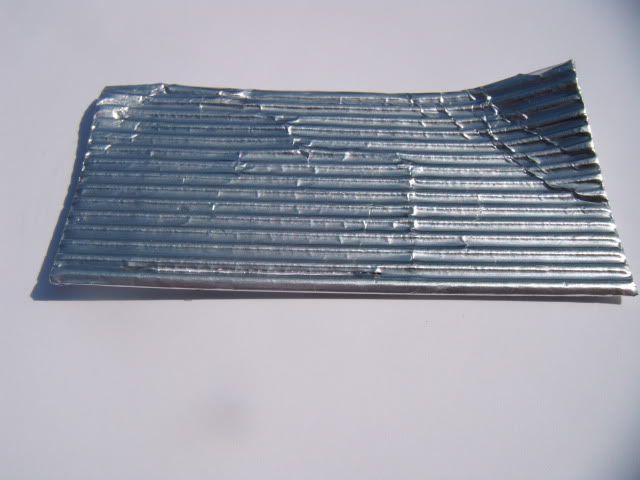

Next take some ordinary household aluminium foil and spray the shiny side with an aerosol adhesive.
This can be applied in small pieces as the overlap is barely visible. The edges can be folded over to give the impression of overlapping separate sheets of iron. This is then stuck directly onto the card.
Work the foil into the contours of the card with a soft sponge and a cotton bud.

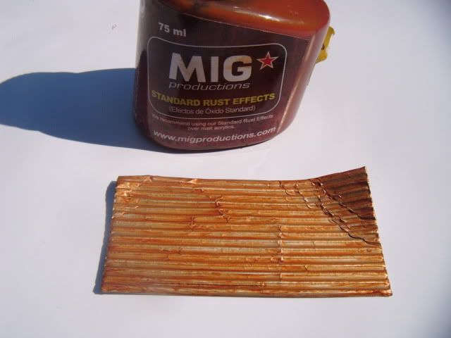

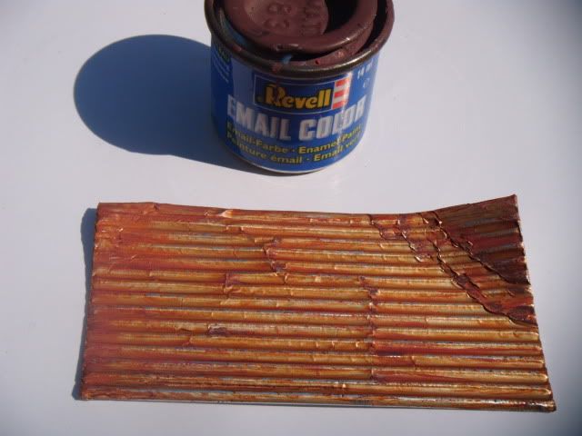

Next add rust etc using rust powders and paints.
The foil can be scratched and raised to give the impression of lifting paint/rust etc. This process would also work on flat sheets of card to produce "sheet metal". I hope this is of some use to you.
