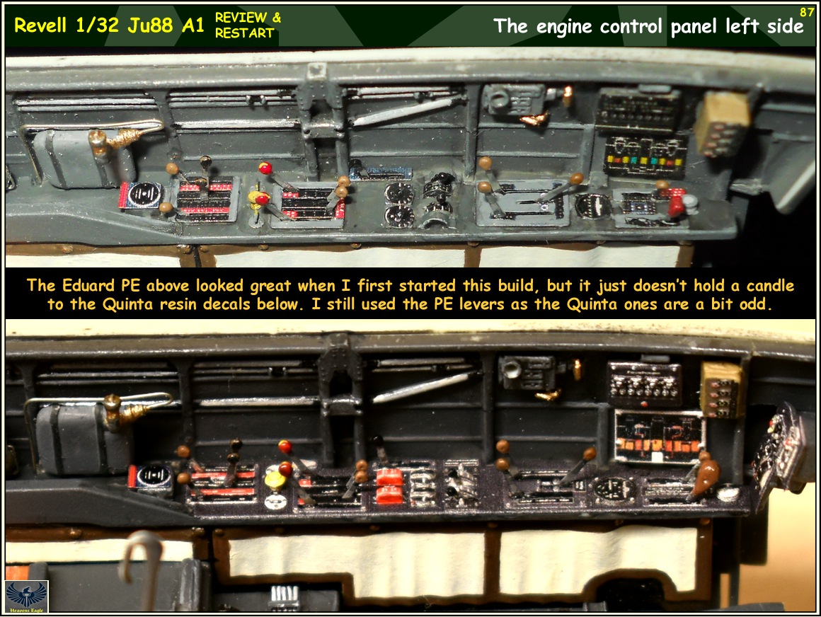

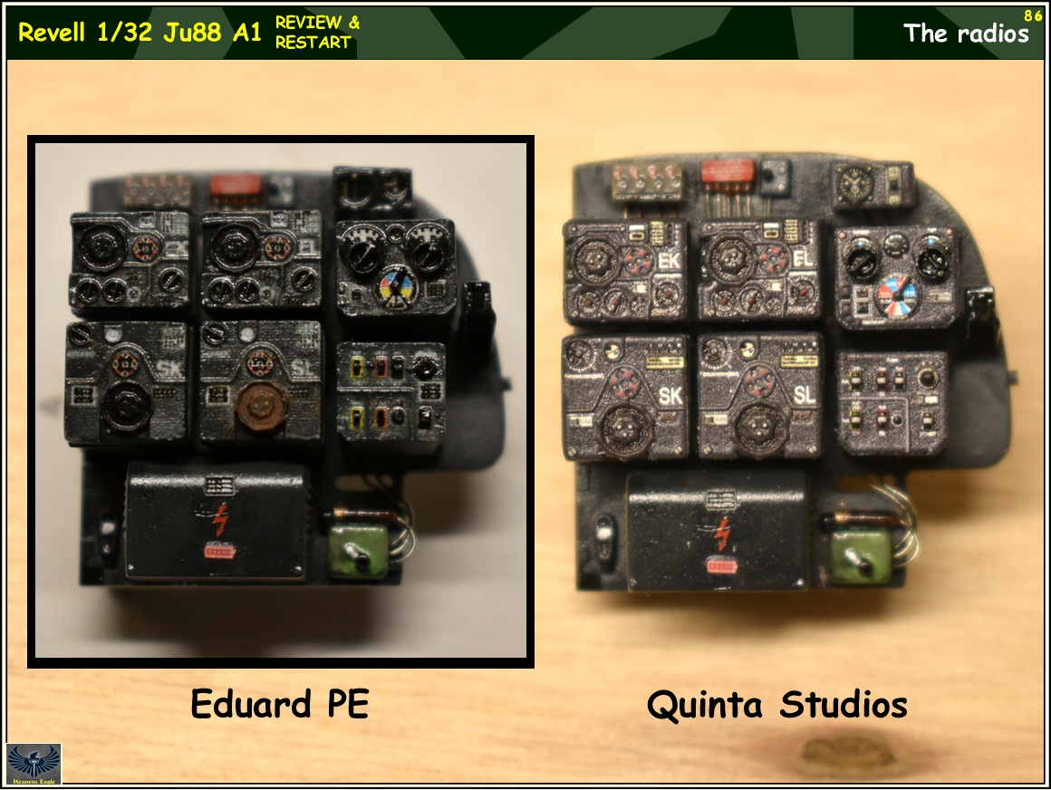

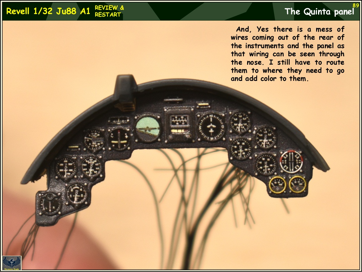

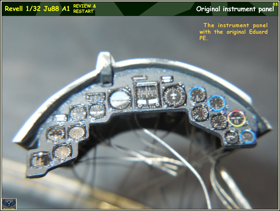

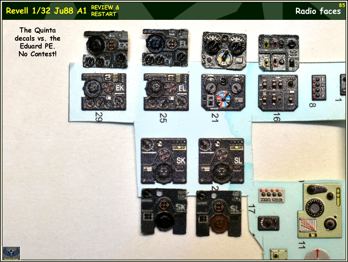

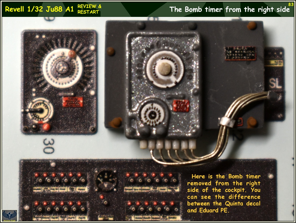

Finally here are some NEW build photos. I decided that I liked the new Quinta decals so much better than the old Eduard PE ( :poop: poop extrusions :bigrin: ) That it was pull things apart and replace them. I think you will probably agree that there is a marked improvement.
This is all that has been done at this point as I have been busy with things that HAD to get done in a timely fashion.

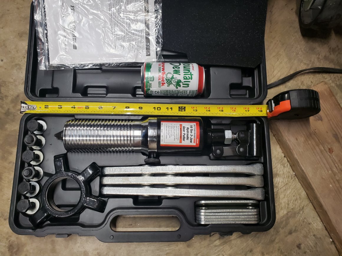

So I am sitting here drained as I spent the night replacing the front brake rotors and pads on my little Corolla. The rotors were a bear to get off, but luckily I spent the $$ a while back and got the 10ton hydraulic puller and that is what it took to yank them beasties off. I had to get those rotors replaced as they were worn enough that the brakes were doing some things they shouldn't. All good now, and all stiff, sore, bruised, and tired as been working on that car all week. Maybe I can do a little this weekend still. Got the BIG JOB done for now so yay!
It seems that I spend part of what I would be saving on tools, but then the next time it goes much faster and easier. I originally bought the BIG wheel puller just in case I needed it on the bug restoration. It really was the only way I was able to get the rotors off. It was actually scary as I didn't want to damage something else, but after doing some research I was doing it the right way. The rotors had a 1/8th inch surface band around the center hub that was tight and rusted. After setting the puller on the rotor. (should have taken a photo damn) 3 pumps and the rotor just flexed. 🤯
On the fourth pump the whole mess popped loose and launched on to the floor with a loud bang. The puller alone weighs about 15 pounds, and I had some 4x4s under it in case it did what it did.
Here is what the puller looks like and how big it is.
Setting this up is like holding a big dead heavy spider.

Ah proper tool
I had something similar for pulling the flywheels of Ducati engines. Clamp it on, wind the centre in to load up the middle then sock the end with hammer. An almighty gun shot and the flywheel, puller and some skin would rocket across the garage and chip a hole in the brickwork opposite....happy days :)

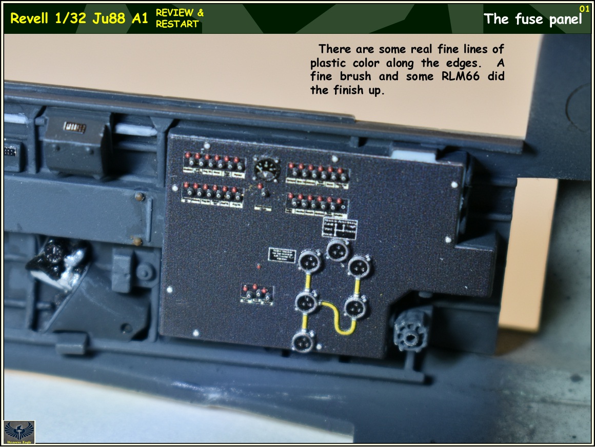

I finally have a decent update on this build. I have been working on it over the last few weeks redoing some of the mods I had previously done in the tail wheel well, and adding new stuff. I have also been working on the cockpit getting ready to glue the fuselage halves together.
I can now say the fuselage halves are together and I will now press on with finishing out the cockpit.

I am fairly happy with how things have turned out so far. The Quinta lap belts are a pain in the can. On the Stuka they cracked in the middle and even though I did some things to make them a bit stronger they still cracked. I went in fore armed so it wasn't as bad, but they need to come up with something different as the lap belts have to bend and twist sharper than the resin can stand. The shoulder belts are fine.
Hope you like it.
Talk about engineering modeling. All that hardware looks functional Paul. Looks great!
That was all the big stuff back there and yes you can see it through the opening, though probably not with it sitting on the ground.
The main gear wells are a lot of the same, though I have a lot of that done already.
