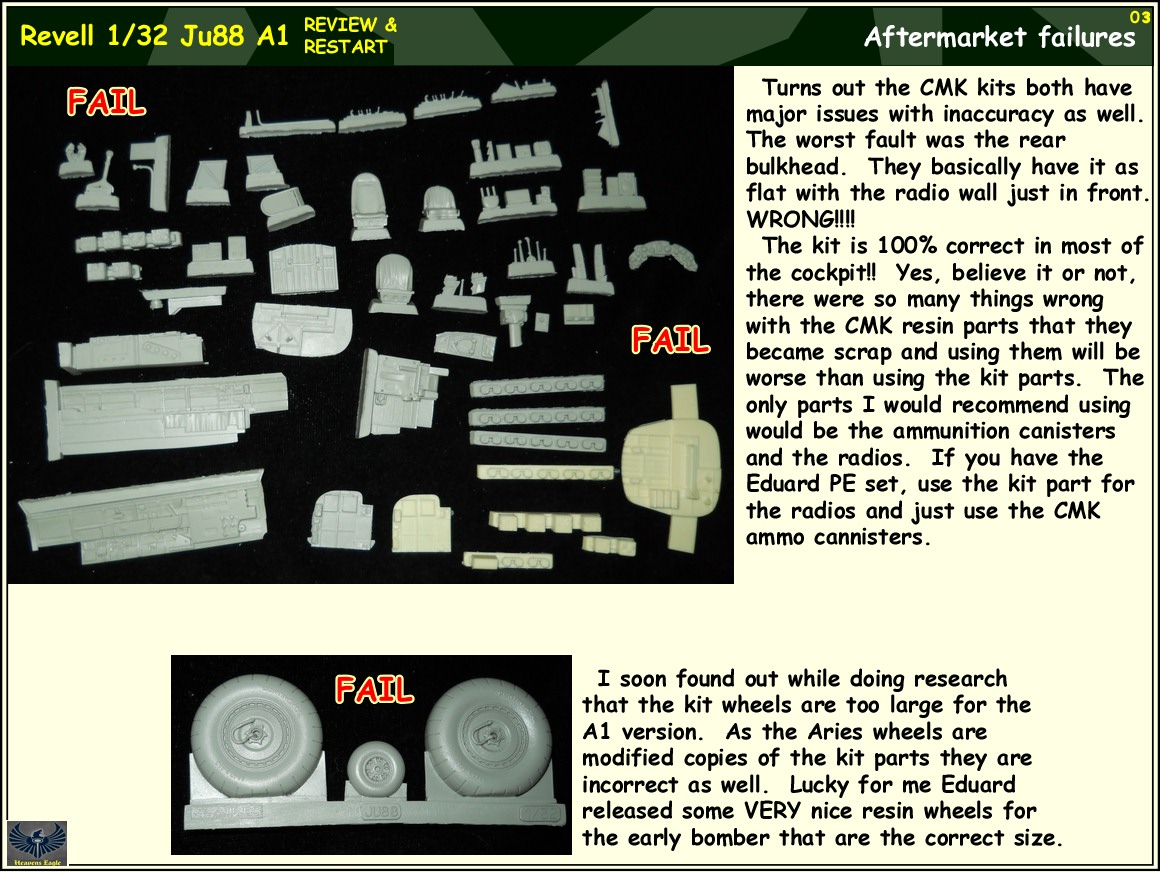

I believe this beastie was the build that fully brought me to MA if I look into the way back machine. I think that old thread is still around, but I don't recommend looking it up as my posting style is much better these days. Also there will be a lot more of the in process detail that was left out back then so you will definitely want to follow along on this one.

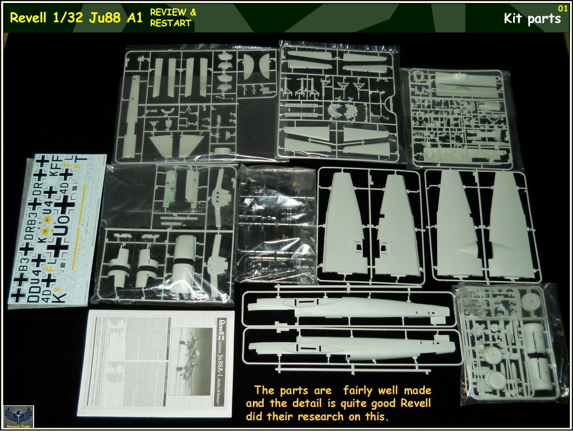

The Stuka is taking another break. It made great strides, but I got to where I just didn't want to go there right now. Hopefully this will cross the finish line this time. The kit is really a good kit and the fit is quite good. The detailing is a little soft in some areas as opposed to very crisp and sharp detail, but it is good. Revell really did their homework when doing this one and while I have added a lot and modified more, it was only from my desire to do the extra detail that it deserves rather than have to do a lot of corrective rework that never seemed to end.

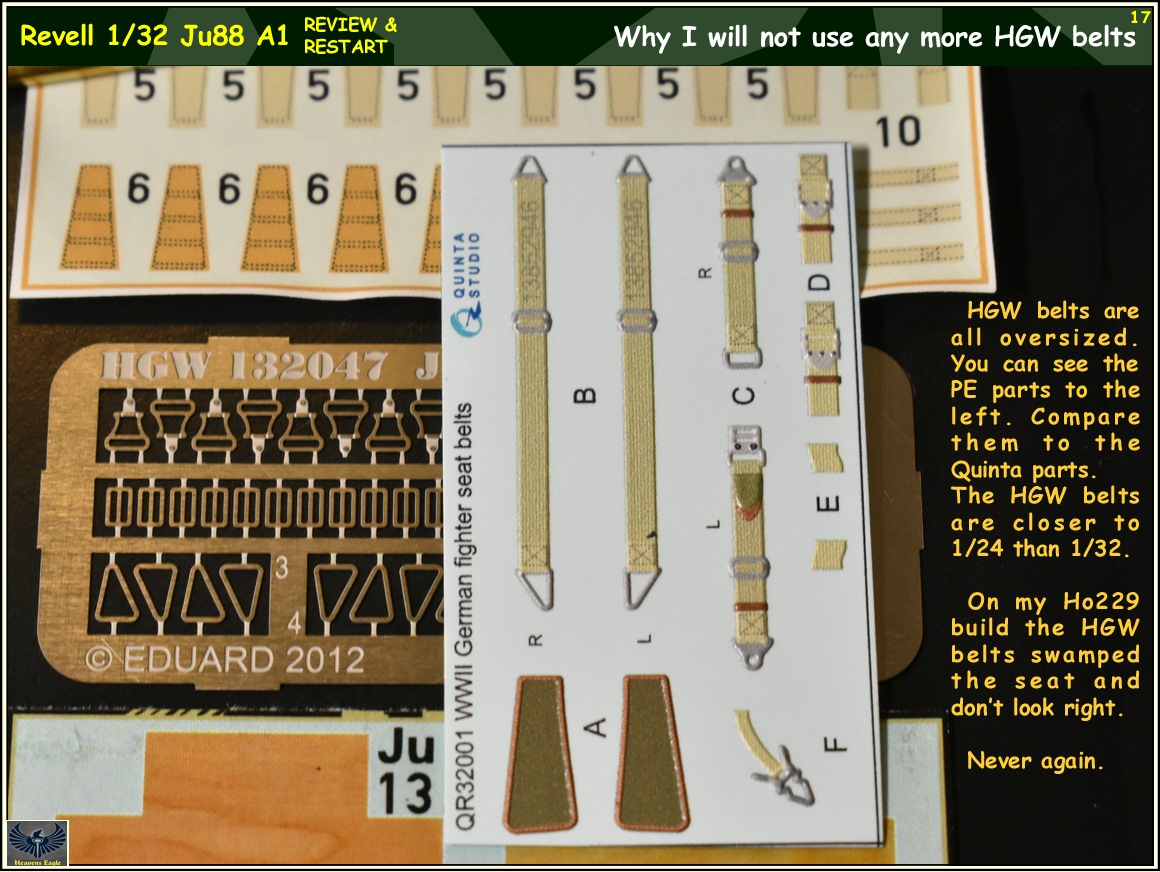

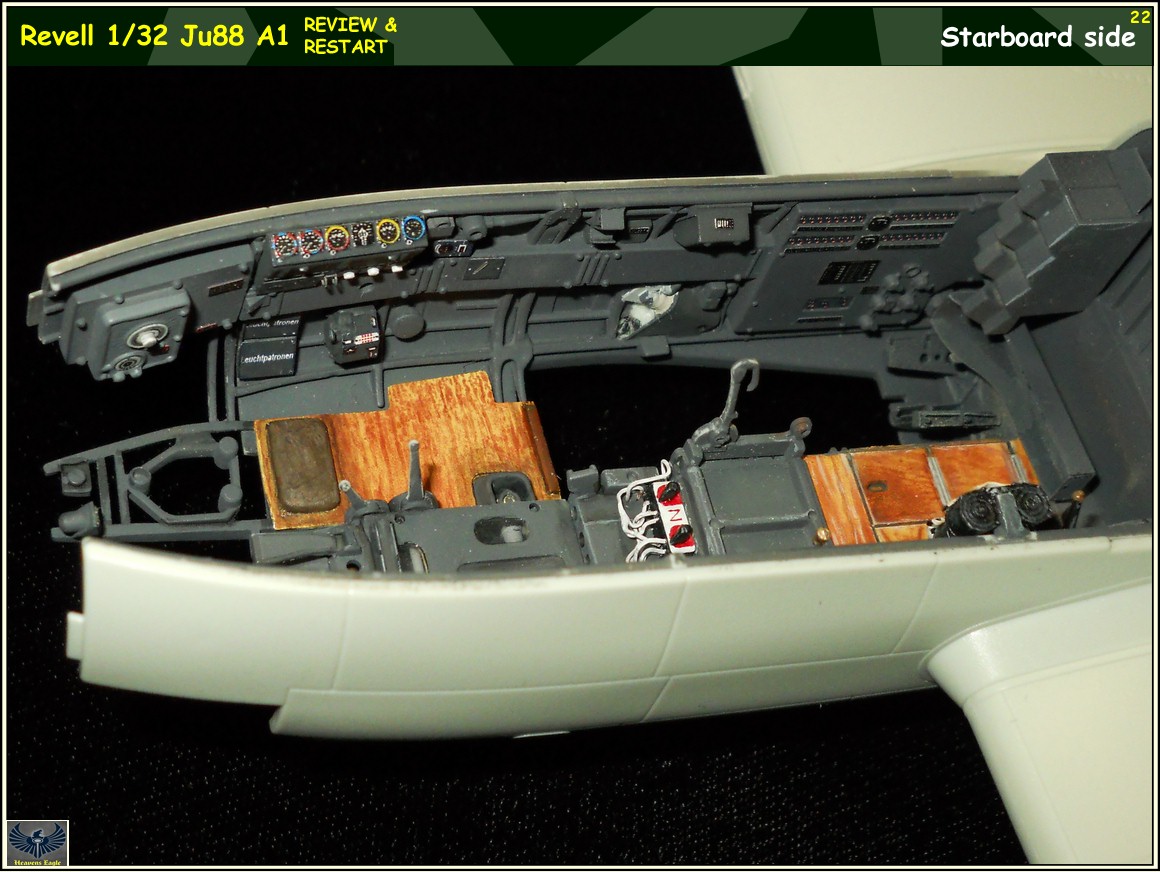

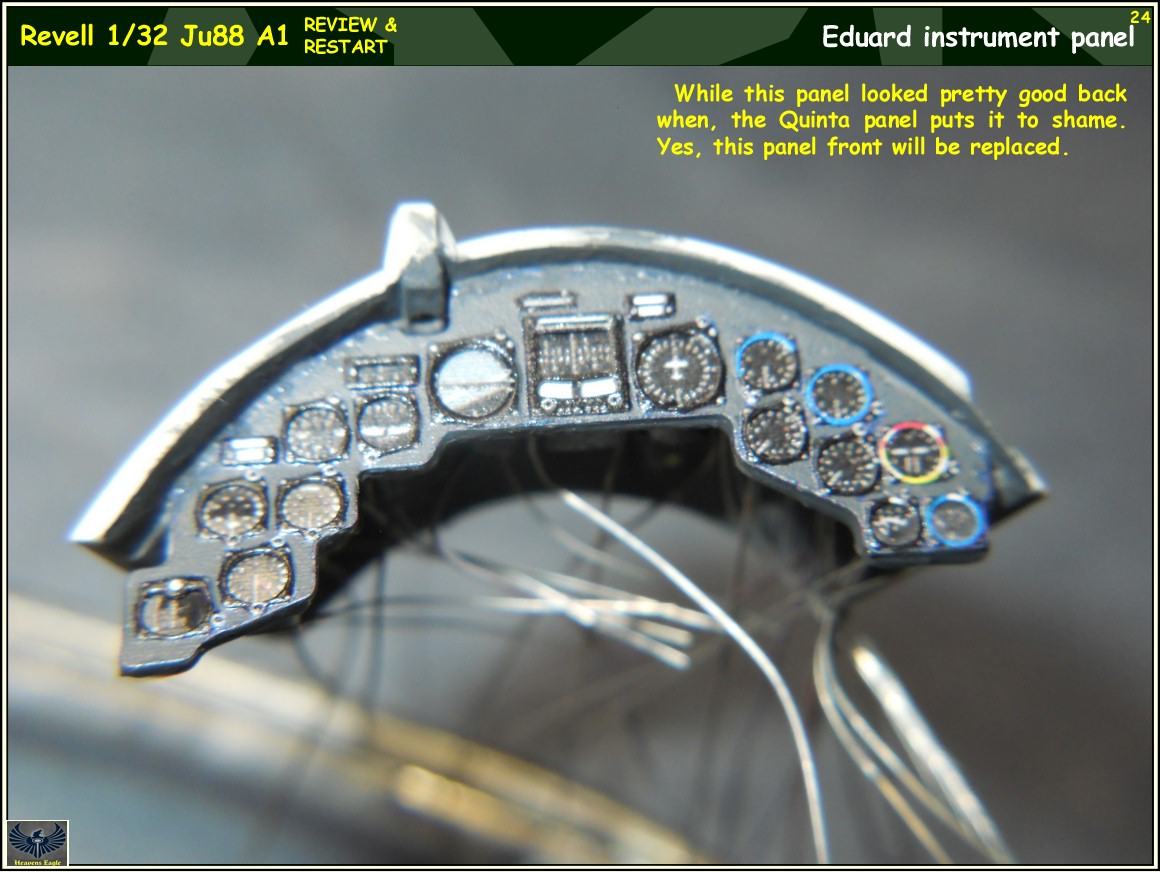

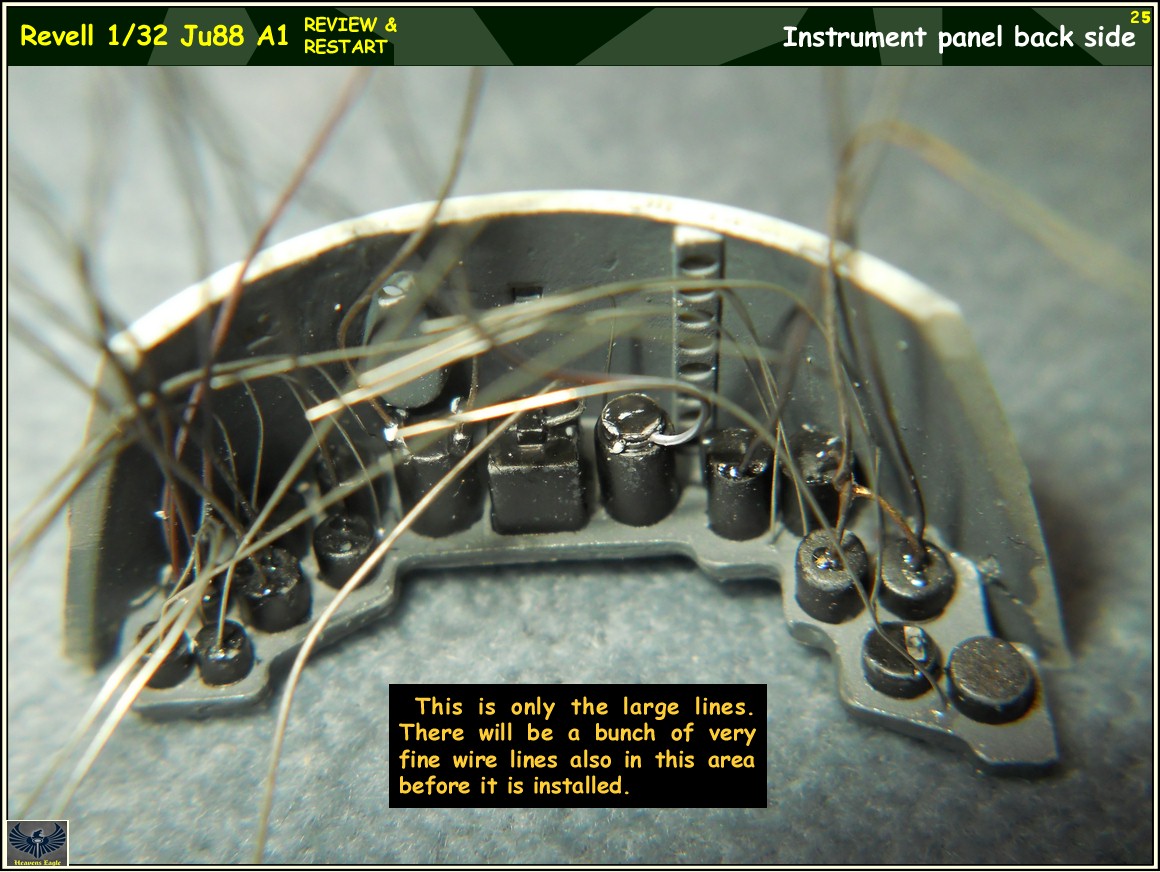

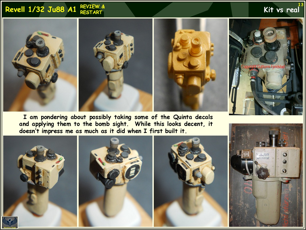

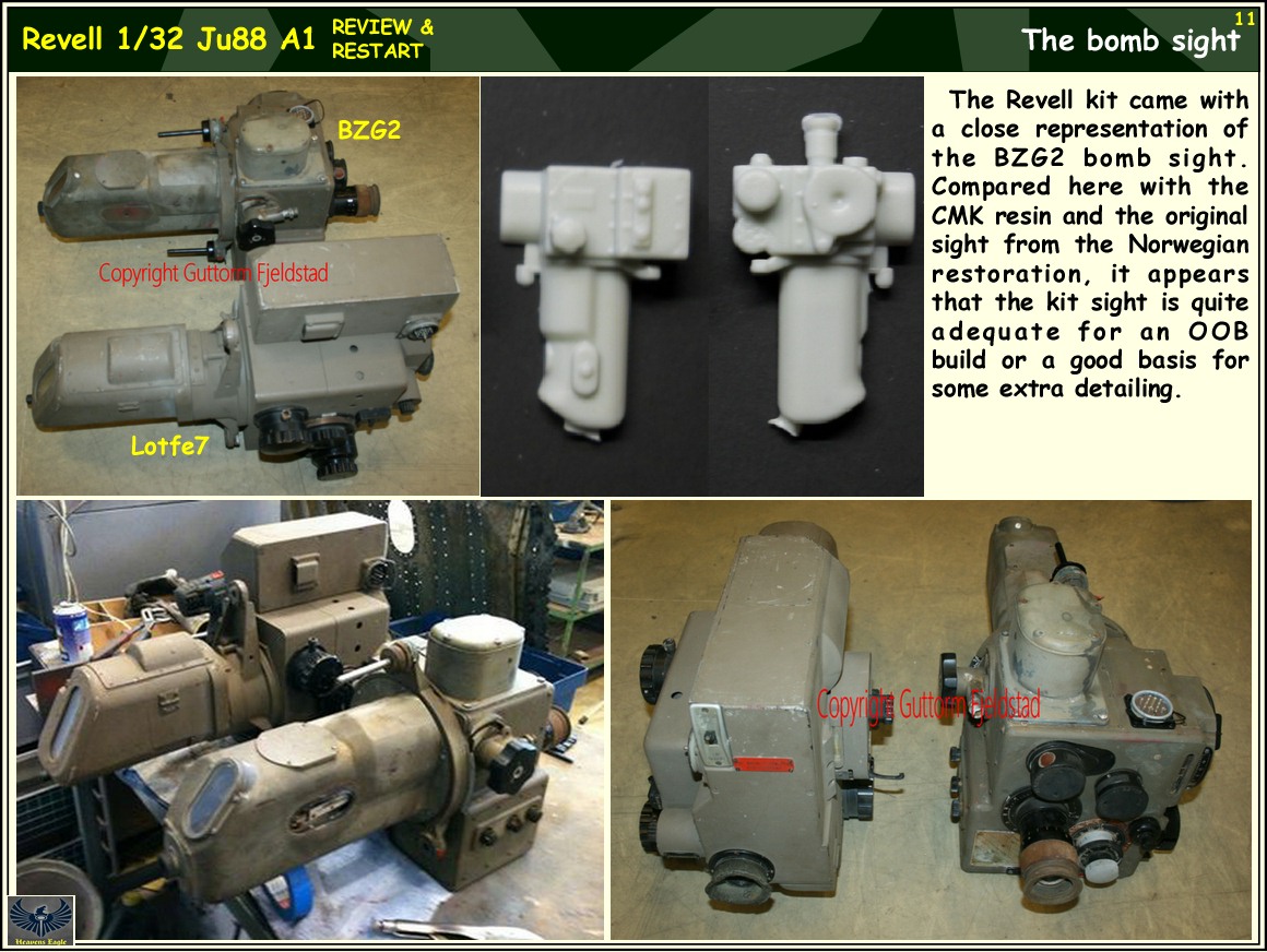

The first posts are going to be reviews and a deep run through of all the build that went on in the beginning. I have already decided that I am going to pull the Eduard PE instrument panel items and replace them with the new Quinta Studios decals. They will make the cockpit pop even more than it currently does.

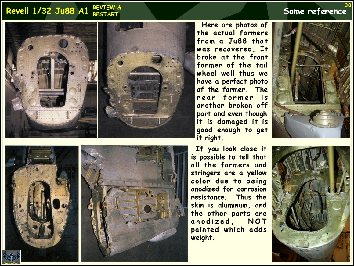

As for reference I used and will be using a lot of photos from the Ju88 A1 that has been undergoing restoration and rebuilding over in Norway. That plane is what this kit is based on, and they have been quite diligent in the restoration process to get it absolutely correct. Makes it so easy to paint the cockpit.
Anyway, time for the first installment. This is as much for me. as it is to bring everyone else up to speed. I still have all the old build photos and reference material as well as my revision notes.
Enjoy!

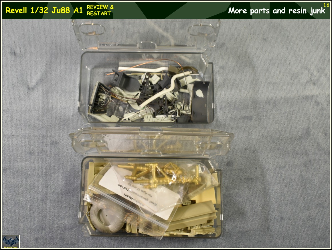

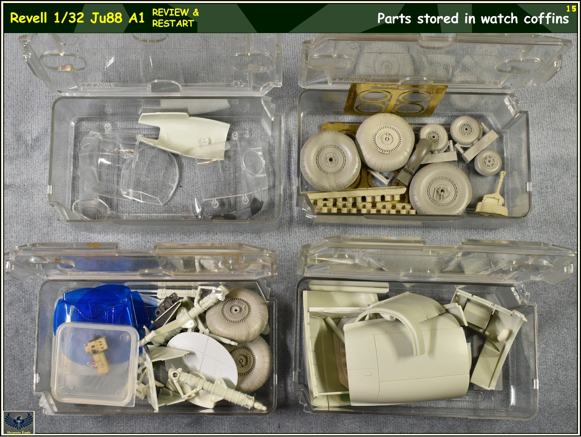

A little teaser update. Have been working on getting all the info, posts, photos etc. put together so they make some sense and show what I want to show. The old stuff kind of sucked.

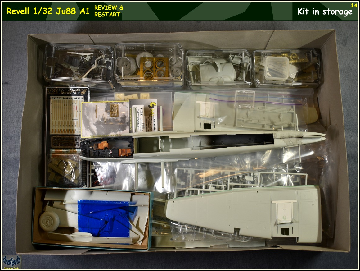

Anyway, here is how it has been stored. I have these clear boxes that I got from work a number of years ago. New watches came in them and the name "watch coffins" was mentioned by someone and it stuck. They are really great as they are pretty stout, decent sized and when shut have no way for even a tiny nut or bolt head to fall out. 👍 They also stack and lock together so they don't tend to slide around when stacked.

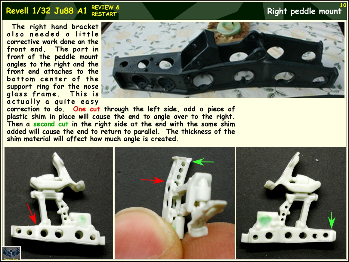

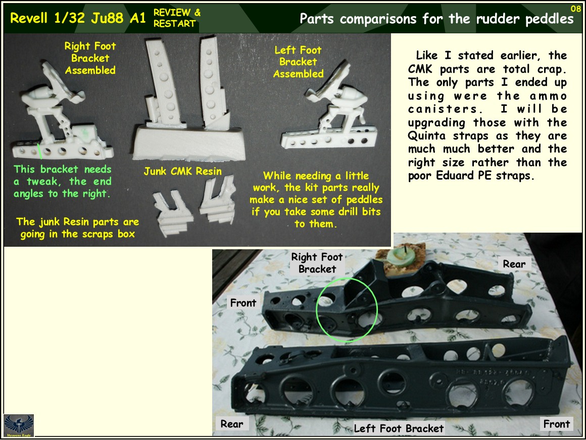

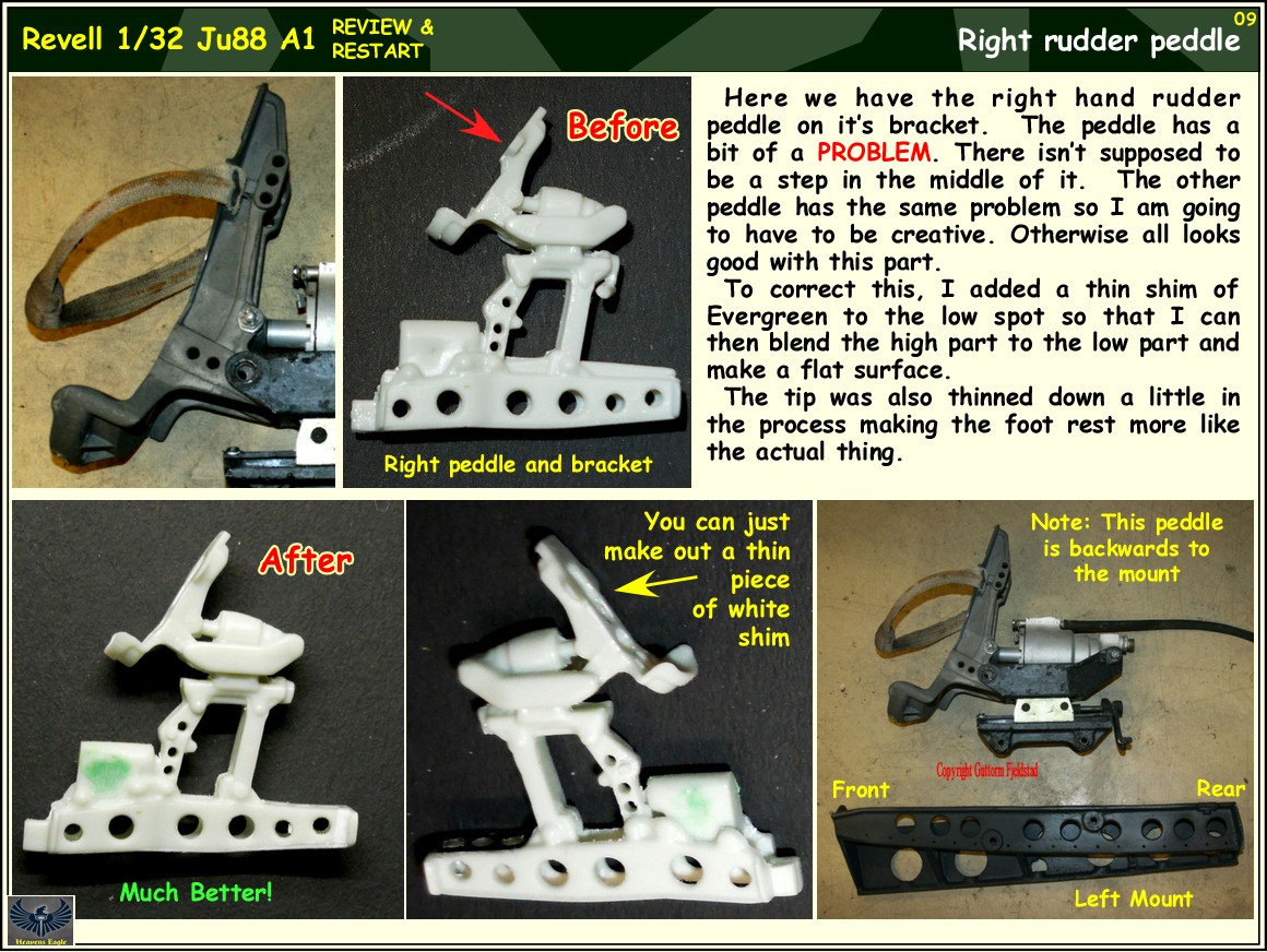

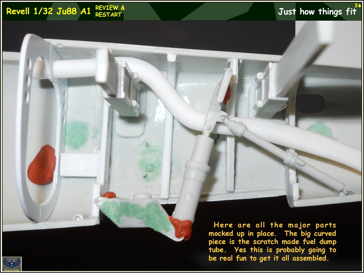

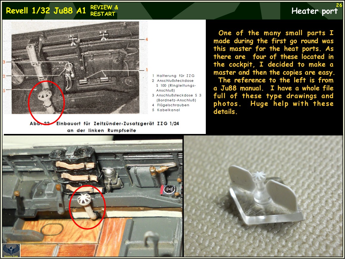

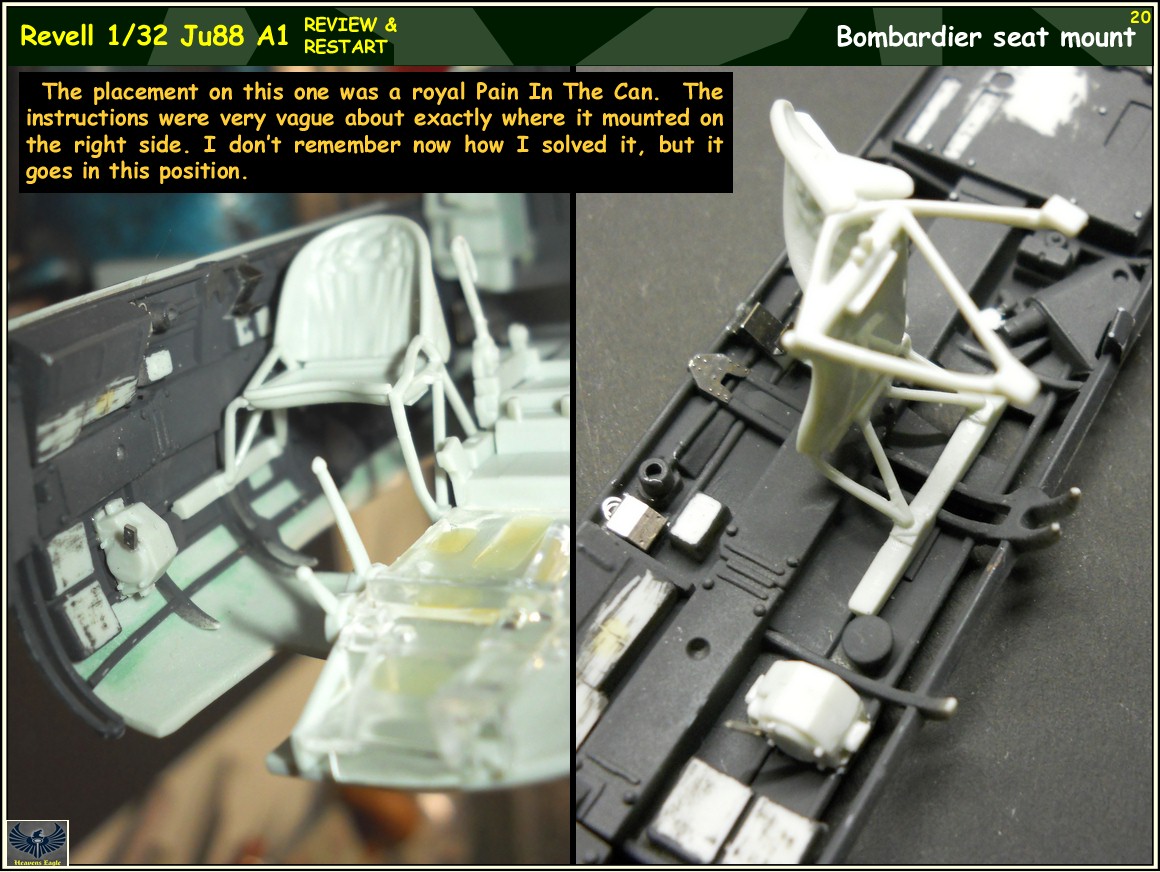

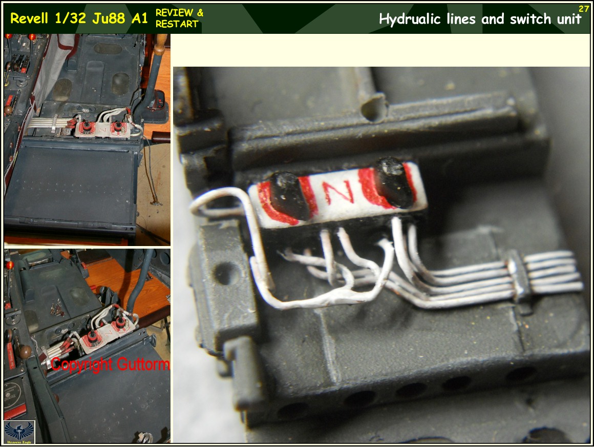

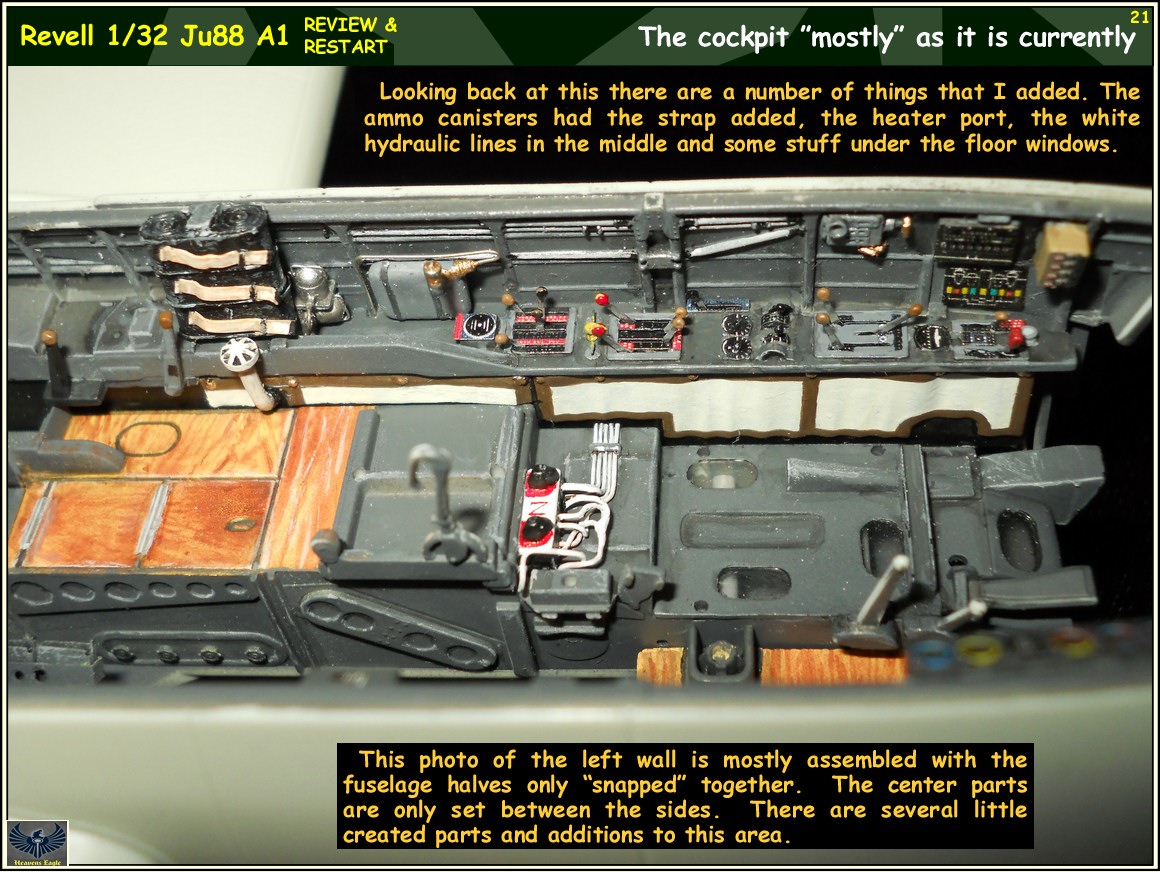

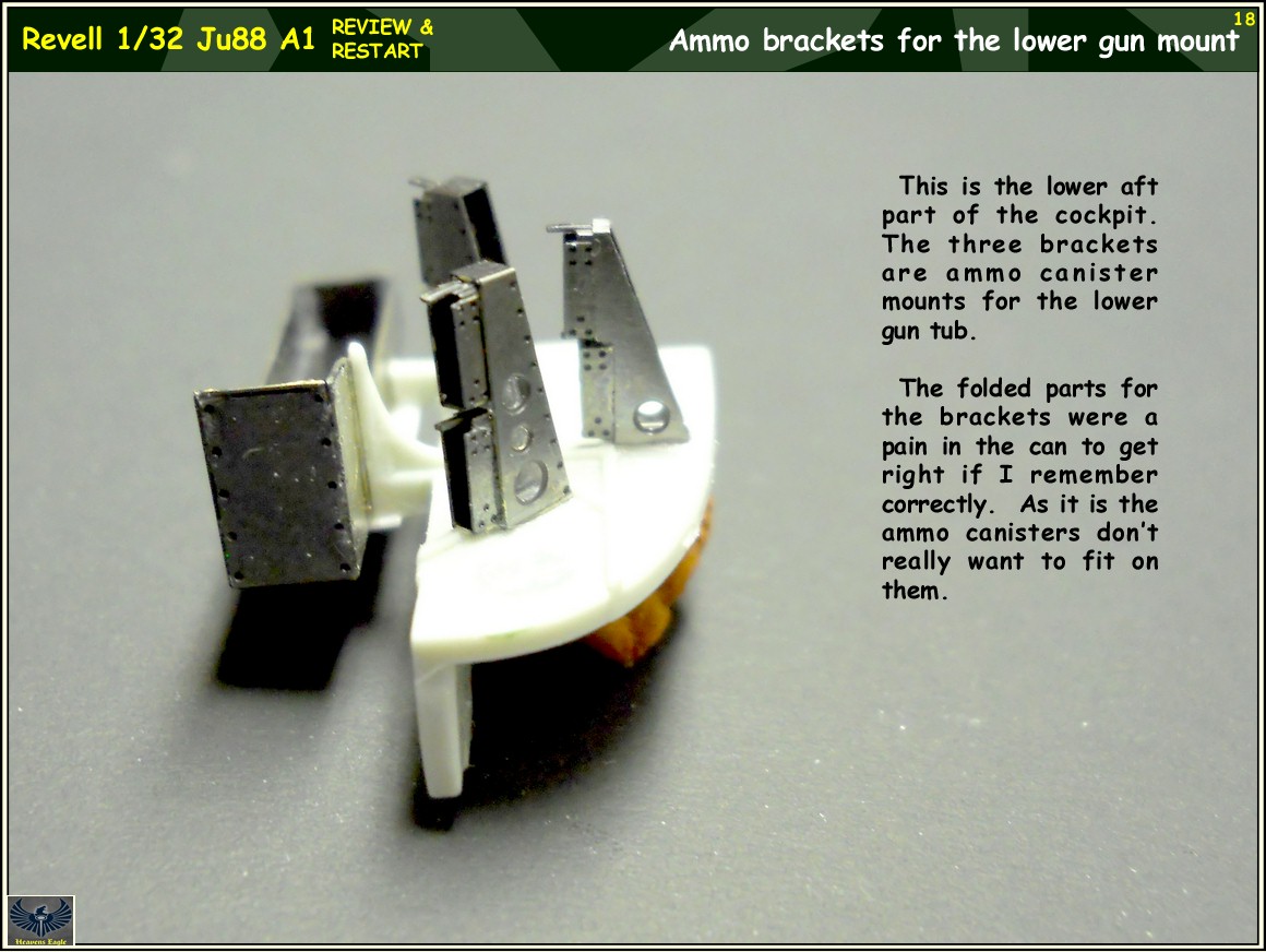

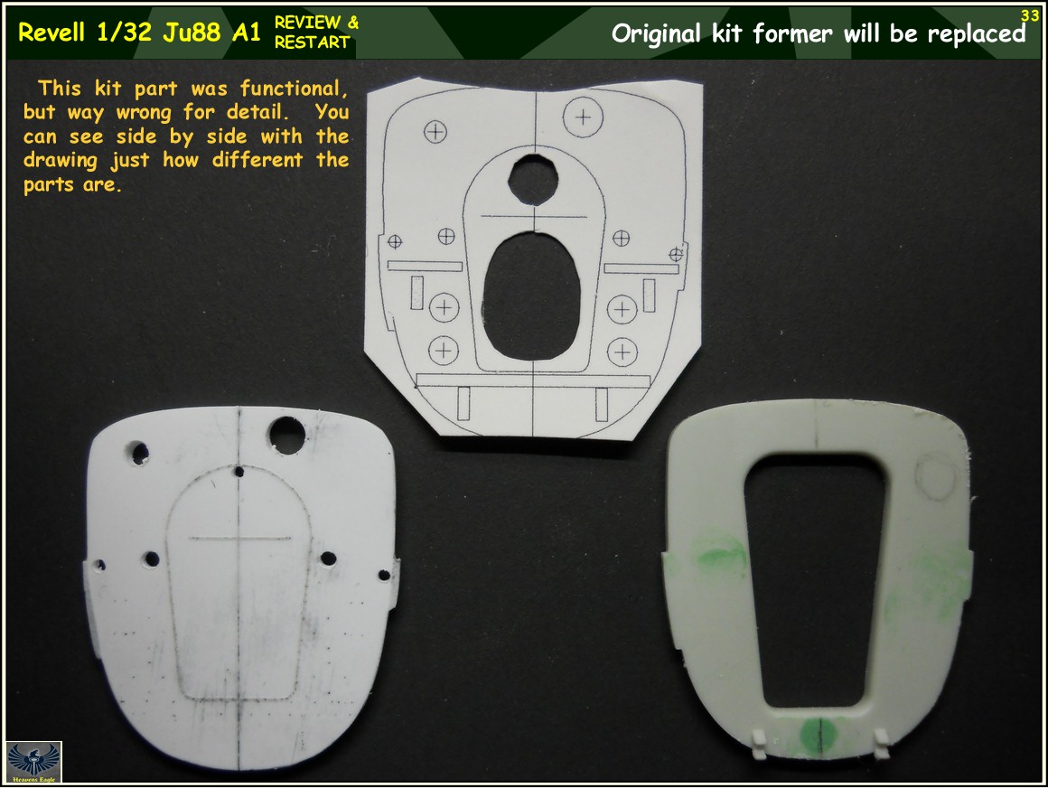

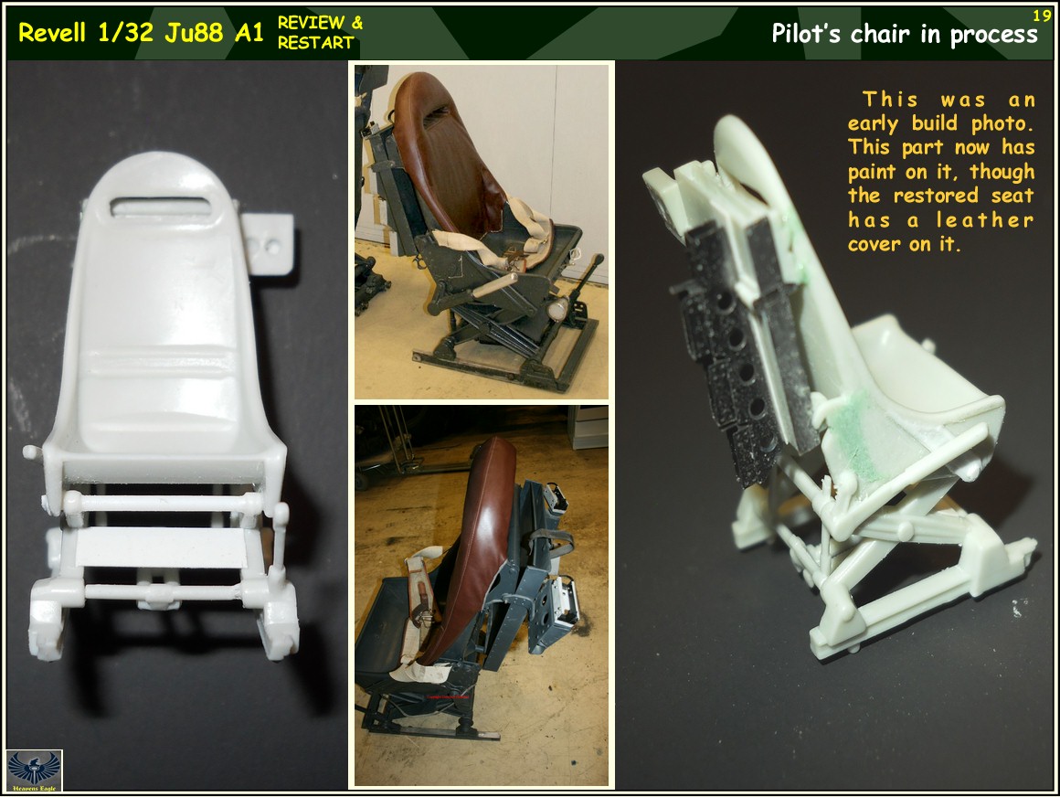

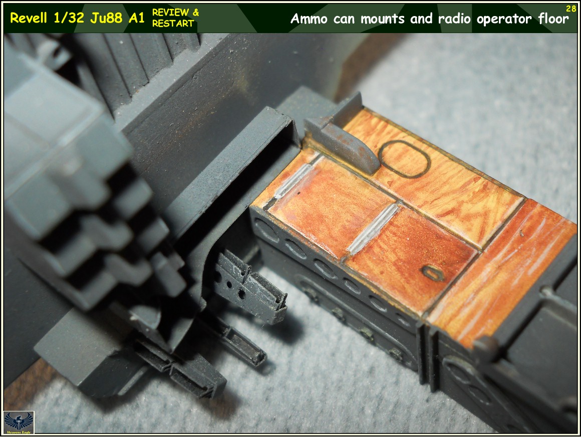

Hey all, I am going to keep doing little updates as I go through and review what I did before. Here are another few photos and updates. Starting to get into some of the meat of the build now. Some of this is a mid step that was in the middle of the build, some is of current state of a part. I am trying to just do stuff that would have information for ground work for where it ends up now (helps me remember what the 🤬 I was doing or thinking).

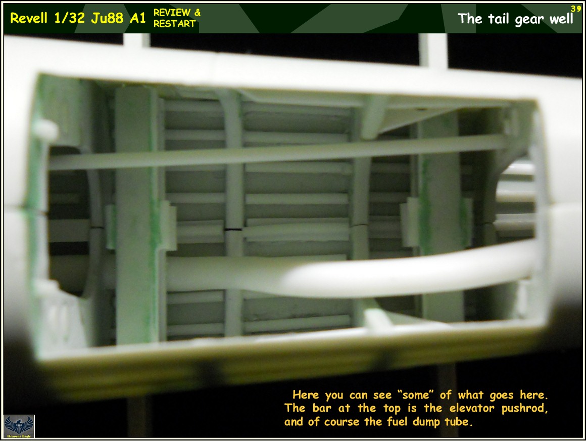

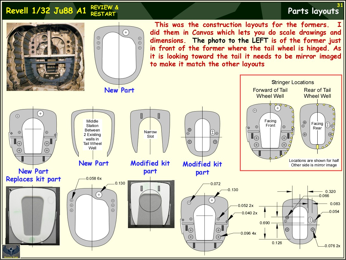

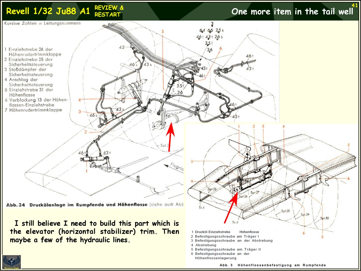

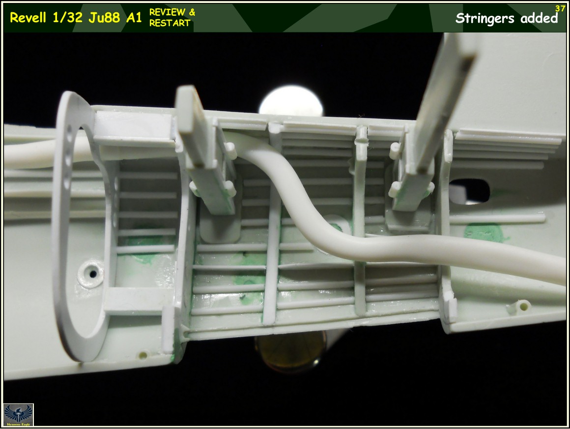

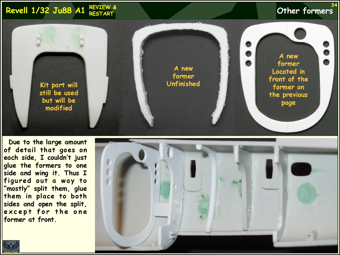

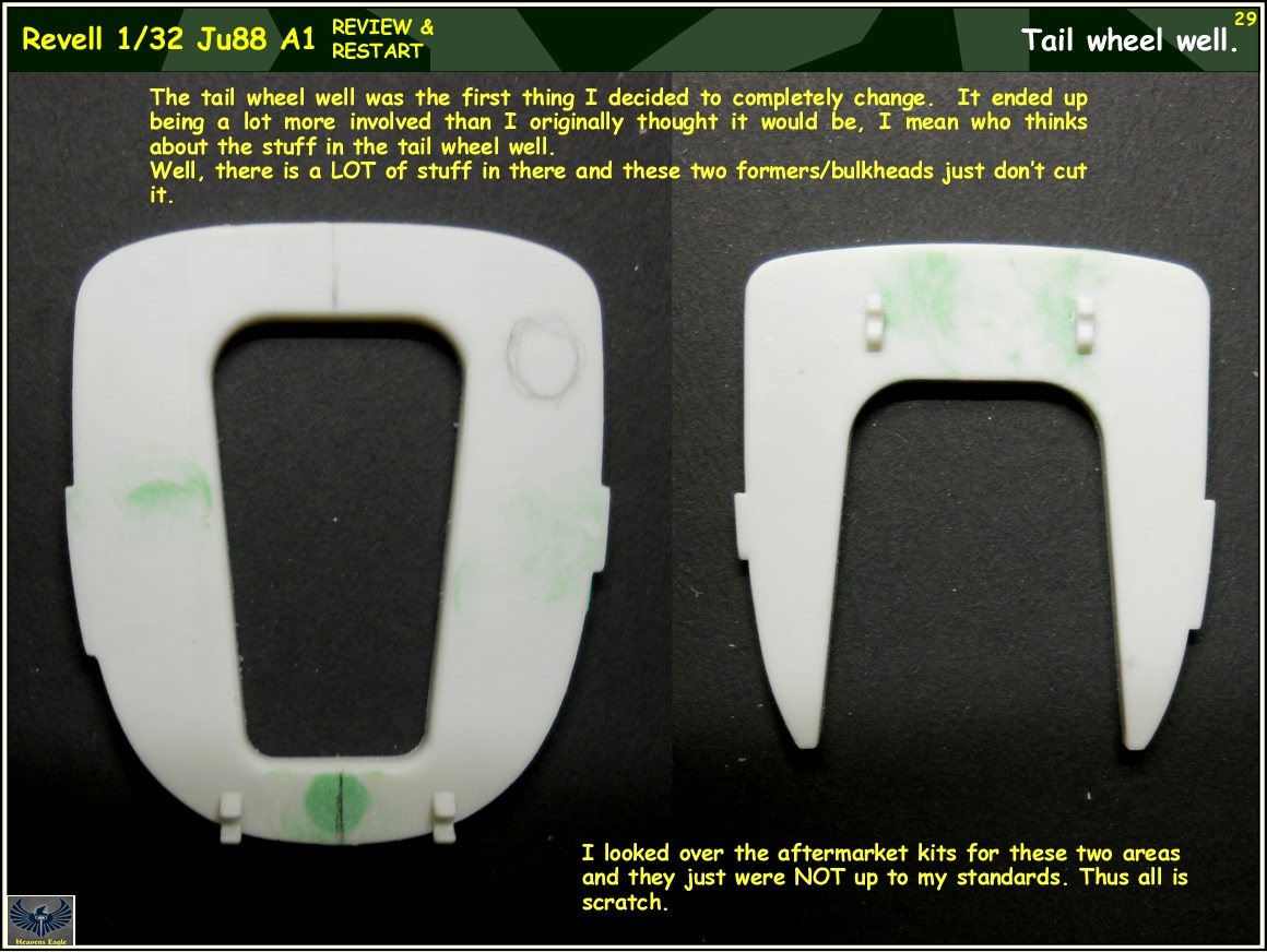

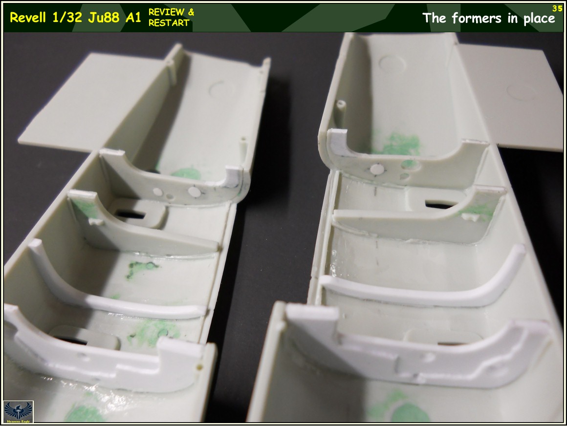

The next installment should be quite interesting as I did a huge amount of scratch building for the back of the fuselage tail wheel well. Not much correction as much as ADDING things, LOTS of things that can be mostly seen through the opening in the bottom of the fuselage.

Thanks for looking in guys. I think you will find the next installment rather interesting. Something I didn't have to do, but decided that it would be fun to do anyway.

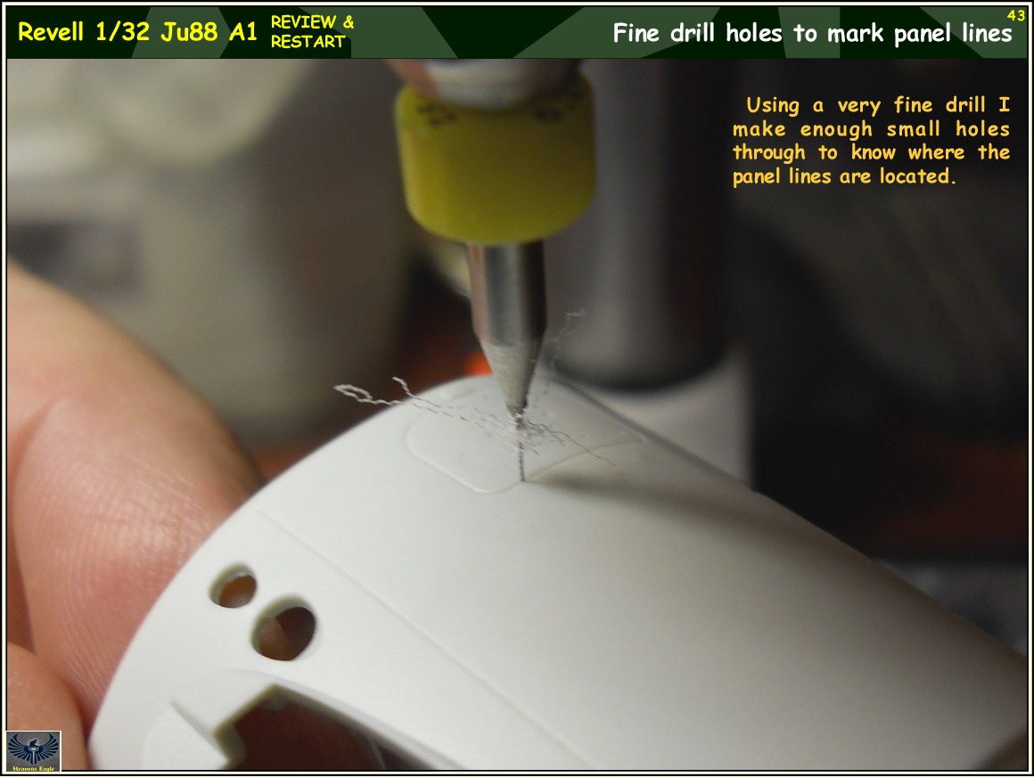

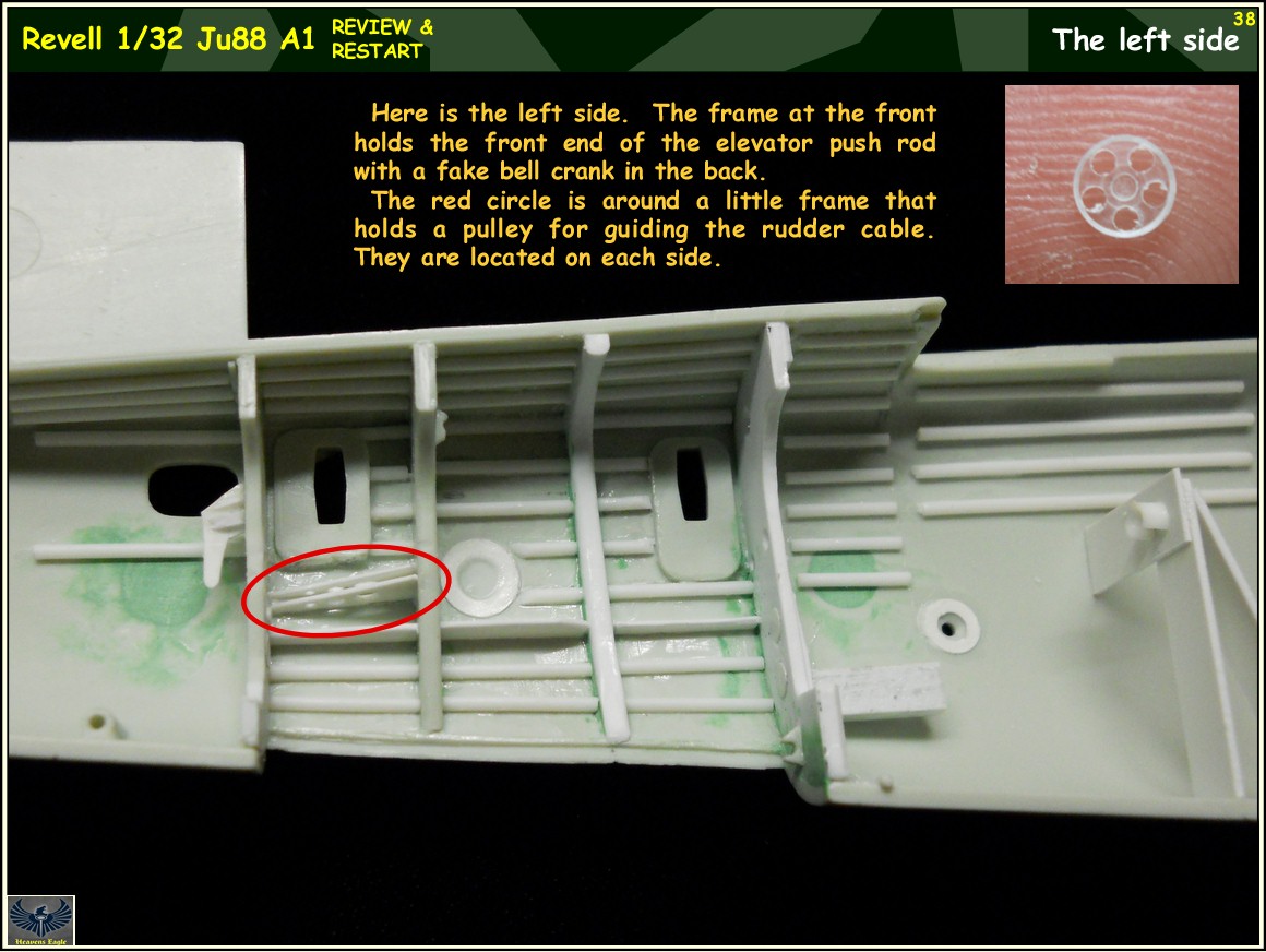

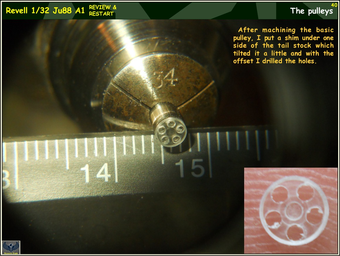

OK, got busy tonight and here is another update where I am going through all the old build stuff, reviewing it and making sense out of what I did back then. In some cases it is a little rough as I am working with OLD photos, but it is holding up well and my posting skills have definitely improved. This is almost as much work as doing the build. ;)
On with the show!
I will get some more out here soon. Now need to go do some real lathe work. Thanks for looking in and commenting.
Actually Bob you can see a whole lot of this as the openings are fairly large. Remember this is a 1/32 scale aircraft and it ends up being fairly large. Not gigantic like a B-17, but fairly large. Thus, while you don't necessarily notice things being missing as not many folks are familiar with the plane to the extent that I have become. When all the extra stuff is there, it does make a difference.

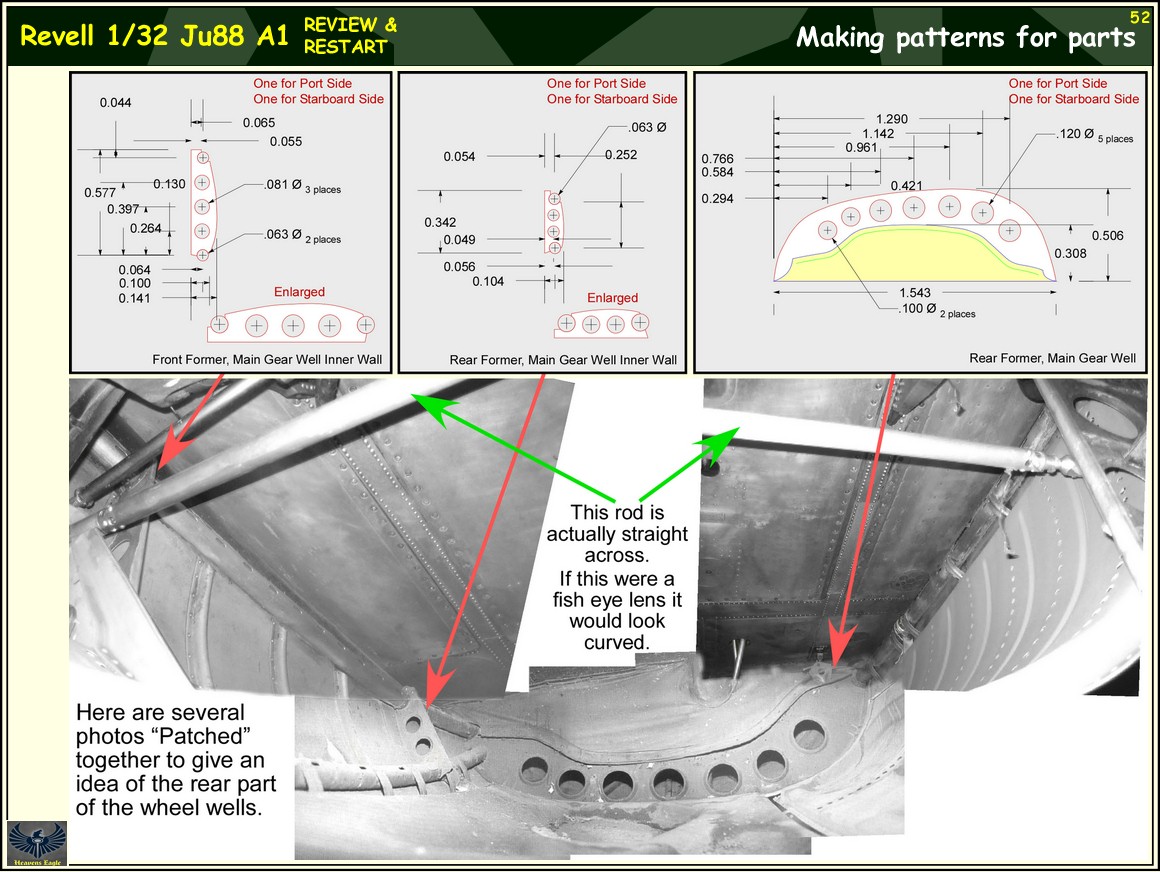

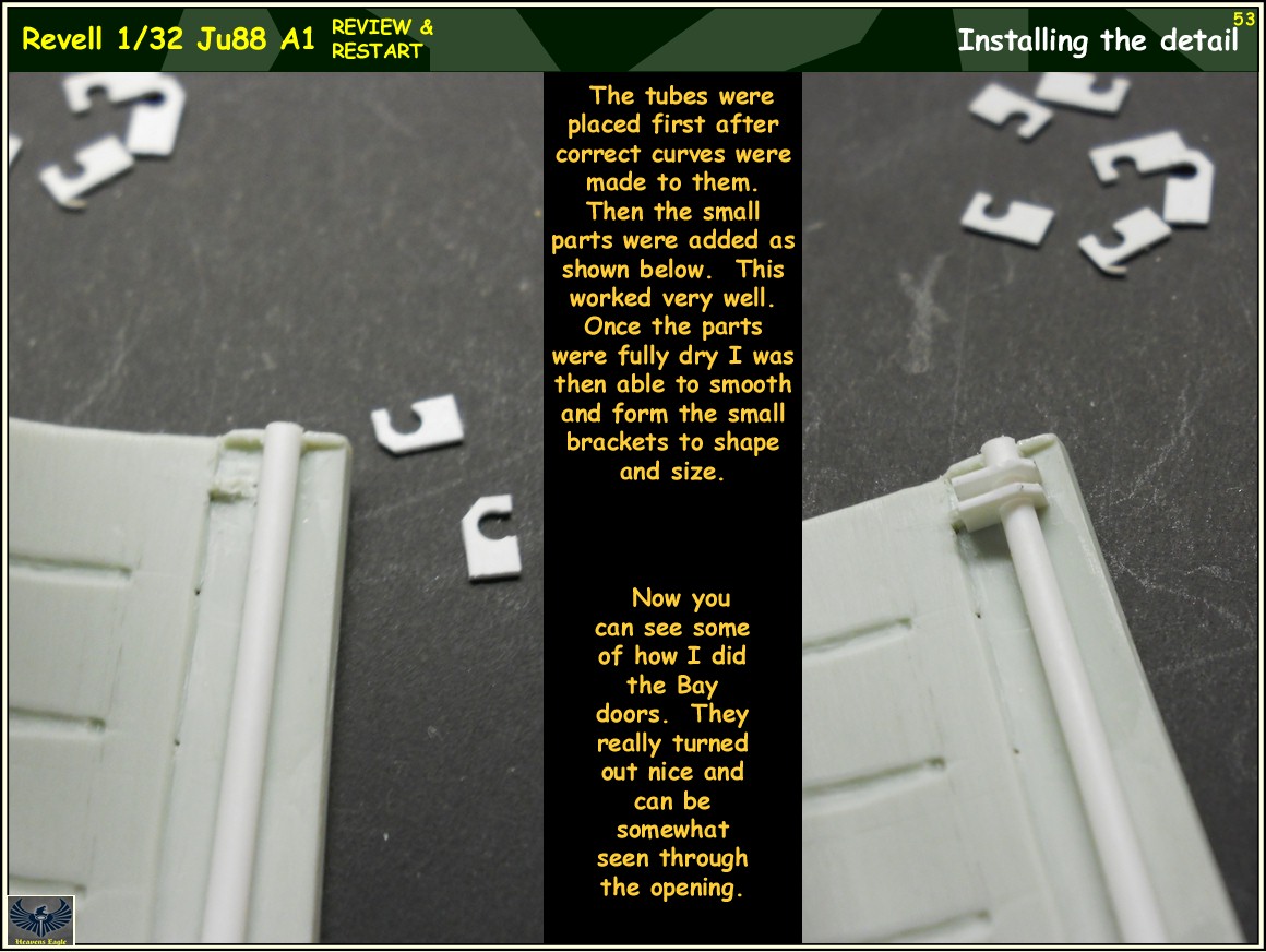

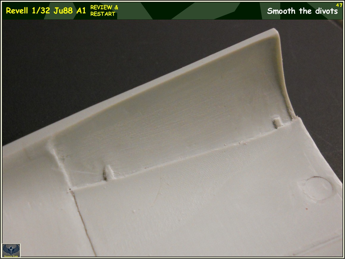

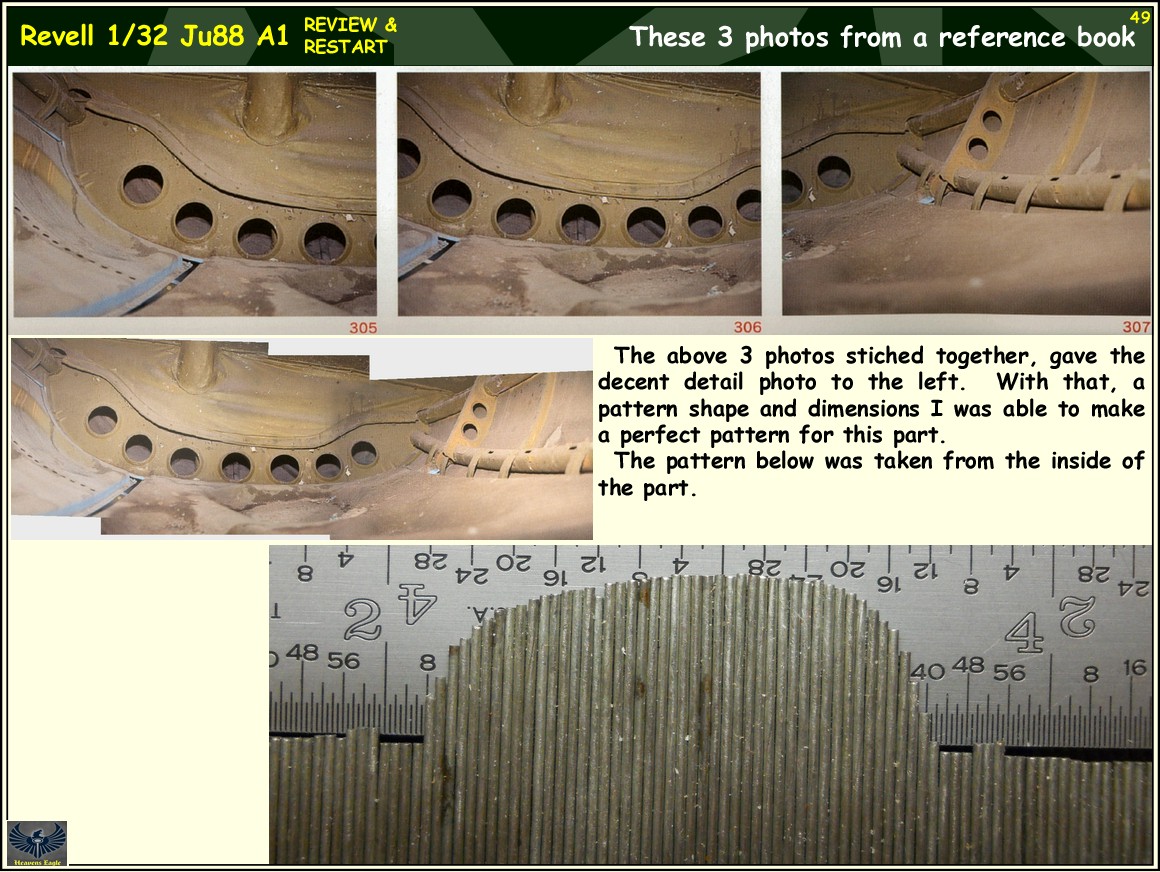

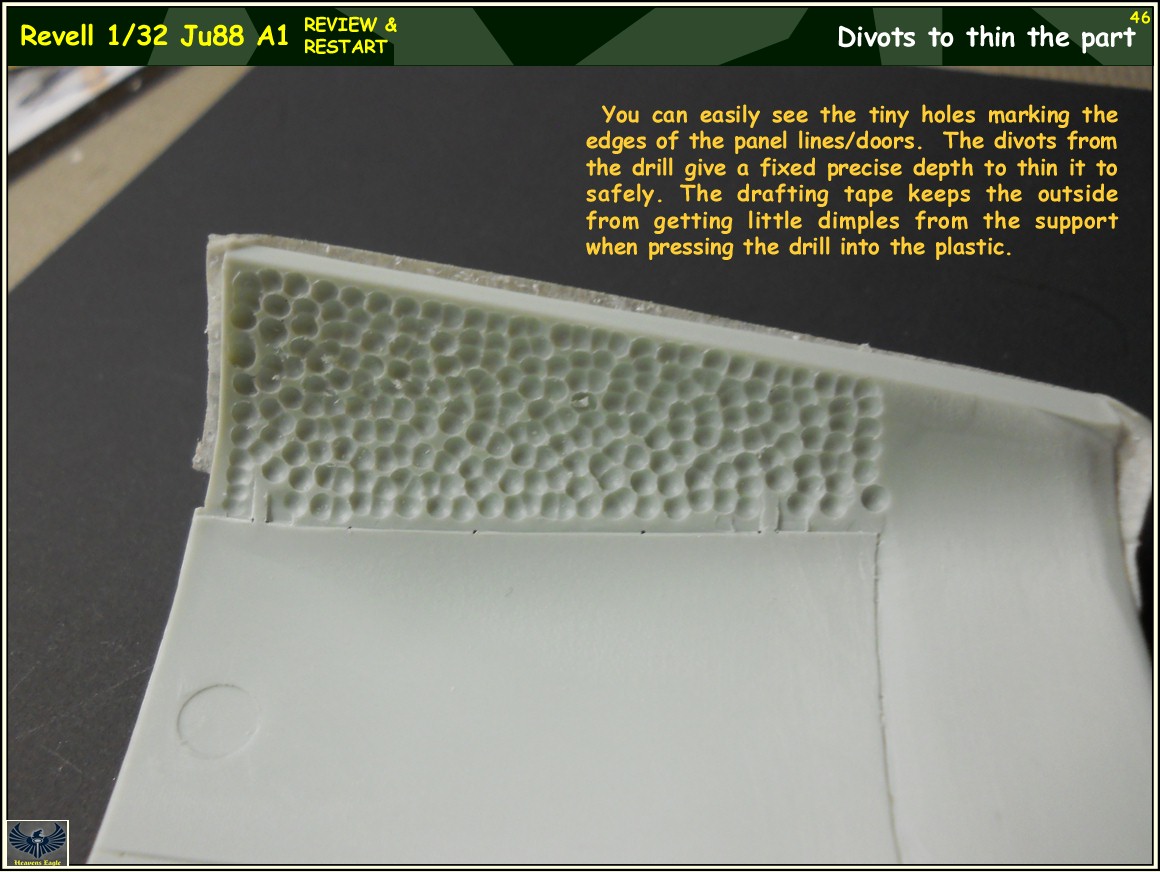

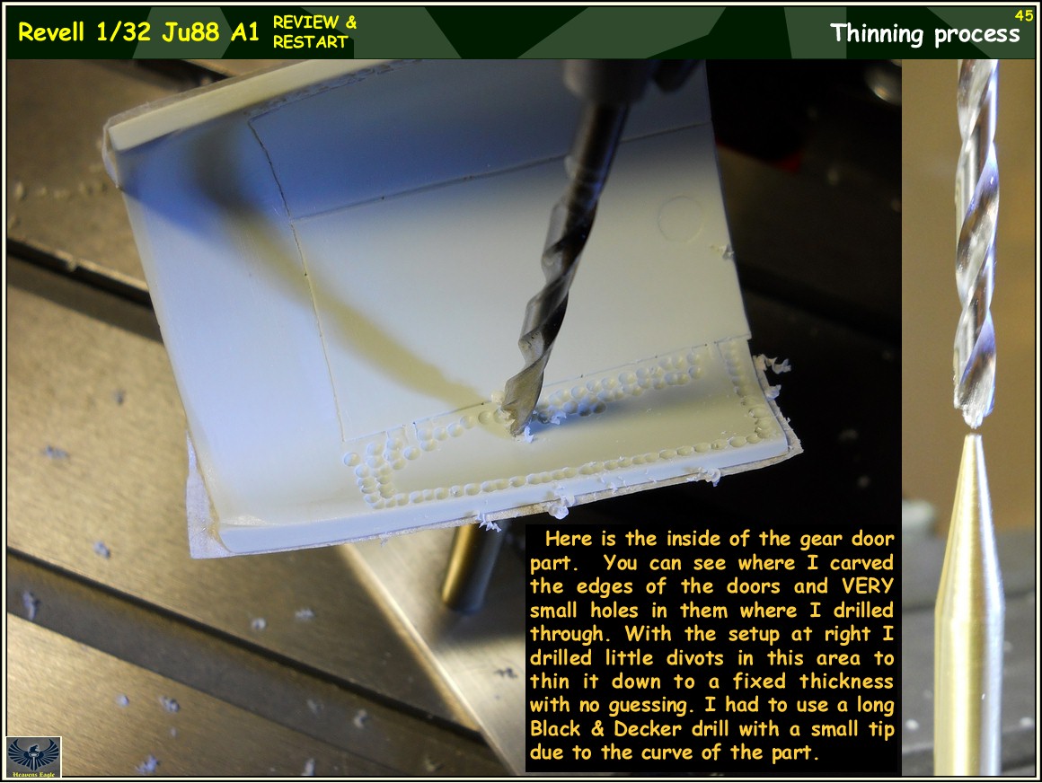

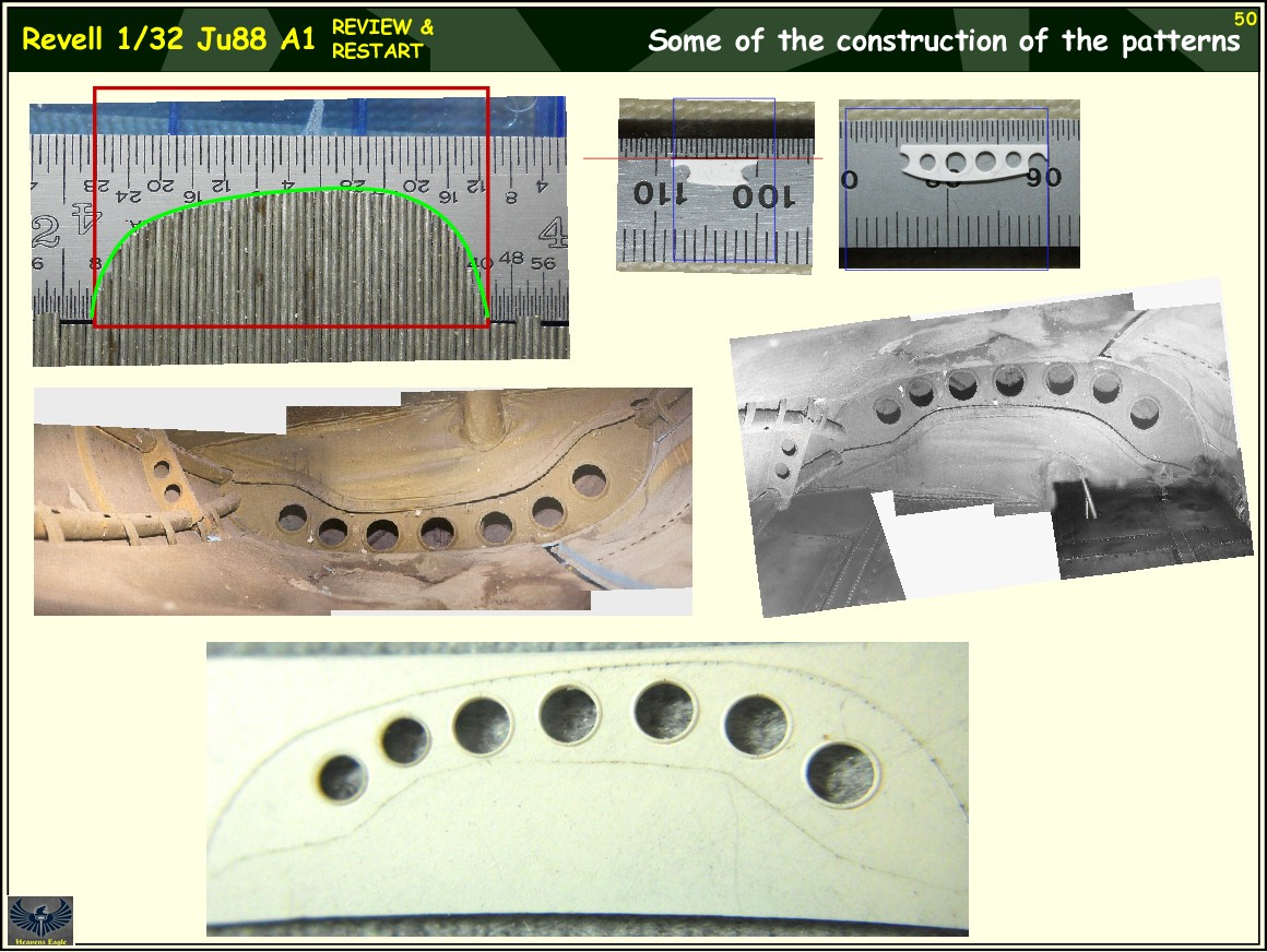

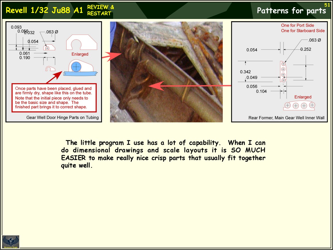

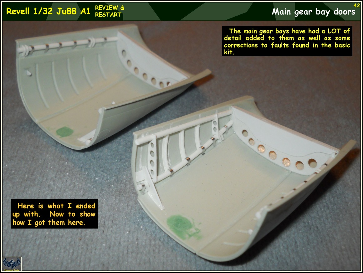

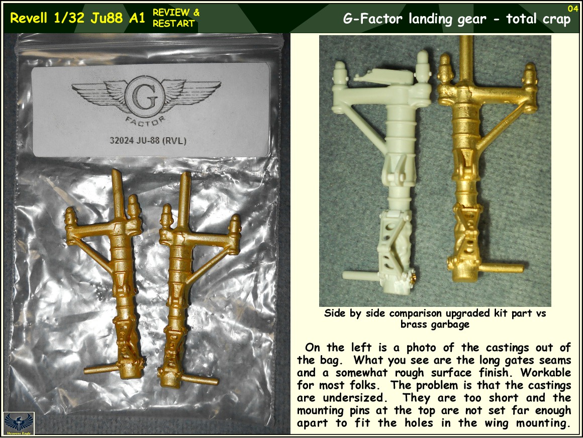

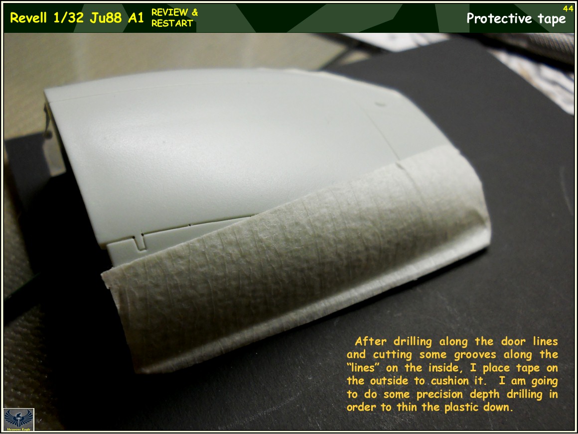

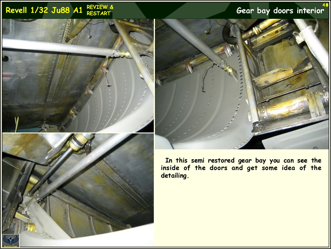

Speaking of difference. Here is the review and write up on what and how I did the main landing gear bay doors with a little tid bit that was left off the tail gear well.

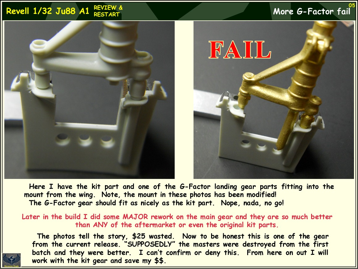

I think the next bit is on the main landing gear. It really gets quite a bit involved as there is a LOT of detail that wasn't done right on them.
