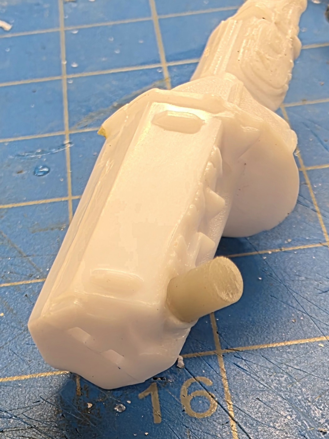

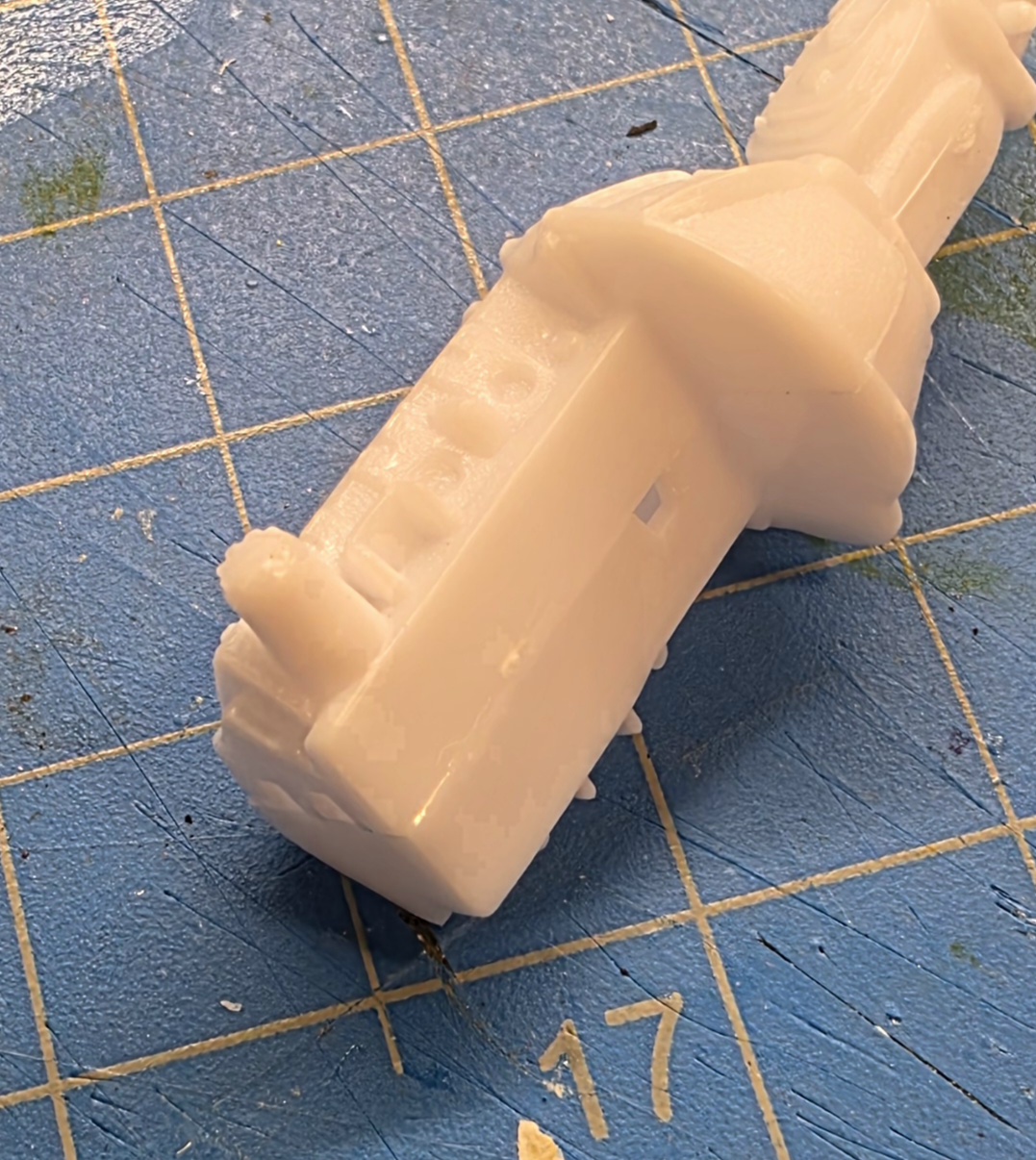

So, starting on the engine while things dry. I cut off the oil filter and filled the hile with 3mm syrene tube.
The printed oil filter is more crisp

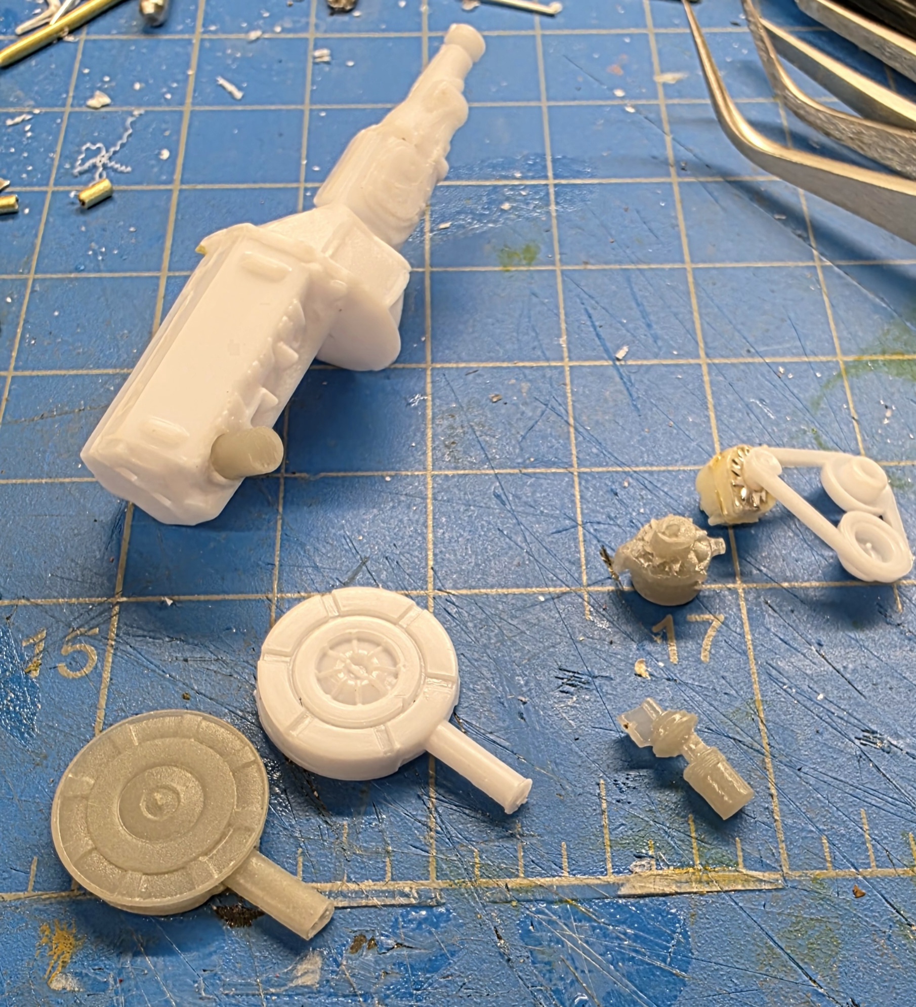

These are the parts I made. The fuel pump is not included as a kit part.
