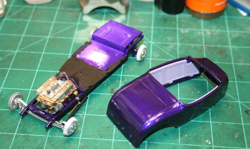

More detail painting and some assembly today, making progress. Fit is very good.
Looking less like a pile of parts and more like a roadster.

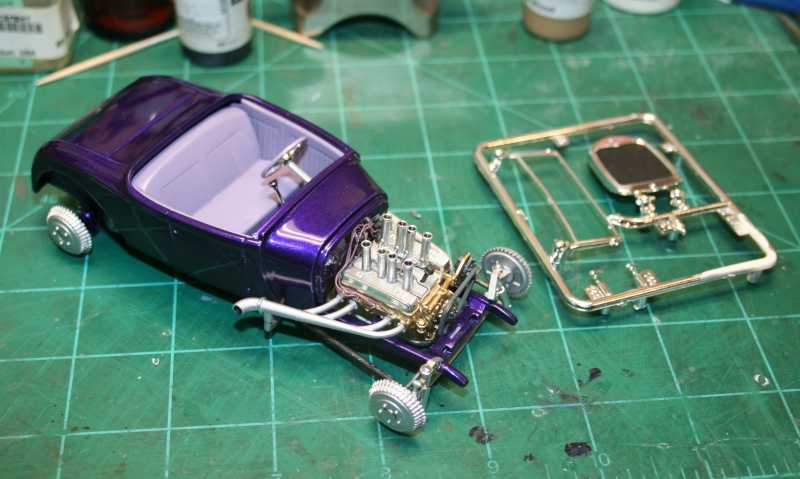

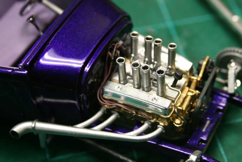

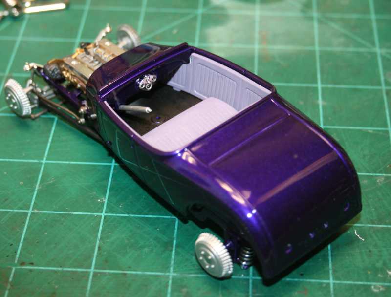

Thanks, Chris and Dave for taking time to look and comment. :good: I actually got a little further with the assembly, this is where I left it last night.
Gotta touch up that steering wheel. :facepalm
The fit of the kit is quite good, usually by now I would have swapped out and kit bashed parts, but this is almost all Revell. I was skeptical about the variants with the part # snafu on the instructions and it proved to be the case when I went to install the exhausts. If you build this kit, I would highly recommend painting all the exhaust pieces and fitting them as you assemble. I had to paint the other exhaust pipes to get stuff to line up. We're getting closer...

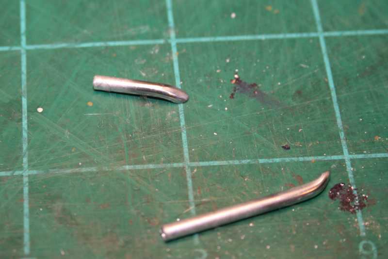

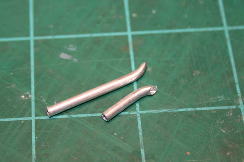

There was progress made last Sunday, but I hadn't posted the photos. I didn't like the way the kit exhaust tips looked, they were just kinda puny and the way the exhaust is situated, they would have been cocked at an angle. :S So I made some aluminum turn downs from K&S tubing. I got out my spring bender, it allows the tube to be bent without kinking.
Making them long makes it easier to handle.
I polished them with a dab of Flitz and the Dremel. Cutting them to length with a stop block and my razor saw was easy.

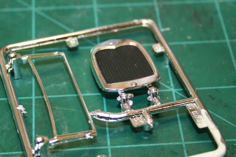

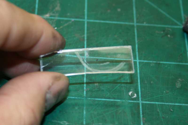

Here's the worst part of this kit. This is the clear windshield right out of the package.
Thanks, Revell. 😠
Tried to sand and polish it, but this injury is terminal.
I'll make a replacement from .015 clear styrene, looks better anyway. That thickness is more to scale. Stay tuned, I may finish this sucker soon.

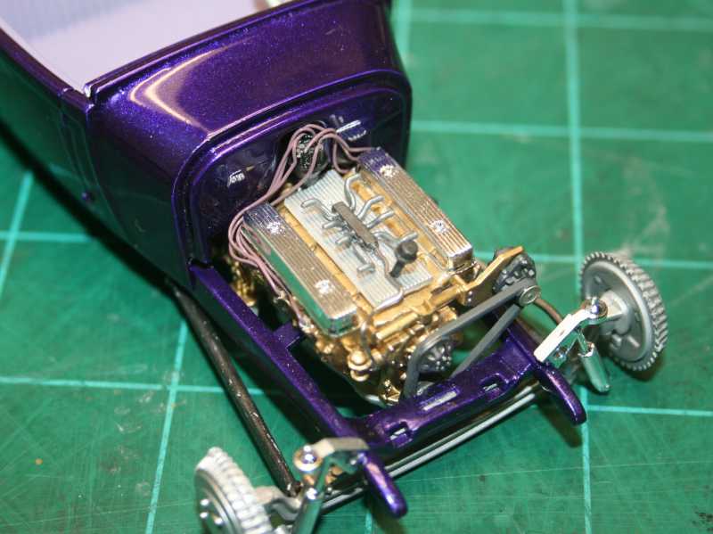

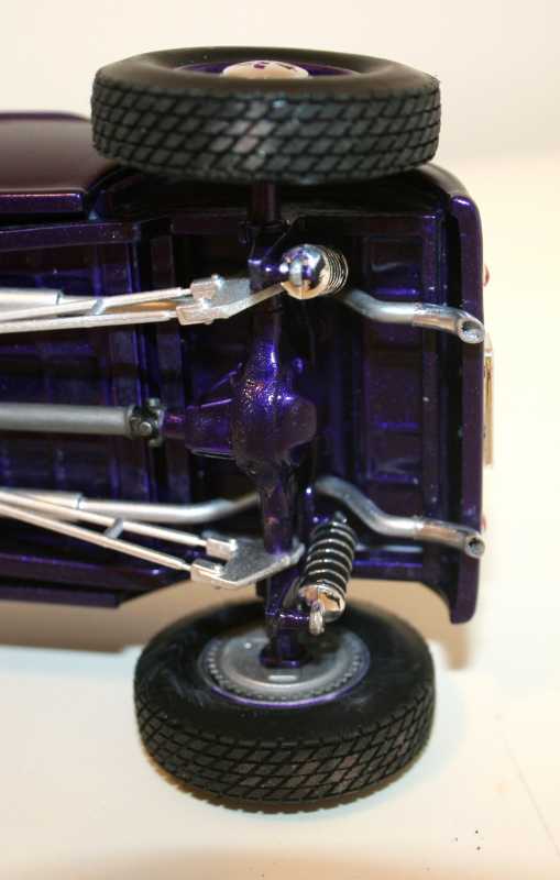

Here's where we are this morning.
Scratch built exhaust turn downs. Almost made it through an entire build out of the box. :S
This is a shot that you never want to see your rod in.

Impressive Piping! I'm digging the color Too! How about a bow shot?
