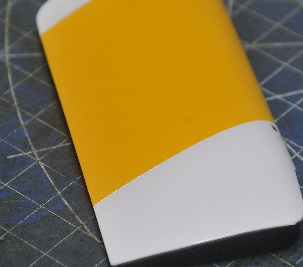

I am currently working on a Tamiya 1/12 car which involves gloss paint and stripes.
I have used Tamiya masking tape as it gives a good sharp edge however inevitably, you get a build up of paint at the edge of the tape , its hard to photo but like this
I'm thinking if i try and rub it back its going to feather the edge but i do have some 3000 grit cloth and i will gloss clear this so it will put a finish on it.
Any thoughts I'm sure others have sorted this in the past ?

Sanding off the ledge I would think but could expose the under coat. Maybe build up clear coat and sand smooth?
The best method is prevention, thin paint, low pressure, and spray the edges first aiming away from the tape, toward the center. To sand, put down the tape again before sanding and then sand. Probably not how the experts do it but it's what works for me. Yellow is probably the most challenging color with respect to this problem, and it may be better to let the paint film be a bit thin at the edges rather than add paint until you are sure of 100% coverage.
