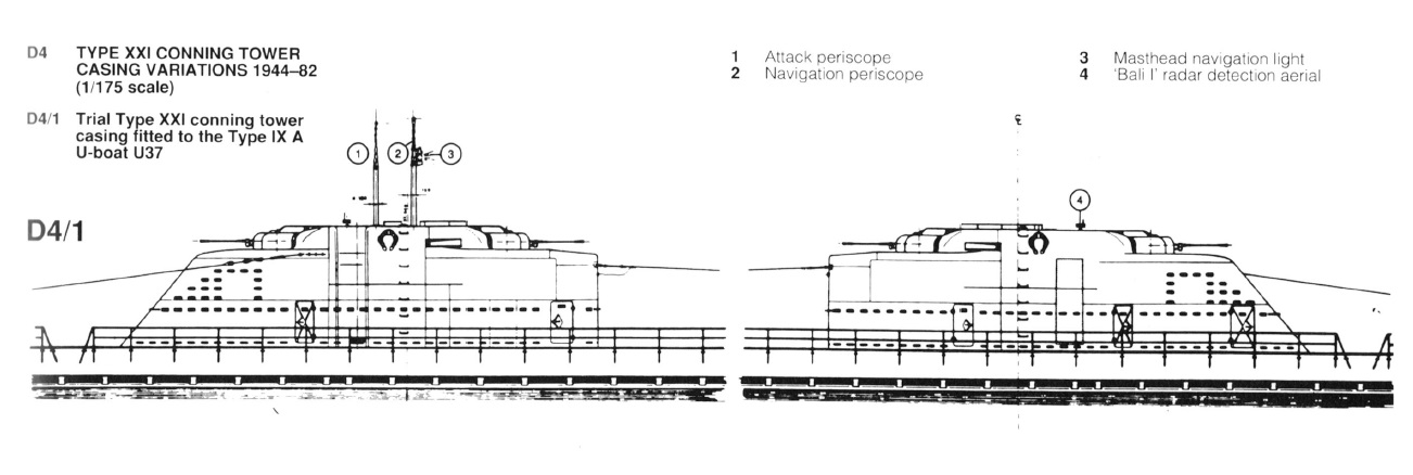

In its final phase during the last year of the war it became a trial boat, being the only type 9(or7) to be fitted with a Type XXI TOWER, the first tower completed, to be used in submerging and streamlining trials. This tower was also unique being the original design without the radar housing bump at the front and a few other details such as the flooding vent pattern on the sides.

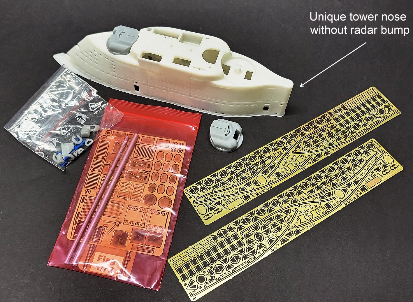

I will be combining the early Revell 9C hull and slotted deck, back-dating it to a 9A (which is only a few small details) and matching it with a 3D Printed U-37 specific Type XXI proto tower. I will use some extras I have left over from the various PE sets and rebuild the under-deck torpedo storage covers with strip plastic. Revell has incorrect patterns for these covers and have used an 8 plank pattern on the strip covers that should be only 7 or 6. I will need to study U-37's early deck to determine all the details acurately.

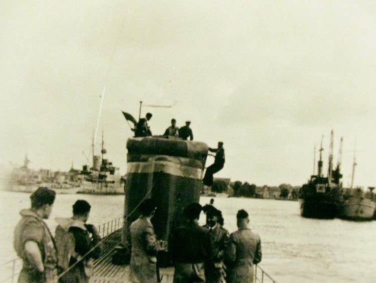

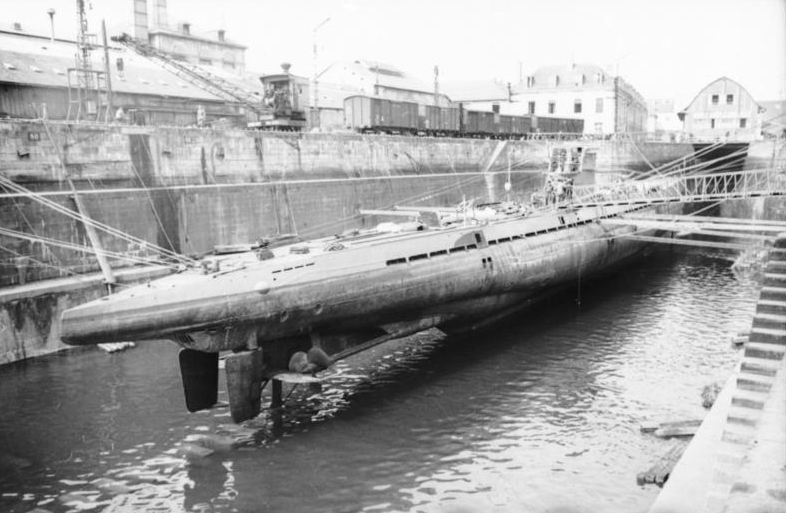

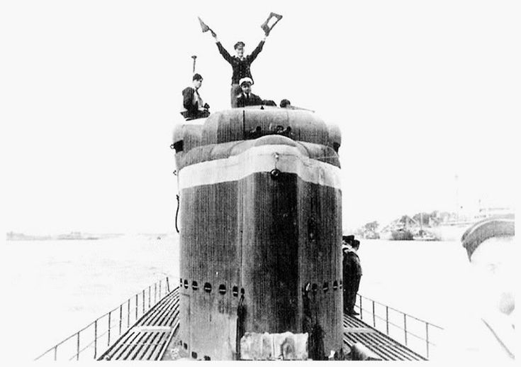

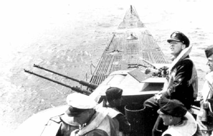

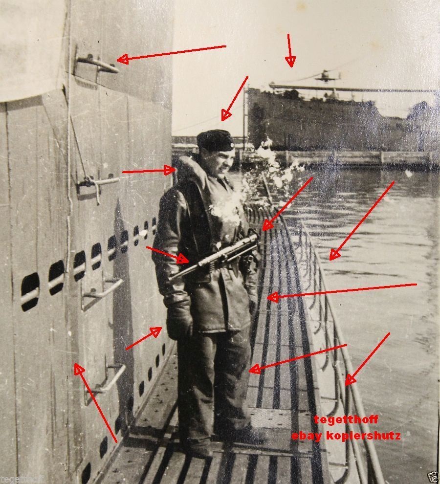

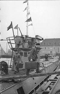

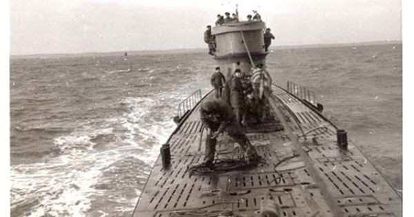

I have scoured the net and only been able to come up with a few photos of the late war trail tower version and a few of the early slotted deck. The U-boat tower has a yellow stripe around it and the forward deck also has a yellow strip across it denoting a training vessel. In the last photo you can see the net cutter.
Early tower and deck
200px-Bundesarchiv_Bild_101II-MW-5613-30A,_Wilhelmshaven,_U-Boot-Männer_gehen_an_Land.jpg
1944 with TYPE XXI TOWER

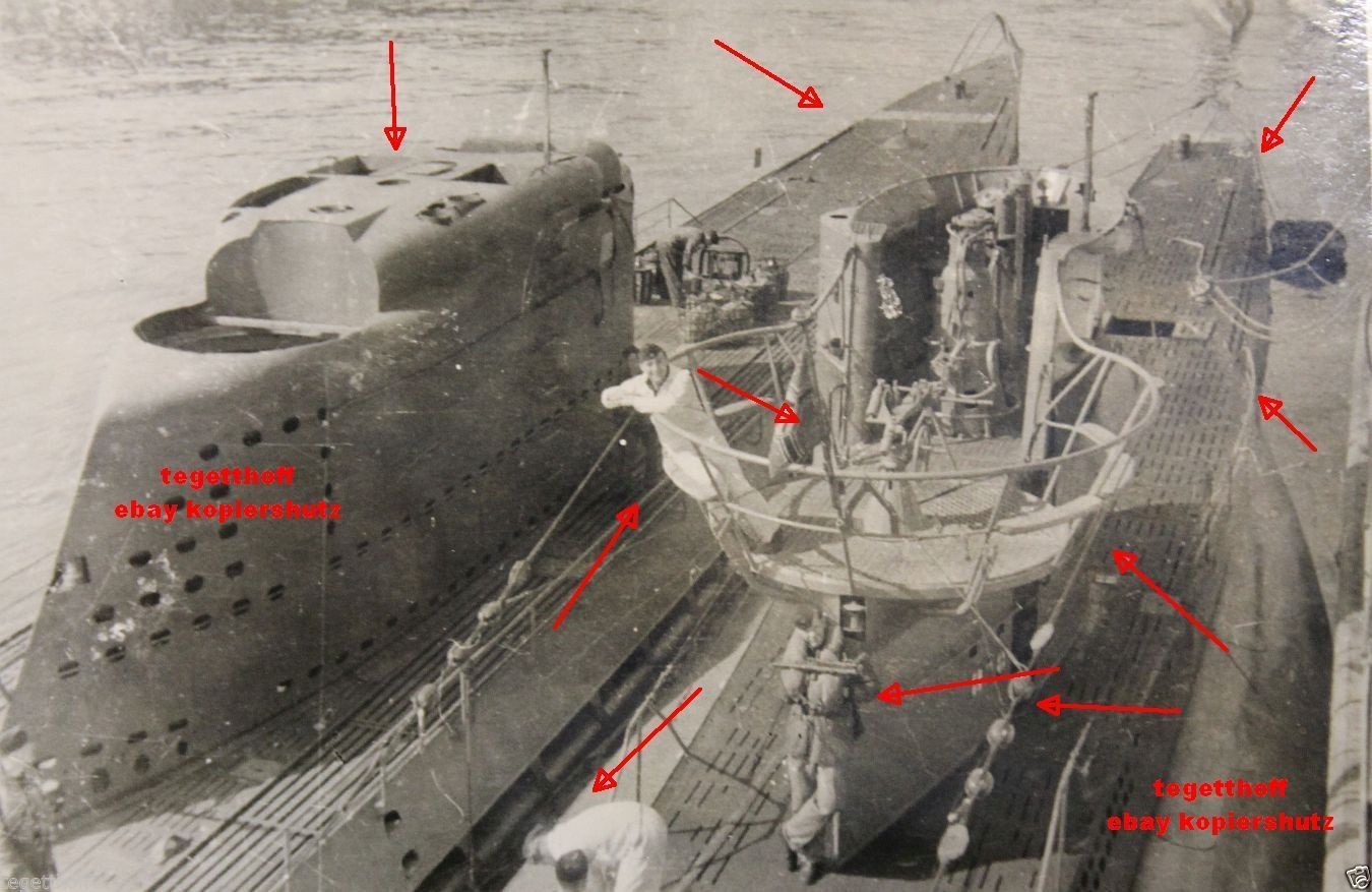

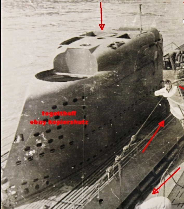

Through my sources I have had a few more rare photos of this boat turn-up, showing more details of the tower.
These new photos show that the rear turret has not been installed as yet and the tower doesn't have the typical shape at the rear, leading into the turret cavity. It seems to be more curved.
Also these photos show the complete lack of doors at the deck level in this proto tower.
Other details that don't seem to match are the tarp draped across the white stripe, running around the top of the tower and a different configuration at the front of the bridge, one that seems to fit in with a production series layout but it still lacks periscopes. As you can see below, the earlier photos show a more open bridge without the rectangular sections that divide the space.

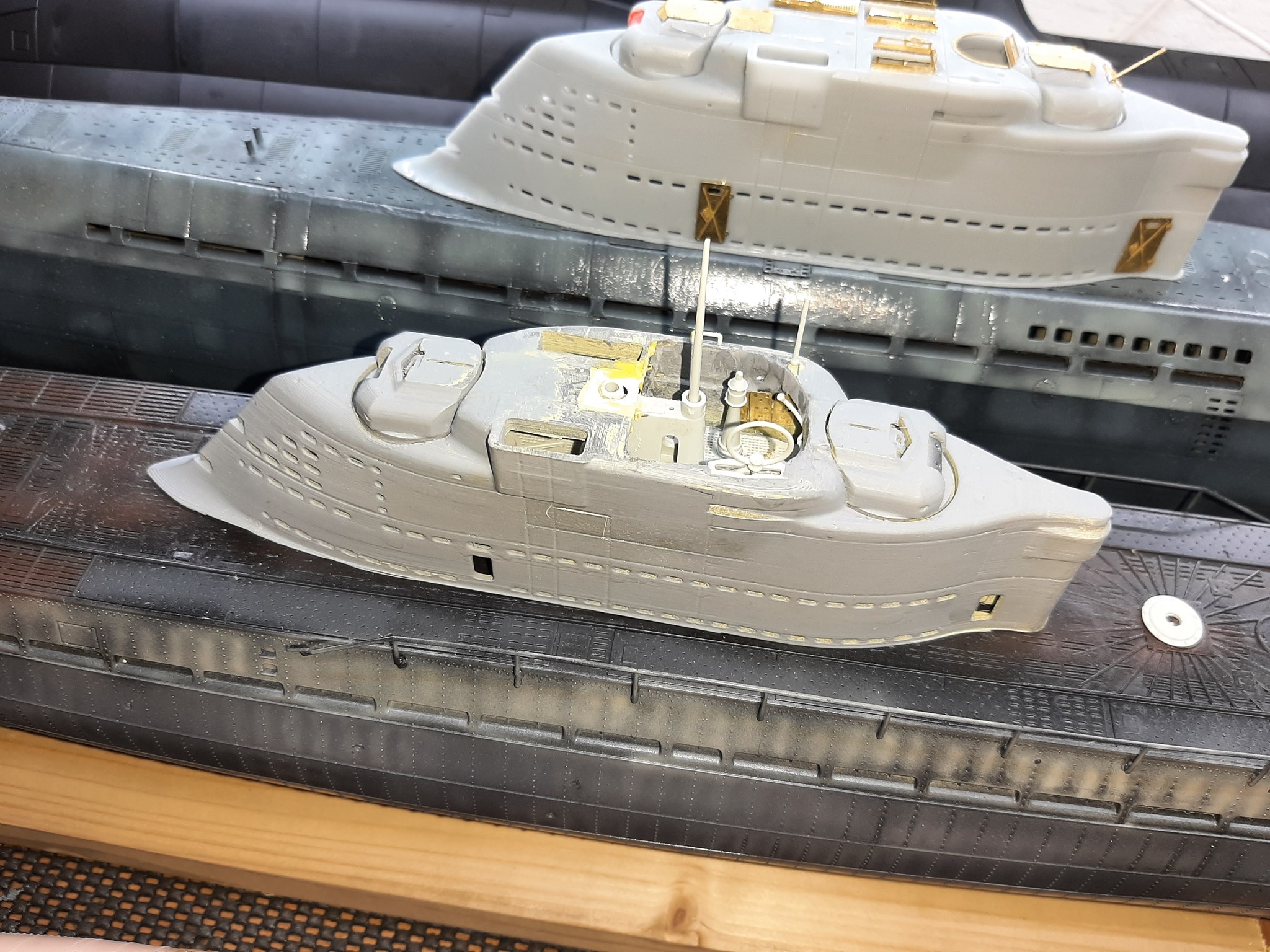

The model below[from RC SUBS, has been modified in this way compared to the later prod series behind it. You can clearly see the change in shape at the right rear turret that has not been applied on the model below.
