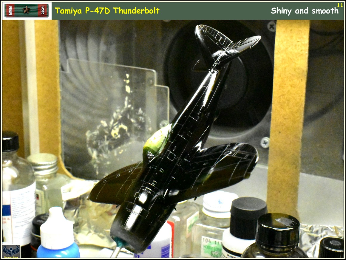

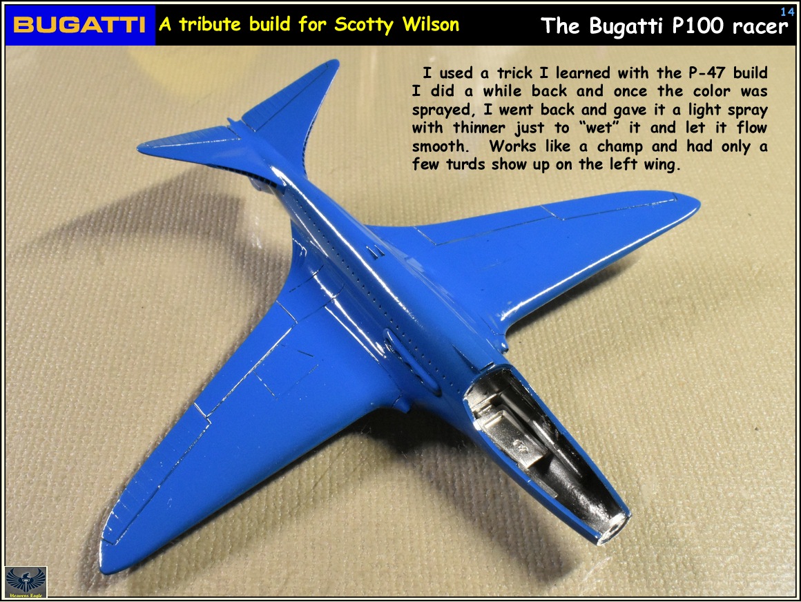

I have used this process quite a bit since I discovered it. As to the turds, (dust specs) I simply took my super pointy #5 tweezers and plucked them out while the paint was still a bit soft. Then the wet mist of thinner retarder and have a smooth glassy gloss coat.

I feel like I got it with the black base of Alclad finishes. also didn't do back with the first version of Black Magic. Did a flat color then progressive gloss coats.

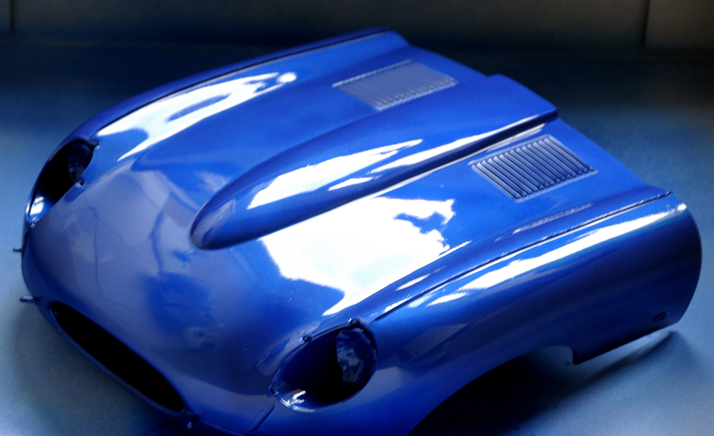

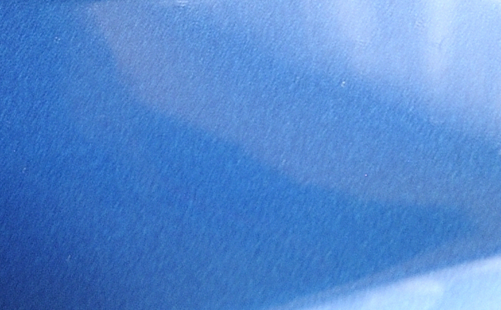

This where i am see the bit just above the headlight at the bottom
this bare paint

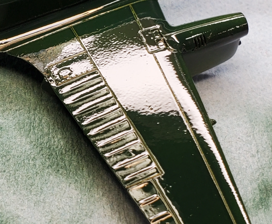

this is about the 3 or 4th time I've stripped the Green One and every time it orange peels. I've tried thin coats built up slowly, heavy thick coats...all of it orange peels. I'm going to sand this and clear coat it.
Resin is porous to a small degree. When you strip it, leave it alone long enough for the solvent of the stripper to cure all the way out.
Even if it's just Windex (amonia).
You have a surface prep problem. Park it in the sunshine for a couple of days. You must not rush the chemicals.
I advise against using Humbrol clear over Tamiya acrylics. Enamel paint is unharmed by acrylic clears. It seems the reverse is not true.
I think this is it. I did let the Tamiya yellow cure overnight before hitting the Humbrol. You told me before, I'm not letting the chemicals work. I'm going forward with the sanding to see how that works today.

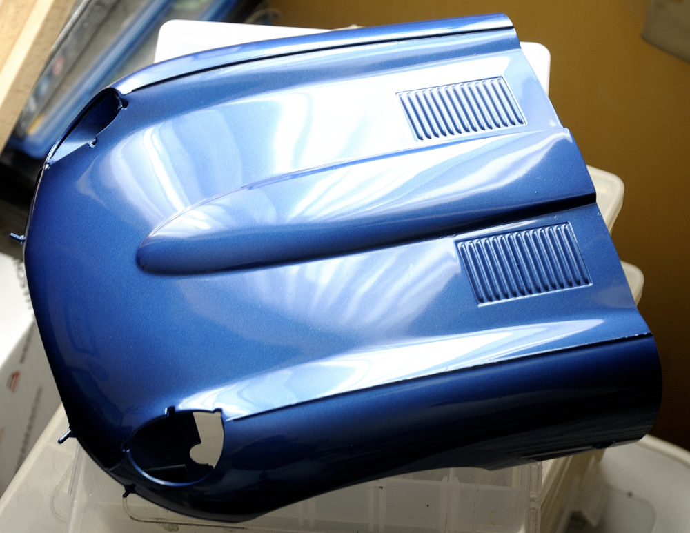

I wasnt happy with the dust i had although it was only a few specs it did notice. I flattened the whole thing back to a uniform finish with 3000 grit and removed the dust but then i found if you do that it also removes the metallic effect
I am using Tamiya rattle cans with Mica paint thats like a std metallic but much smaller particles so more to scale on a model.
I want to now give it a clear coat but I'm paranoid about dust now having got rid of it in the colour coat so i got some of those vacuum packed lens cloths today and will give the paint another day to harden then go for the gloss clear, all being good i will give it a week then cut the clear coat back..
Here is the dust free attempt and also a close up of the fine metallic
I think my problem was the part was originally sat in a box and the spray stirred up dust, this time i did it hanging in the open so no dust to disturb.
Any way....pleased with these results. :)

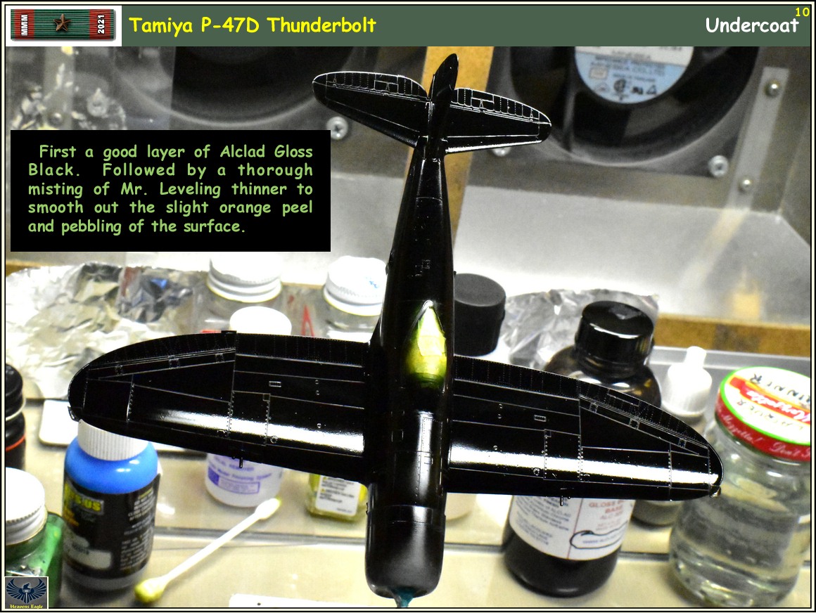

With the Alclad paints I do different solvents. Alclad has an airbrush cleaner that I have used to thin their metallics. I have sprayed their gloss black, flat black, and primer grey directly from the bottle.
To make the gloss black settle down and the orange peel and pebbling go away I sprayed some Mr. Retarder on the gloss directly as a heavy wet mist. Just enough to make the surface of the paint look wet and it then settles to a smooth almost glassy surface. I did this with a Testors gloss blue paint on the Bugatti. NOTE: I did the thinner (retarder) overspray right after spraying on the gloss coats so they were not fully dry yet and it worked perfectly.
