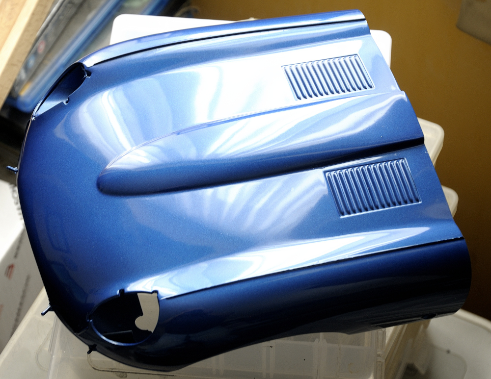

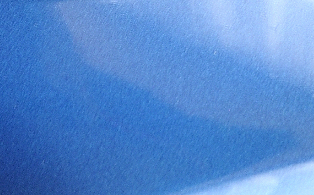

Ok so an update.
I wasnt happy with the dust i had although it was only a few specs it did notice. I flattened the whole thing back to a uniform finish with 3000 grit and removed the dust but then i found if you do that it also removes the metallic effect
I am using Tamiya rattle cans with Mica paint thats like a std metallic but much smaller particles so more to scale on a model.
I want to now give it a clear coat but I'm paranoid about dust now having got rid of it in the colour coat so i got some of those vacuum packed lens cloths today and will give the paint another day to harden then go for the gloss clear, all being good i will give it a week then cut the clear coat back..
Here is the dust free attempt and also a close up of the fine metallicView attachment 168174View attachment 168175
I think my problem was the part was originally sat in a box and the spray stirred up dust, this time i did it hanging in the open so no dust to disturb.
Any way....pleased with these results. :)
That looks almost flawless, Paddy.
