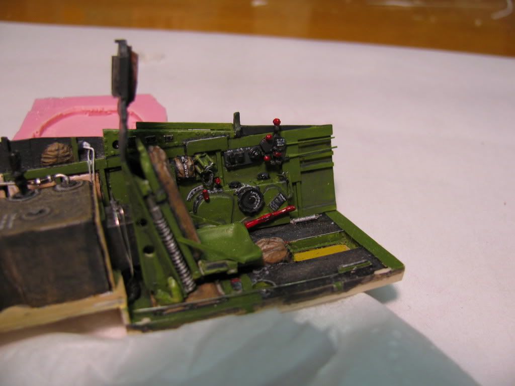

test fitting with the IP in place and I end up with about a 3mm gap right above it. Can't close up the fuselage. Guess I should have thinned the side walls down to paper thin. I can't trim the IP itself. Did I say... :bang head :bang head :bang head

I'll do some pictures. I'm going to have to cut into the resin sidewalls but that's going to obscure details along the edges of the IP. I don't know why I didn't dry fit with the IP in place to start with. Probably because all those loose parts just don't dry fit well..I tried this with both the kit part and the resin IP, same result.

Here's some pictures.
First two are without the IP in place. The Resin firewall is in place and lined up OK.
And here's the one with the Rutman IP
closer to 2 mm instead of 3.
And with the kit part in place, which I opted to go with including the Ed color pe.
I can probably shave down a mm on each side to make this work, that's not reallya problem. After reading Jerry's neverending build and someone elses, I have no doubt it's something I looked over but I don't know how I could shave the side wall down further as it is already paper thin.
First off the IP looks really good. How does this IP compare with the one in the kit(same shape and size)? The kit maker has probably taken liberties with the kit IP to make it fit into their cockpit. The only way I can see to fix this is to take material off the IP until it fits. :(
Terry the first two are Jerry Rutman's IP that I decided not to use, the second two is the kit with the Eduards color PE installed. Both IPs are identical width.
The reason I asked was several pits I've done (not P-51) the IP almost always sits at the end of the side wall, not attached to it but from the looks of things yours attaches to the side wall. Was there a mounting point on the side wall for the IP ?
The panel should be centered before the sidewalls. Compare to these images:
